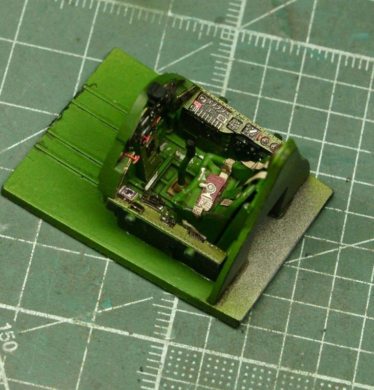

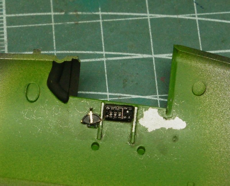

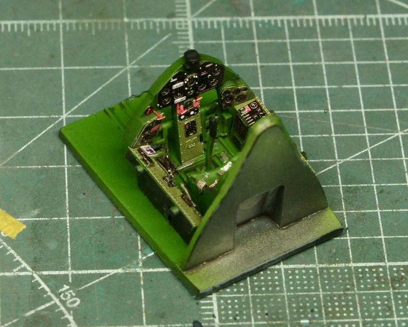

Started building the cockpit. The molded in detail that will be replaced with PE was removed using a chisel and then sanded smooth. All the parts where primered in Ultimate black.
I then painted the cockpit in aluminium, followed by a couple of coats of chipping fluid.
The cockpit was painted green and then using a damp brush some of the paint where chipped off.

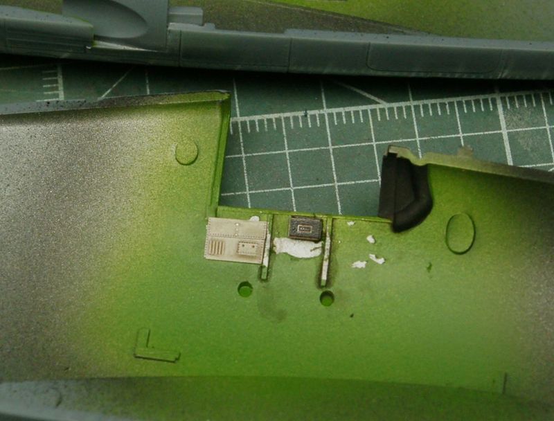

Finally I started to add all the PE.

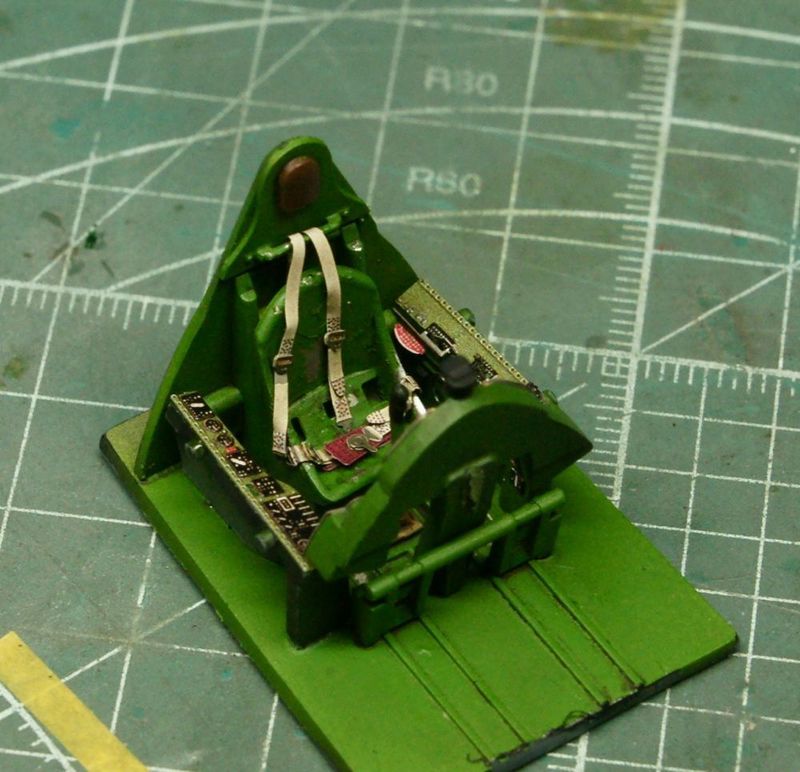

Work on this have been really slow, due to trying to get a lot of other projects done. But now it's time to get something done. Finished the cockpit by adding PE seat belts and the PE on the inside of the fuselage. Finally adding a dark brown oil wash to the whole cockpit. Got the fuselage it needed a bit of filler, probably more then it should due to my resin rear half not being perfect. There is still a little bit of sanding left and then start the rescribing.

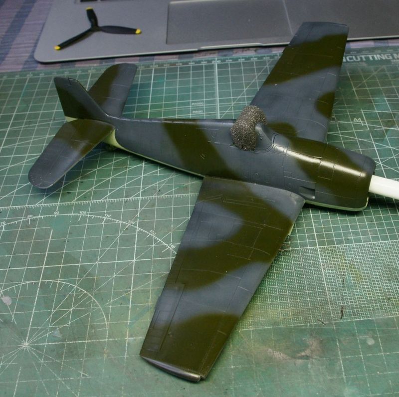

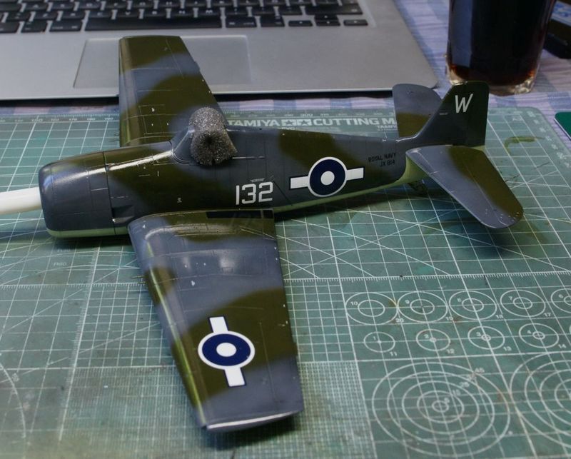

I've made some more progress on the Hellcat. Got it painted using Tamiya XF-24, XF-62 and Mr Hobby H74, then clear coated it using Aqua Gloss and applied the decals.
I then applied a second coat of Aqua Gloss, now I had some reaction with the gloss coat and the Micro Set or Sol. The gloss coat went flat around the decals.
So I lightly sanded the decals using the Ultimate polisher and applied a new coat of clear, this time using X-22 and leveling thinner.
Just waiting for the clear to dry and then it's time for a Dark Dirt wash.

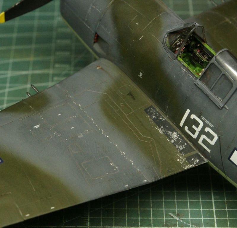

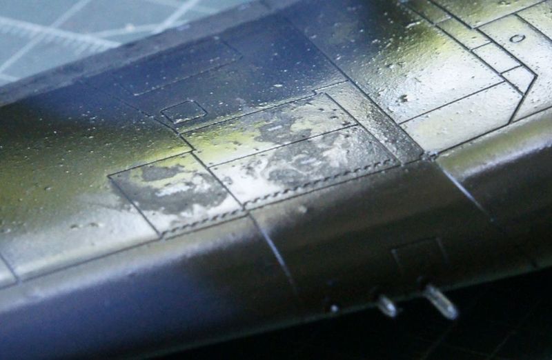

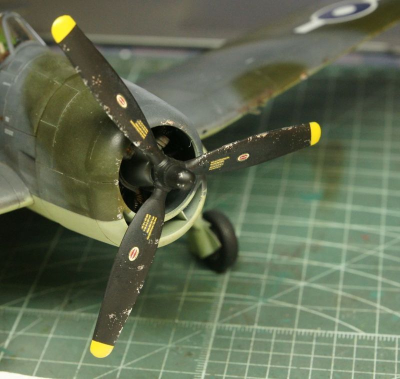

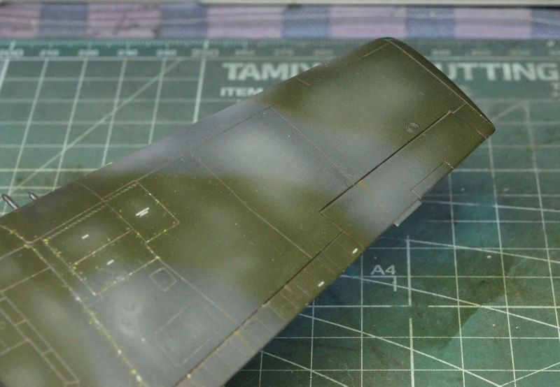

Final update on this, have been doing a little bit of weathering. Started with an oil dot filter, using blue, yellow and light grey.

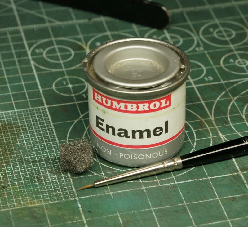

I then added some small chipping using a fine brush and sponge with Humbrol silver.
I thought the paint was a bit too uniform and the grey a bit too dark. So I mixed about 4 ml of Tamiya X-35 semi gloss clear and 5 drops of XF-55 deck tan and used it to lighten the center of some of the panels.

Great progress. It looks really nice. I love the chipped prop.
