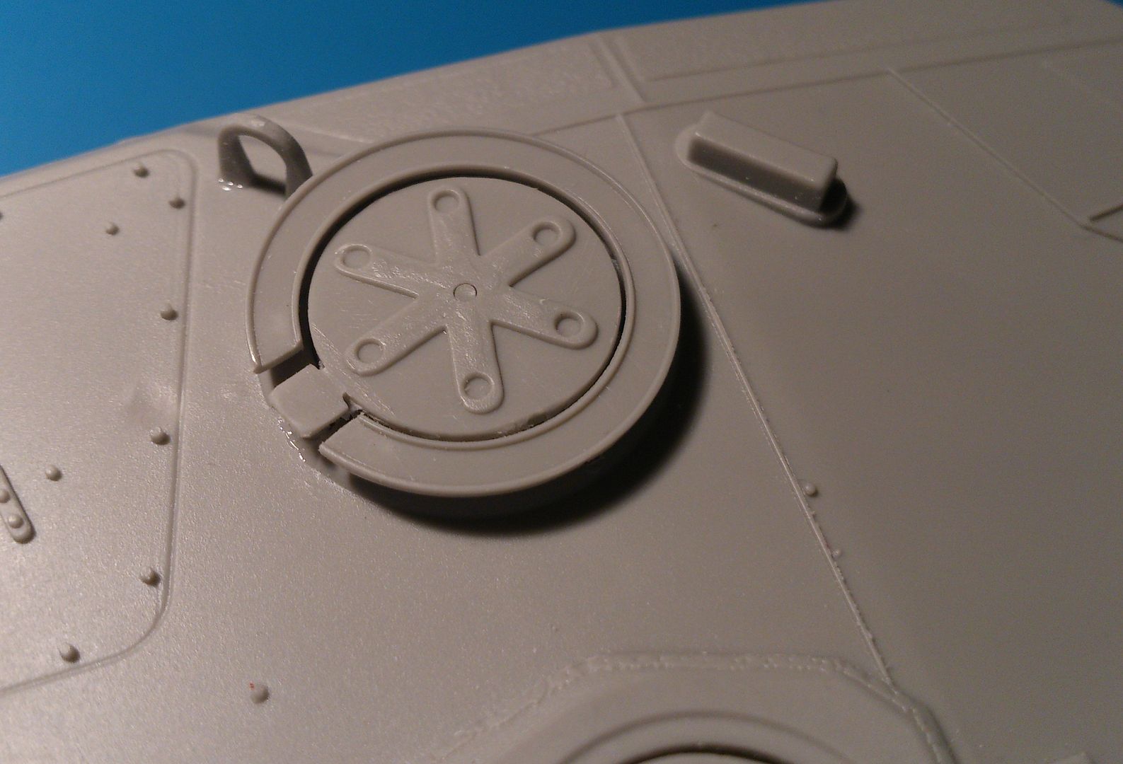

Update # 3: upper hull and attachment tools
Just a little progress during the last weeks – I’m sorry!

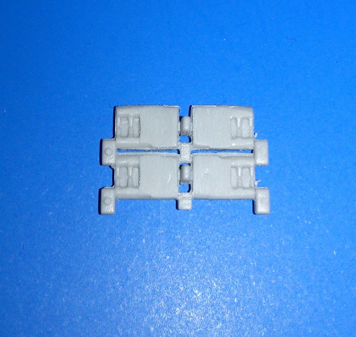

Anyways… let’s start with some penny-ante stuff… ugly pinmarks on the spare track link! Sanding smooth slightly was quite enough as is mostly the case on this kit (no filler needed):
Plan on painting the attachment tools / accessories separately that I have not added them on:

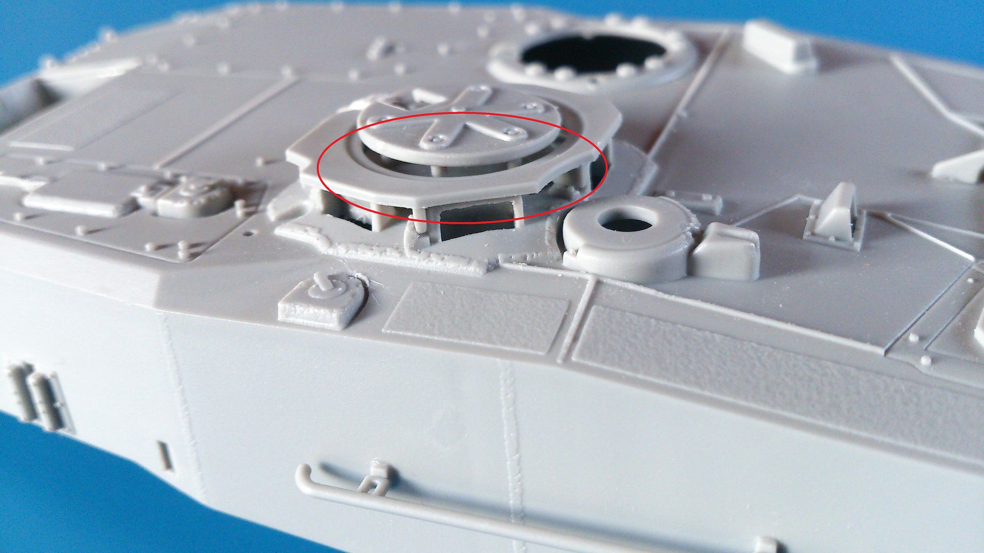

Oh no, not again
! More pinmarks – is that really necessary
? To come along on top those are located between the “ice claws”. Why not at the backside? Why
? Scratch and bite was in order now
… folded sandpaper was the only possibility and it worked so-so. The result looks pretty bad… that’s why I didn’t add all available ice claws as well.
Damn … I should have taken the pics from a greater distance

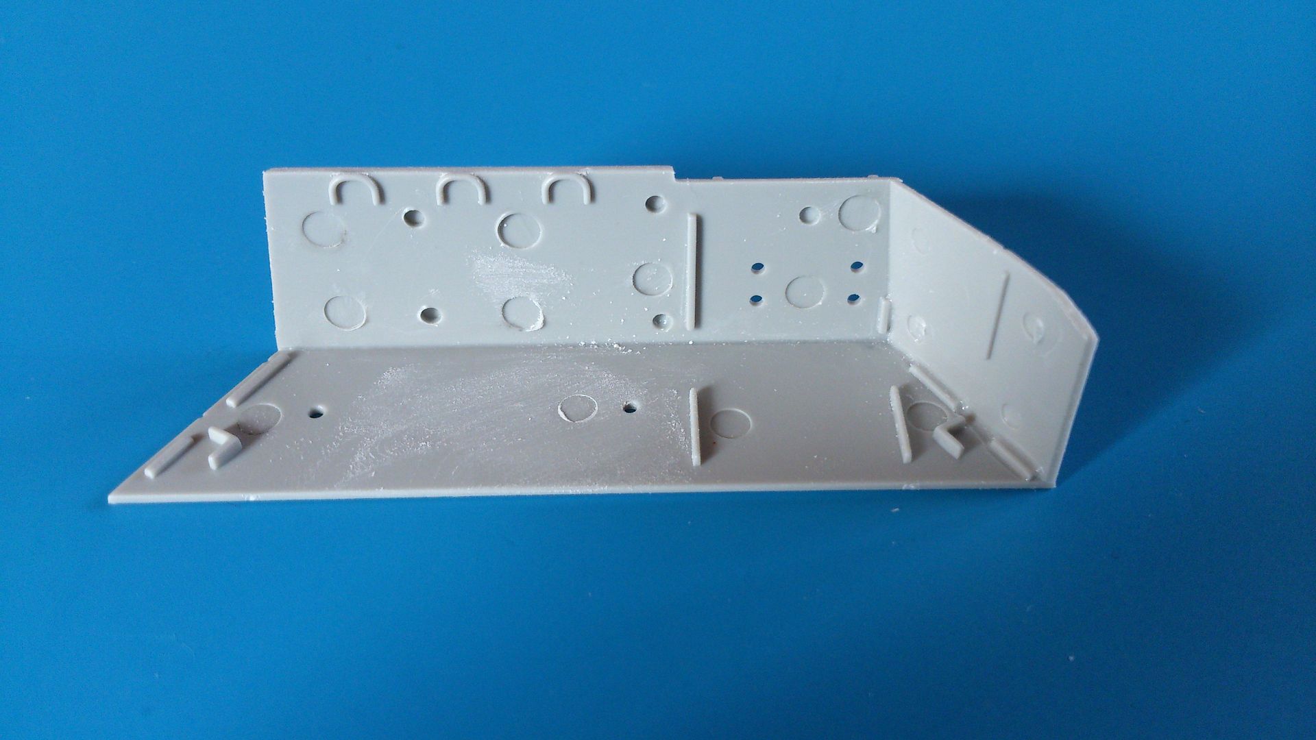

Horrendous gaps between upper hull and fenders (on both sides)! Enough to make you weep! No chance for sanding the angles. How to get there
? I’ve no idea! All you can do is applying some Mr. Surfacer 500 carefully (not too thick) and trust in its ability closing up such huge gaps without forming cracks
The result was passable thought:

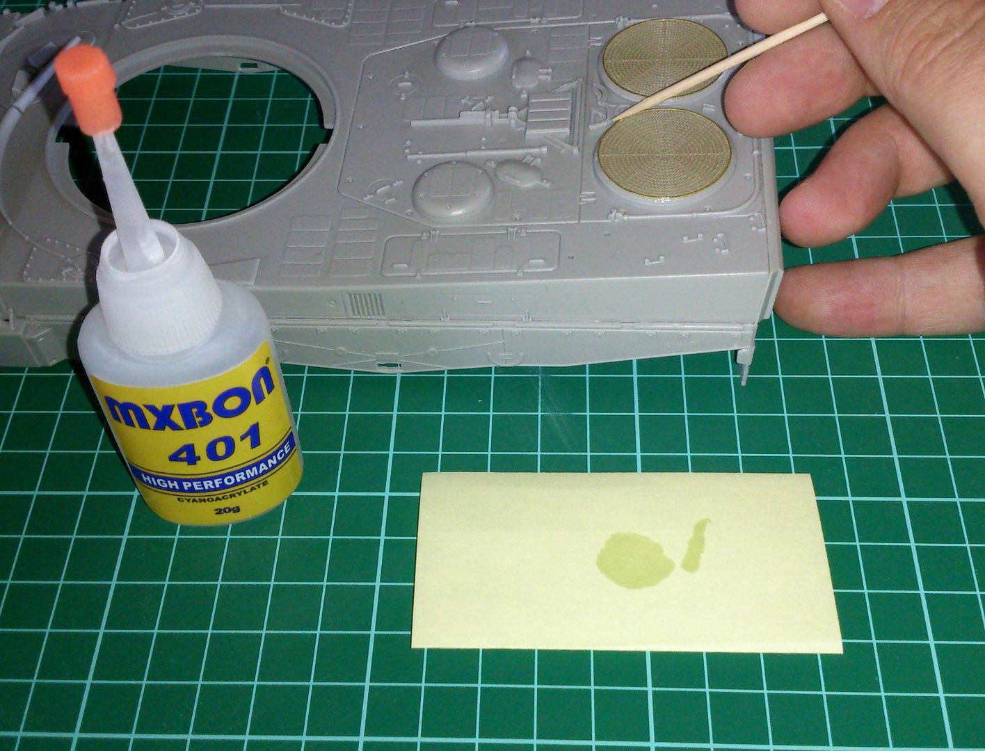

Another PE work (after the “Leitkreuz”)… the grilles. Not that complicated, no bending work just had to cut them off with my hobby knife and glued them in place with extra thin super glue while using a toothpick as an applicator. How shall I put it? … the PE-grilles are looking really wicked and now I can understand why all y’all are so hot for PE … cos it looks hot indeed
! Am really delighted with those grilles:

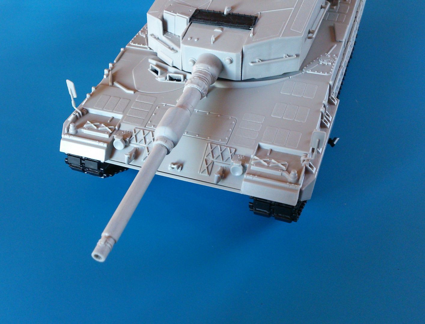

Upper hull completed
Conclusion up to here:
That recent stage was a little arduously cos plenty of spackle and sanding work on awkward spots had to be done and you get less progress as a reward for that. All in all it was a small bit time-consuming but I had lots of fun during the work nonetheless. Next update will following hopefully soon and will show the assembling completion.
Previously I wish you guys and your families a Merry Christmas and a Happy New Year! Hopefully Santa will give you all you wish for or everything you need. Take care guys and enjoy your holidays …
Please feel free to post any comments (also criticism is allowed)!

I had all of the same issues with my Leo2A6 CAN Markus. The ice cleats where the worse. What a pain to get those pin marks out. The gap along the hull sides was tricky to deal with too.
Have you made plans for the Non-Slip surface yet?
I don't know how necessary it is, it looks to be rather low profile Non-Slip when compared to other AFVs. You may not even see it at 1/35 to be honest.

I've to second this. The ice cleats are anything but well-engineered and it was a pain to clean them all upCoen wrote:I had all of the same issues with my Leo2A6 CAN Markus. The ice cleats where the worse. What a pain to get those pin marks out. The gap along the hull sides was tricky to deal with too.
Regarding the anti-slip surface: I'm not exactly sure at the moment

Wow Markus, those issues were a real nightmare, specially those ice cleats... geeezzz I would be tempted to scratch build the parts....
Great work dealing with those troubles my friend, I looks very, very good!

Ok ... some issues are infuriating indeed
Scratch building the ice cleats was also an option I considered first

Visible pinmarks on the stowage box had to be filled and subsequently sanded …
The stowage box didn’t figure exactly
that more filler was needed:

And now a construction fault of the kit to my mind
: much overhanging hatch on the commander’s side! In order to remediate the problem I had to sand down plenty of material from the bulge which is located around the manway that the hatch could be flush-mounted:
Diametrically opposite on the loader’s hatch: Much too low-lying hatch here! Resolving the problem was much easier here as on the commander’s hatch. The only thing I had to do was glueing two pieces of styrene from below that the hatch could be placed on flush...
Rubber part on the gun mantlet is super-glued in place
The gap between the two sections of the gun barrel could be closed with some Mr. Surfacer
The result after sanding looks not too bad and I’m happy with it
Finally some pics from completed assembling

That's looking really nice now Markus. There's some cool differences between your kit and the one I'm working on.
That rubber guard on the mantlet being one. That looks pretty sharp.
Does it flex when you move the gun or is the gun now fixed in position?

Many thanks Coen!Coen wrote:That's looking really nice now Markus. There's some cool differences between your kit and the one I'm working on.
It flex indeed and the gun is still workable!
I guess that the differences between our two Leo's are that enormous that your canadien version and my german A4 version have less in common anymore (in terms of their appearance at least) after all those modifications I've seen on your variant ... it's considerable actually!
In my opinion it's also a very fascinating aspect cos of the large number of different Leo-varieties you're able to keep its history of development under review!
