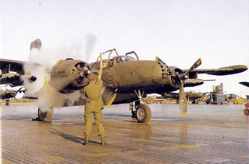

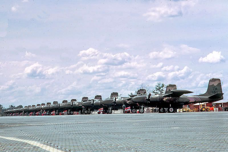

Some Vietnam era Imagery
SOURCE: http://www.warbirdinformationexchange.o ... 5&start=30
SOURCE: http://commons.wikimedia.org/wiki/File: ... _start.jpg

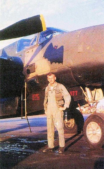

SOURCE: http://www.warbirdinformationexchange.o ... start=2415
The image above is of the plane I'll be modelling. A-26A/B-26K Serial 64-17677 was flow by Al "Batman" Shortt (pilot) and Larry “Robin” Counts (navigator)(pictured).

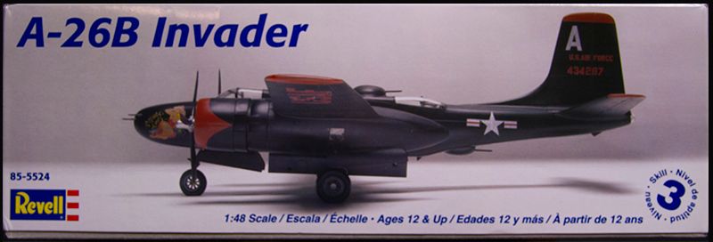

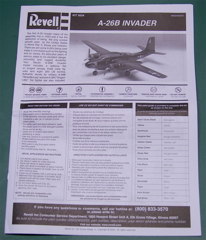

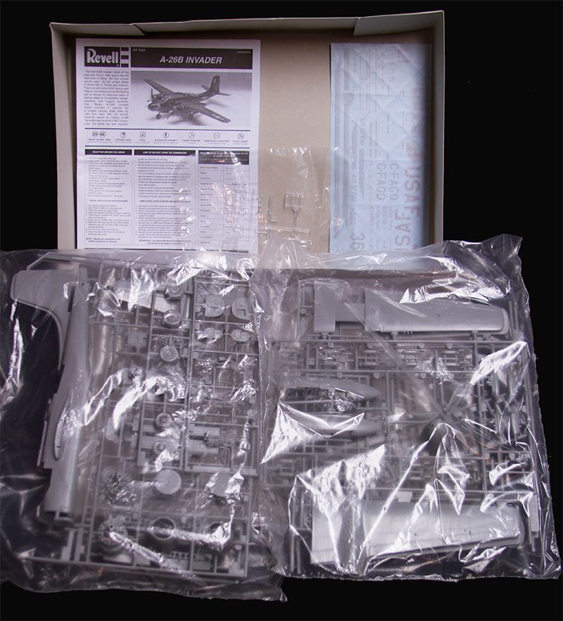

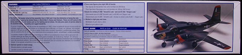

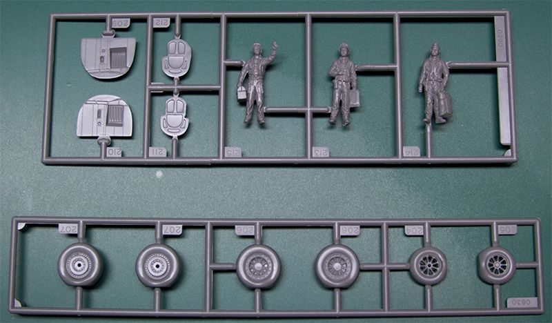

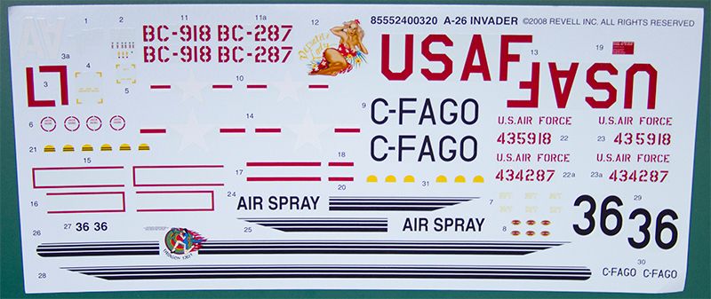

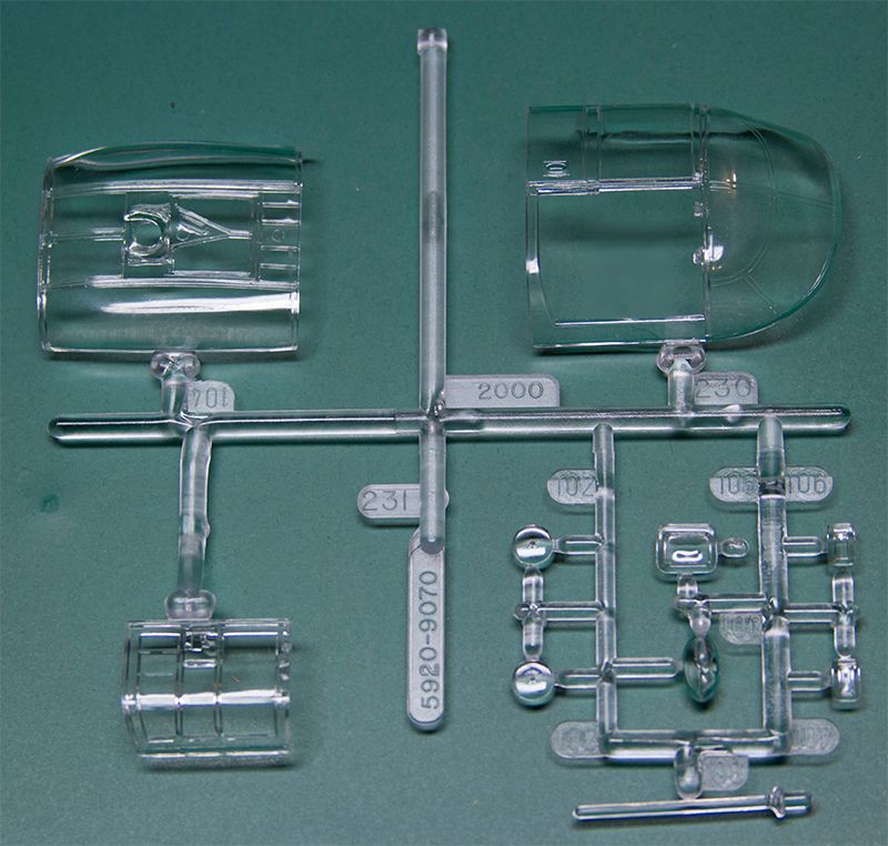

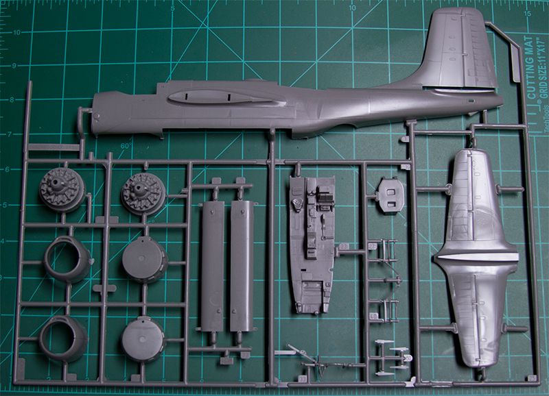

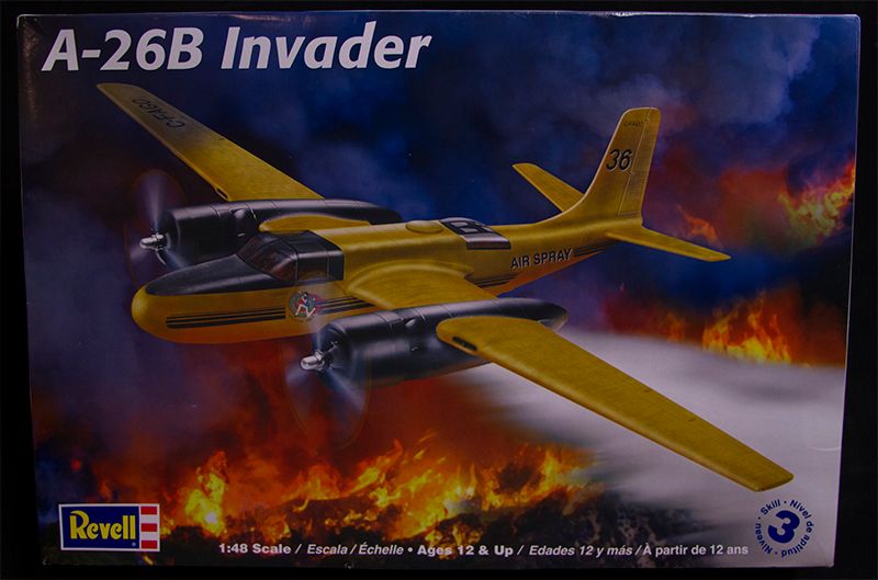

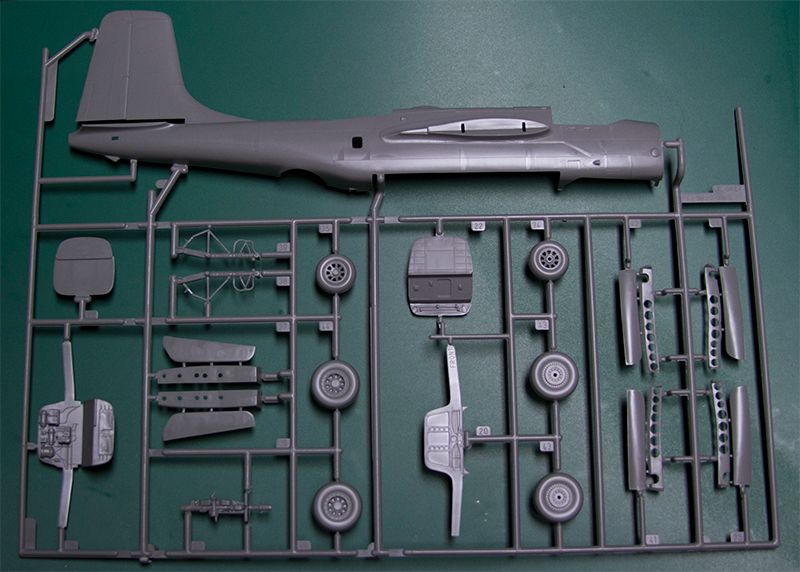

Revell 1:48 A-26B Invader kit
Some of the Required Kit Modifications
- Tip Tanks (A-26A/B-26K had 165 gallon tip tanks installed, not part of this kit)
- Rudder (A-26A/B-26K rudder chord was increased, kit rudder will need to be enlarged)
- Canopy (A-26A/B-26K canopy was late type "clamshell" canopy, kit has early type "flat" canopy)
- Cockpit (A-26A/B-26K had dual controls and an expanded instrument panel, kit has single controls and half width panel)
- Antenna (A-26A/B-26K has numerous antenna for special operations, kit has no antennas)
- Gun Turrets (A-26A/B-26K has no upper/lower gun turrets, kit turrets will need to be removed/closed)
- Nose (A-26A/B-26K used the 8-gun nose, kit nose will need to be modified from 6-gun nose)
- Propellers (A-26A/B-26K used square tip DC-6 propellers chopped by 10", kit props will need to be modified or replaced)
- Cowlings (A-26A/B-26K used "Congo" cowlings later in the war, kit has early cowlings) - this mod is optional
My objective is to do the mods on a budget if at all possible. The goal here is to find options for those who don't want to spend a mint building this aircraft in 1:48 scale. There are two mod kits I'm aware of, the first and most accurate/complete is that previously offered by Cutting Edge. The Cutting Edge kit is excellent but very pricey, today going for $120-$200. The second is by OzMods and is much less complete/accurate and sells for around $30. If 1:72 is your scale of choice, Italeri offers a nice kit of this aircraft.
