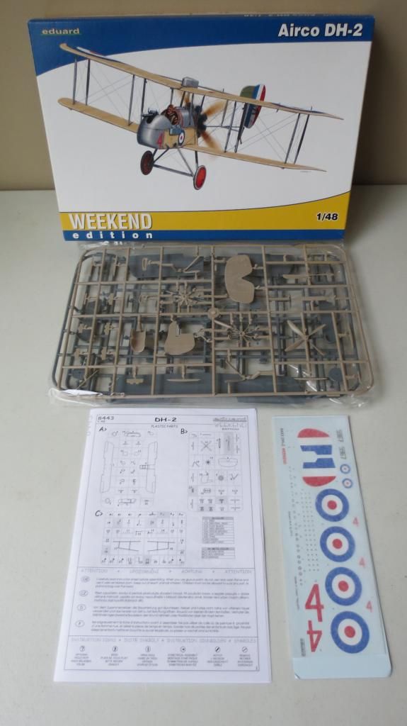

The box contains one polythene bag that has a self sealing flap containing 2 grey sprues and 1 tan sprue, a 8 page instruction/assembly and painting guide booklet and a sheet of decals:

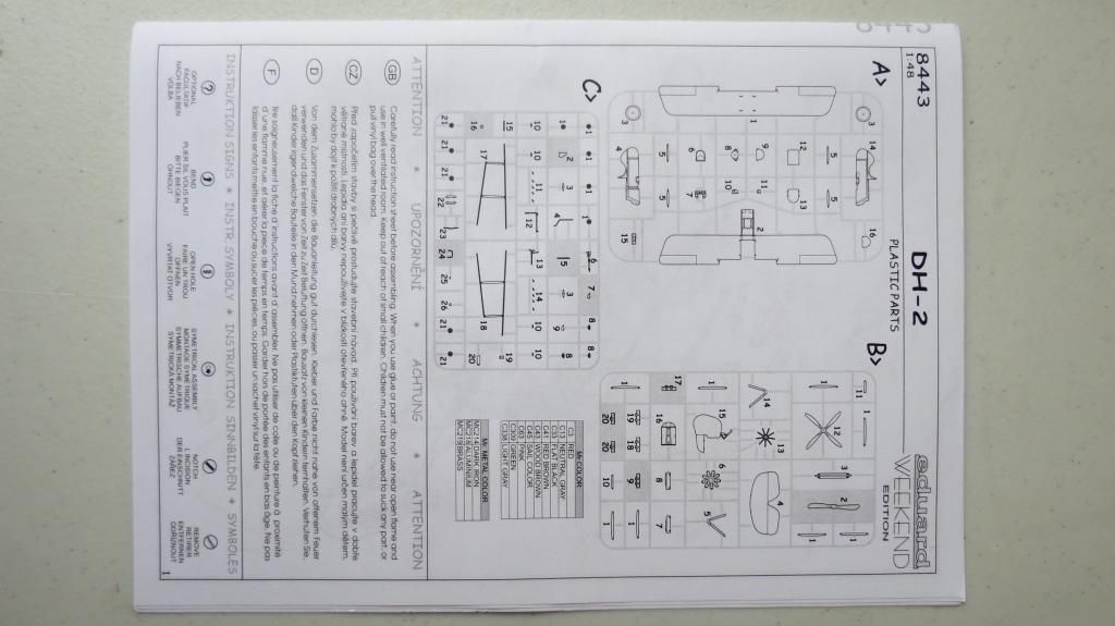

Page 1 of the booklet:

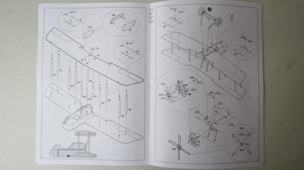

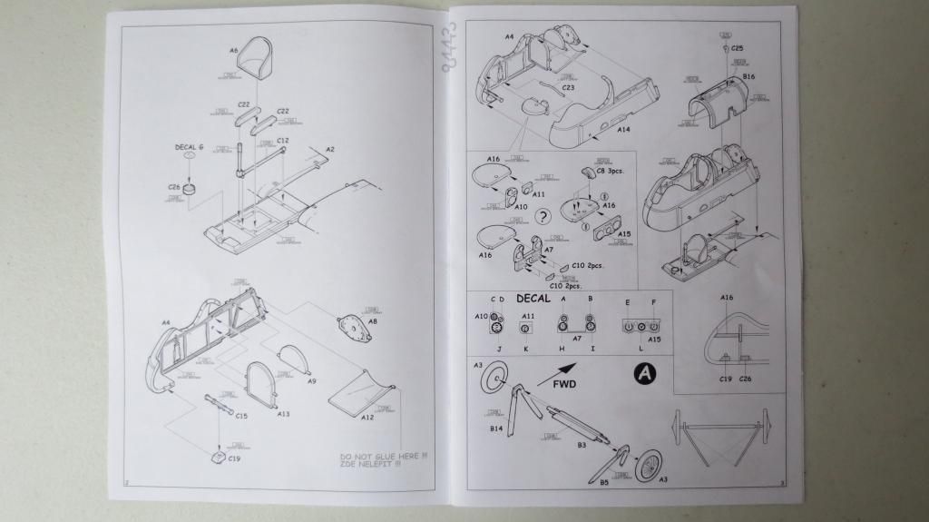

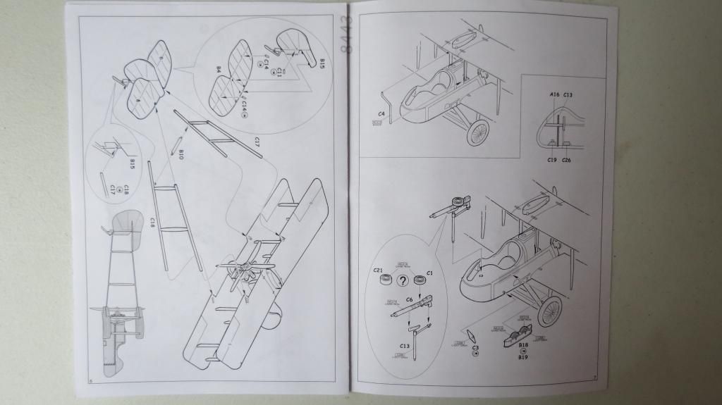

Pages 2 and 3 of the booklet:
Pages 4 and 5 of the booklet:
Pages 6 and 7 of the booklet:

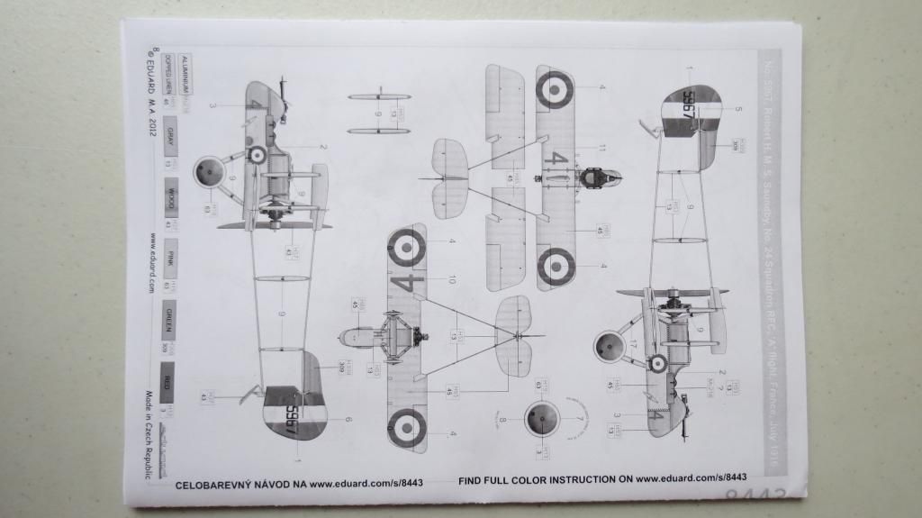

Page 8 the rear page:

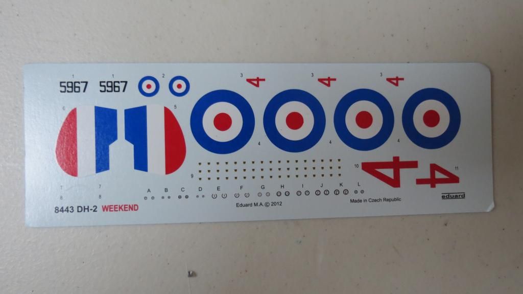

The Decal sheet:

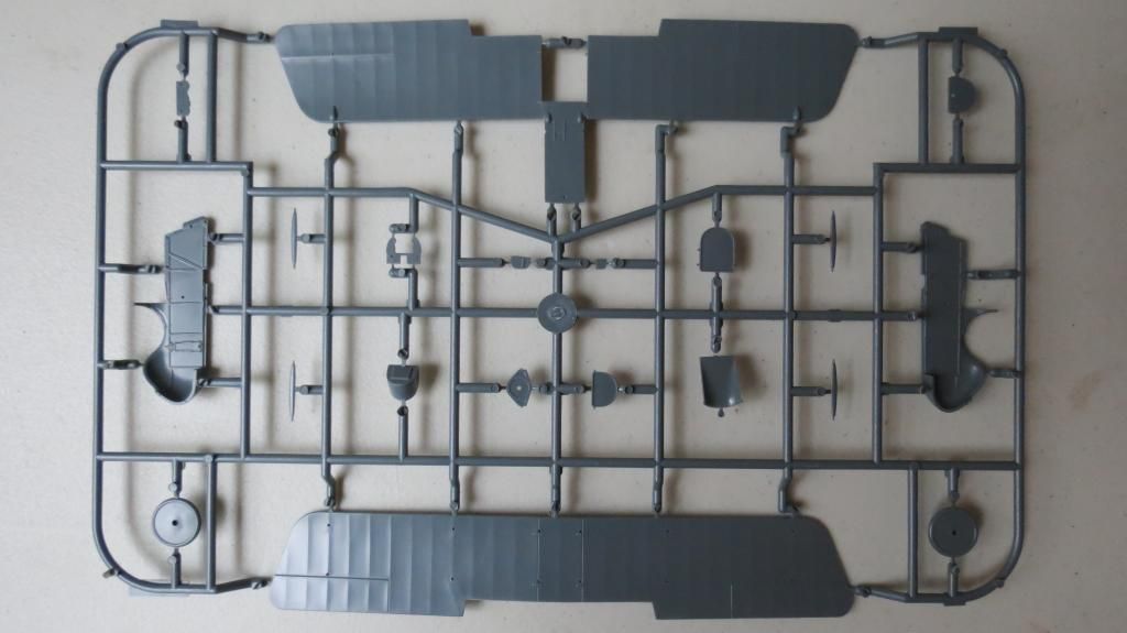

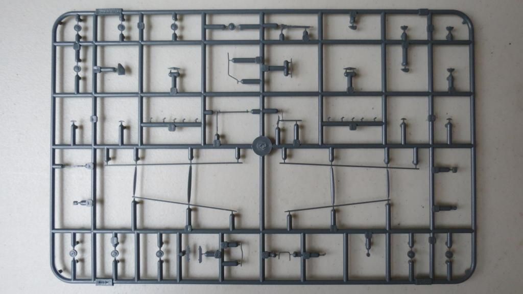

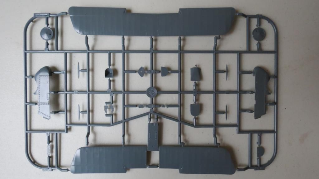

Sprue "A" Front/Top Side:
Sprue "A" Back/Bottom Side:
Sprue "B" Front/Top Side:
Sprue "B" Back/Bottom Side:

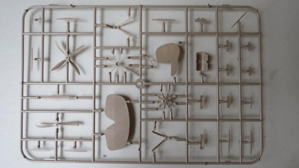

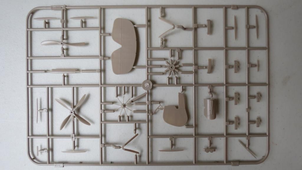

Sprue "C":
The booklet is printed in black and white and would have been better to have had at least the back page painting guide in color, or, a separate color printed sheet for the painting guide. I will refer to the box art as best I can and any photos/reference material that I can find to help me build and paint this as best I can.
The decals are nice and thin with very little if any overhanging carrier film. They look really good, although I'm not certain if there will be any issues because of how thin they seem to be. We will find out when it comes to the decaling stage! ;)
All sprues are excellently molded; very clean crisp parts free of flash, warp, stress marks, blemishes and ejector pin witness marks. All ejector pins have been placed outside of the parts and onto the runners feeding into the gate entry locations around each part. This is great, because it means there are no pin marks on parts that would require filling and smoothing to blend them into the surrounding surfaces. Other kit manufacturers could learn a lesson from Eduard Engineers/Mold Designers and begin to implement this method where possible.

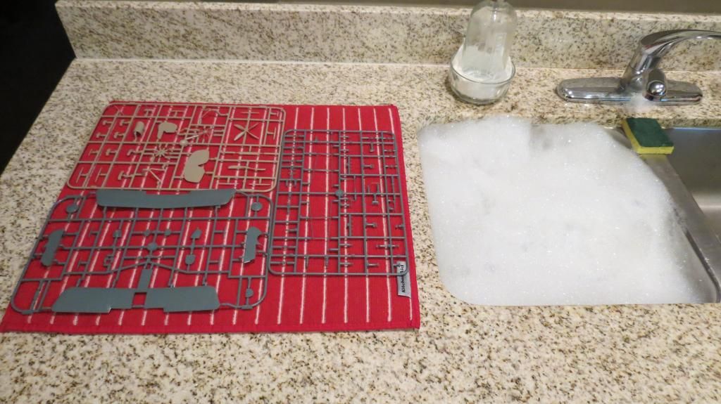

First, I washed the parts as always to remove the risk of any mold residues present on the surface of the parts;

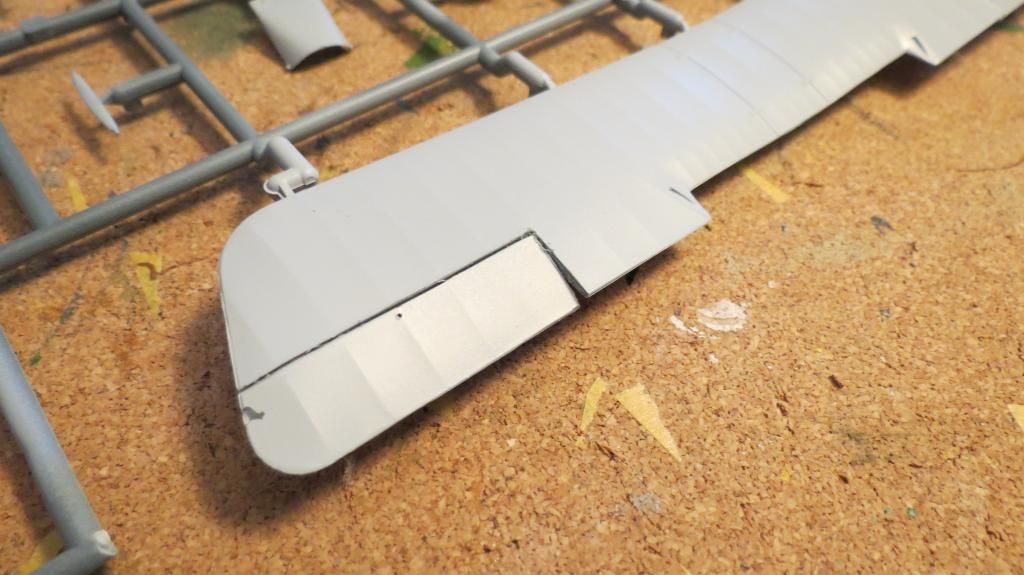

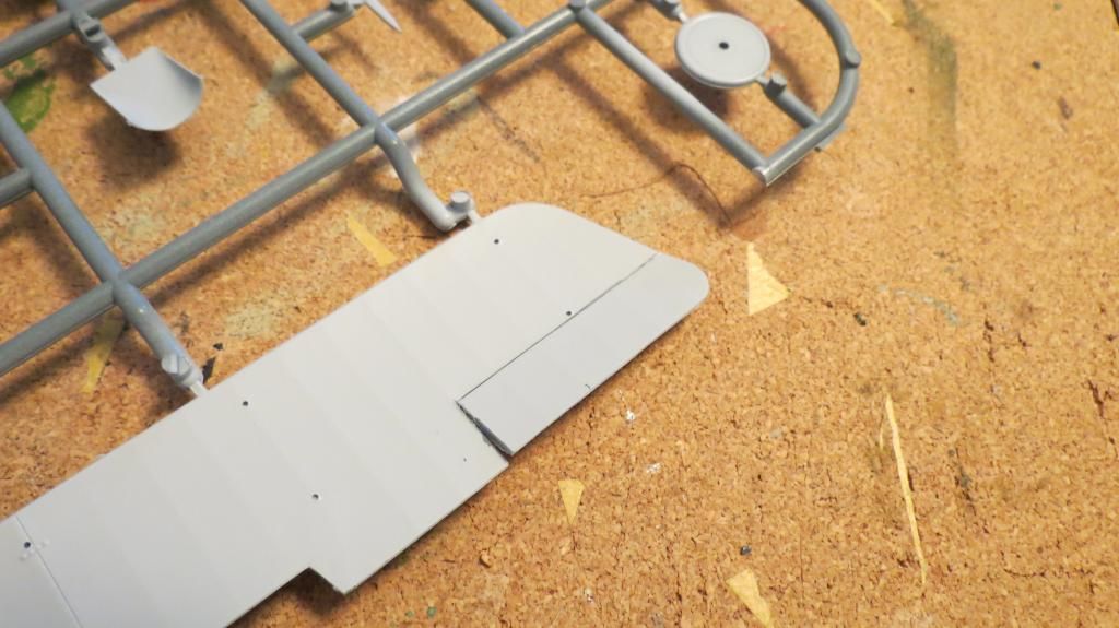

Then I air-brushed primer onto the parts whilst on their sprues followed by cutting the ends of the recessed panel lines indicating the flaps, all the way through. I then scribed the recessed flap lines on both the top and bottom sides to thin the wall section down, thus creating a "hinge" like section that was moveable, similar to the thin hinge on a "Tic-Tac" breath mints top.

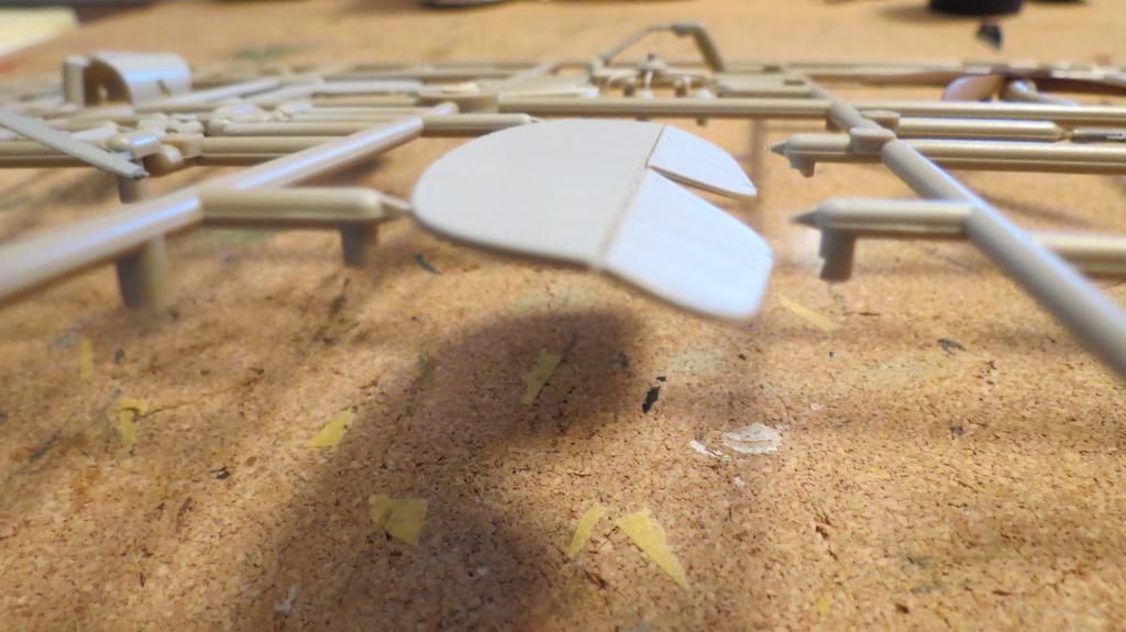

I repeated this process on the rear stabilizers and the rudder....

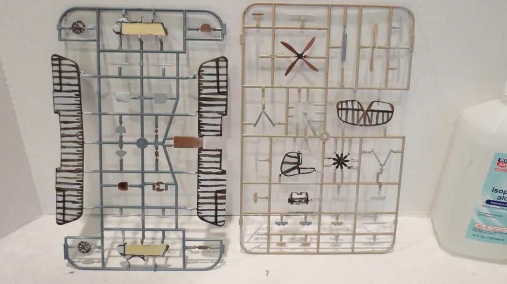

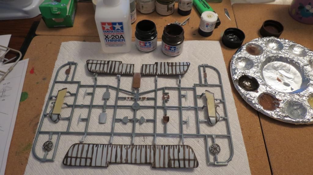

I then pre-shaded the wings, stabilizers and rudder whilst on their sprues..
It was now time to play in the "Spray Station", so much better than a "Play Station"!!

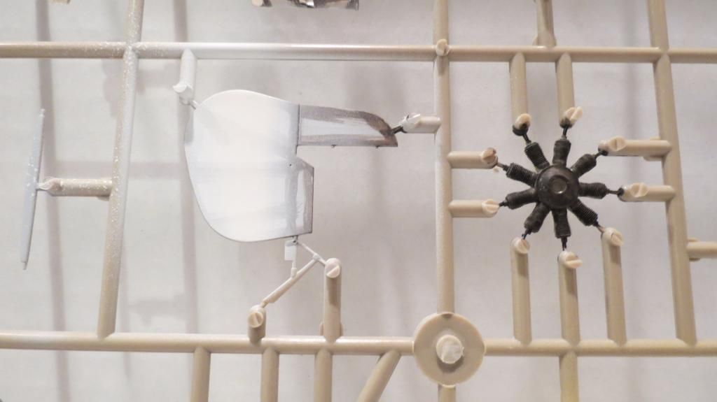

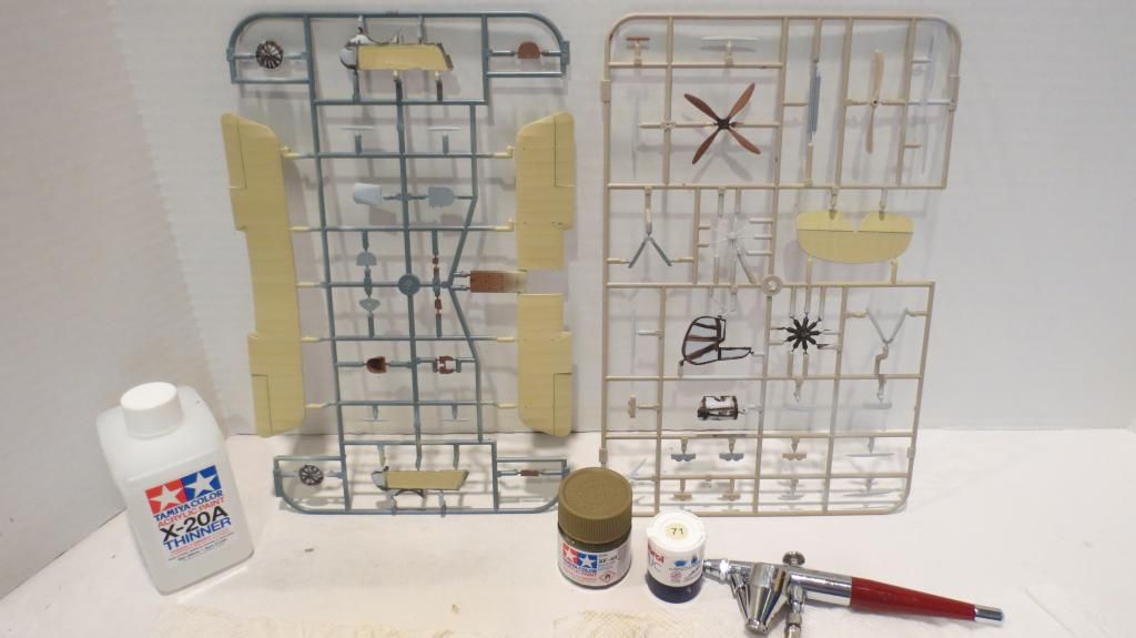

I then air-brushed the "Doped Linen" color to the wings and stabilizers. I used Humbrol 71 mixed with 10% Tamiya XF-49 Khaki and thinned with Tamiya X-20A thinners....

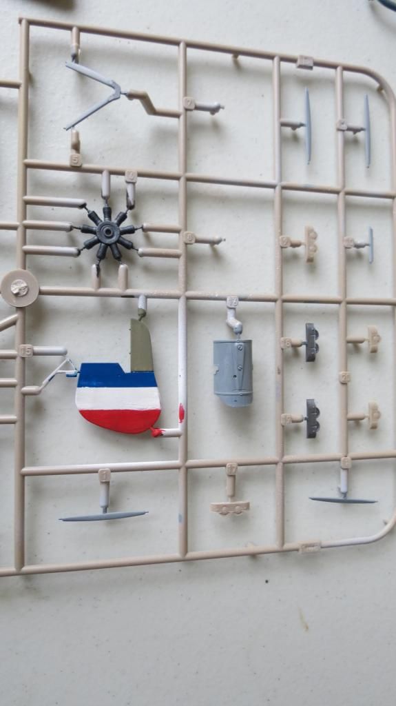

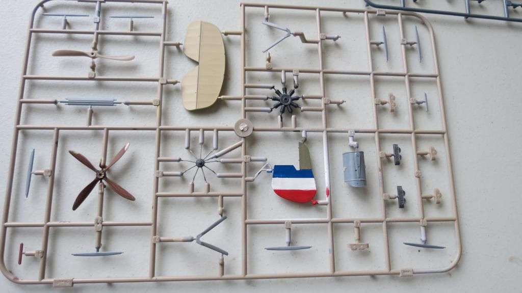

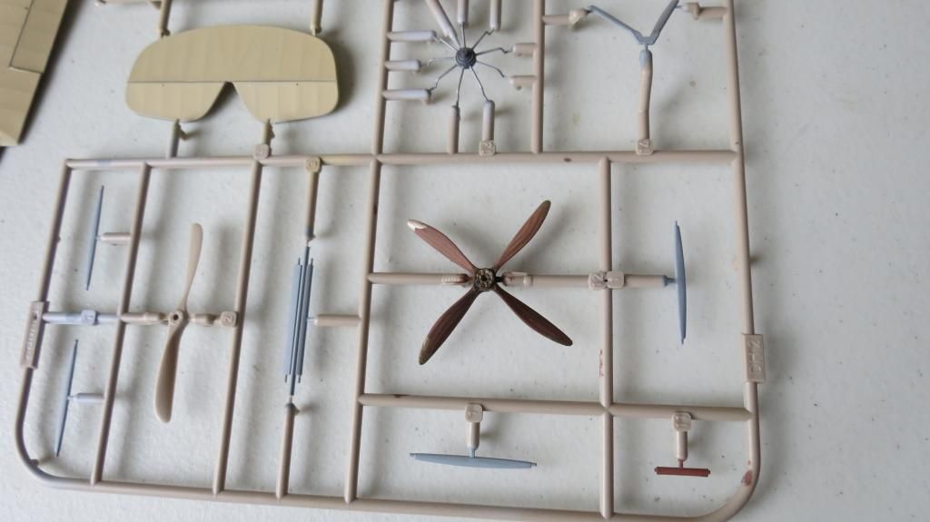

I also painted other parts on their sprues, including a base coat on the radial engine, the upper engine cowling, the cockpit/fuselage sides, the propeller and plane frames and struts....
Including painting the tri-color onto the rudder instead of using the decals....

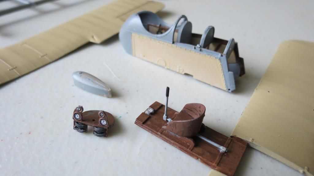

Eduard 1/48 Scale Airco DH-2 Build Update #2 (10.6.14)

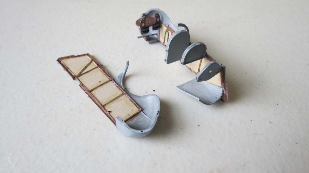

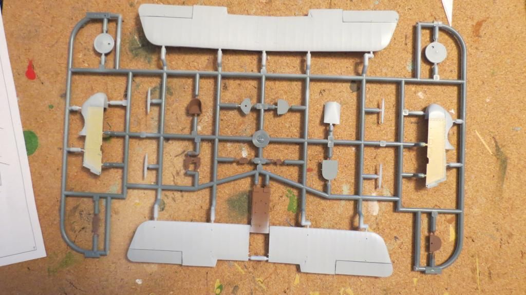

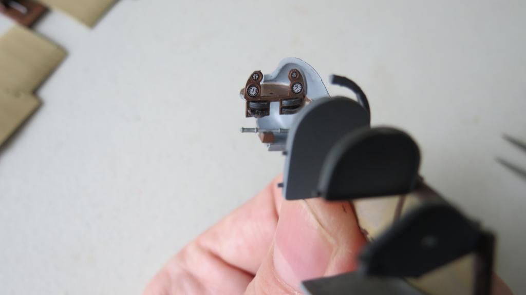

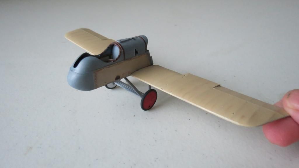

Following on from Build Update # 1, it was now time to start working on the cockpit/fuselage areas. I painted the interior parts and began assembling them into the starboard side of the fuselage, along with adding decals to the instrument panel...

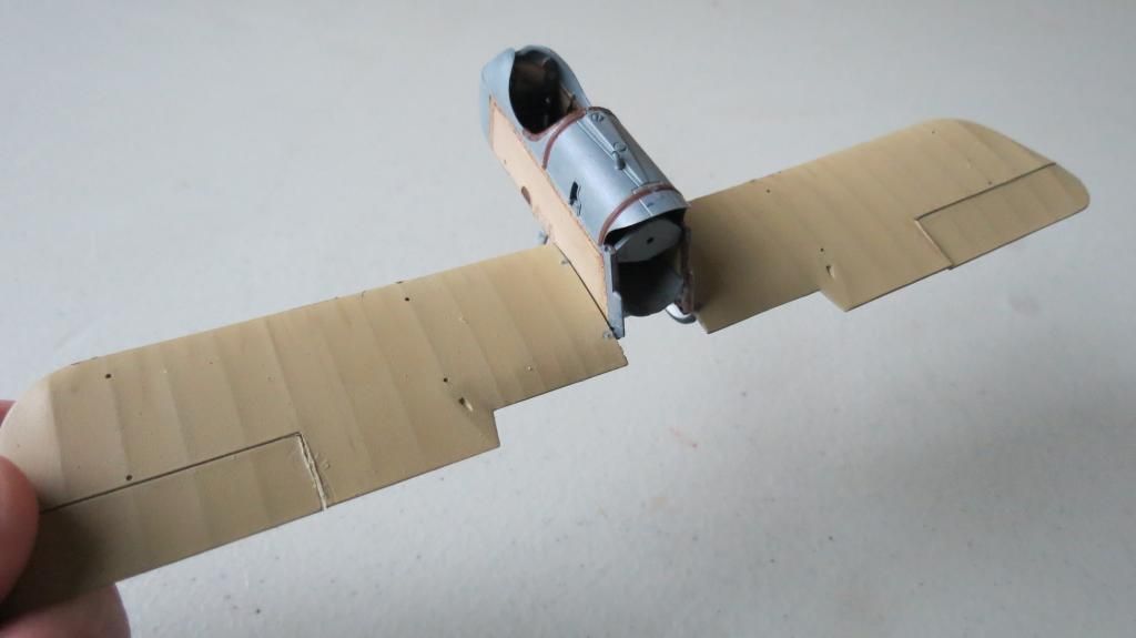

I then assembled the portside to the starboard side of the fuselage and then glued that assembly to the lower wings....

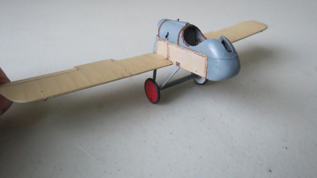

I then fitted the wheel assembly to the underside of the lower wings...

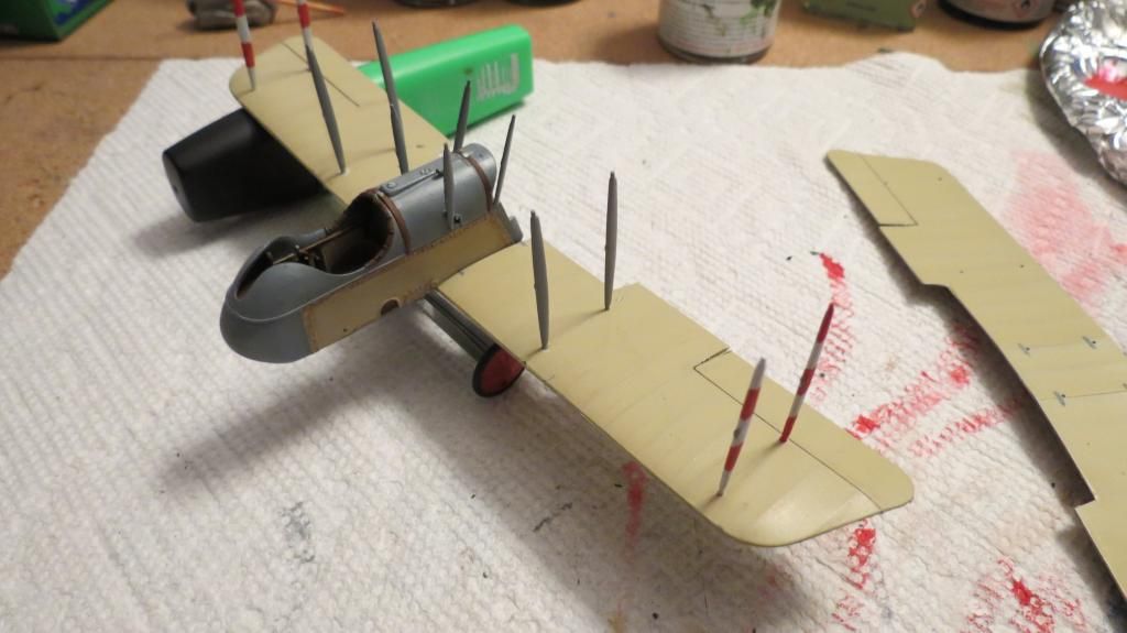

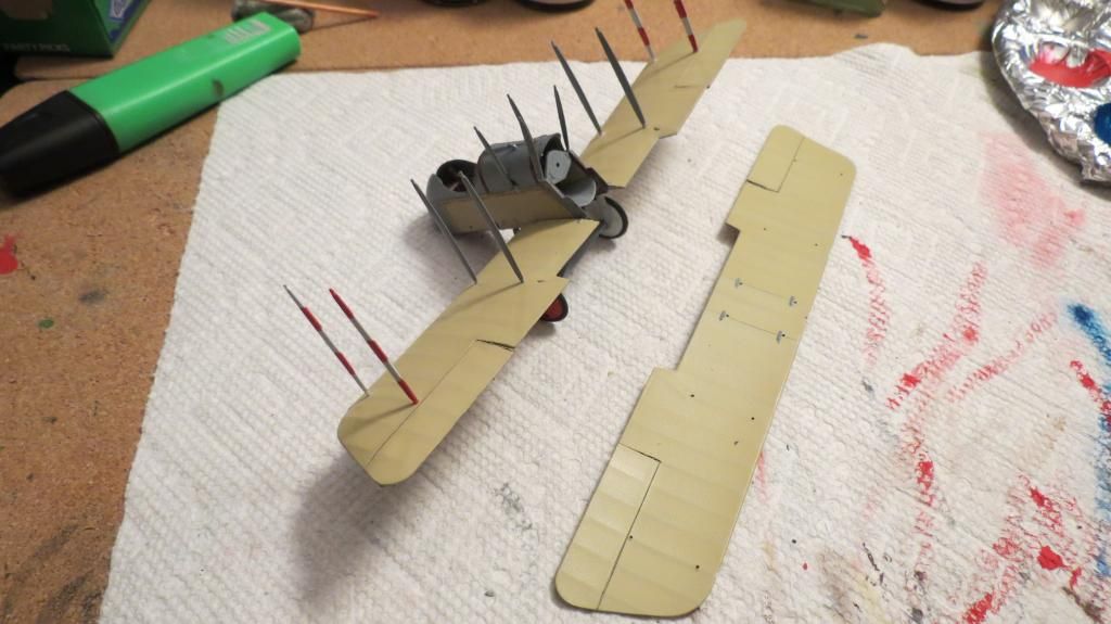

This was followed by gluing the wing struts in place using super-glue...

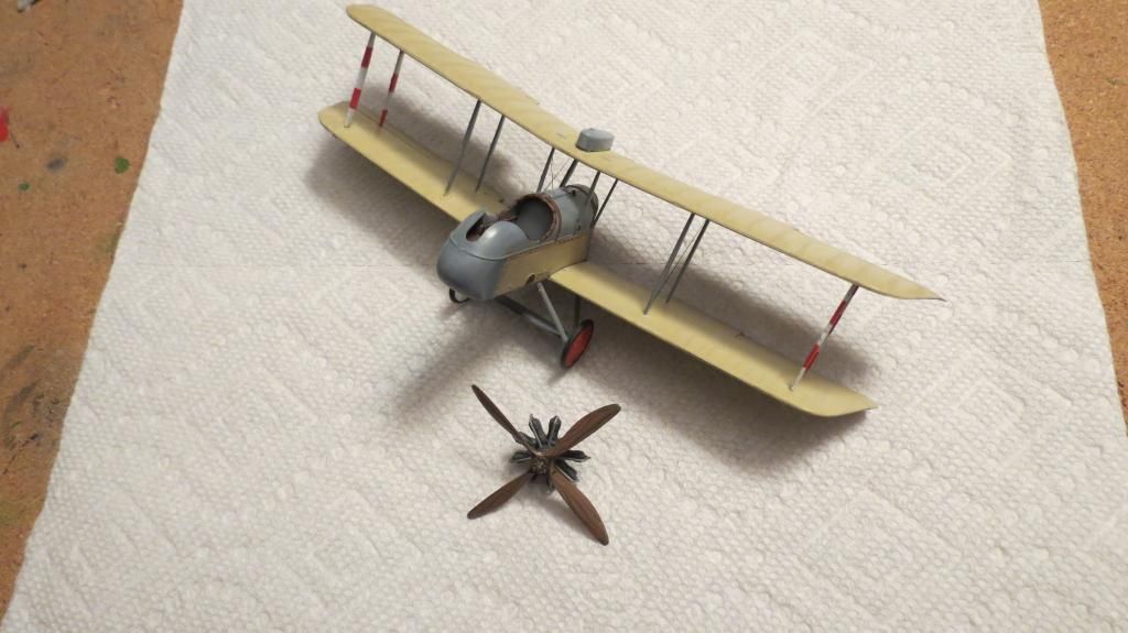

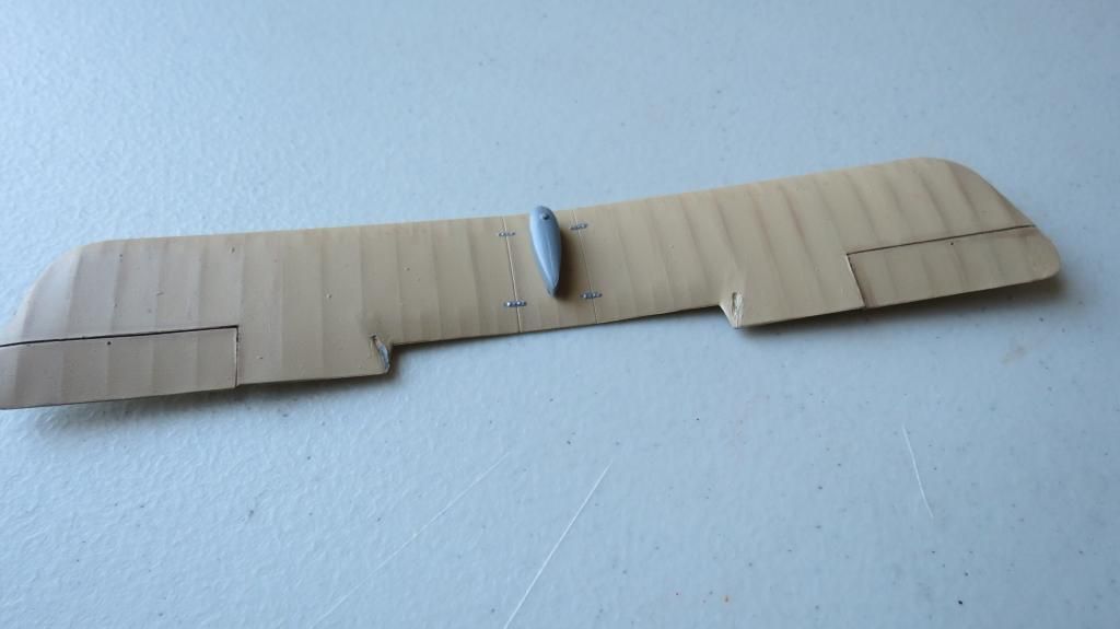

I then fitted the gravity feed fuel tank to the top of the upper wings....
While the wing struts were setting in place, I wanted to make sure that they would align with the holes in the underside of the upper wings, so, to do that, I fitted the top wing in place to help keep alignment of the struts until they were fully set.

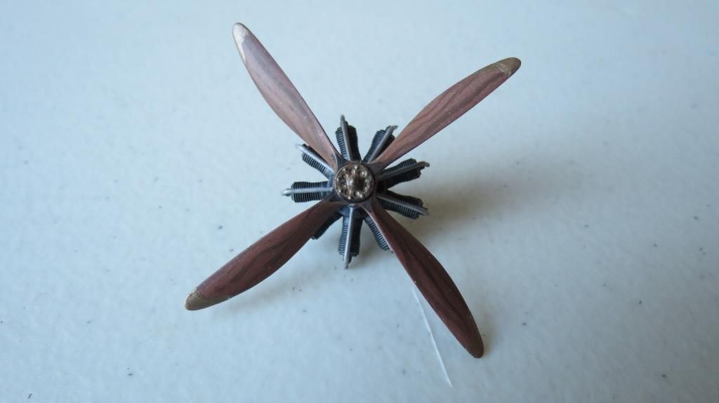

I also assembled the propeller to the radial engine....

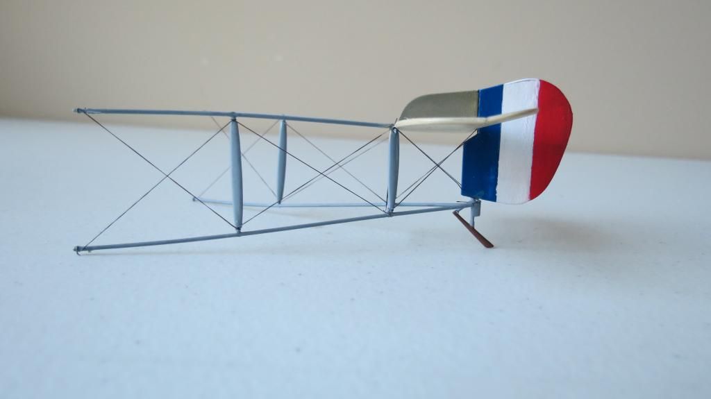

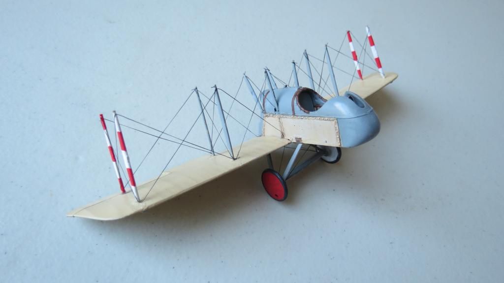

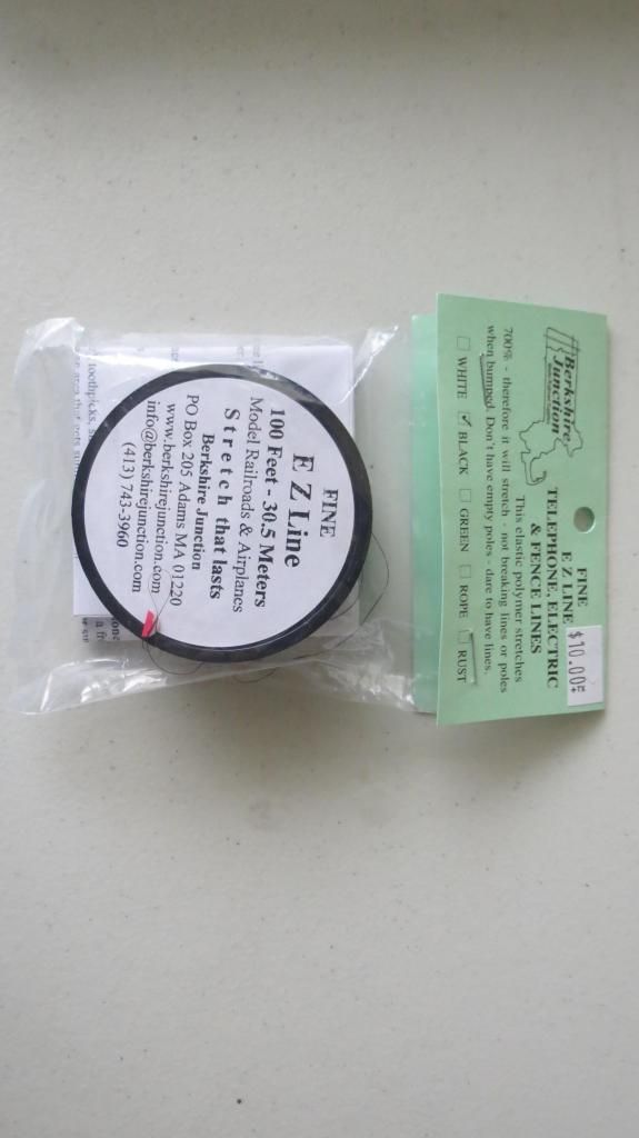

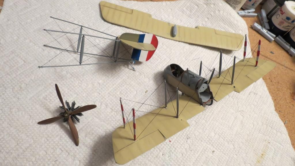

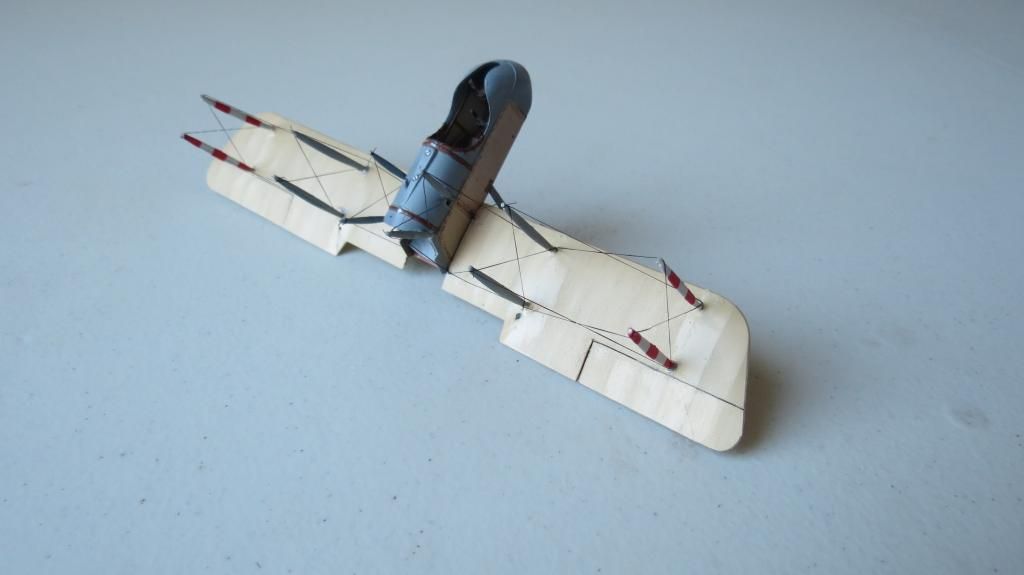

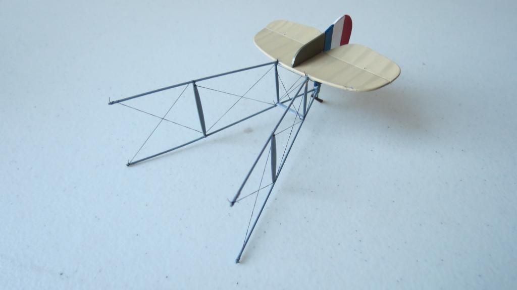

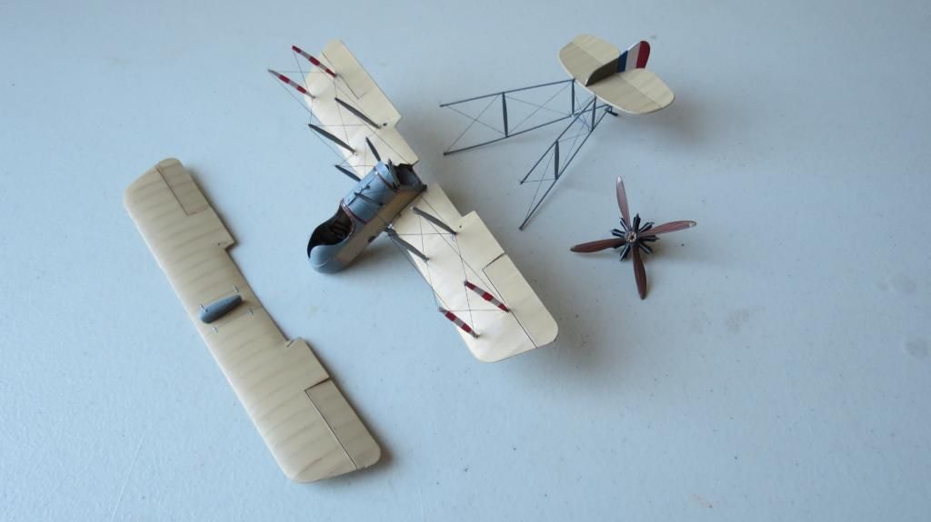

Once the wing struts were solid, I removed the upper wings and then it was time to start the rigging! :eeek: Out came the E-Z Line and the rigging began on the Wing Struts first....
Followed by rigging the Tail Boom section....
Just a couple more images of my progress so far....
Well, that's it for now. The next update will be my final reveal video...I'll assemble the plane, give her a clear coat, then add decals when that is dry. There'll be more rigging to do after decaling, along with adding small pieces such as the aileron, flaps and rudder actuators, the machine gun, the fuselage side gear boxes, pipework and then another coat of clear prior to weathering. I'll only be doing a delicate amount of weathering and then I'll give her a good coat of flat / matte varnish to finish her.
