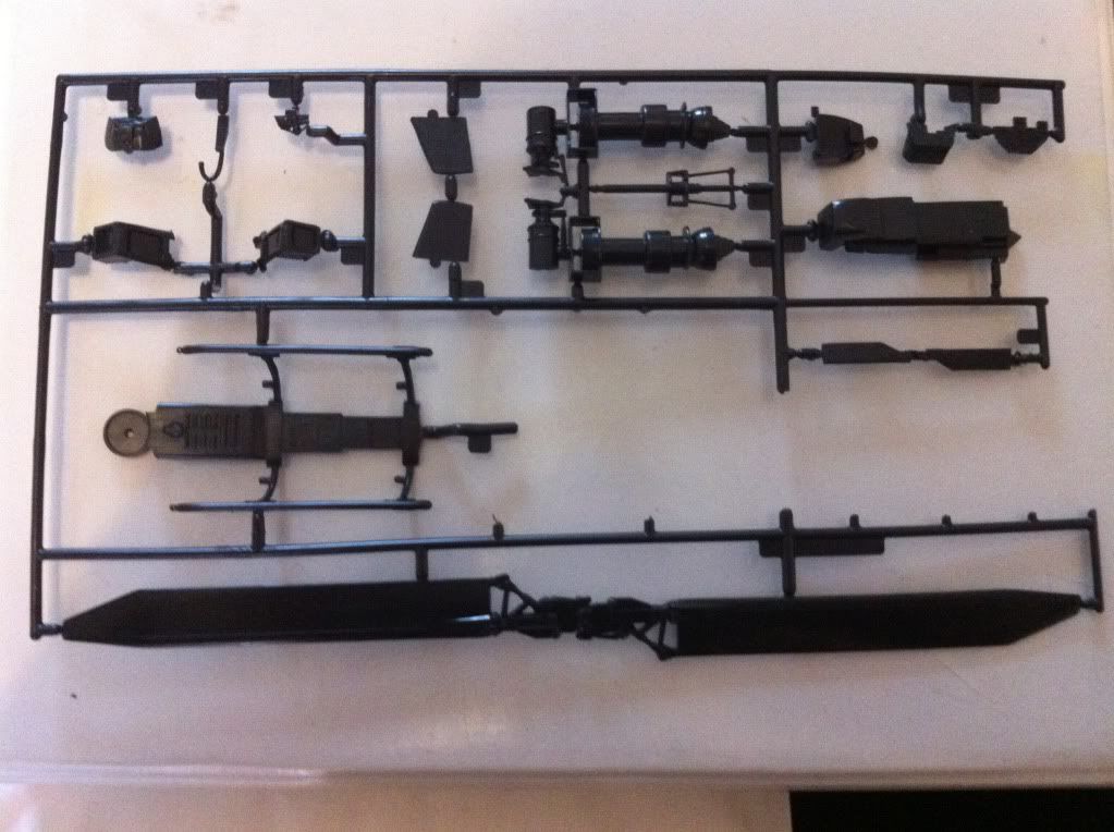

As promised the box and sprue shots
the box

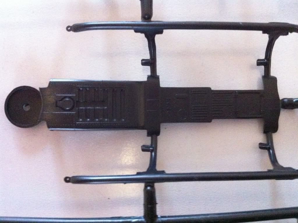

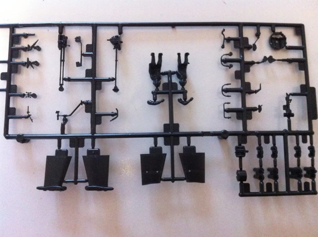

sprue 1

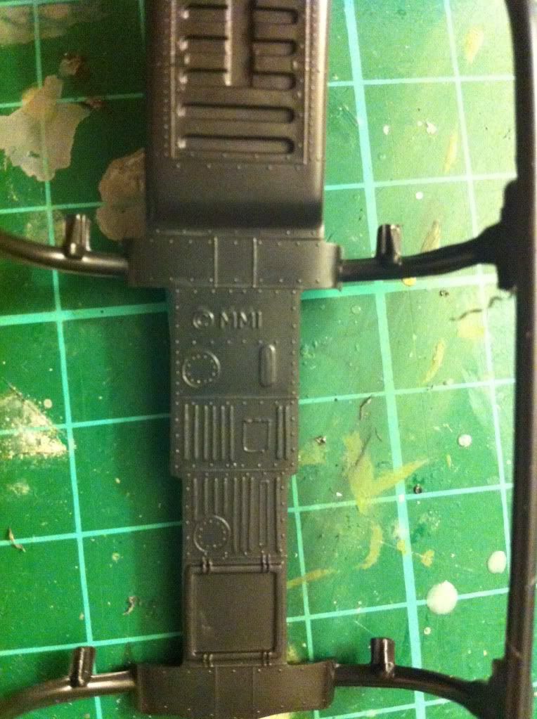

here you can see the makers copyright mark which will need sanding
sprue 2
and sprue 3 with some really good detail but all raised to it will be out with the p-cutter and dynmo again because after watching red dragon build his there its a few gaps that will need filling.

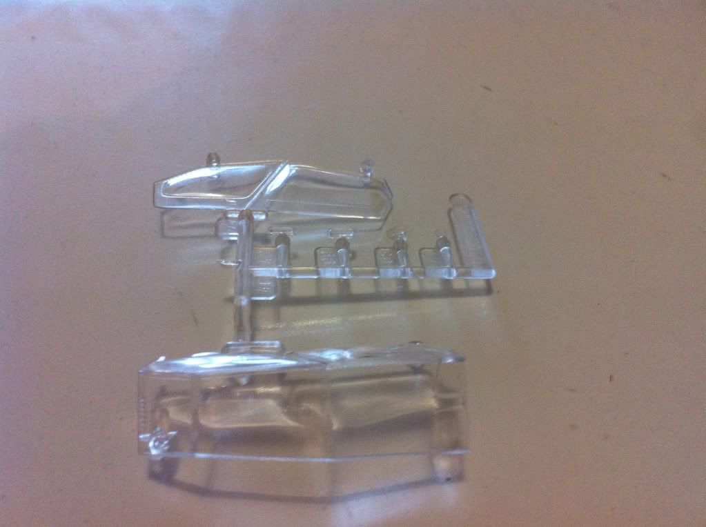

the clear parts

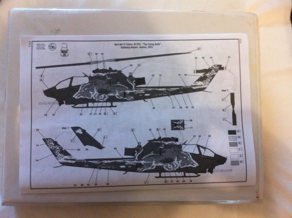

the instructions only 30 steps but very basic.
the colour call outs all black so that will be easy.

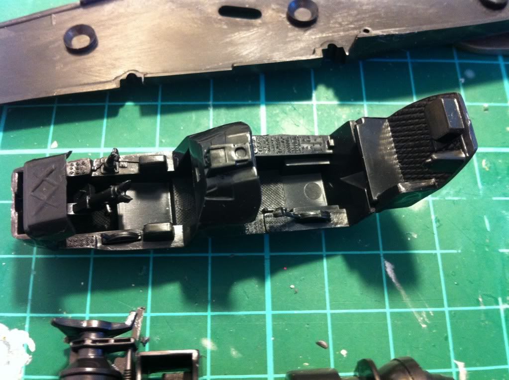

So to start with i thought i would get the sub assemblies build 1st then i could paint them all in one go.
The cockpit first some nice raised detail but quite a bit of flash but builds up really quickly
The engine just two parts so slapped them together will remove all visible seam lines before i paint it.
The main rotor next this is a one piece affair so just got rid of some pin marks and as i want this parked on the ground i put the part in some hot water and gave them a twist down at the trailing edge and a slight droop thing it needs more but will look at it again later

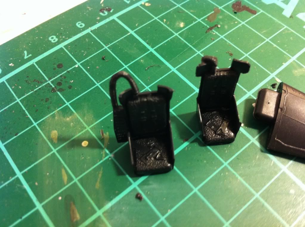

The seats ready for some paint
The "wings" dont know there real name on a helicopter all together.
they need some filling at the tips why these are not moulded whole i don't know and filler needed for where the stores normally go as it a display aircraft.

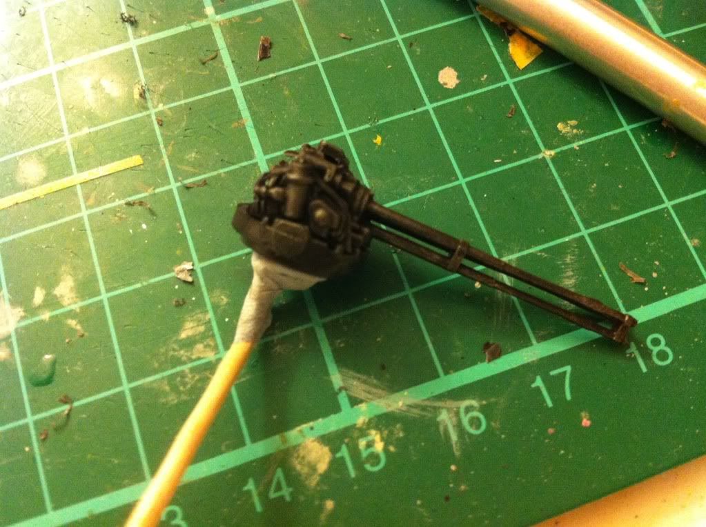

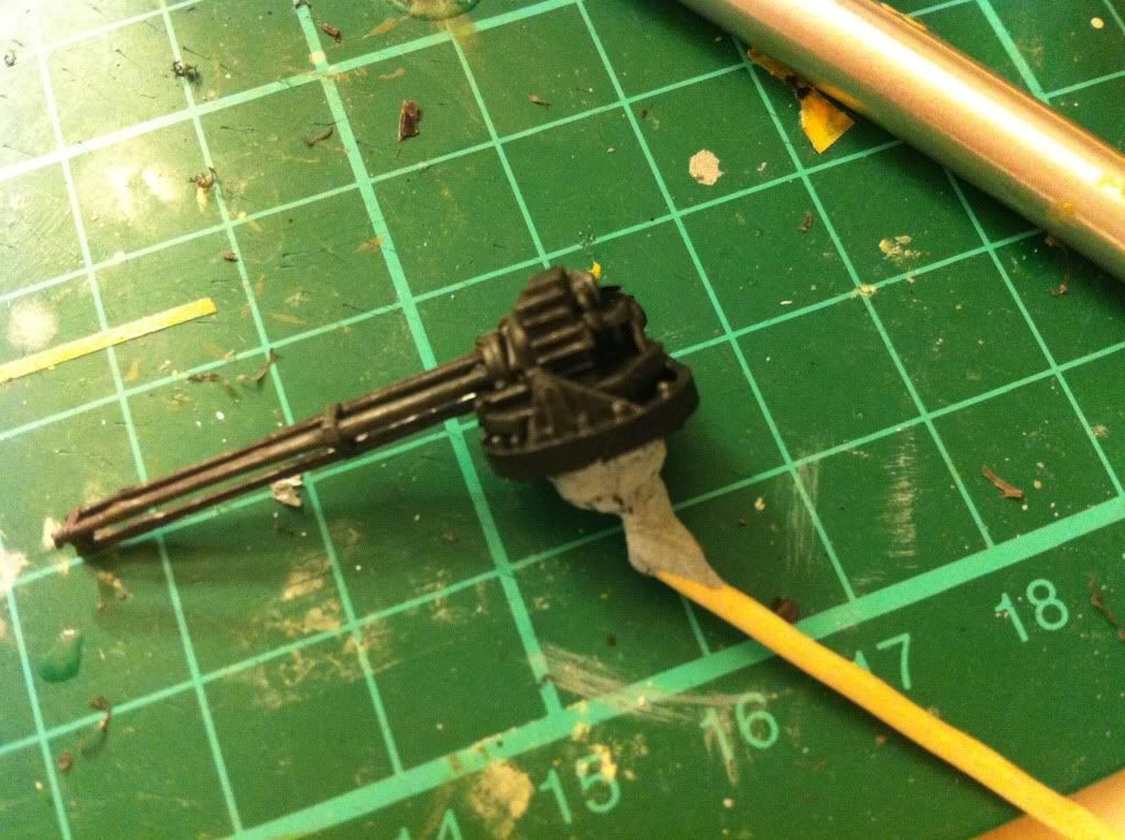

The gun built up
So far this has gone together quite well but the big test will be the fuselage half's and the skids will need to add a bit of weight under the cockpit otherwise it will be a tail sitter.
Well that's it for now see you in the next update.

Any way whats next oh yeah the copyright mark needs removing
that's better all gone now :banana:

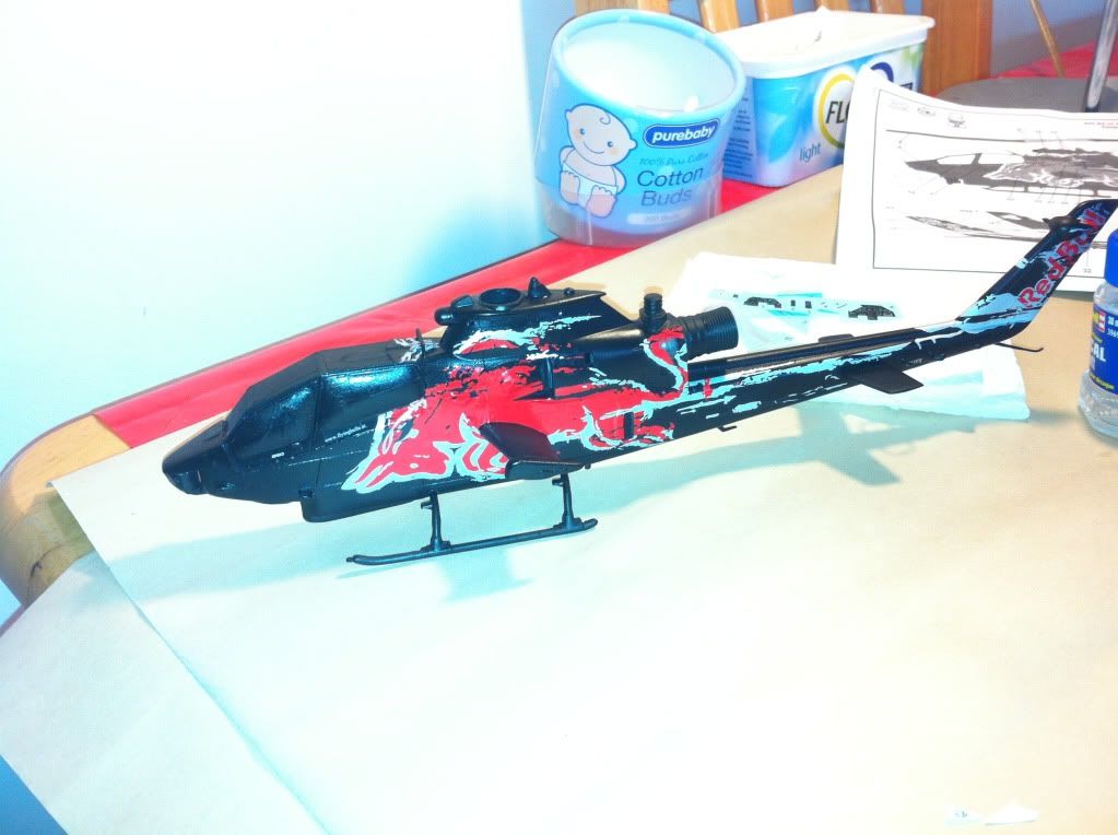

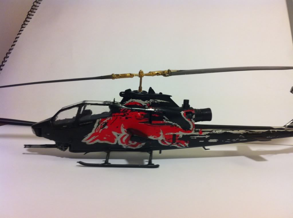

Hi all update time.
So once it was sanded and filled and sanded again (which i forgot to take photos of) its was on with the primer and then sorting any of the problems out which there wasn't that many so out with the airbrush (1st time used) and shot it with some thinned vallejo black and it went on lovely was really happy with it for a 1st try.
i then shot it with some clear and left it to dry for a good 24 hours before i applied the decals. I must say i was not looking forward to this lol but apart from some not being labelled up right i had no problems with them at all.
so i will leave these for a day or two then it will be more Klear and a wash and she will be done.

Re: Revell Bell cobra the flying bulls
Cheers James
well after the decals all that was left was to give it a wash in the panels lines so here is the finished article.
The rest of the photos will be in the revel section.
Very nice job!
:clap: :clap: :clap: :clap:
