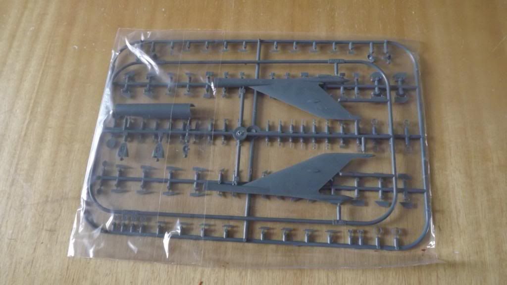

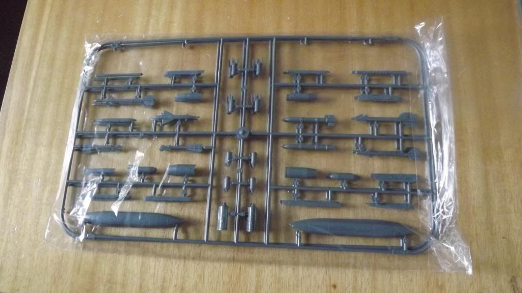

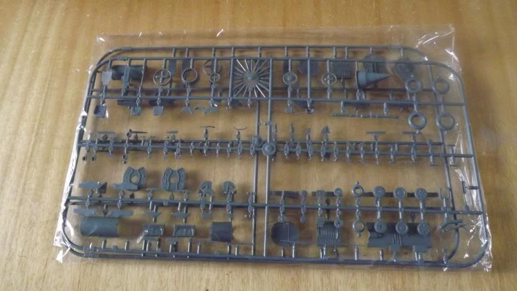

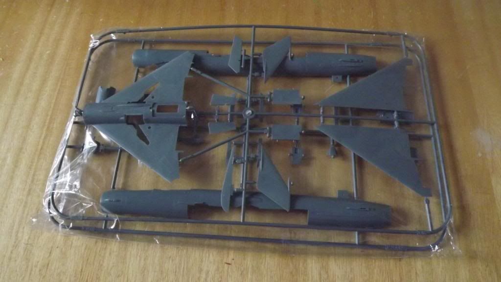

This is going to be my entry into the Cold War group build. I was saving this kit to do the Egyptian Air Force paint scheme (as on the box), but as its not Cold War I will be doing the Soviet paint scheme.
This build will have a few firsts for me, first entry into a group build, first time using Photo Etch and the first time using Vallejo paints.
Looking through the instructions, i think I am going to build it with the air brakes in the open position, this will involve some chain drilling and filing (better not get this wrong as it's what i do as a job on real sized aircraft).
Phots of whats in the box!
Will try my best to keep this updated with phots and waffle.

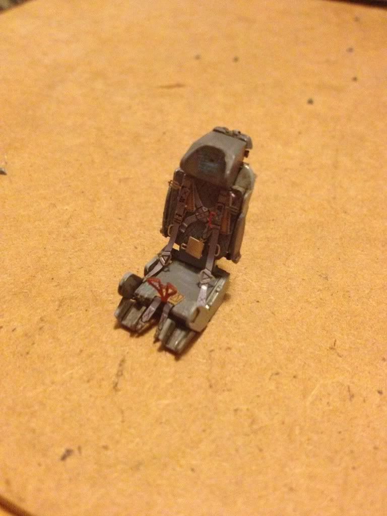

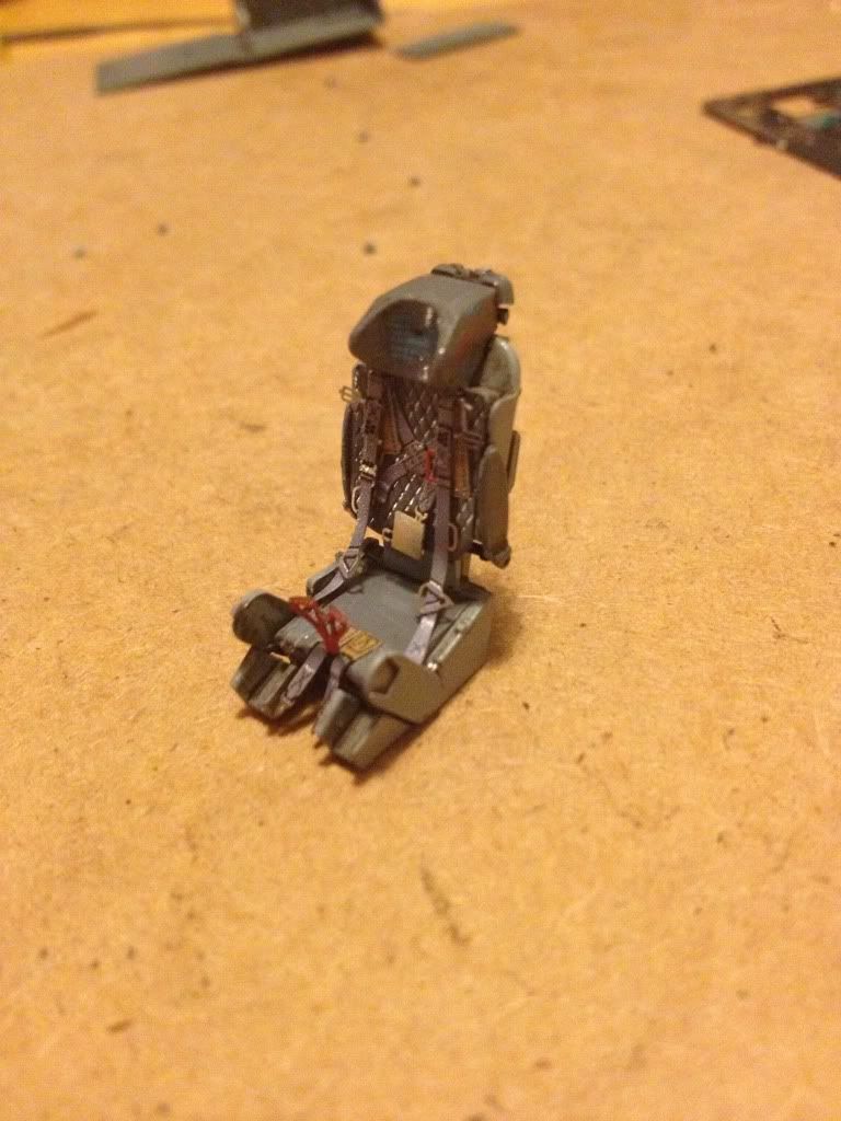

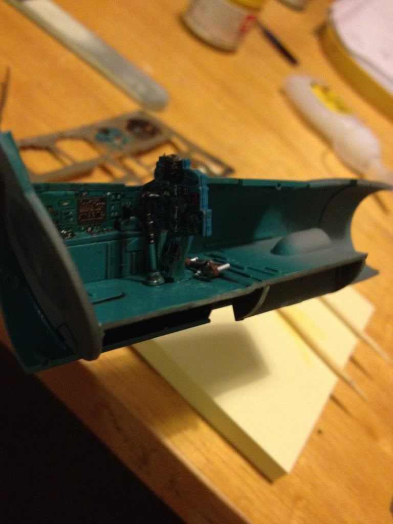

It's a bit slack at work at the mo, so have completed the ejection seat. Nearly went cross-eyed doing the Photo Etch :tongue:
When my eyes return back to normal, will start on the air brakes.
Simon
Re: 1/48 Eduard Mig21-MF ProfiPACK
That's a brilliant entry and a great start :th:
Posts: 7312
Nice entry and a cracking start on the ejector seat :th:
Nice entry dude.
And great start that ejector seat really looks the part. :th:

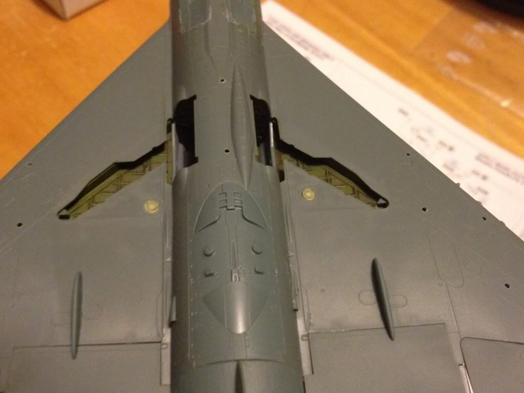

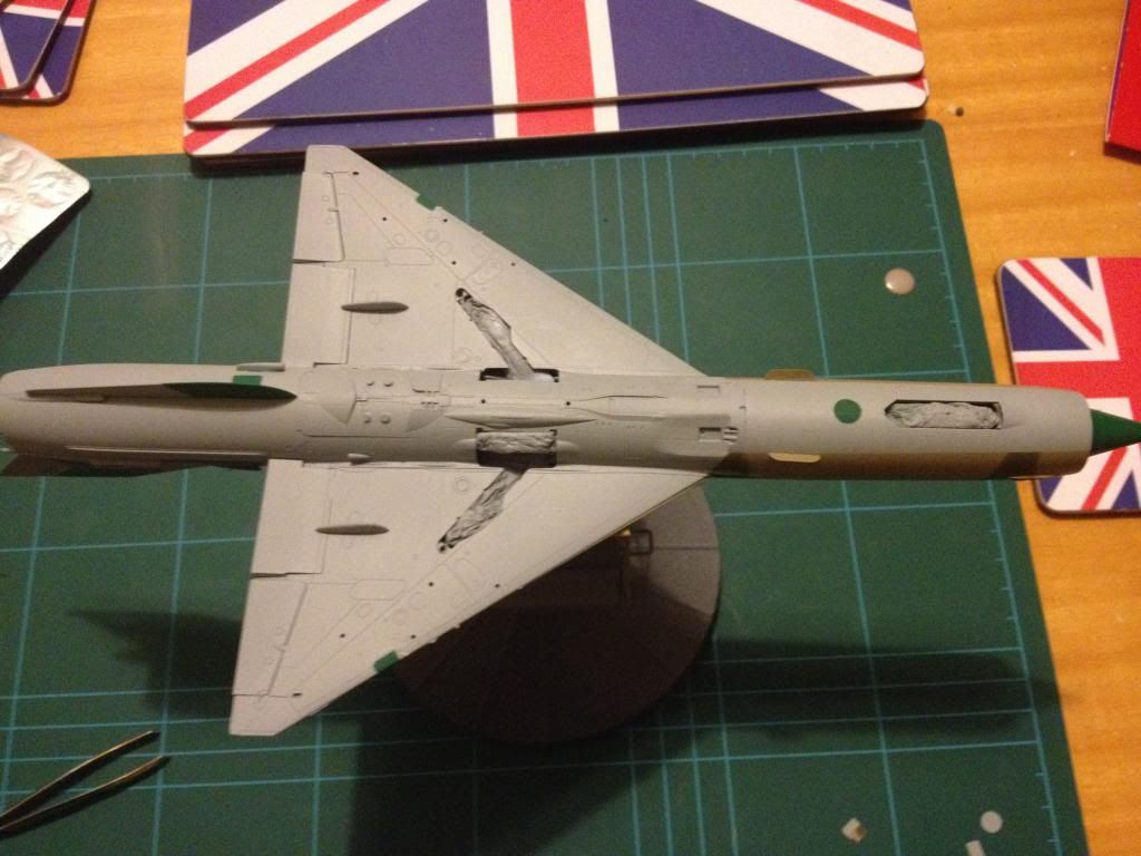

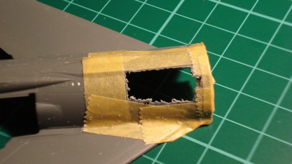

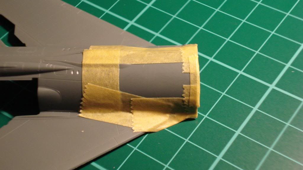

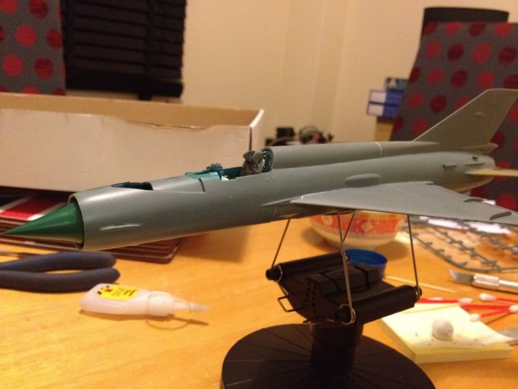

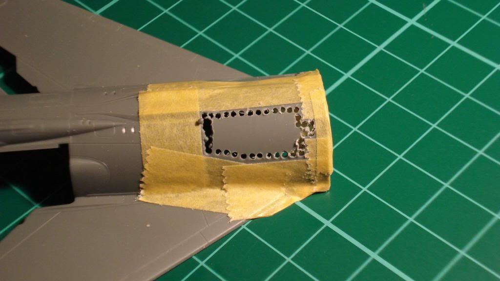

Quick update, I have done the cut-outs for the air brakes, it went ok, will have to see what they look like once I get some primer on them.
After quite a few attempts, I managed to get the cockpit colour as close as I could to the Photo Etch, I used Tamiya flat yellow XF-3 and Tamiya sky blue X-14 at a ratio of 4 parts blue to 1 part yellow.
With any luck I should have the fuselage together over the weekend, will post phots.
Phots below.
Simon
Posts: 7312
Love that pit - Excellent!
Great job mate, cockpit looks great :th:

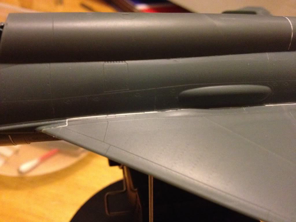

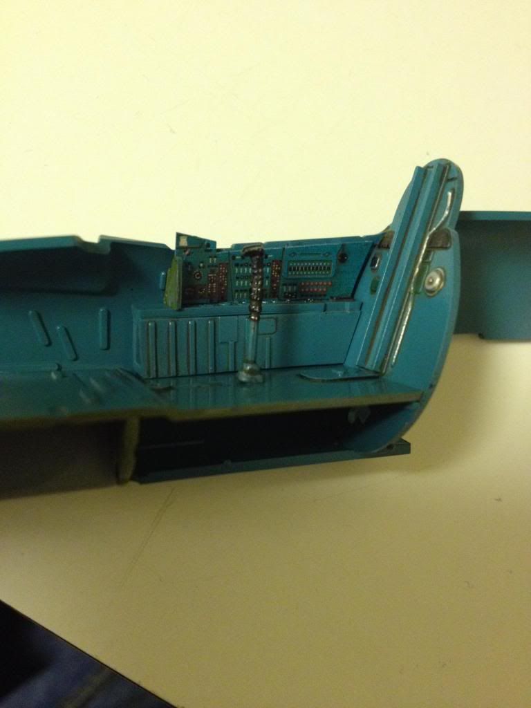

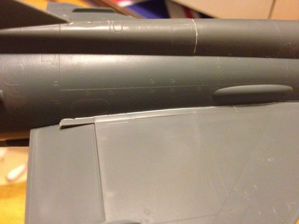

Quick update, cockpit all finished, am really chuffed with it. Carried out a dry fit of the fuselage, had a gap of around 2mm aft of the nose wheel bay :wall:
A lot if filing later, have managed to close the gap.
Hoping to get the fuse together tonight, will post photos of it tomorrow night.
Phot of cockpit.
Sorry about the quality of the phots, had to use my phone :th:
Simon
ModelingMatt
Posts: 119
Joined: Wed Jun 12, 2013 1:56 pm
Location: Michigan USA
Post by ModelingMatt »
Cockpit is looking terrific. :th:

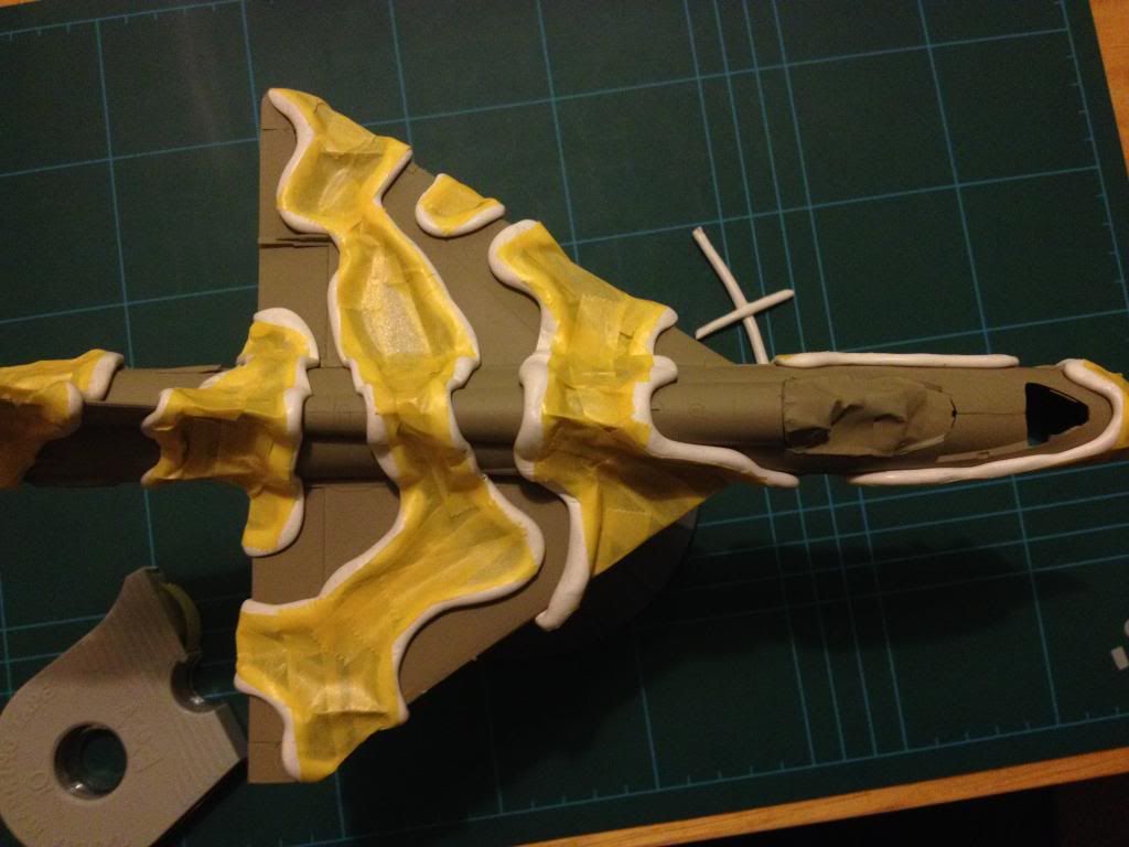

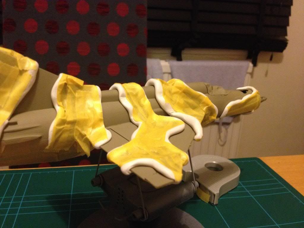

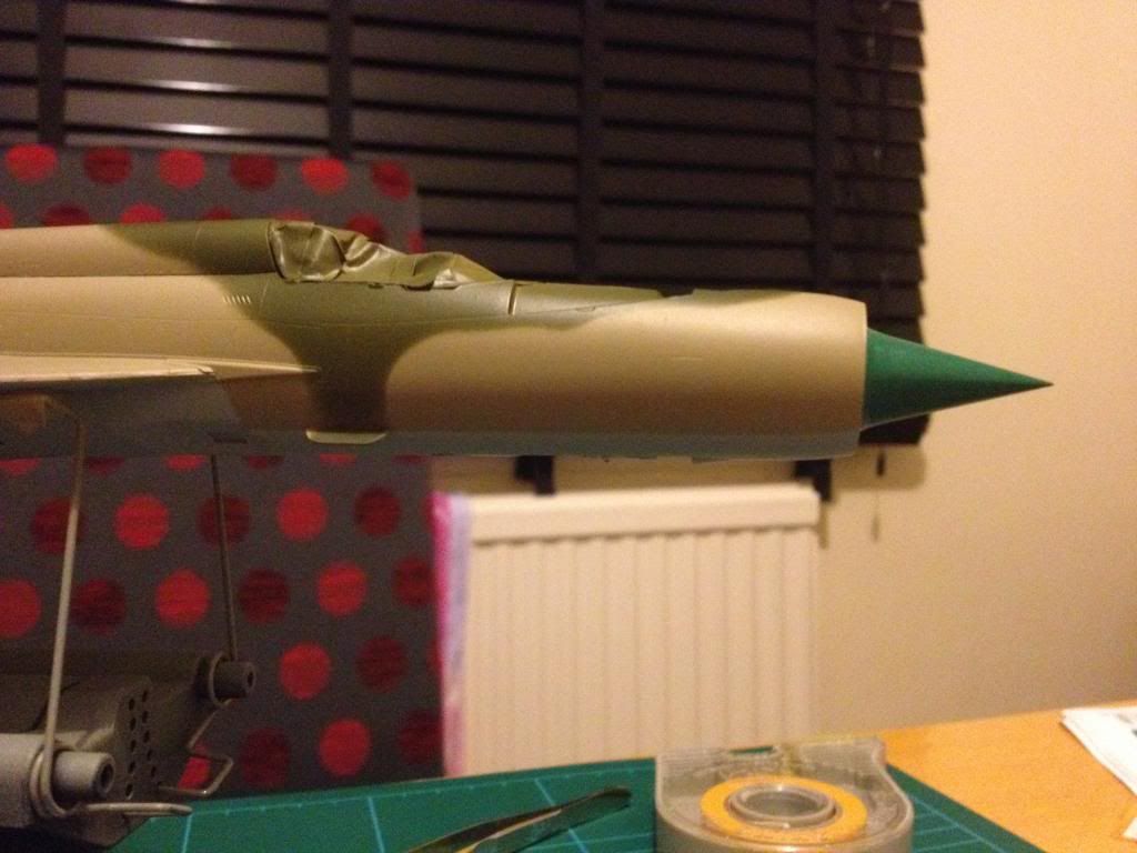

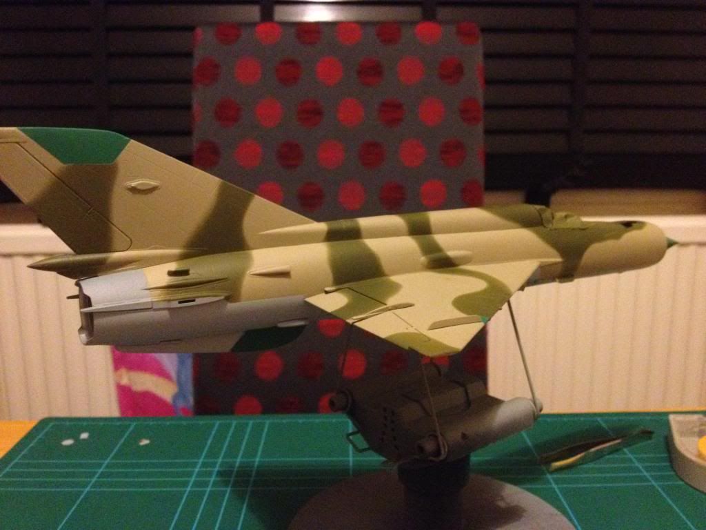

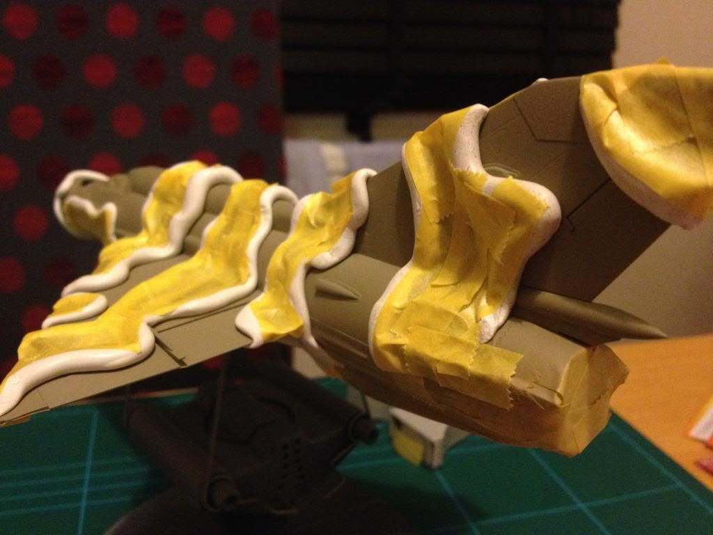

Right, big update, after a week or so not really getting anything done due to work commitments and the wife and kids giving me grief :evil:
I have finally made some progress.
Got the fuselage together, wings on (slight gap at the wing roots tidied up with some Milliput), all the little aero bits on and stuck the masks on that came with the kit .
Primed everything in Vallejo grey primer, painted the underside, lots of masking up and painted the camo scheme on the top.
Really pleased with it so far, next is to get the exhaust shrouds painted with Alclad and lay down 2-3 coats of Klear and get started on all the decals :wall:
Simon
Nice Camo work :th:
Paul wrote:Nice Camo work :th:
Hell yeah! I agree, looks fantastic.
Great job on the camo dude.
Sweet looking scheme. :th:
Joesdad
Posts: 1519
Location: Torquay UK
Post by Joesdad »

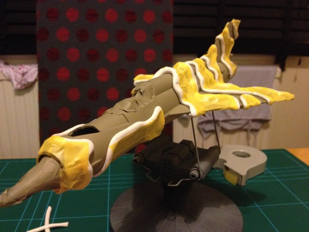

Wow! Rocky the camo looks brill mate, Is that "white tack" buddy?
Tim (Ted)
British Aviation In Scale
SiDennis
Posts: 118
Joined: Sat Aug 17, 2013 11:56 am
Location: Telford, Shropshire
Post by SiDennis »
Cheers joesdad, yes mate it's white tack, unlike blue tack,I have found it doesn't leave behind any residue. It's a bit less tacky but works great.
Simon

For those in the UK, got this from Poundland for hmmm a £1 :eeek:
Simon

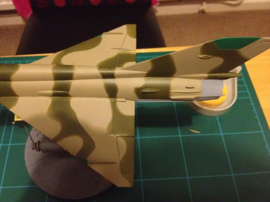

It's been a while since my last update, have made some good progress.
Decals finished thank god, three straight nights it took me to do those :bash:
Clear coat applied ready for some weathering.
Going to push on now and get it finished by the end of next week.
Sorry about the photos, don't know why they are so small, will post off my laptop not my iPad tomorrow night.
Simon
