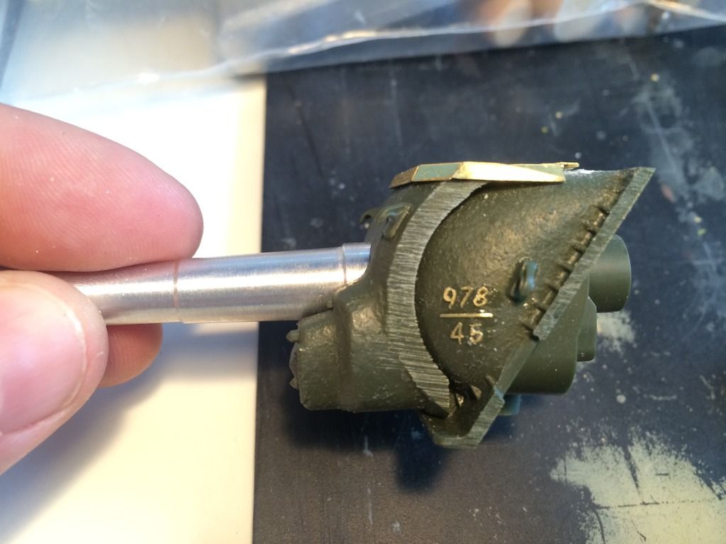

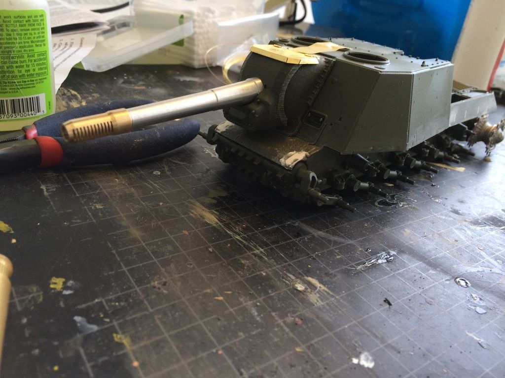

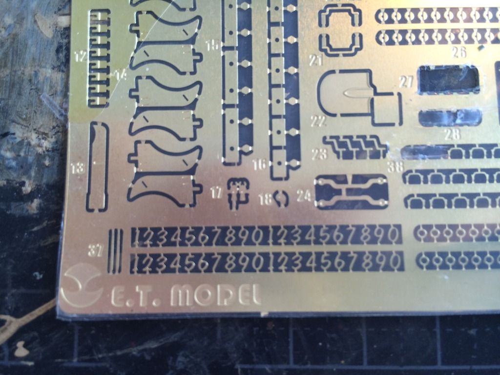

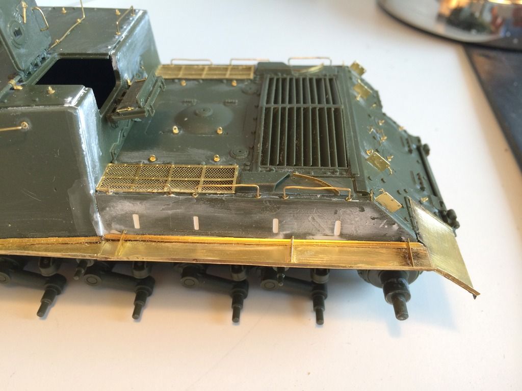

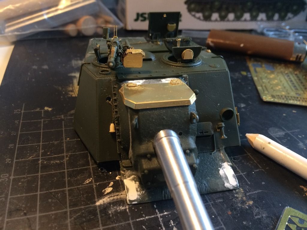

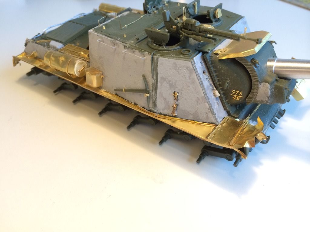

Update 1 thoughts
The tamiya plastic is fantastic to work with! The et model pe is easy to work with and the instructions are quite good. So happy little camper here! The barrel is dreamy.

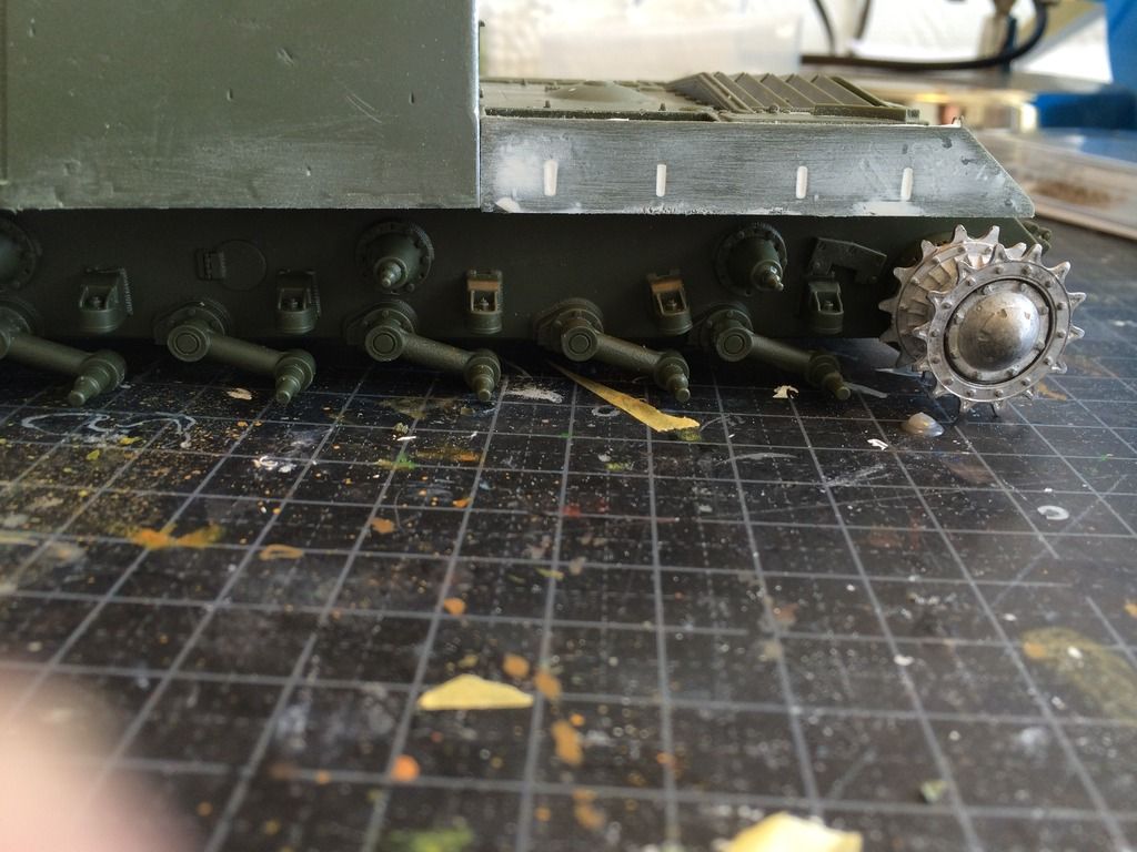

Nice extra with the fruili. Sides are prep for fenders. There are rough casting marks in the plastic but I'm gonna add my own with mr surfacer. So not so specific with the sanding.
Casting numbers :banana: + the frests are protected with a layer of plastic. Great work et

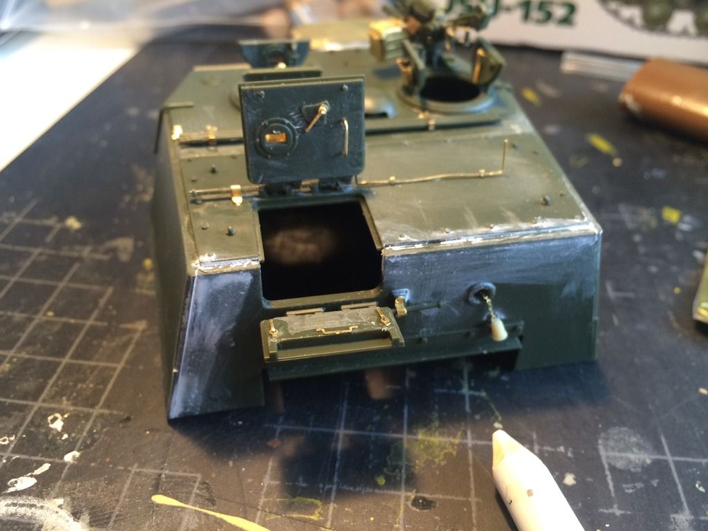

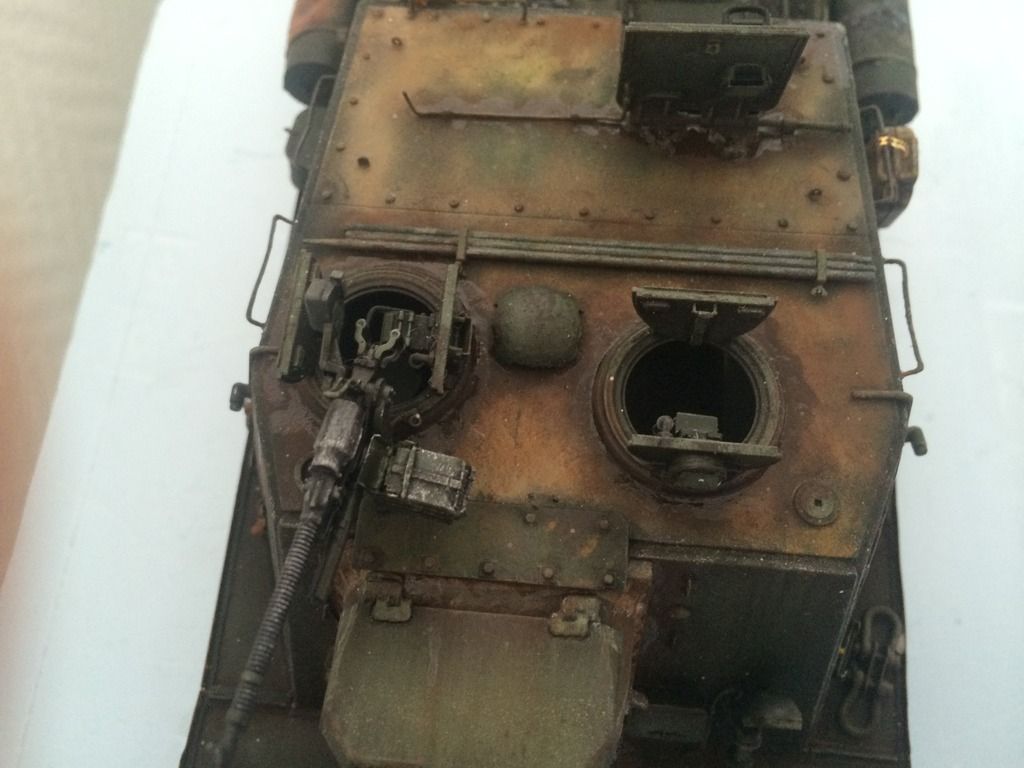

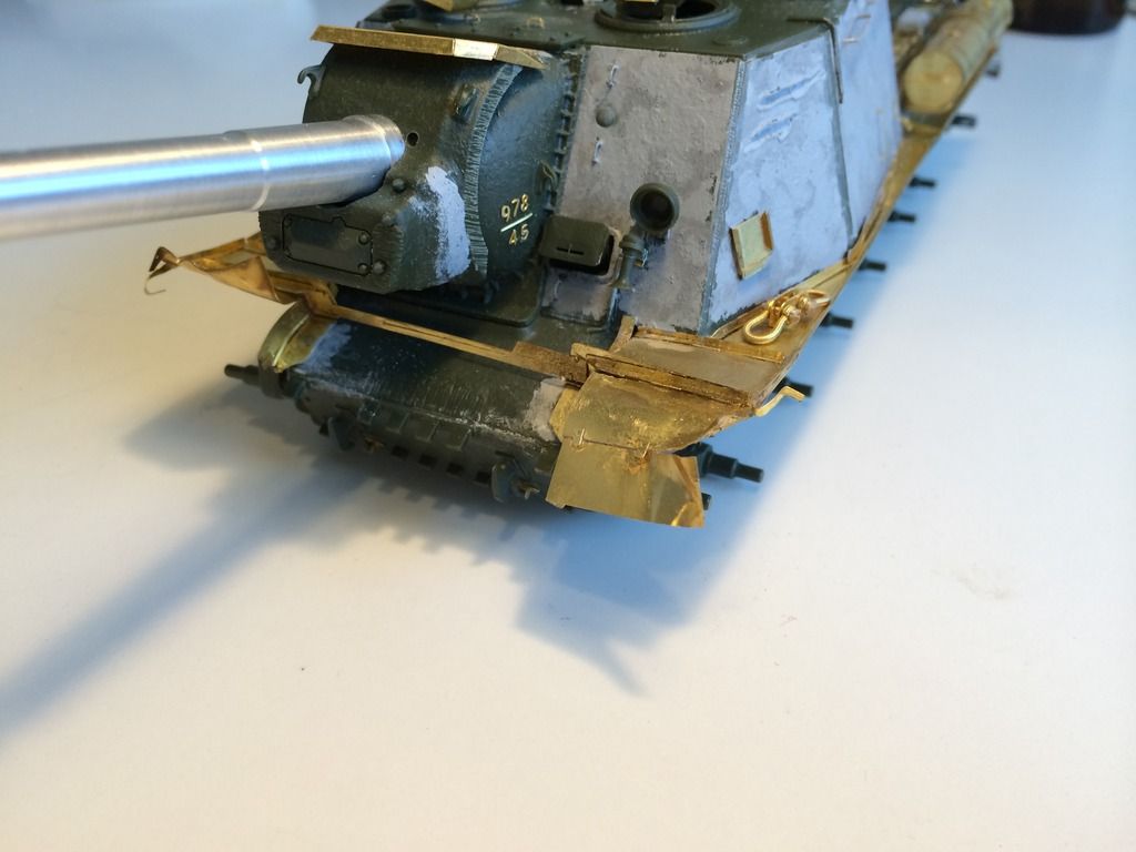

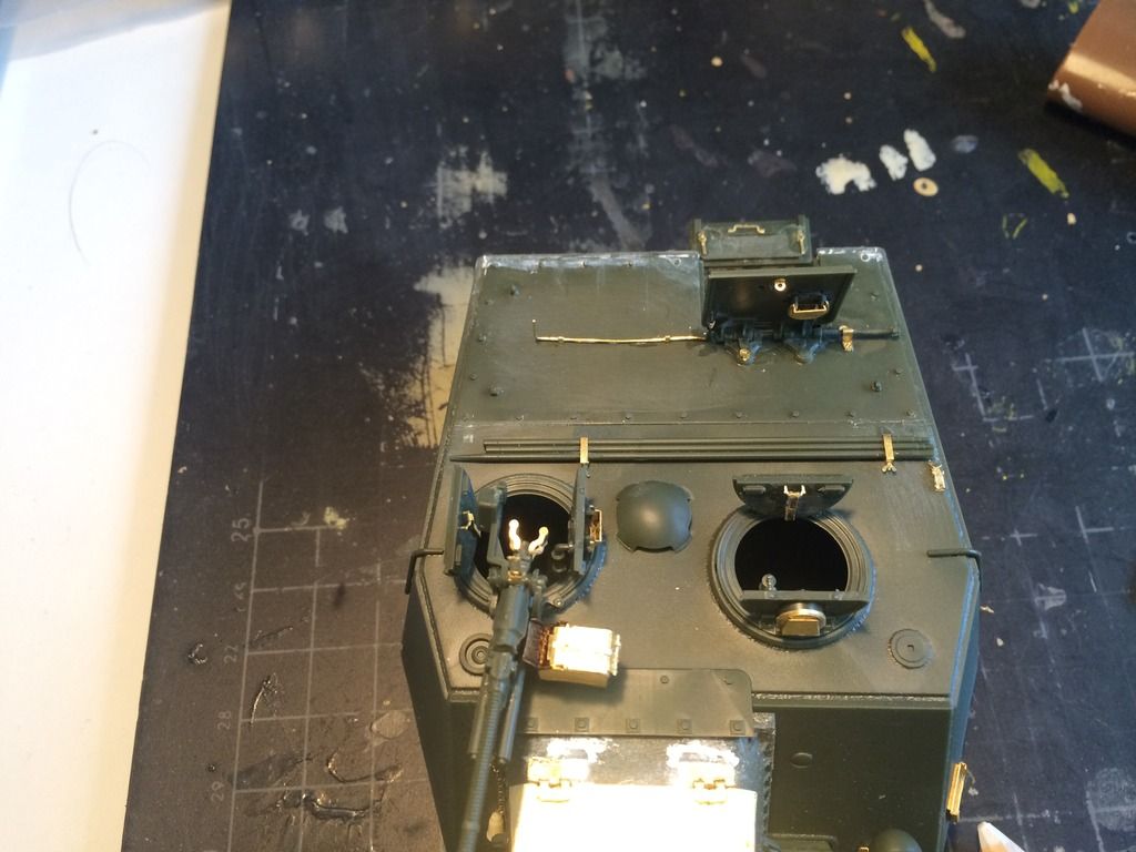

Update 2 slow build and happy build. Third big fret build for me. Anyone who looking to start working with pe, go for tamiya base with et model frets. Have done voyager and griffon before. Buuuut what I missed in the et frets was rods. Wished that were some ammo for the DshK
Trying to deliver some popcorn action.
Casting nr and added rough casting

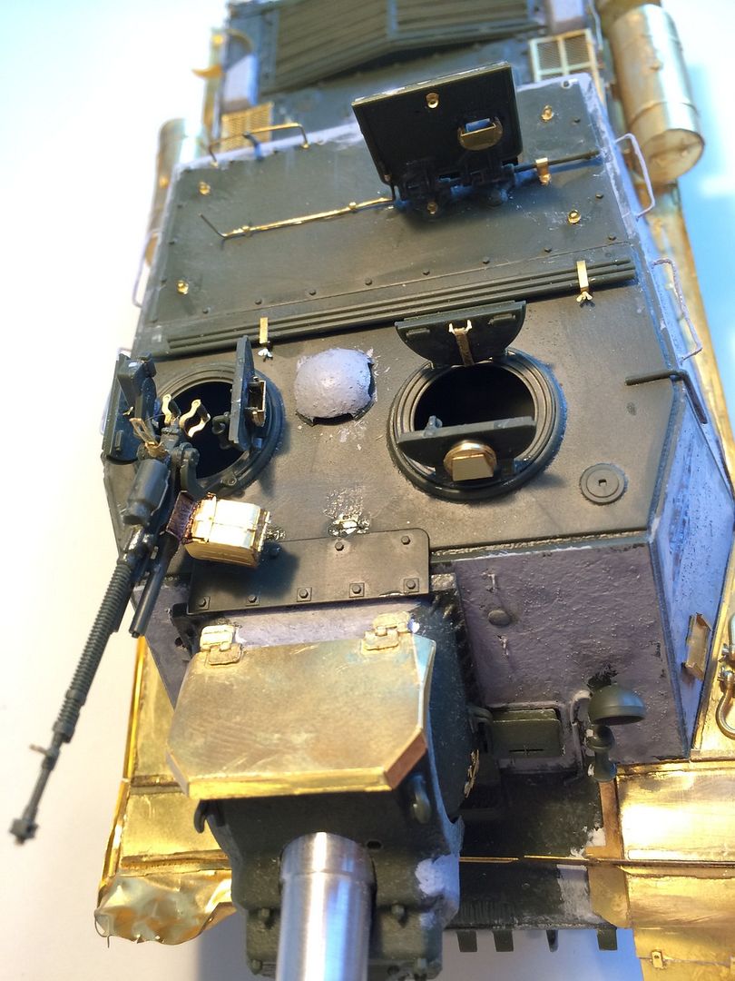

The top of superstructure is done :banana: some mistakes but nothing to cry about.

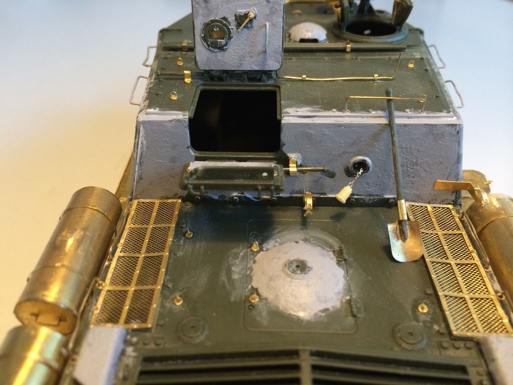

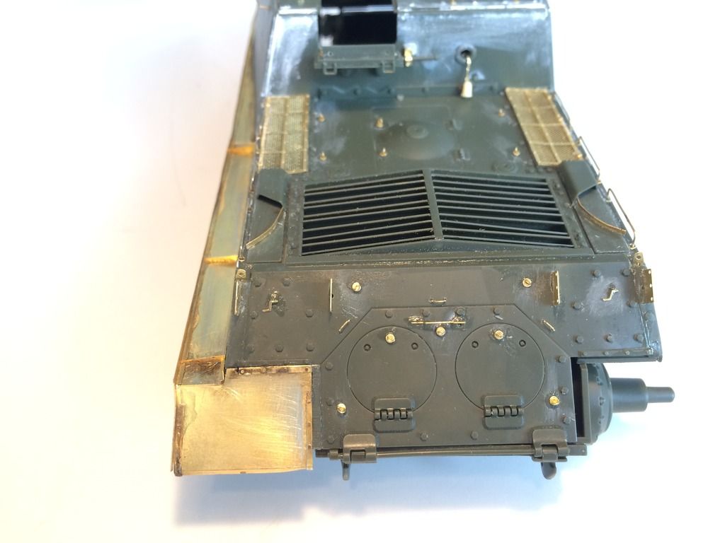

Re: Tamiya jsu-152 with et value pack

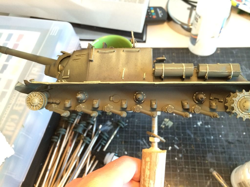

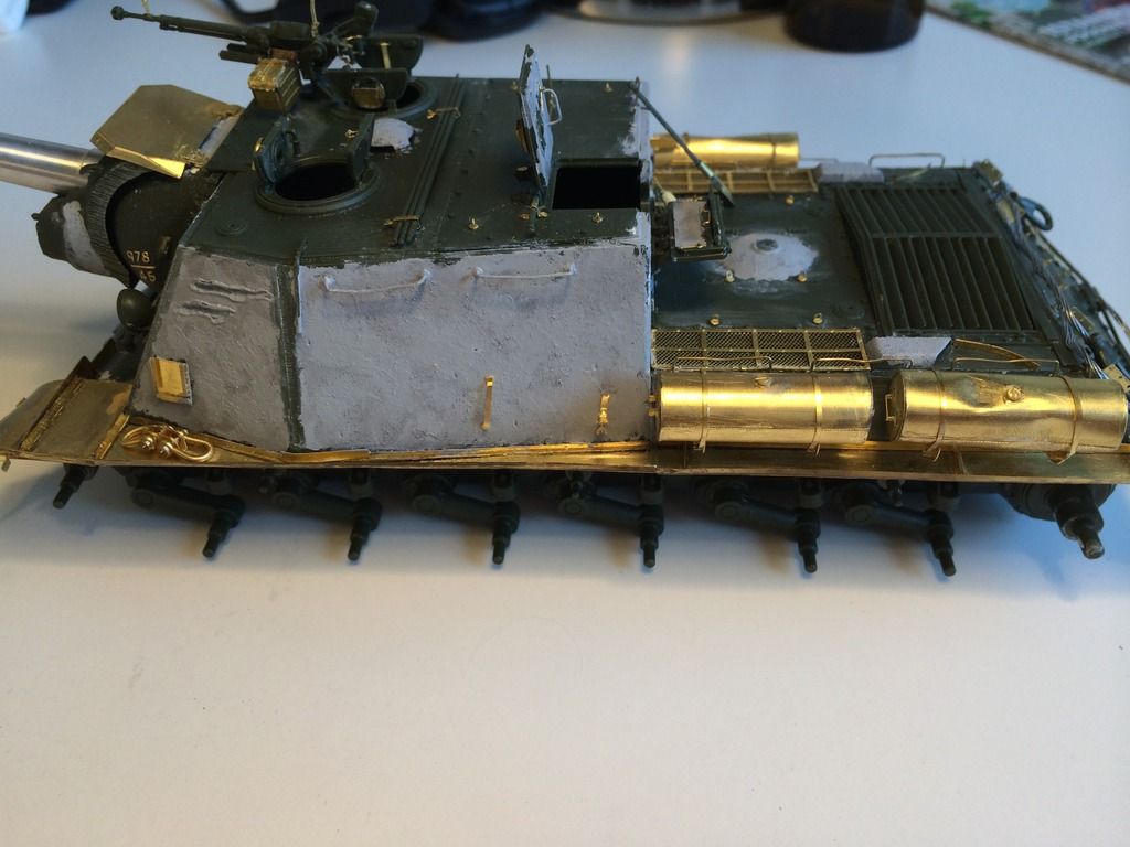

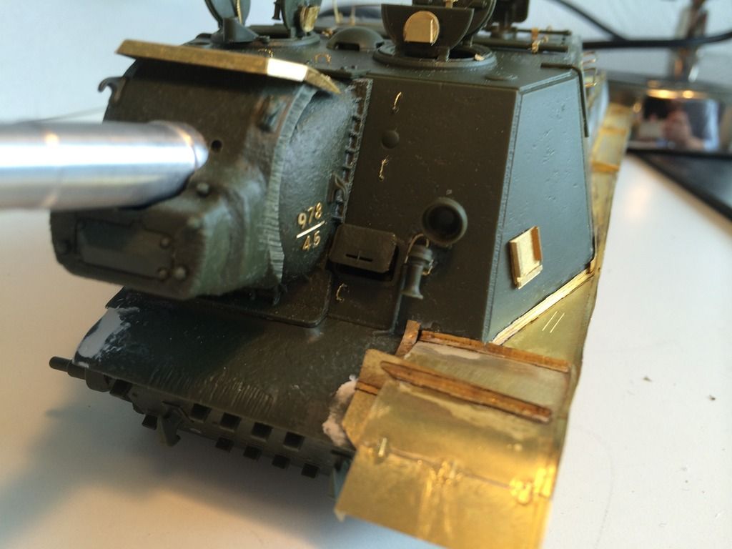

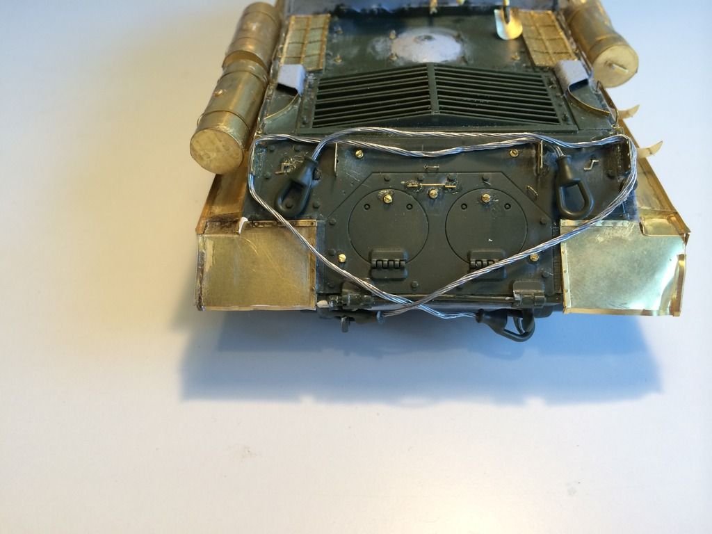

Happy update again! Amazing?! Just one complain! The plastic to protect the fenders had melt?! Fricking hard to get off. Otherwise just some glue on the wrong place but nothing I can't cover up. The build is going quite fast due lack of hinges on the tank. So this is a great first big fret starting tank.
Just love the menacing front.
One fender done! Sides I wait until the last. Otherwise I know I'm gonna destroy em.
Back done!

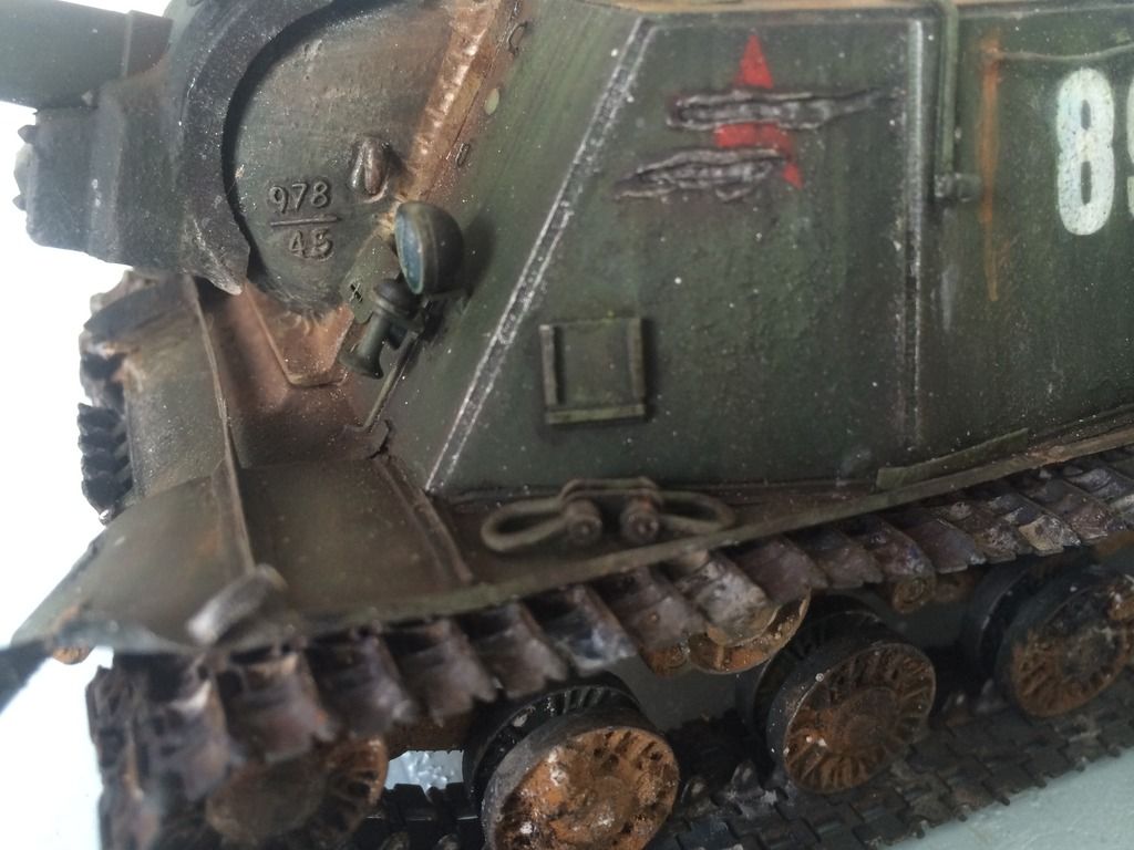

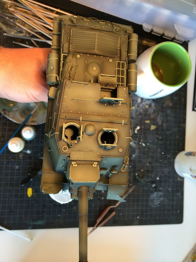

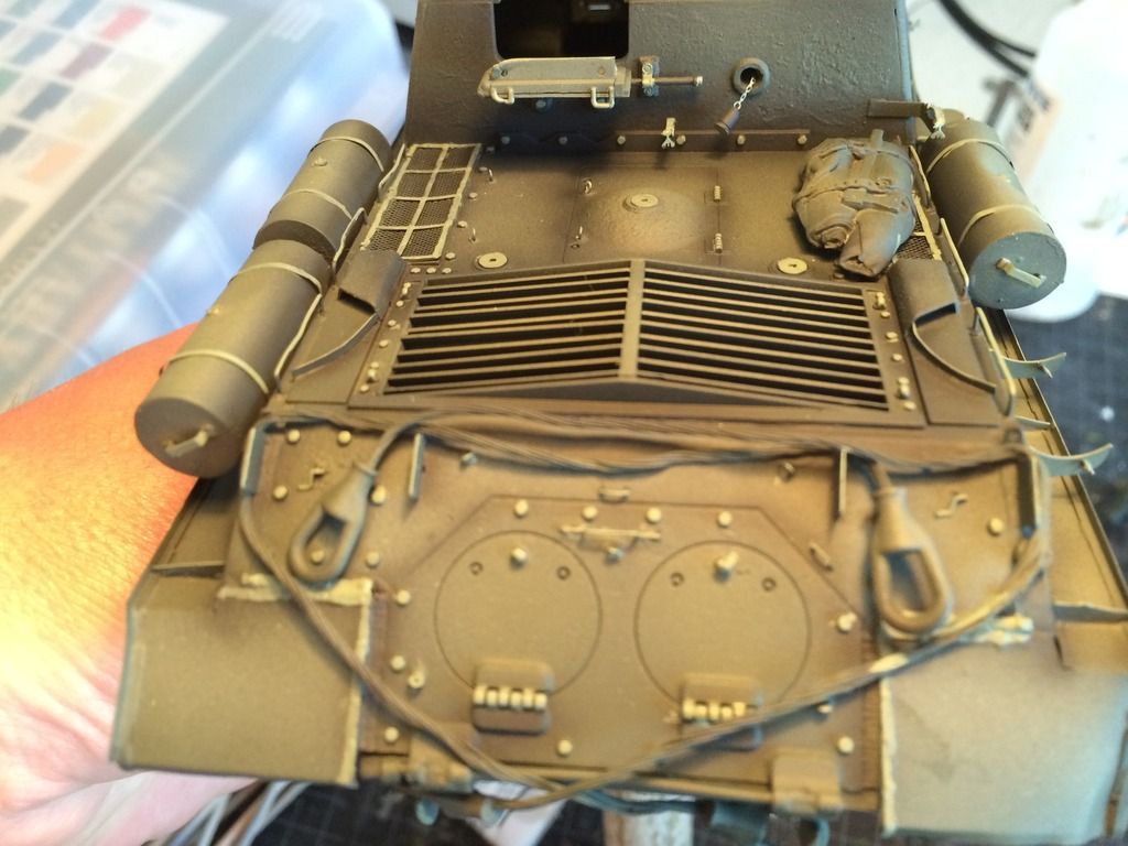

Update pe done!!!! Last tiny things was hard to motivate myself :crazy: but great pe set! Thank you et modeller! Now stowage! Next step is a little bath for the beast then metal primer from tamiya.
I've added battle damage with soldering iron and BENDING! Surface texture is mr surfacer and true earth "rough casting" I've replaced the shackles with tiger metal ones and the horrible rope with metal.

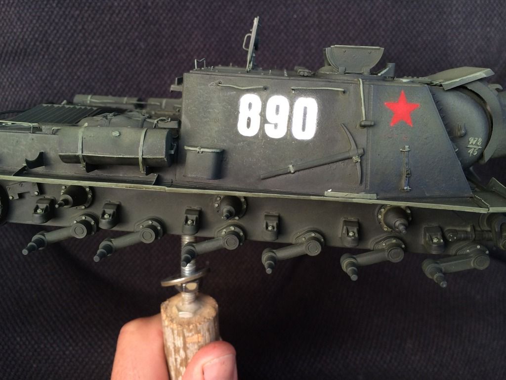

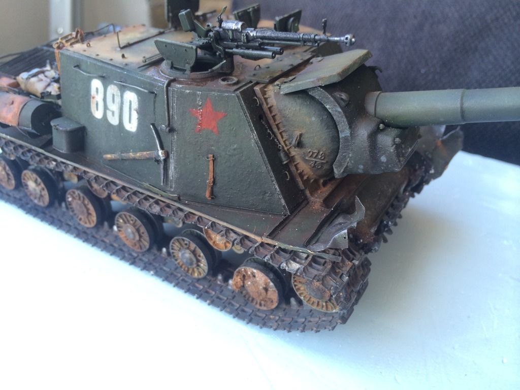

Some paint is on! This is how I like to do my basework. Its preweathered and preshade with black and white paint. Then ultimate shadows to ultimate highlights. Now it looks a bit like a spaceship! But its the way I like it. Base is tamiya mix and ultimate highlights are vallejo yellow olive mixed with ice yellow
It's drying with matt varnish.
Next step it's filter to unify the paintwork and then it's decal work. I'm using stencils so that's why I wait with the markings until the filter is dried.
The back hatch seams to have melted on the left side... The right grill caught some dirt and then paint so I've covered it up with stowage. :wall:
To make it look less like a spaceship and unify the paintwork ;) I gave it a filter mig production "green for allied tanks". The markings are stencils. My markings my space ship :shifty:

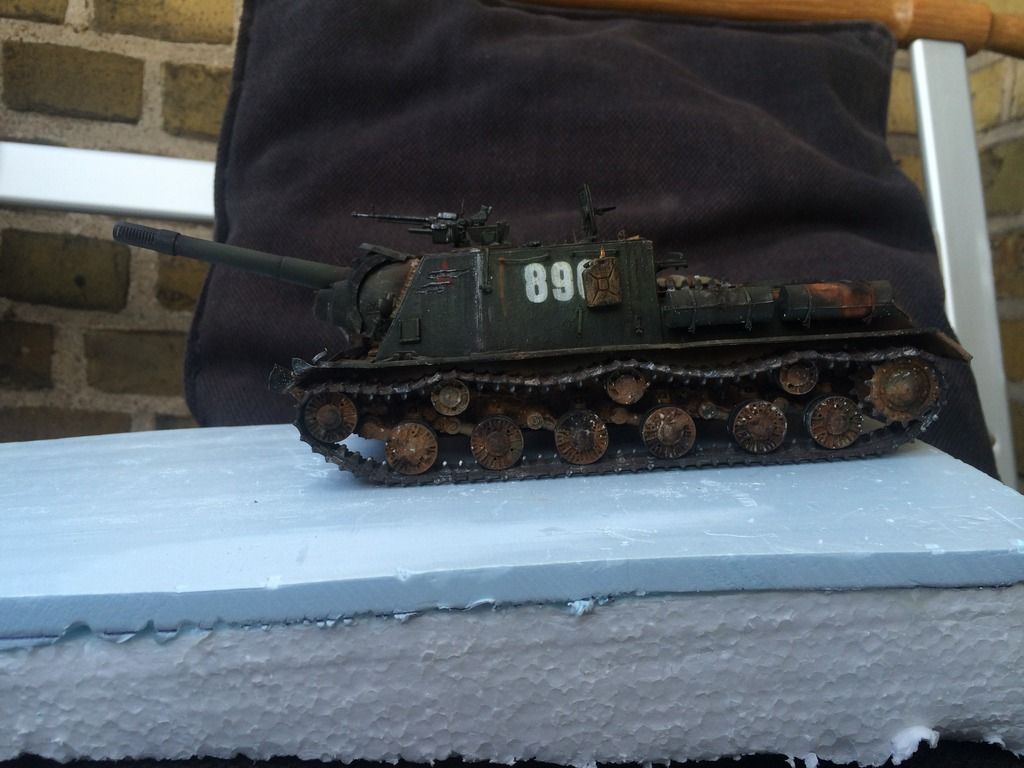

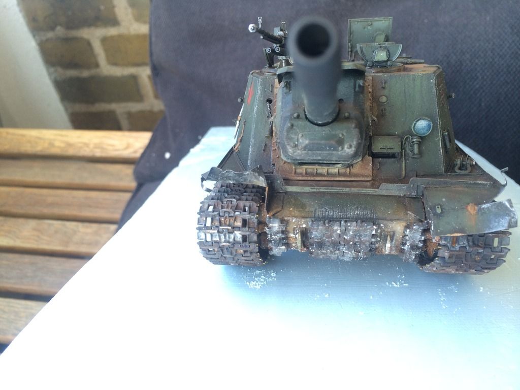

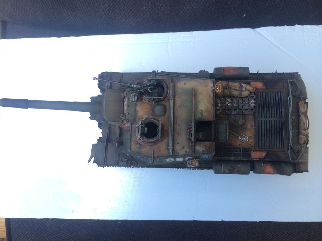

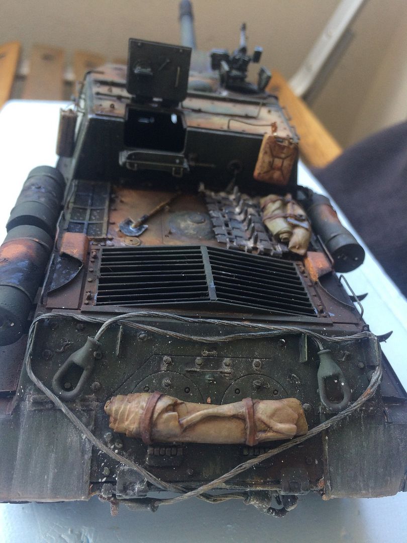

Update dio start.
From bagration to Berlin and it looks the part.
The tank is almost done. Heavy weathering. But I find the rust to be to much. I'm gonna find a way to hide it.

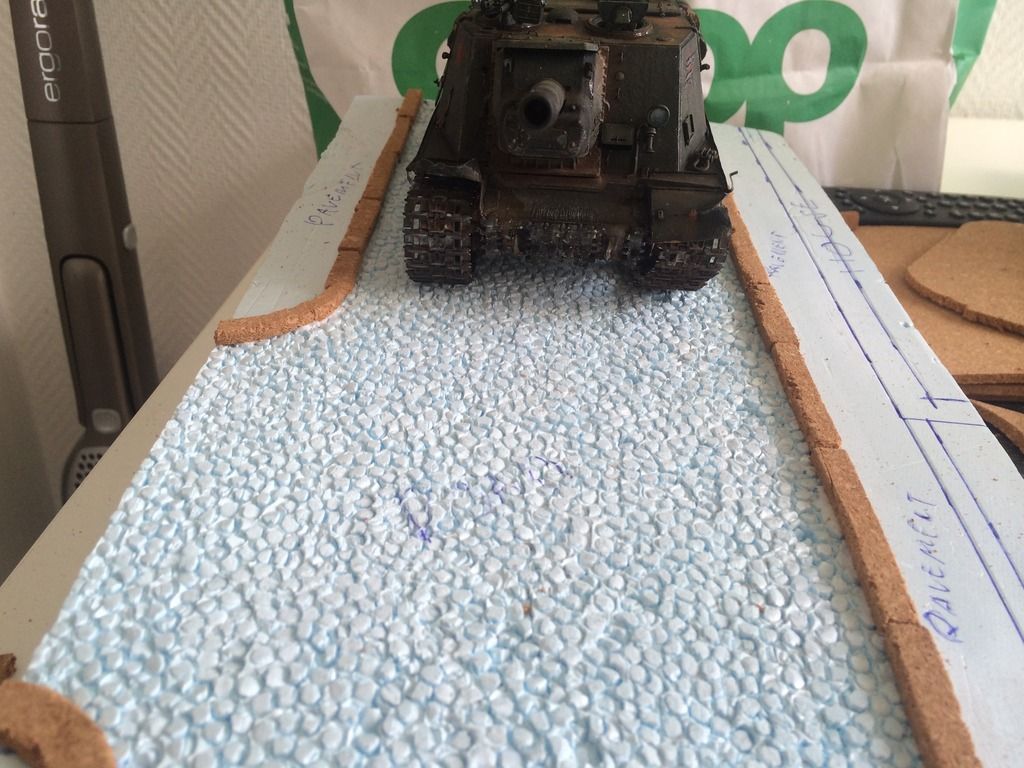

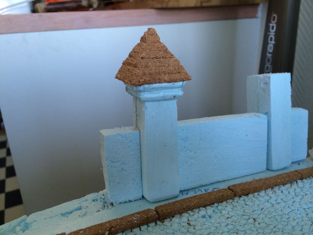

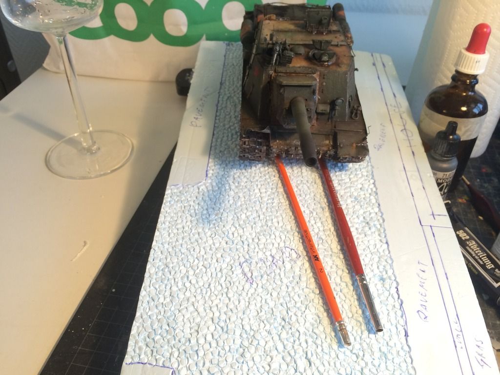

The diorama base is done with white and blue foam. The blue foam is so I can sculp out curbs, pavement and so on. It's slanting to create a more dramatic look.
Thanks for watching

How did you do those cobble stones on the dio? And what kind of material is it made of?
Did you use the bent pipe technique?
cheers
Hansolo
hansolo wrote:Looks amazing so far, Gustav!
Love how you battered up that ol' 152.
cheers
:bow:: thank you!
It's foam for bathroom floors. That's why it's so much denser than regular foam. It has been used in arts n crafts for quite some time, and can be found in office or hobby stores here in Sweden.Great material! The cobbles are made from 2 broken brushes. Take away the hair and you got a perfect cobble, the just push down a million times and you got a street. I'm gonna give it a coat of vallejo earth thinned with water to finish it off, before primer.
Gonna give this wall bricks next with a razerblade. Easy to identify the right foam is that it's blue in the western world.
