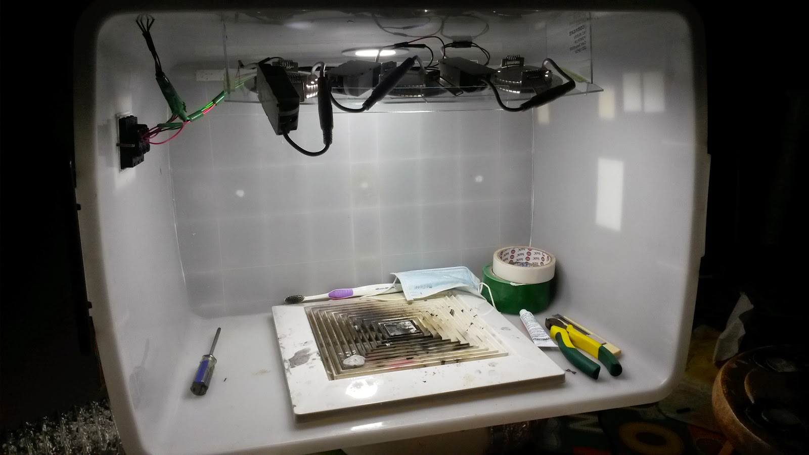

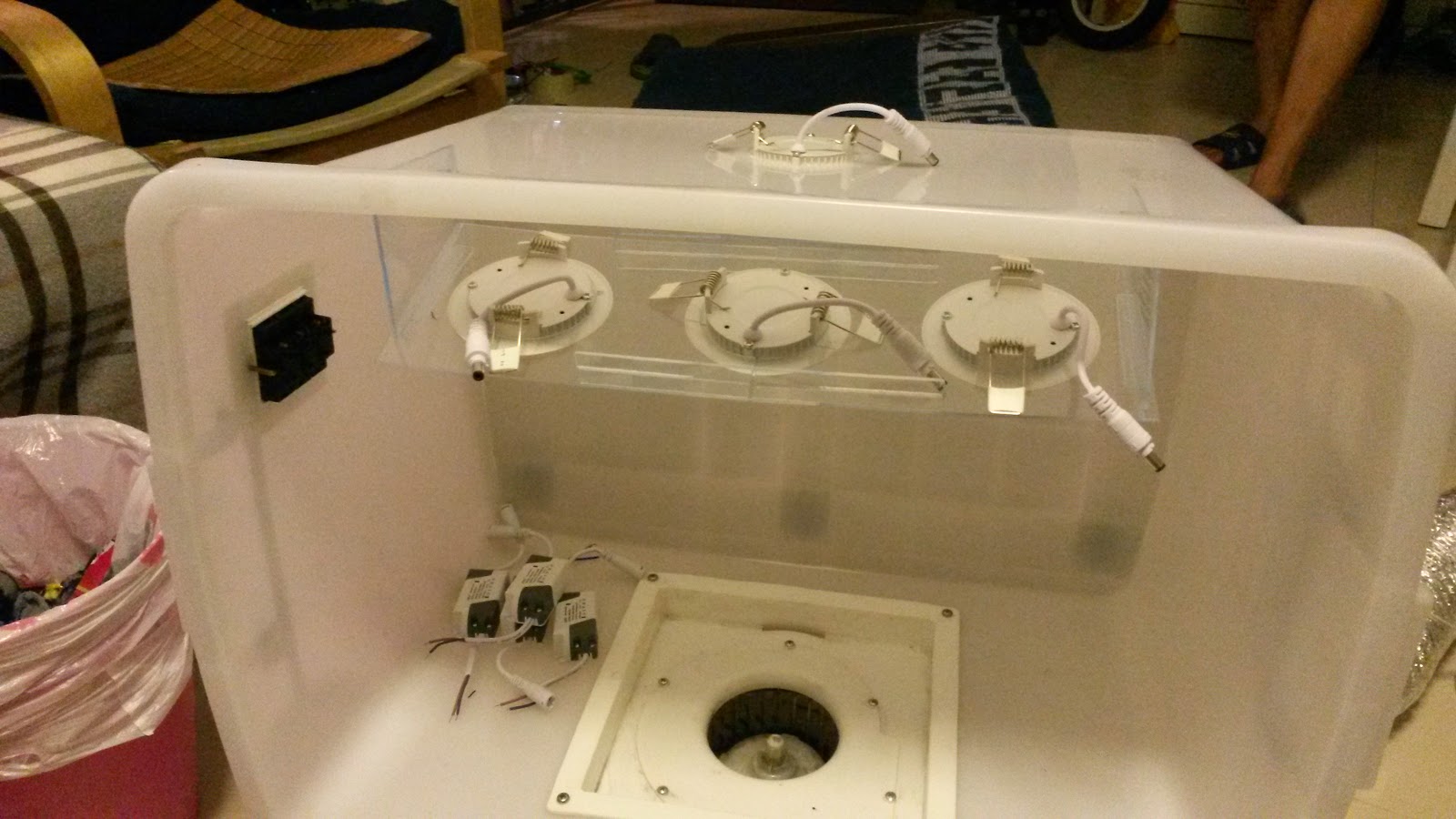

I built my spray booth. Well, actually two. The first one is out of cardboard box and using 4 CPU fans to draw out air. That didn't last long since it is so humid here. The box soon disintegrated. The one I'm currently using is simply a big plastic storage box. For the fan I chose a squirrel cage kitchen fan just to be on the safer side that the fume won't explode. I cut the mounting hole on side of the storage box so that the box can act like a downdraft booth (downdraft requires less power than side draft). At first I also mounted some LED strips to provide the lighting. However, due to the lack of metal cooling plate, the LED modules soon burnt out. So I found some ultra slim panel lights with build-in cooling plate to mount on it. At the back of the side I also pasted a strip of Velcro tape so that I can tape a backdrop paper on it.
So, my spray booth can act as 1: a spray booth, 2: close the cover after finish as a drying box and 3: as a photo booth with backdrop paper.
Sorry about the big pictures. I'm still trying to figure out how to post pictures from google+....
v2.1: With LED strip, you can actually see part of the fan and the hose at the bottom of the picture. But it didn't work out fine since the LED was burnt out and the glue doesn't stick to the side of the box too well (also due to the heat of the LED)
As a photo booth:
Four panel lights on three different switches to control the lighting level. I built the light frame out of acrylic boards.
