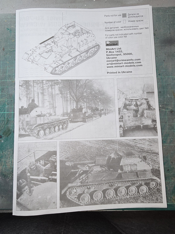

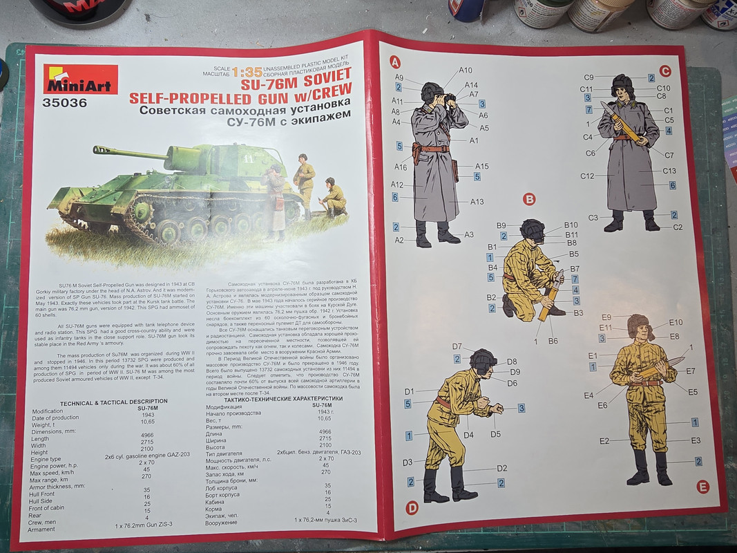

Now - onto the kit.

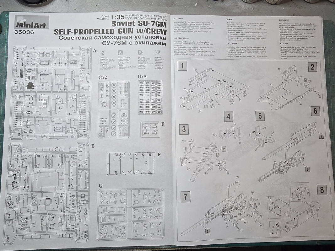

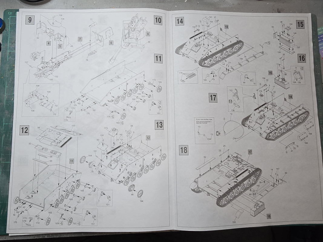

Instructions

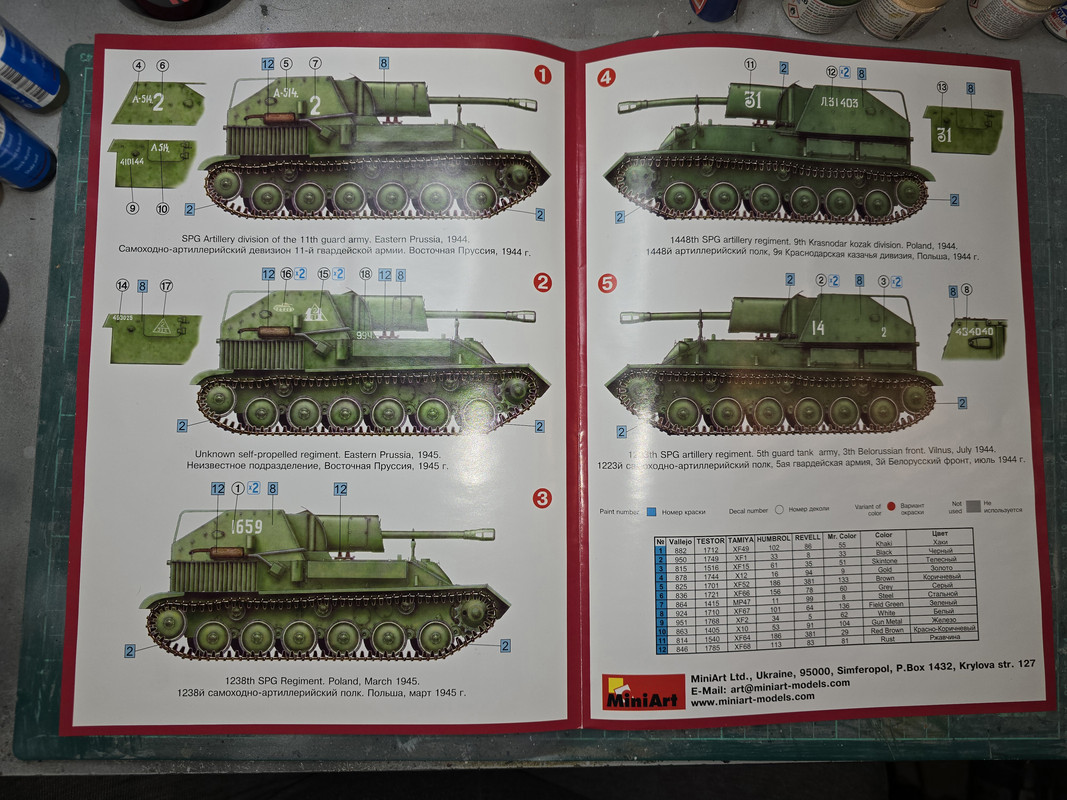

Painting guide

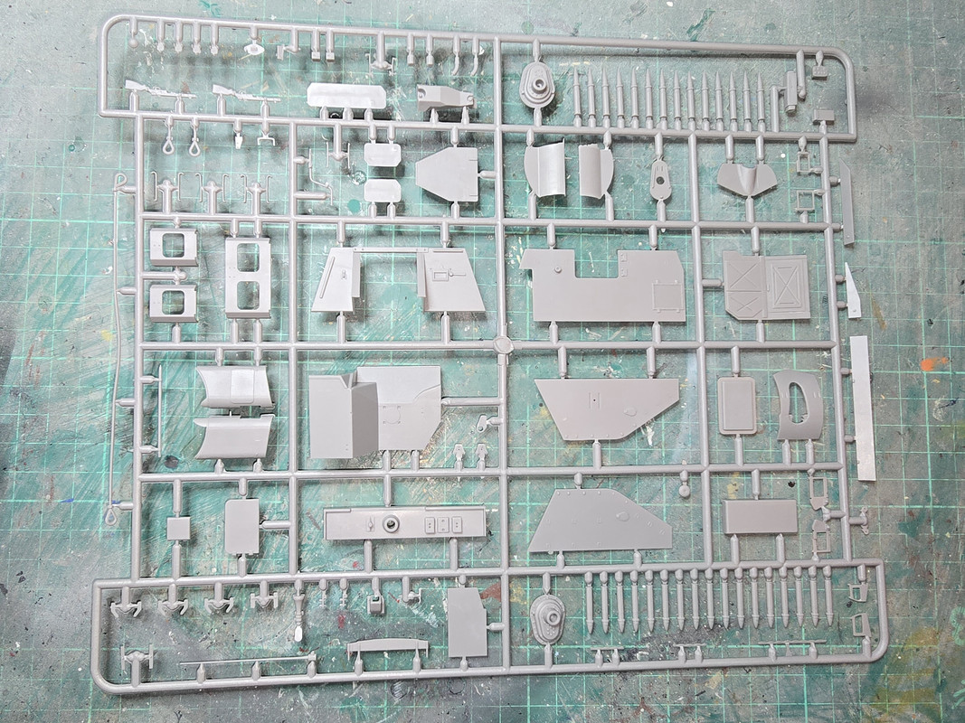

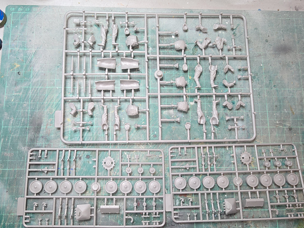

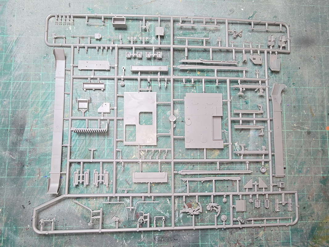

Sprues

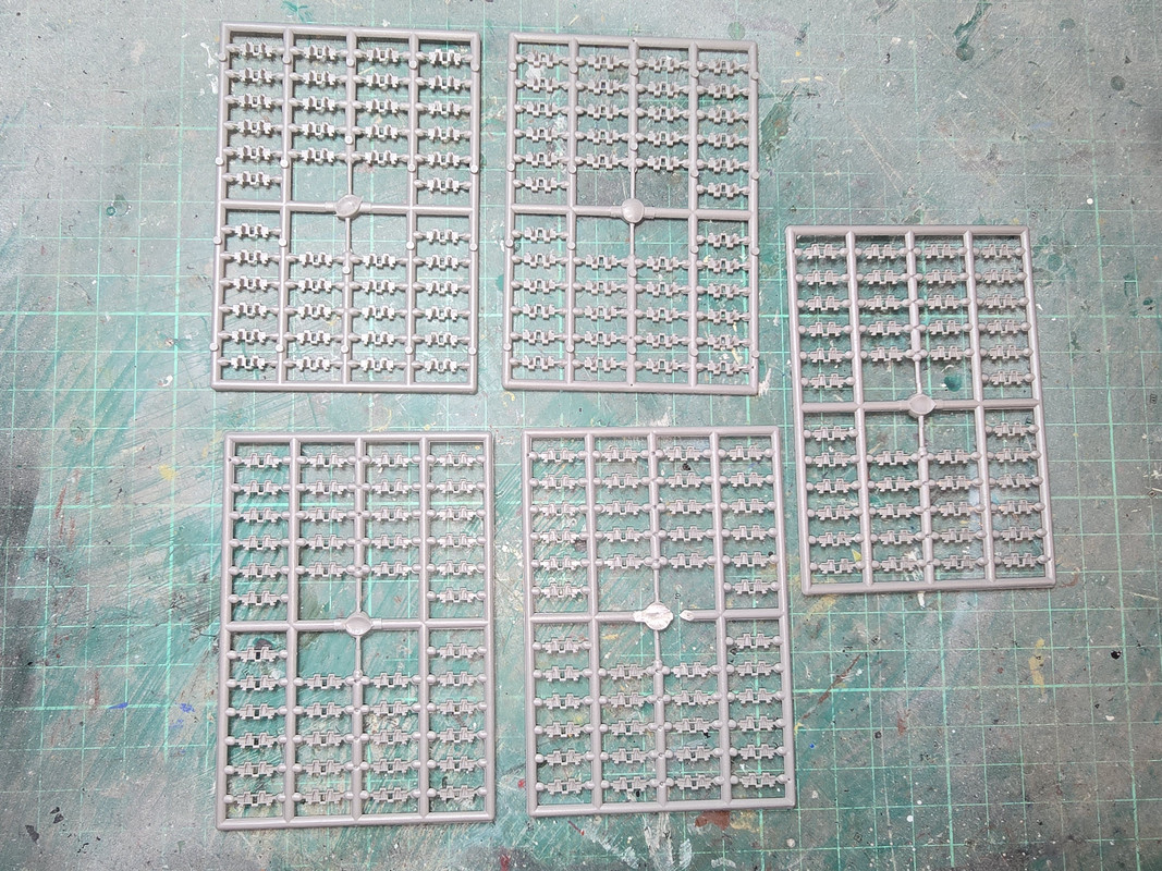

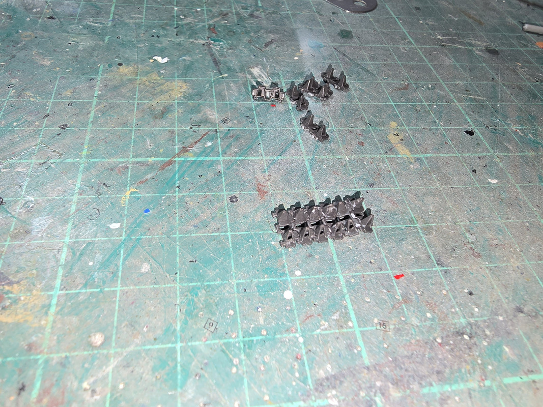

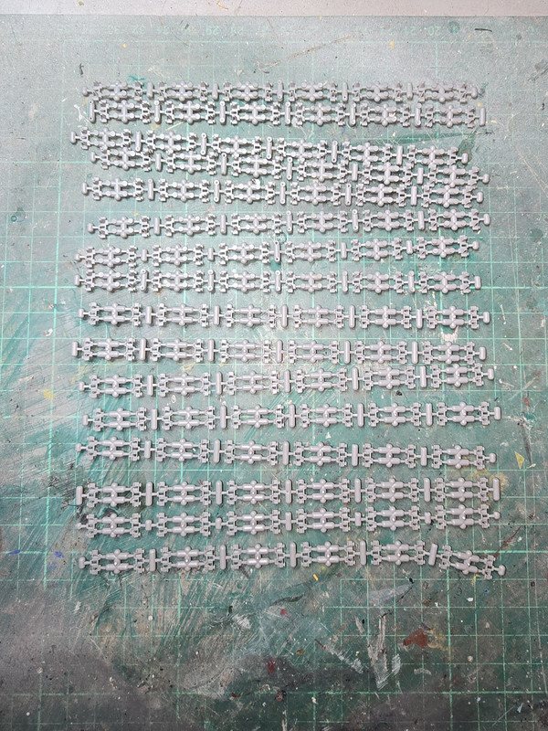

Kit tracks

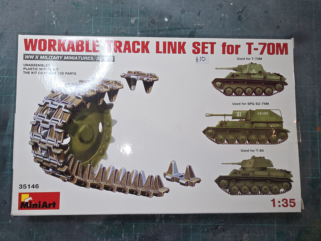

The kit also came with this pack:

    That's a lot of tracks! Looks like a fun kit. :th:
    Posts: 8374
    Re: RangerNeils SU-76M
    Nice looking kit. Have fun with the tracks!

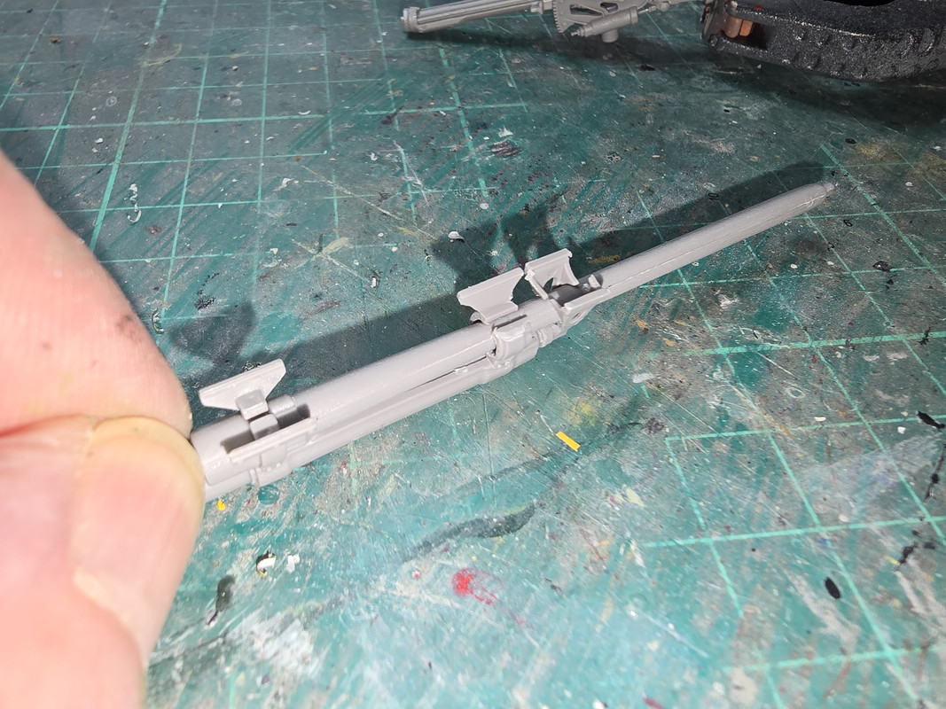

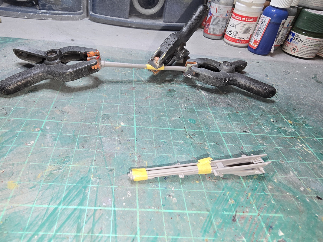

      Going on the work so far I very much fear you are right. :(
      The gun barrel is made up of 3 cylinders that slip inside each other - there are no locating pin, just butt joints so getting the two halves to line-up has to be done by feel and eye. Oh yes - and clamping the hell out of it!!! :lol:
      Annoyingly the kit was in sealed bags - but one of the front brackets was broken! Luckily its shrouded when finished so won't be noticeable. Phew!!!!!

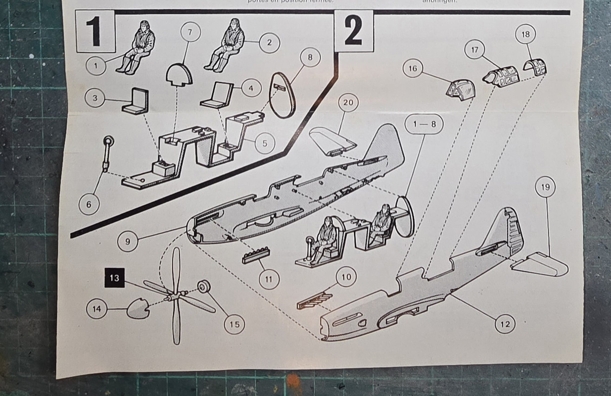

        Already had a "where's bin 13" moment a couple of times!!!! :)

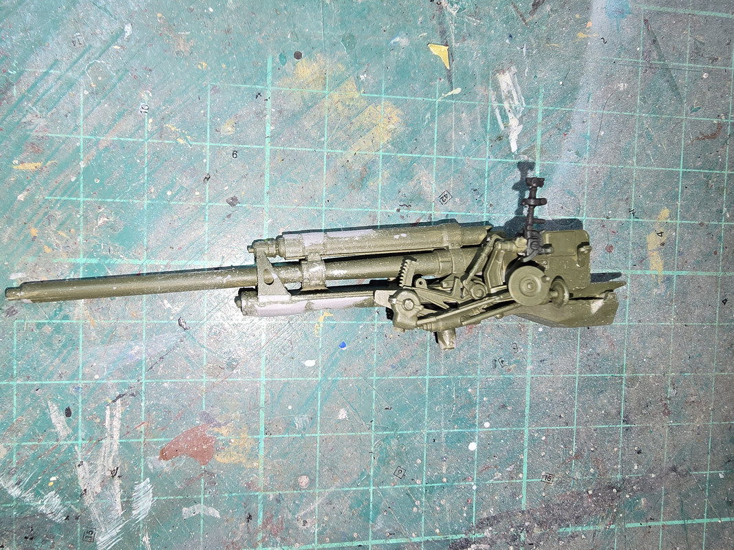

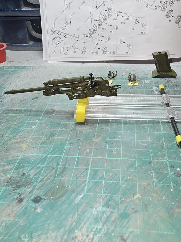

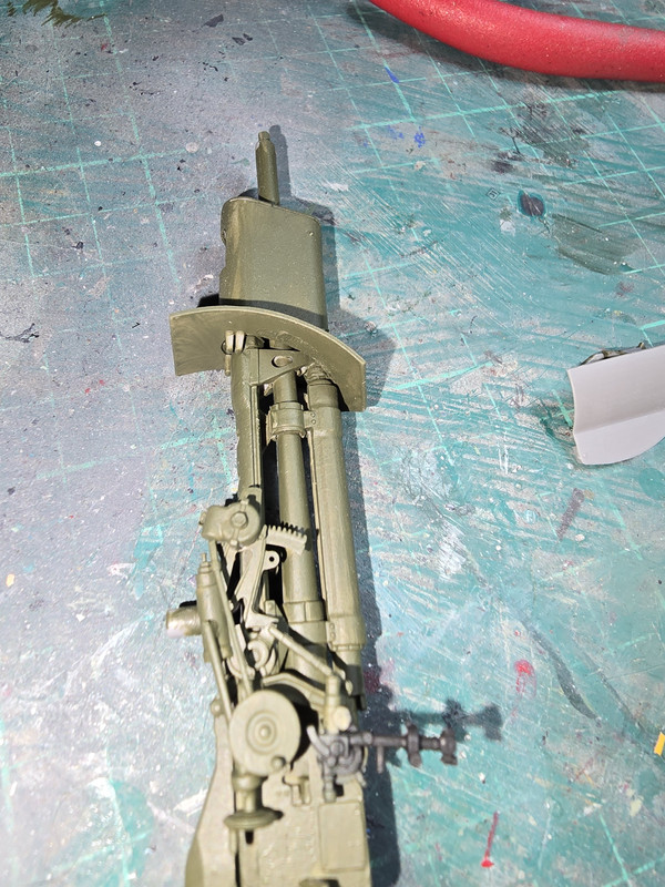

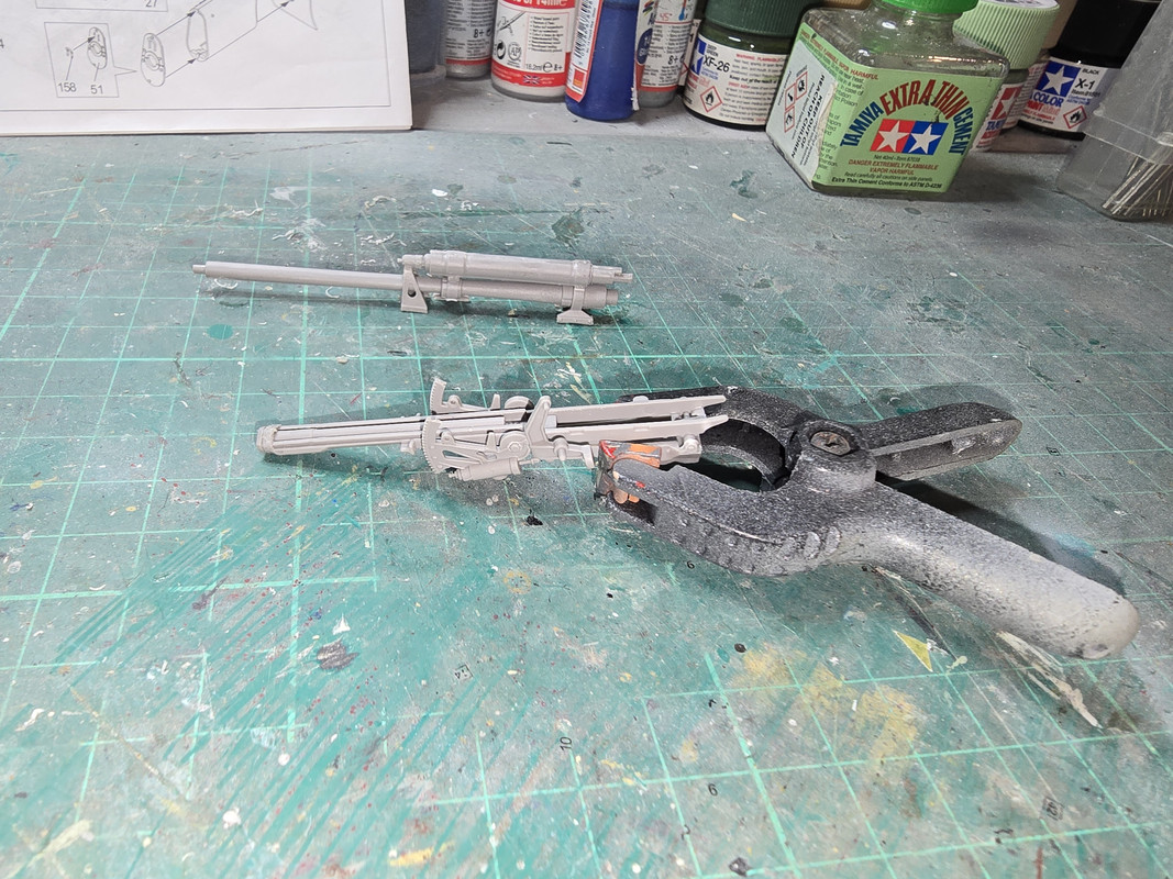

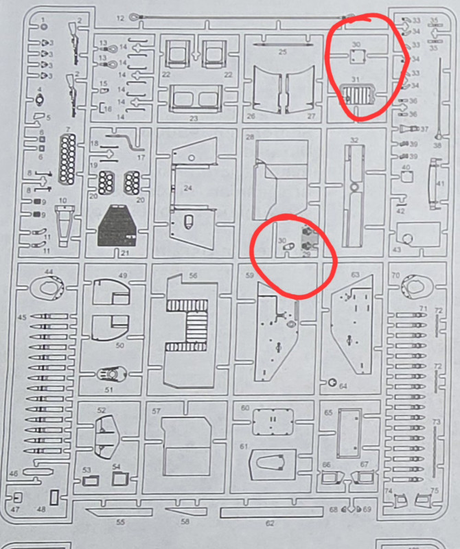

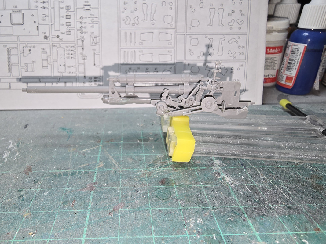

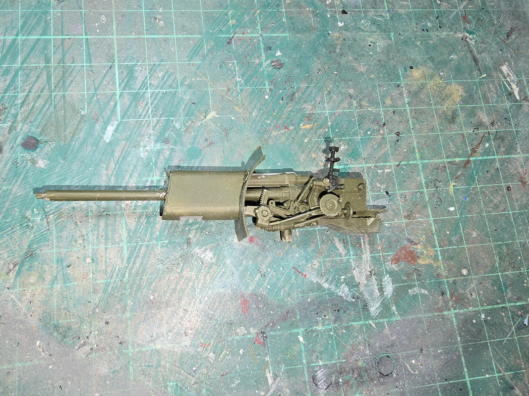

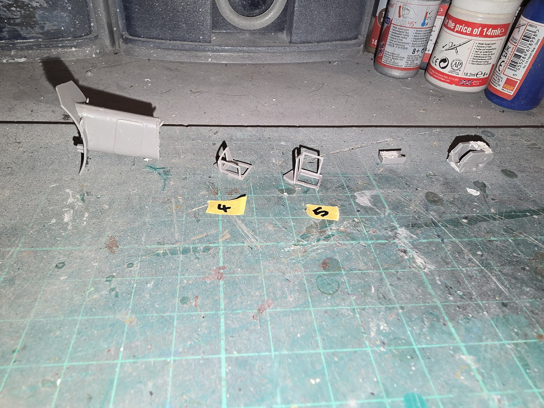

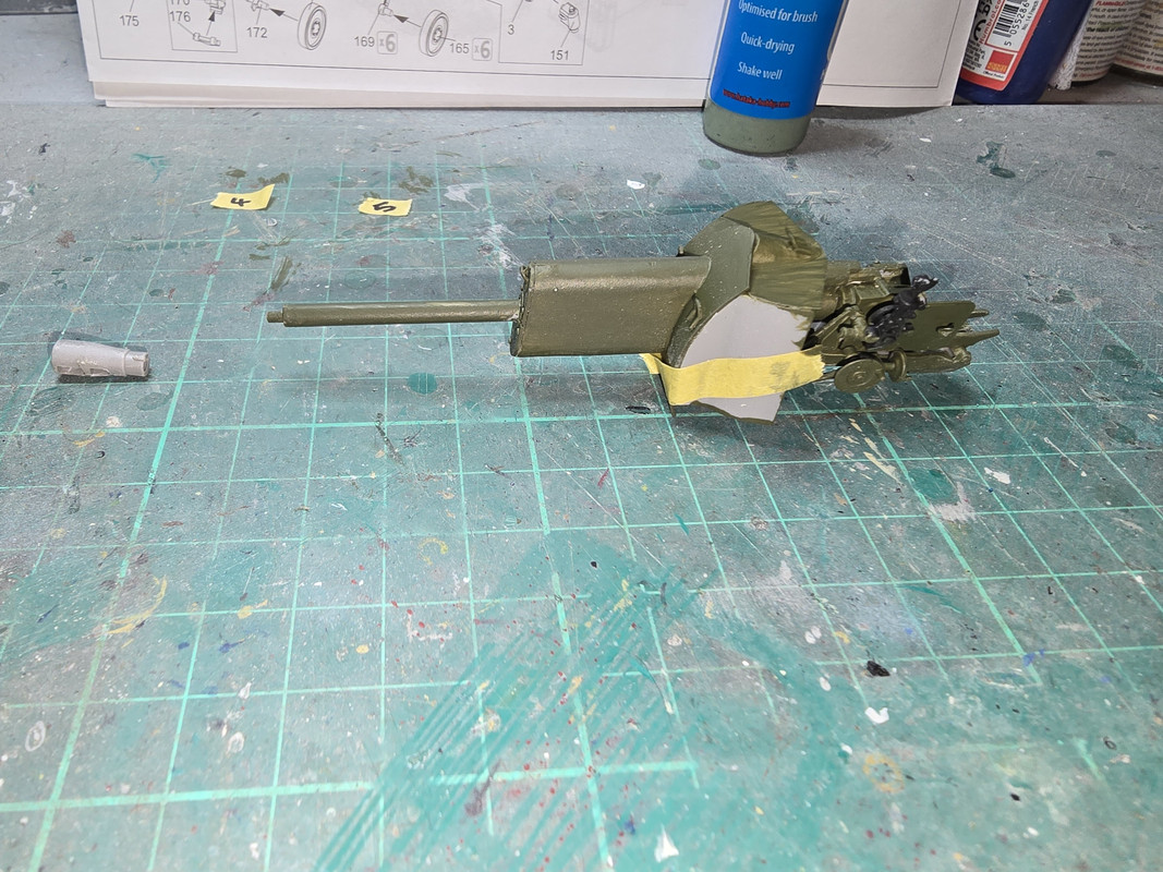

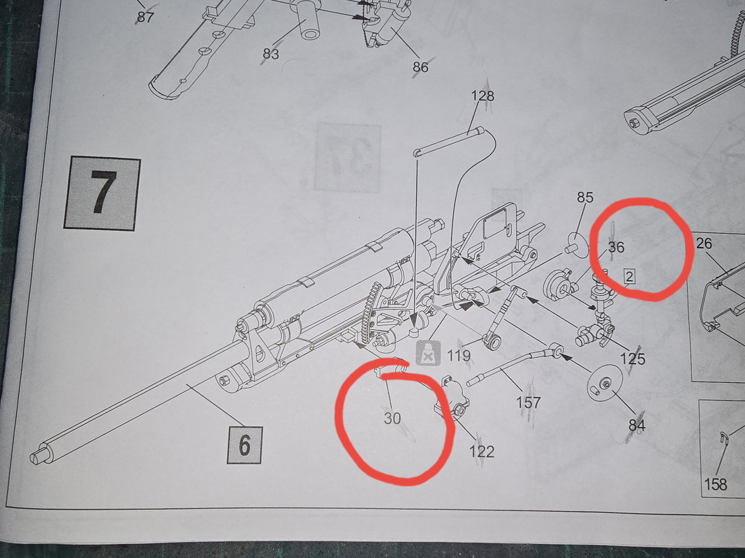

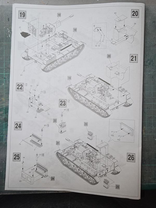

            Sanity took another dip today...... :(
            One side of the gun is done:

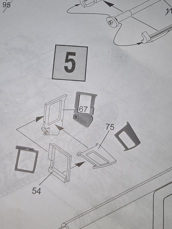

            And we come to the first glitch!! Looking at the build diagram and the areas circled in red:
            Firstly there are two parts labelled 30 on the sprue diagram!!!
            Secondly the positioning instructions for part 30 are, frankly, diabolically awful!!
            Also the part labelled 36 is actually part number 136.
            Anyone with this in their stash might want to make a note of this.

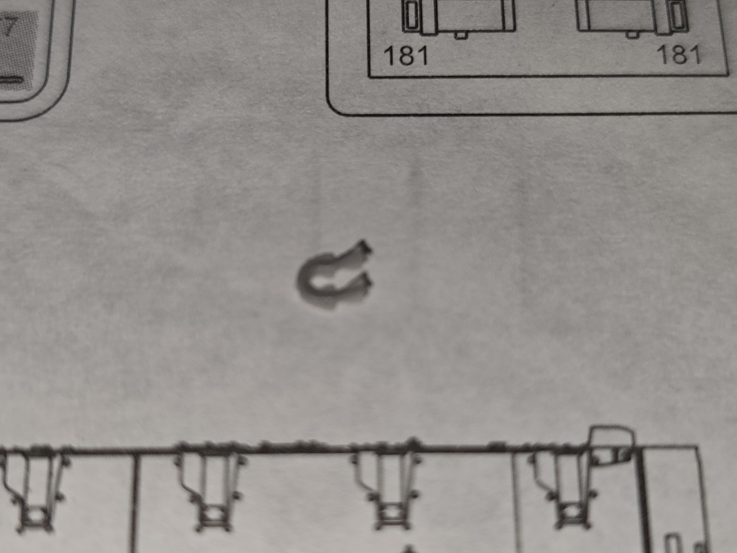

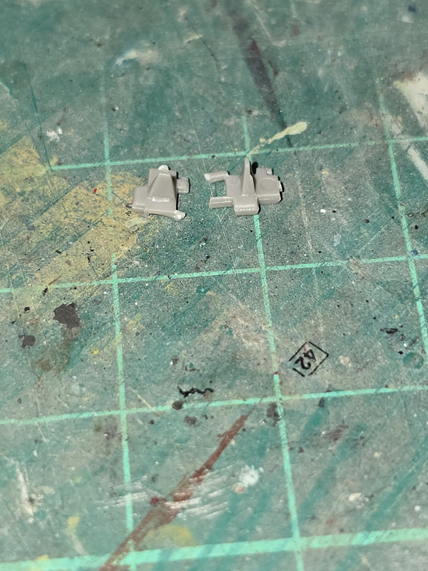

            Next issue is the amount of flash on the minute parts.
            There are quite a few of these that are going to need very careful cleaning
            Lastly for step 5 two parts are short shot - the parts are laid on the diagram and its obvious where - incredibly annoying as it made getting this sub assembly to line up a nightmare.
            Hopefully its right. So - close of play today we have half the gun complete, breech in progress (the moulding left the joins with rounded edges so I've had to resort to filler!! And the sliding block had a massive sink spot - also filled. The mantlet is also complete together with the frames in steps 4 & 5.

              Plenty of detail but its making you work for it! :th:

              Stokesy44 wrote: Fri Jan 17, 2025 7:16 am Plenty of detail but its making you work for it! :th:

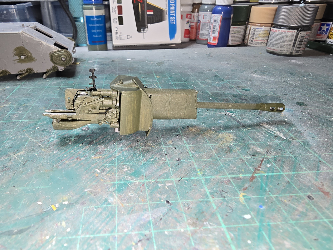

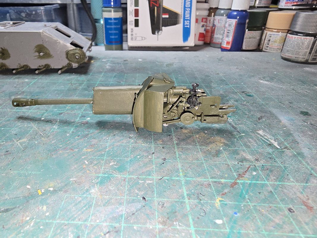

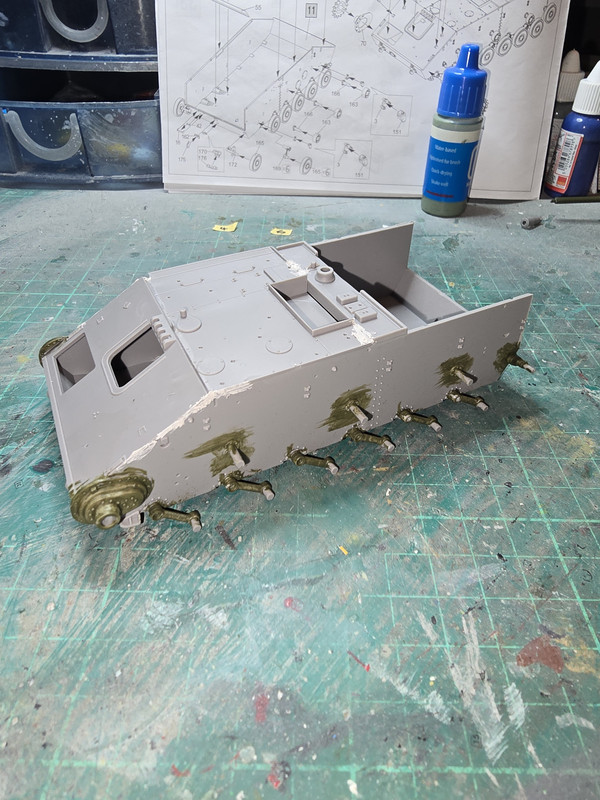

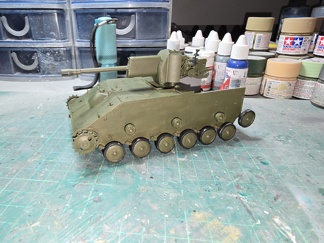

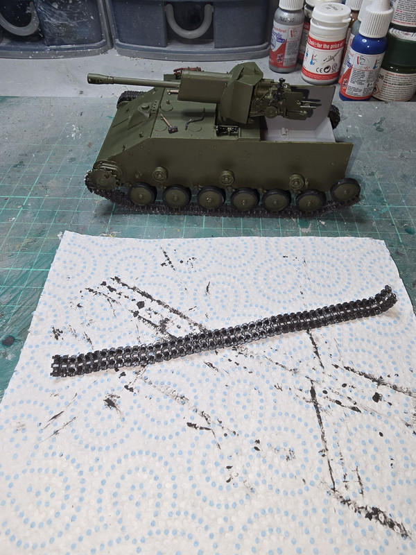

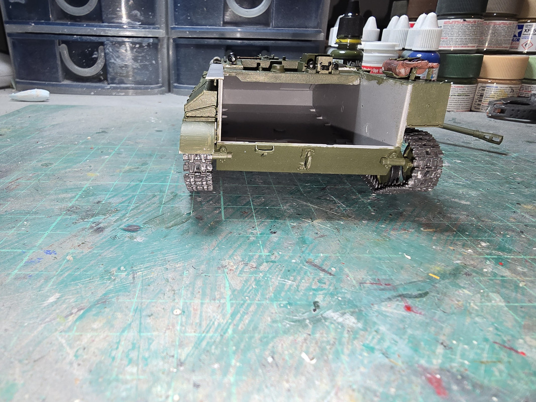

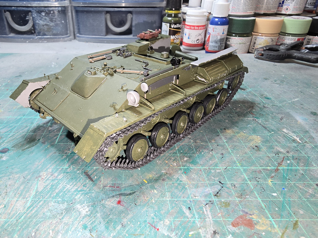

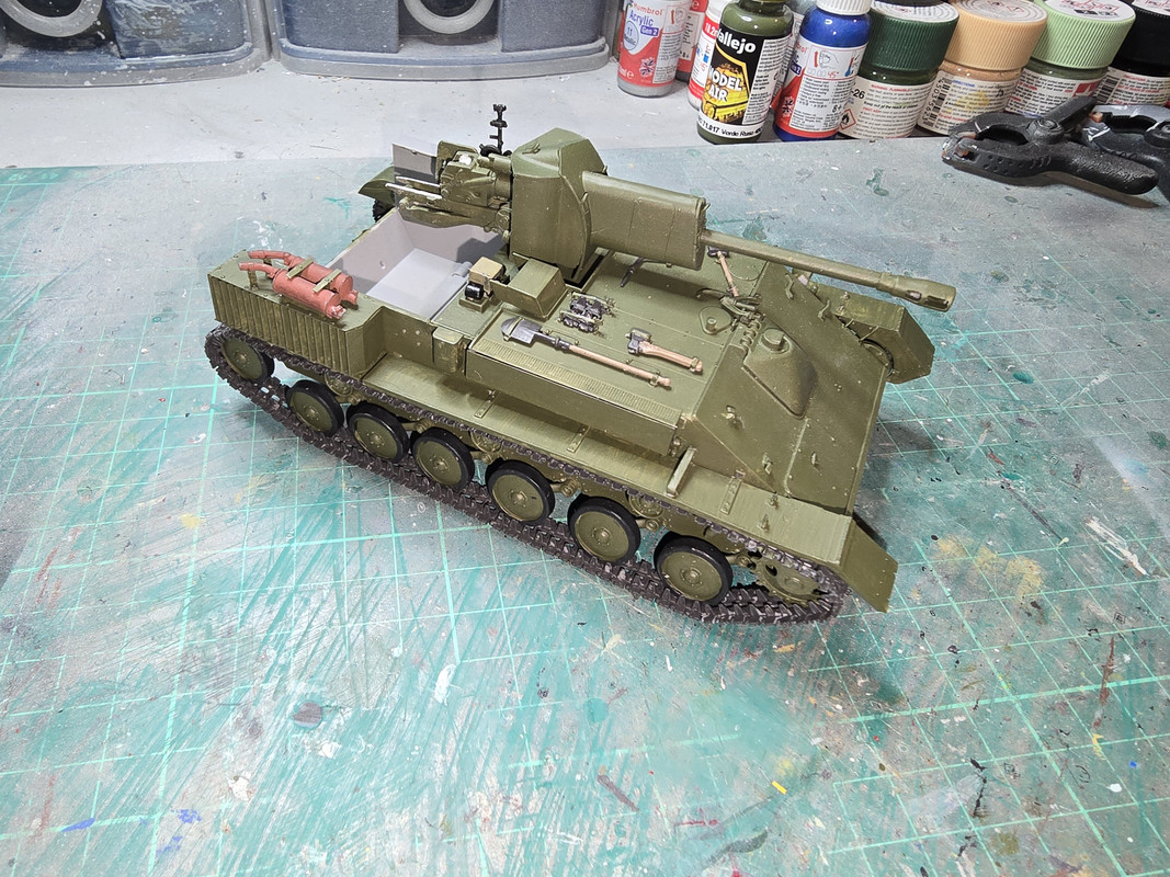

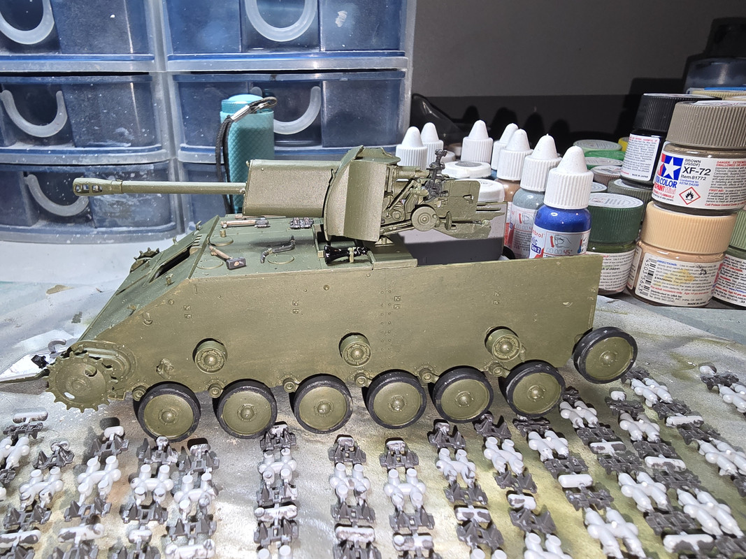

              Tell me about it!!! Gun was primed last night and had the first coat of 4BO green applied. Second coat goes on today then the mantlet can be assembled on to the barrel.

                Well - it gets better and better - he laughs cynically!! :roll:
                Went to fit the shroud & mantlet over the barrel - and the hole for the barrel is too small!! Opened it up to 3.5 mm and it became a nice fit. Until it met the recuperator. The assembly is too tall to fit inside the shroud.
                I reckon by at least 1 mm. :( Only solution I can see is to sand off the top of the recuperator cylinder the length of the shroud. Its invisible once assembled so just a total PITA.

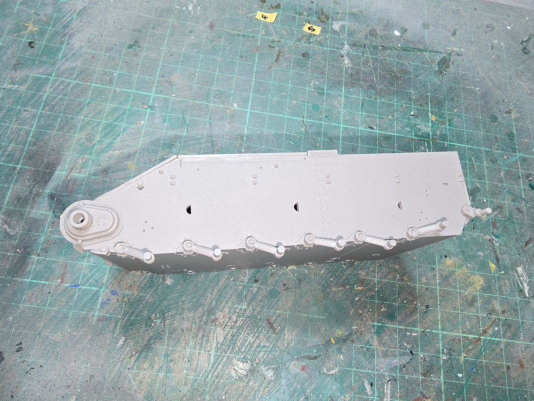

                It's kind of sapped the mojo a bit so I put the gun assembly to one side and started on the hull. I hope I've got all the upper plates right because - again - there is no positive location!! Tamiya/Airfix etc. step the top plates so they locate in the hull. Miniart - flat hull side, flat top so you have to hope and pray every thing is aligned correctly!!!

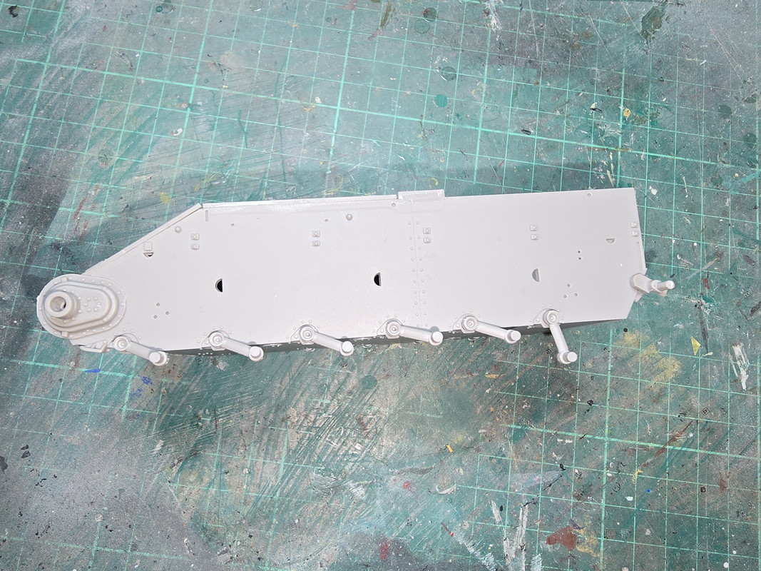

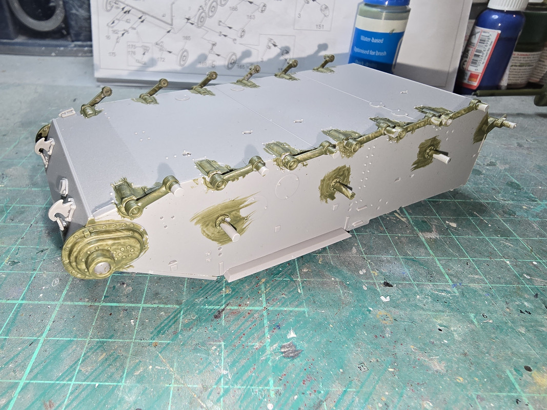

                Then we come onto the suspension arms and AGAIN nothing positive to align them. As can be seen in the photos they can be positioned anywhere.... So I'm thinking some stacked lolly sticks to set the height against so they are at least all the same.
                Correctly wondering whats going to go pear-shaped next!!!

                  Tomcat64 wrote: Sun Jan 19, 2025 8:27 am Image
                  It looks like the only difference between this and the kit I had is which parts got undershot :(
                  Still here for moral support though mate - just beware more dragons on the upper deck :?
                  Going to need it I think - and the beers to follow!!

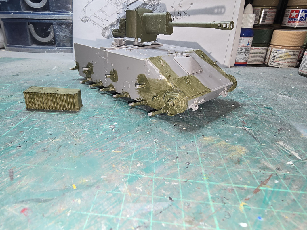

                  So - I had a close look at the gun/shroud assembly last night. After a bit of head scratching/hair pulling I came the the conclusion the problem was two-fold. The gun was too high overall and too wide at the bottom. So after a bit of sanding/test fit/sanding again etc. I wound up with this:
                  Which means the shoud now fits - more or less - as intended.
                  Roof and sides added - going to need a bit of filling and sanding because the mantlets a different curve to the side walls:
                  Moving on to the hull - the lolly stick height gauge seems to have worked.
                  But again theres a bit of sanding after filling to do.......
                  But we are getting there........ I think!

                    Good catch on the gun.

                    digger303 wrote: Sun Jan 19, 2025 12:52 pm Good catch on the gun.
                    :th: :th: :th:
                    Ps....don't worry about the sanding your a dab hand with a expert technique after all those old school kits... :whistle:

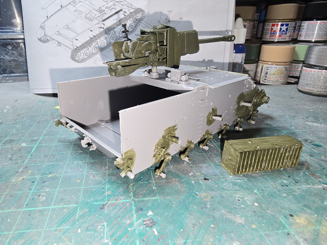

                    Thanks for the vote of confidence Digger..... :lol:

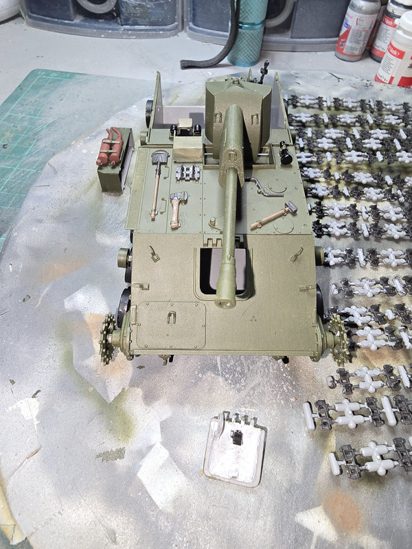

                    The gun is now more or less finished, just some fine detailing to do once its mounted on the hull - whenever that will be.
                    So we move onto the hull..... All the lower components are on, front, rear and sides. As is the way of things it seems these days it turned out I had put the rearmost upper hull plate on back to front so that had to come off, be cleaned up and turned around. Necessitating a bit more clamping - but no photos of that as I feel a big enough idiot for doing it without broadcasting it! :)
                    Work now moves onto what I assume is the engine air intake that has the exhaust muffler mounted on top. Dinner got dished up before I got onto the muffler ....
                    So this is the state of play tonight.....
                    I'm thinking as its going to be North Korean I'll go for a brush finish. Oh - and the mouting hole for the gun is too small - of course.......

                      Posts: 16010
                      I think you've tamed the kit now, but I'm sure it's going to get one more lick in.
                      :th: :th: :th:
                      Posts: 8374
                      Maybe spry the base coat then add a hand painted effect? Might struggle for coverage with the plastic being so light in colour?

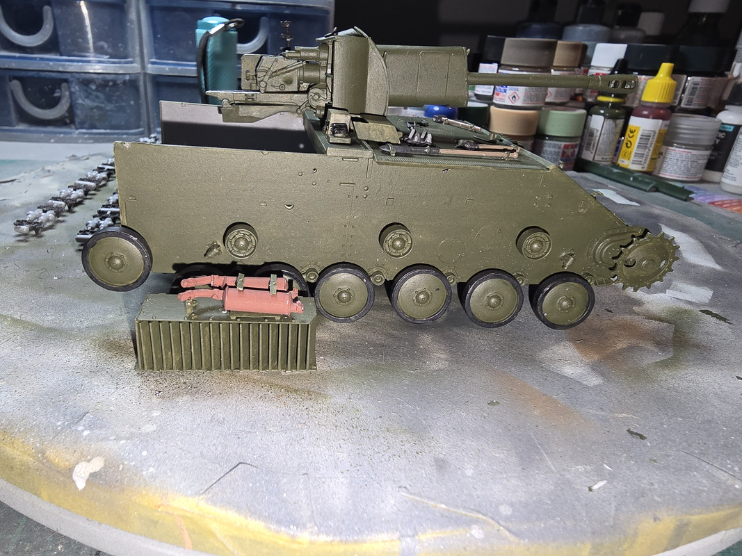

                        Post by RangerNeil »

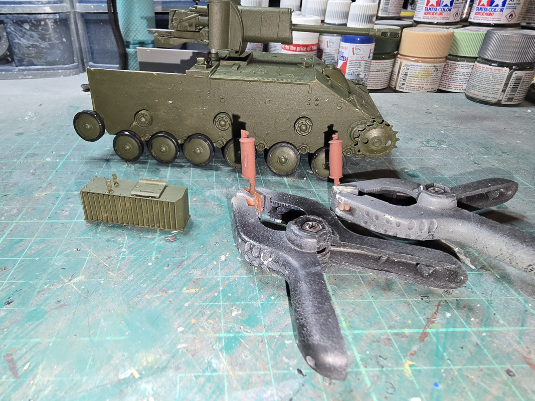

                        Hull air-brushed today and drive sprockets, road wheels, idlers and return rollers are fitted. Needless to say about half of them didn't want to go on the stub axles and had to be "persuaded" - with a pair of long nosed pliers..... Next job on the hull is the tracks and I will bet anything its going to be another "throw at wall" jobbie!!
                        Airbox/exhausts are painted and ready for assembly when dry.
                        Still need to touch-up the tyre black on the road wheels.

                          Posts: 16010
                          The wheels all look straight an level so that's a plus and I crossing my fingers that there's enough links.
                          :th: :th: :th:

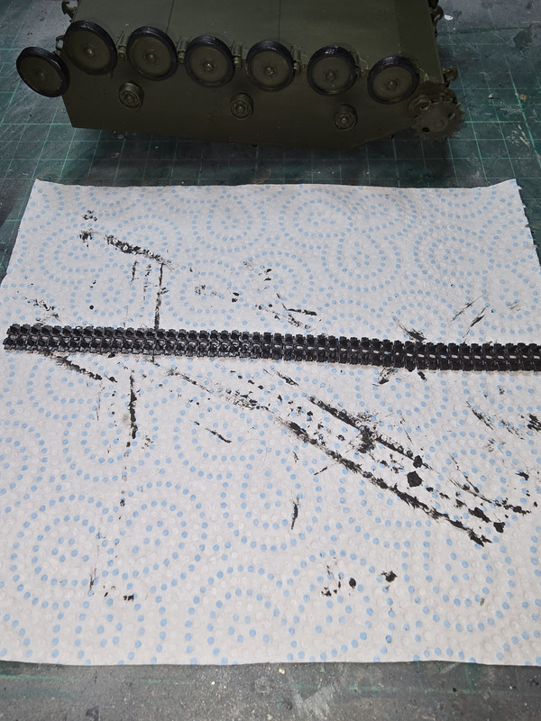

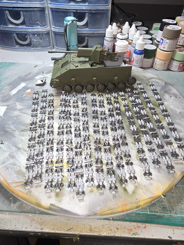

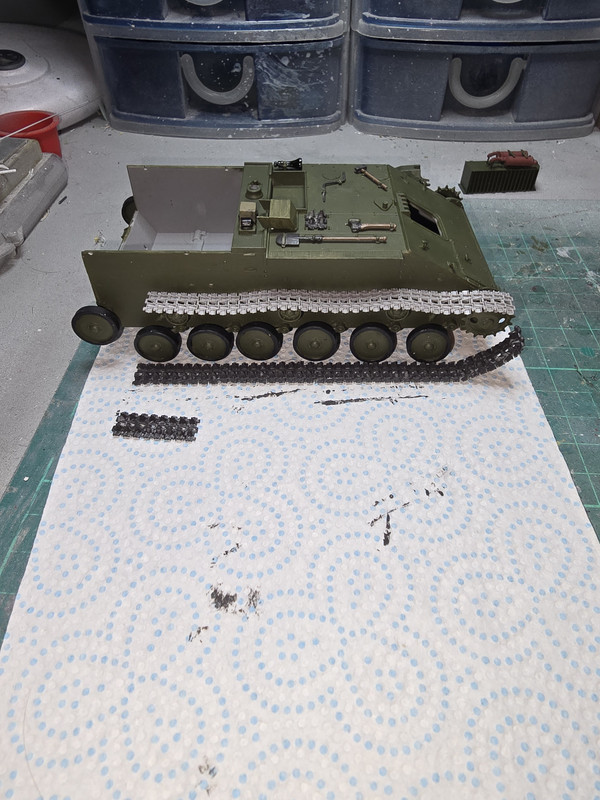

                              Stokesy44 wrote: Thu Jan 23, 2025 7:54 am I would have gone off the deep end by my now mate! Your perseverance does you great credit. Good luck with the tracks! :th:

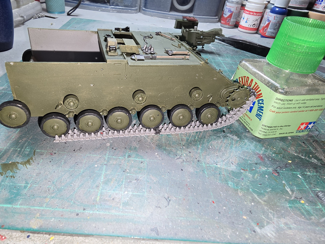

                              Made a start on them tonight. I tried using the workable links that came with it - what friggin IDIOT decided to mould them with the sprue attachments on the faces that make the joins!!!! :evil:
                              After a solid hour I had 5 pieces joined.....
                              So I had a look at the kit tracks - which had the sprue attachments where they should be - on the sides!! The same amount of time produced this:
                              Plan is to make the kit tracks in a number of sections that can be joined on the model after painting.
                                Good save on the tracks. I wonder sometimes if the buyer was even considered when kits like these were designed :cry:
                                Posts: 7051
                                If I remember right I did the tracks in four sections... bottom run, top run and the bits that run up & over the drive/idlers... I think it was ninety something links per side in total (97 comes to mind for some reason but don't bank on it).
                                Well done for sticking with it so far :cheers2:

                                RangerNeil
                                Posts: 4445
                                Location: Dagenham
                                Tomcat64 wrote: Fri Jan 24, 2025 3:45 pm If I remember right I did the tracks in four sections... bottom run, top run and the bits that run up & over the drive/idlers... I think it was ninety something links per side in total (97 comes to mind for some reason but don't bank on it).

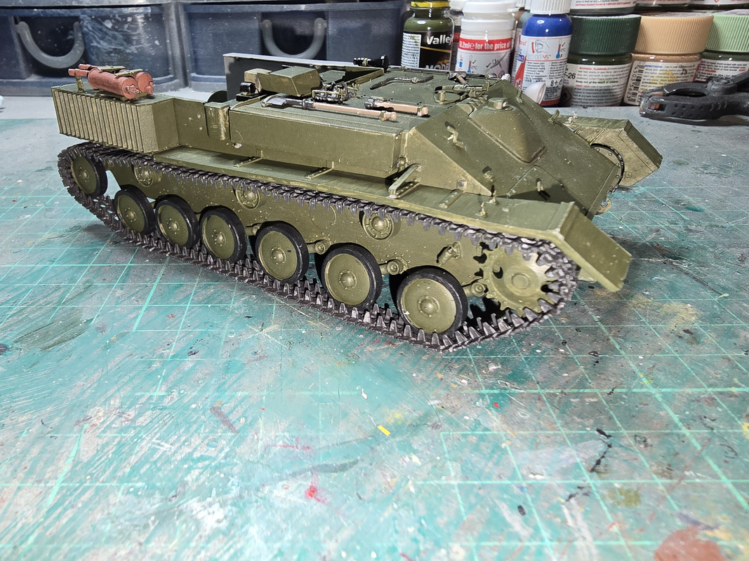

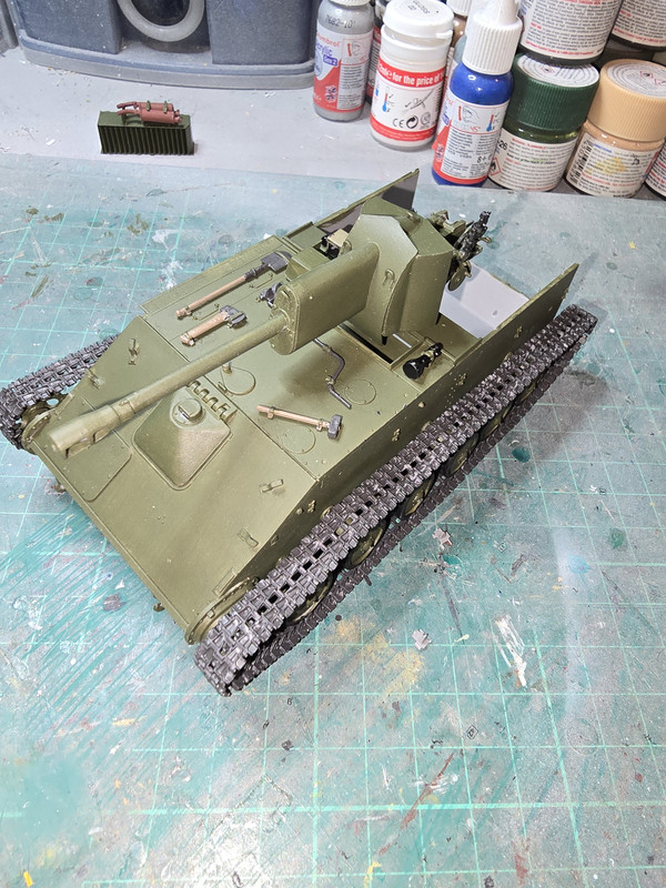

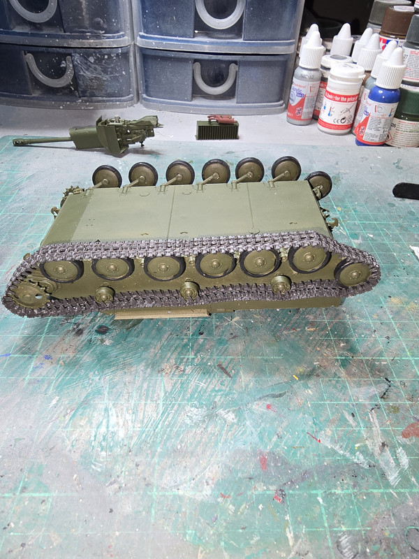

                                I cheated - did them in two sections, upper and lower joining halfway around the drive sprocket and idler wheel. I was amazed at how quickly the kit links went together - even allowing for old aged clumsiness because they are, after all, rather small!!
                                Both sides are now done......
                                They are also remarkably fragile- I had 3 or 4 snap in half as I cut them off the sprue - and this one snapped just from being pushed together.......
                                  Neil (yet another one...)

                                  I'm guessing they supplied you with enough spares so not too bad a problem. The ejector marks look deepish are they on the inside of the track and sort of hidden ?
                                  Posts: 8374
                                  Good result with the tracks. The pioneer tools look nicely done too :clap: :clap:

                                    RangerNeil
                                    Posts: 4445
                                    Location: Dagenham

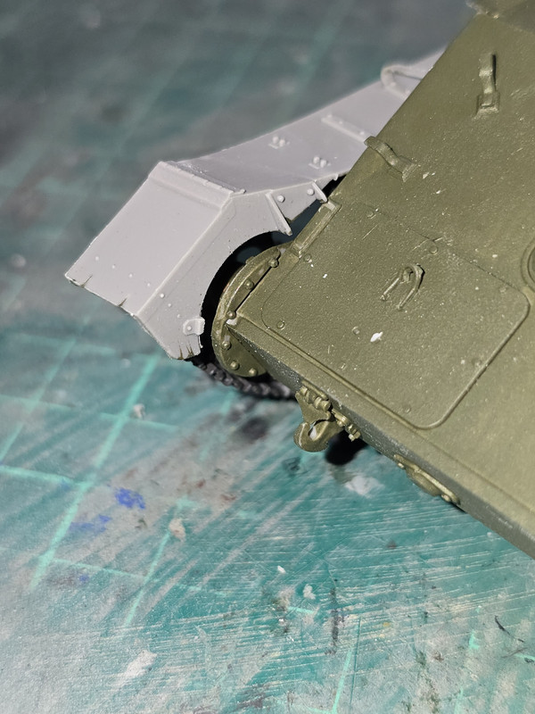

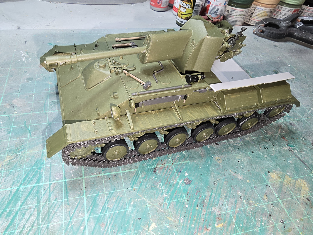

                                    The outside is now more or less finished - just needs a final coat of 4BO (which I think I'm running out of - must get some more..)
                                    Didn't realize one of the fenders was warped till it was on:
                                    CA is holding it down though.

                                      RangerNeil
                                      Posts: 4445
                                      Location: Dagenham

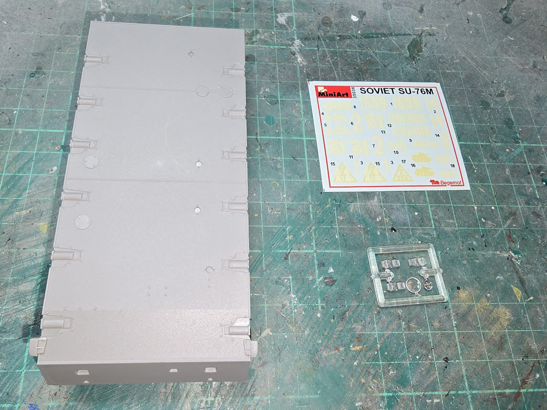

                                      digger303 wrote: Sun Jan 26, 2025 2:02 am Clamp fest is still rolling on :thumb1:
                                      :lol:

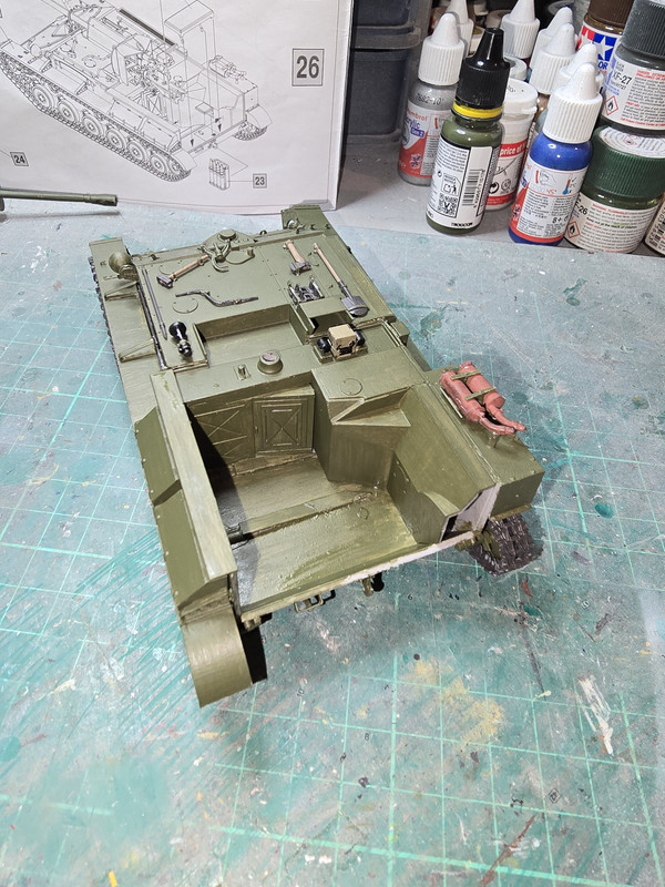

                                      Of course.... :lol:
                                      Close of play tonight:
                                      To note - the bulkhead part on the left required extensive sanding to fit being about 0.5mm too tall!!
