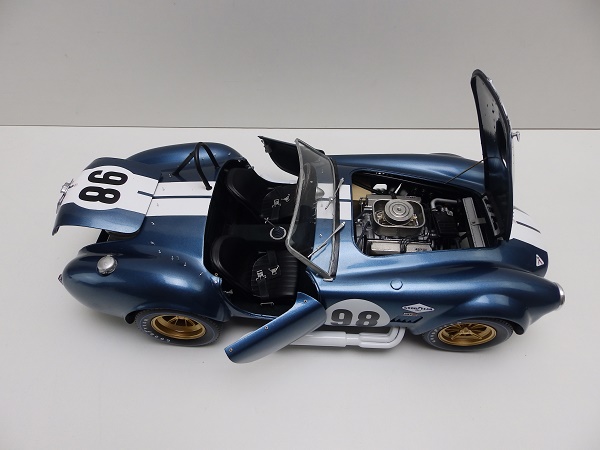

I use Iwata HP-C +'s one each for acrylic and oil based paints for general use and have a micron plus for finer work. Most of the oil based paints I use are Zero paints which come ready thinned so I have never had a problem spraying these paints. I also agree about super cleaning your airbrush to prevent clogging especially if your using acylics, My micron can be very touchy if not cleaned properly so clean it and clean it again you will be ammazed how much more gunk can appear.
I also agree with Kev about correctly thining your paint as this is the major cause of spitting and blockages. The main trouble is that each paint from each manufacturer needs thinning in a different way as each one needs either more or less thinner to get a good result every time. It may be best ti stick to one paint like Vallejo for instance until you get well used to thinning your paints.
Bent needles are a pain and I have had a few but the 'SharpenAir' tool I recently Purchased has given excellent results and saved a couple of spray sessions for me, link below-
https://sharpenair.com/
Picture of my Zero painted 1/12 MFH Cobra below.
Andy
