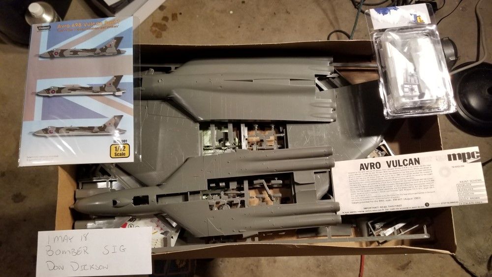

I have no connection to the plane per se, but this is my favorite non U.S. bomber. Also, i built this back in the 80s, so doing it again with after market stuff and more knowledge should be fun.
Speaking of after market, I have Wolfpack decals and will do a plane that was retired the year I graduated high school, 1982. Also from Wolfpack is the seamless intake set, which will make a HUGE difference. I may get the SAC metal landing gear set, not sure yet.

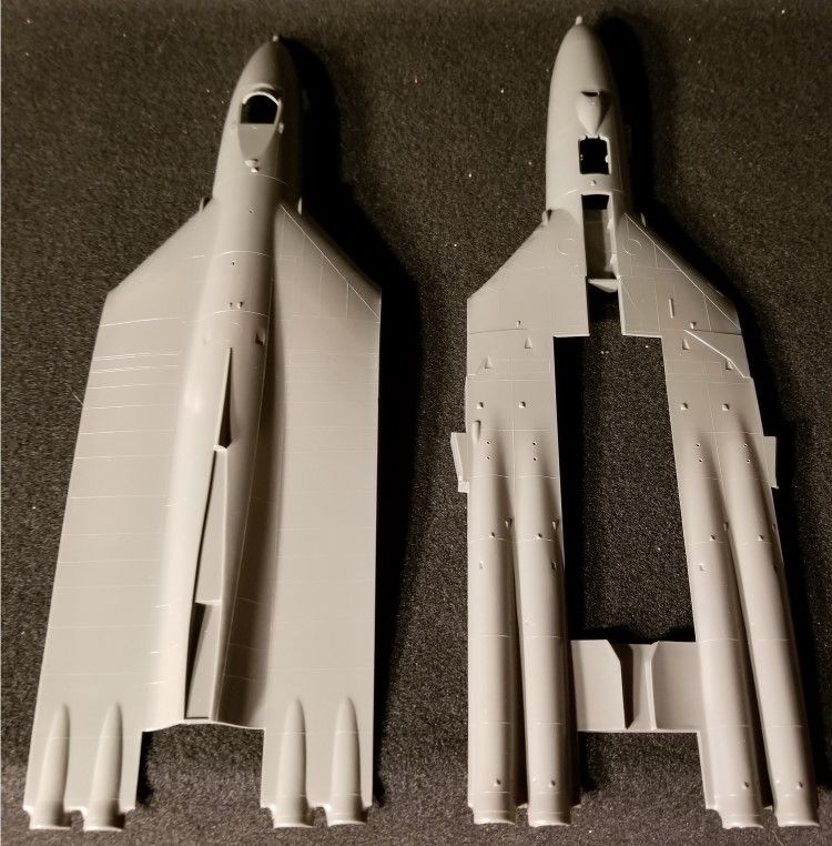

So I just did a little bit of clean up on parts and the like. And started painting the pilots. There is very little detail in the cockpit because you cant see squat. But, I think you will be able to see the pilots a bit in the side windows. So they will be painted.
And I made the requisite blood sacrifice to the model Gods...

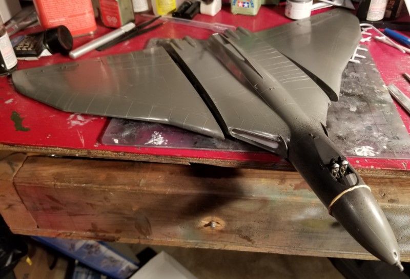

OK, so some progress has been made. The next few pics are from two nights ago.
Yes, that is the cockpit. But then, you are not going to see anything, so it would be a waste of detail. I know I didnt do a superb job on the pilots, but as I said, you will barely be able to see them.

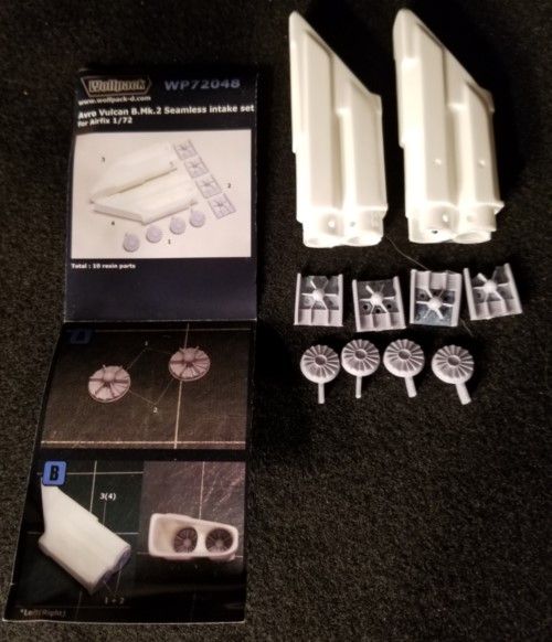

The replacement intakes. MUCH better than the kit items.

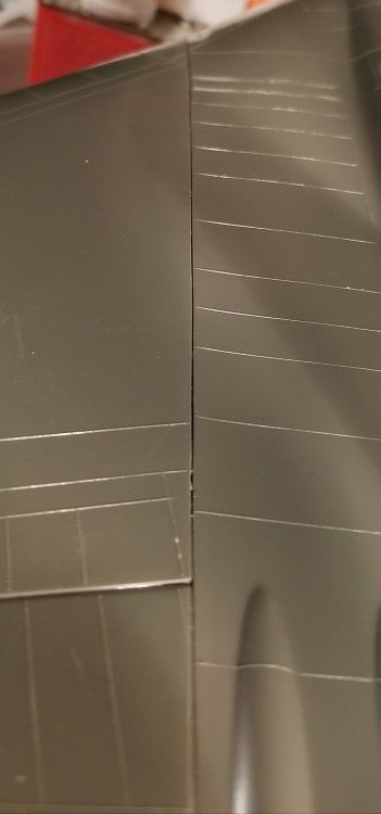

So on to the pics from last night. All major parts together. These are the seams. Perfect Plastic Putty party! Woohoo!
Well, you get the idea. I have got most of the seams filled. Just gotta work on that area around all the exhausts. Speaking of the exhausts....
They are just holes. Nothing there at all. Gotta figure out what to do with that. yay.

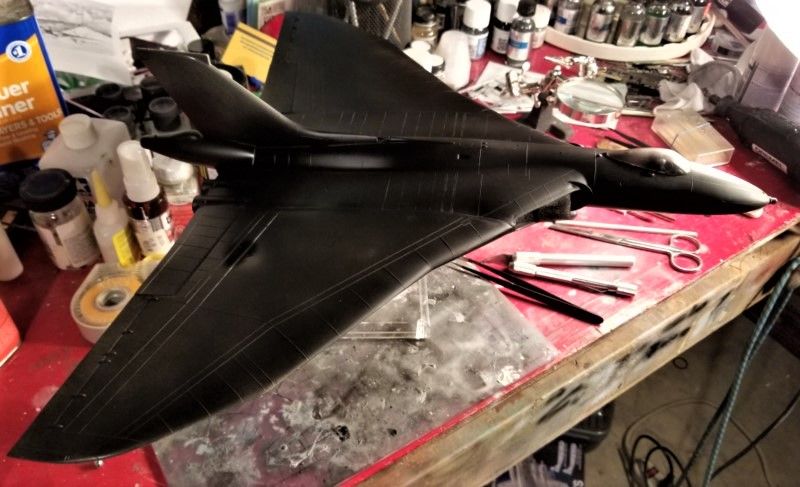

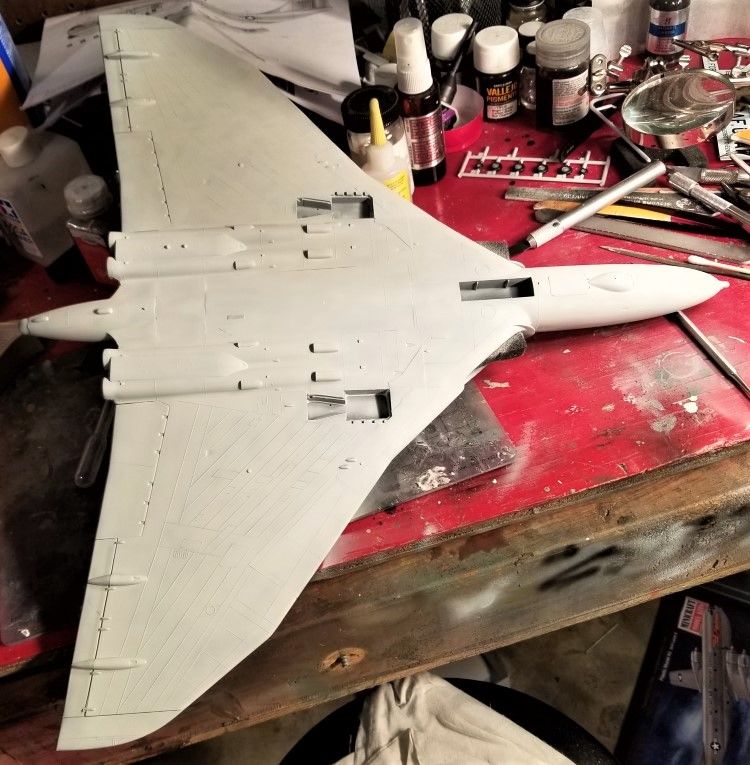

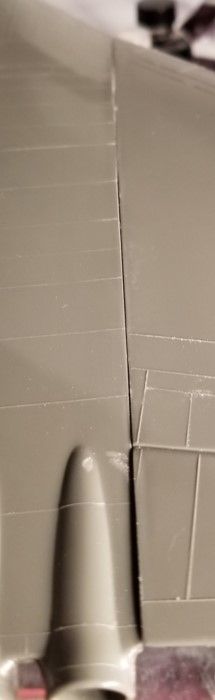

OK, got the puttying done. Shot some primer to check everything. The wing joins definitely need a bit more work. But its fairly close.
Posts: 5595
Re: #37 Smokeriderdons 1/72 Vulcan
This build is moving at some speed :th: shame about the fit issues which you're well on top of :th:

Posts: 18019
That thing looks menacing in black primer :twisted:

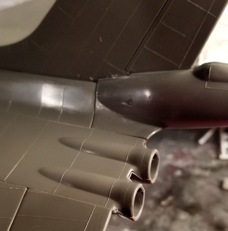

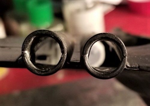

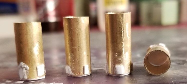

So, this is what the exhausts look like:
It was suggested to me on a FB page to get some brass tubing to make the internal part and cap it off. This would at least make it look closer to real. An excellent suggestion! So I stopped at the train hobby shop (no model shop, but this place is very cool and has plenty of stuff I can use) and grabbed the appropriately sized tubing and made these:
not overly impressive or complicated, but once painted black and inserted, they are a vast improvement in my mind.

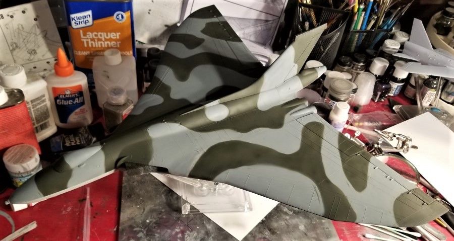

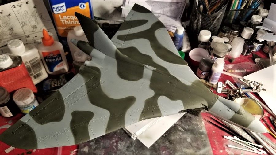

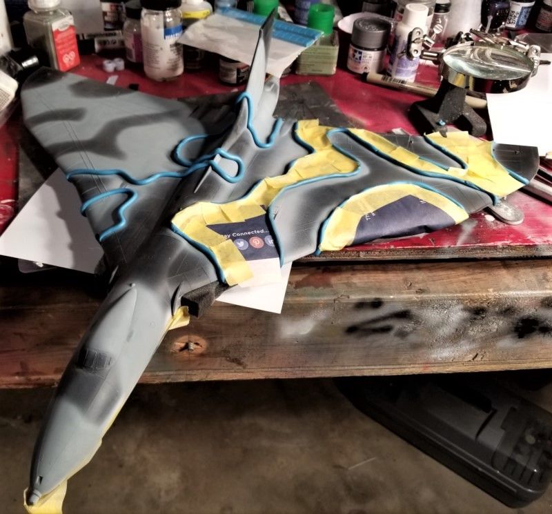

So more painting done. I started the topside camo. Every pic I have seen of the Vulcans show rather crisp lines between the colors. And as this is going to be an aircraft that was flown to retirement and kept whole, I am quite sure the paint was pretty clean and crisp. So, not want ting to mask something this size twice, and not wanting to simply cover the entire top in gray the mask the green, I came up with this:
using colored pencils, I drew the pattern on and marked the areas that are gray. This way I could freehand this part and not lose track of what is what. I have never done this British camo scheme, so its not like when I do an SEA and barely have to look at a pic. I sprayed the areas a little wide to give me room to mask and overlap the green. And here it is with the gray sprayed on. The black will become green:

What I have done on the Vulcan. Started masking. There is a LOT of territory to do here. I am going with blue tack and tape and newspaper. This should give me a good delineation without marking up the paint trying to use a blade to cut laid down tape. I got this far and then set it aside to watch the rest of the CAPS kicking butt last night. Going for the Stanley Cup baby!!!!!!!!

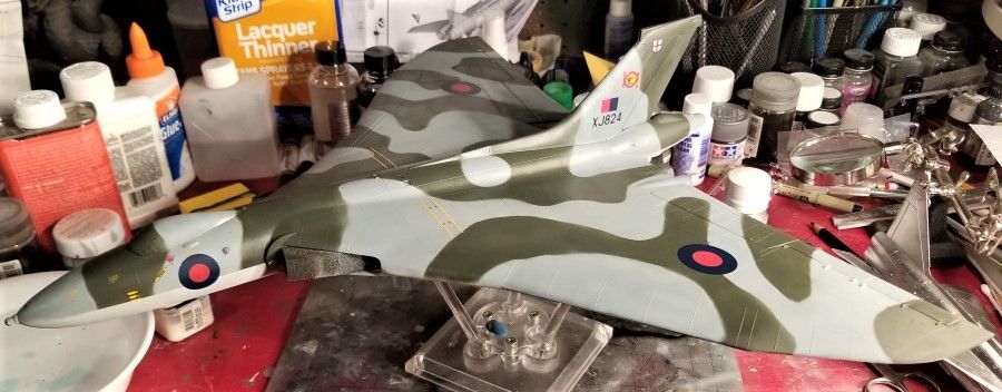

OK, so two updates close together. LOL Got her all masked and the green sprayed:
And this is the result. Drum roll....well, it doesnt work so well when you can clearly see the pic. LOL:
I absolutely LOVE how it turned out! Yes, I have to do some touch up stuff, but I think it looks great. Especially considering this is the first time I have ever done the British gray/green camo.

I got the touch ups done and some gloss on and decals started. Also, the English Lightning I am doing for the CW build. Same scale. Provides idea of how big the Vulcan was. And how big the model is!!! LOL
Looking the business! Adding some decals always brings a model to life. :th: :th:
ElCapitan
Posts: 1725
Location: Glasgow
Post by ElCapitan »
Looks awesome! Fantastic work on the camo :th:
ElCapitan
Quax
Posts: 1262
Location: Andover, Hampshire
Post by Quax »
looks fantastic and a great job on the cammo. I think adding the Lightning shows just how big the Lightning was! :crazy:

Great job with the camo !! ANd the filling ! Just read for the first time all you posts. I love that bomber too. It's quite huge !

The decals always make the plane.
Great job,do I sound like a Mr Trump?

great job... and nearly finished !

Quickie update. All the decals are on the top side with a coat of dull over them. I may spray a bit more, but a little gloss seems to be what the real things had. At least from the pics I have seen. And I have to say, these decals are AWESOME! They are on par with Cartograf. Props to Wolfpack!

Woah! That paint job looks superb. I think you are spot on with a bit of a sheen on the finish.

That really does look the business - very nice work! :clap:

Very nice indeed. :thumb2: :thumb2: :thumb2:
