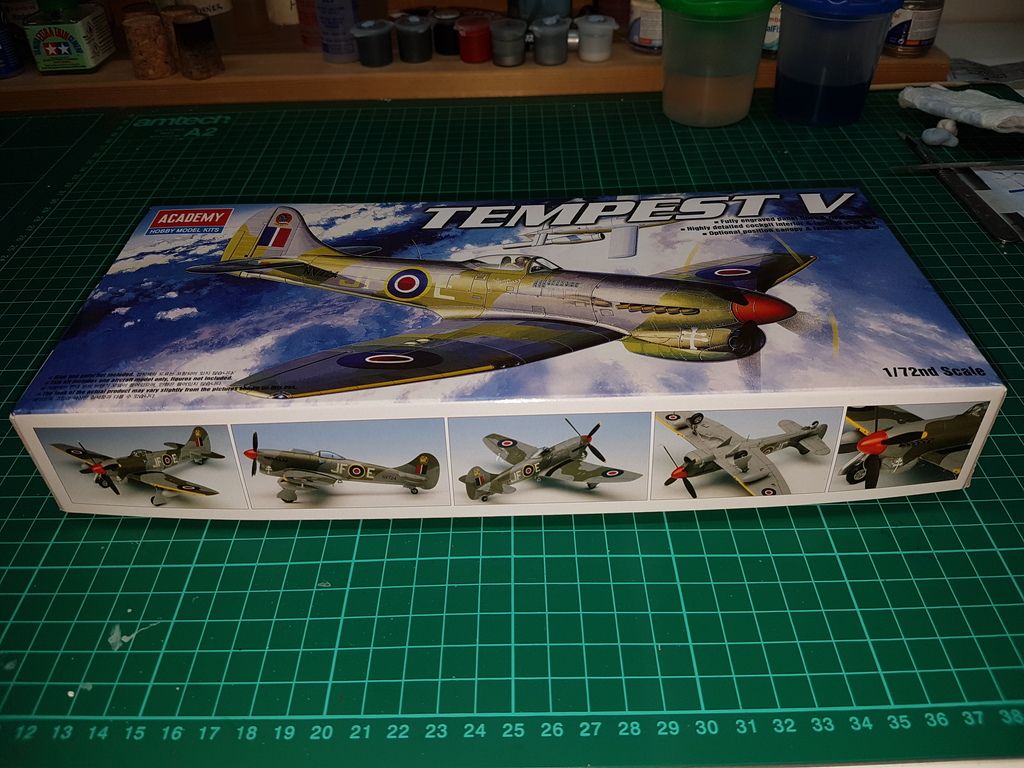

Nice Box Art

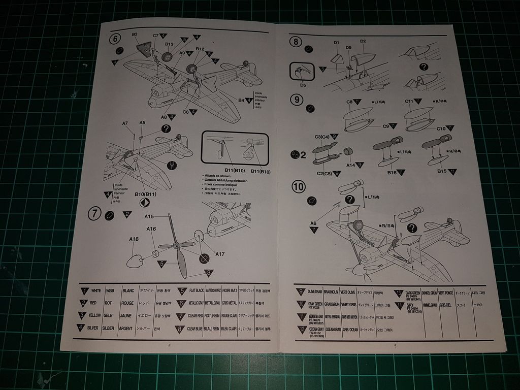

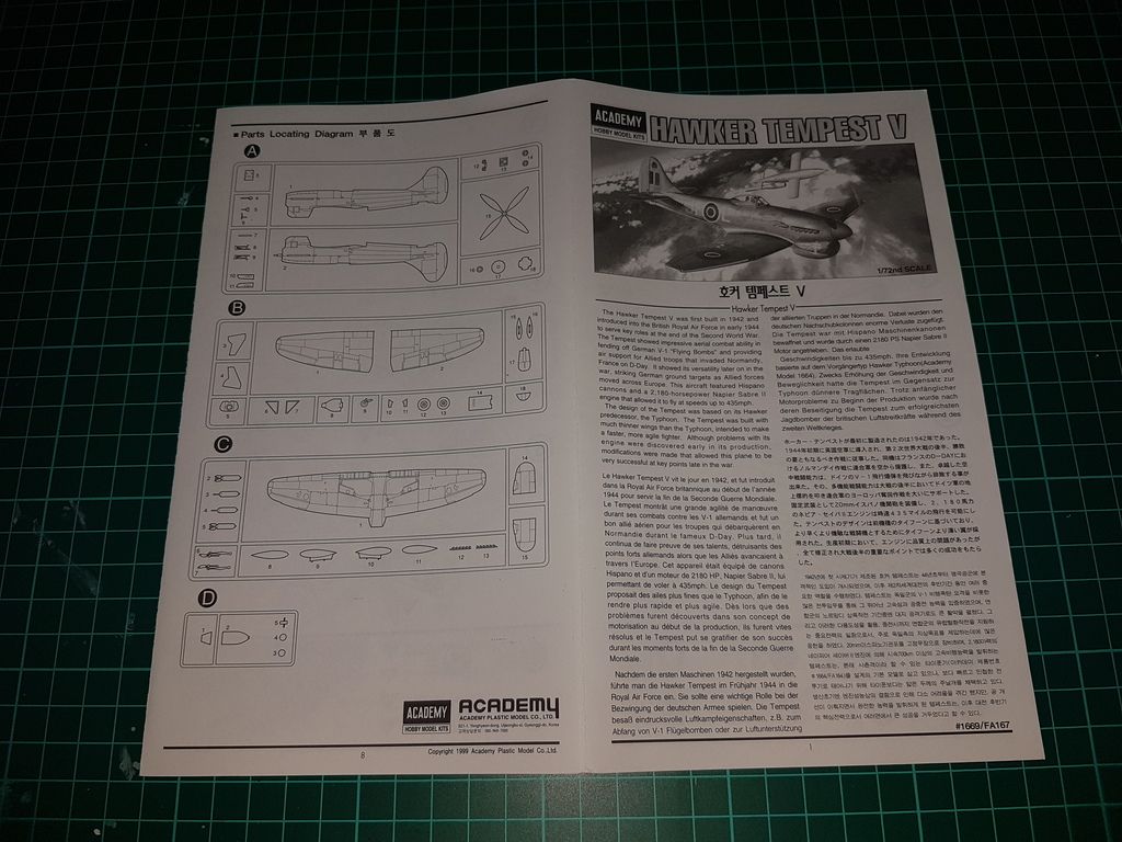

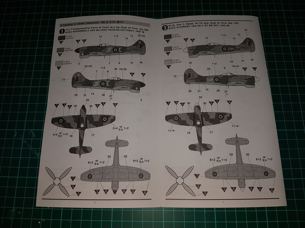

The Instruction Sheet
The Decal Sheet

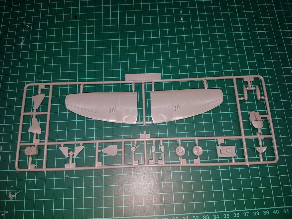

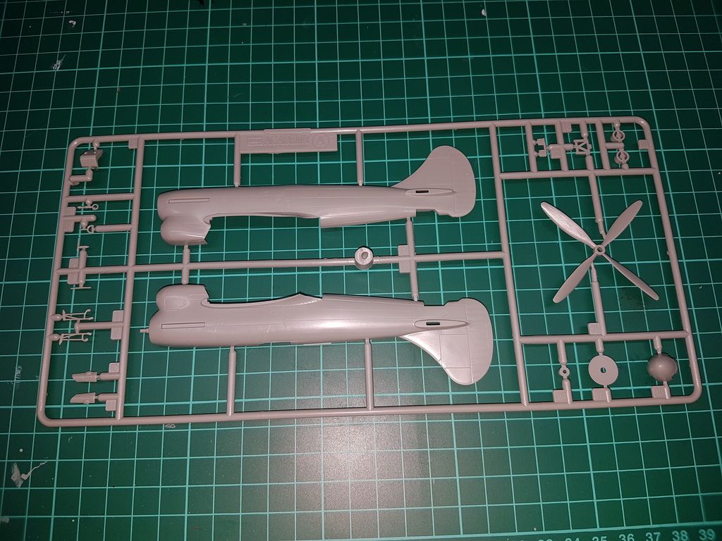

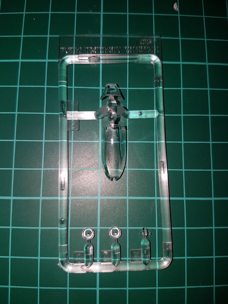

The Sprue's
Ok let's start with Washing the sprue.

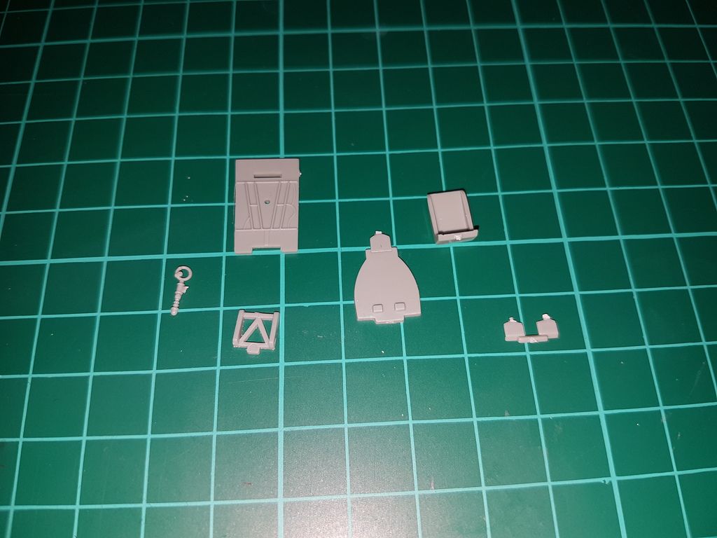

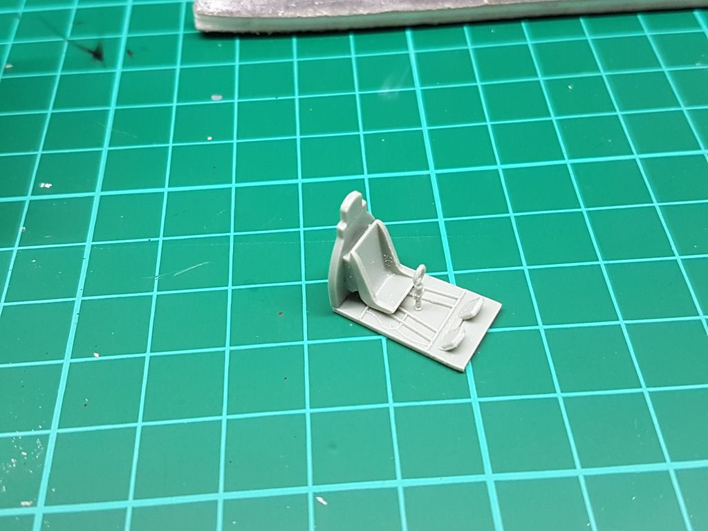

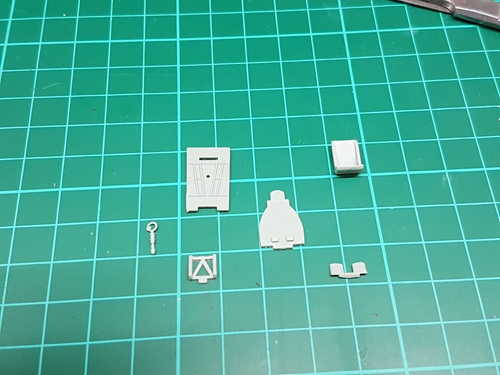

Nice plastic well manufactured kit. I want to give this Aircraft a just off the factory line feel to it if I can.
Small clean up of parts
Used Tamyia Extra Thin to put the Cockpit together

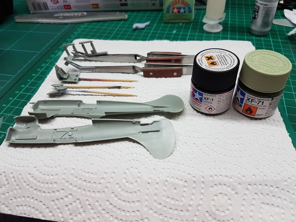

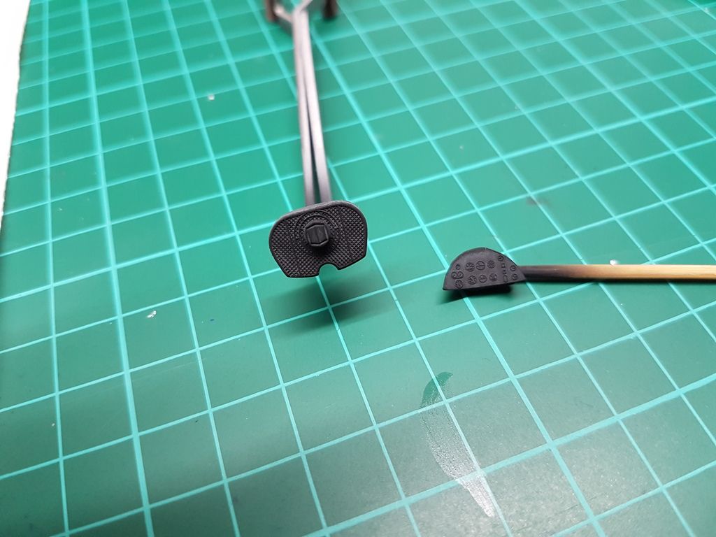

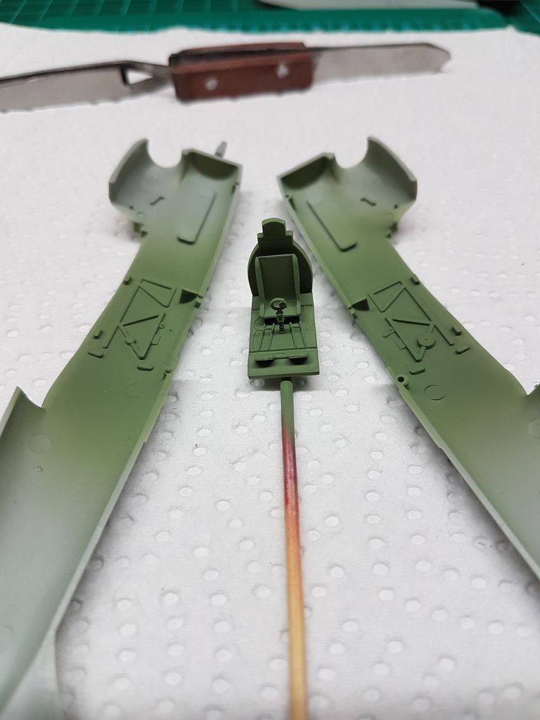

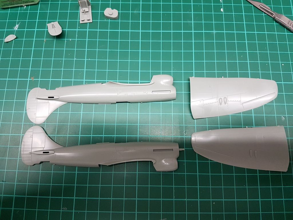

Removed both halves of the fuselage from the sprue along with some other parts for painting.
Used Tamiya XF-71 (Cockpit Green) To paint the cockpit & both halves, applied by airbrush
Airbrushed the radiator & control panel with Tamiya XF-1 (Flat Black)

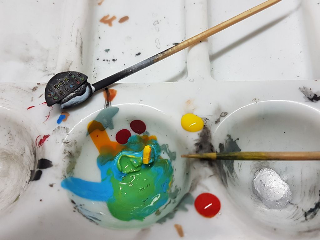

I dry brushed Tamiya X-11 (Chrome Sliver) Over the control panel to bring out to detail of the dials.
Thought I took a photo of that stage but I didn't, Then what I did was take some bright colours Vallejo Air Red,Yellow,Blue & Orange.
Used a toothpick to add some colour where I thought it just looked cool.

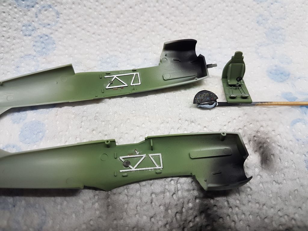

Painted the air-frame & added some detail to it. Dry brushed the cockpit & painted the control stick & the side lever

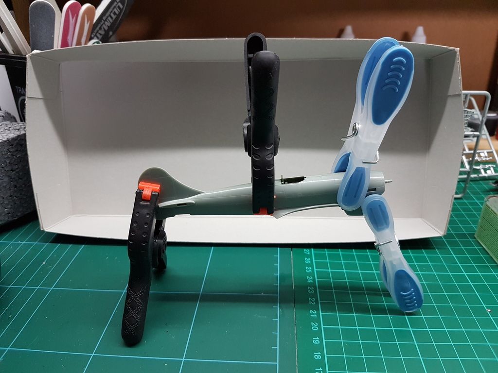

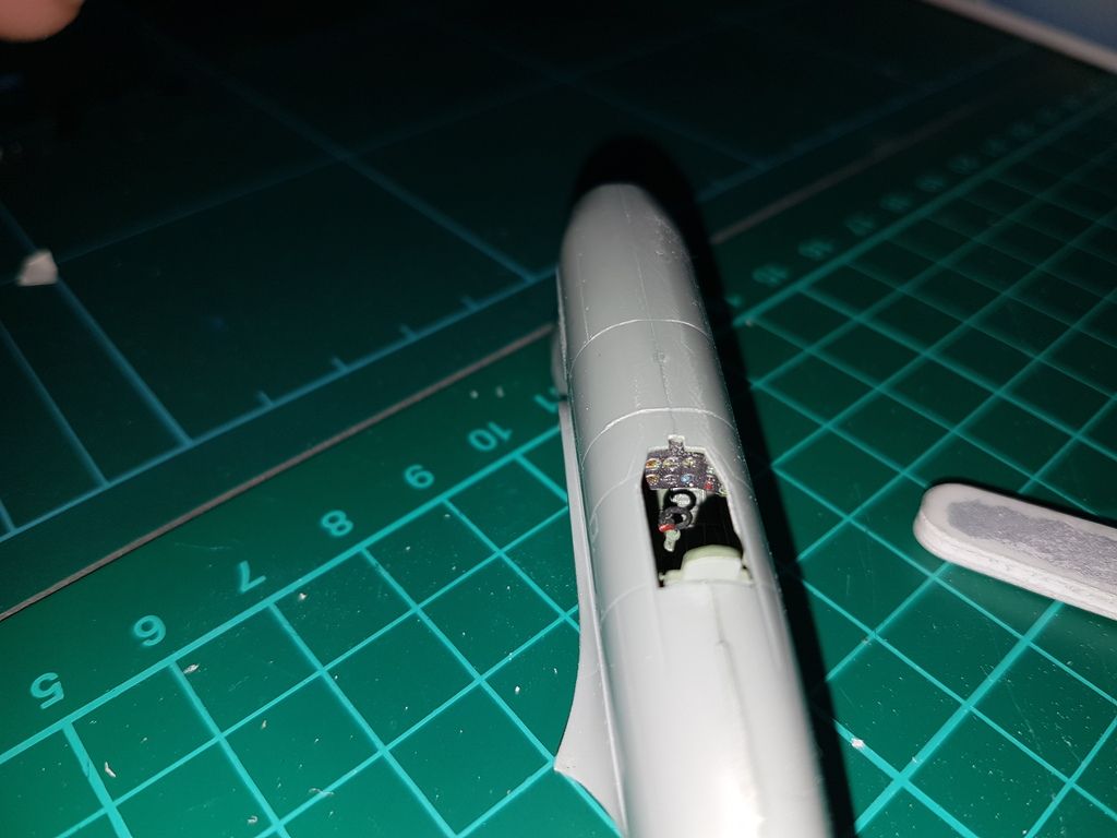

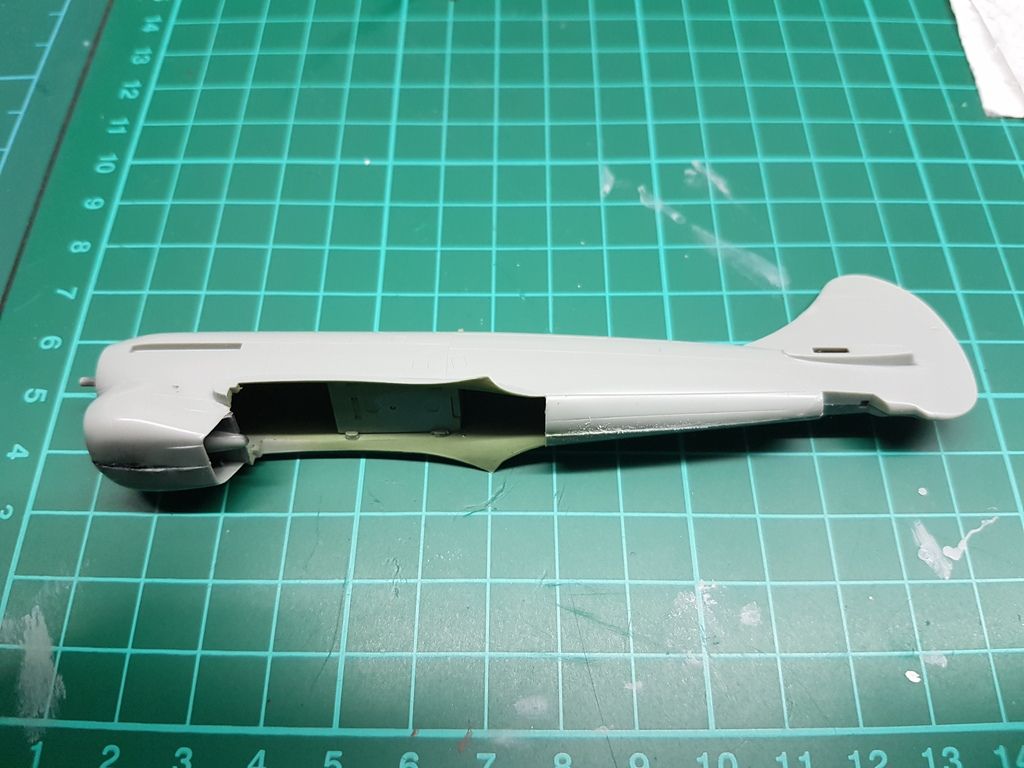

Glued the fuselage together with Tamiya Extra Thin

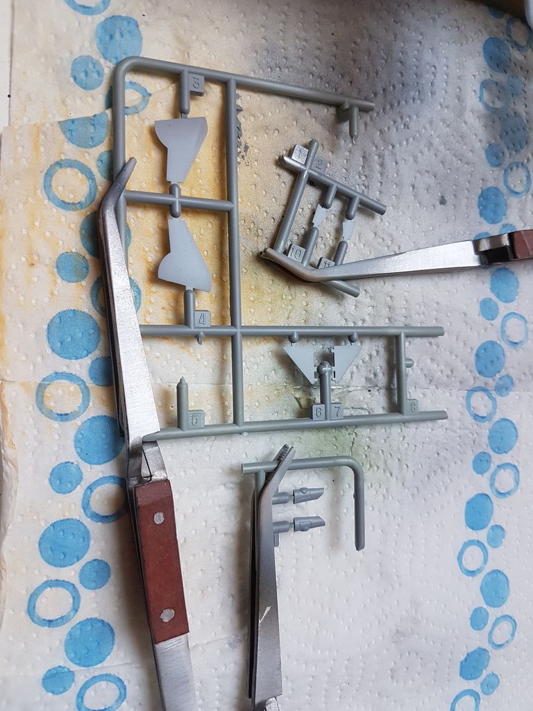

Airbrushed Vallejo Model Air (Steel 71.065) on to the landing gear & the wheel bays & inside the doors.
I just sprayed the parts on the sprue

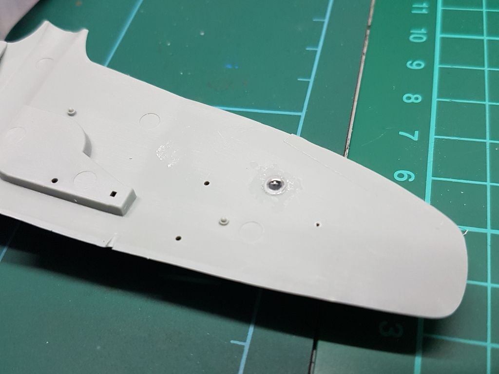

Post by Muzrik »
Put the wings together and placed the clear parts under side of each wing.

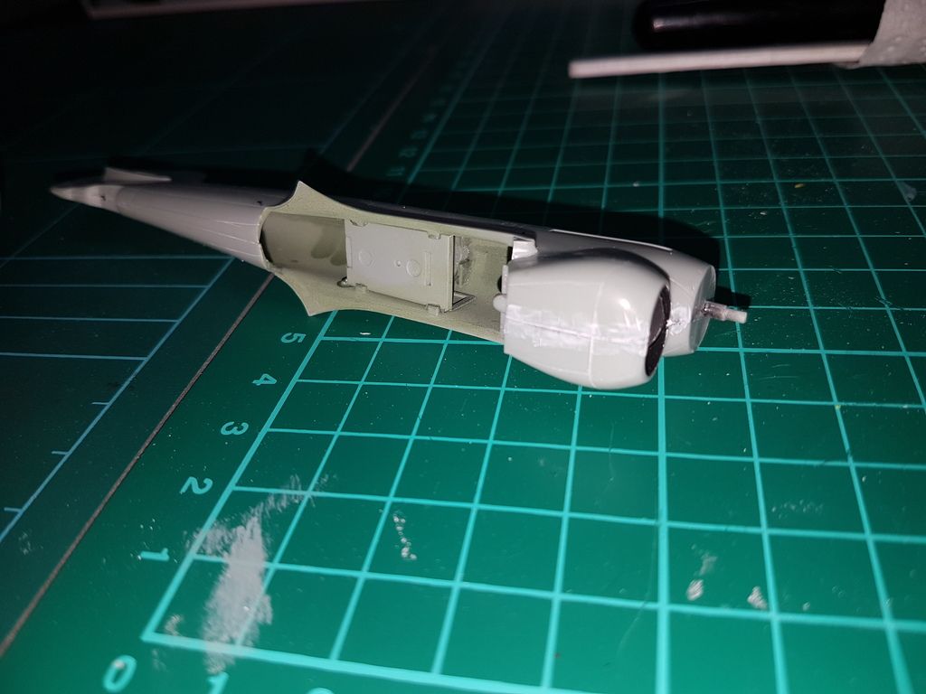

Post by Muzrik »

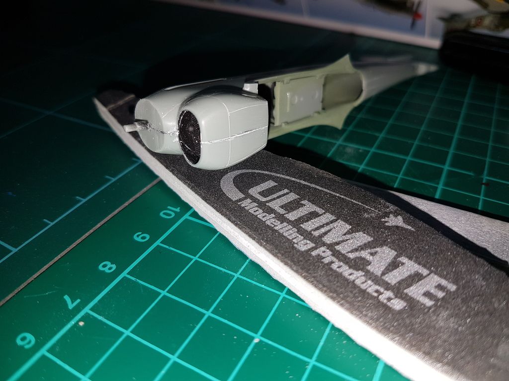

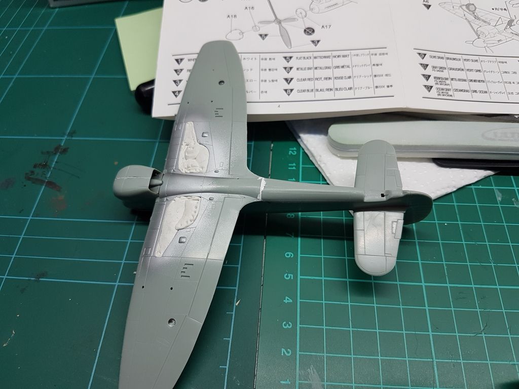

Seam lines on the fuselage needed to be filled in in parts and sanded smooth. I used Tamiya Putty to fill the gaps and used my Ultimate Sanders
Used my Tamiya Scriber II to put back some panel lines

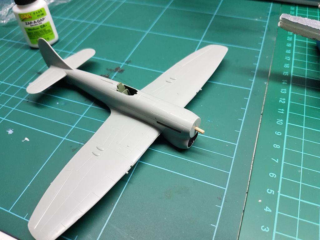

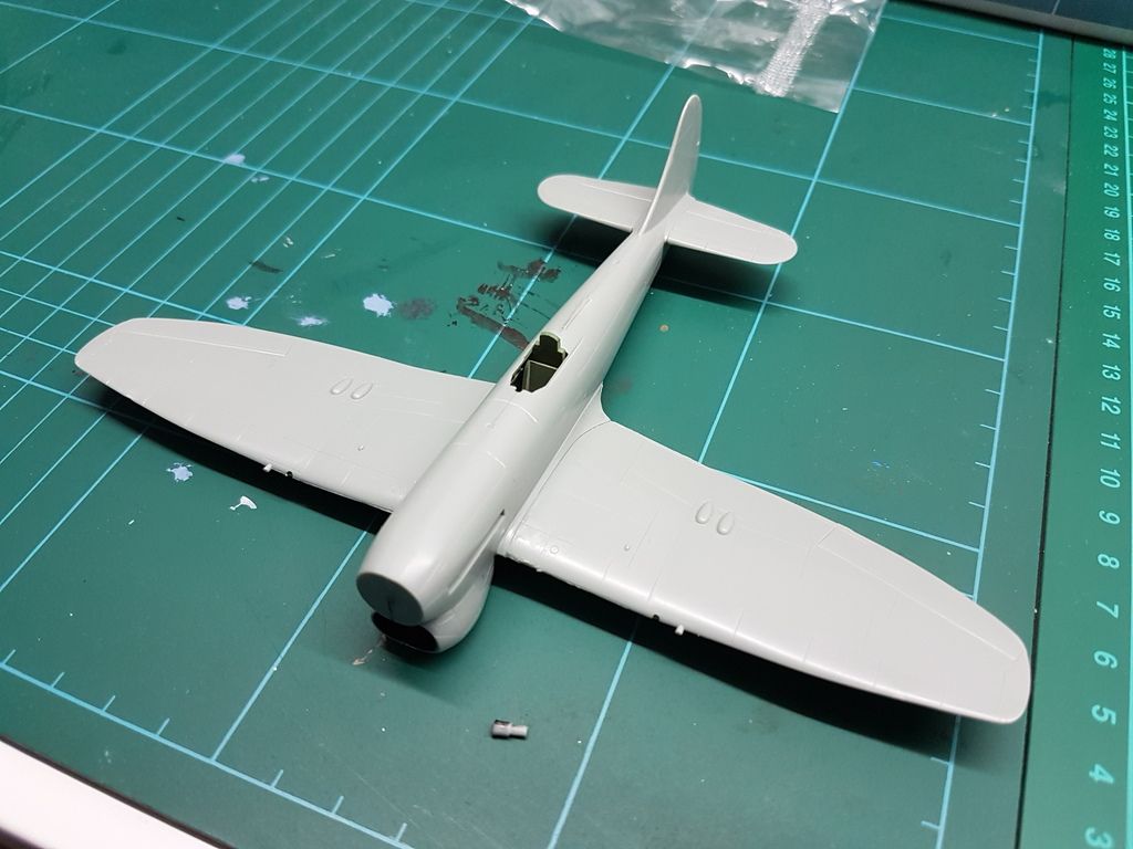

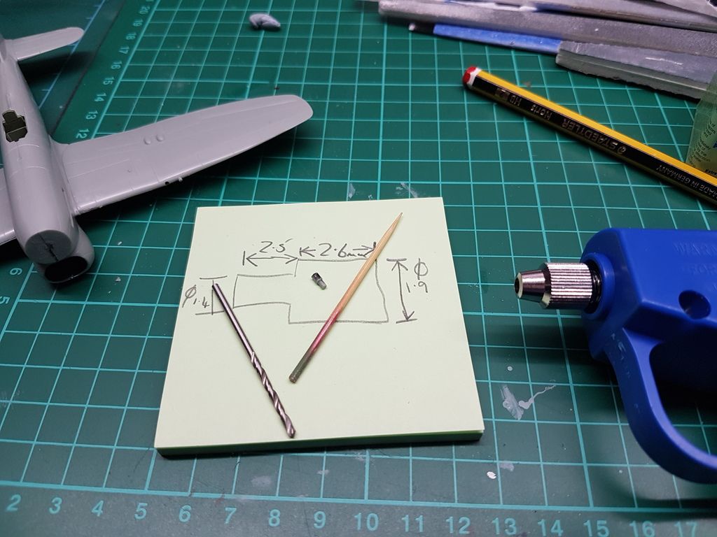

While putting the wings on I broke this off :wall:

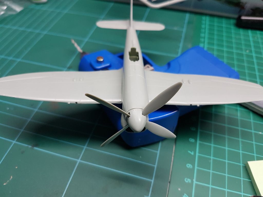

Post by Muzrik »
I measured the broken part with a Digital Caliper & found a toothpick has the same diameter hopefully came up with a useful fix
Had to drill a hole for the toothpick to fit. the toothpick bottom out I think by hitting the back of the control panel so I used CA glue to hold it in place.
I think it looks OK.

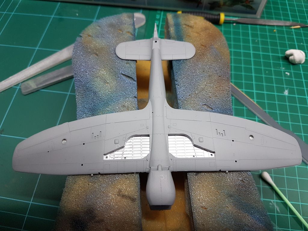

Post by Muzrik »

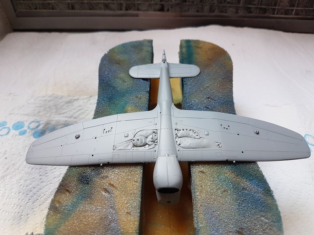

Had a small gap to fill a sand, I just followed the same steps I used with the fuselage seam line.
Used White Tack to mask off the wheel bays. Used Humbrol Maskol on Both clear parts on the wings

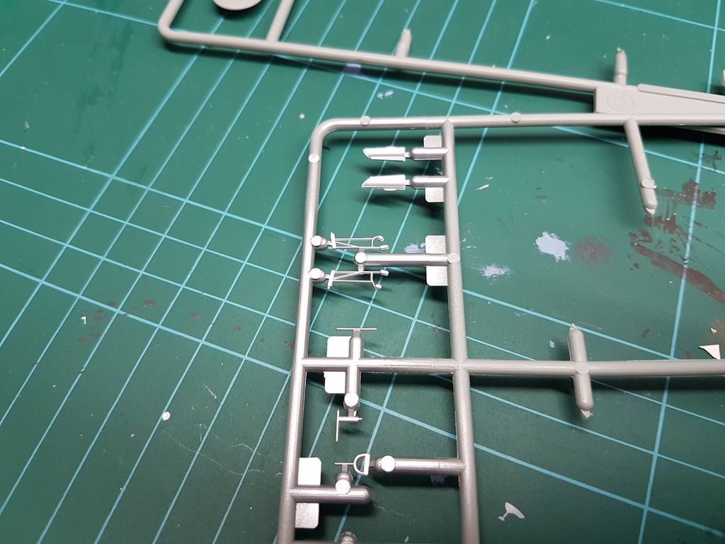

Post by Muzrik »

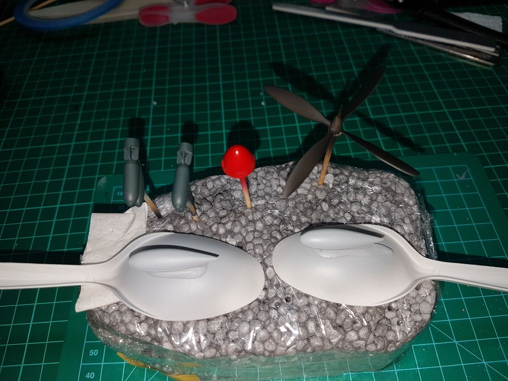

Airbrushed the underside colour.
Painted some parts on the sprue
Removed white tack & the maskol
I don't know why I made the choice to not use a Primer coat :bash: Hope I don't run into to many issues

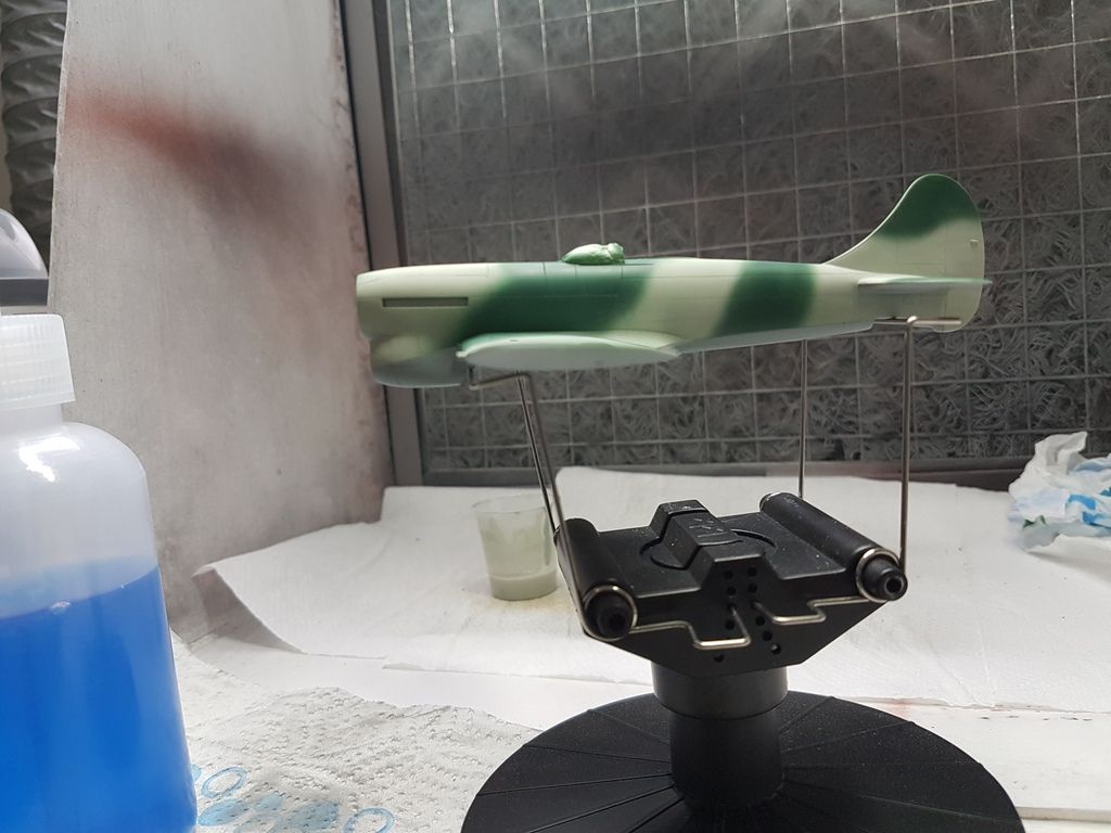

Post by Muzrik »

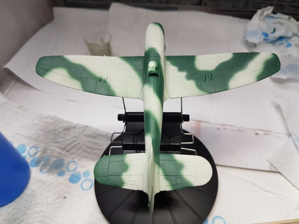

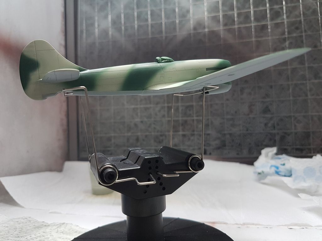

The callout sheet asked for Federal Standard colours, I found a conversion chart to Tamiya & this is what I used.
36270 Medium Grey -- XF-12 J.N Grey
36152 Grey -- XF-66 Light Grey
34079 Army Forest Green -- XF-11 J.N Green
I airbrushed the XF-12 first.
I was also wanted to try a soft line camo. I didn't mask off anything for the second colour
I think it turned out ok

Nice recovery on the shaft, flying right along! Looking great so far.
