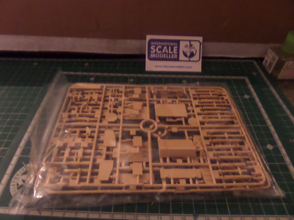

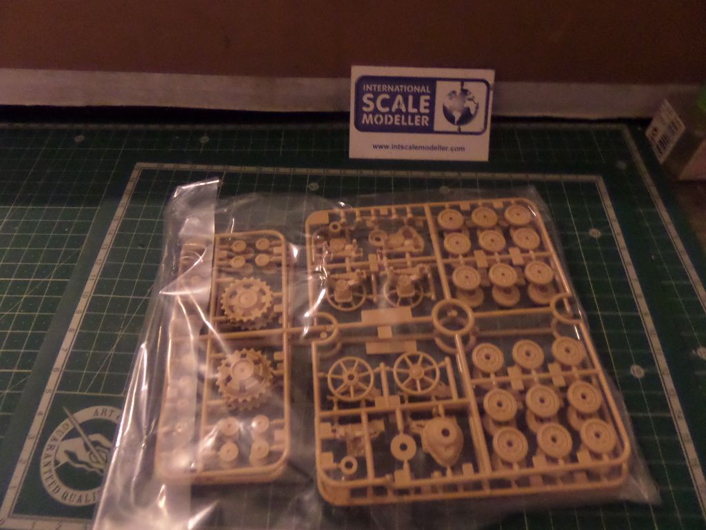

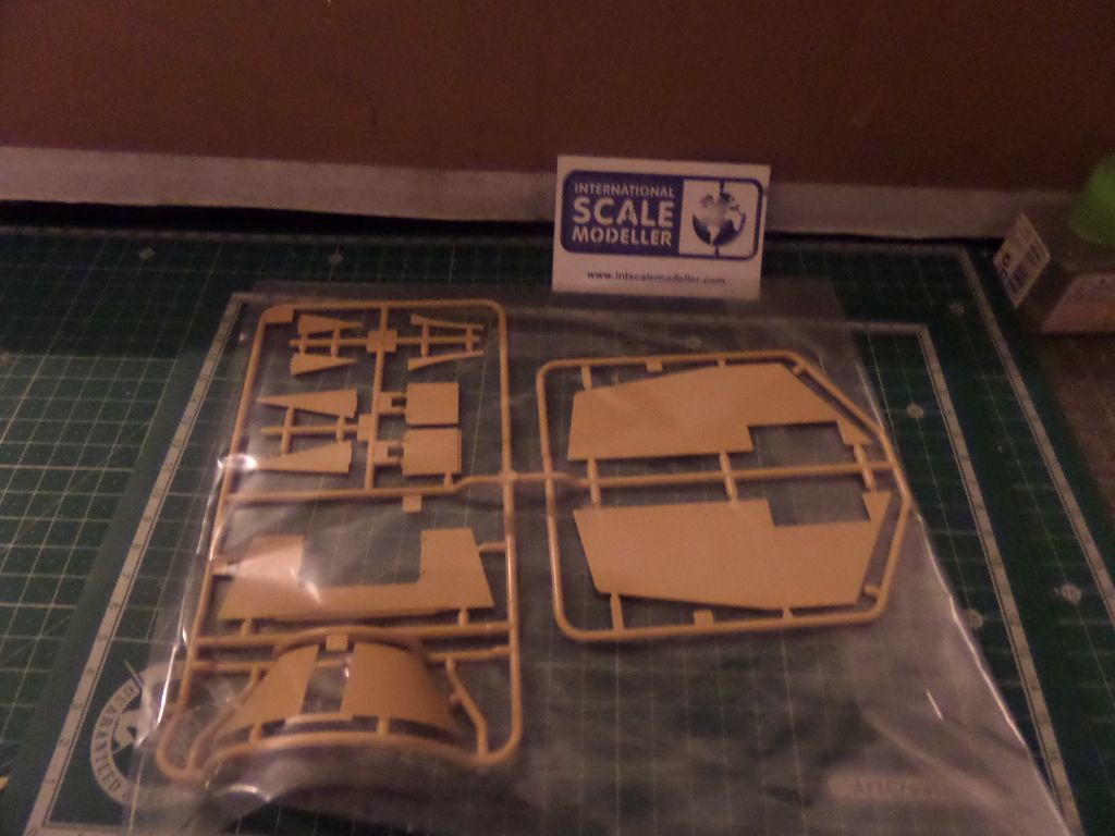

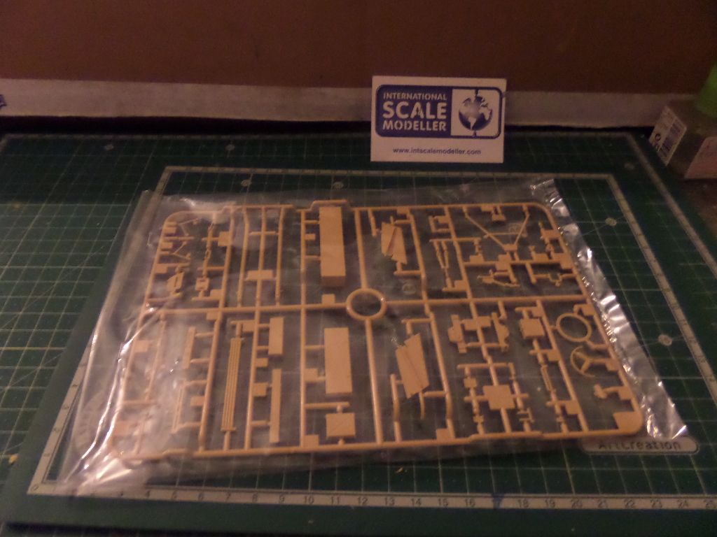

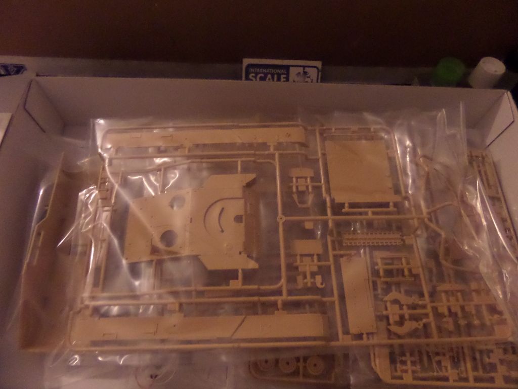

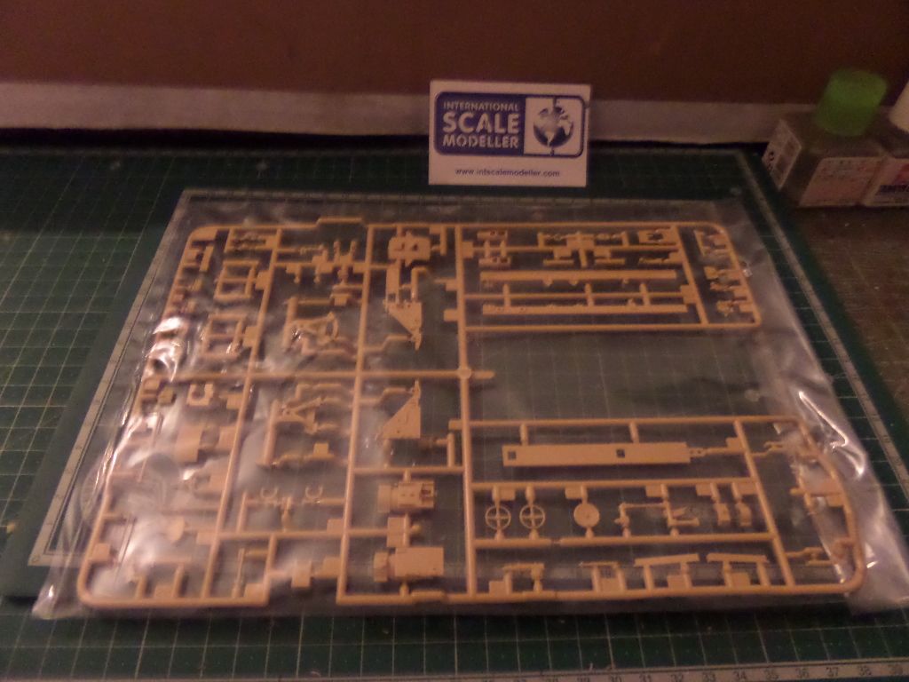

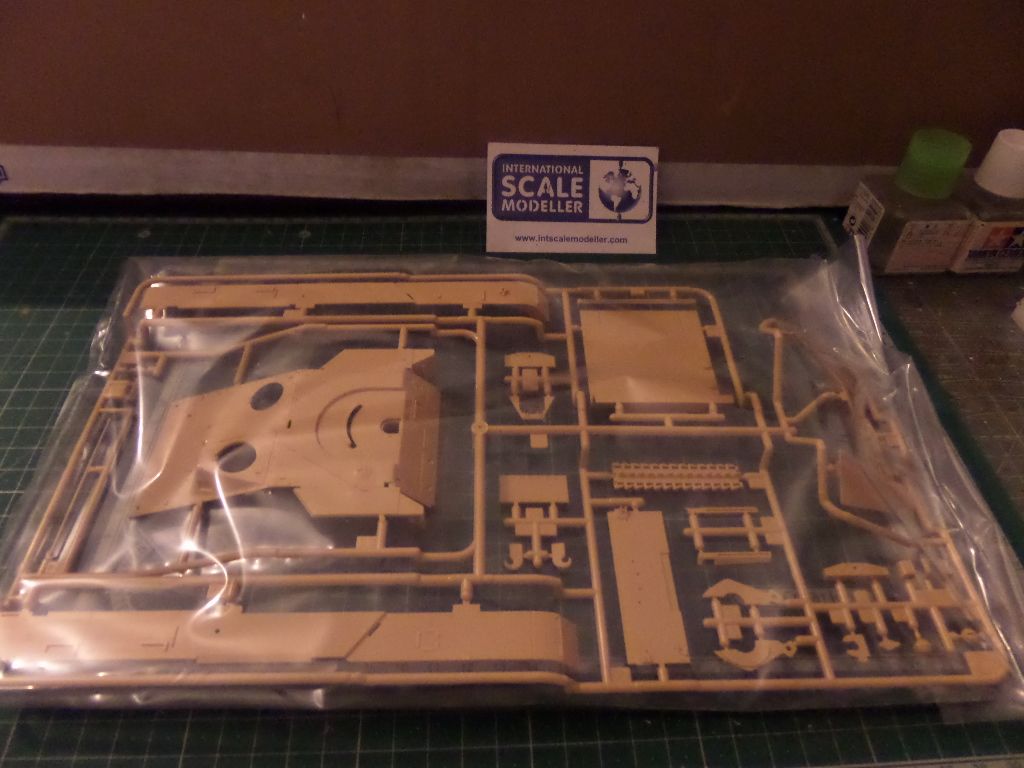

The usual photos of the box and sprues

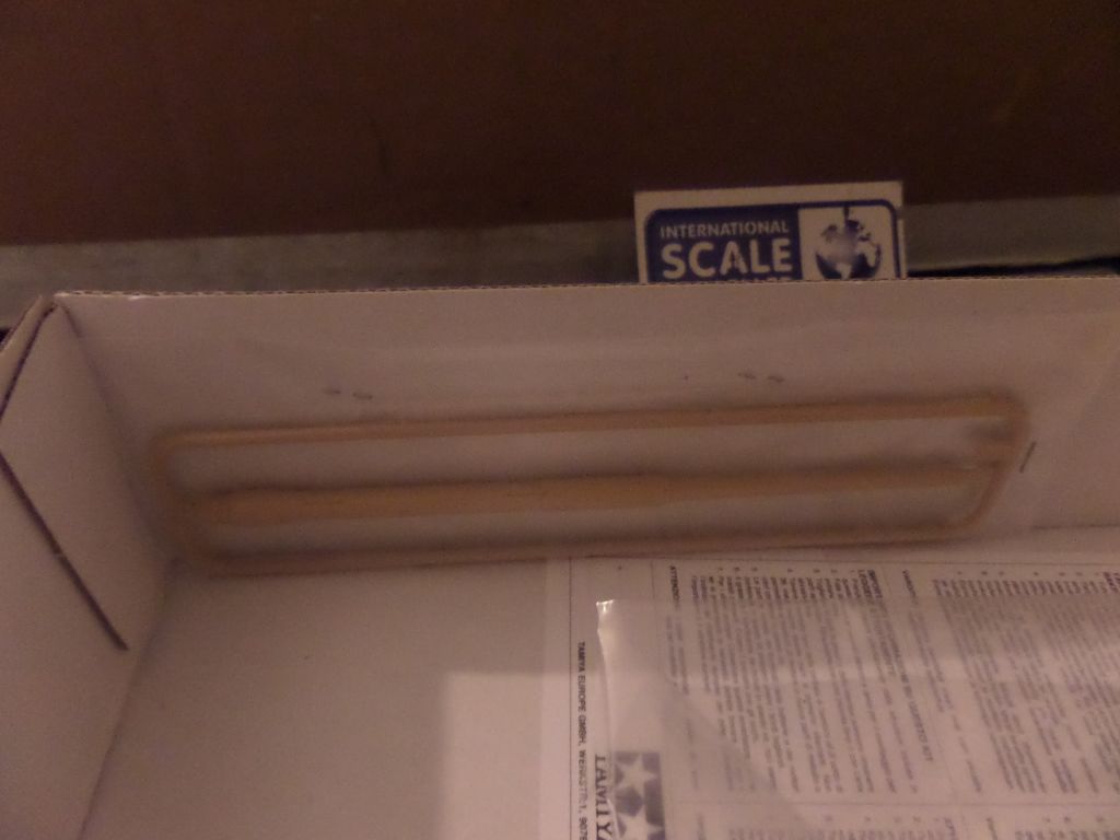

The gun barrel is glues on the box cover , so carefull not to loose it or miss it :lol:
The crew !

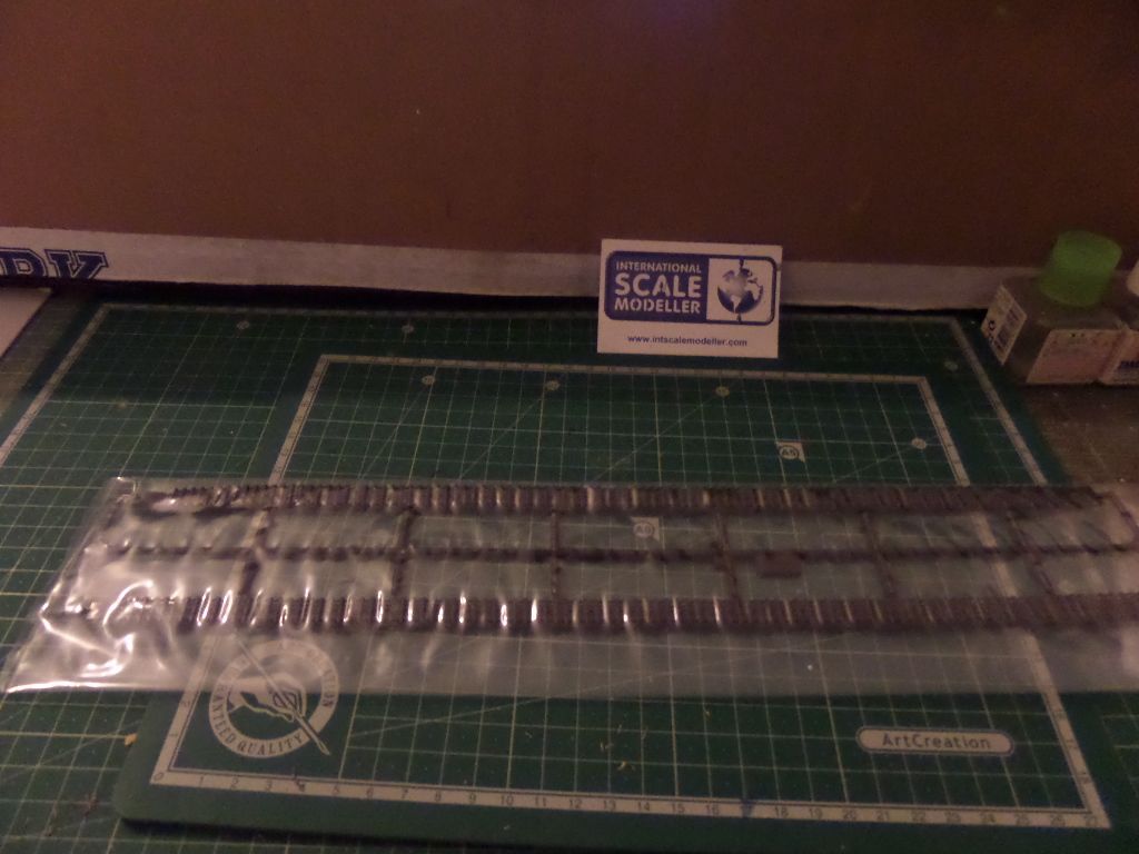

Tracks , in plastic , for me it is ok , I will use this ones :-)

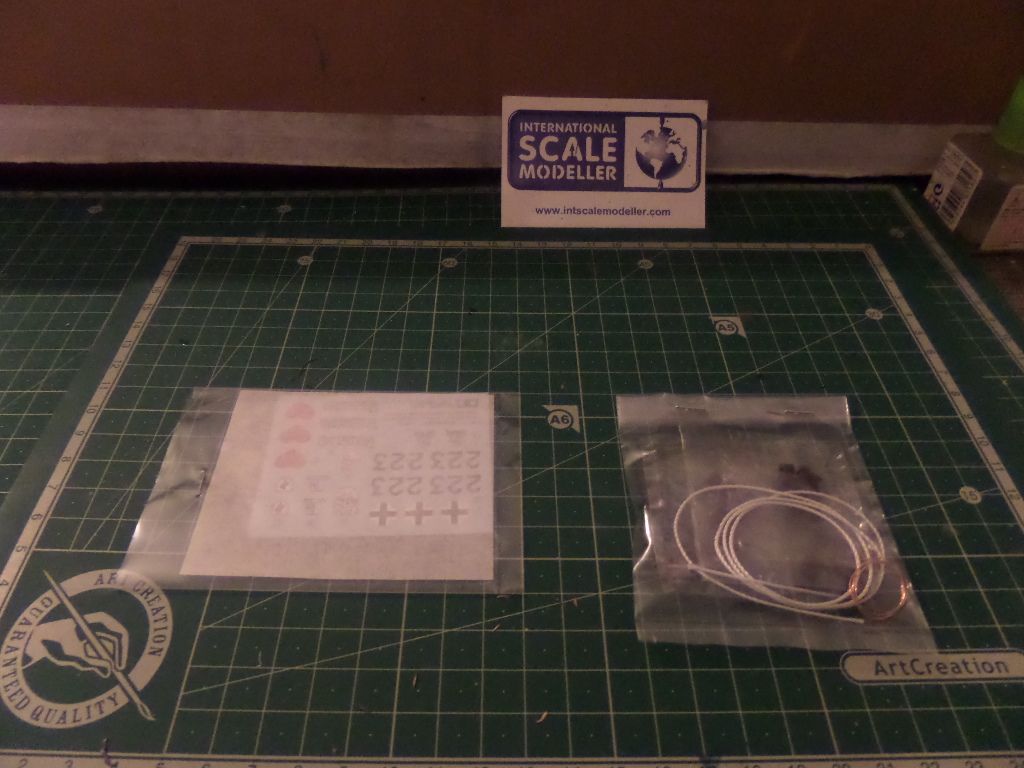

Decals , the usual plastic rings and the usual rope to depict the steel cables

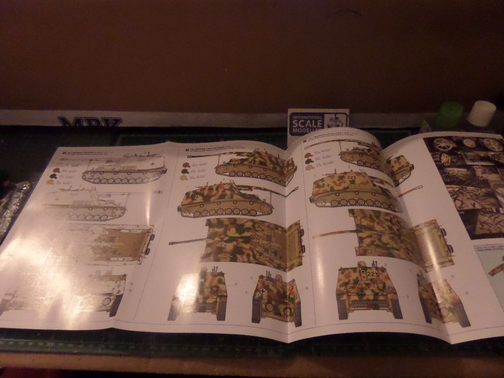

Instructions

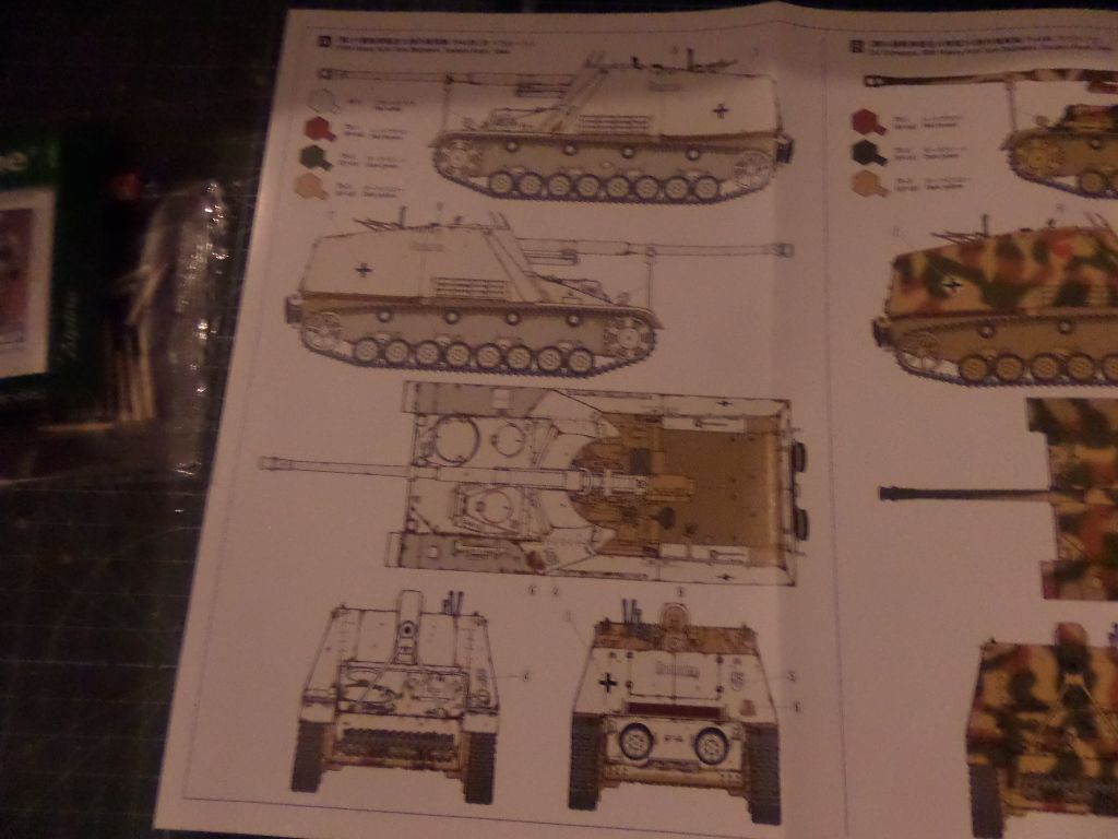

Colour schemes and technical data on the vehicle
Three nice colour schmes , one from Russia ( the one I will do ) , two nice three colour schmes used in Italy ...I like them also :-)

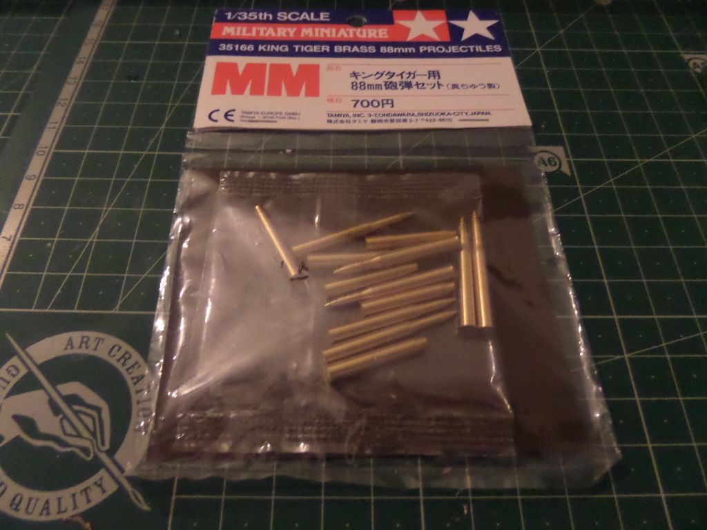

Will use this brass ammo from Tamiya ( 88mm ammo )

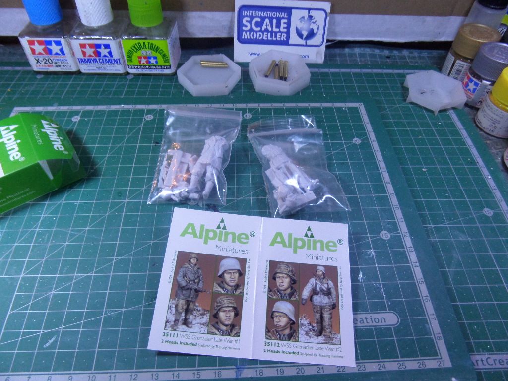

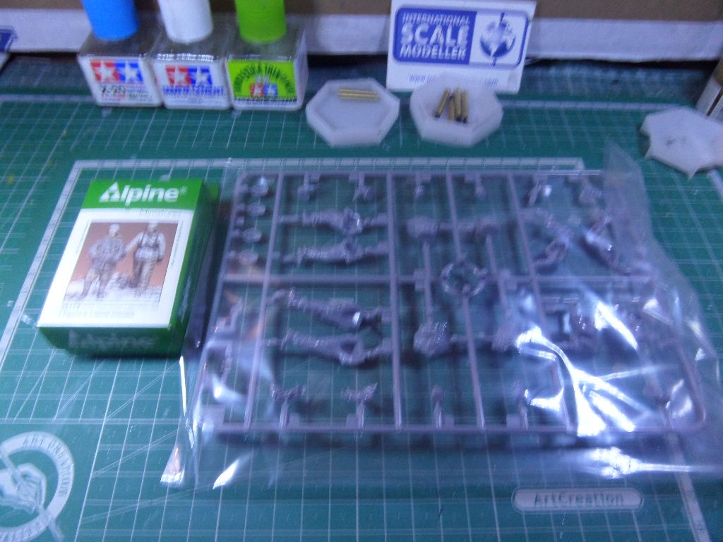

and this two Panzergrenadiers figures from Alpine

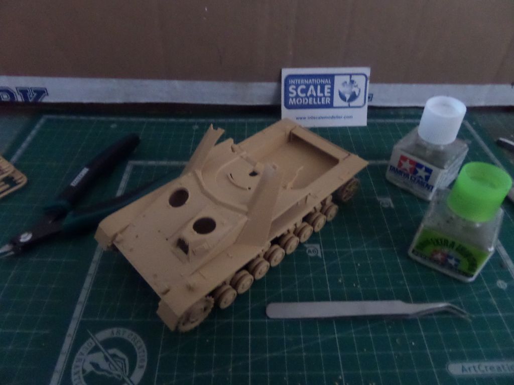

Re: Tamiya 1/35 Nashorn , 519th Heavy Anti-Tank Battalion Eastern Front 1944

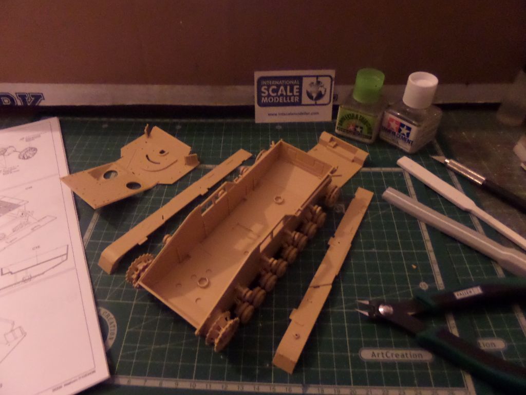

Started last night while watching /listen to the Friday Night Show and keeping this going :-)

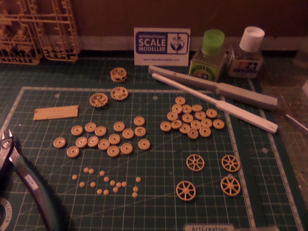

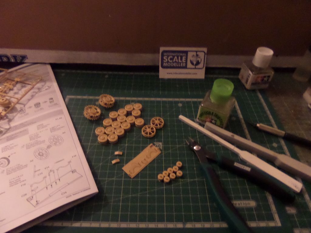

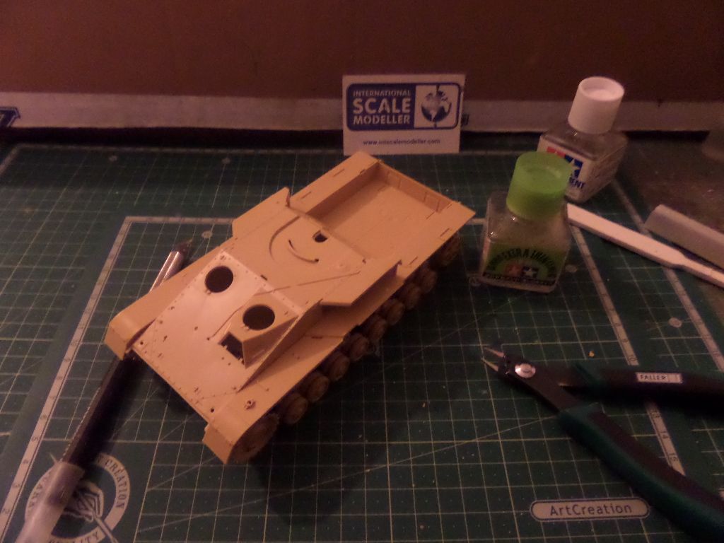

Wheels , a lot of them ...

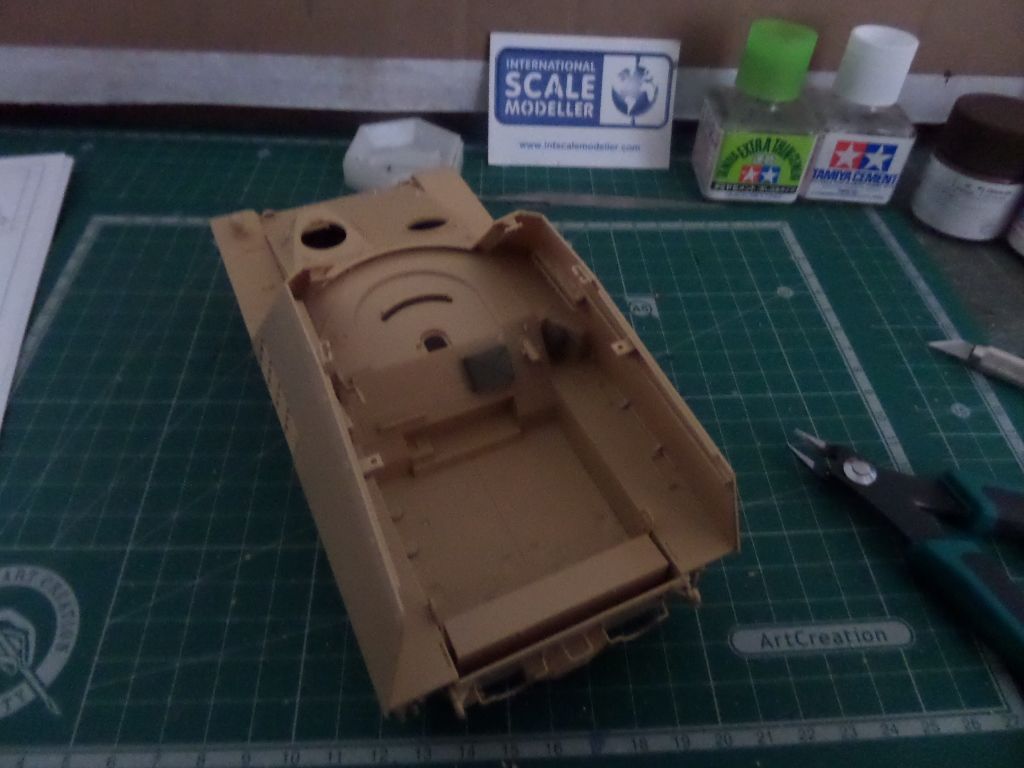

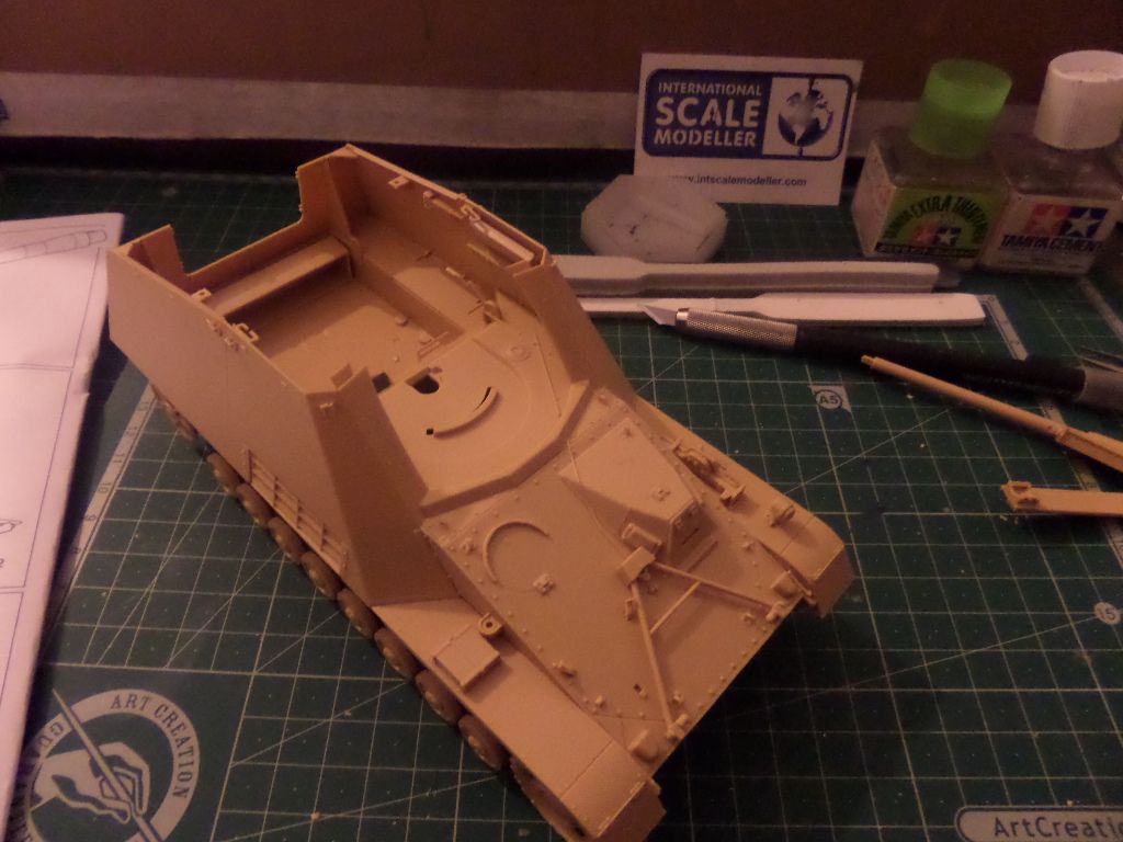

Then rear pannel from lower hull...nothing special , it is another great Tamiya kit , already noticed that
Lower Hull with side mud guards and the plataform for the crew to use the massive AT Gun from the Nashhorn
Now to follow work on the front armour and hatches ...a lot of small pieces to be placed there ...keeping busy :P

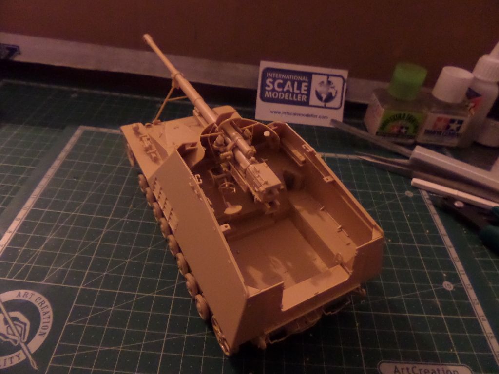

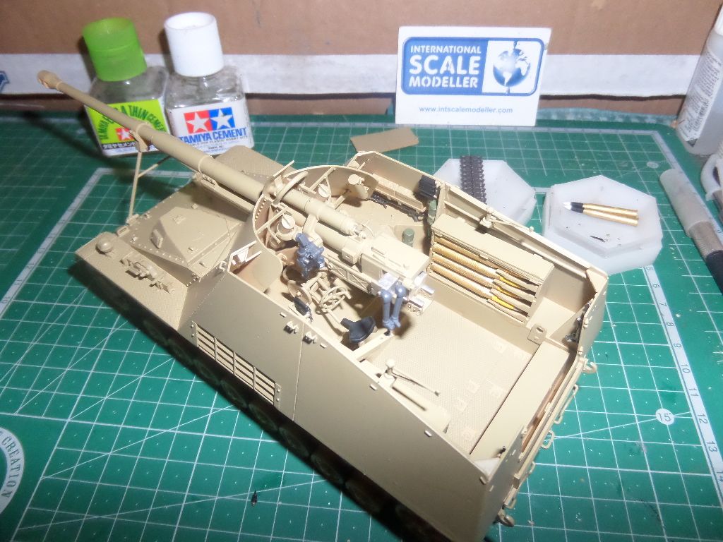

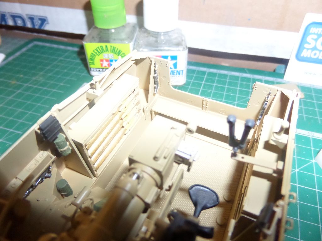

Last Saturday I continue to work in the hull, upper hull front and side armour panels
I painted some of the interior , but then I decided to leave it and painted after as for sure it will be all cover with the main colour

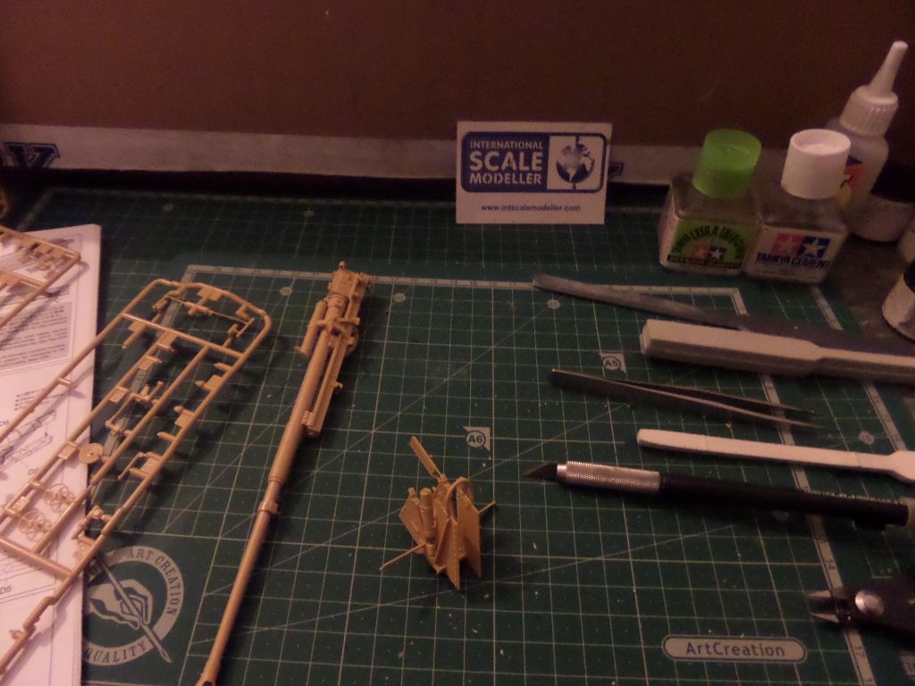

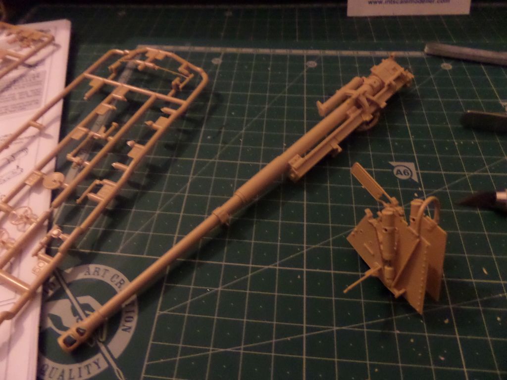

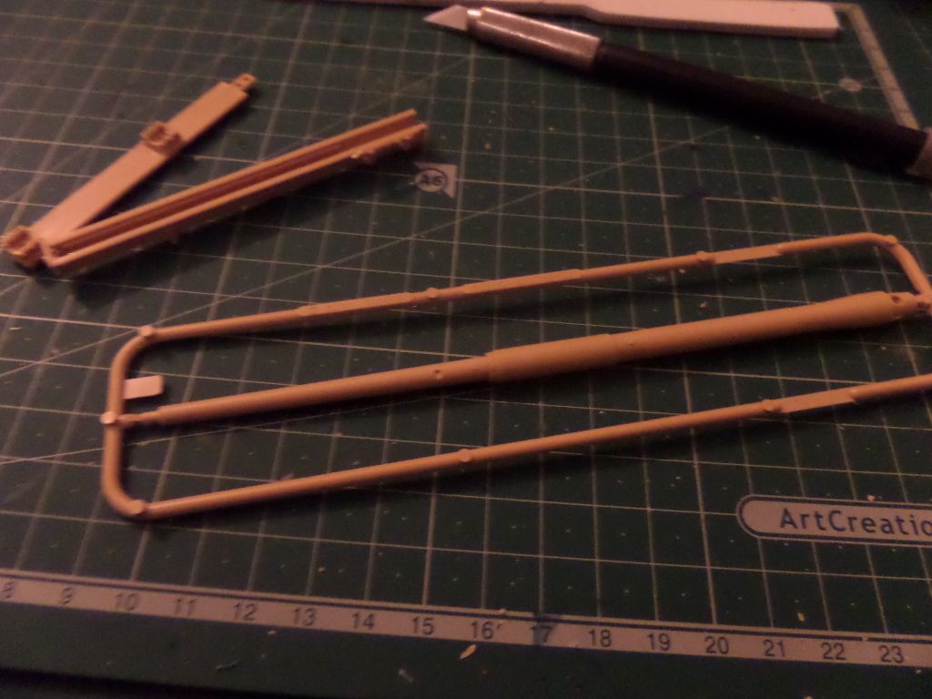

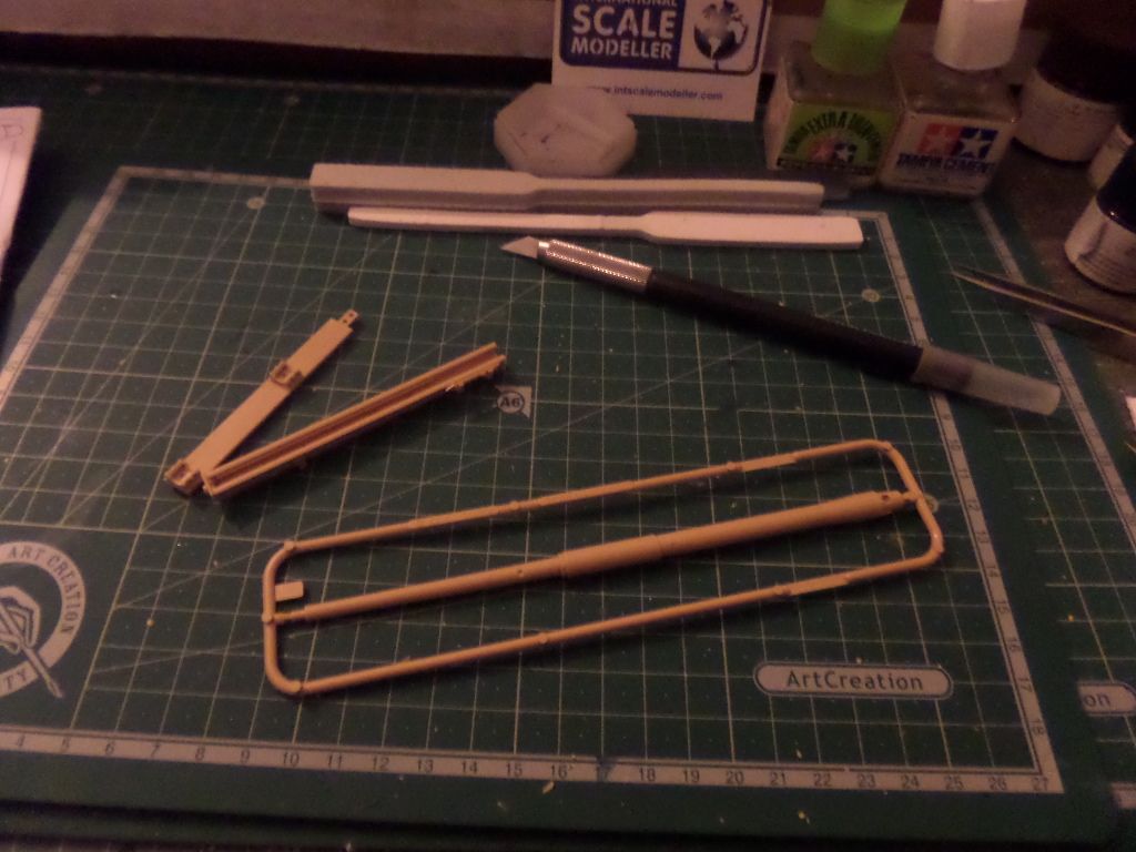

A first to me ...the gun barrel is one piece ...it is nice ,even there are some mould mark on it will be easy to clean !

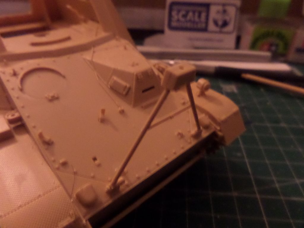

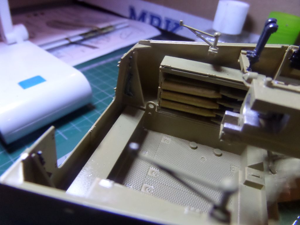

I placed the barrel support for travel , I should place some wire ( supplied in the kit) to depict the mechanism that could be operated in the inside of the tank to lower or place the support
Already placed some of the accessories in the side skirts

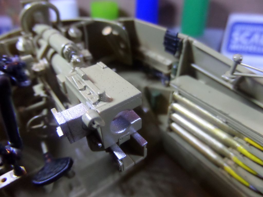

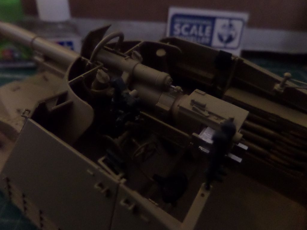

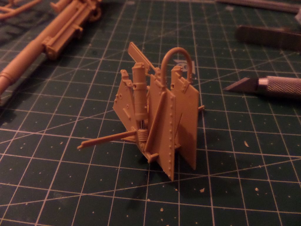

Gun ...now that is very detailed ...some Plastic PE , give me a all afternoon of modelling , that I liked a lot :-)
to place all this was hard work , but with patience and following the instructions all went to the right place ...it's Tamiya at its best !
Here I make a mistake ...I glued the barrel support ...this was to be used during travel , I will depict the tank firing ...well the should place the tank first and release it after so ...but a mistake I must admit , as I wasn't thinking ... :wall:

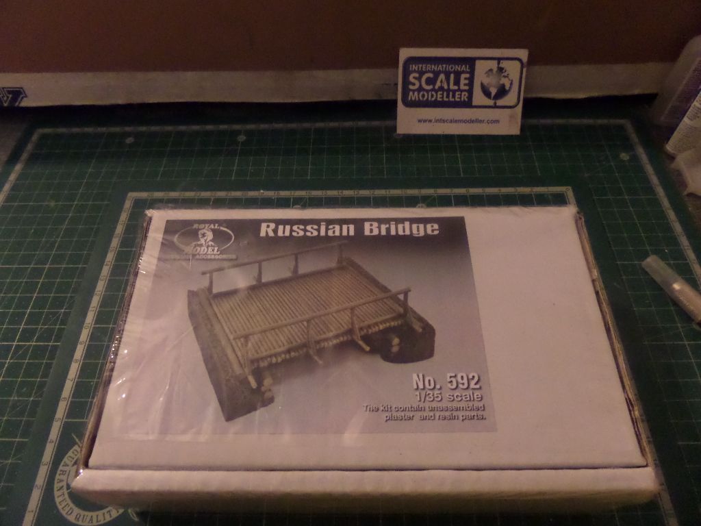

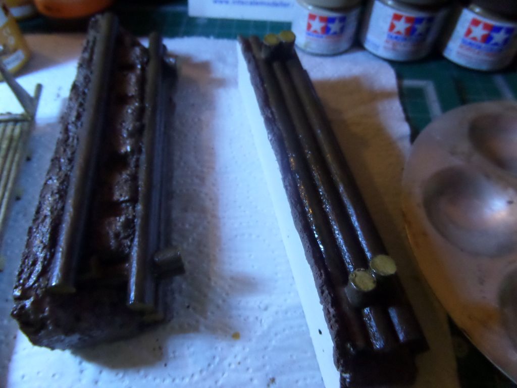

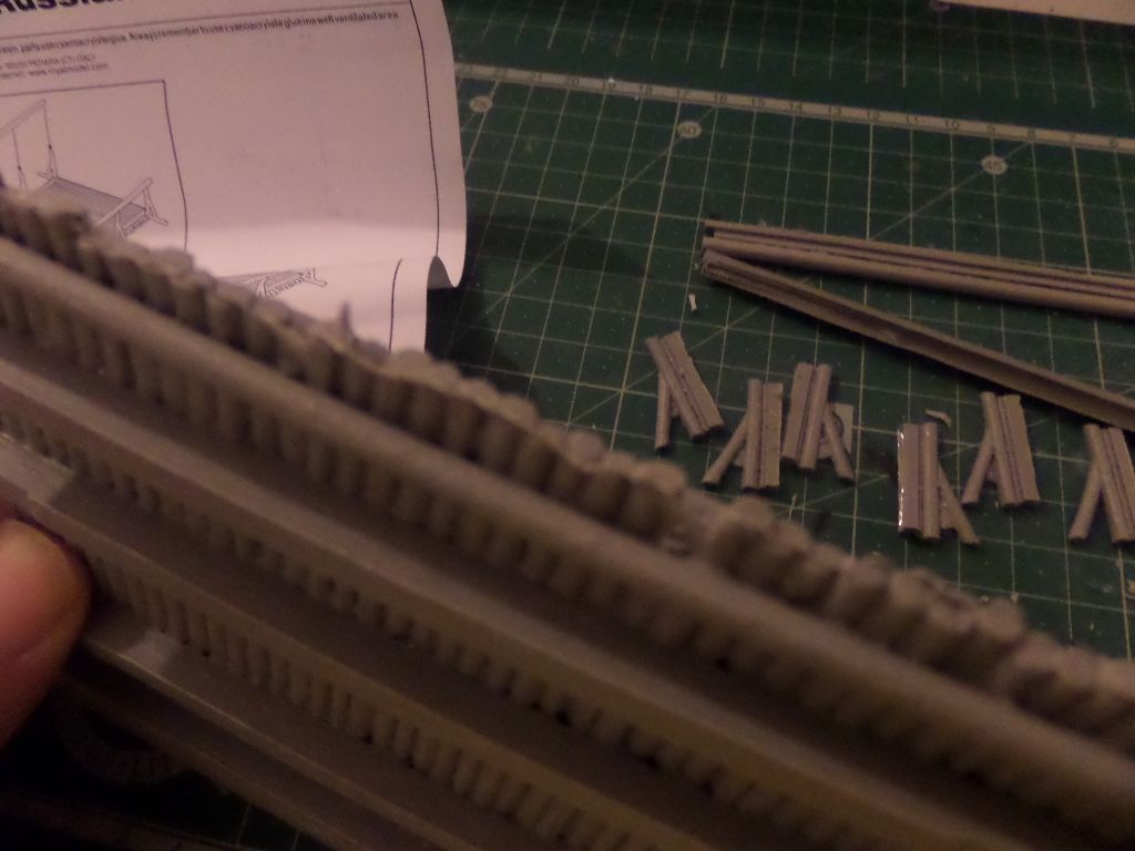

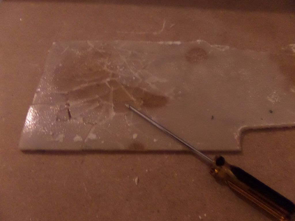

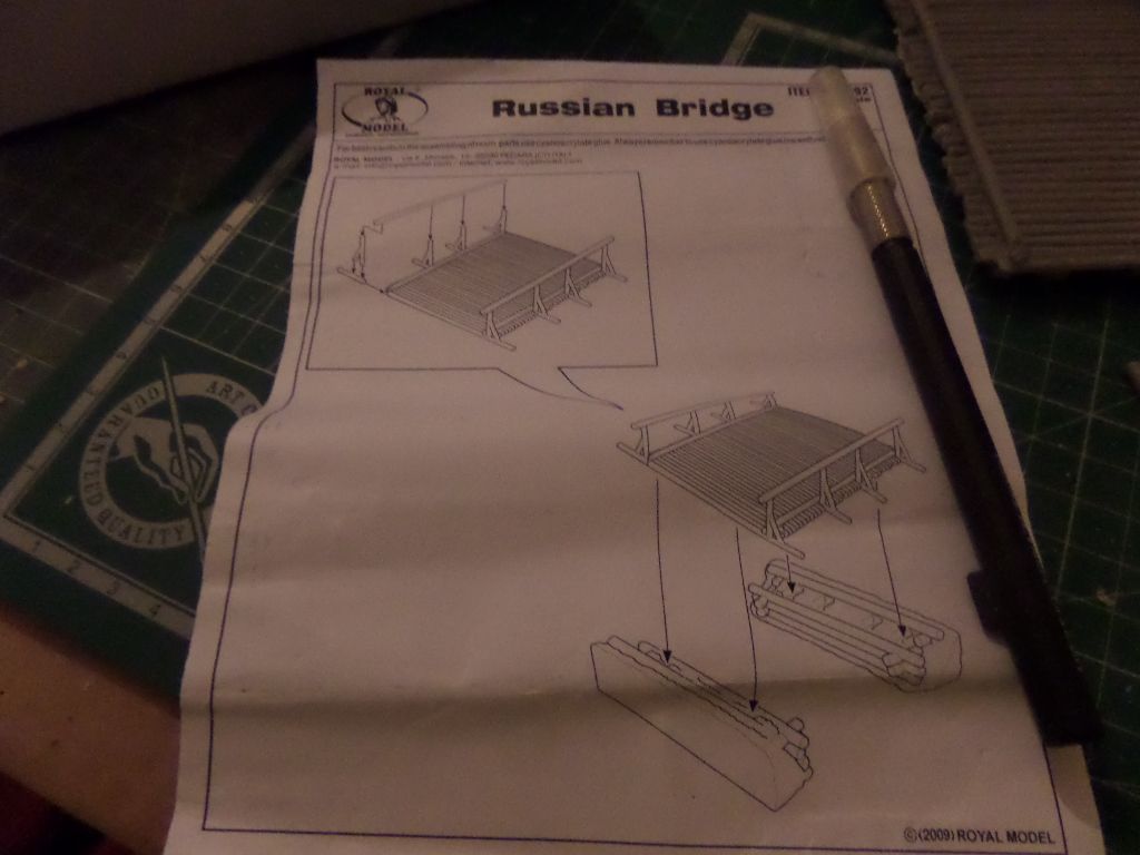

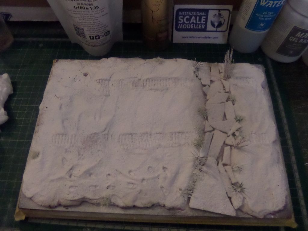

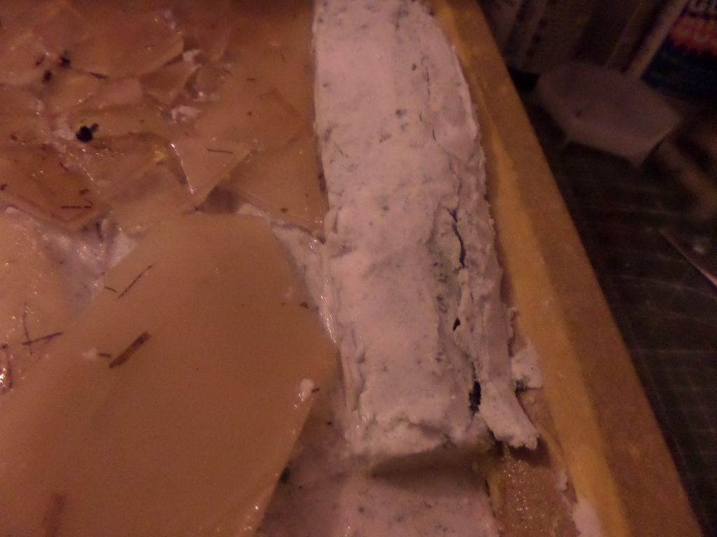

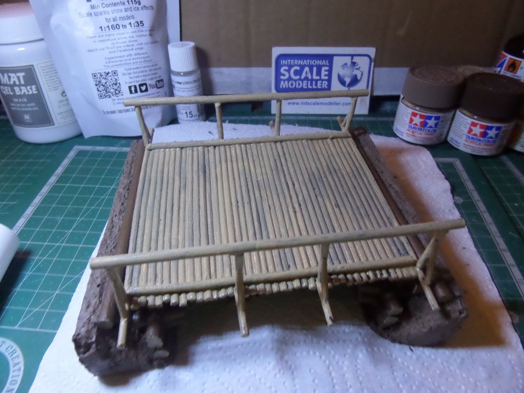

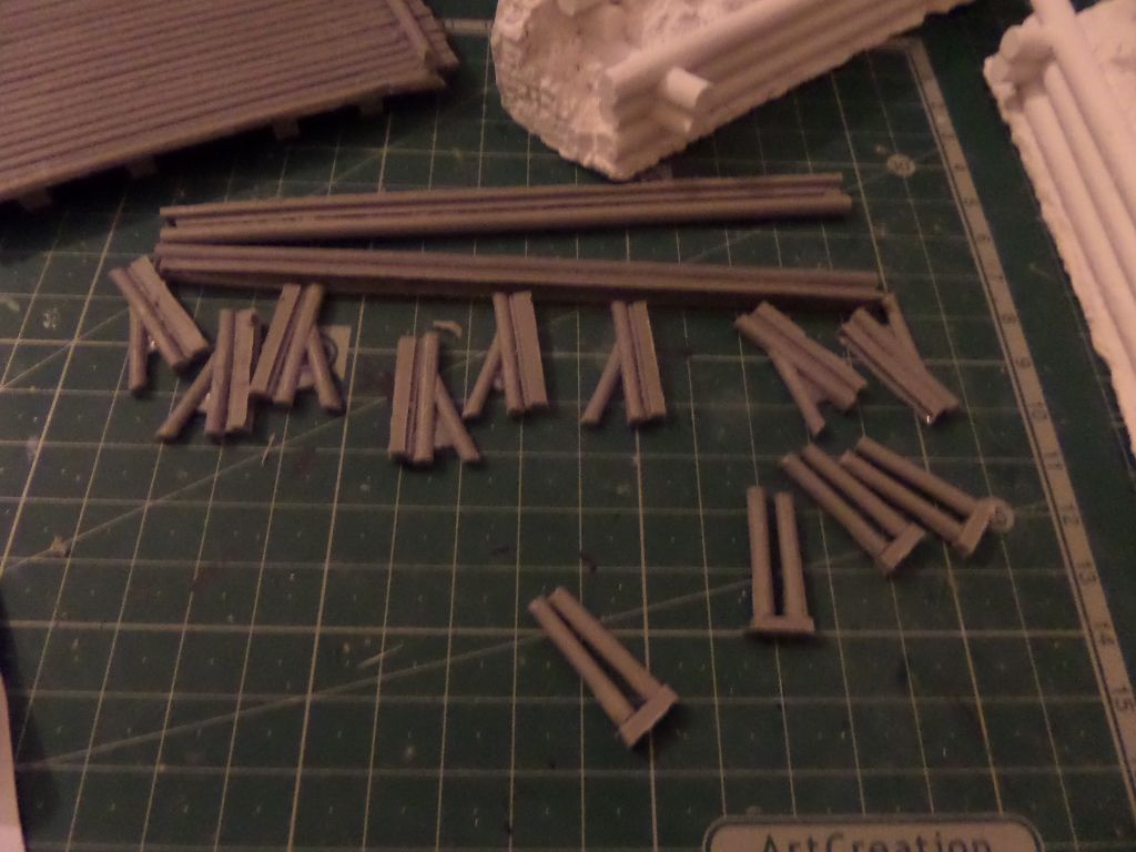

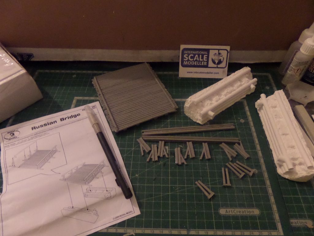

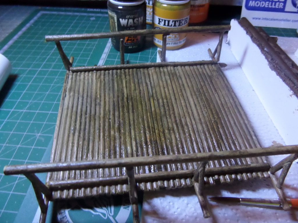

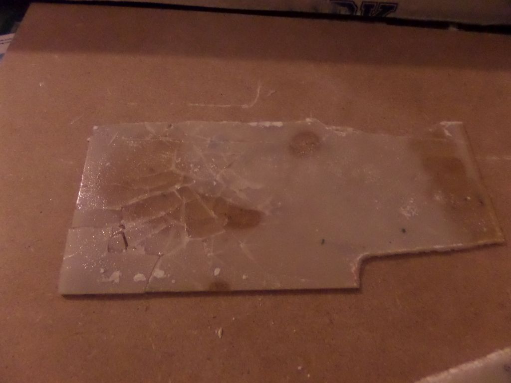

Working on the diorama ...I have this Russian BRidge from Royal Models for some time ...
Some plaster elements and some resin
And a first idea on what could be the diorama , I wanted to do a real winter scene , with ice under the bridge ans lots of snow ...but the base is small , and a NAshorn on a wooden bridge ...well I think couldn't support it so a bigger base or no bridge ...I must decide that later ...

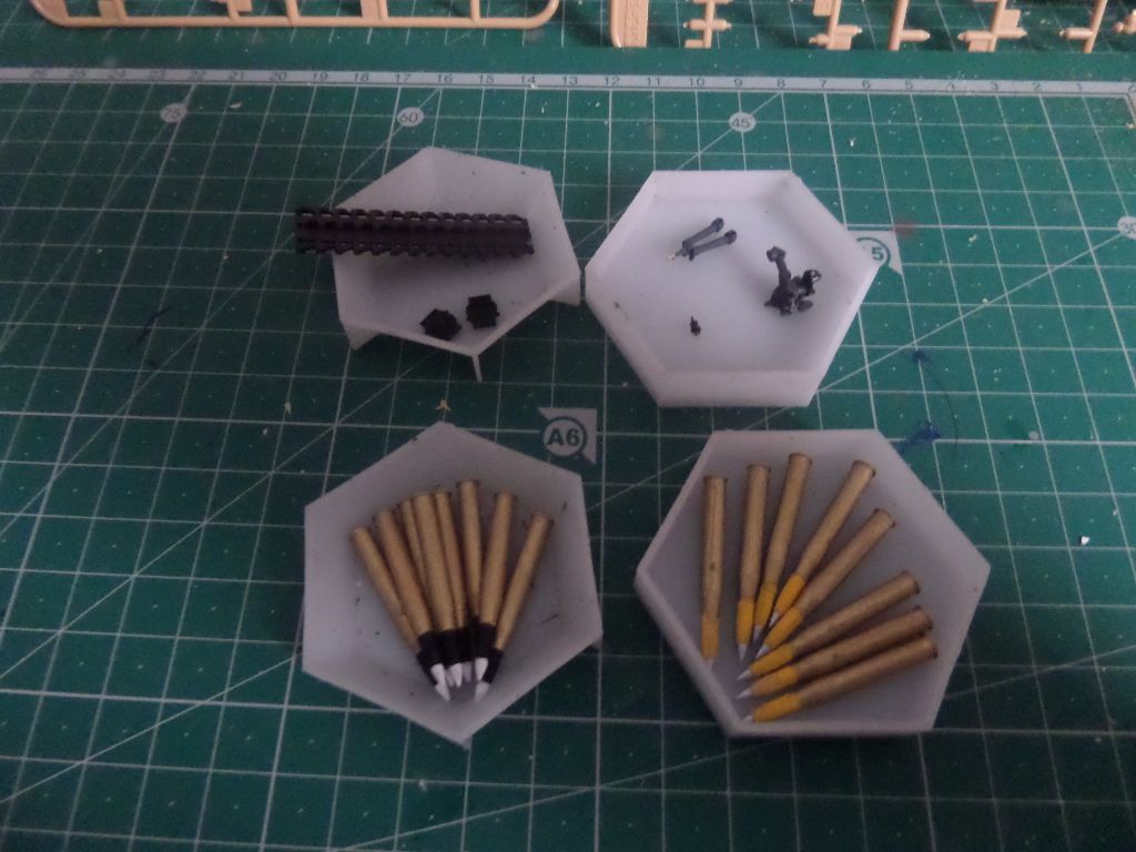

Some small pieces already done ...gun sights ...shells ...
The yellow tip ones are HE(High explosive) shells and the black tip ones are AP (Armour piercing shels ) , I read that the NAshorns usually use AP ammo as the gun was so good that they didn't really need to use the HE ones ...some curiosities :

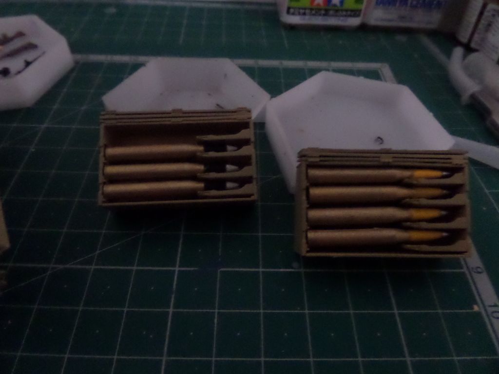

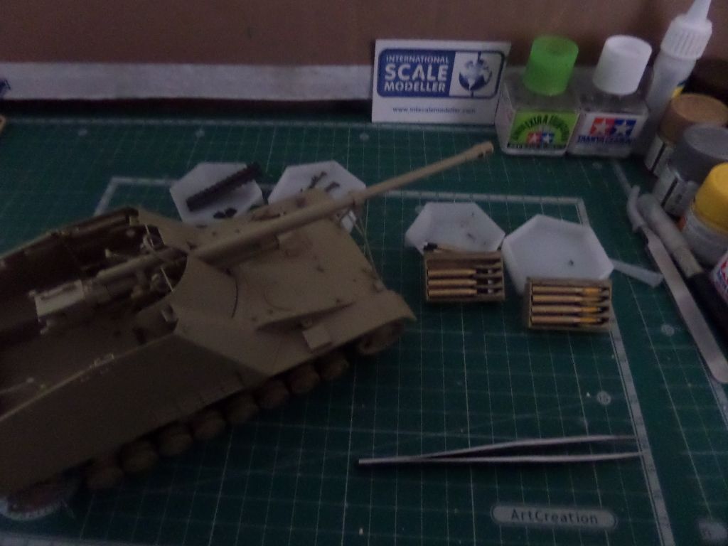

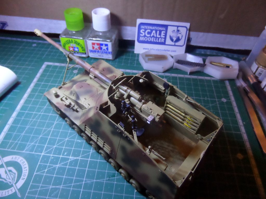

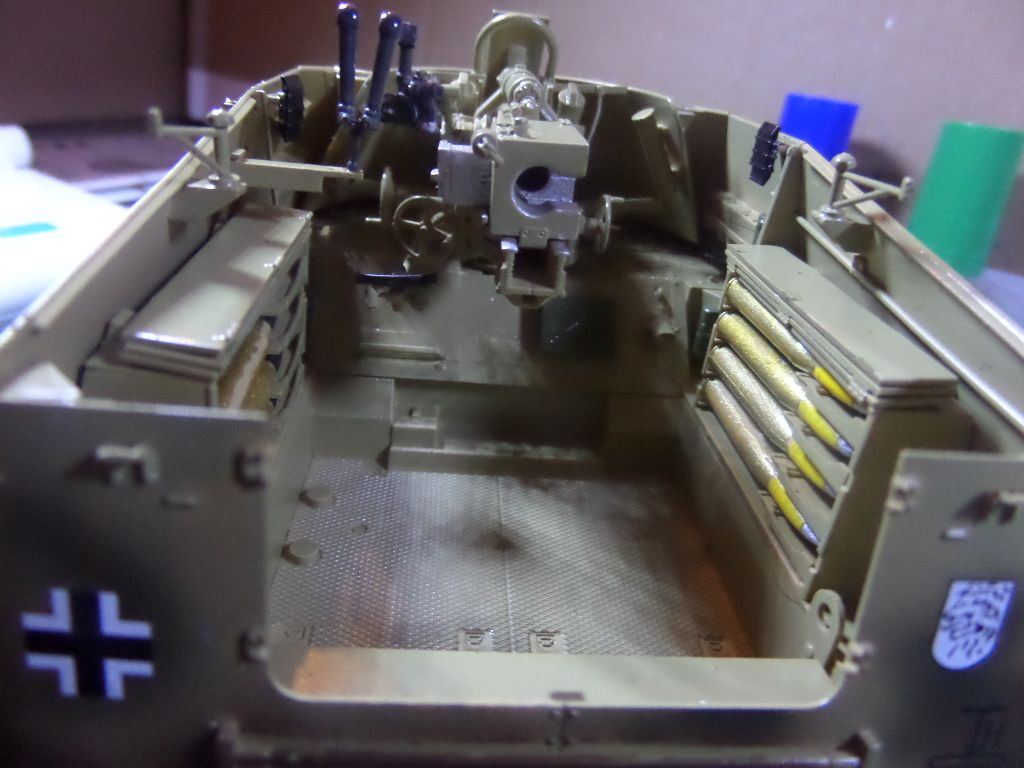

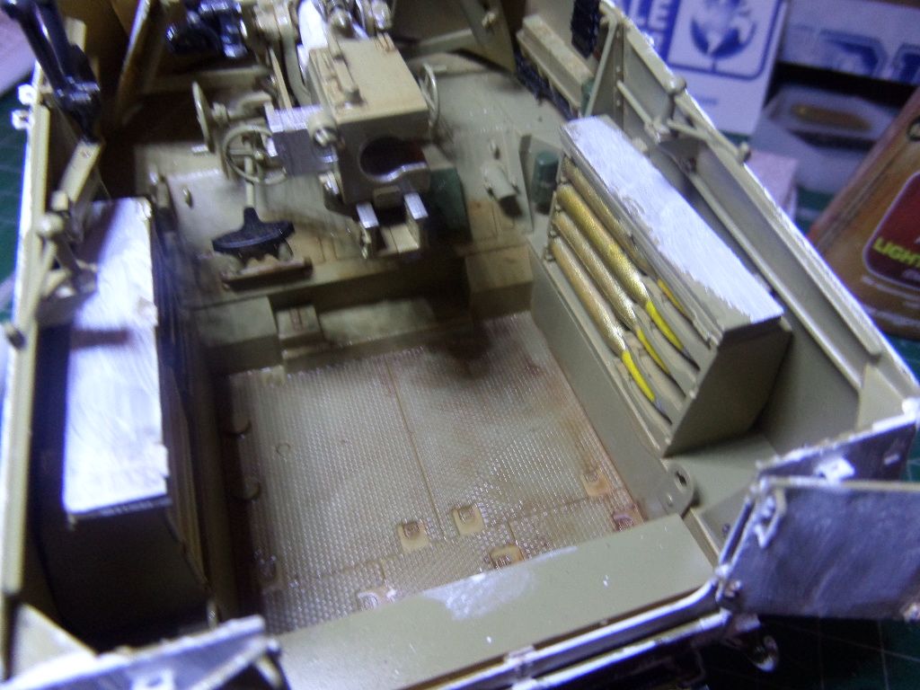

Well I made the ammo racks to be placed on both sides decided to have ine with the AP and other with the HE ...used the plastic ammo form the kit , I will use two brass ammo from the Brass shells kit that I have and the empty ones also from brass...
I painted now some details of the gun using x-11 , mainly some somall details in the recoil and in the gun interior
Palced the MP-40 in the back ...they are stored , one issue with tank destroyers was that they were fantastic armour AT , but were very vunerable to infantry , so they must have small arms to defend themselves ...also a MG 32/42 were stored at the tank , I will take more visible photos as it is hidden in a side pannel , you can see it in the lower left corner under the ammo boxes for it ! :-)
here, see it ?
Brass ammo
the difference between the plastic and the brass ones ...pitty that i do not have enogh brass ones to fill all the rackets

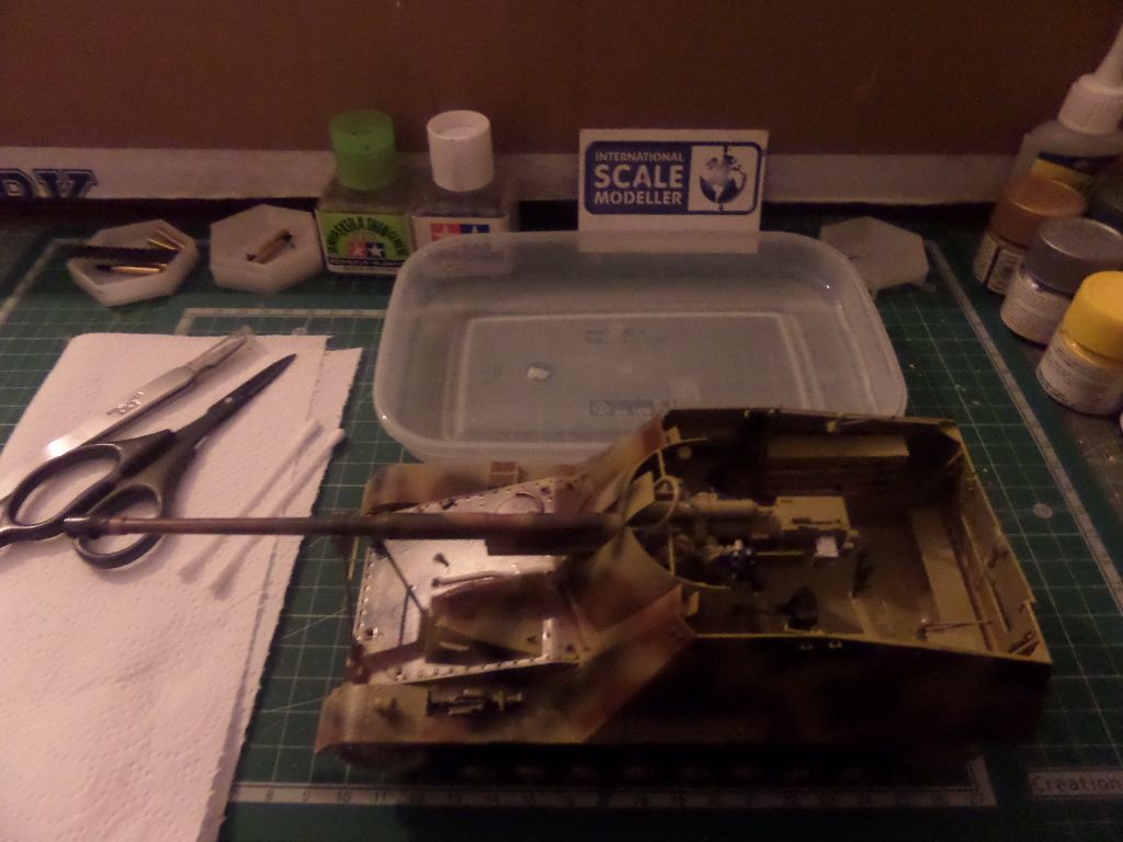

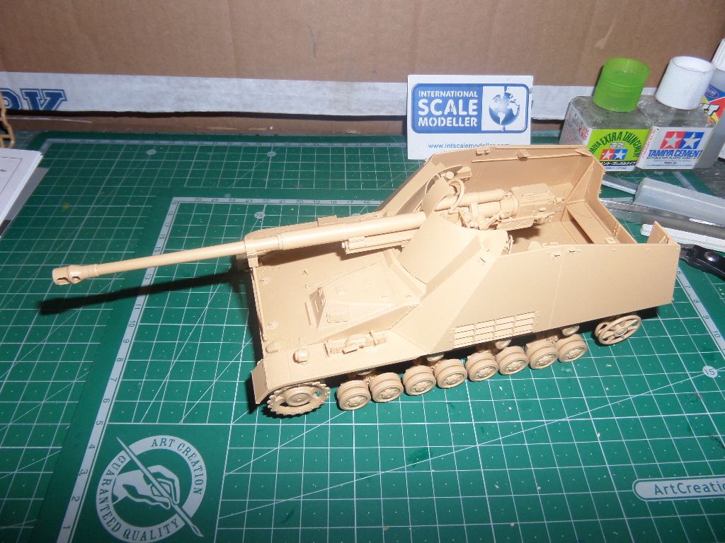

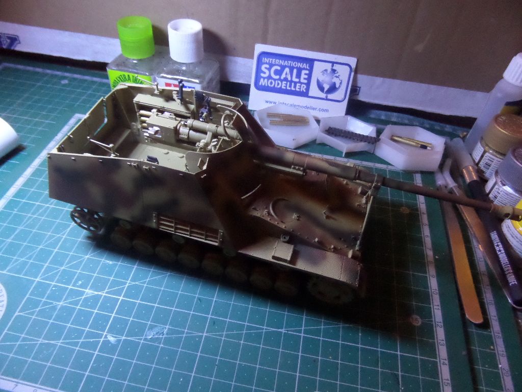

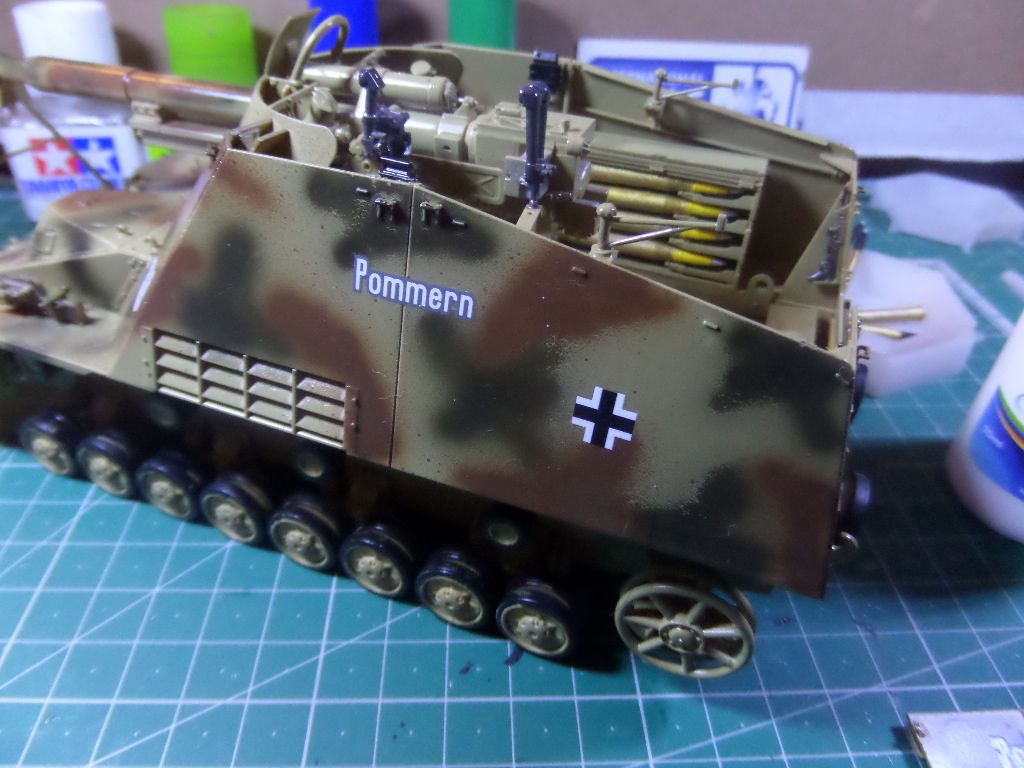

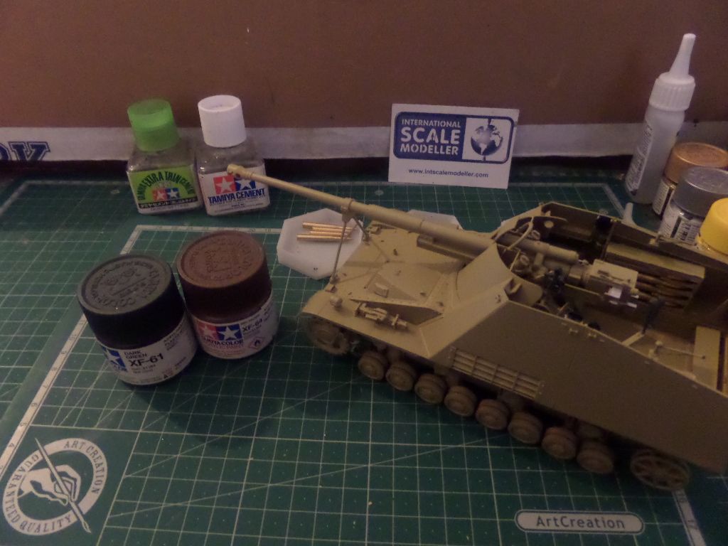

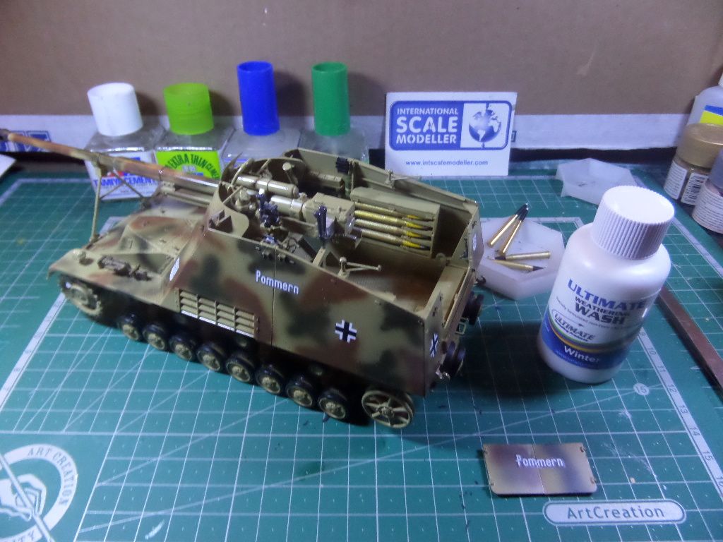

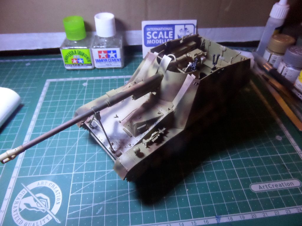

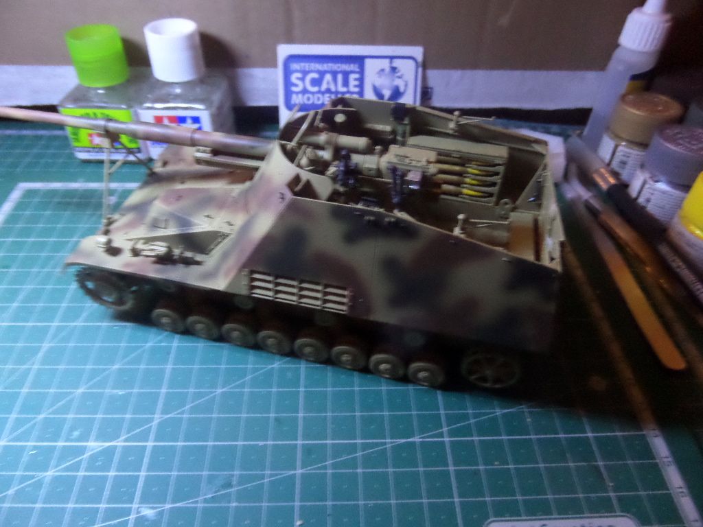

Now the tank is ready to have some three tone camo , I have painted it already in Dark Yellow XF-60
And some free airbrush done :-) , it is ok as it will be covered later with some white wash
After a Clear Gloss , ready for some decals

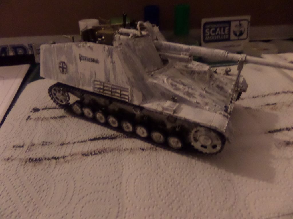

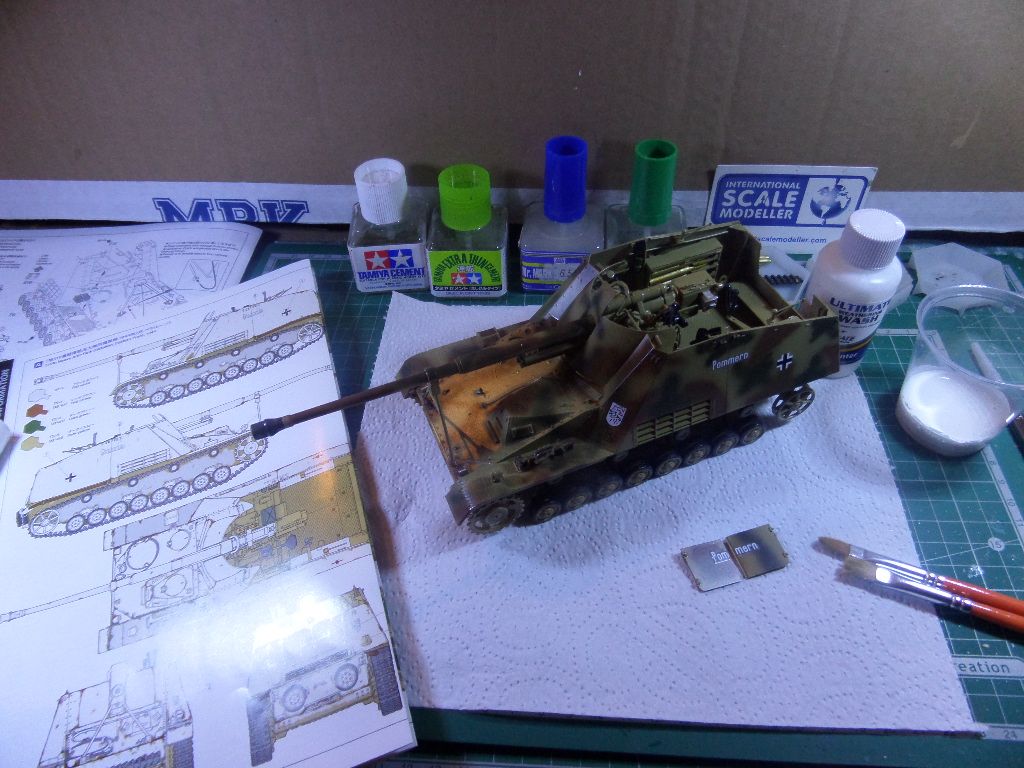

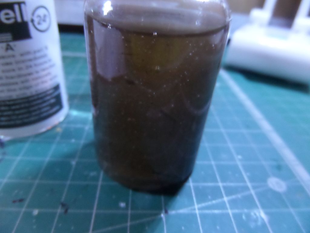

And now ready for some Ultimate wash thatI will use to try to depict the winter camo

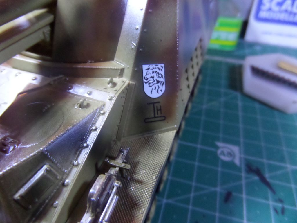

I had some doubts on the name of the tank and the heraldic of the unit as in the instructions they seem to be placed after the winter wash...but I thought that they will have this at Kursk and after in the winter they have been covered with the wash
too clean yet :-)

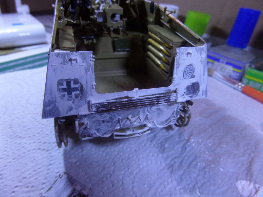

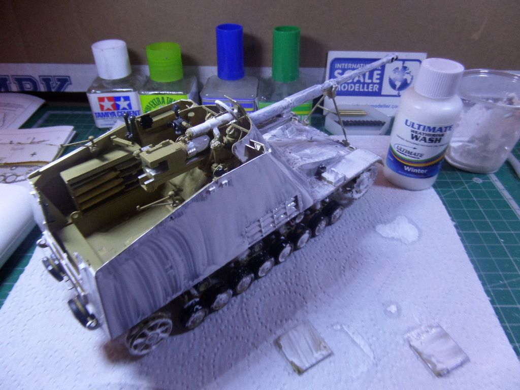

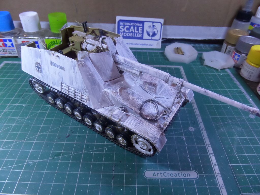

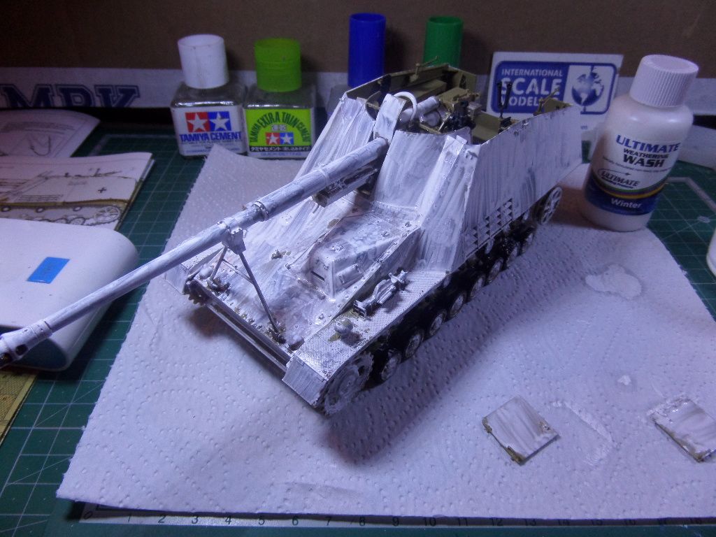

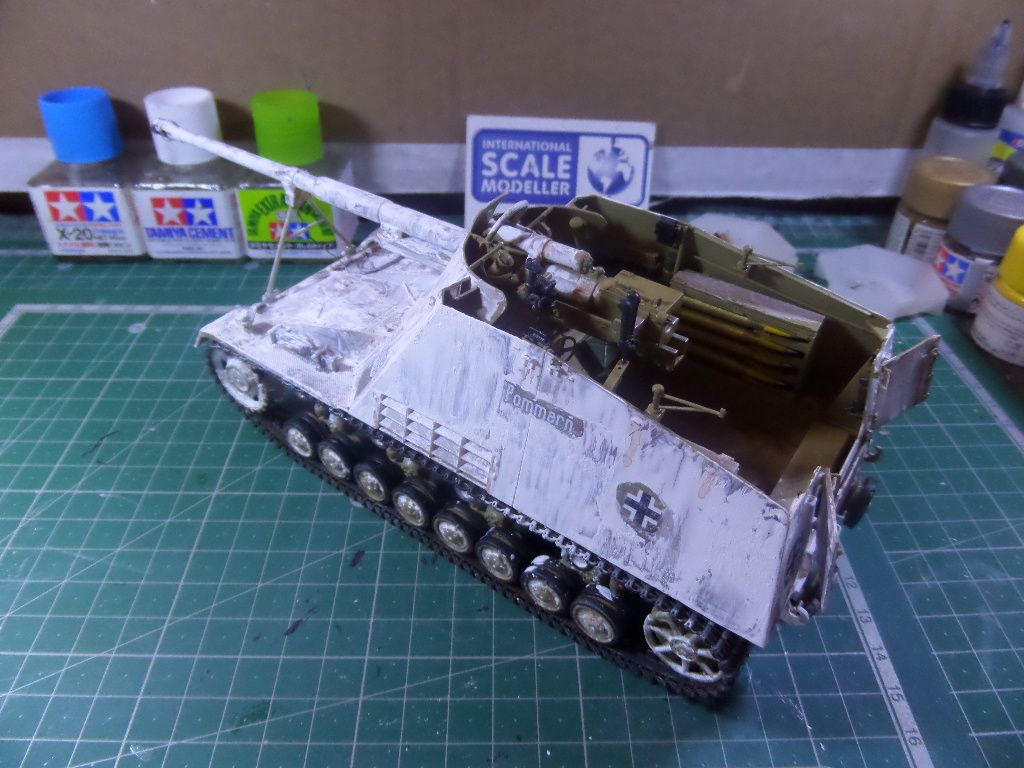

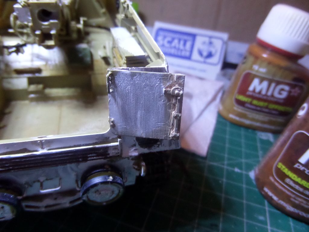

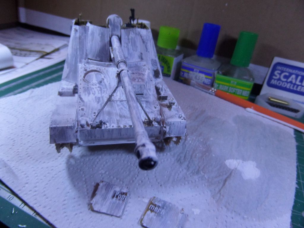

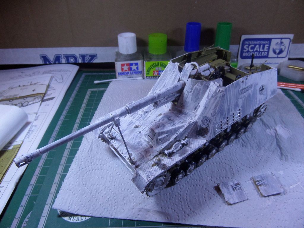

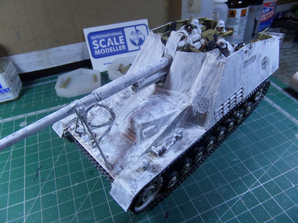

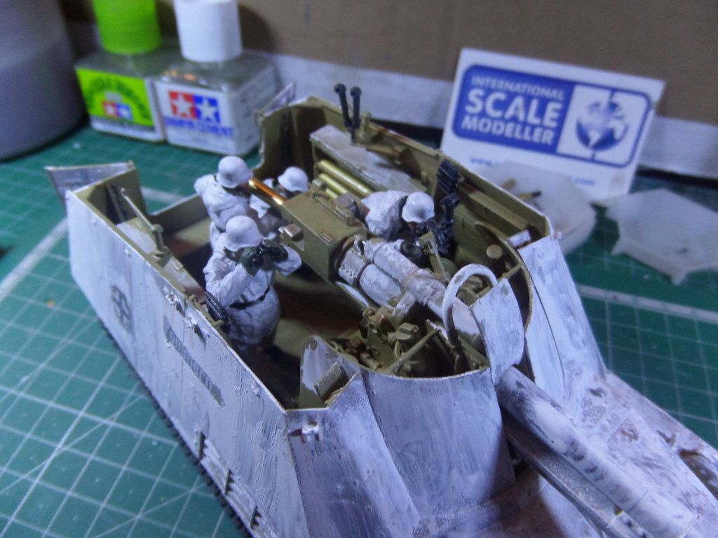

New update ...

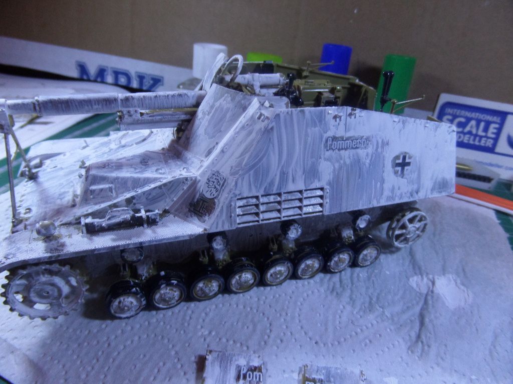

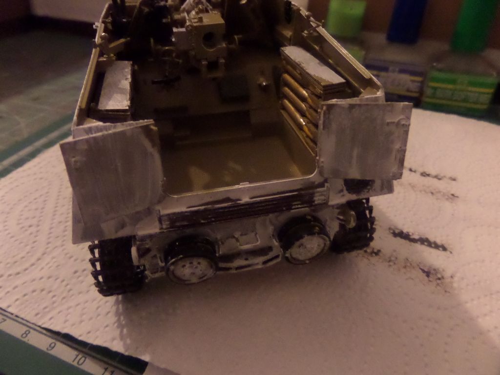

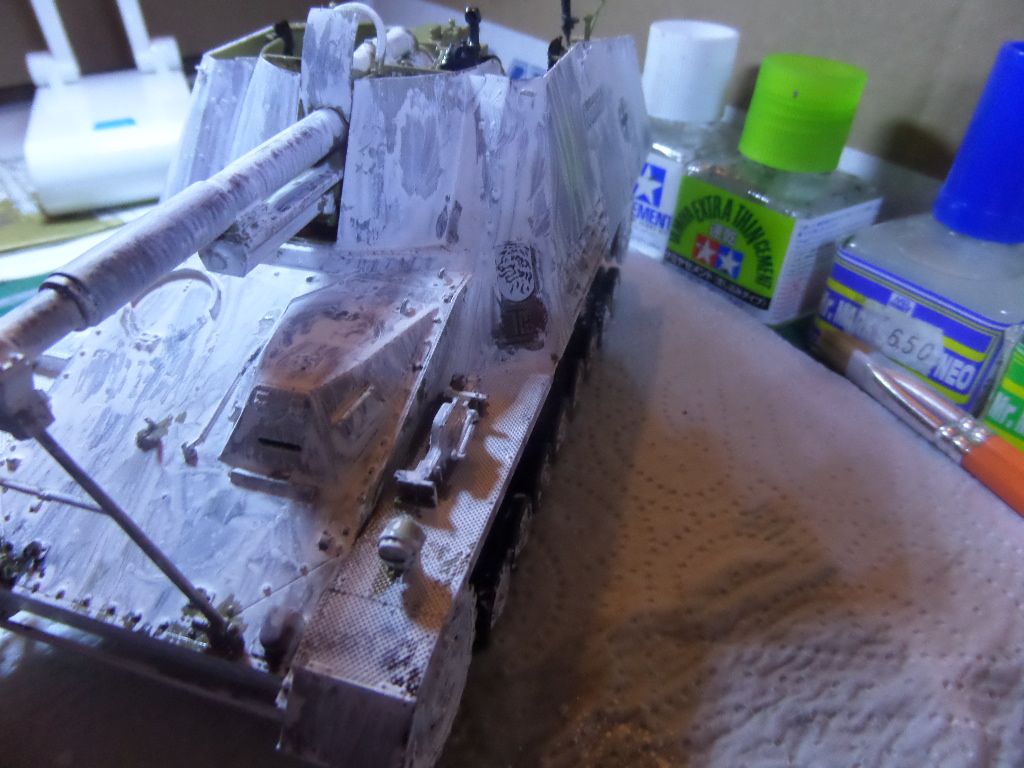

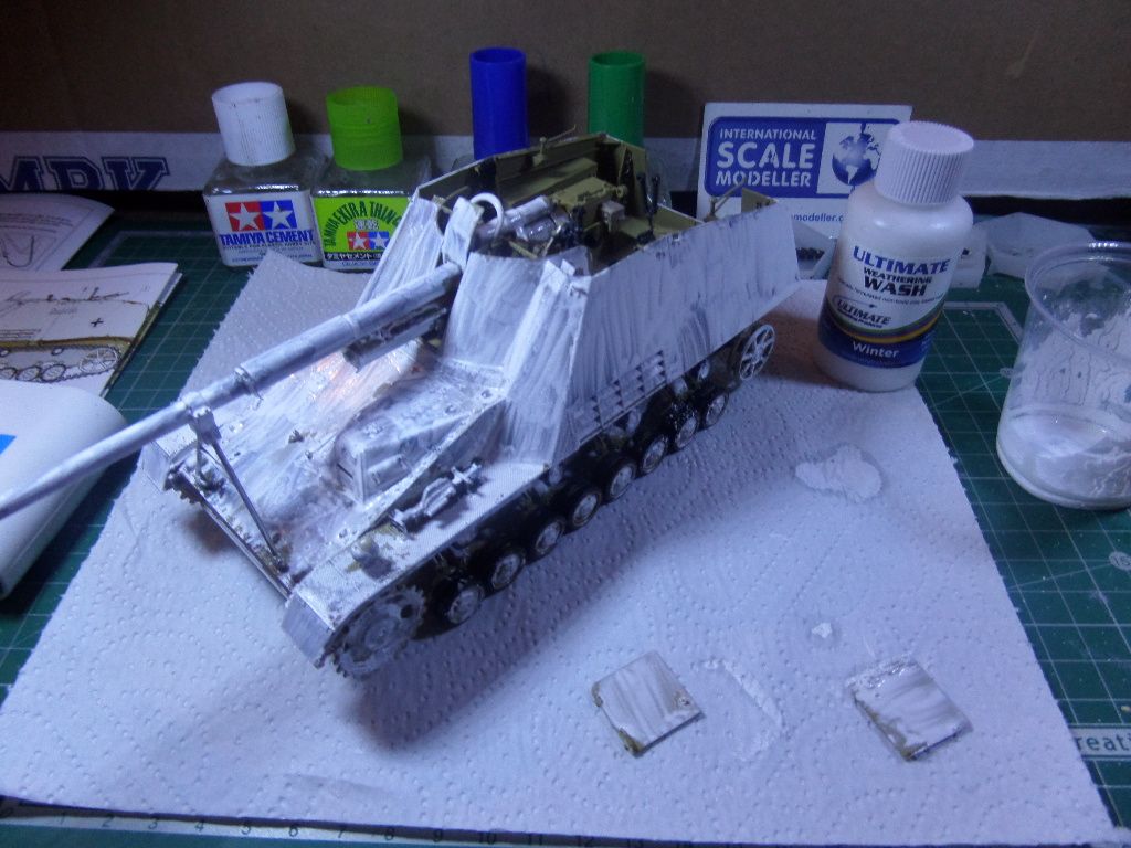

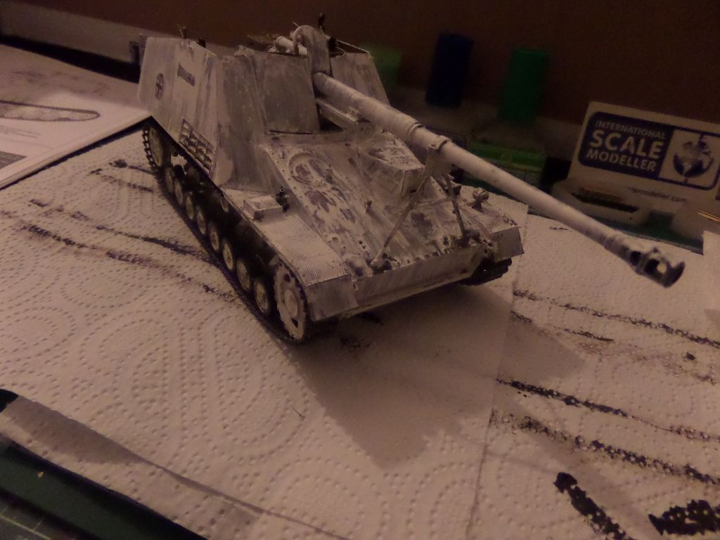

I paint the NAshorn with the Ultimate winter wash :-)
then I try to remove some using a brush , my idea is to not remove too much given that impression of a winter camouflage...at this point I'm a little in the edge of thinking that I could remove more , but I also could remove less ... :-)
this side pannel , I didn't like so much the result ...

I think the camo actually looks pretty good. Sometimes the crew didn't have enough time to spray on the paint, so they would apply it with anything from mops to rags. A tank in combat might not have a pristine, homogeneous coat of whitewash.

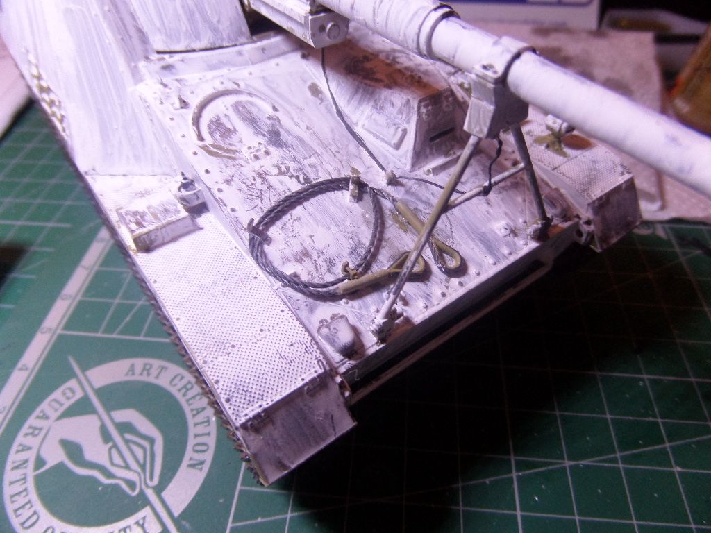

after 'destroying ' all the paint camo work wuth that white wash (for me is is really great stuff, an very convencing, as should be more or less the way that the crews did it in the battlefield !) time to get things going ...

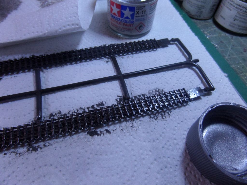

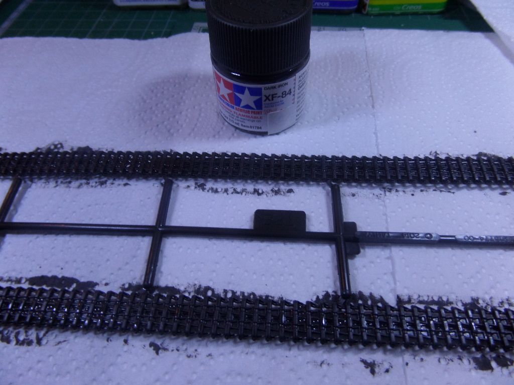

tracks ..they are rubber , bu for me no big issues on that ...og course some metal ones could be better , go for it if you can ...
Some Dark Iron XF-84
Some x-11 drybrushing to give that worn metal look
Also you can also drybrushing with some XF-64 to give them a rust look !
no issues at all palcing them , glue them outside, remove the sprocket (it isn't glued) and easy fit afterwards
I added the wire ...this was operated from inside the tank to up or down the gun support ...this was a mistake in my build ...when firing this should be down I think
Tow cable ...it is some rope that tamiya gives us in the kits , after it is painted with dark iron XF-84 or XF 56 Metal

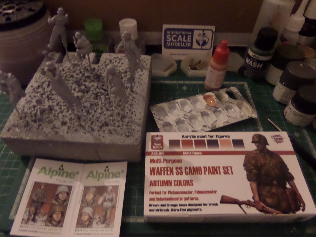

Will start with the alpine set
Will use for the camo in the SS figures the new Andrea Miniatures camo set
Crew

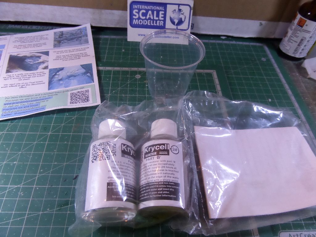

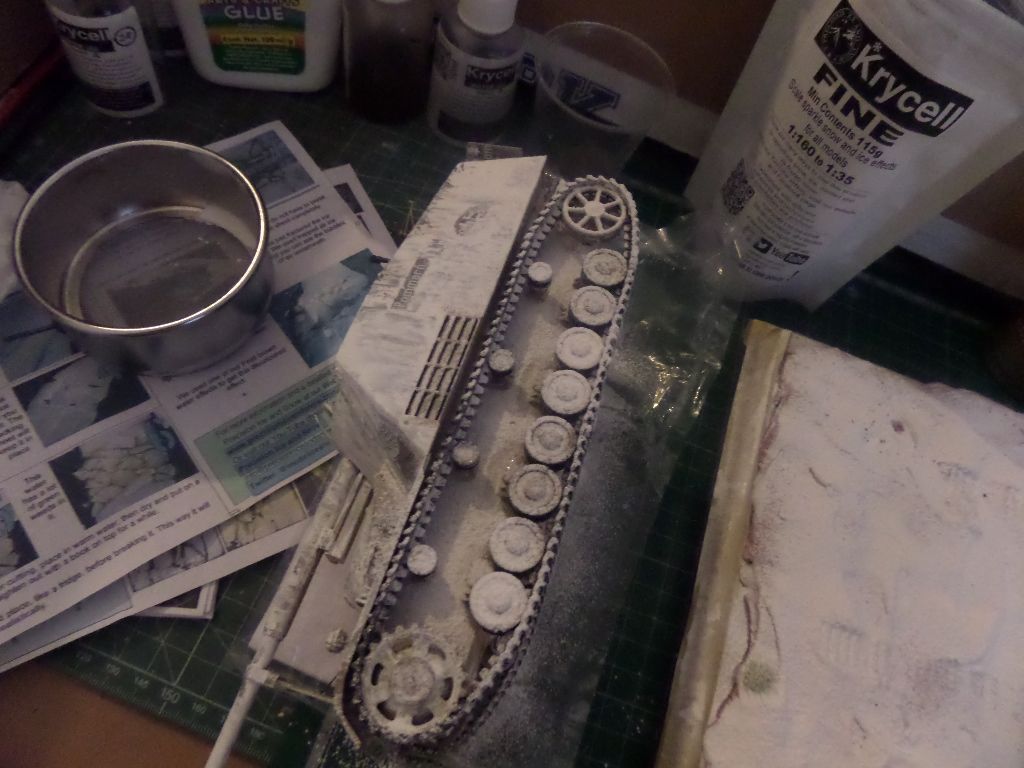

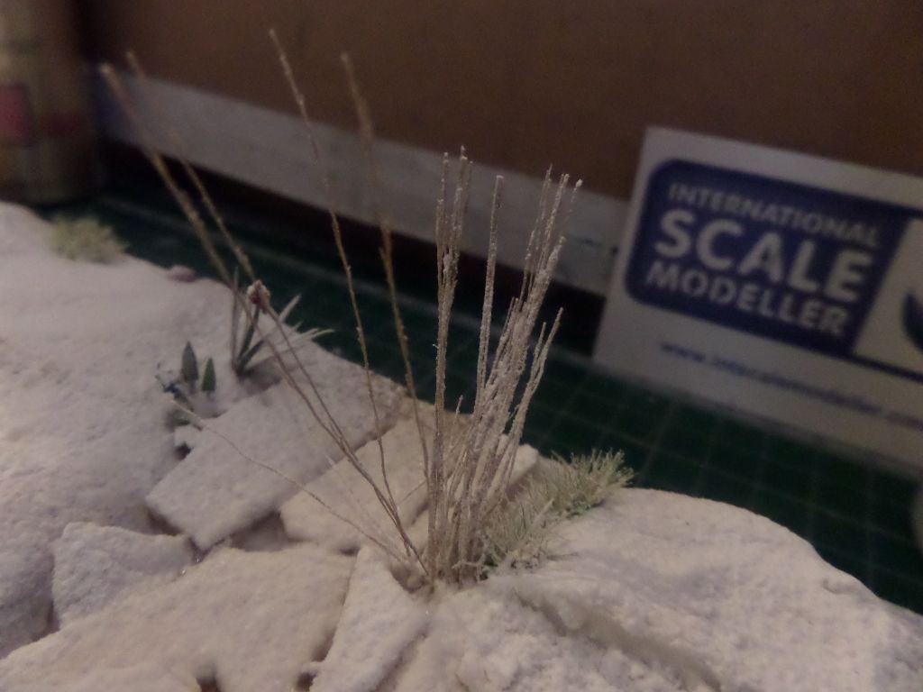

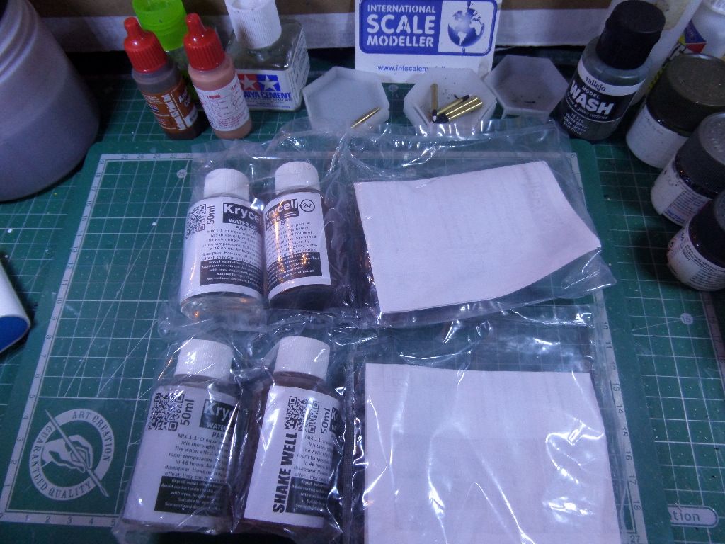

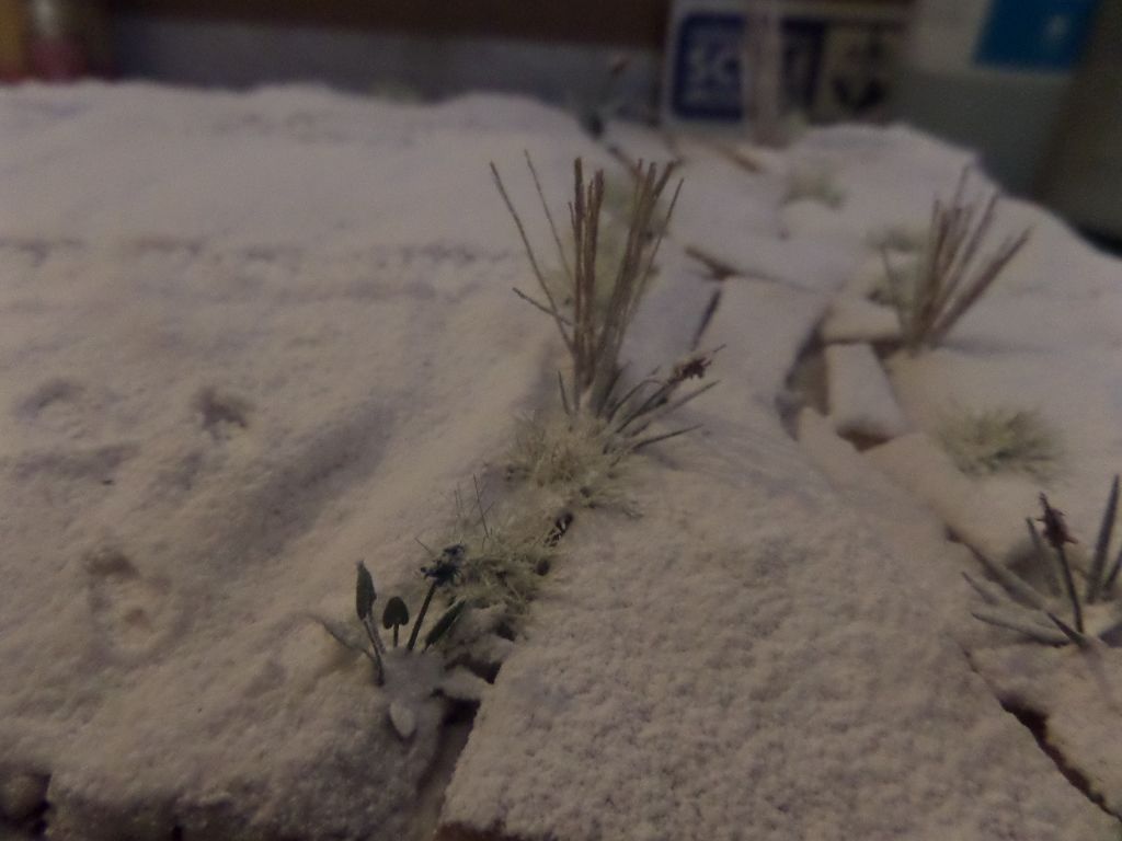

Meanwhile some of the materials that I will use in the diorama , from Precision Ice and snow
Snow...
dirty water
Ice sheets

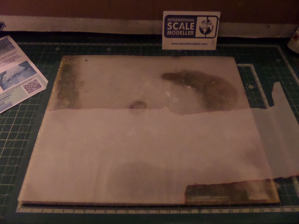

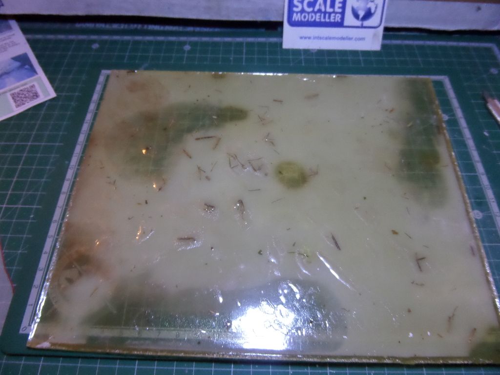

Disrupted Ice...
This is a sheetof 'ice' actually is a resin , but vey nice effect hopr to grt in the dio

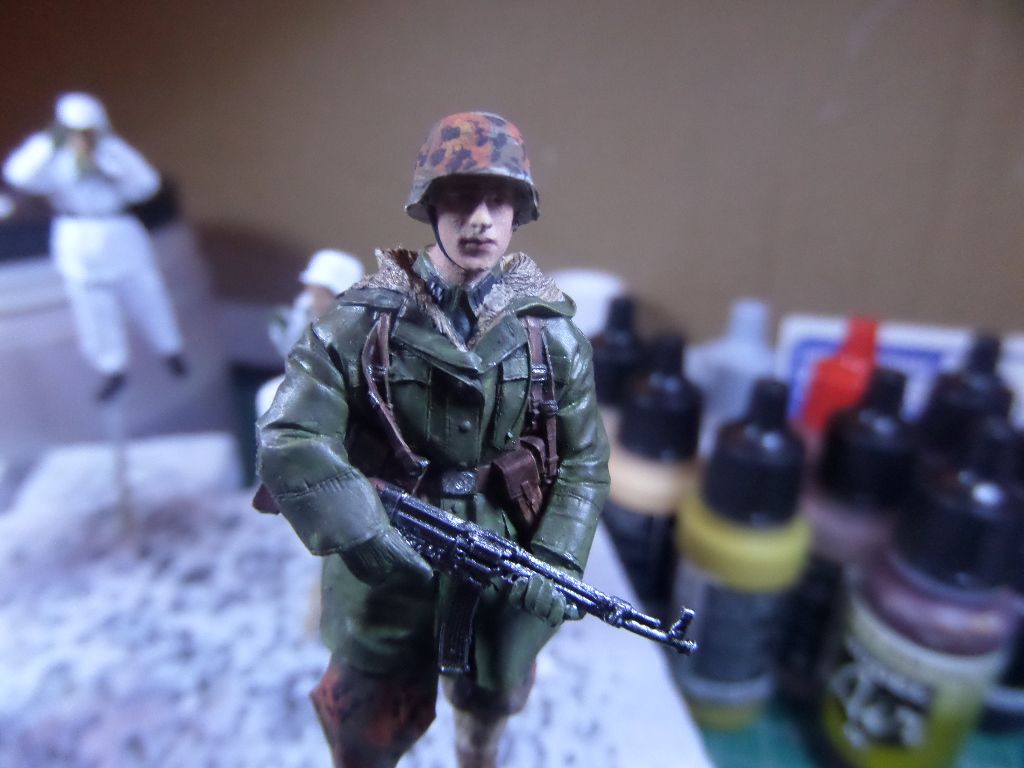

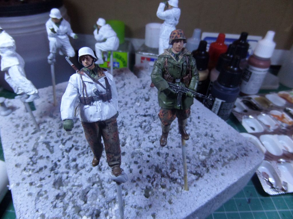

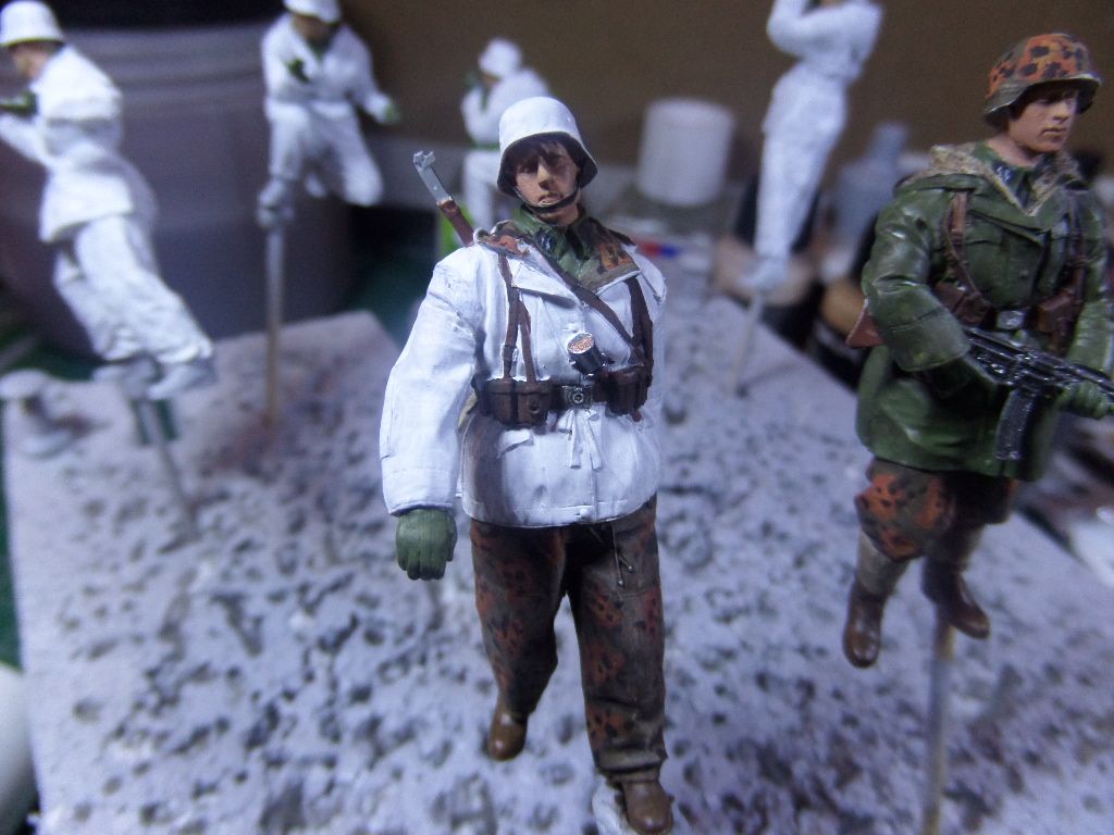

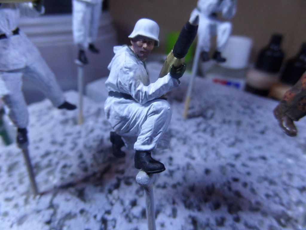

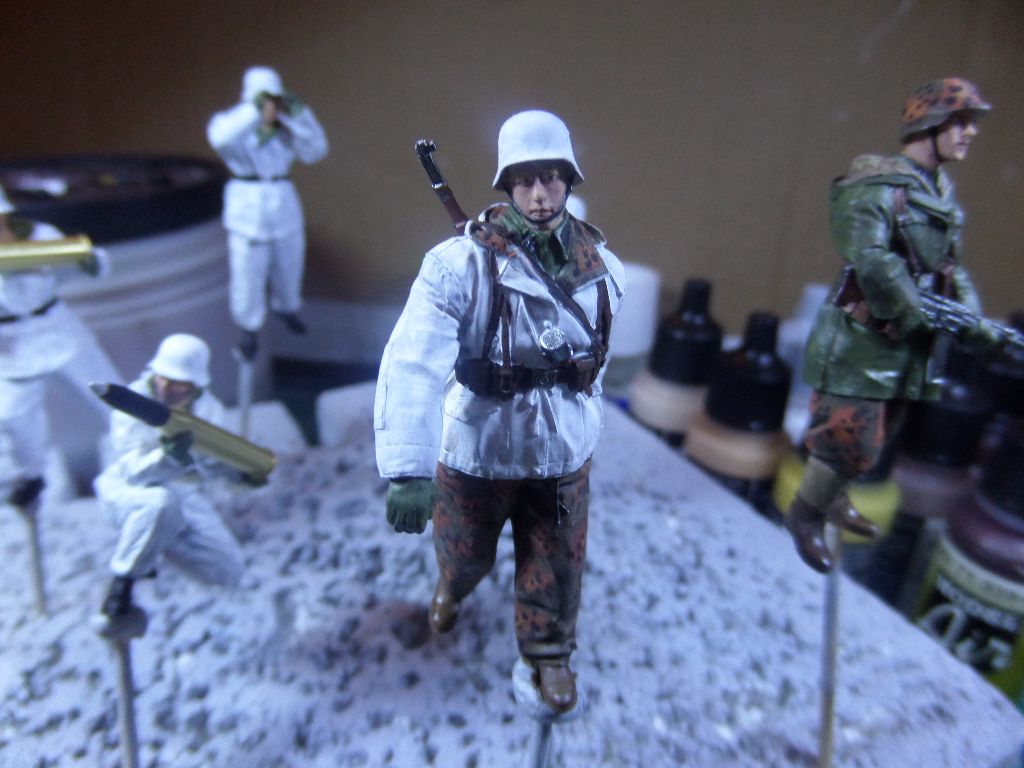

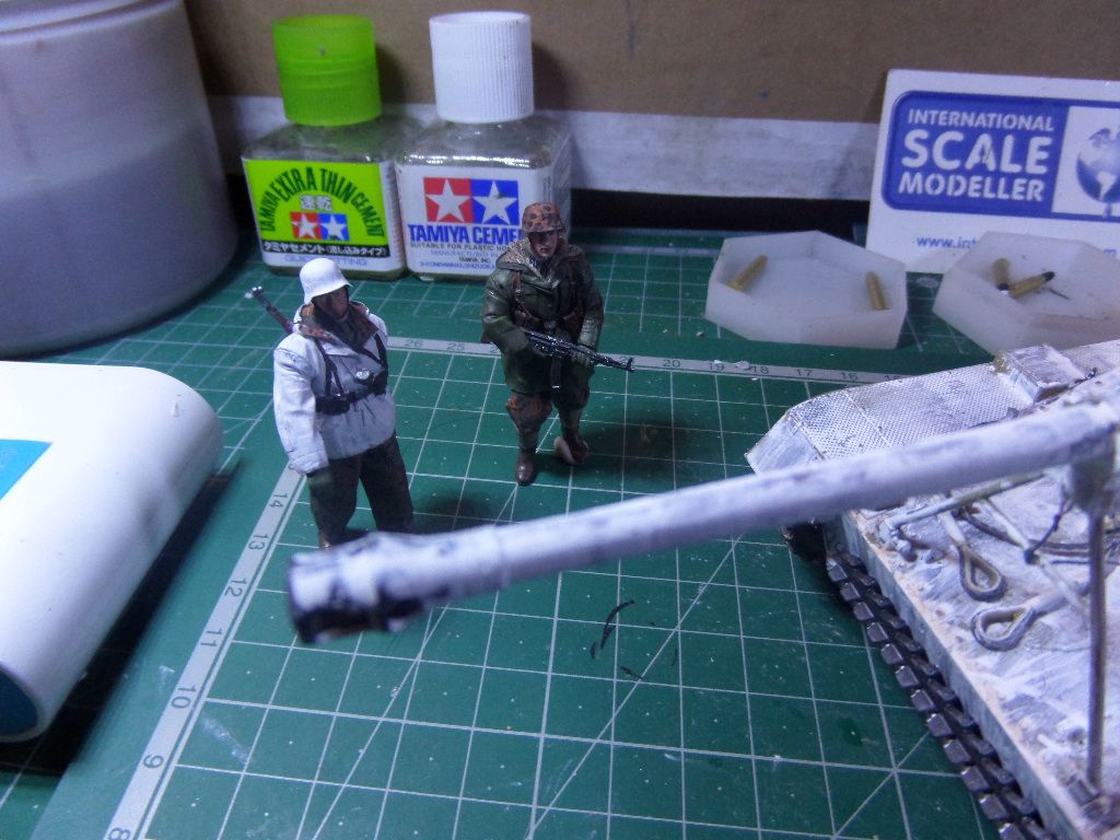

The SS grenadiers are being painted, used the new Andrea Set for Waffen SS camo (autumn colours )
Nice paints an easy to use
The jackets are done with Tamiya Paints , XF.2 white, and Dark Green XF -61 , the wood on the rifle and STGM44 was from Model Colour from Vallejo Mahogny 70.846 , and XF-10 Gun metal , XF-1 Flat Black , XF 57 Buff and X-18 and X-11 for the belts and ammo pouches ...

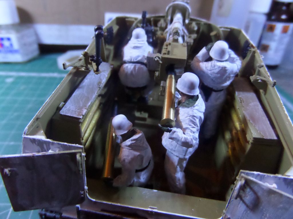

I try a littel unshaved effect on the two crewman with the ammo ...

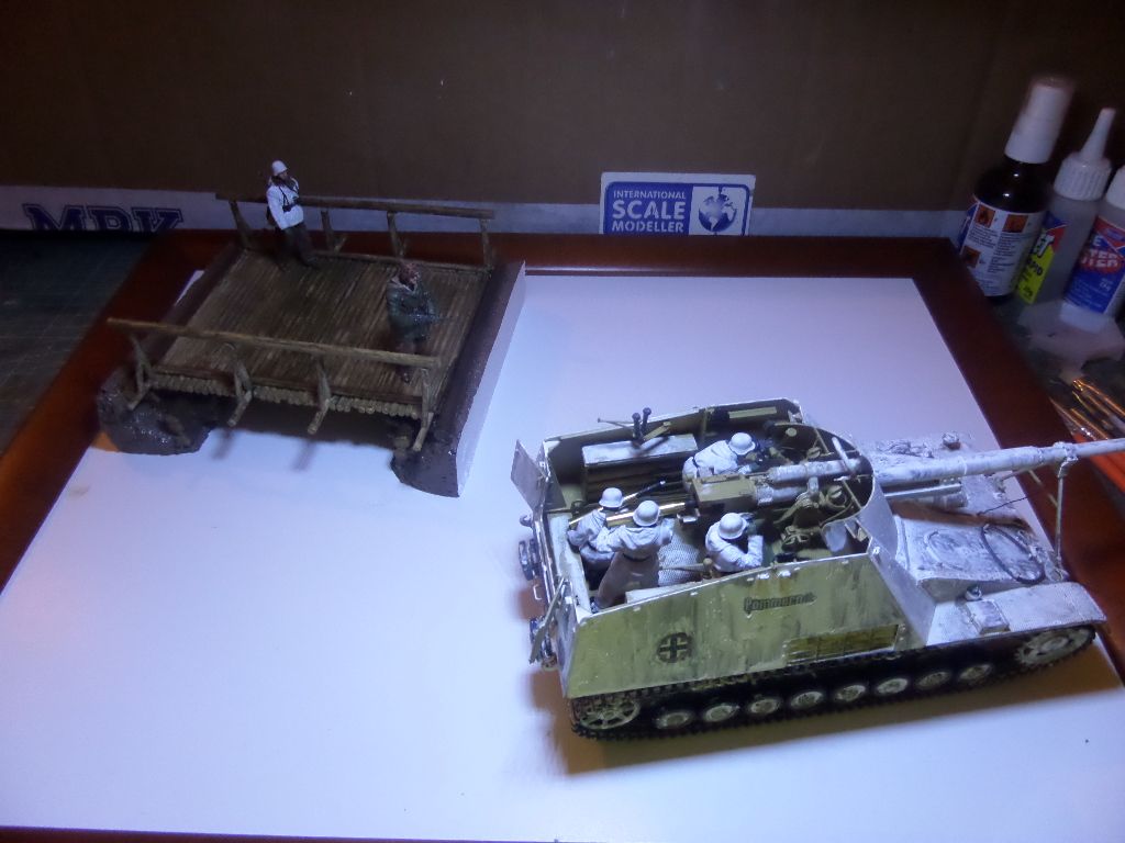

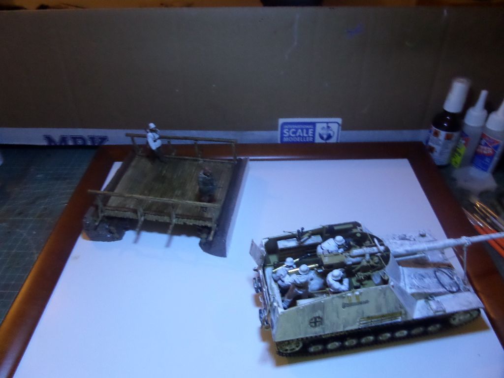

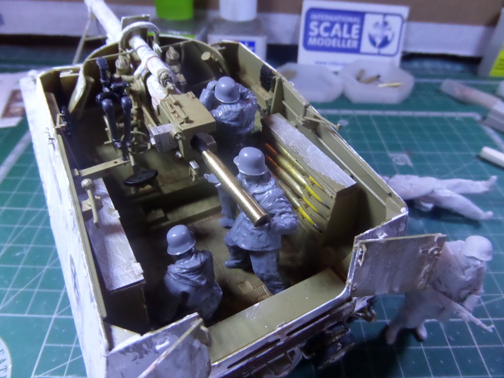

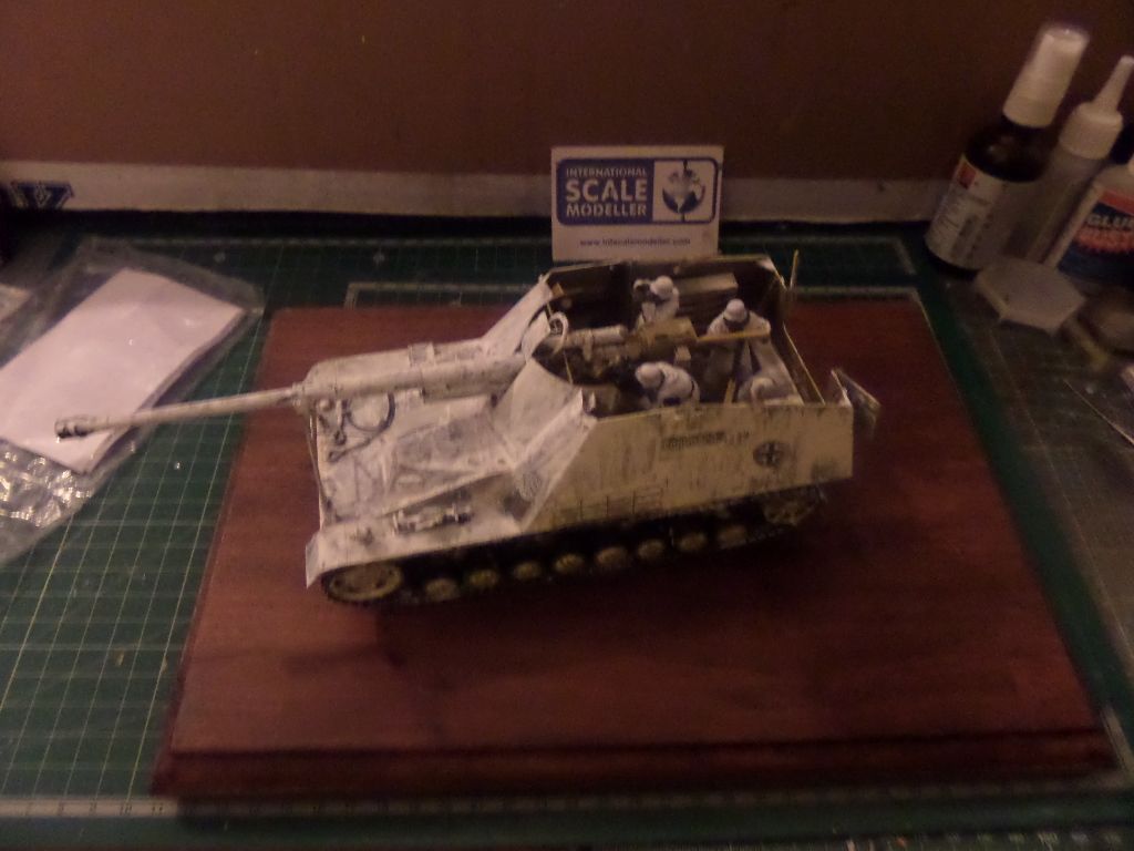

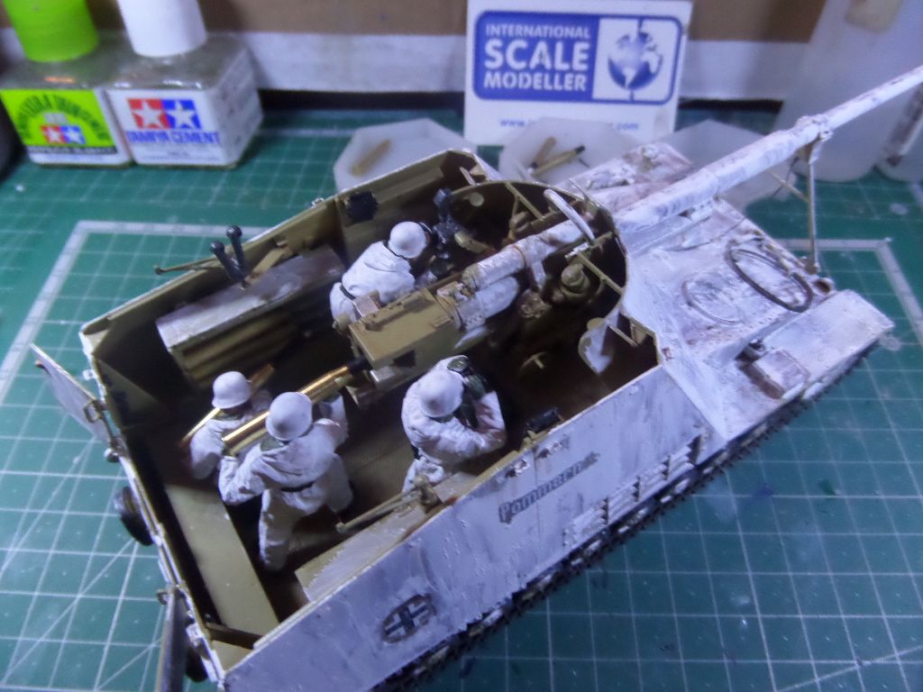

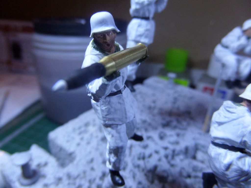

Crew at combat stations !!!

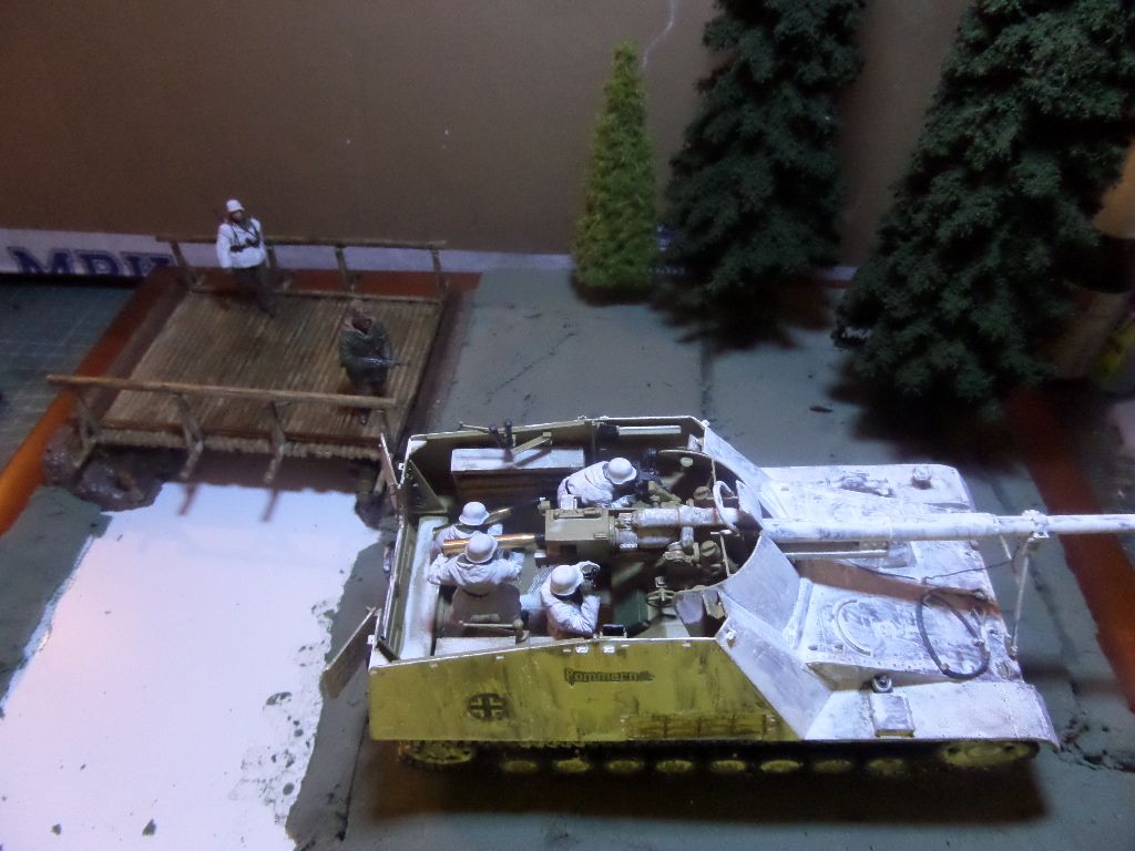

A very nice kit to do OOB in my opinion ...wonderfull kit , would have a go doing an Italian front one soon !
'Hey Franz ...that is a big Gun ! '

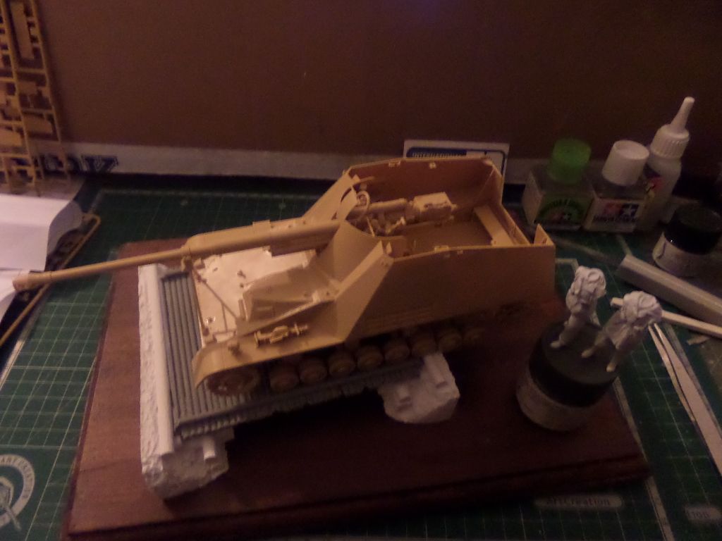

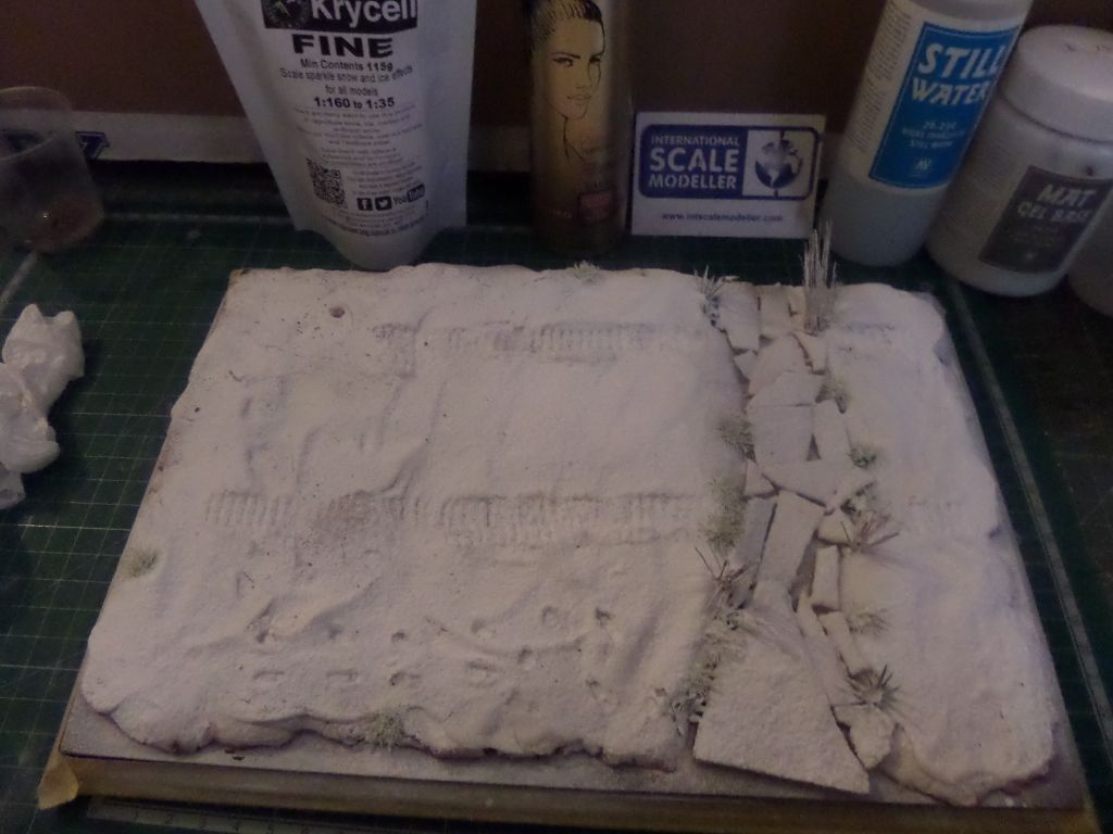

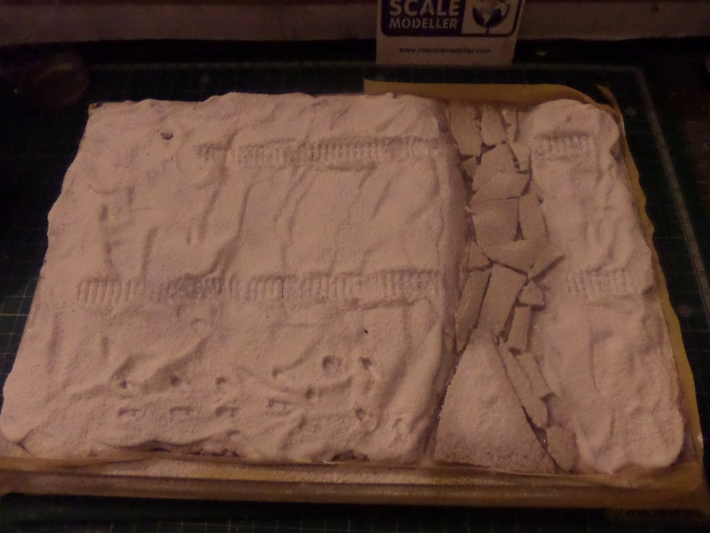

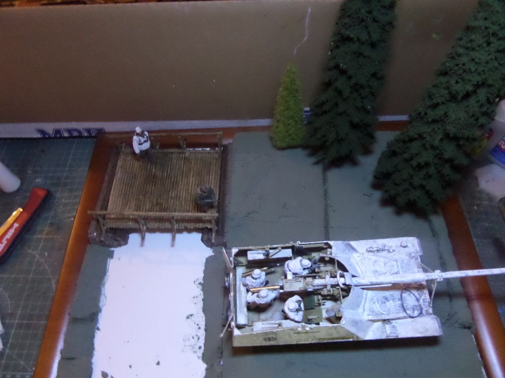

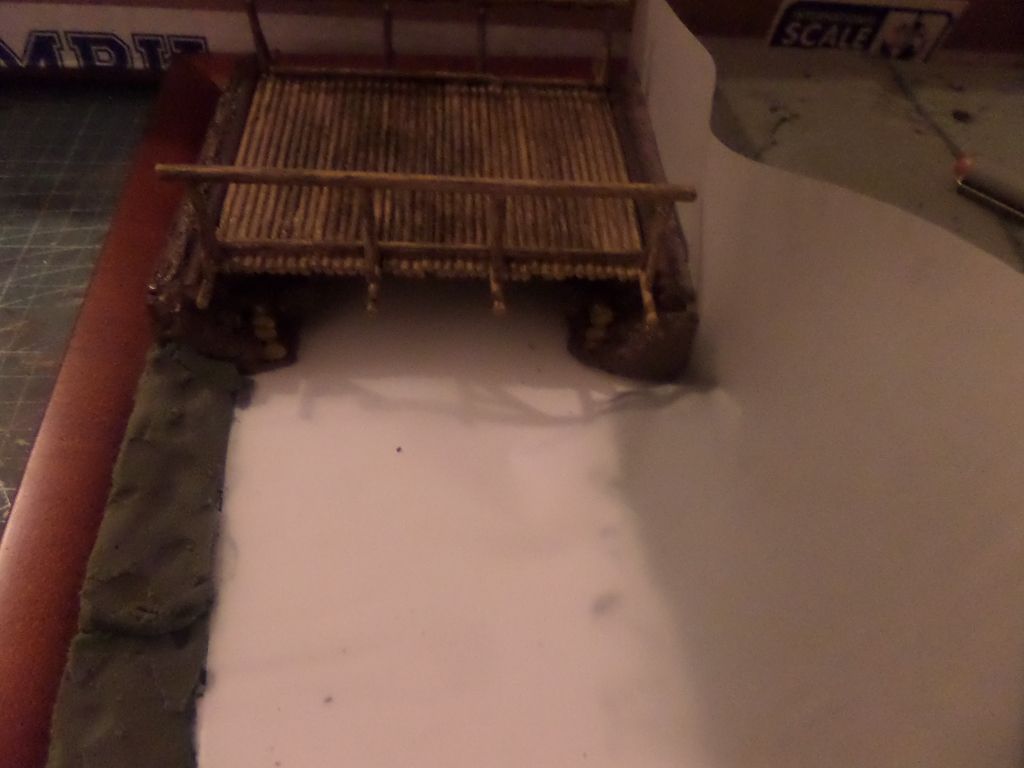

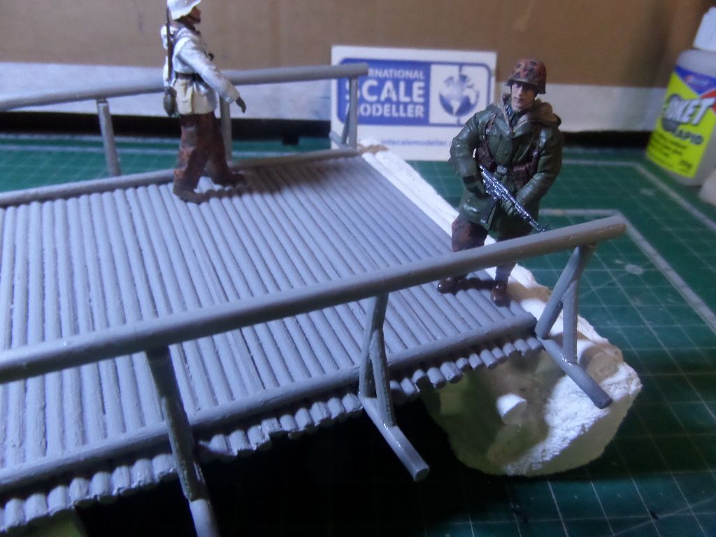

A first idea for the diorama ...again a big one , do not lke those trees to be honest , also do not like to have only the two figures , Like the idea to give all the winter environement that I can do , Ice under the bridge ...snow , the NAshorn crossing the frozen river and not going trough the Bridge ...

In this kit I found Tamiya had really upped their game on figures. The gunner fit like a glove.

So continuing with the build thread ...
I do the bridge now, it is from Royal Models
Looks easy to do :-)
Some resin and plaster parts ...
Some cleaning to do
And Glue all the resin parts
Black primer
The colours I'll be using for the wooden bridge
After painting
and now some washes from AK set for Wood
And getting the pices on the base ...

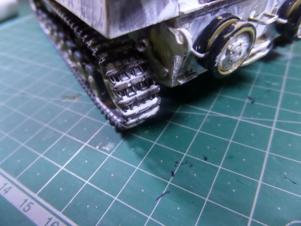

on the NAshorn , I decided to get a try on the Krycell winter wash ...
the tracks are too 'clean'
After some coats of the wash...great snow effect
Also inside the tank...the crew should get some snow inside ..
I will use this foam to the terrain ...a littel soft ...but that is what I have around ...
the base will be a frame
After I cut it ...
I draw the river shape
Not easy to do with the bridge and so ..
The ice sheetthat I will cut
Must use a dremel tool ,a mask and googles , as dust is hell ! :-)
Also cover all the terrain with some plaster
After the ice been cut to the right shape ...
we shall place the ice sheet in the freezer for half an hour so that we can break it more more easily
My idea is to depict the NAshorn crossing a small river , and break the ice in the crossing :-)
I cover the all surface with some gloss varnish ...use this one that I bought some months ago and never had the courage to use it in models :-)
Water ...for placing in between the ice cracks
two components , one coloured and with some debris on it
but...this all stuff not went well with the base i choose, impossible to have the water without spilling it all , I waste a wall bottle ...and by my mistake ,I can't use this base anymore...
also cracked the material that I use for the terrain ...too soft and not suitable for this
Will try to get the ice
Yes ...we learn form the mistakes...so Plan B ! :th:
Some DAS modelling paste...primed with white Primer ...ice pieces fit to the base ...think iy can be done !
Some water and some snow on the ice...nice effect!
Then some MAtt Gel Base from Vallejo
Let it snow...let it snow ... :-)
Nice !
Some foot prints ...and some Nashorn Prints
Some green turfs , herbs and Noch plants
place them here and there near the small creak
Hair Spray
And snow again
I liked so much the effect that the Nashorn wheeles will have the same treatment :-)
So now to have a littel tree ...and place the tank and figures for the final reveal !
Fianl reveal here :
http://intscalemodeller.com/viewtopic.php?f=583&t=21480
