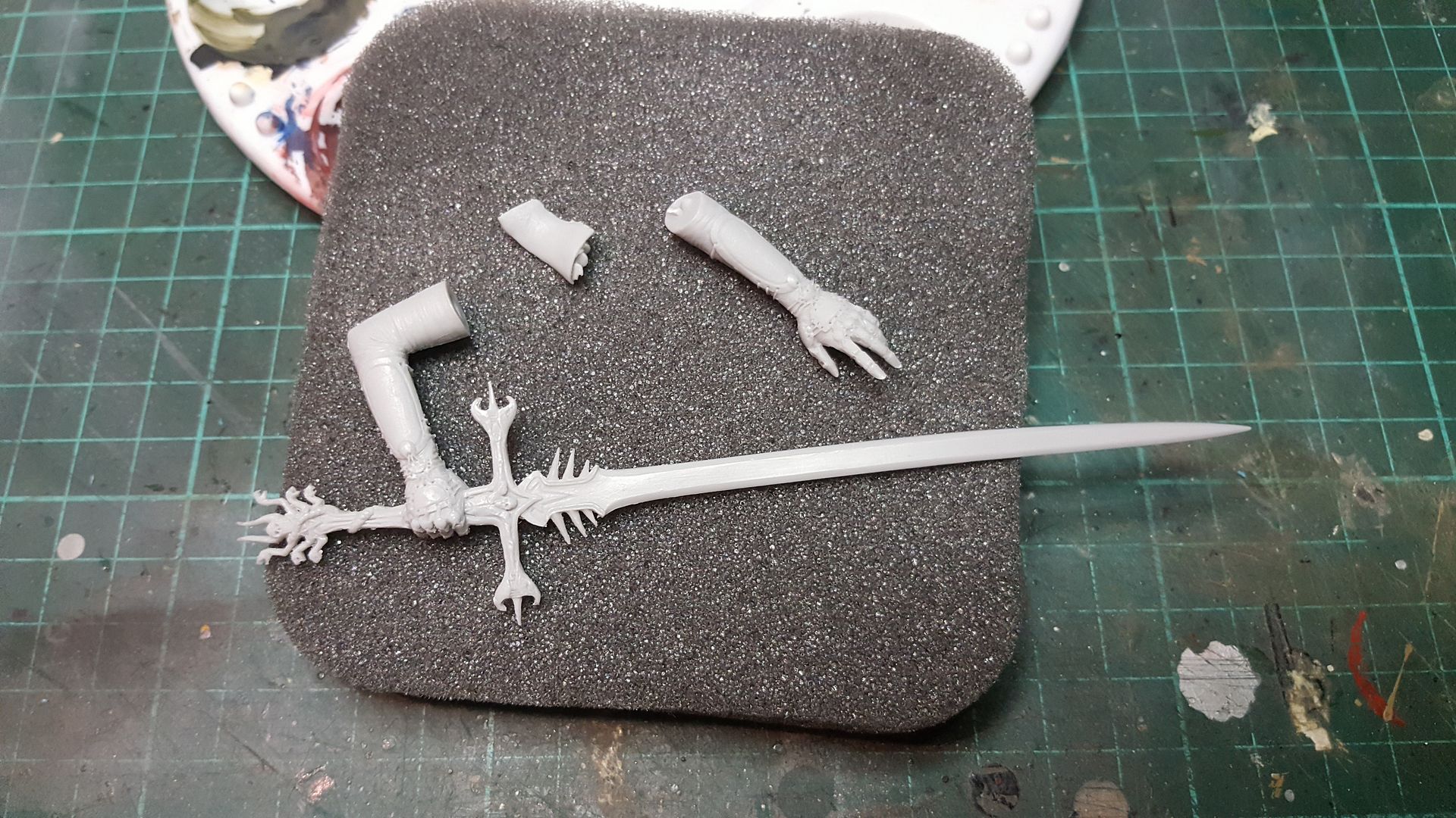

The kit comes in a nice metal box with the parts sandwiched in between 2 sponges for safe keeping

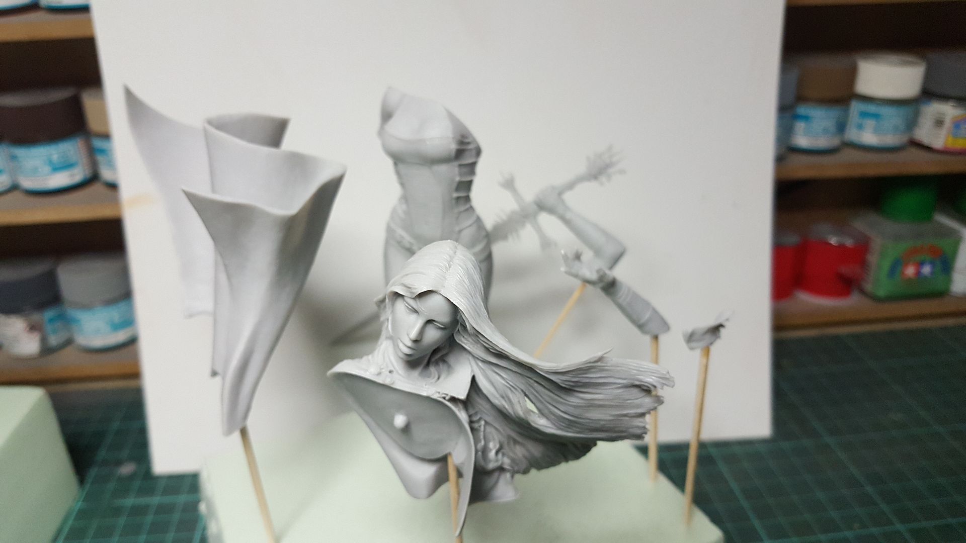

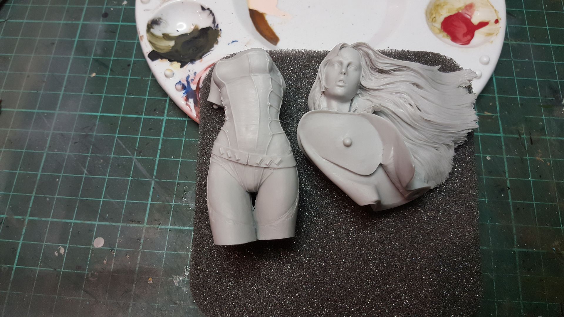

These are all the parts
Not that many parts but then again most figures and busts only have a few parts
The only problem i had was with the sword as the blade was bend because of the way it was in the box
The sword was on the bottom of the box and the body was on top of it so that pressed on the blade
But with some hot water you can soften it and bend it back

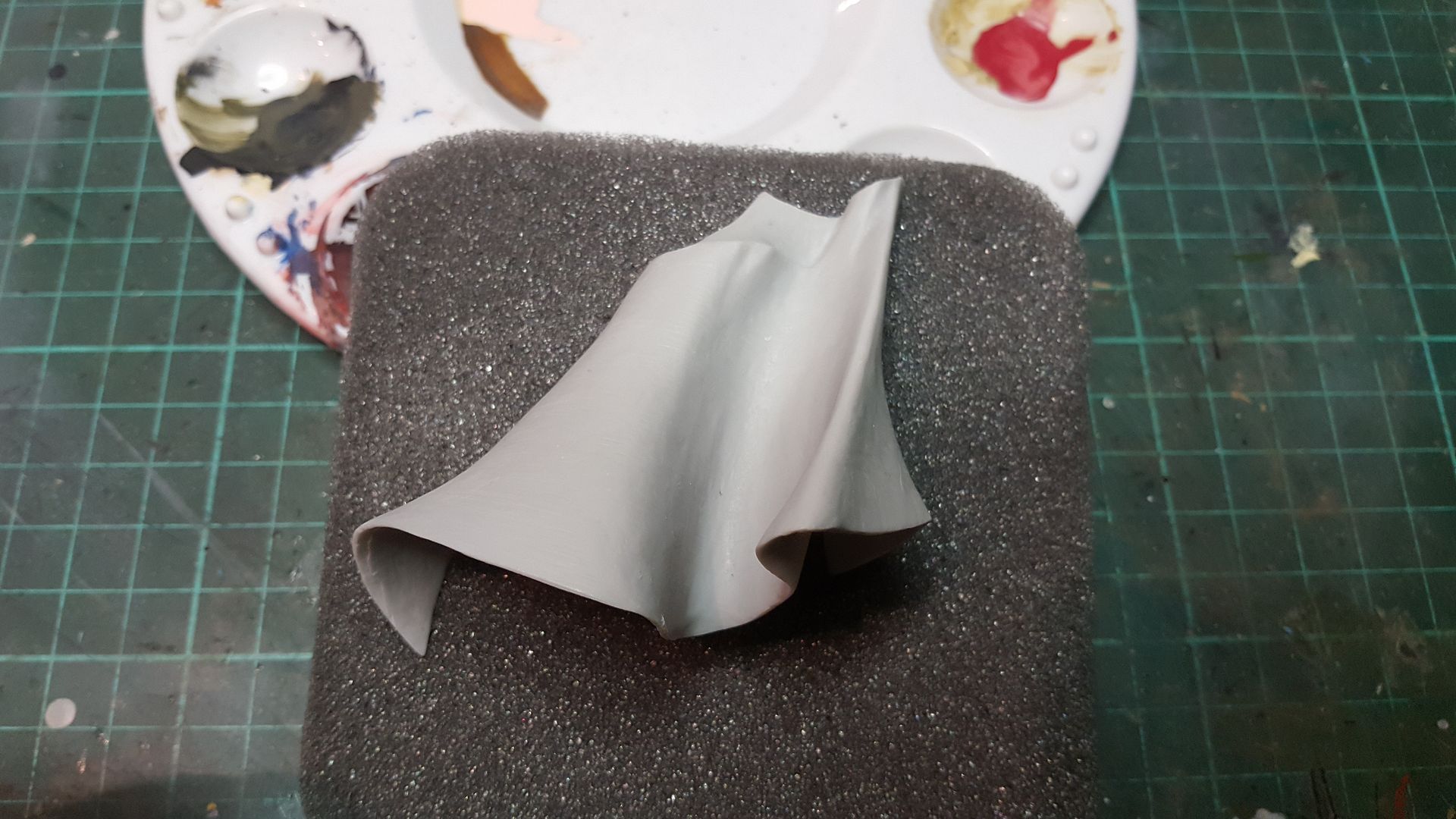

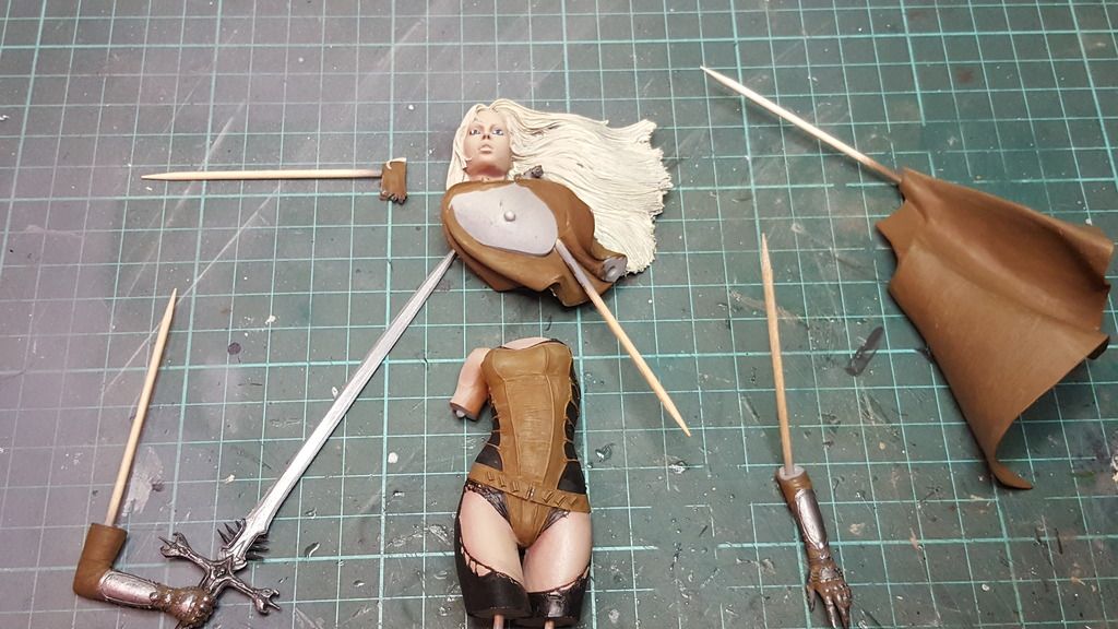

The first step was to glue all the parts to sticks to make painting and priming easier

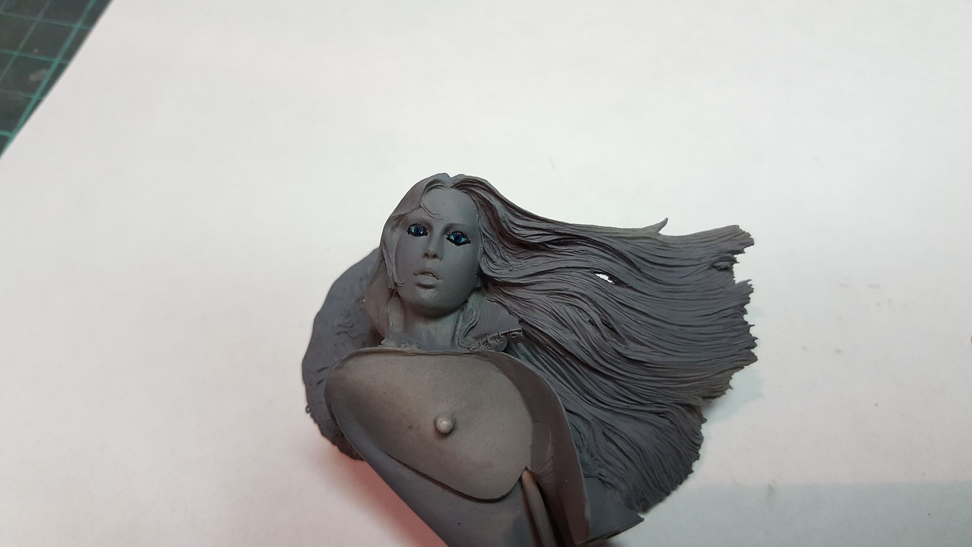

After a coat of grey Ultimate primer i started with the eyes
I use ivory for the white as a base then i painted the black outline
The iris was painted with Vallejo dark prussian blue
Then the centre was painted by adding some ivory to the blue to get a lighter shade
And finally a little dot of blaack to finish it
Once the paint was dry i uwed some masking fluid to protect the eyes from any other paints that may get damaged or get painted over them

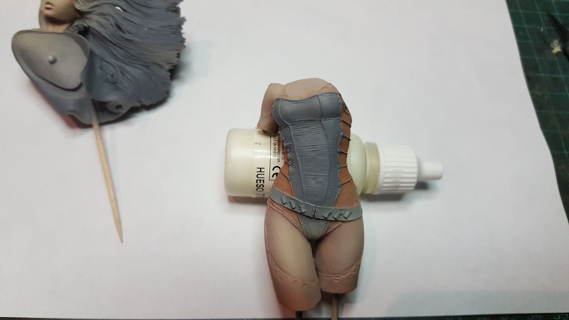

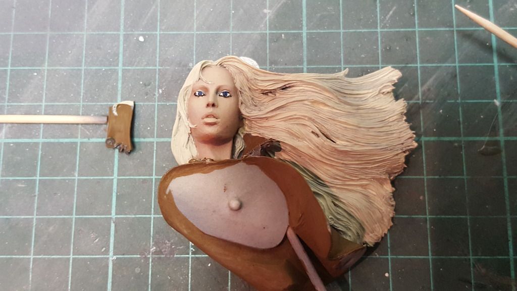

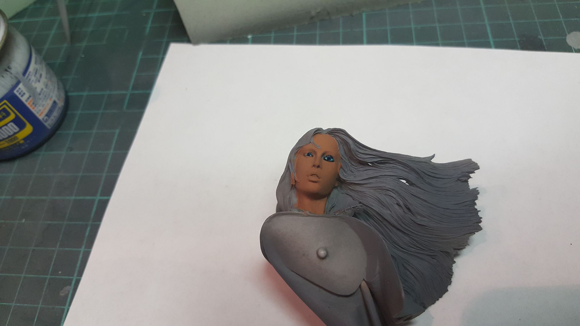

Then the flesh base color was brushed on
Then some shadow colors where added
It looks pretty harsh now but it will look better in the end
And finally the highlight color
This was applied with the airbrush but this light color was applied heavier in some places like the forehead that would appear lighter anyway
I used the flesh color set from Andrea for this
A very nice set of quality paints in my opinion
The flesh colors where also used on parts of the clothing as there are several holes and tears in those
When the black is added they are now visible

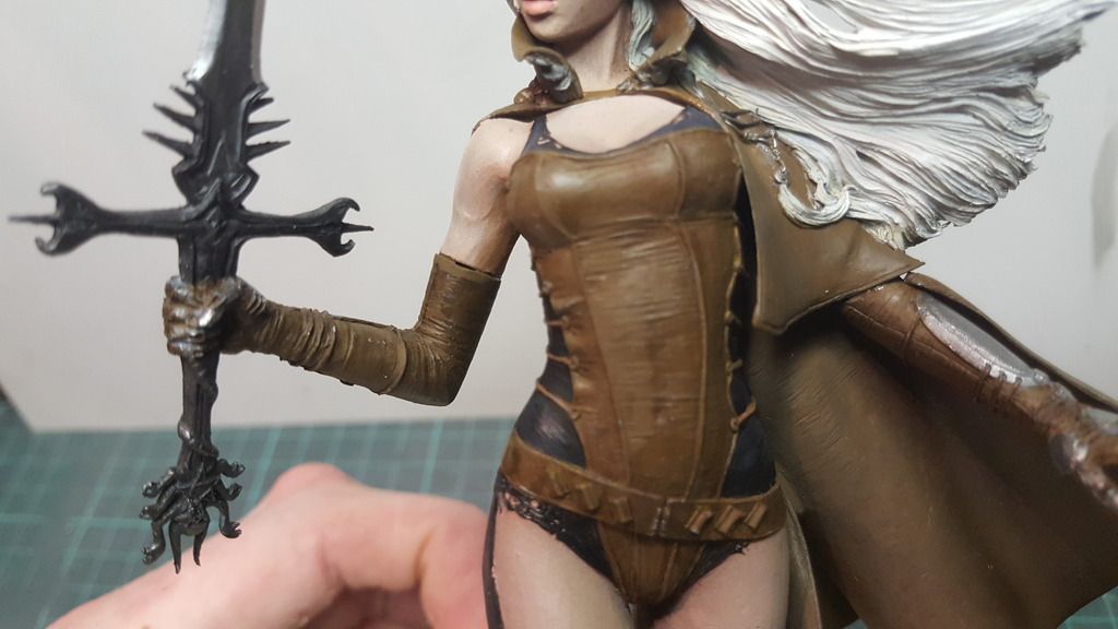

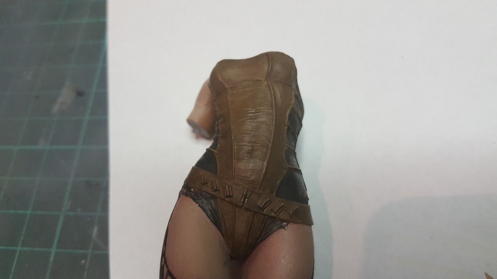

Then the brown for the leather and cloth parts was painted on
I used vallejo medium brown as a base and with the help of buff and dark brown i added the highlights and shadows
The cloth and leather both have the same steps but to finish the leather i used Vallejo smoke
This gives more depth and adds a bit of a shine to it aswell

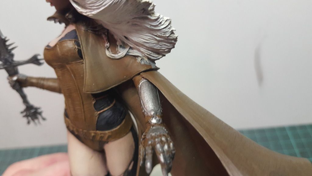

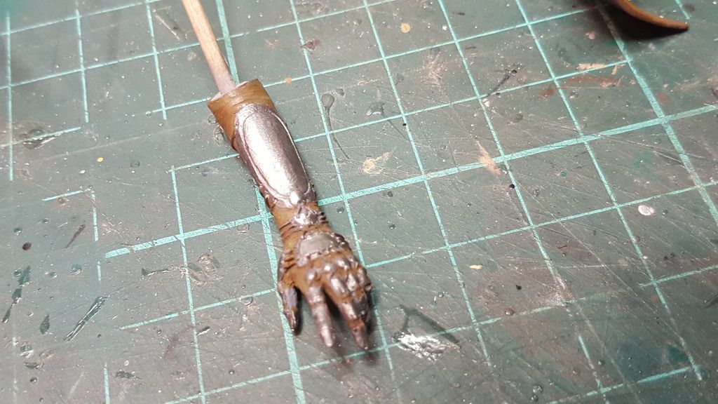

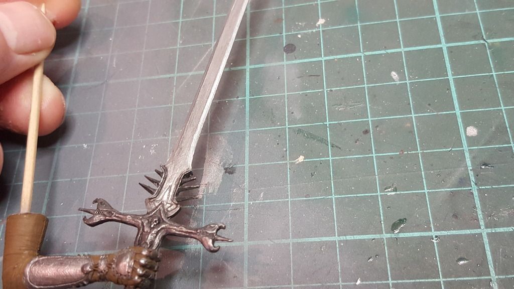

Then the metals where painted
I used 3 colors from the mr metal color range
I used stainless steel for the armor on the arms and the centre of the blade
The edges of the blade where painted in aluminium while the handle and spikes are painted in dark iron
Those where then buffed to get the nice metallic effect
The only drawback is that the buffing causes metallic dust and that was stuck on the leather parts so i needed to repaint a few spots
A closer look at the armor on the arms and hands

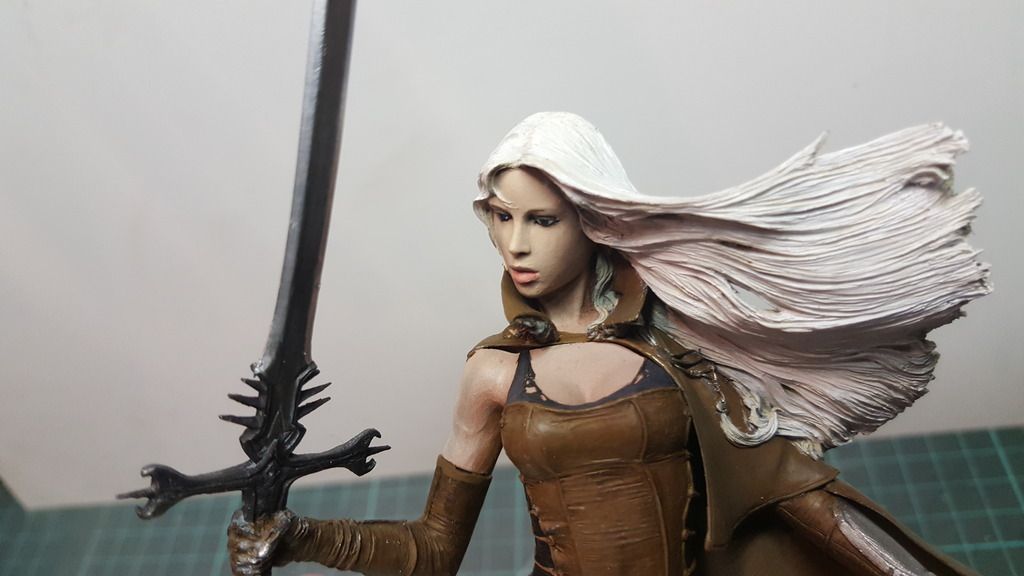

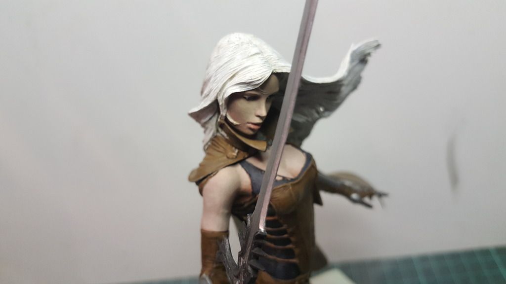

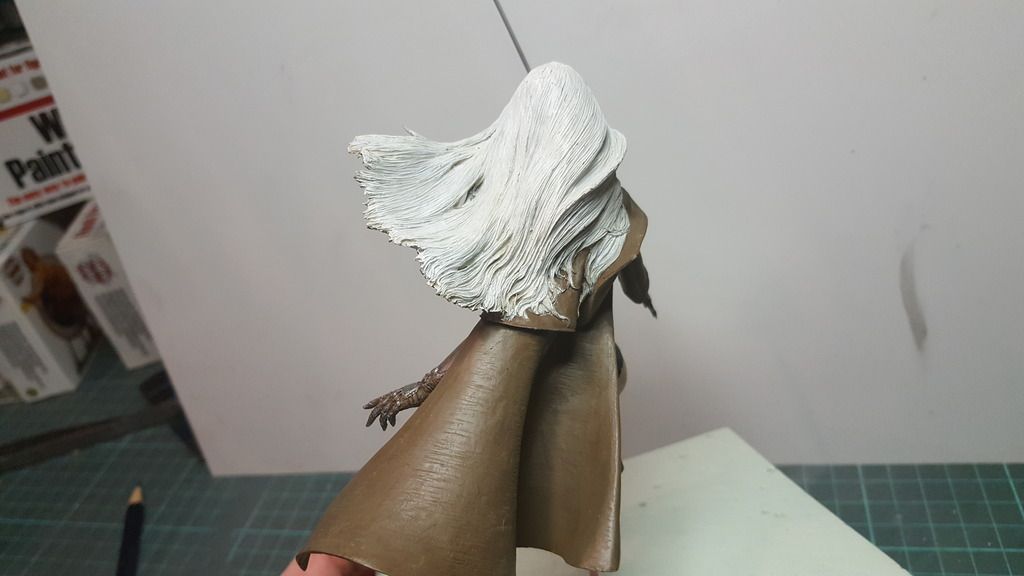

The hair was painted using the white set from Andrea
The highlight is white so all the others are darker
But this character has white hair so the darker colors add some depth
The effect of the smoke is a bit more visible here
The black was shaded aswell using the Andrea black set
This has black and several dark greys for highlights

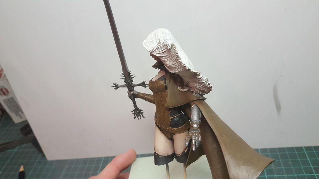

And then the parts where put together
The only part i painted the last part ,the lips
For this i used a Vallejo color but i'm not sure wich one
I think it is carmine red but i thinned it to a wash thickness and aplied several coats

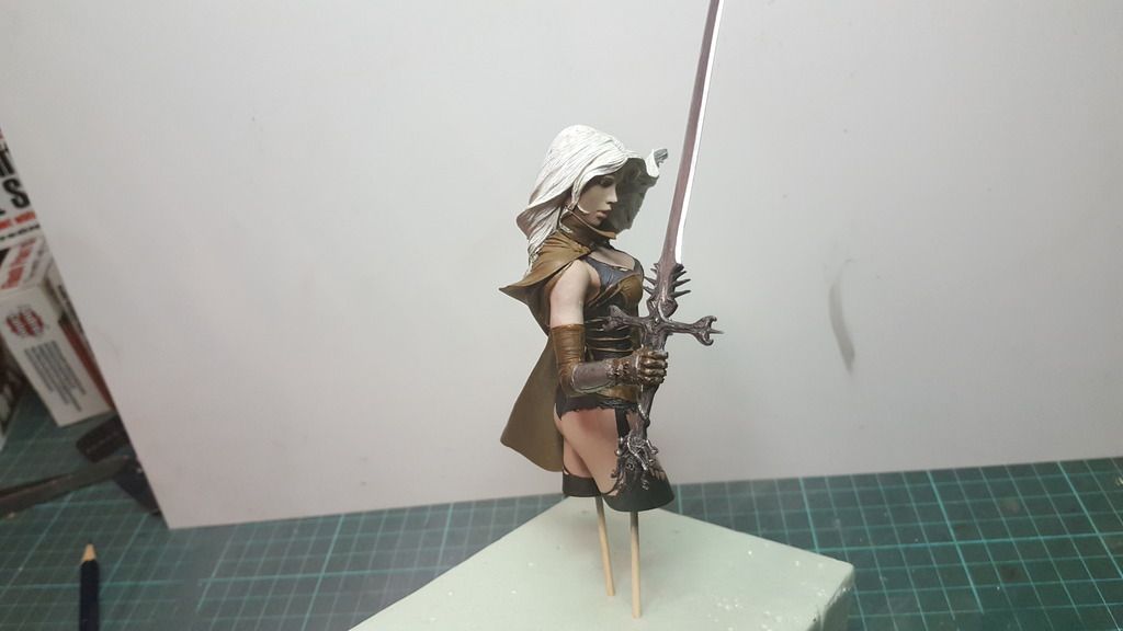

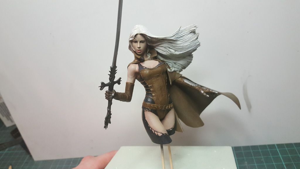

And this is how it looks at the moment
So the bust as they call it is finished except for the base

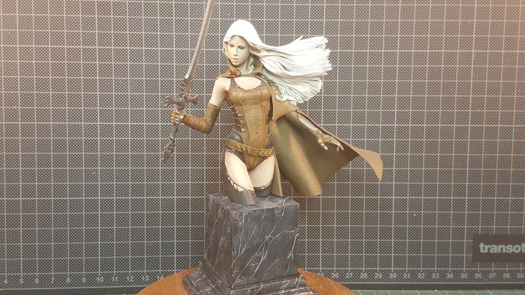

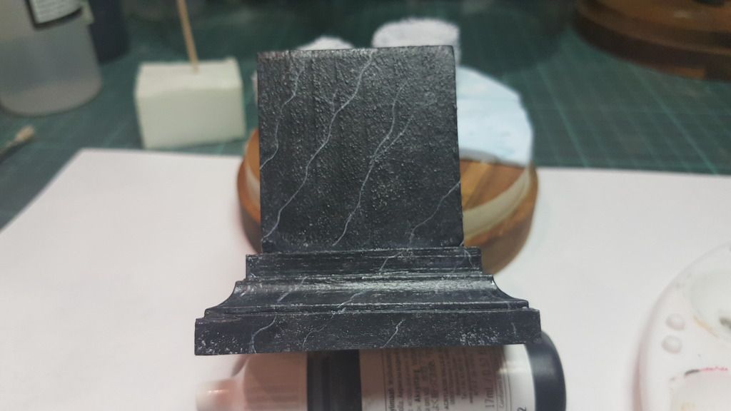

And then i came up with the idea to paint it like a piece of marble
Unlike a real marble stand this is much cheaper and much easier to get hold of
So how did i do it and what do you need
First of the stuff i used
1 wooden stand with a wider base ,others will do aswell either wood,resin or styrene
2 brushes ,1 small and 1 large
A piece of sponge
Some paints ,i used black ,sky grey and white from Vallejo for a black marble effect but you can make it into a brown or white marble aswell using different colors
Some clear coat or varnish of your choise
They way i made this stand

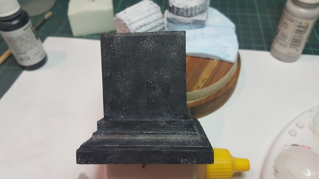

I started out by giving the wooden stand a black base
Then i used the sponge to add some color to the black
I mainly used the sky grey but this gives a pretty strong effect so once the grey was dry i repeated the proces with black to make it darker again

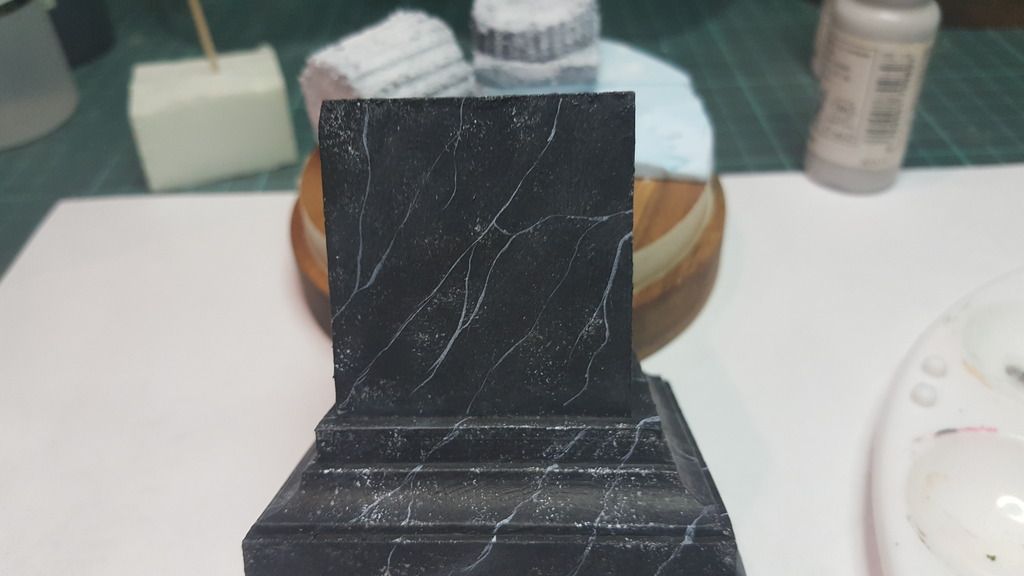

Then it is time for the most distinctive feature of marble
The lines
I used white for this wich was thinned with water to get more control and a finer line then with regular unthinned paint
And finally a coat of varnish for a nice finish
Now i do want to note 1 thing
Because i was a bit over enthausiastic i didn't sand the base to a smooth finish
So i do advise to sand the base to a smooth finish for a better effect
But that is all it takes to give a simple plain wooden stand the appearence of a rather expensive marble stand
And finally i glued the figure to the base
