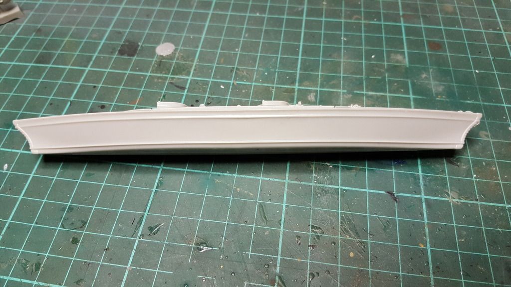

The canoe
For this build i want to recreate the box art
So some parts will get airbrushed ,like the canoe and paddles
The other stuff will get brushpainted

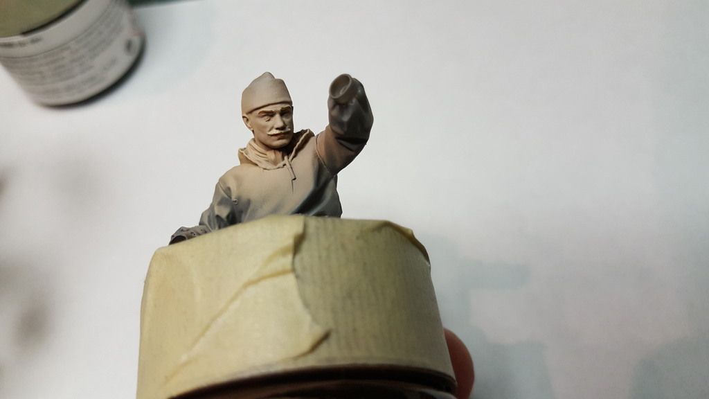

So here are the figures of the 2 Royal Marines

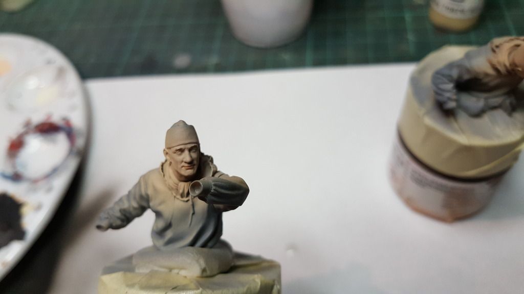

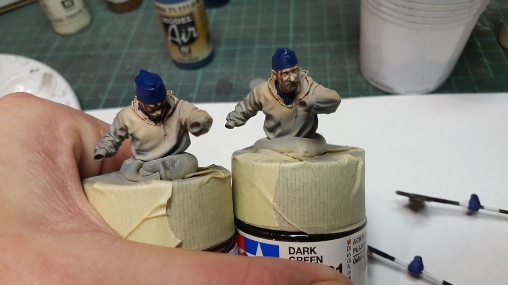

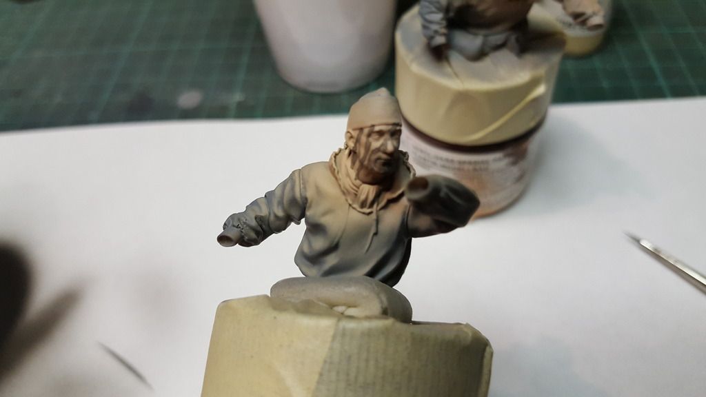

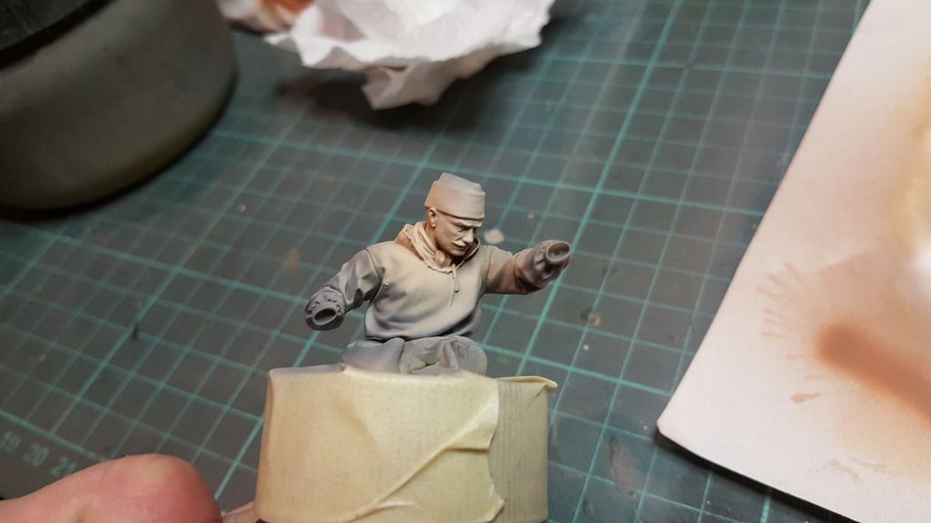

After a coat of Ultimate primer i sprayed the first skin color
It is base 2 from the Andrea skin set
I sprayed this all over the face

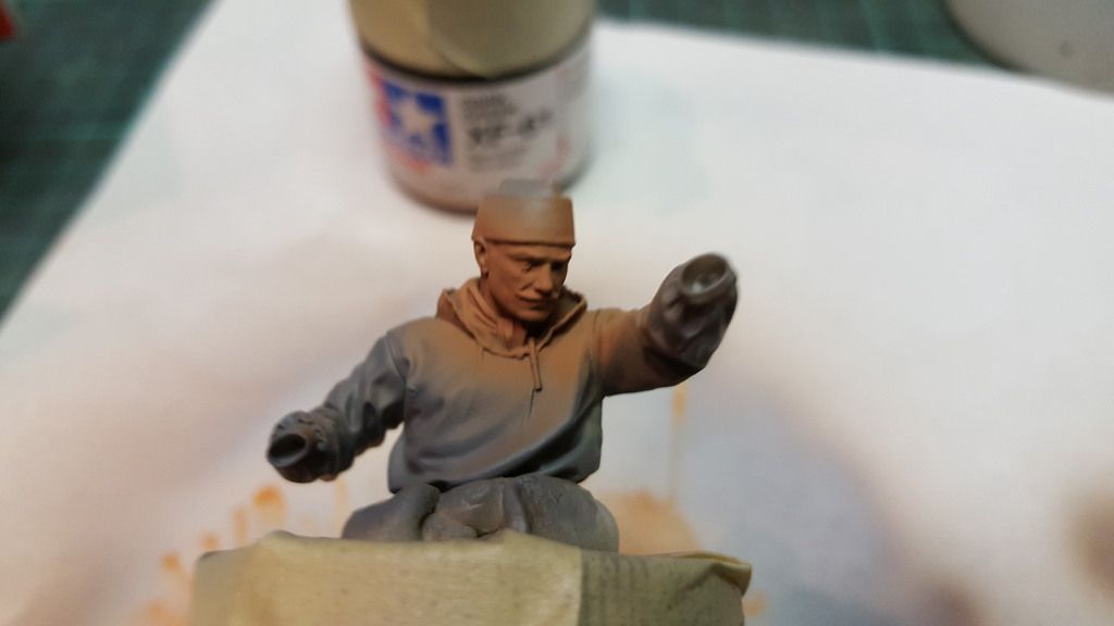

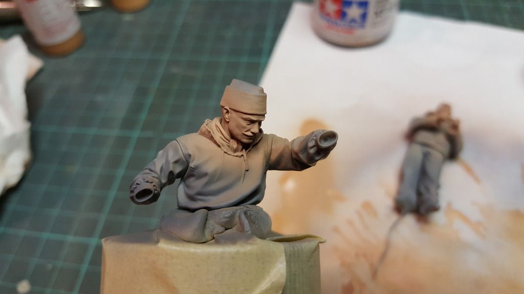

Once that was dry i switched to the second color
This is base 1
I sprayed this head on so i can't fully hit the shadow areas
Like the part underneath the chin
And finally i used highlight 2
Wich is the brightest color from the set
It was sprayed from the top downward
This way i can only hit the actuall highlighted parts of the face like the top of the cheeks and forehead
I have chosen to use only 3 colors because the figures will get camouflage paint on their faces so that would hide most of the face colors anyway
Otherwise it would look better to use the full set of colors

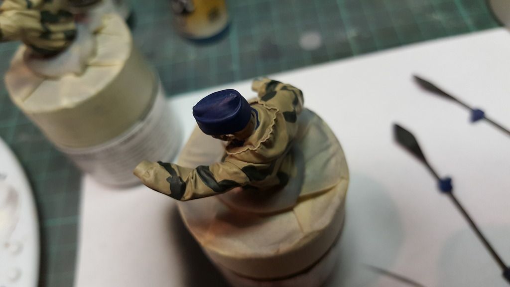

So with the faces done i moved on to the facepaint/camouflage paint
I thinned down some black and drew the lines on the faces
One thing that i wanted to do is have them a bit different fron each other so i made the lines on the Sparks figure more transparent
This way they won't look the same and it gives the idea that maybe one guy sweats more and the stuff wears out or that he just applied less

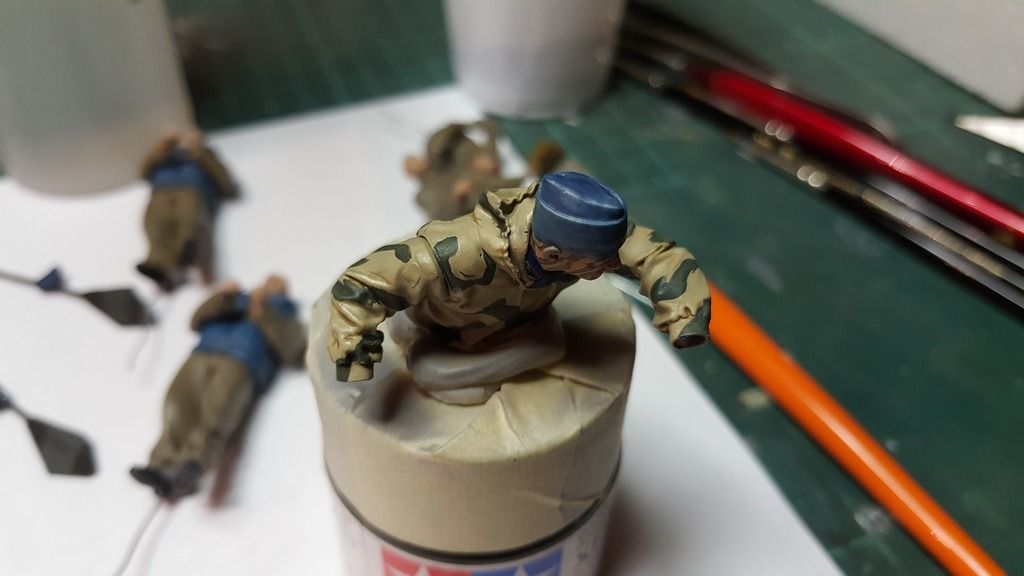

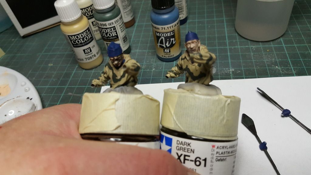

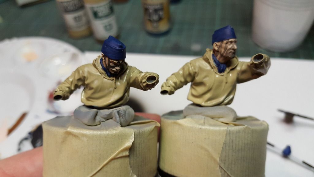

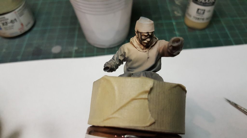

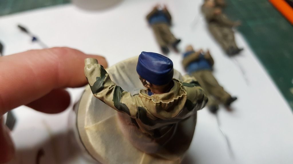

The hats where painted with a dark blue as a base color
The jackets where painted with a mix of canvas and buff to get a sand color
And the dark green stripes where added
I then added some highlights on the sand color
I used the color buff and apied that on the edges and higher areas of the jacket

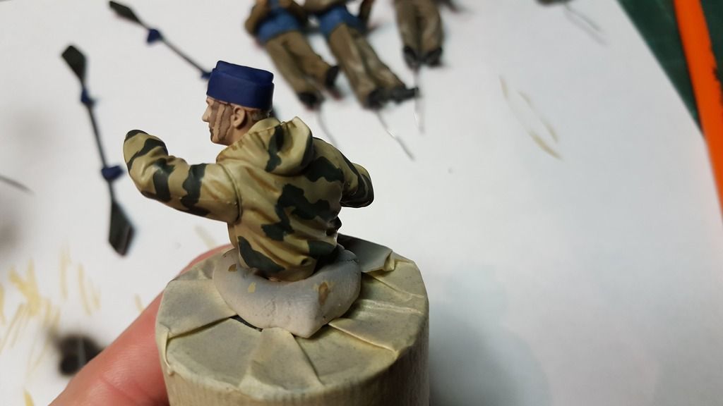

The hoodie shows it the best in this photo
Some dark brown was used for the shadows in the creases
With a bit of help from the natural shadows this will look darker in the end
It is hard to see but i used 2 shades of green to add the shadows and highlights on the green
Thehats where highlighted
Ssbut i already received a tip to do a bit more on them
But that will be done later on

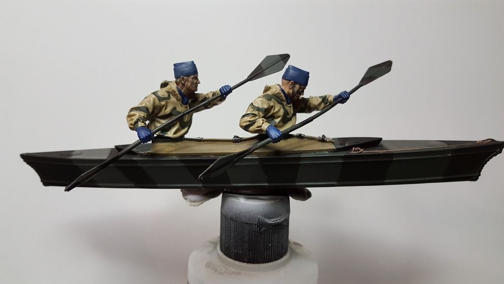

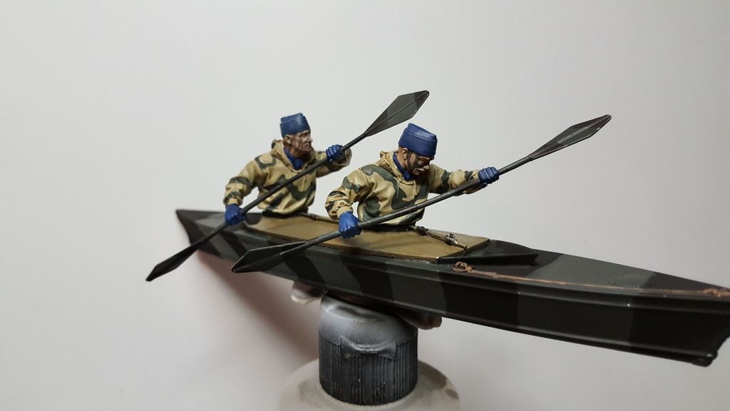

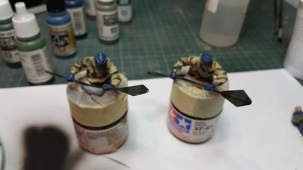

Finally the paddles where added to the figures
And just to see how it all would look i placed them in the canoe
They aren't glued in yet but it gives a idea on how it will look in the end

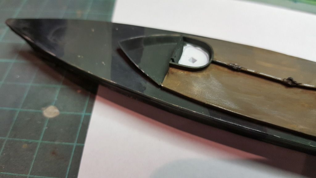

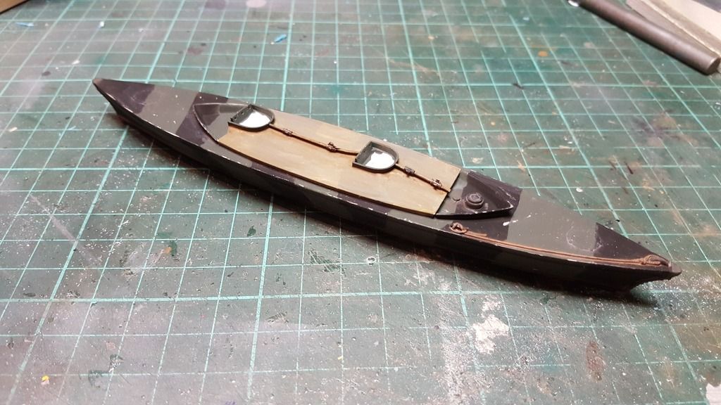

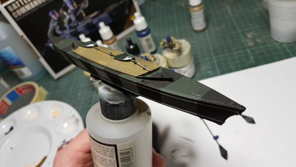

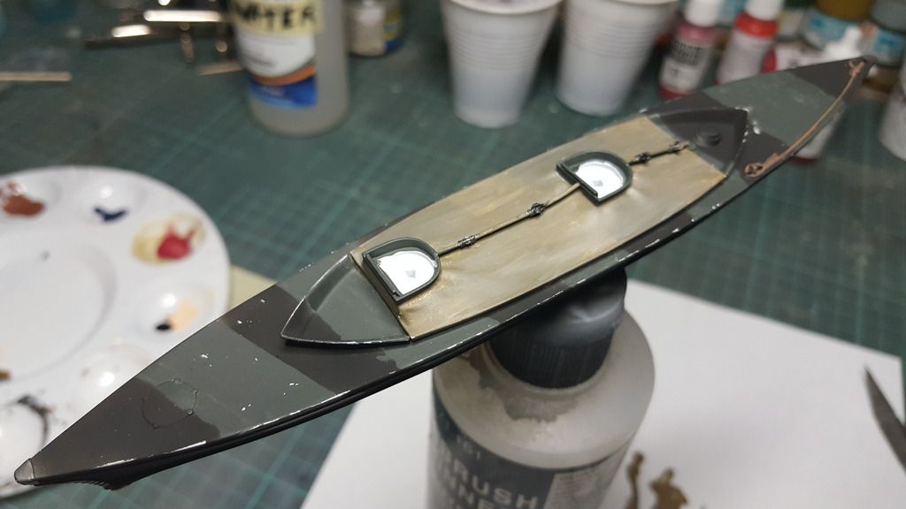

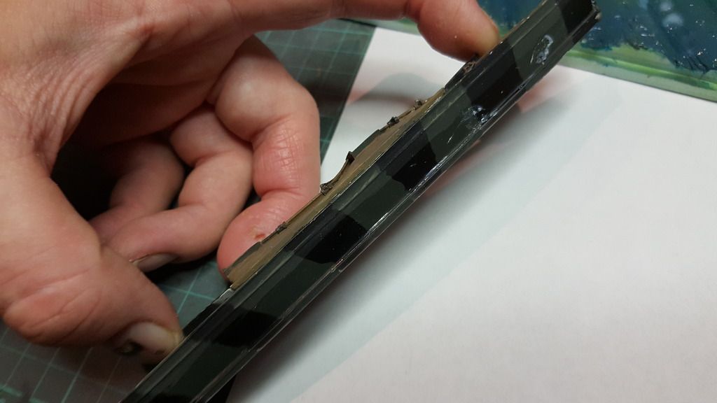

The canoe was first basepainted
I used tamiya black to spray it black while the dark green stripes where brushpainted
In real life they where black with the stripes brushed on so i figured i would do the same
I used canvas color for the tarp and some light brown for the rope
I then added some chipping
Allthough these canoes where pretty new the Royal Marines did train with them so they where already used
So some damage to the paint would be expected
Besides that it looks better

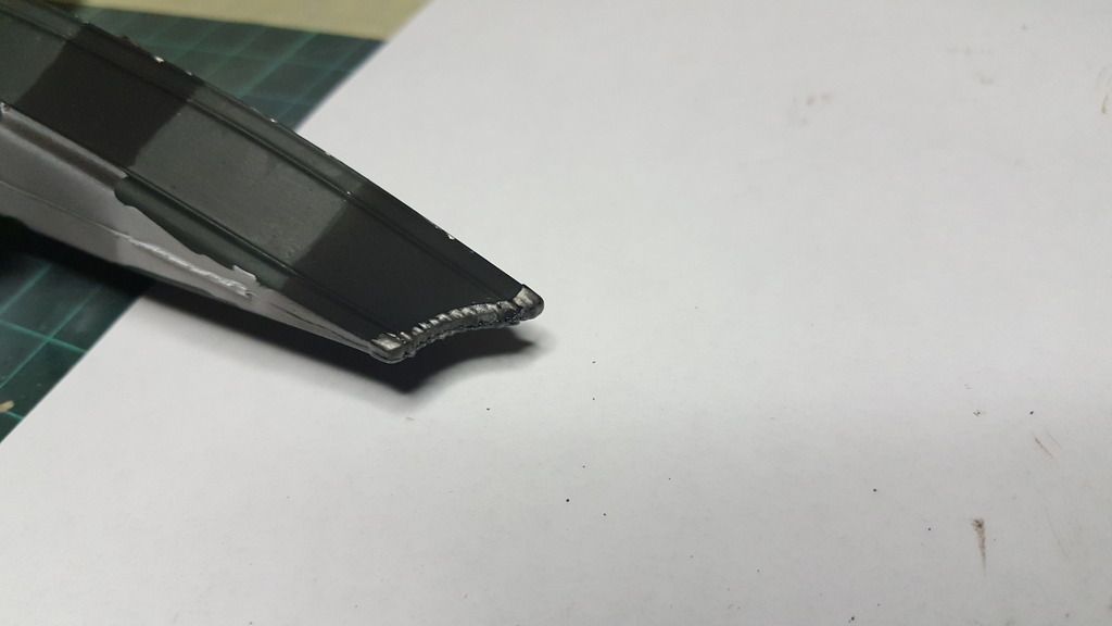

Because the canoes where made fron aluminium wich can easily be damaged they have a steel reenforcement on the bow and stern
I painted that with mr metal color stainless steel
I then used some sand colors to add shades to the tarp
After that i used Mig prod neutral wash and brown wash
The brown was used on the rope and tarp and the neutral (light grey) was used on the canoe itself
It was then coated with some ultra matte varnish from AK to finish it
Finally some dry brushing to make the edges stand out a bit
I then added the Vallejo clear water texture gel to make the sides of the canoe look wet
It is white but dries to a clear glossy finish
But at this point it is easier to see

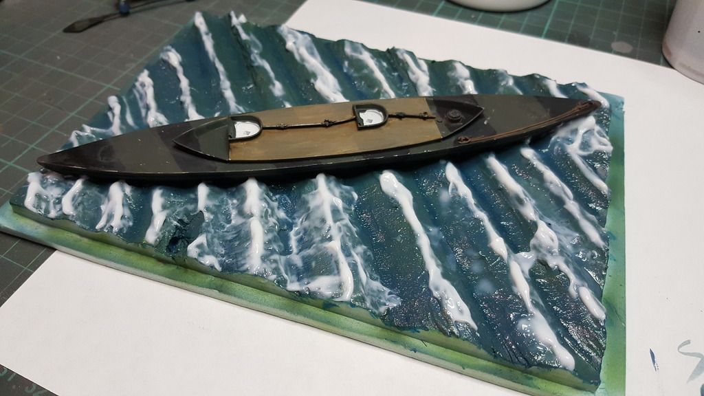

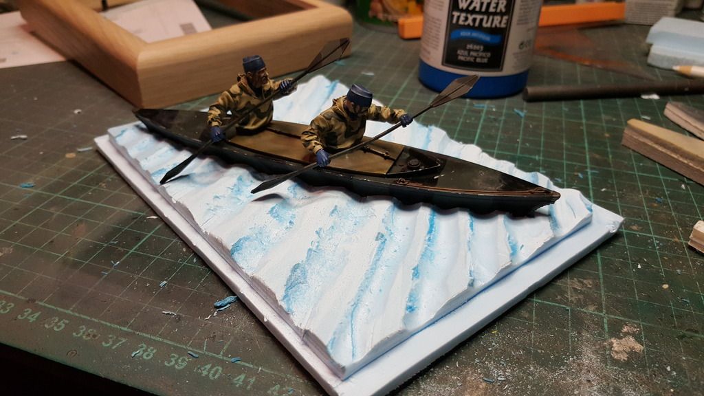

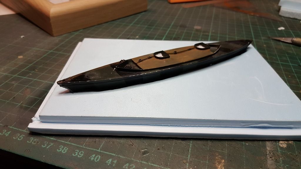

And now that the canoe is finished it is time for the little seascape

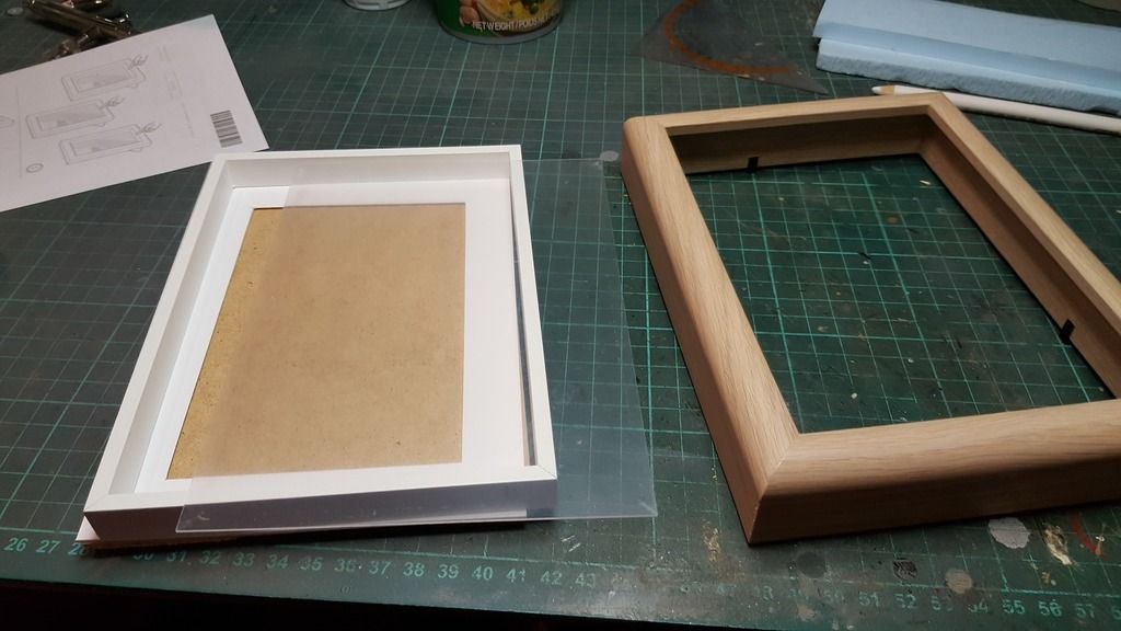

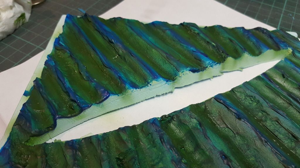

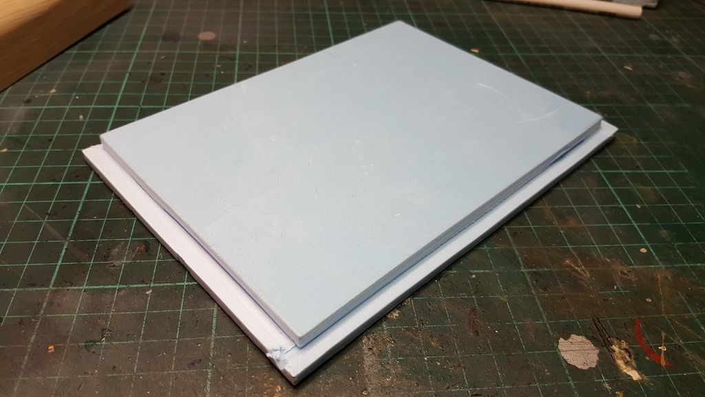

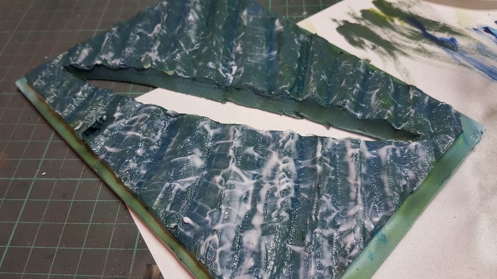

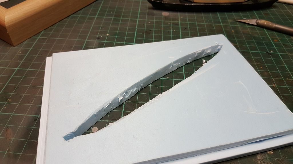

To make the seascape i used a picture frame and some blue foam sheet
The sheet was cut to the required size and i made a little step on it
The step will fit in the frame but only the centre will fit the inside the rest is for support
I then made a hole for the canoe
Seems to fit pretty good
I then used my dremel tool to make a basic shape for the waves
They should only be small as this operation was in a harbor

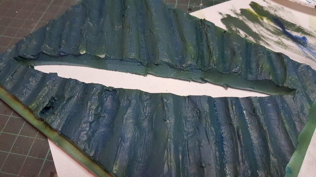

I then covered the base with a thick layer of the Vallejo water texture and left that to dry for a day

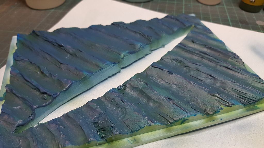

Then i used some blue and green paints to add color to the water

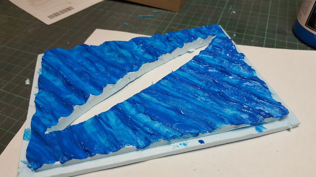

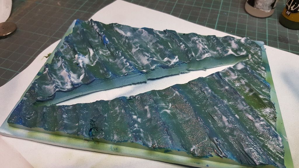

And a layer of the clear water gel was added
After it was dry i turned back to the paints to make the colors a bit nicer
The first attempt wasn't really what i wanted so i just tried again
And a second coat of the clear water

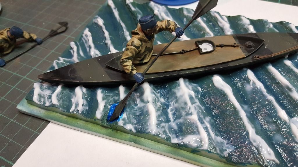

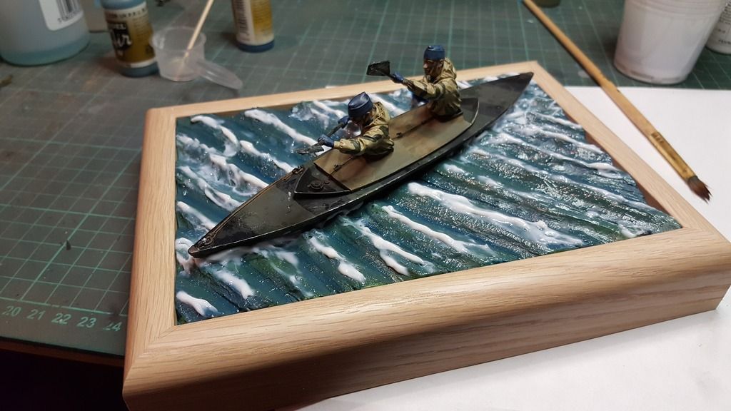

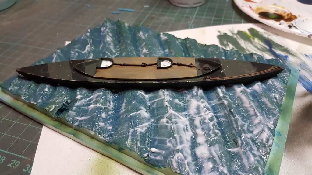

Once the first layer was dry i placed the canoe and added a second layer of the clear water texture
Once the second layer was dry i decided to add a smaller layer on the tops of the waves to make them stand out a bit

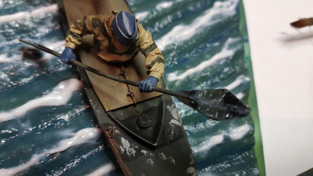

Because the Sparks figure has the paddle in the water i had to make a small hole for it
This was then filled up with more water texture gel
And finished the same way as the rest of the water

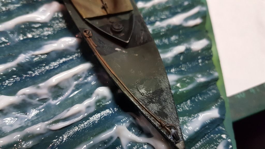

Here the splashes are a bit more visible
The paddles/oars where also covered with the clear water to make them look wet
And finally i placed the seascape in the picture frame and called it finished
