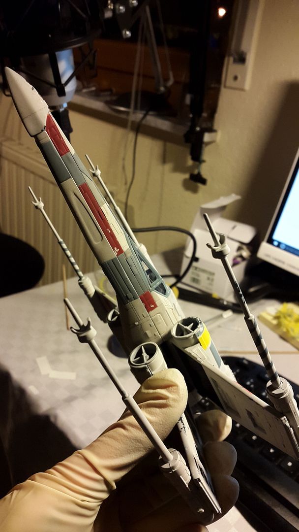

Hello there,
I haven't really found much about this topic, so I'd hoped you could possibly help me out:
I'm currently building an X-Wing on which I'm picking out individual panels:
Now I have googled reference pictures and build threads a lot and I came across this:
Which in the end turned out like this:
I was wondering how that guy managed to tone the blueish panels down to contrast less to the base colour.
Thanks in advance!
