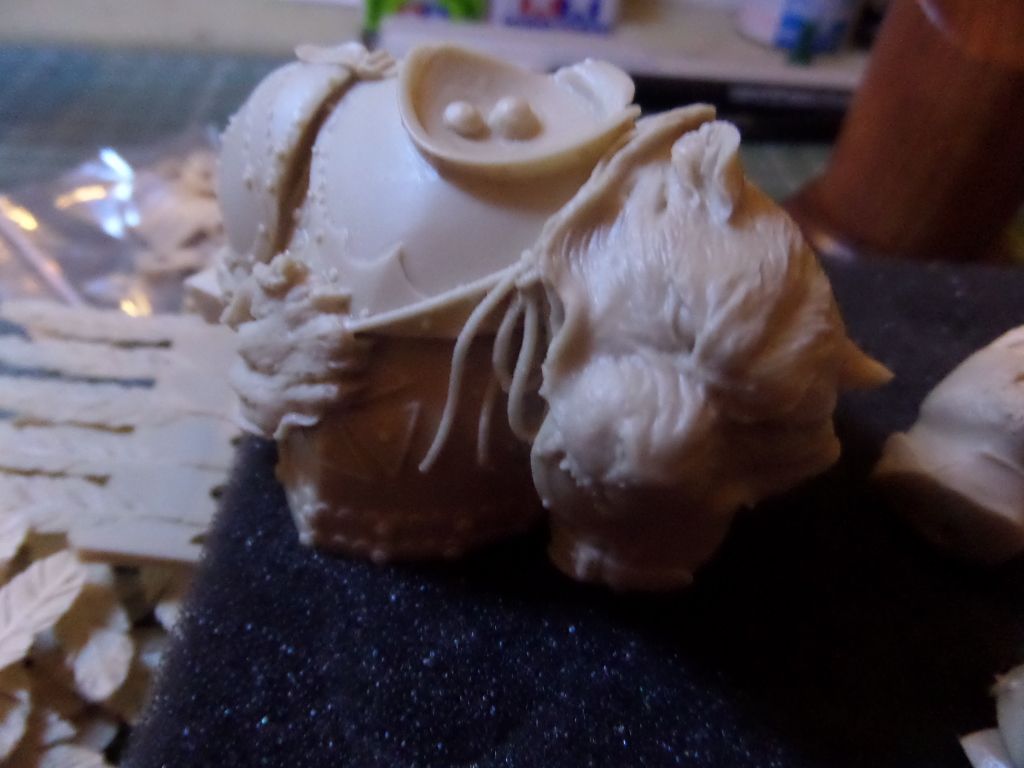

Overview of the figure :

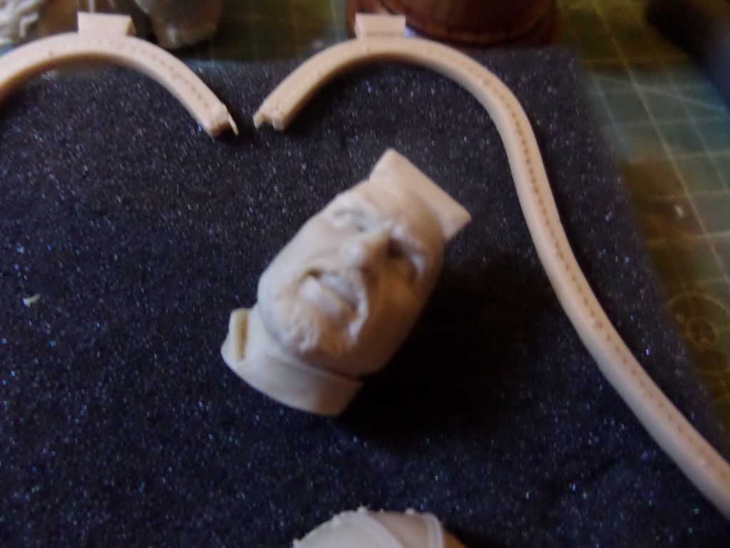

nice detail on the head/face

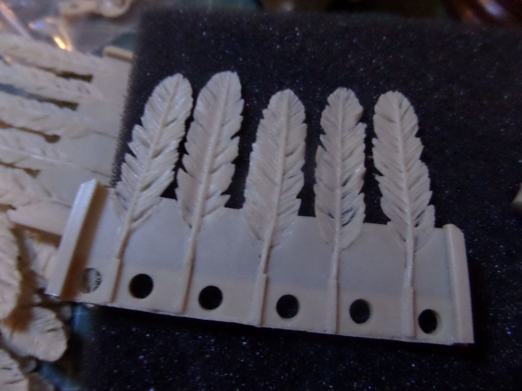

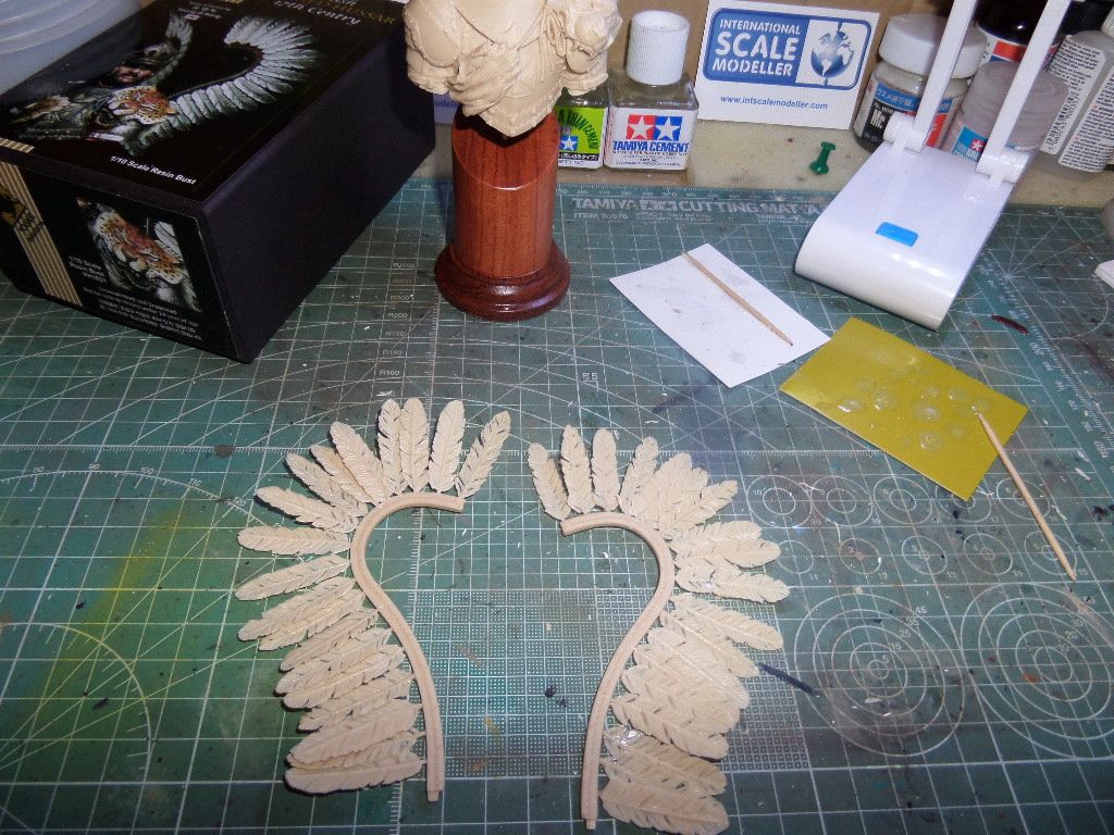

Feathers ..lot of them ...
A new chalenge to me ..to paint the leopard skin :-)

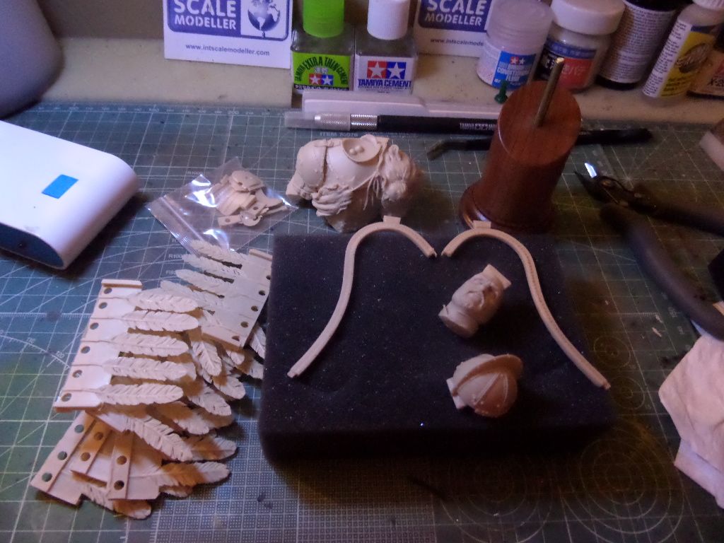

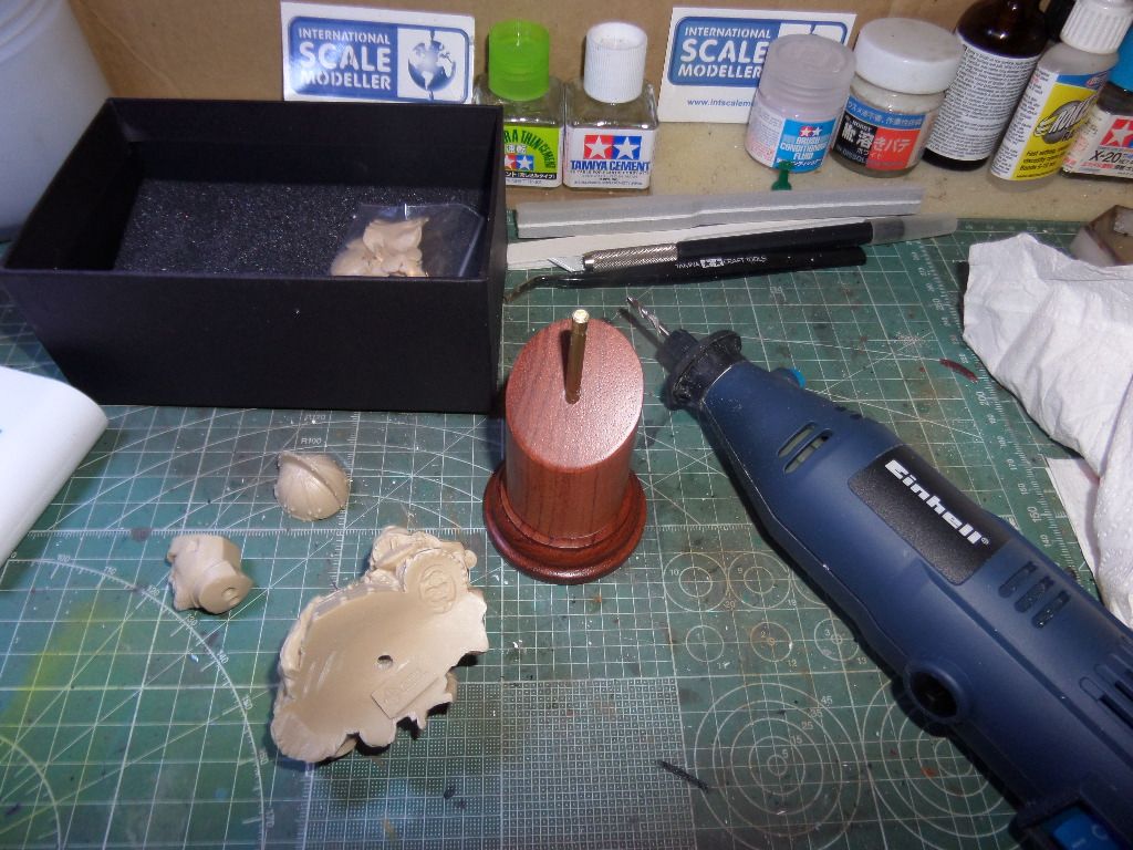

Cleaning the figure ...Resin be carefull to use a mask and ventilation

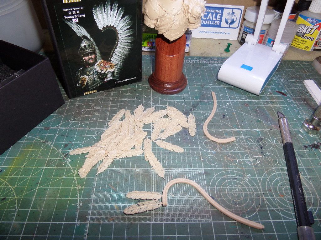

Arghhh so many feathers :-)
they go for this ornament that this hussars have in their back ..should be an impressive view in battle !

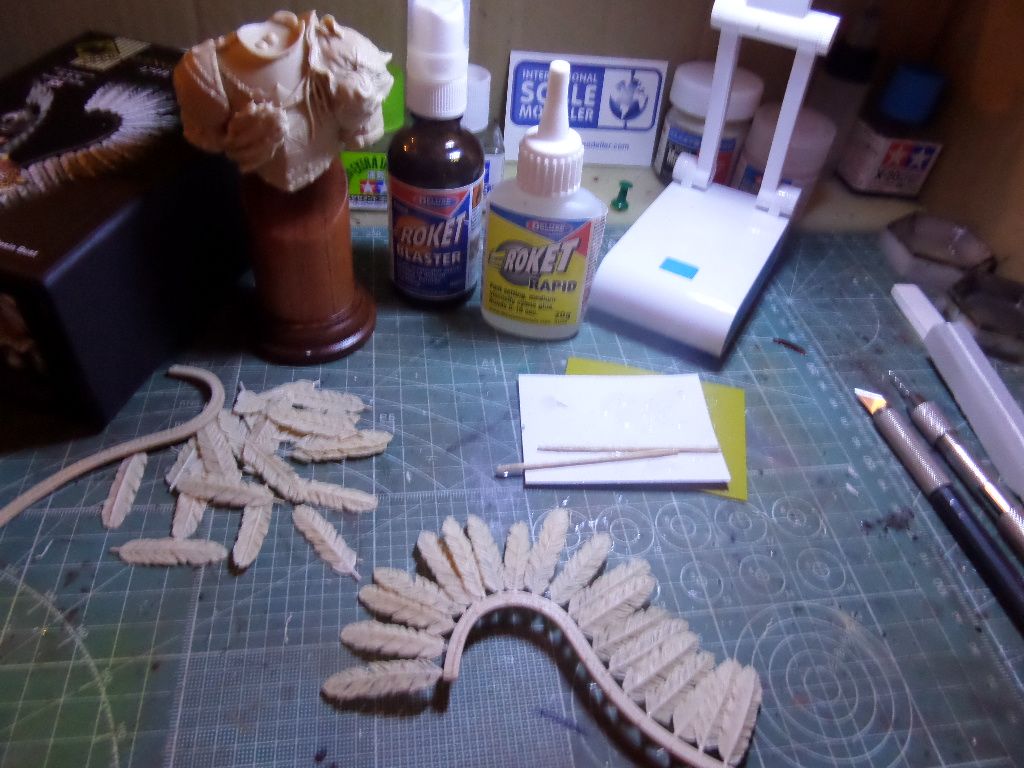

starting on placing the feathers :
Done , some damaged as they re very fragile , but CA glue and a lot of patience did the job !

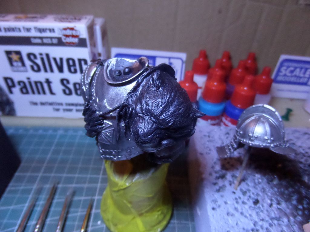

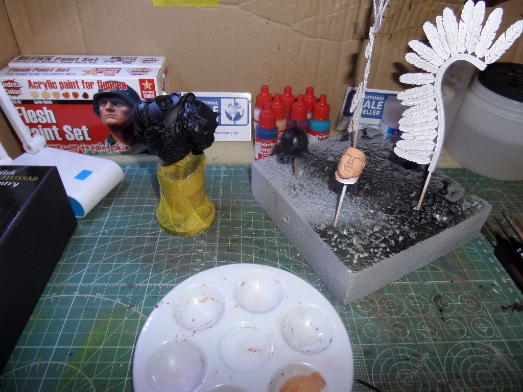

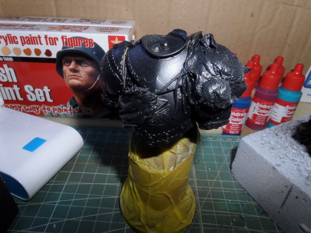

I orimed the torso and helmet in black ...as most will be painted in metal tones (armour ) , I prefer to prime the head and the ornaments using White Primer !

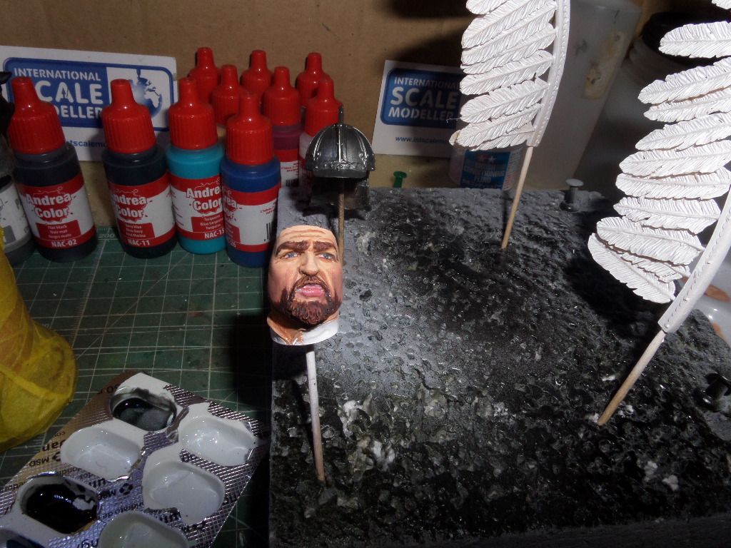

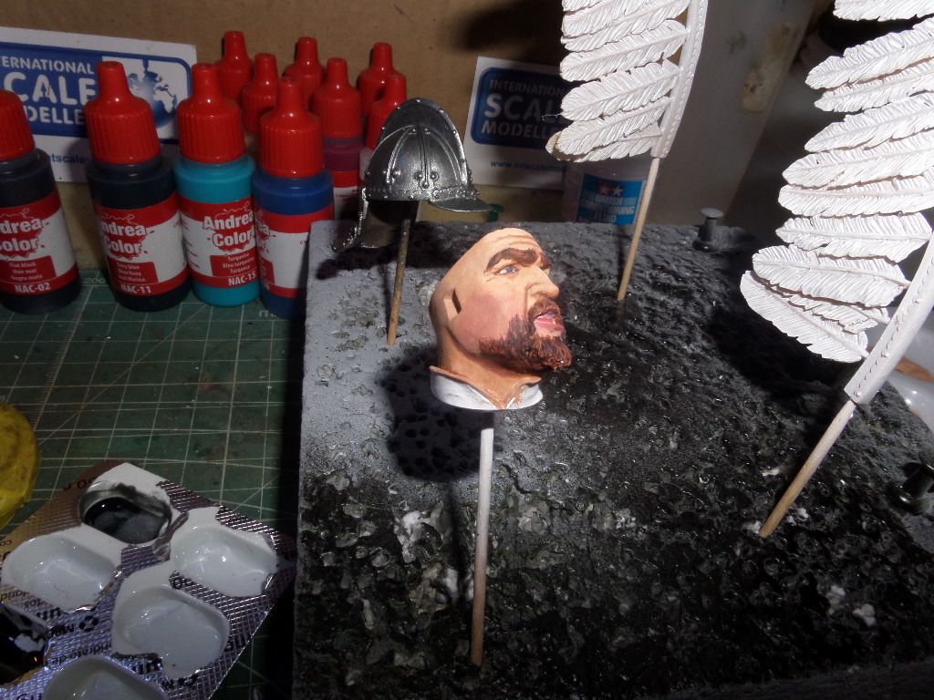

The head I start to paint using the Andrea Colors Flesh paint set , easy to use and you do not have to do many mixtures for the lights and shadows

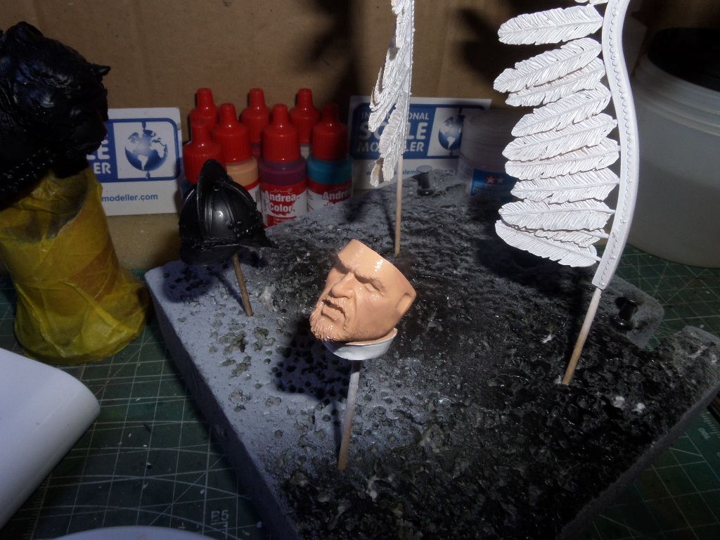

Two coats of Flesh Base color
Painting the face , well after the base paint it is painted doing first two different highlights , and this you must do a lot of brush strokes and try to give the most realistic tones on the face , usually I use a light directly above the face , and try to paint the highlights where the light will focus more , as for the shadows were should be shadow of course , for the eyes I use Flat white , and after dried I paint hte upper eyelid with brown ( I use the ACS-013 from Andrea Brown Paint Set ) and a mixture of the previous with XNAC-31 Crimson Red , for the Iris I used a mix of XNAC-11 Navy blue and XNAC-26 Basic Blue (Andrea colors references ) . Then the pupil is lightenwith a mixture of the previous with some XNAC-15 Turquoise .Pupil with XNAC-02 Flat Black , and the light dots in between the Iris and the pupil is with a little dot of XNAC-01 White . on the oposite and in the Iris I paint a reflection using Turquoise and XNAC-43 Light Flesh . All this was in a book/MAgazine that I bought from Andrea Publications that is a step by step on painting figures by Julio Cabos ! If you want to give it a go on figure painting and can't go to a painting course or see the masters painting live, this could be a good initiation !
The beard is for now with a base of Brown paint , but maybe I will go just for some highlights with some lighter color as I really like how it is right now !

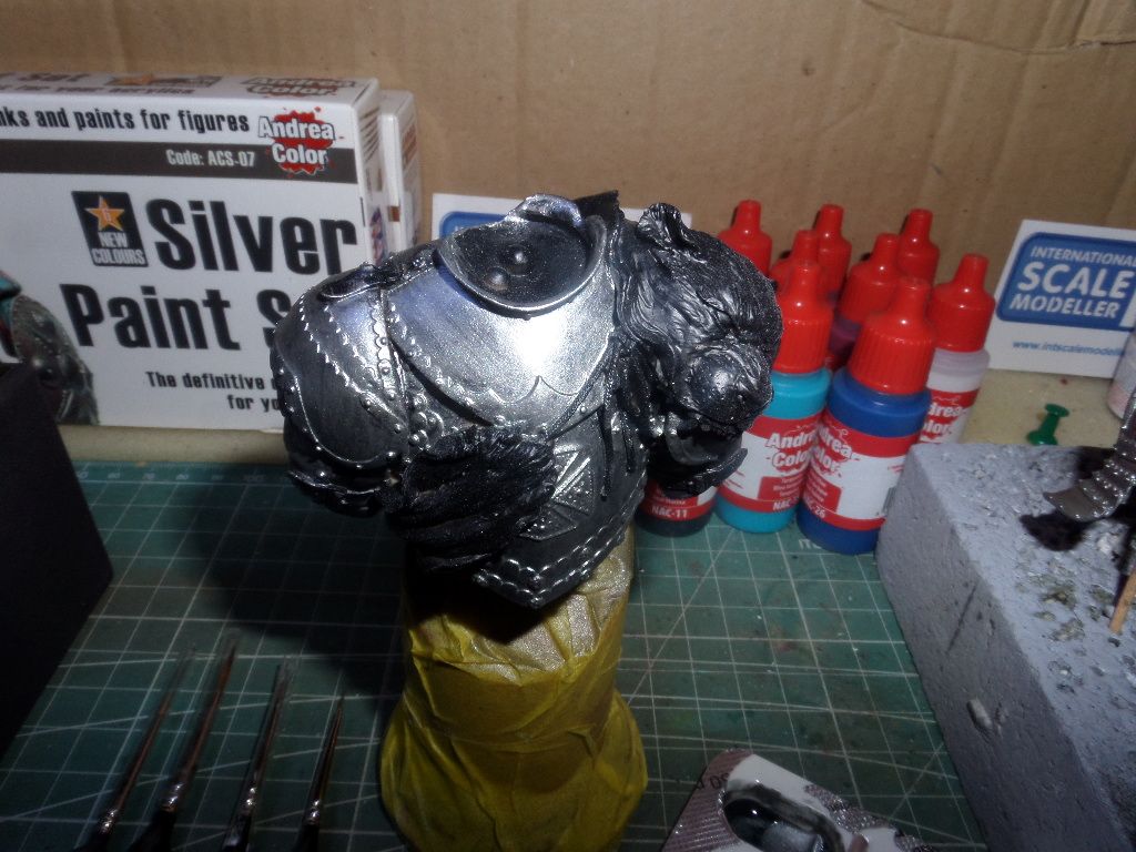

Paint the Armour with the base paint from Andrea Colors Slver paint Set
Two brush coats to really give it a good cover !
