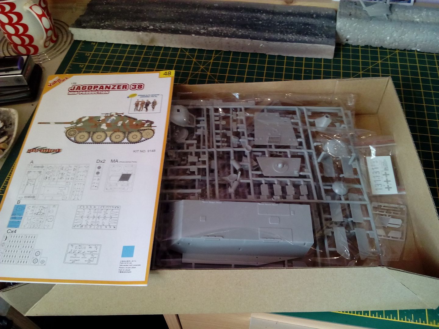

So here is my entry for this one it comes with 4 german elite infantry (ardennes 1944/45)

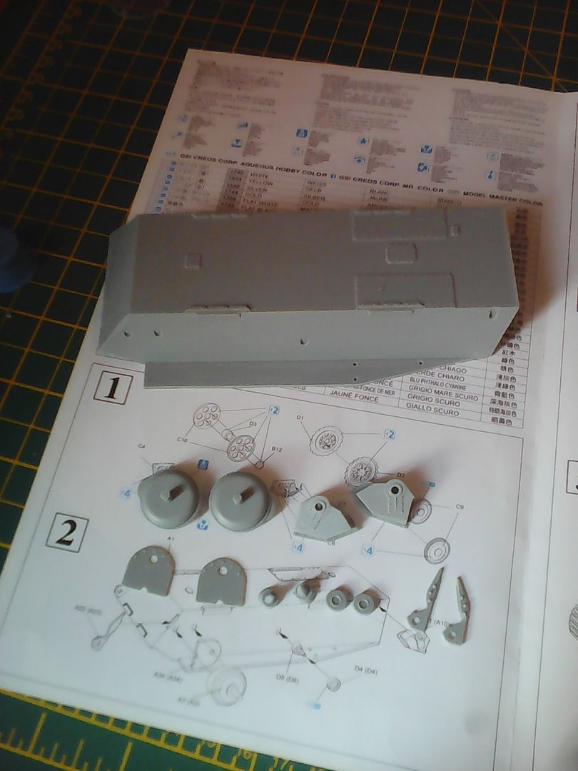

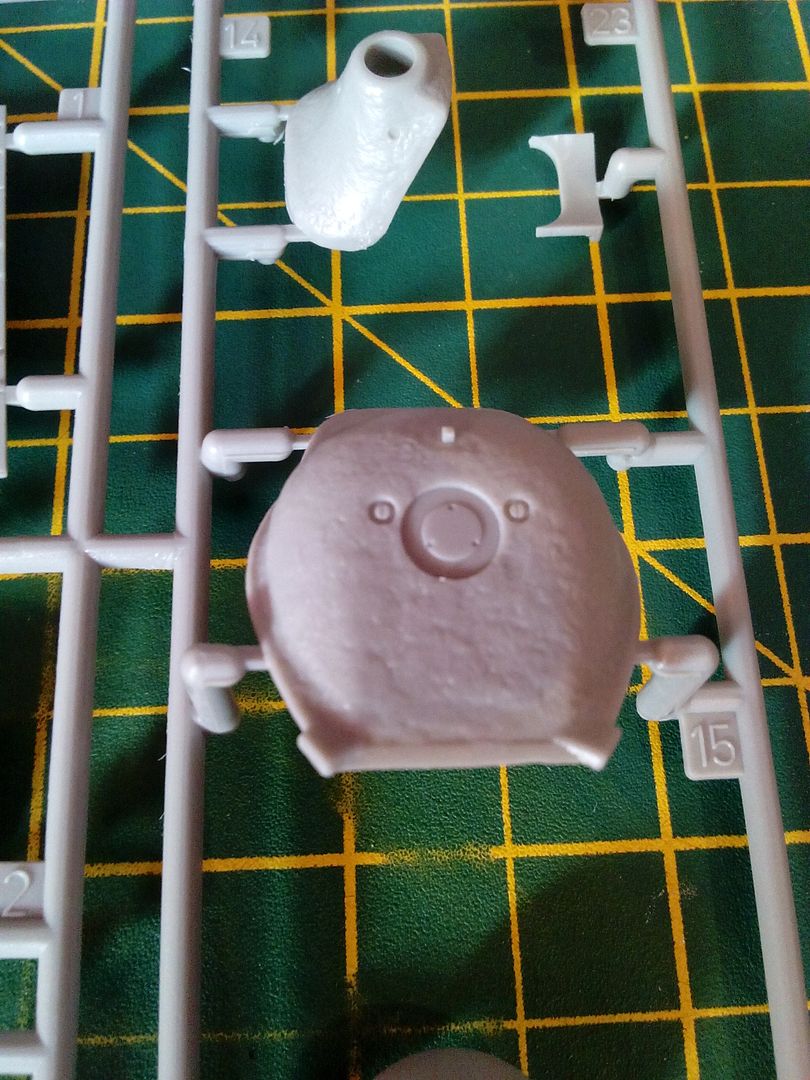

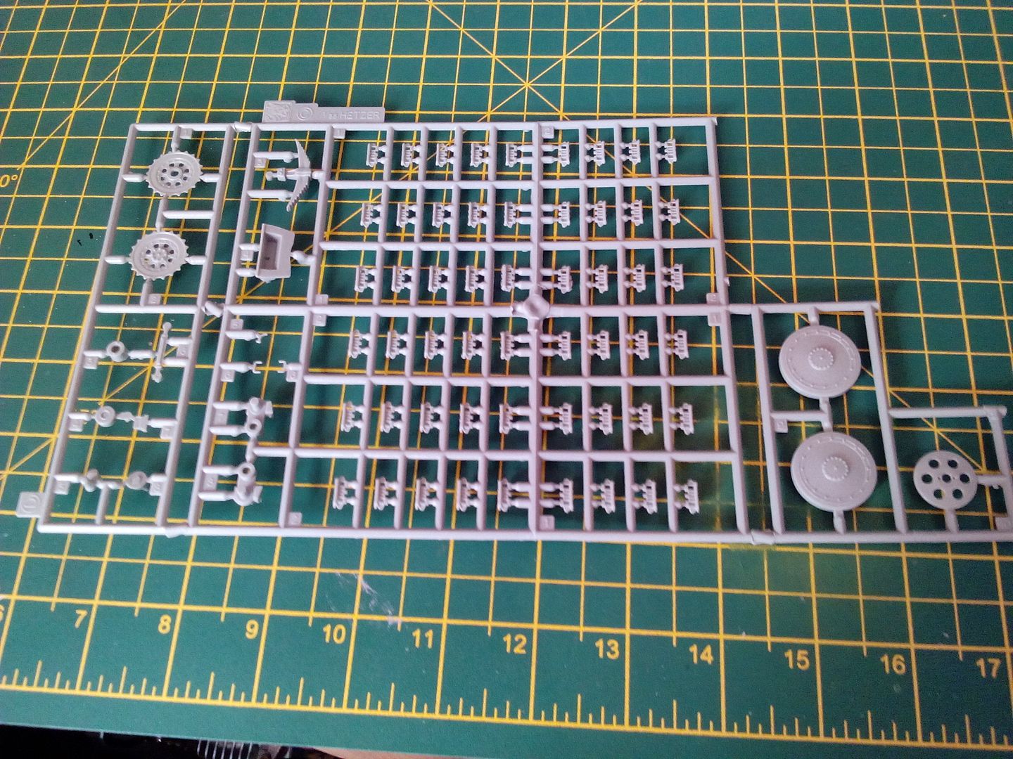

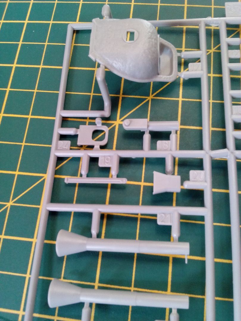

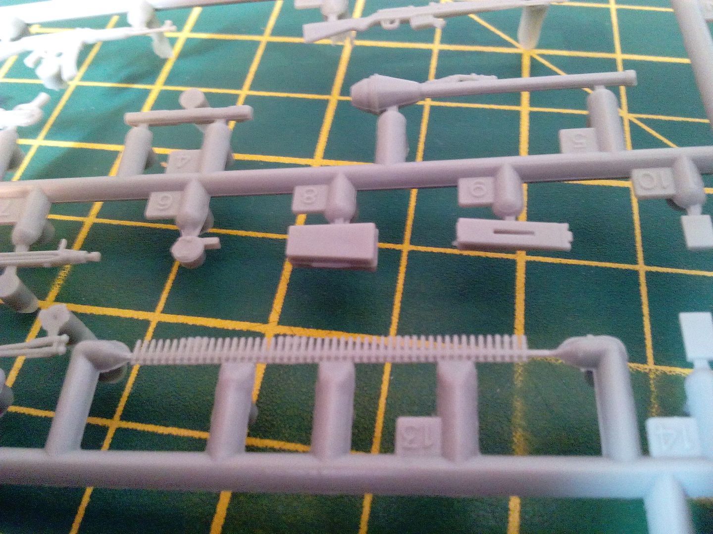

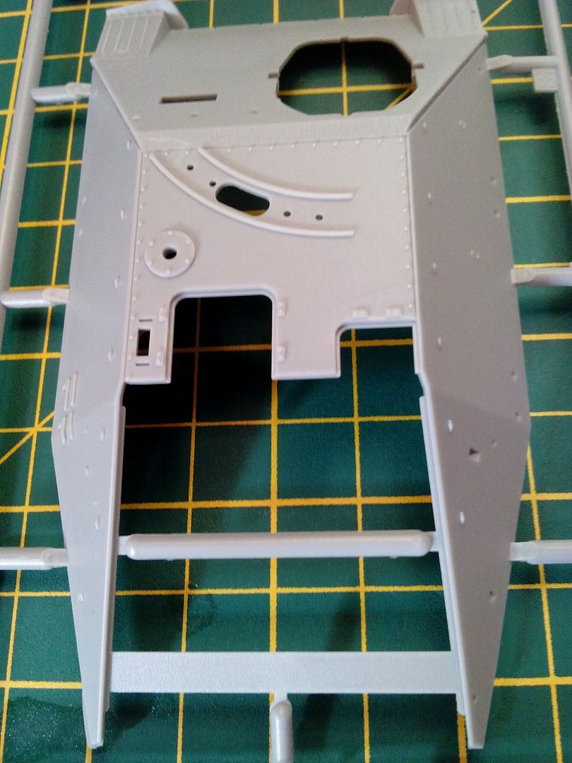

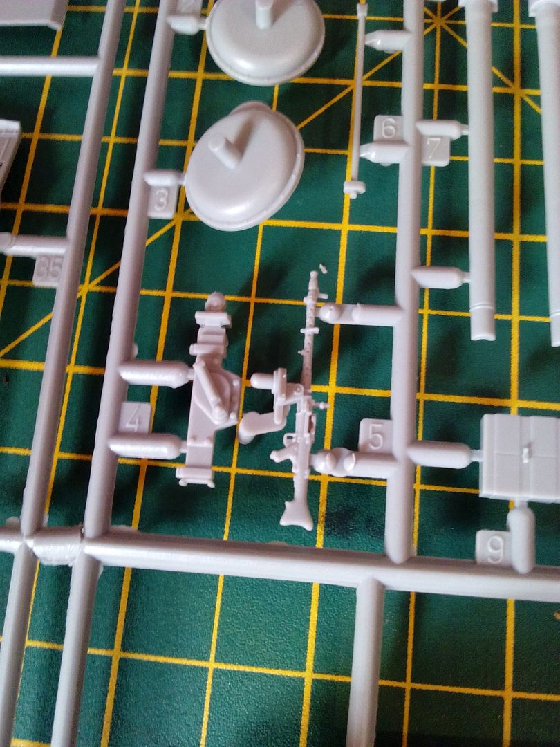

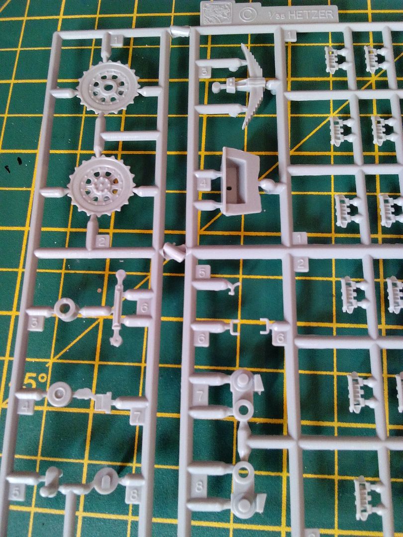

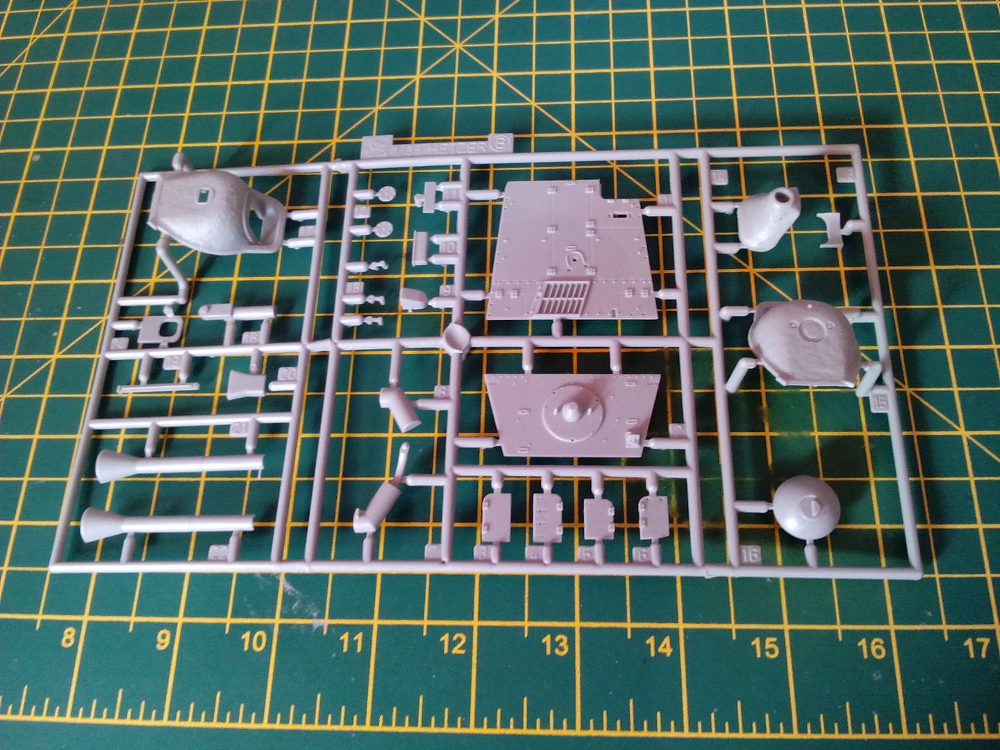

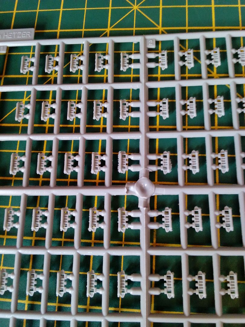

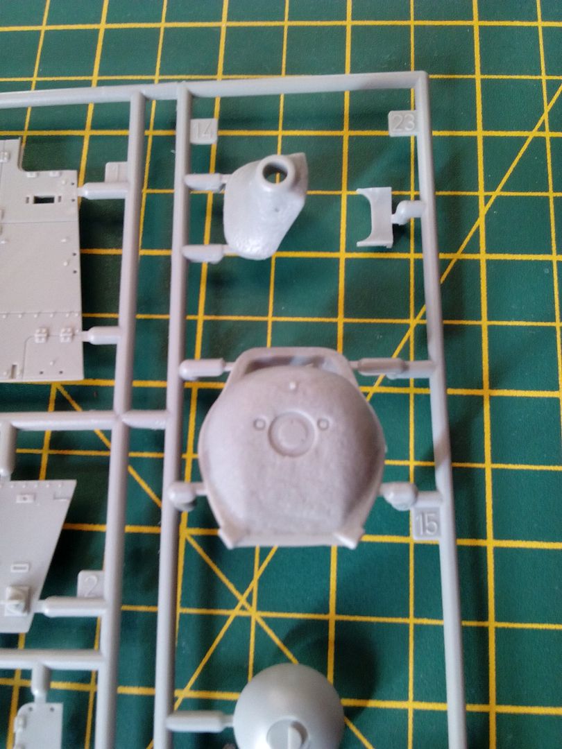

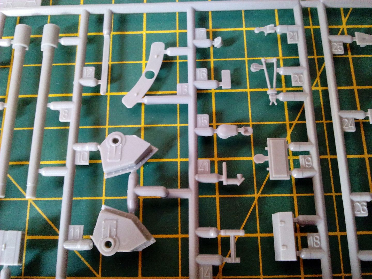

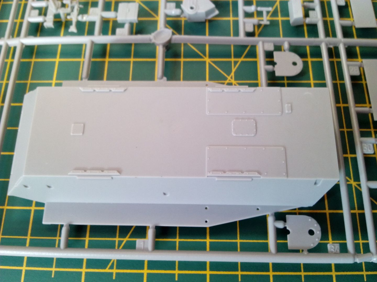

The sprues there is quite a bit of detail on this kit but there is also some flash to be cleaned up

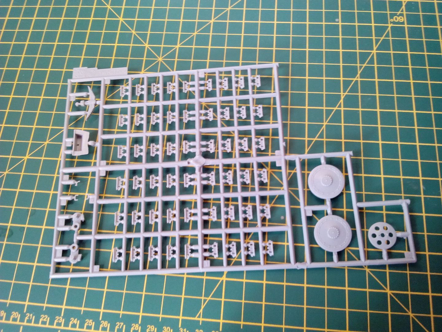

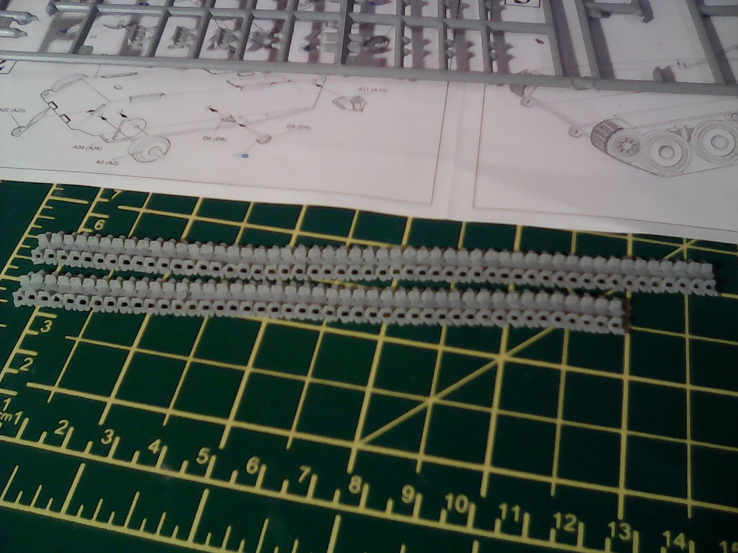

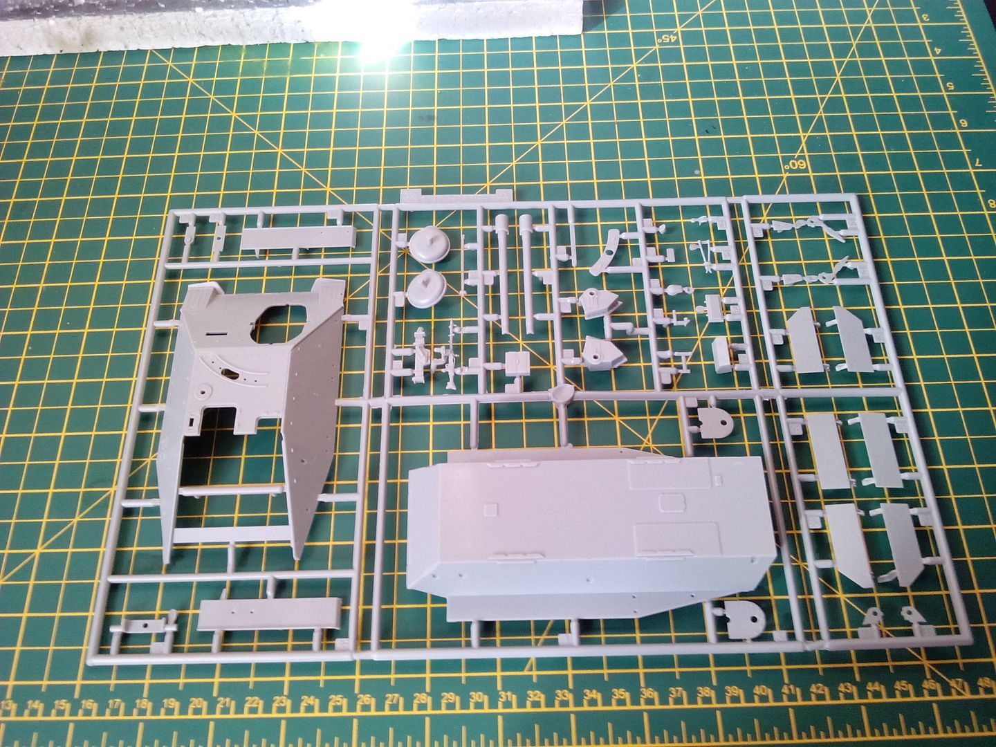

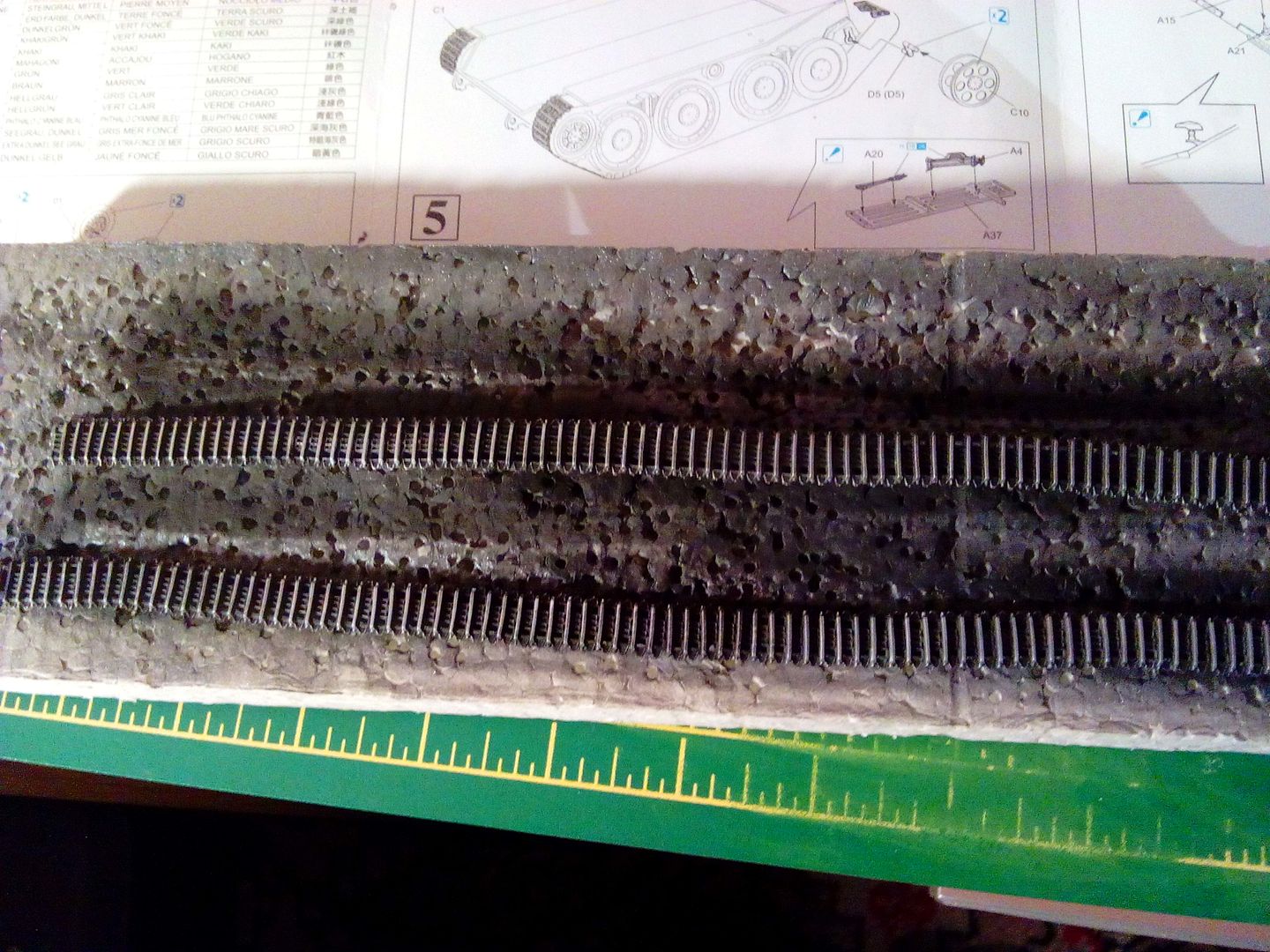

X2 also contains the plastic track parts

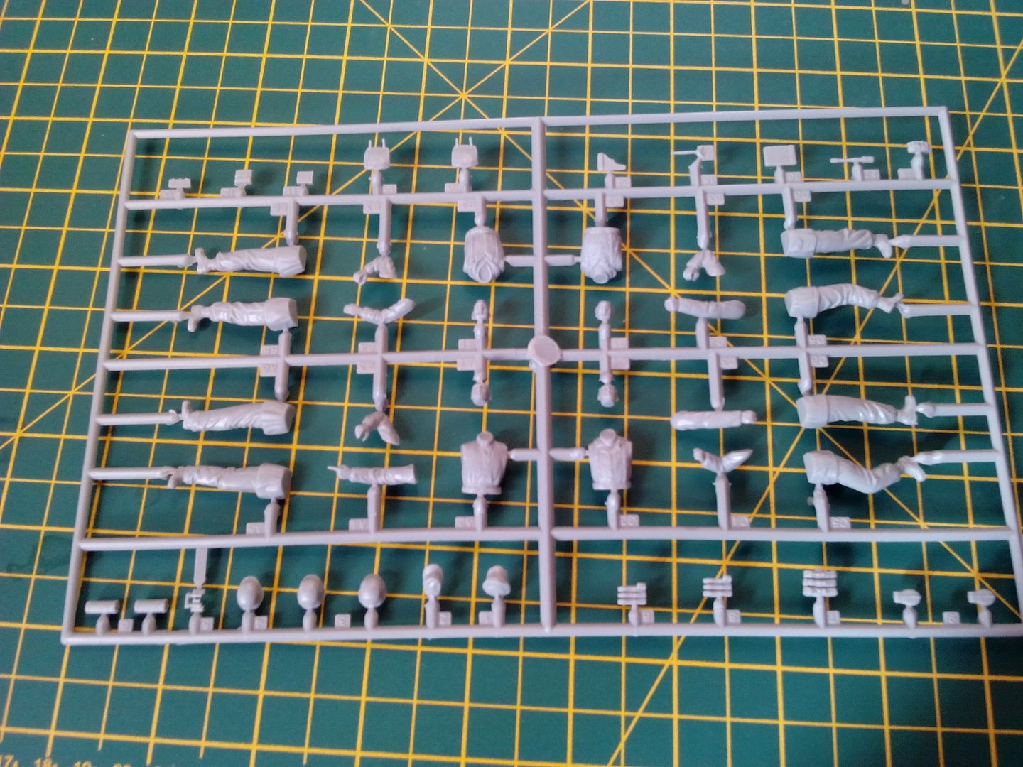

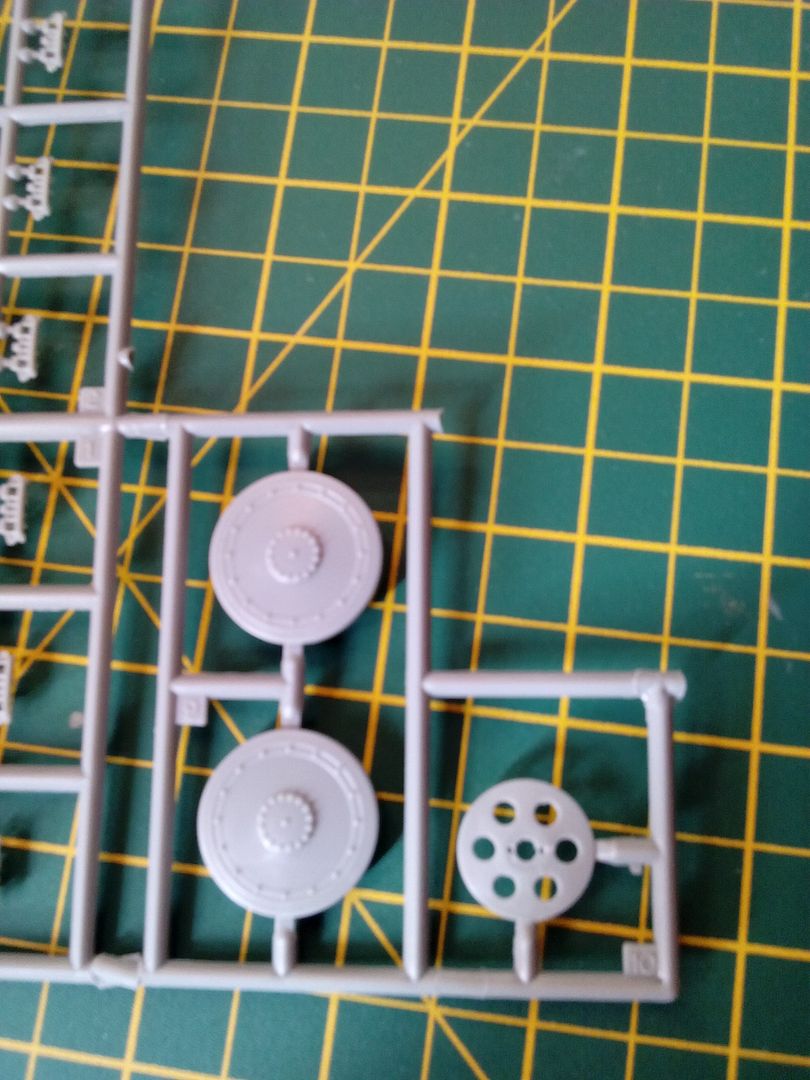

X2 with more track parts

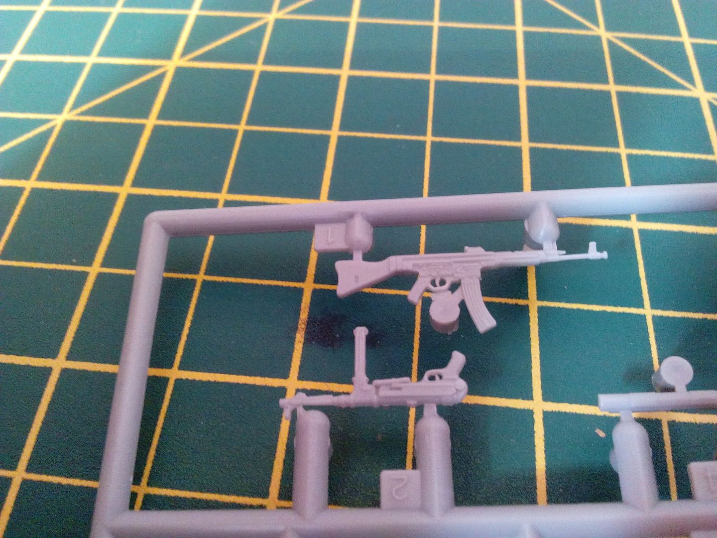

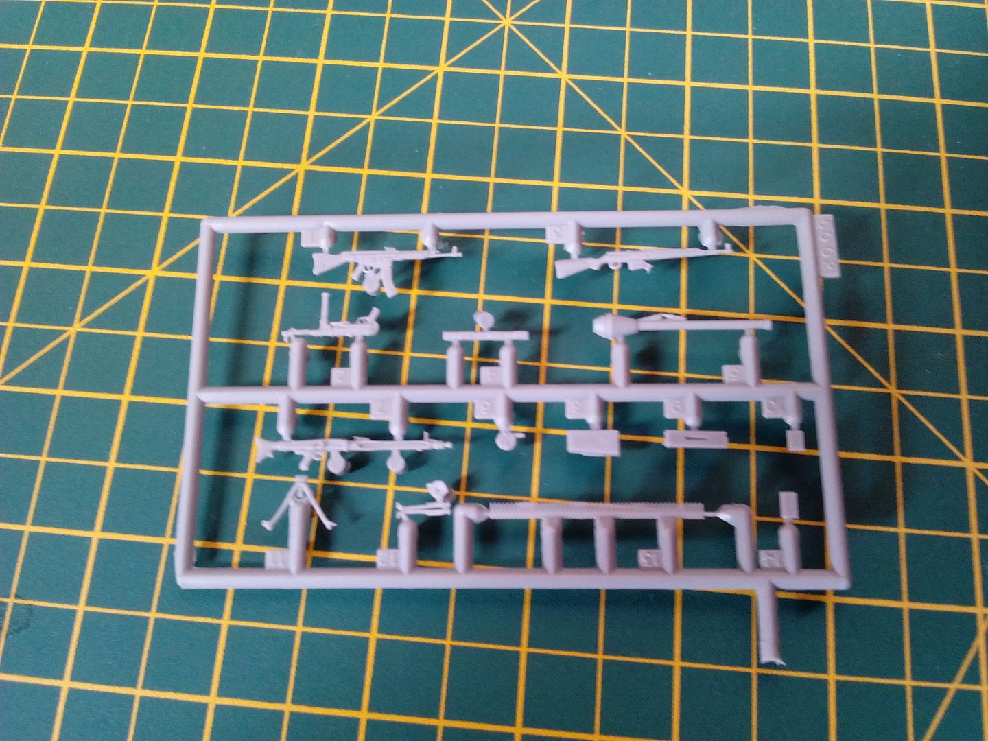

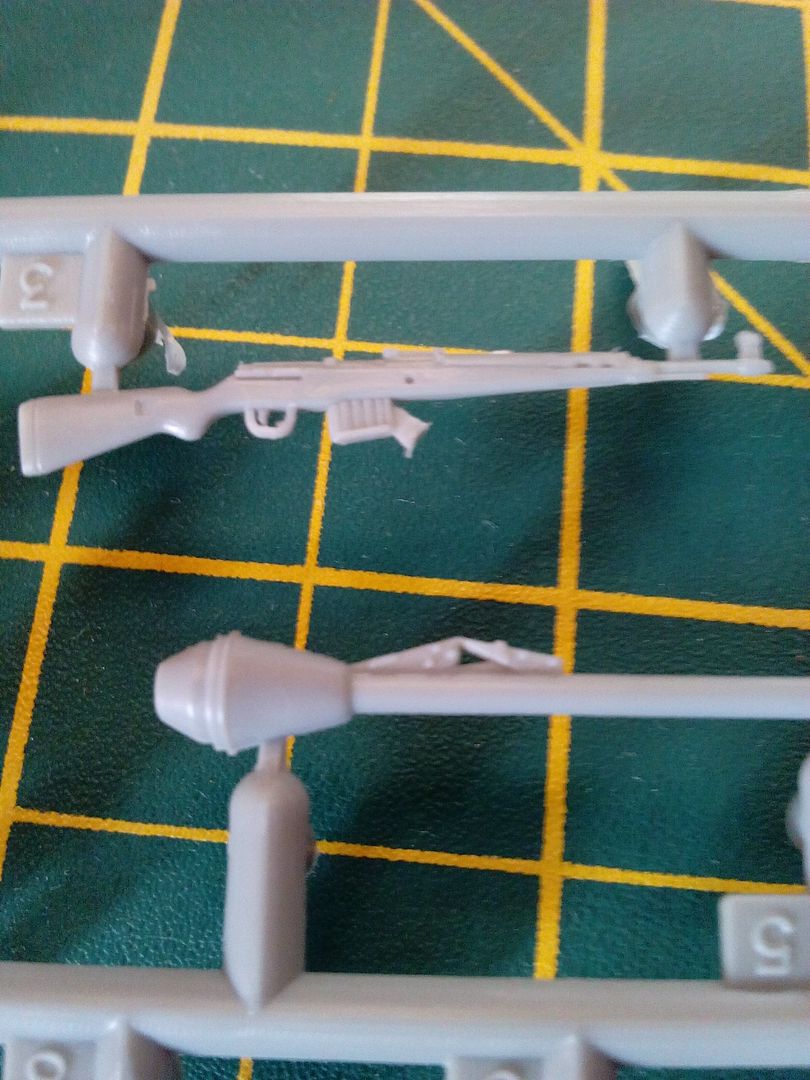

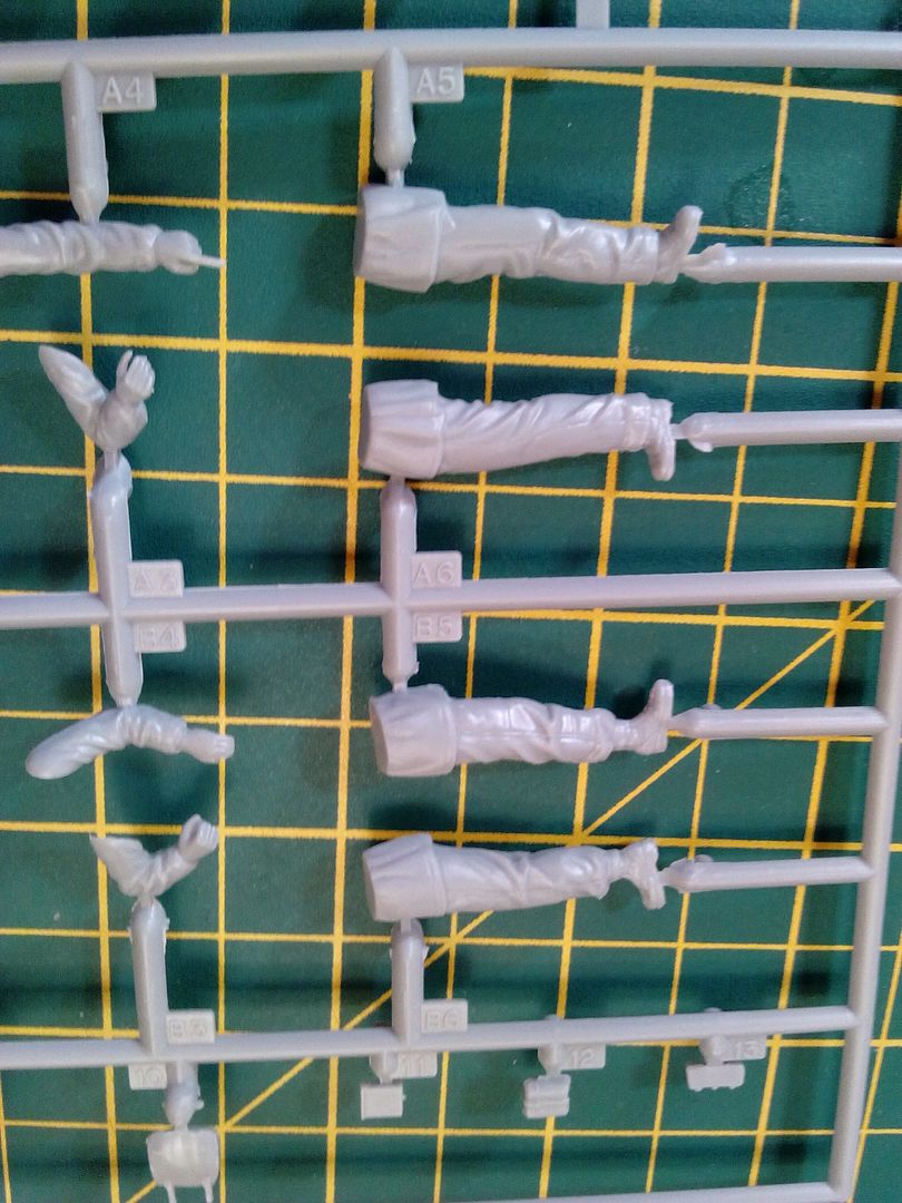

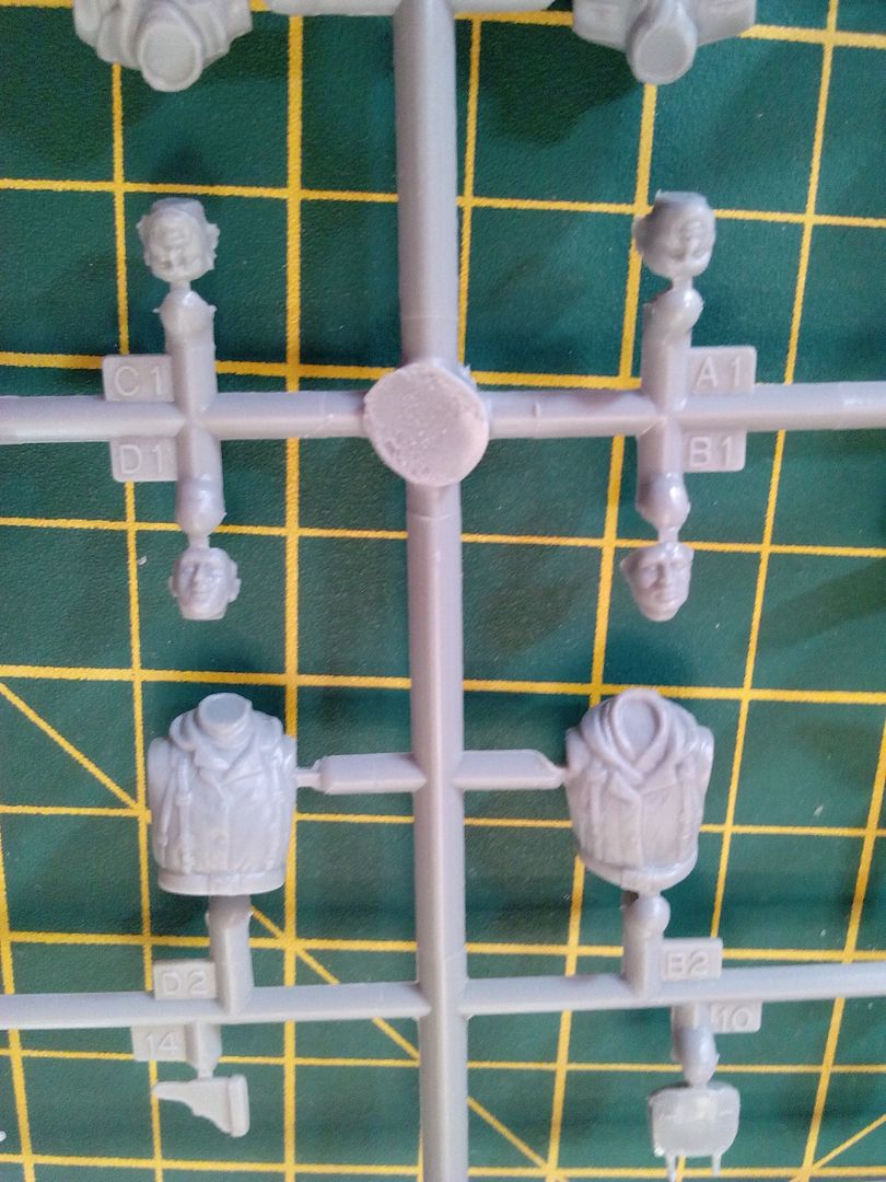

The figures and weapons

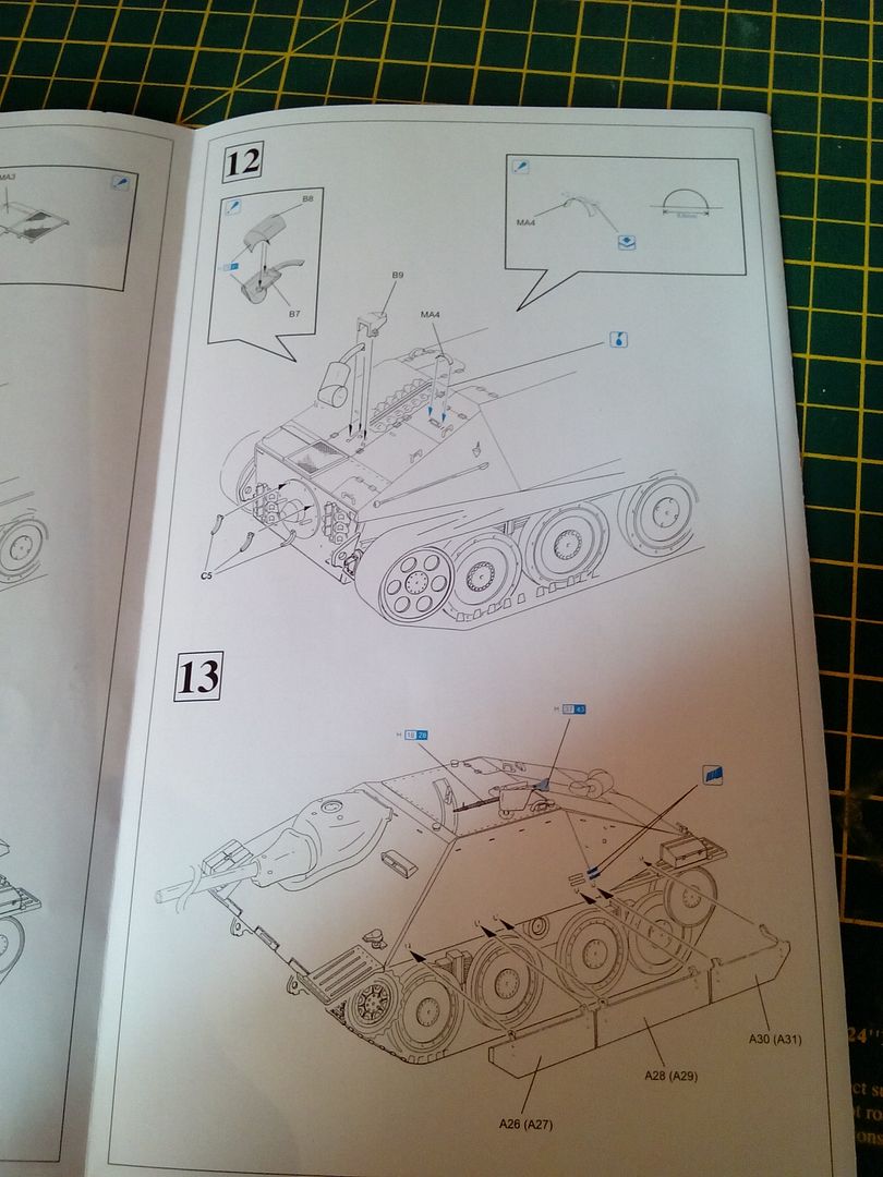

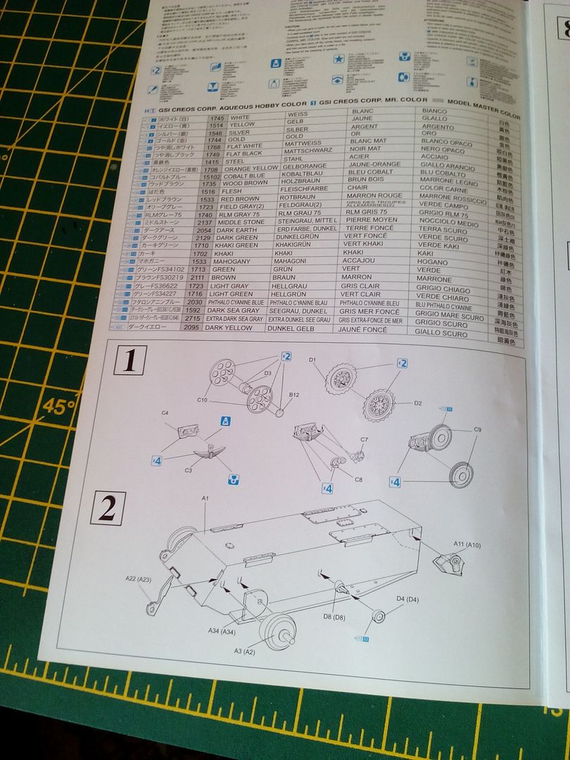

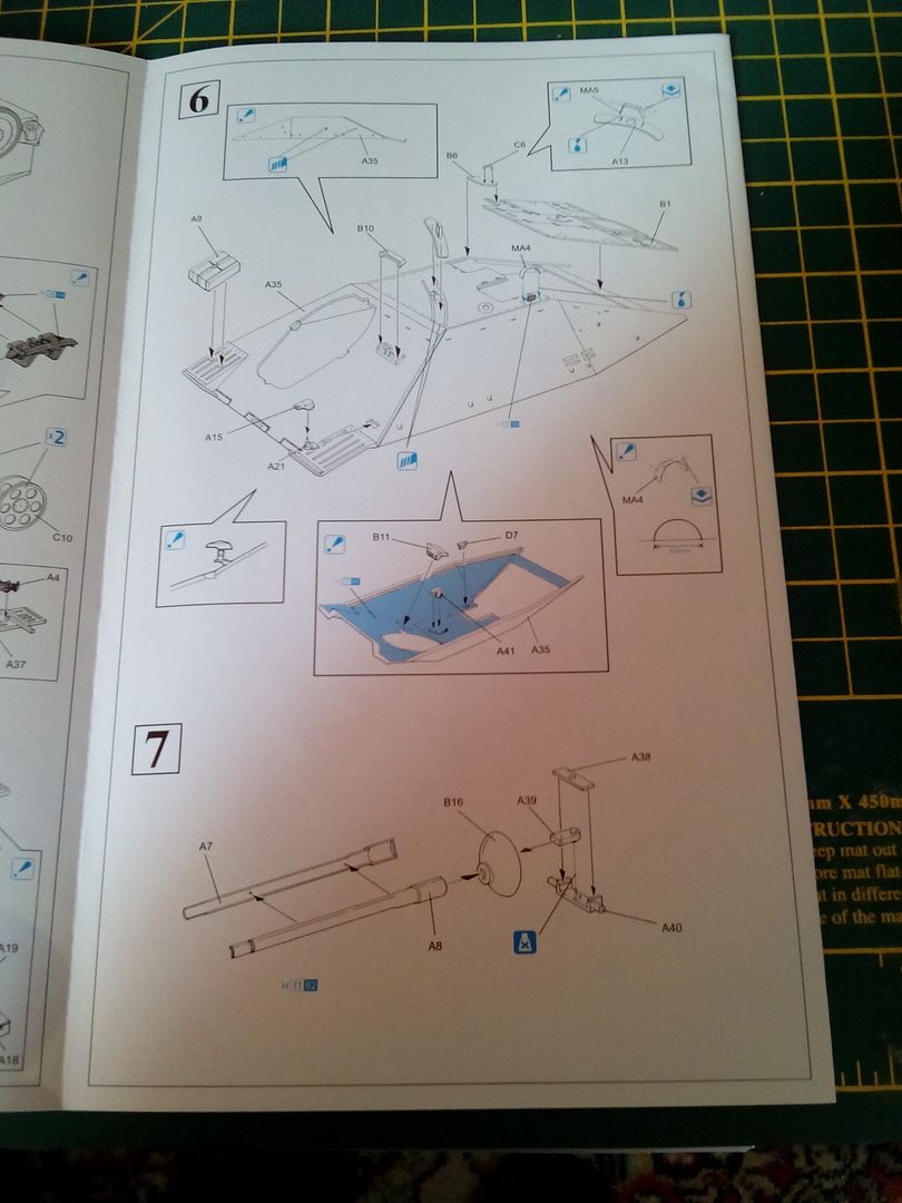

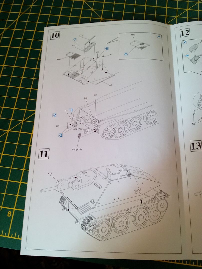

The Instructions
And a very nice color sheet for the painting guide

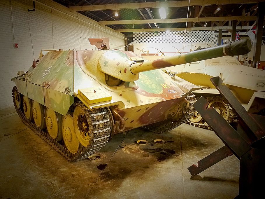

A bit of history for you
The Jagdpanzer 38 (Sd.Kfz. 138/2), later known as Hetzer ("baiter"), was a German light tank destroyer of the Second World War based on a modified Czechoslovakian Panzer 38(t) chassis. The project was inspired by the Romanian "Maresal" tank destroyer
The name Hetzer was at the time not commonly used for this vehicle. It was the designation for a related prototype, the E-10. The Škoda factory for a very short period confused the two names in its documentation and the very first unit equipped with the vehicle thus for a few weeks applied the incorrect name until matters were cleared. However, there exists a briefing paper from Heinz Guderian to Hitler claiming that an unofficial name, Hetzer, had spontaneously been coined by the troops. Post-war historians basing themselves on this statement made the name popular in their works, though the vehicle was never named as such in official documents.

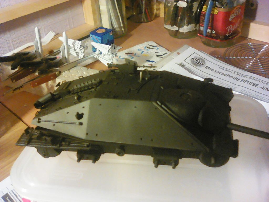

Re: Dragon 1/35 Jagdpanzer 38 mid production

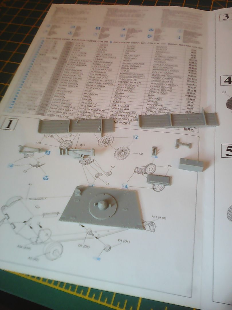

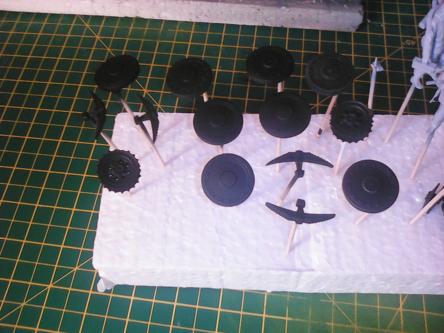

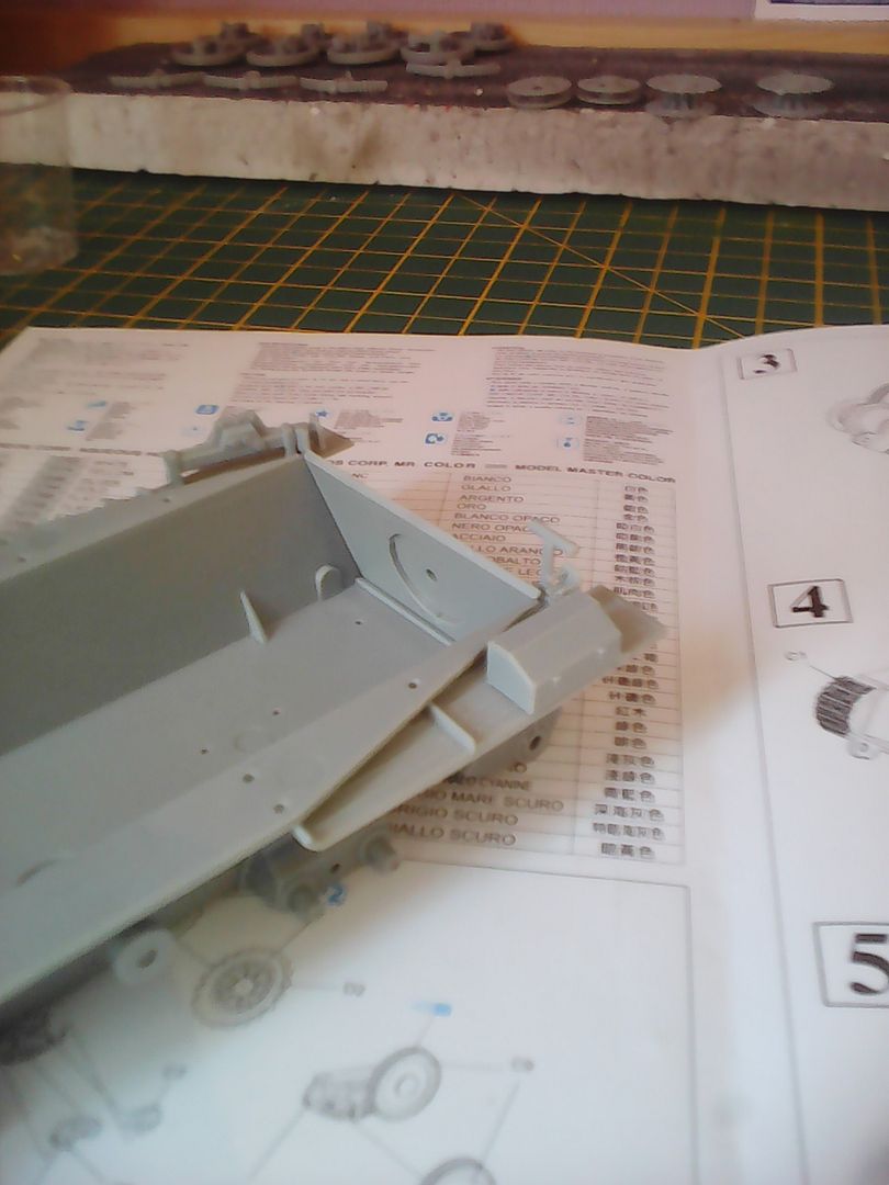

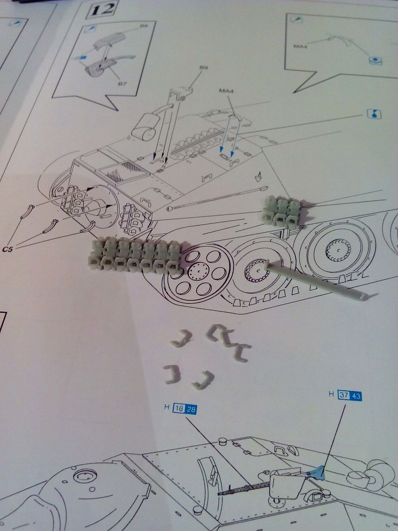

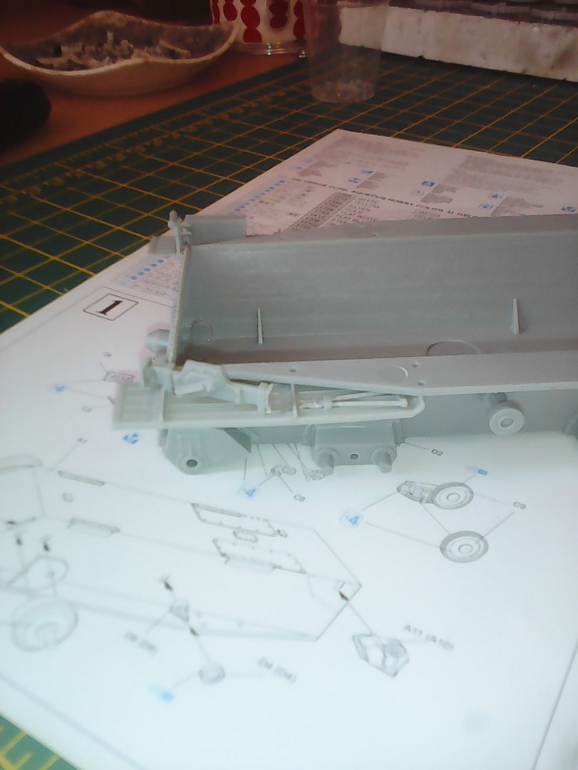

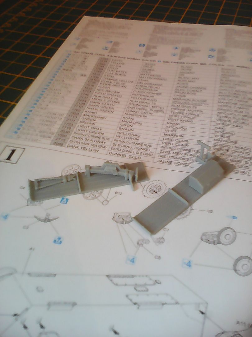

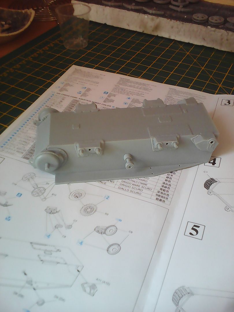

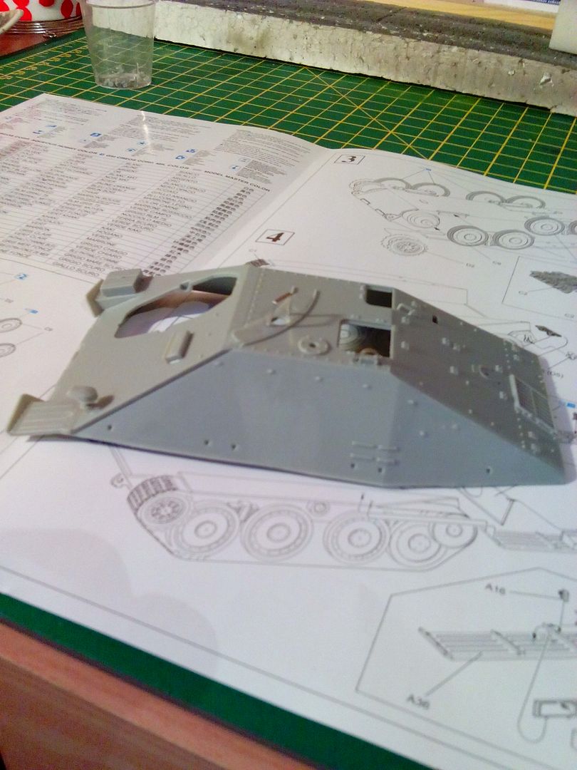

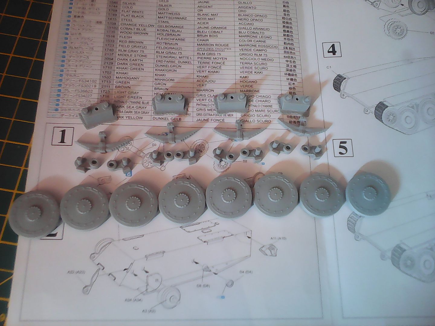

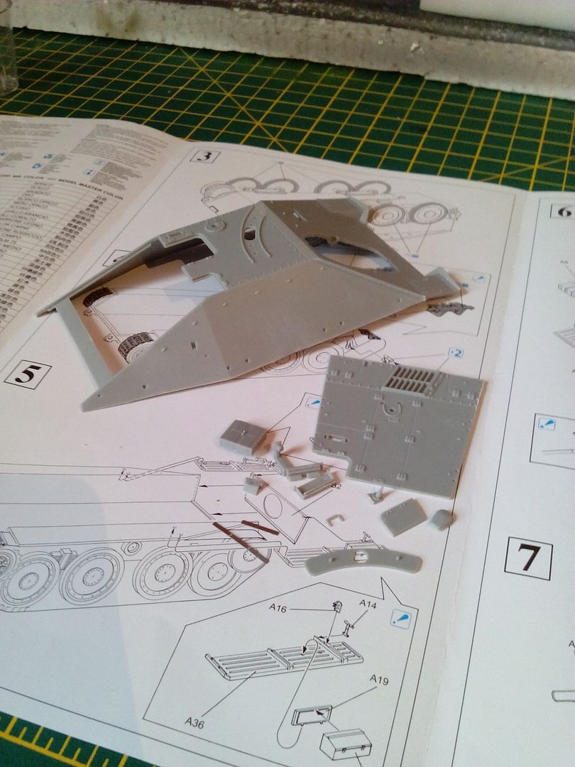

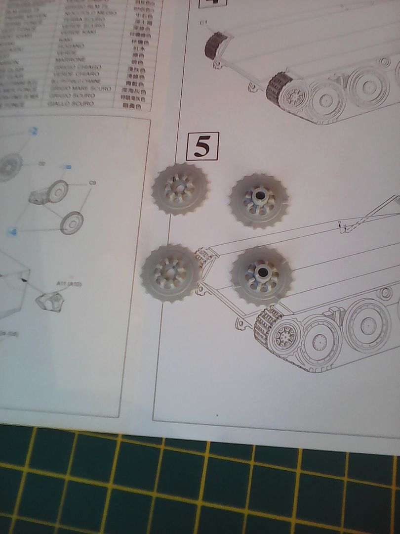

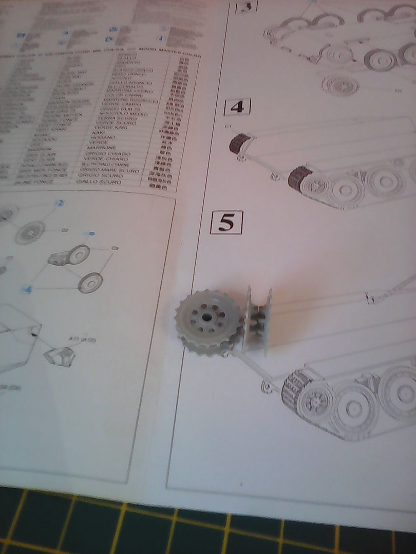

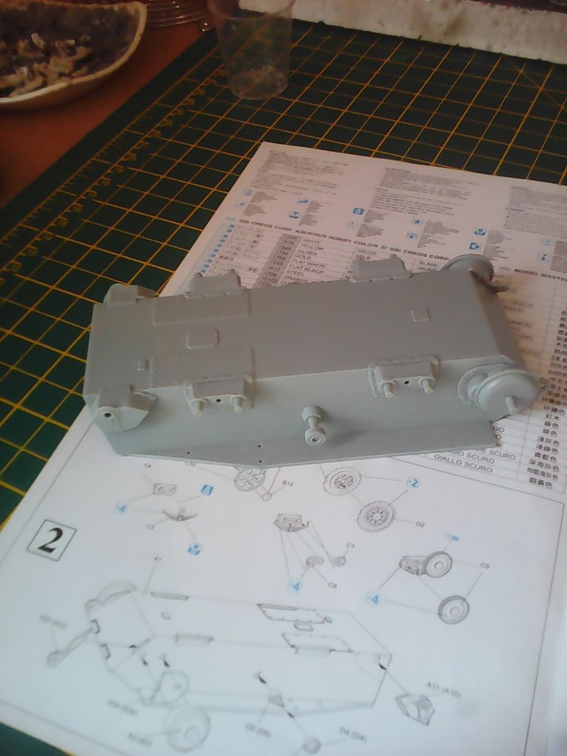

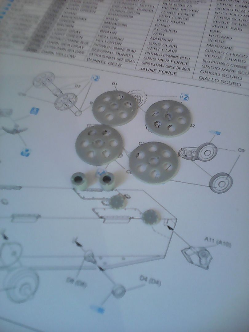

Time to make a start
I've got the wheels and the suspension done and some parts fitted to the lower hull
Thats all for now
thanks for taking a look

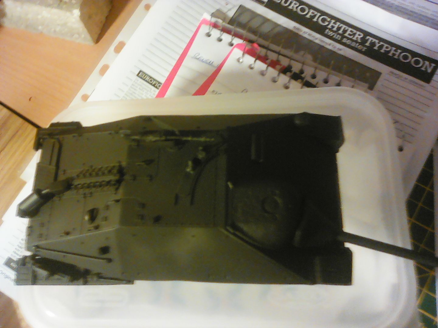

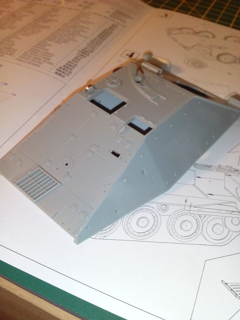

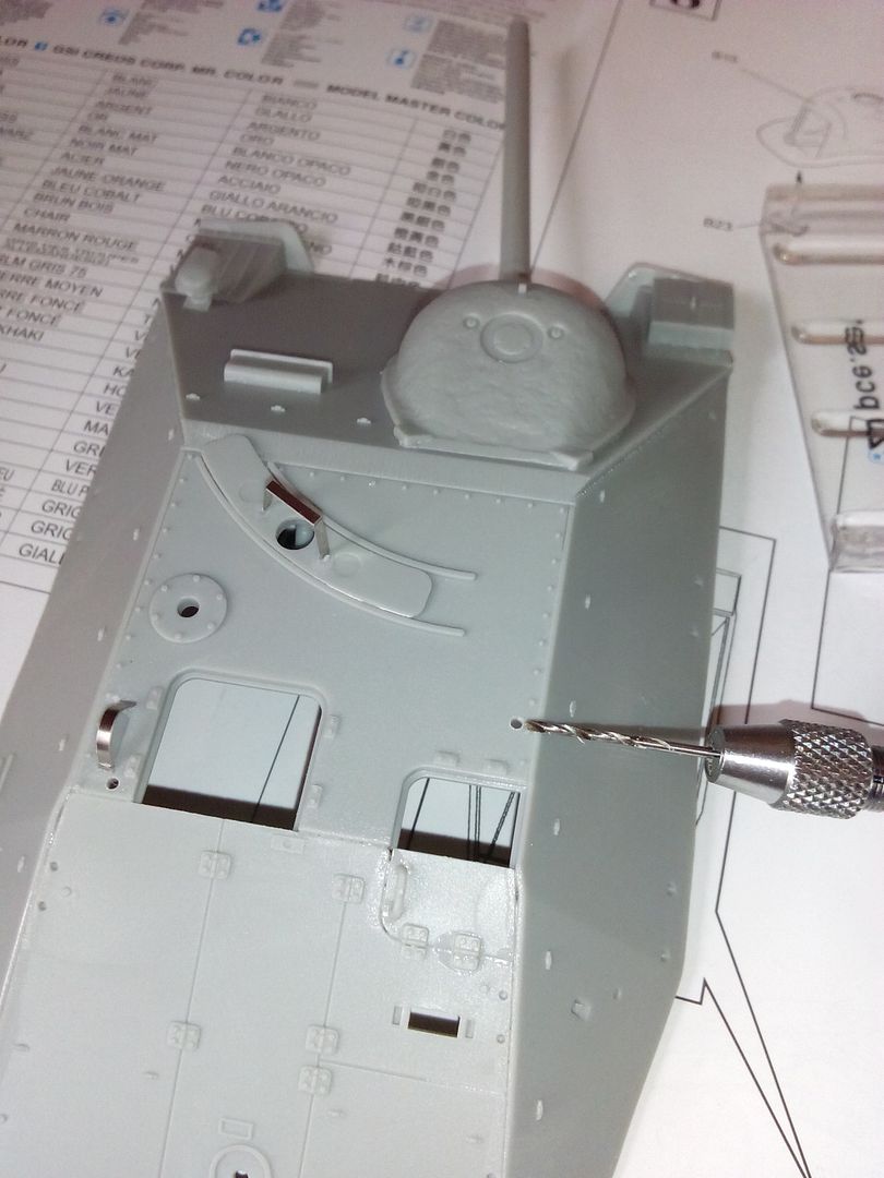

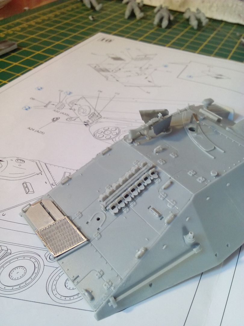

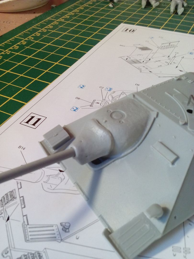

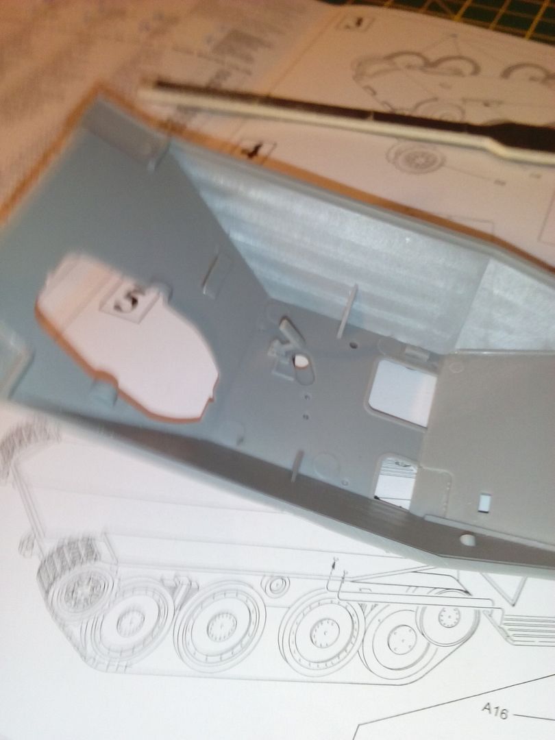

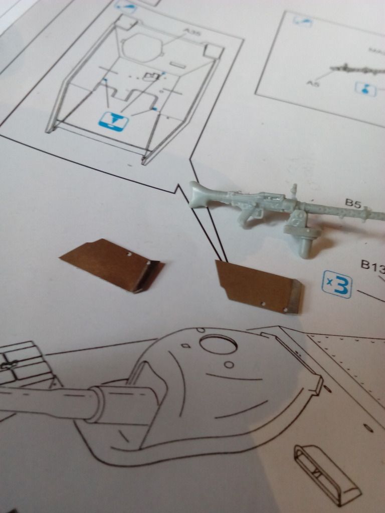

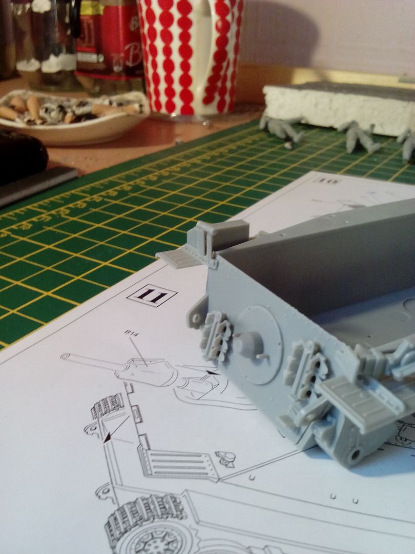

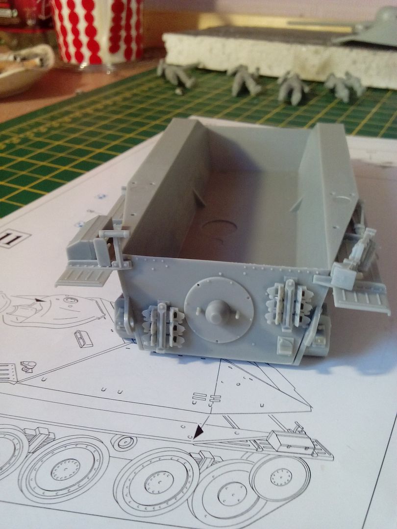

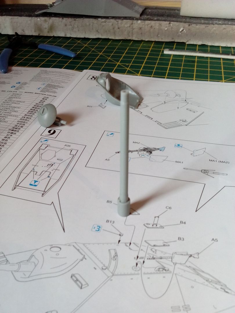

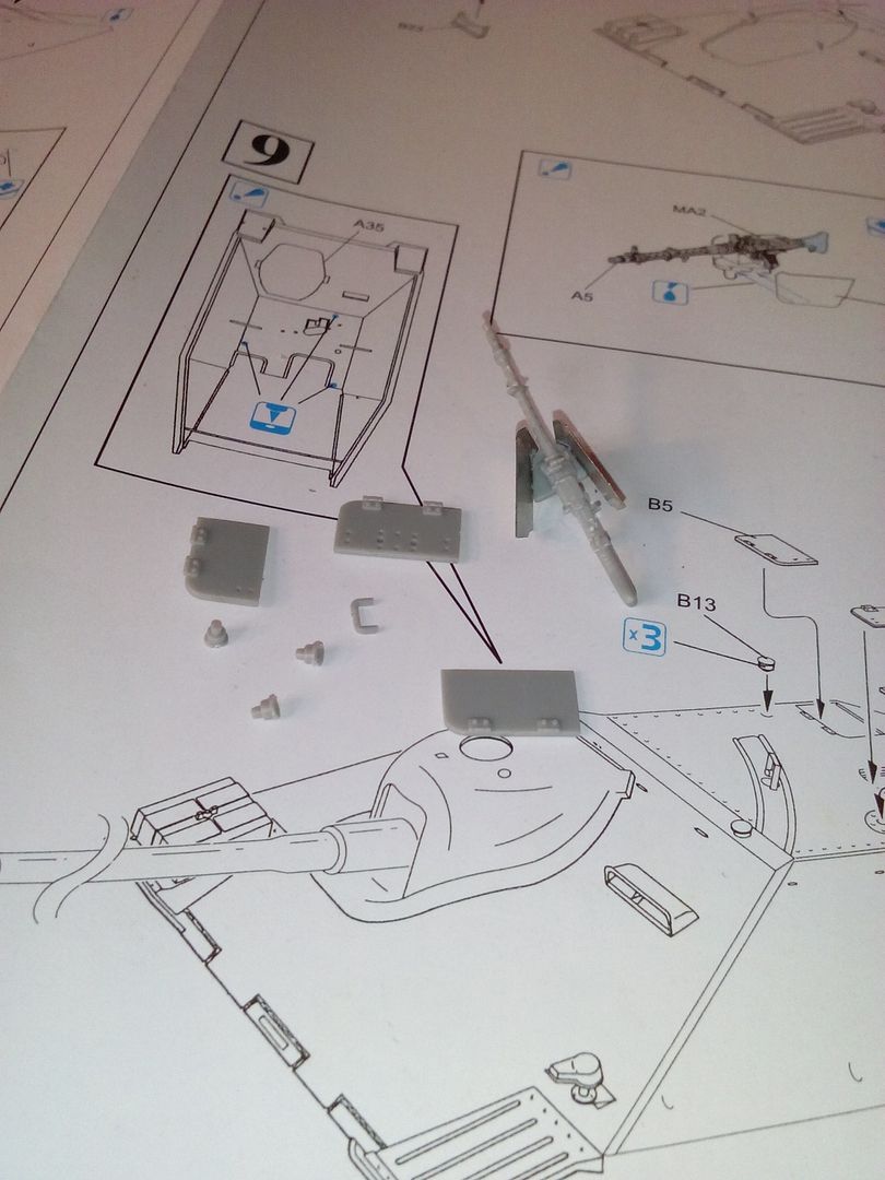

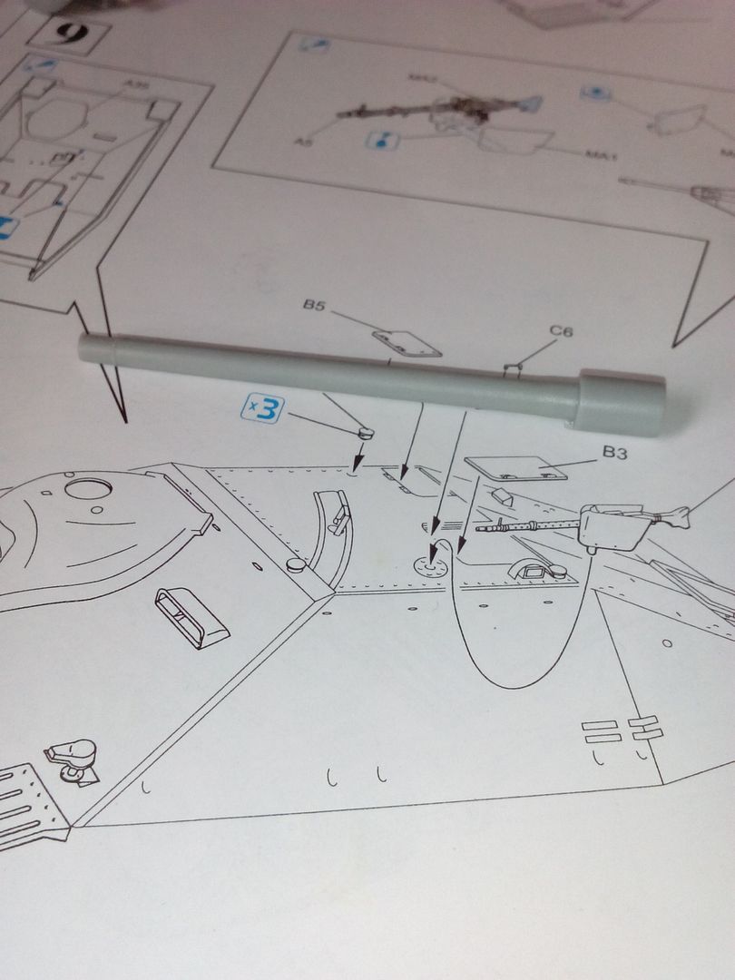

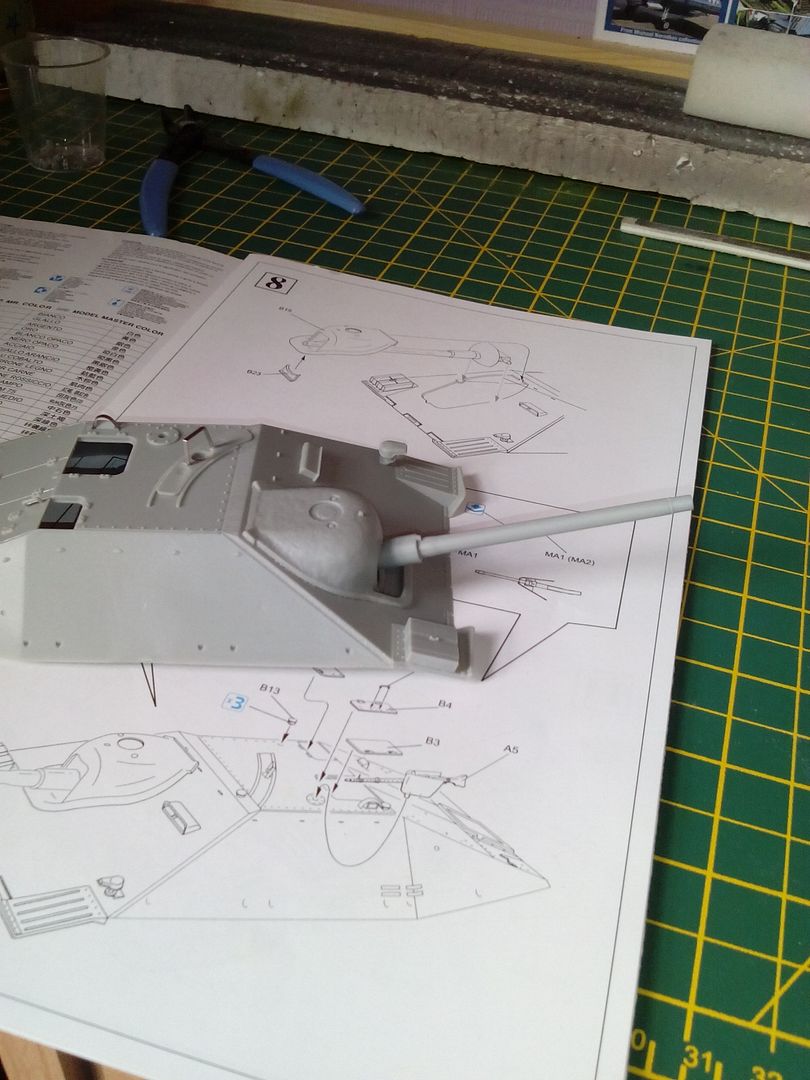

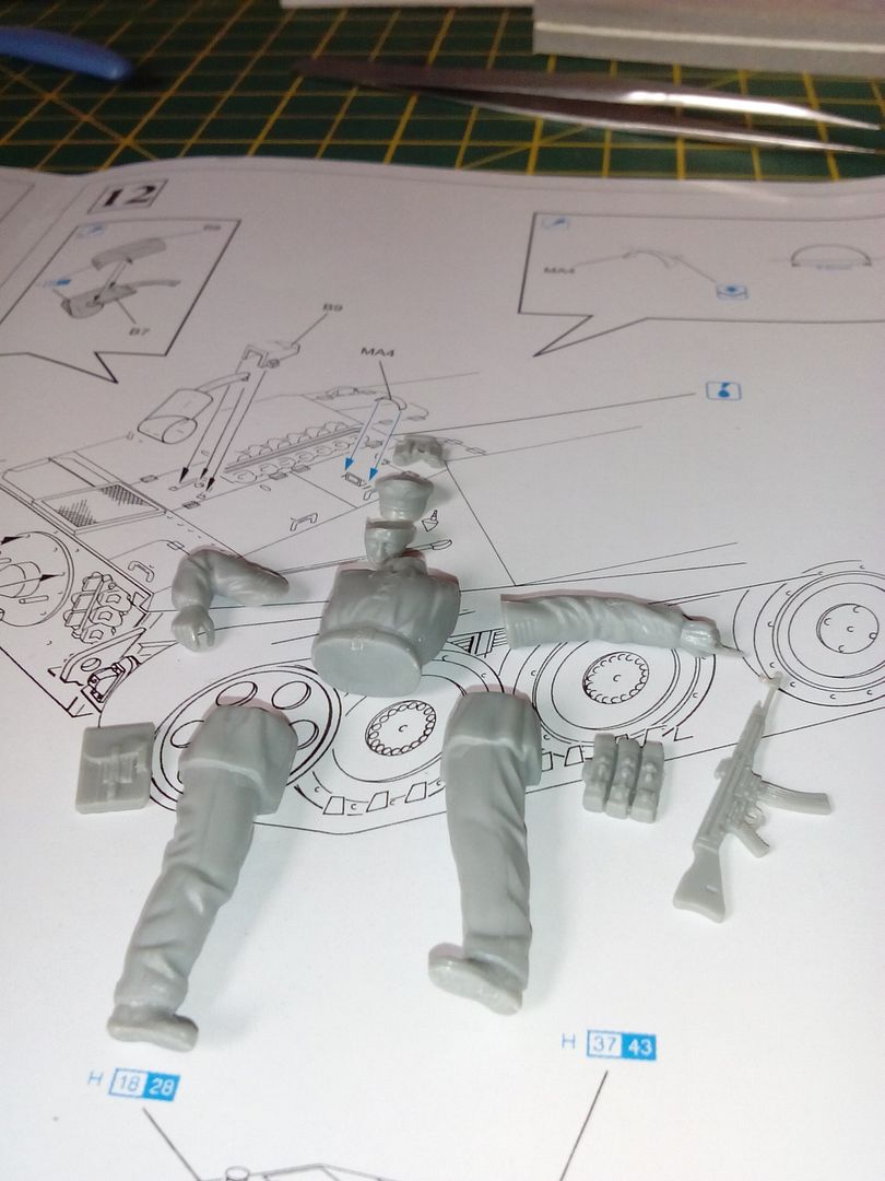

Time to make a start on the upper hull

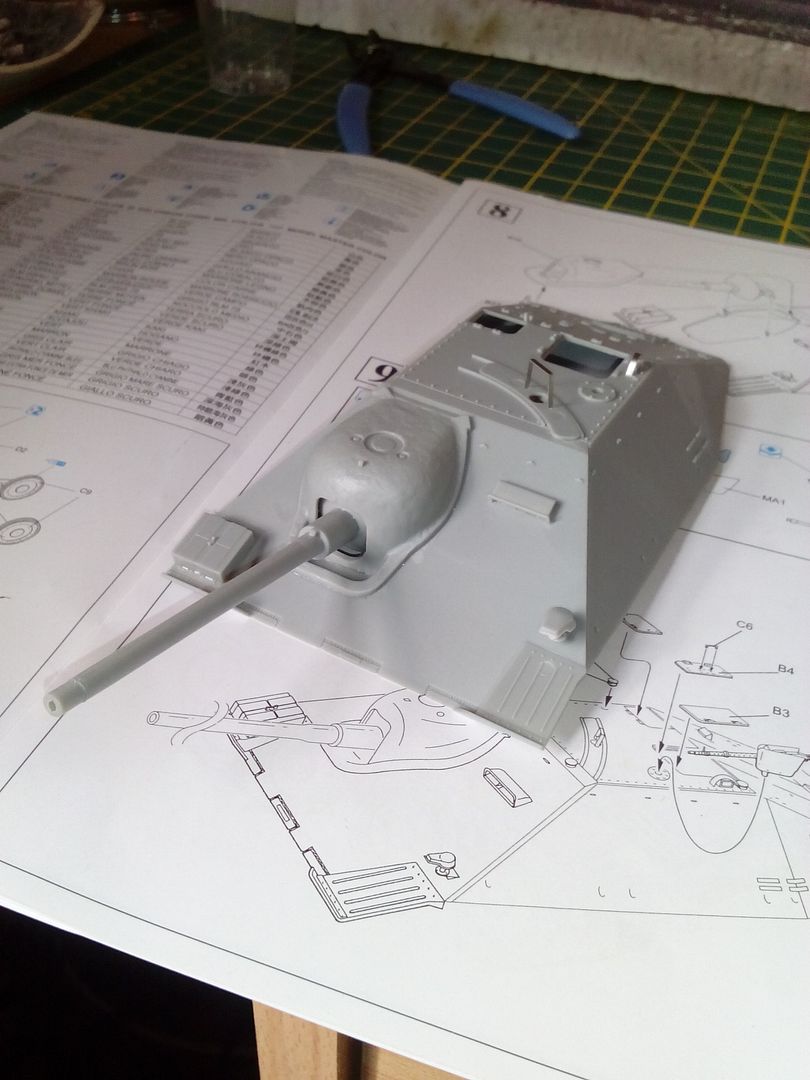

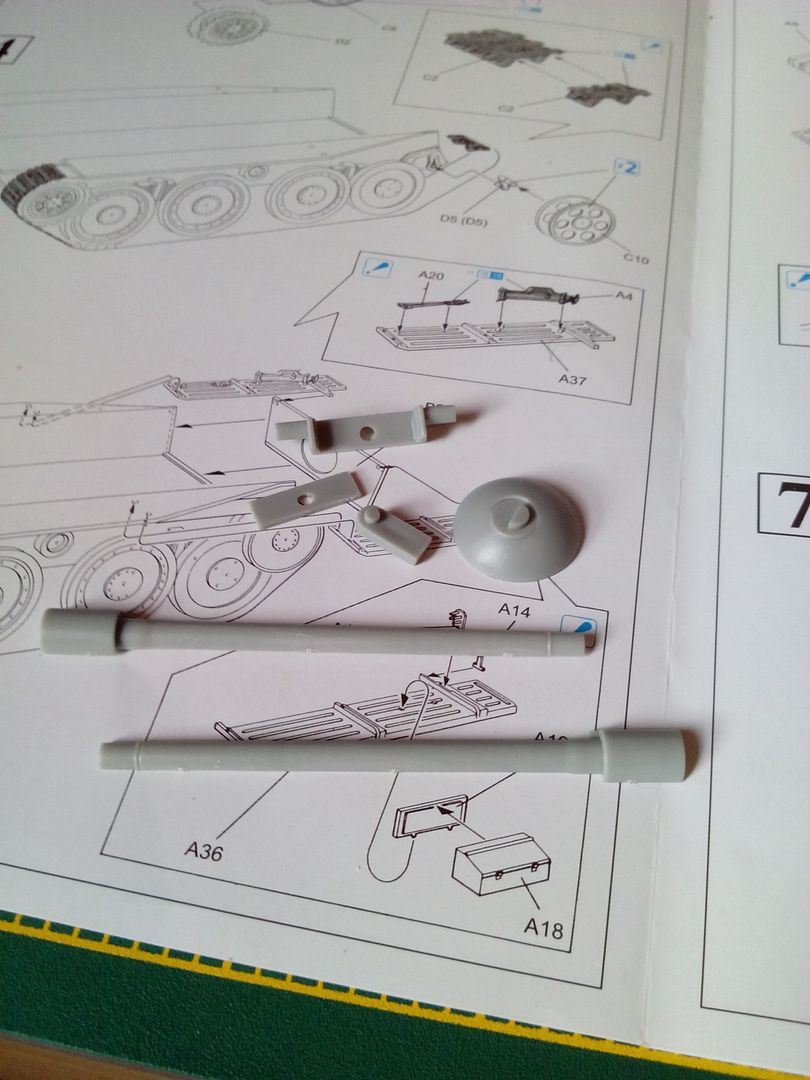

The barrel which was a really good fit for a 2 piece
Had to drill out 3 small holes in the hull
The machine gun with PE plates

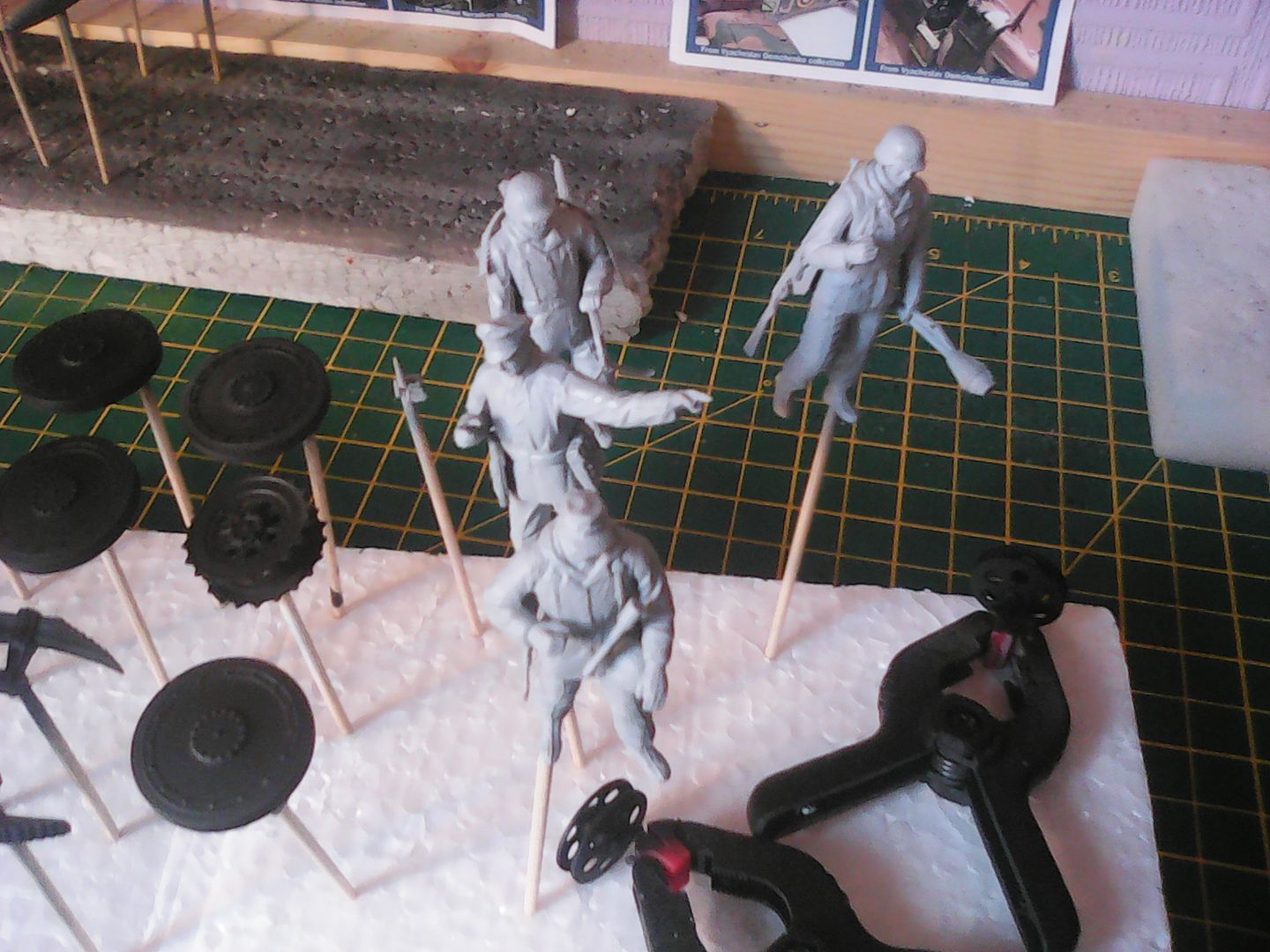

I also made up the figures
Thats all for now there has been no major fit issues so far with this kit
Thanks for taking a look

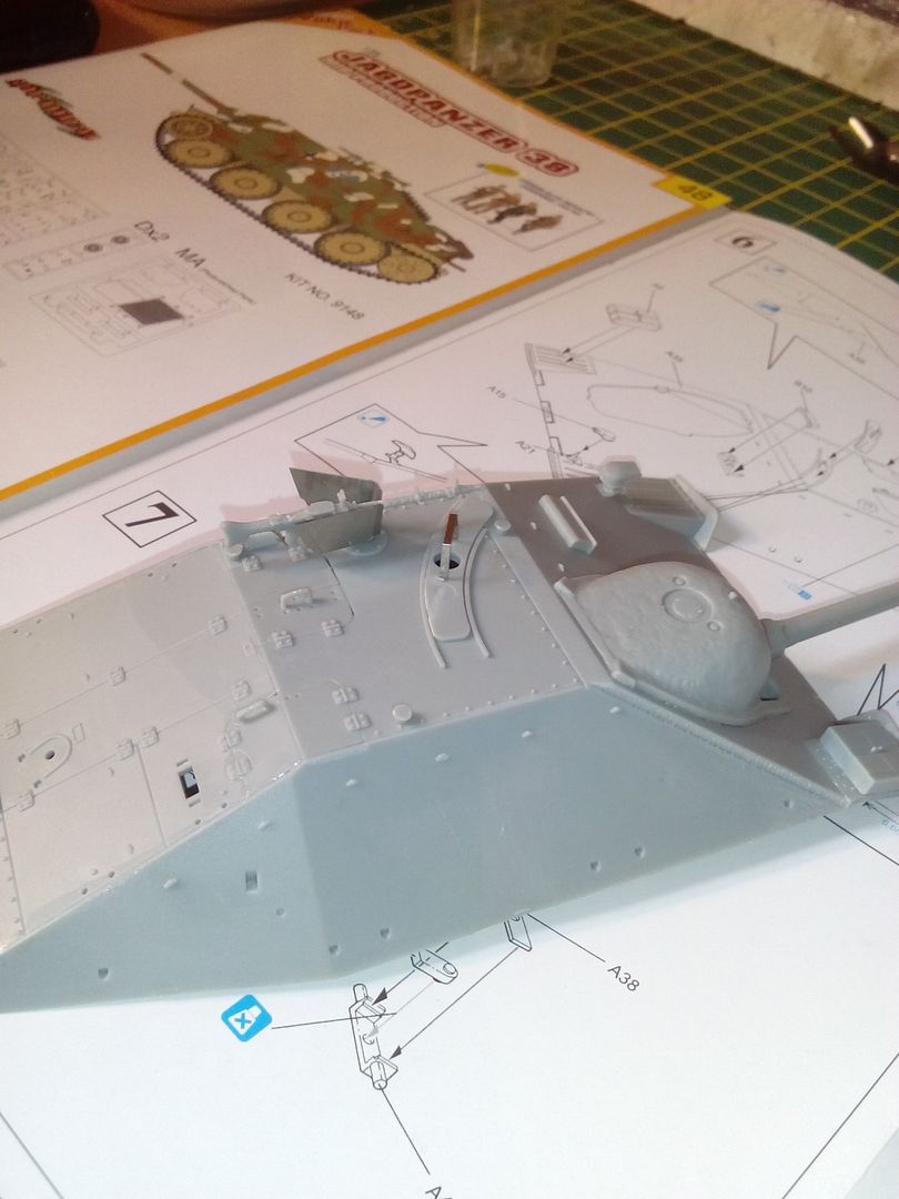

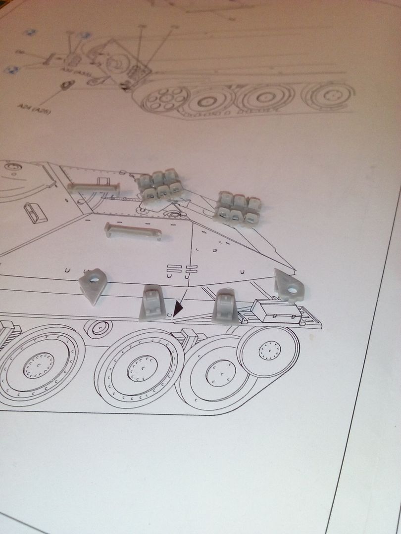

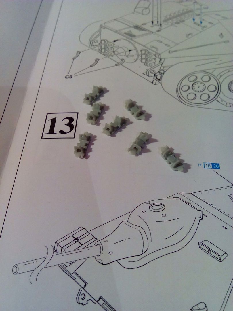

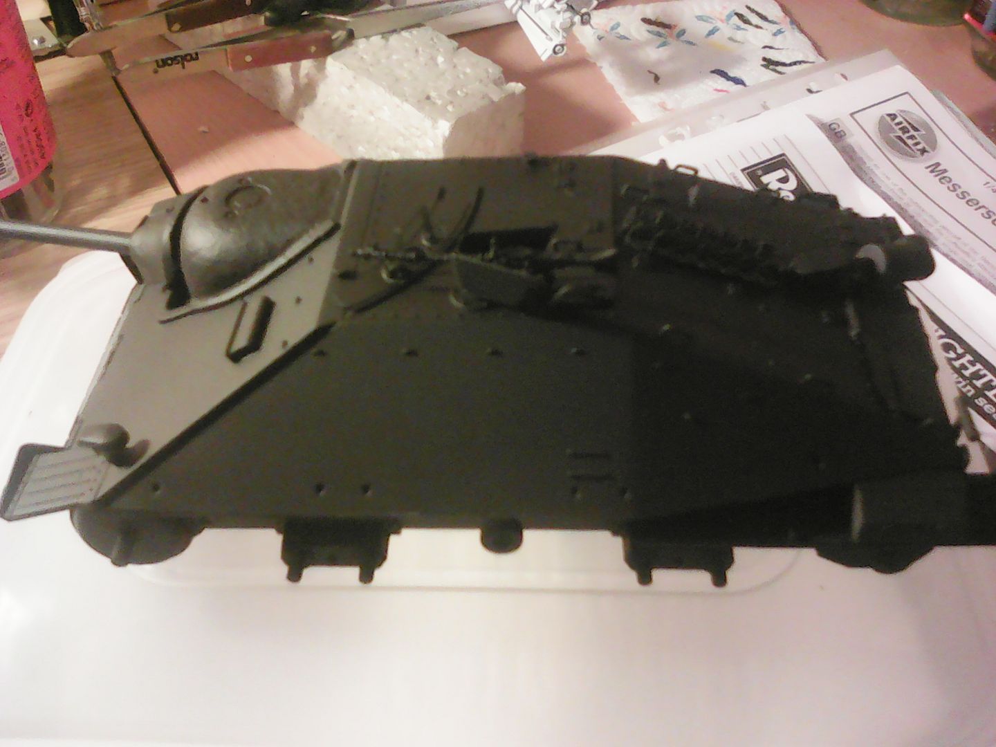

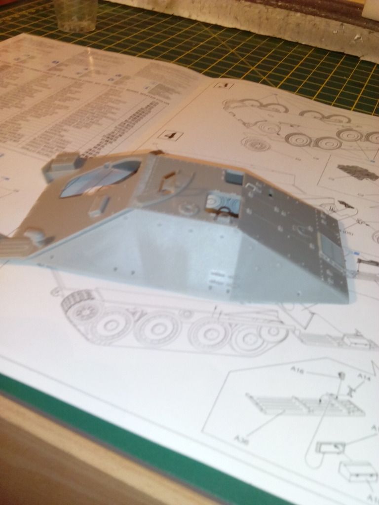

Got a little more done on this the spare tracks and PE on the upper hull
All ready for priming
and primed using badger black and grey primer
That is all for now just need to build the tracks and lay some paint down
Thanks for looking

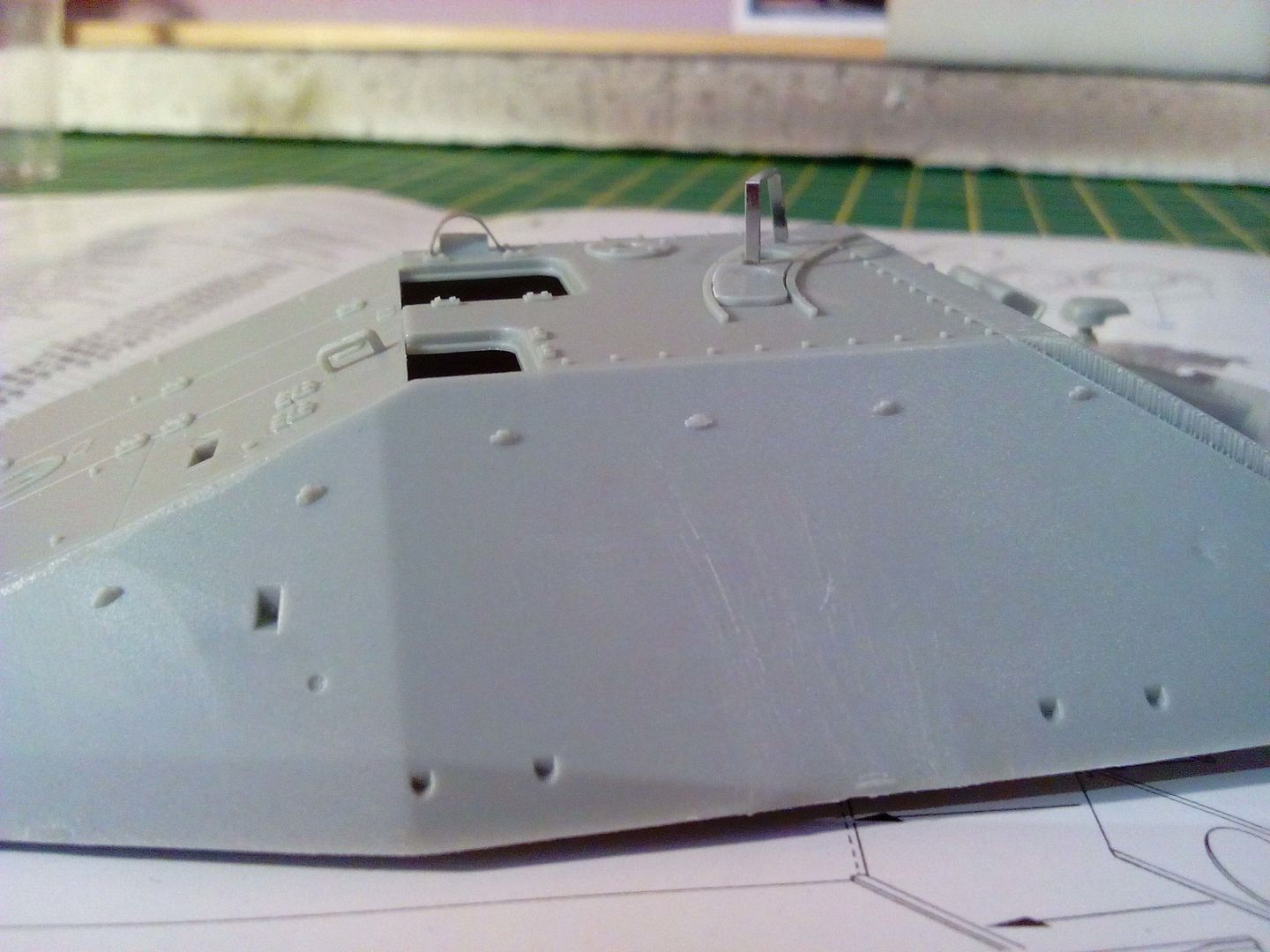

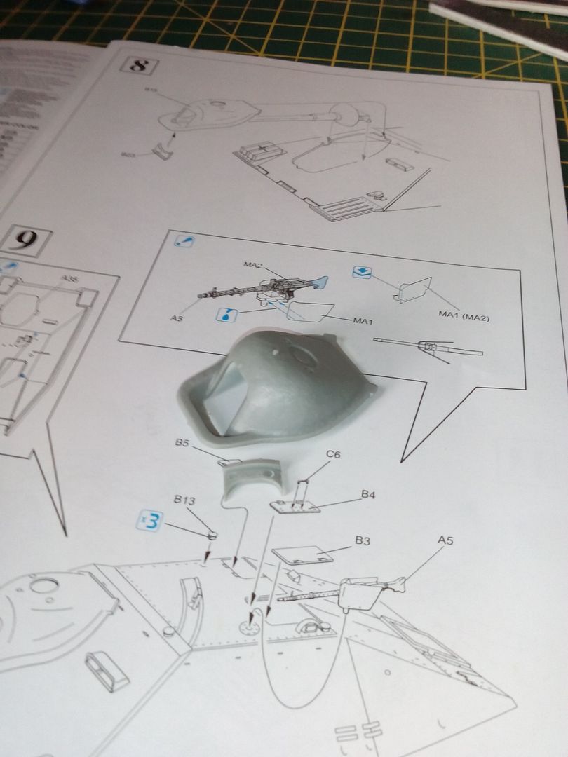

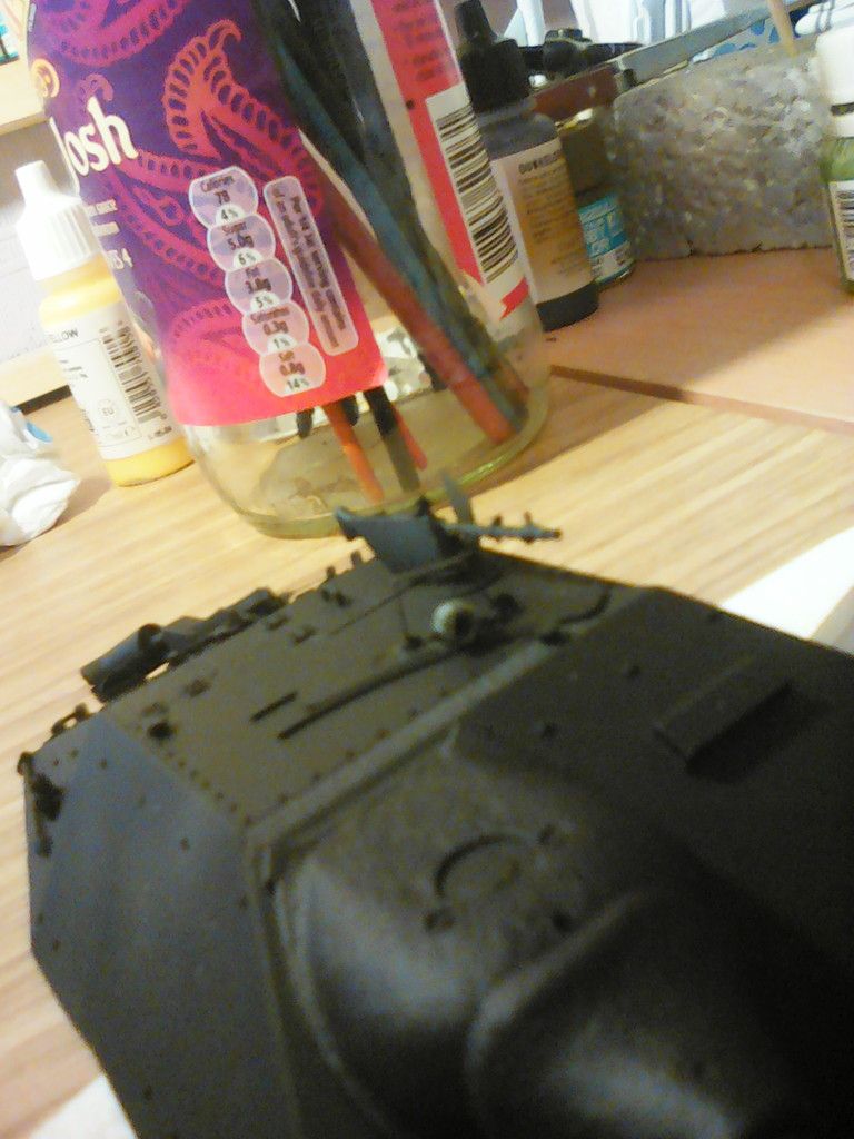

Just a quick question Mike i di try to PM you but it didn't work

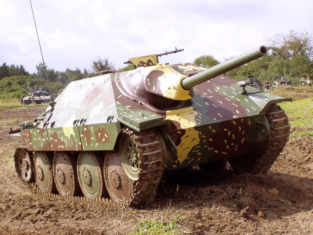

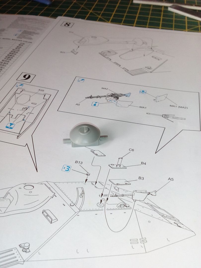

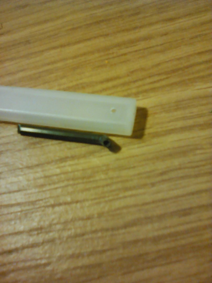

I have seen with other builds of this thread that there is a periscope on the top of the hull now i have the hole but no parts for it. Do i need to scratch build one or maybe an hatch
Thanks
There's actually two periscopes, the main gun sight that poke out through the small hole in the half moon shaped slider on the roof, and the commander's scissor periscope, which you would only see if the COs hatch was open.
I seem to remember having to scratch build a main gun sight for my first jadg38(t) a few years ago as it didn't come in the kit.
It's not a difficult thing to scratch build, just two tubes and a wedge shaped piece of styrene.
Thanks mike i'll see what i can come up with

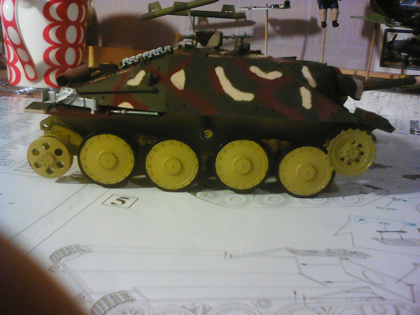

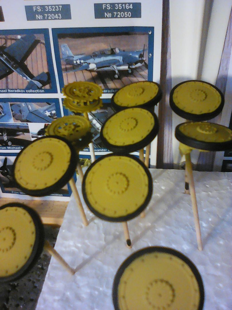

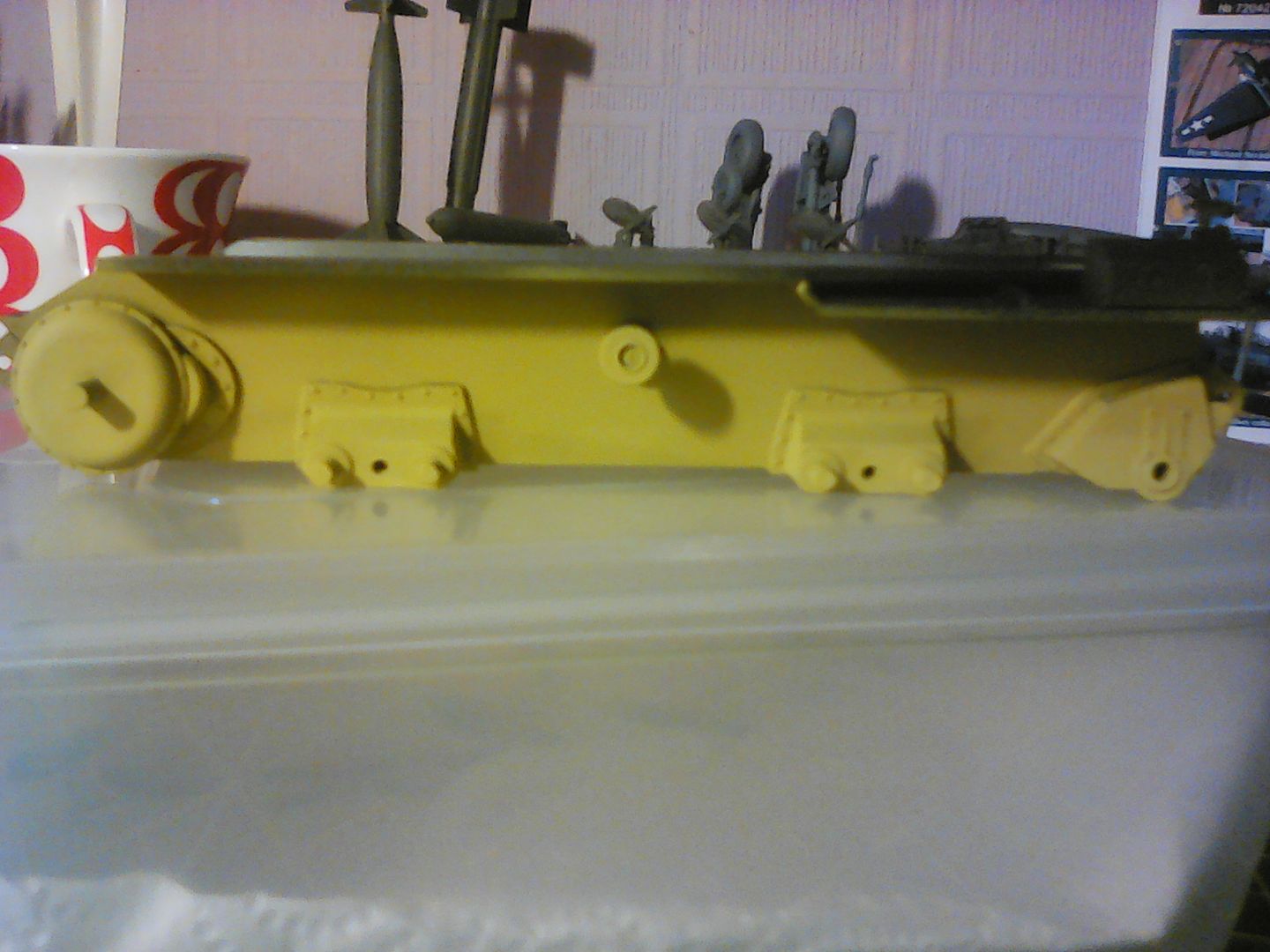

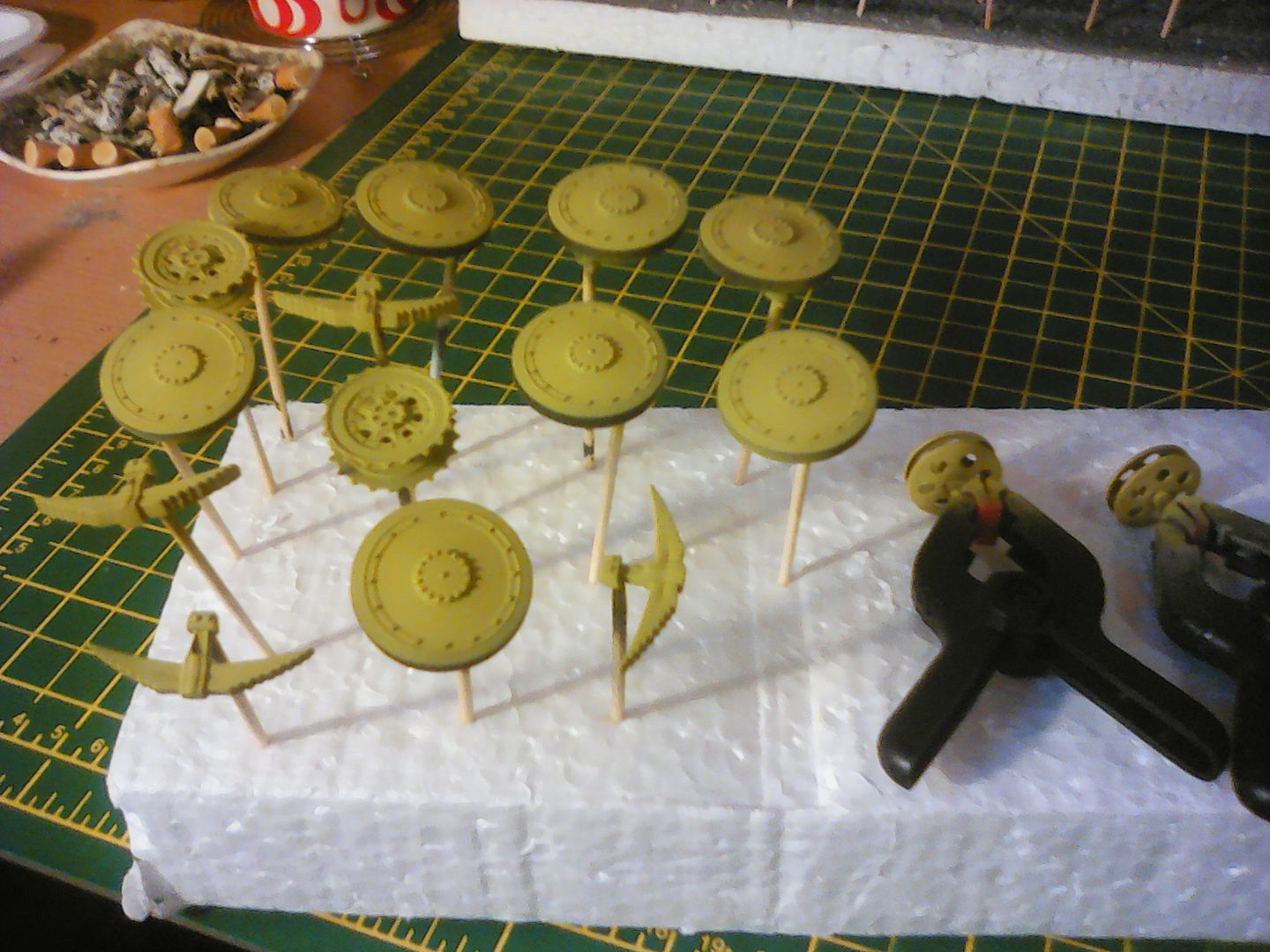

Right so what i came up with for the missing periscope was to use some sprue
, heat it up a little to form the bend and then drill out the end I hope this looks the part ( thanks for your advice mike)

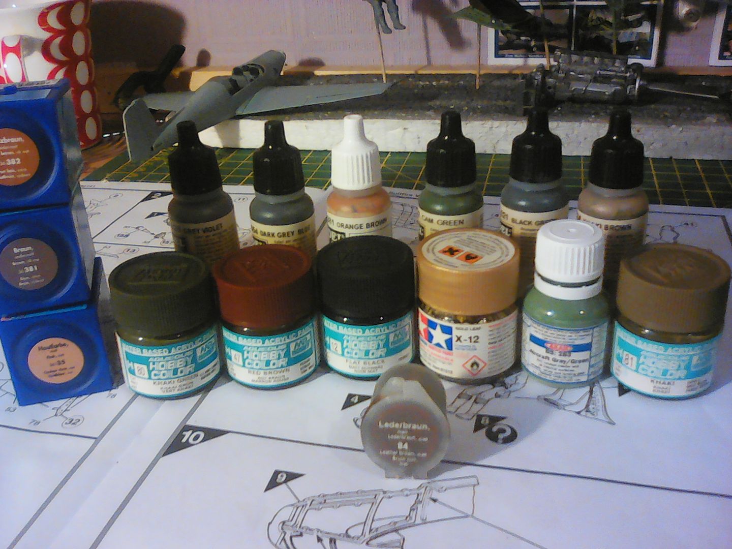

With that taken care of i set about putting some paint on the lower hull, suspension and the wheels
for this i used Tamiya XF-4 yellow green mr hobby H-12 flat black and on the suspension after painting i gave it an oil wash of engine grease
That's all for now next up ill be putting together the track links and atempting the uniform camo patterns

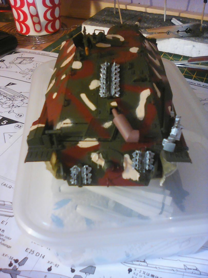

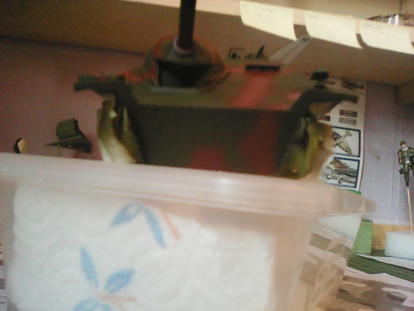

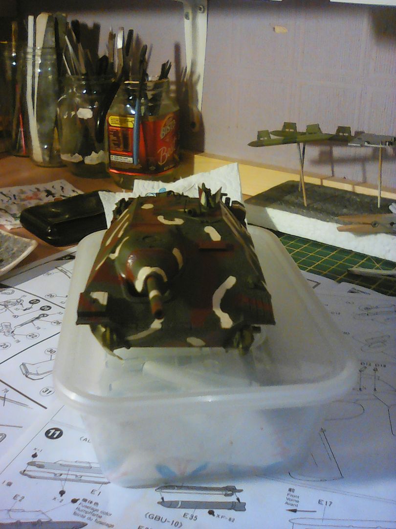

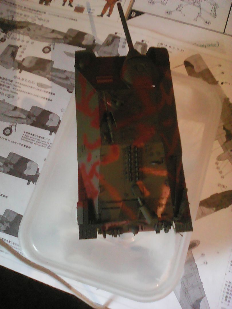

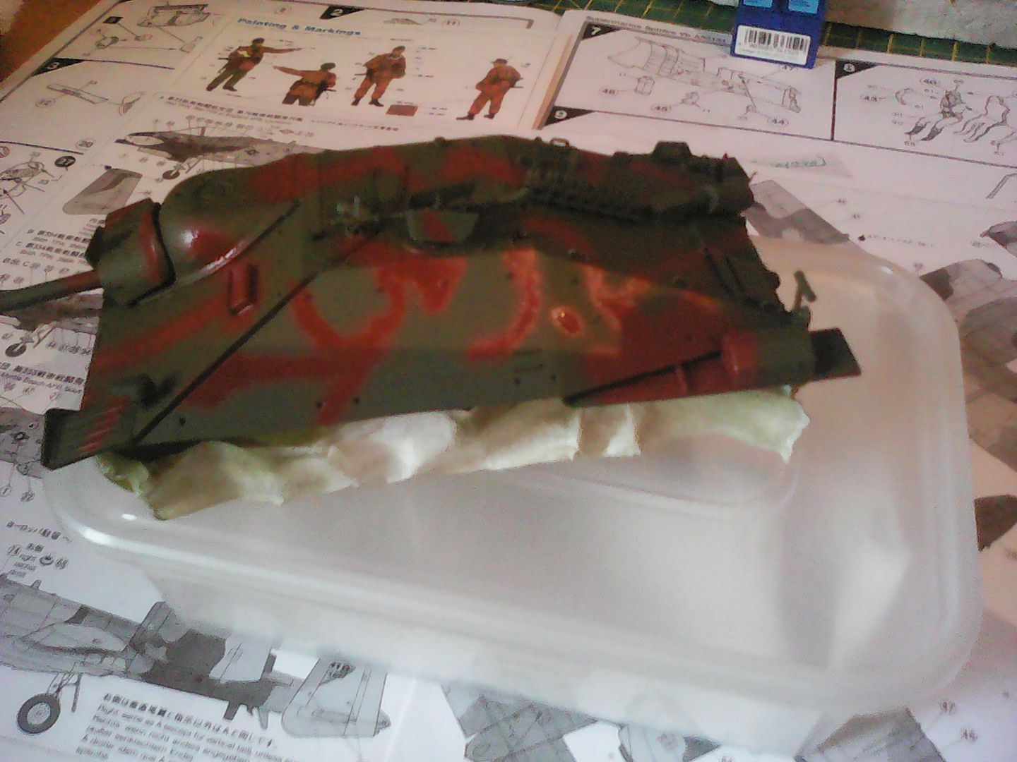

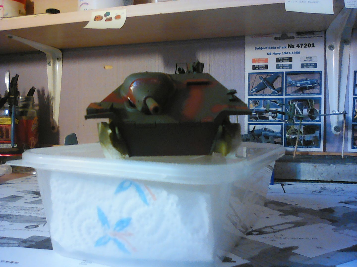

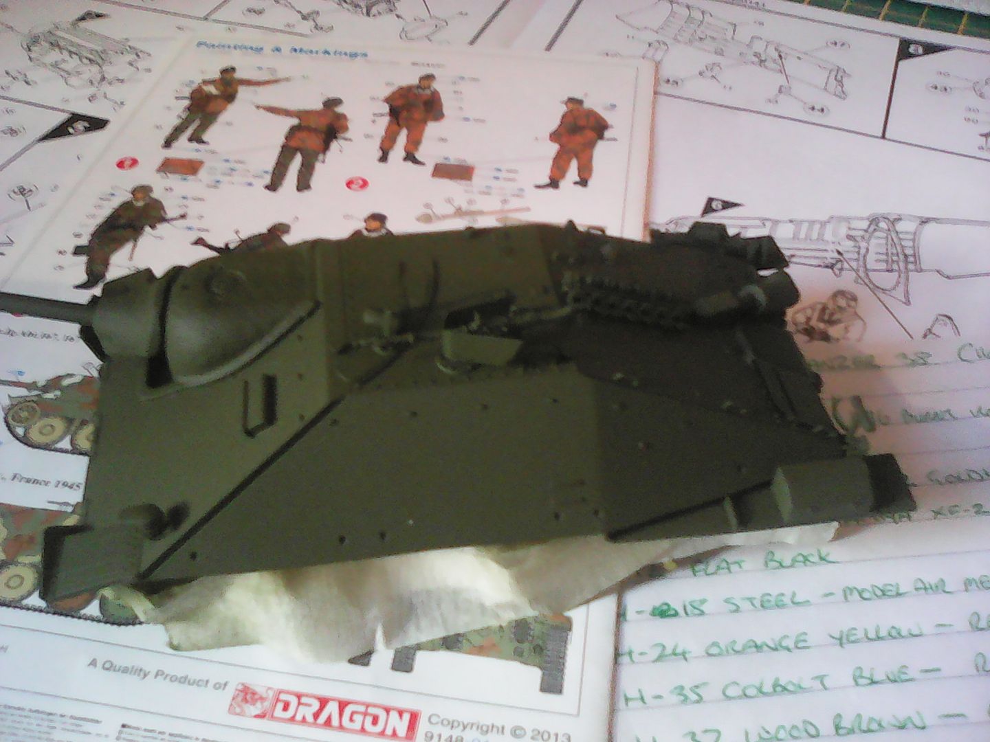

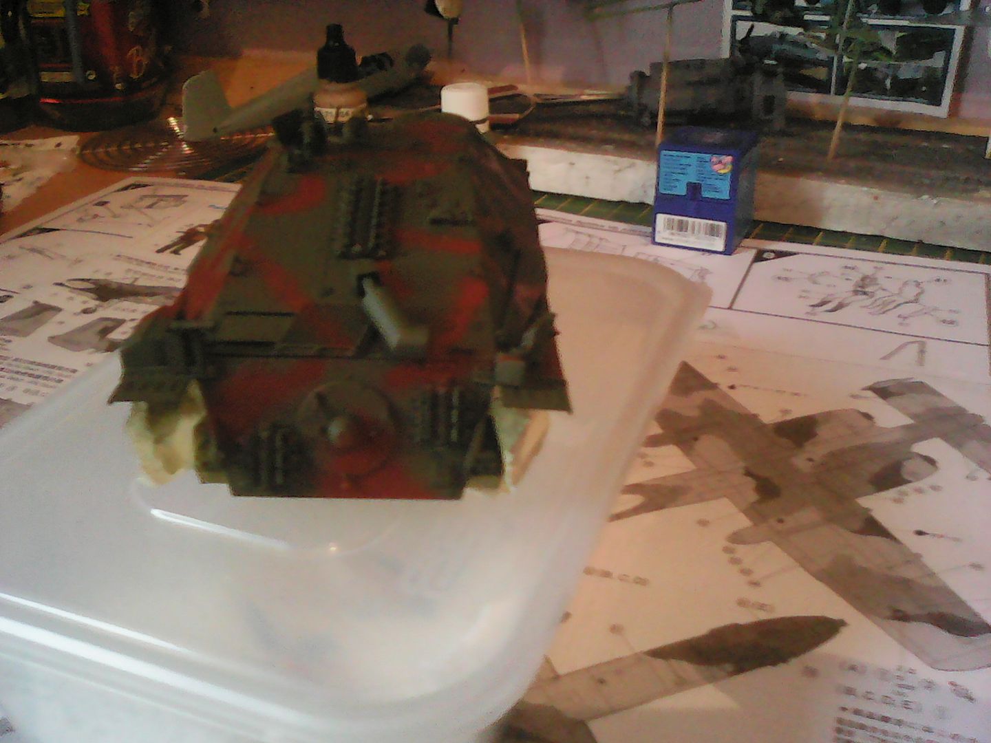

Just a quick update

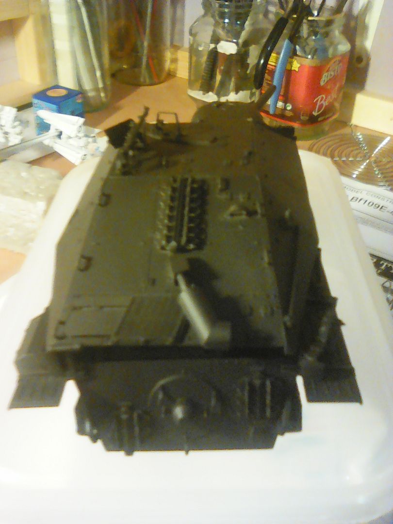

I've got this primed with badger black primer through a 0.4mm needle and it went down great

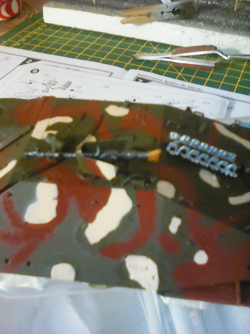

then base coated it using mr hobby H-80 khaki green
Then using mr hobby H-47 red brown i laid down the 2nd of the camo scheme it looks a little shiny at the moment so i'm hoping after a dark wash and a matt coat when i've finished the camo will dull it down some what
That is all for now sorry for the quality of the pics
Thanks for looking and your comments

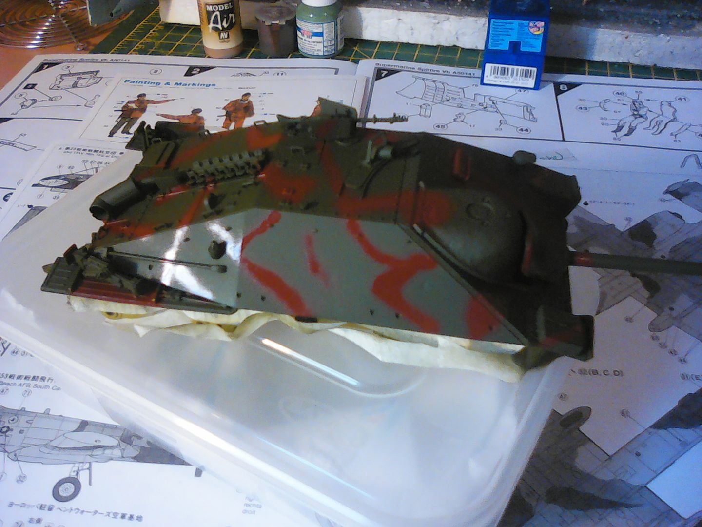

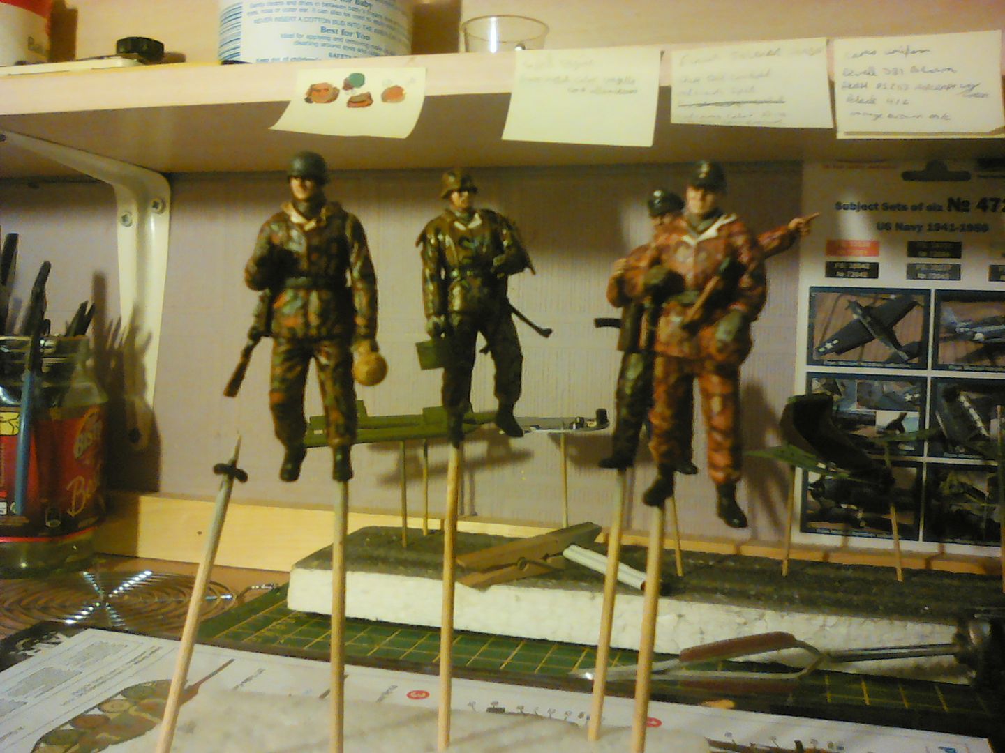

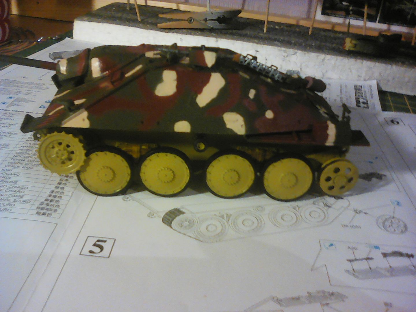

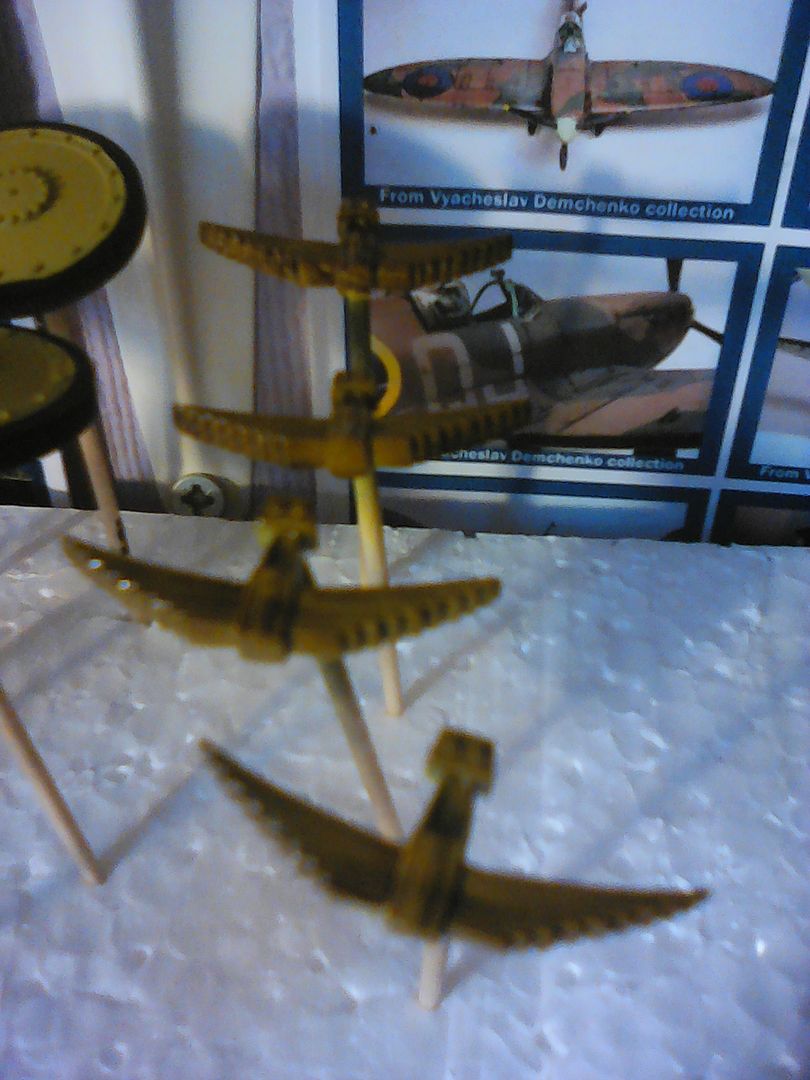

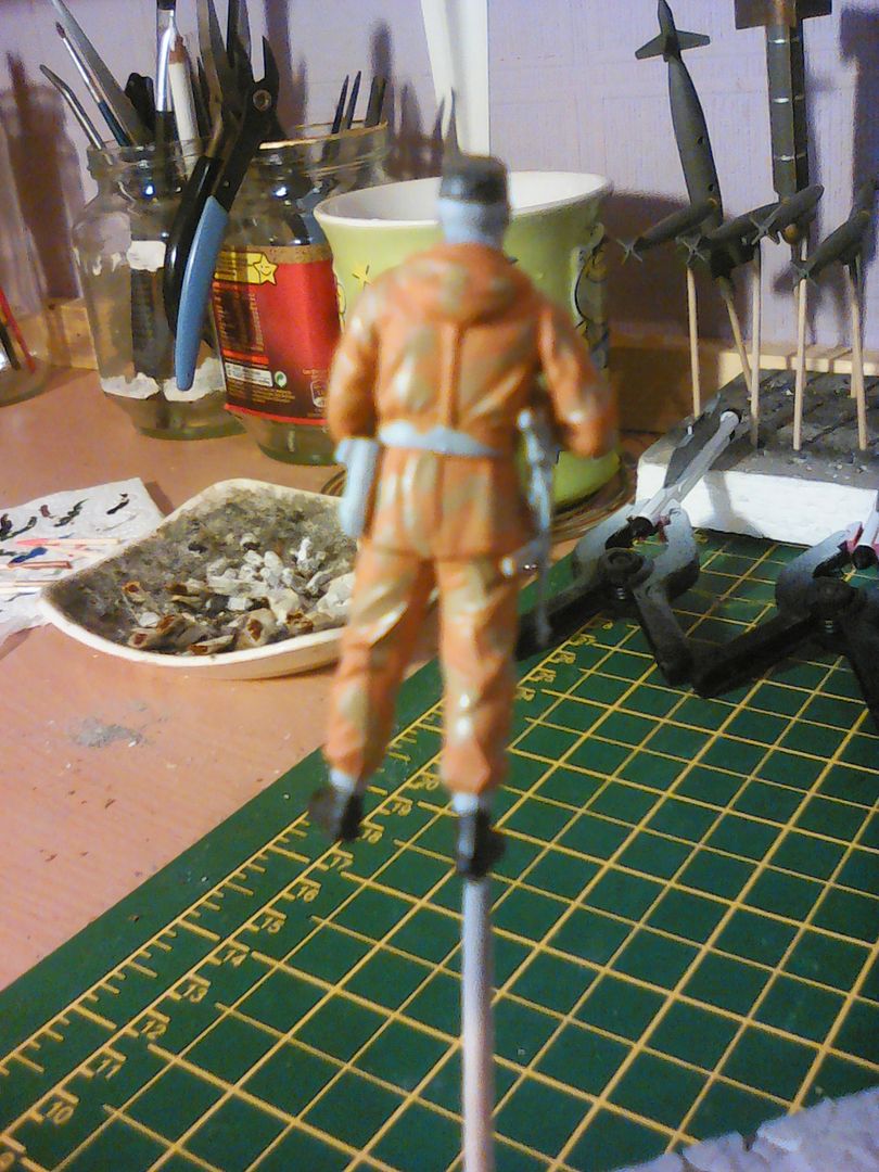

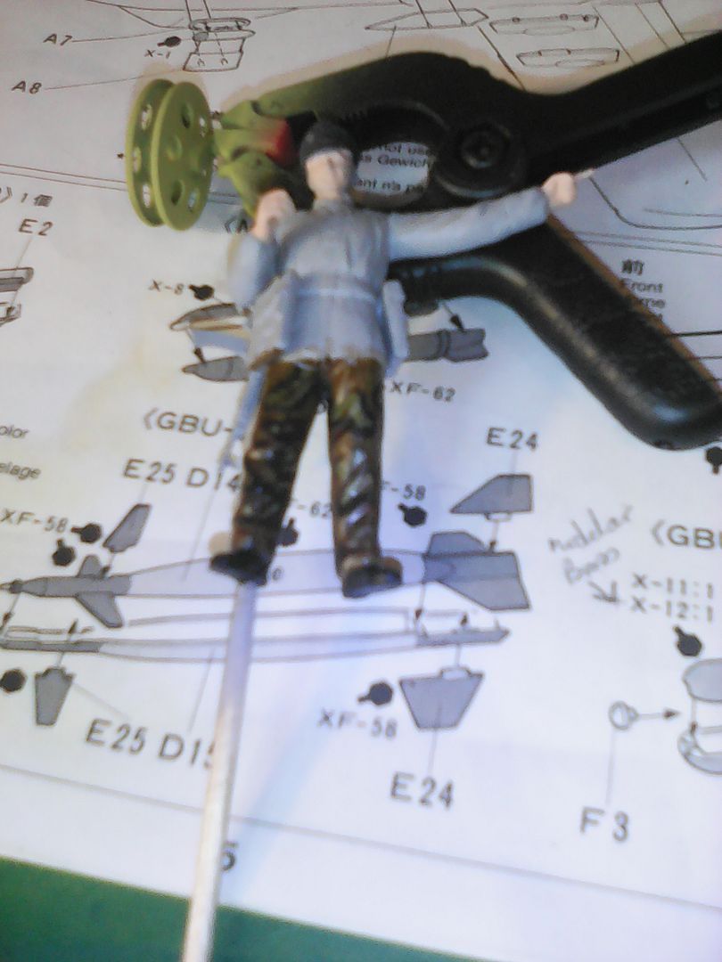

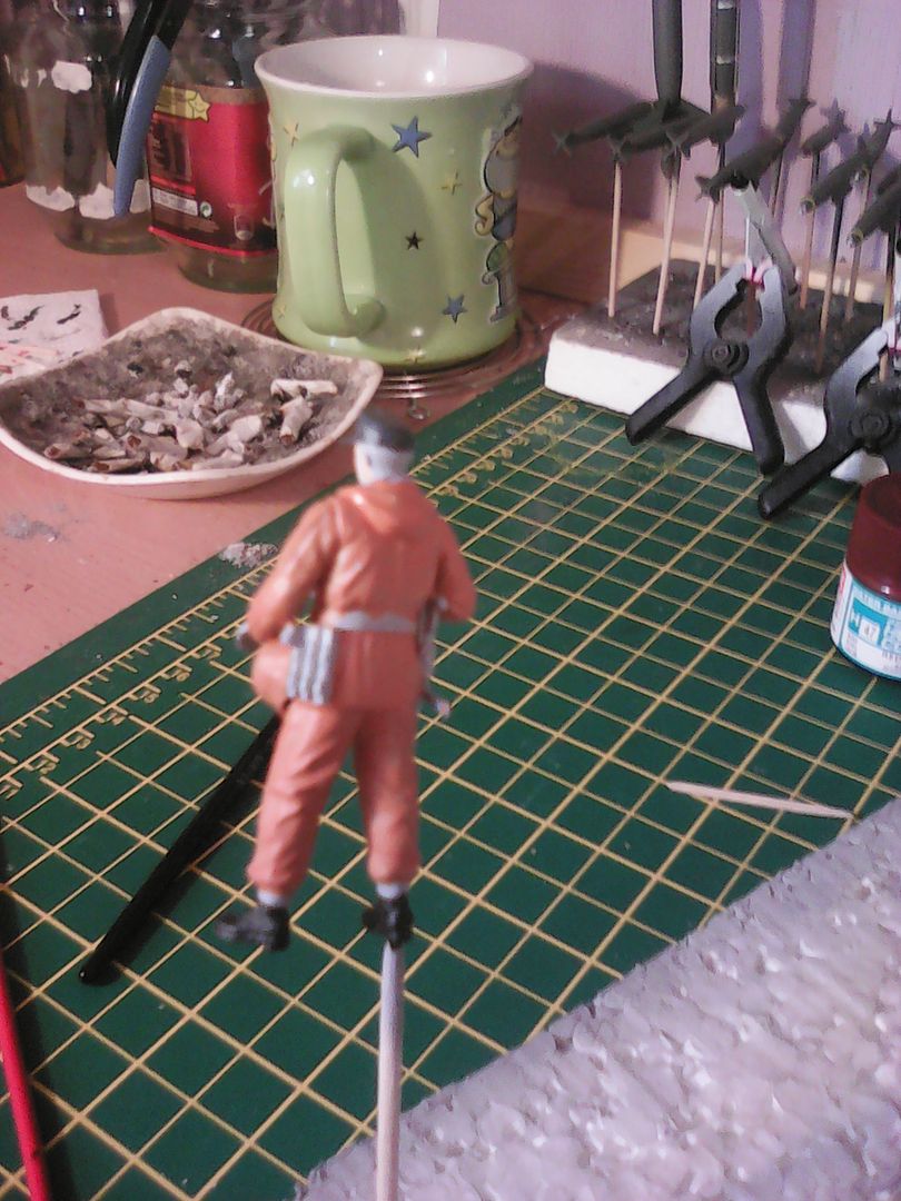

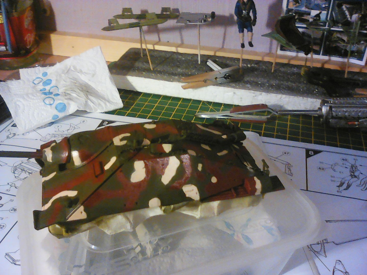

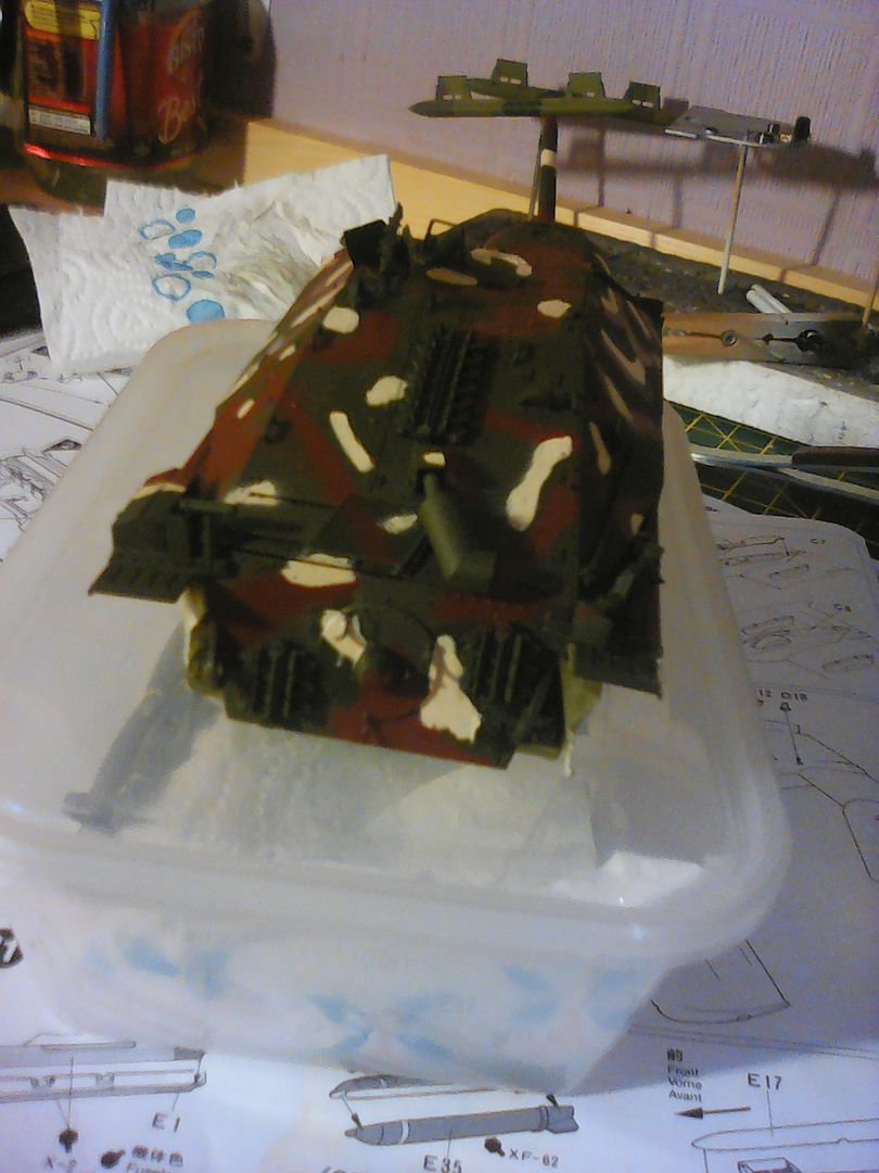

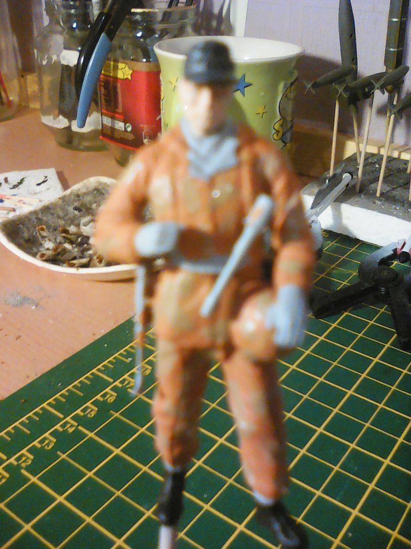

New update

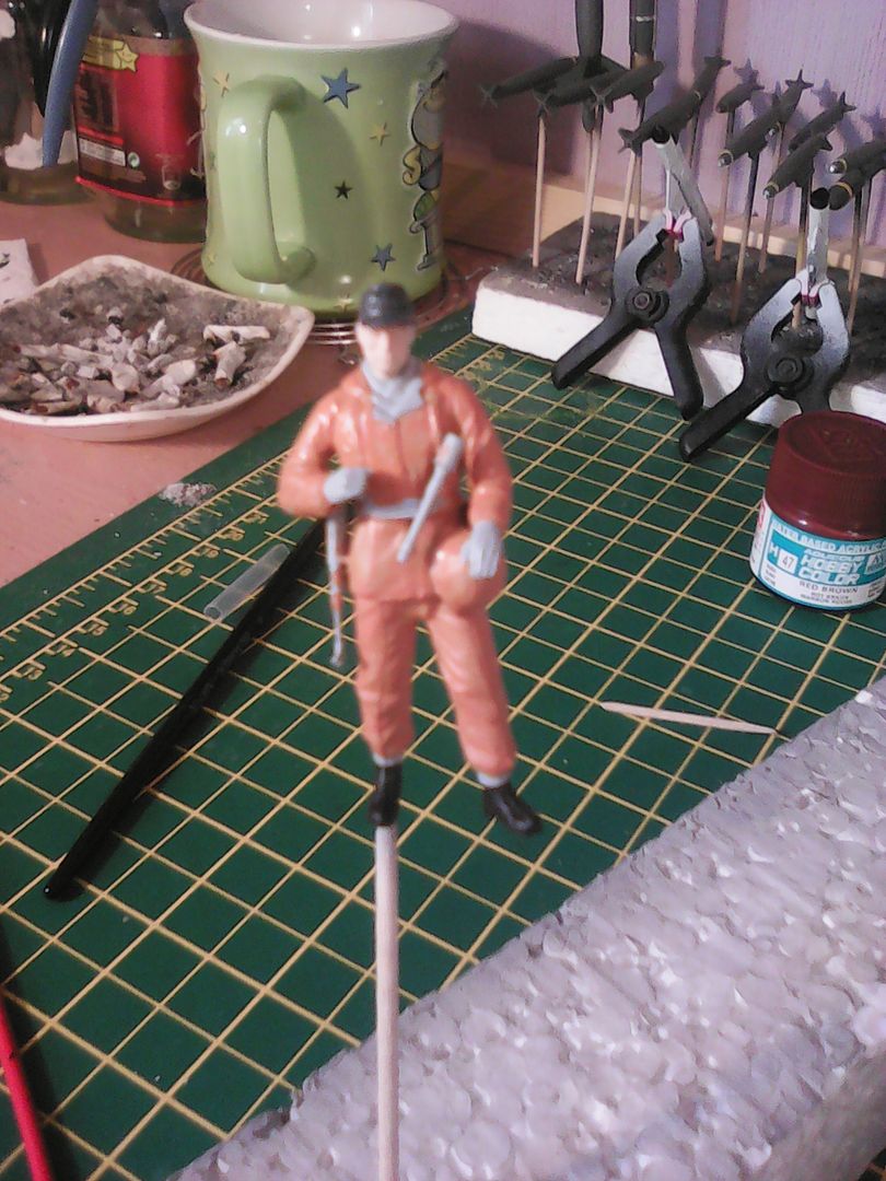

Whist doing the camo pattern on the body i painted up the soldiers and gave them a dark wash and a flat coat
this is a first for me doing camo on figures, instesd of listing all the paints i used as there is a lot of them i decided to take a pic of the paints used
Now for the 3rd color of the camo it said to mix 50-50 yellow and white but for this i decided to use mr hobby H-318 radome which i feel works just as well then did some of the detail painting and attached the wheels
All thats left to do is build the tracks
Then to darken it down with a wash
That's all for now thanks for looking and for all your comments

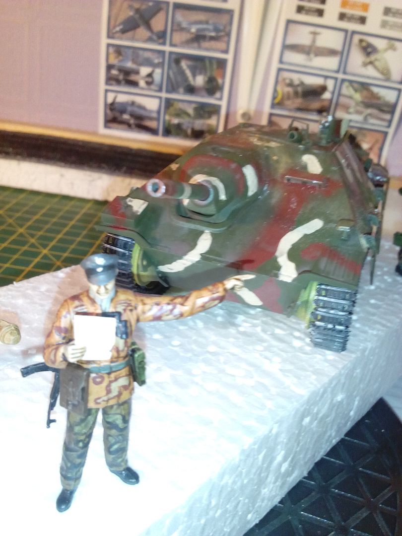

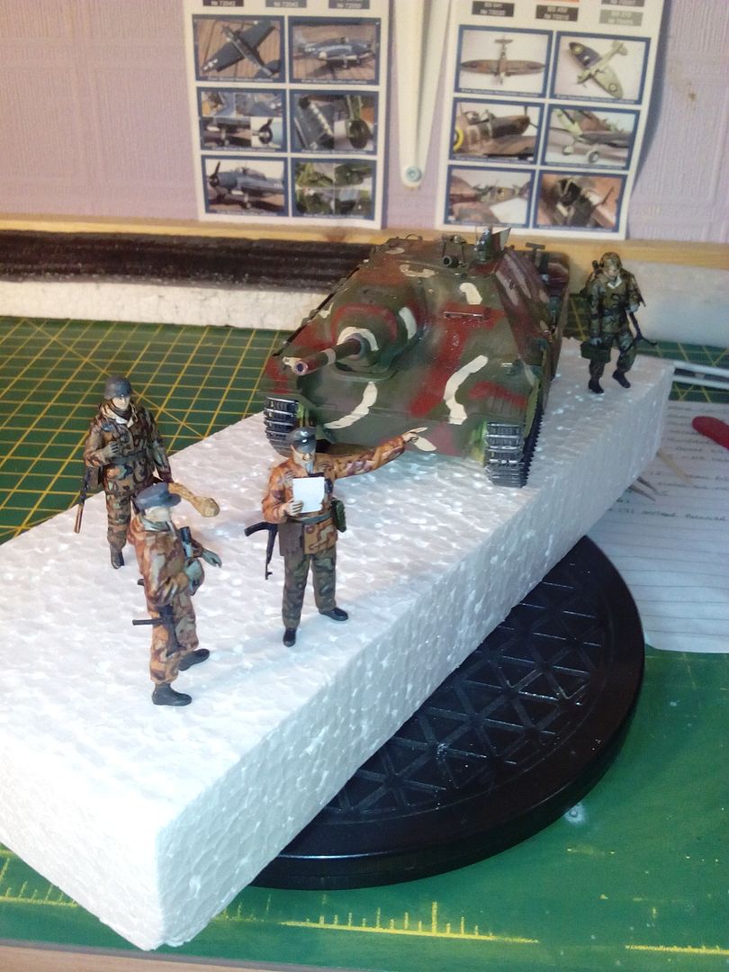

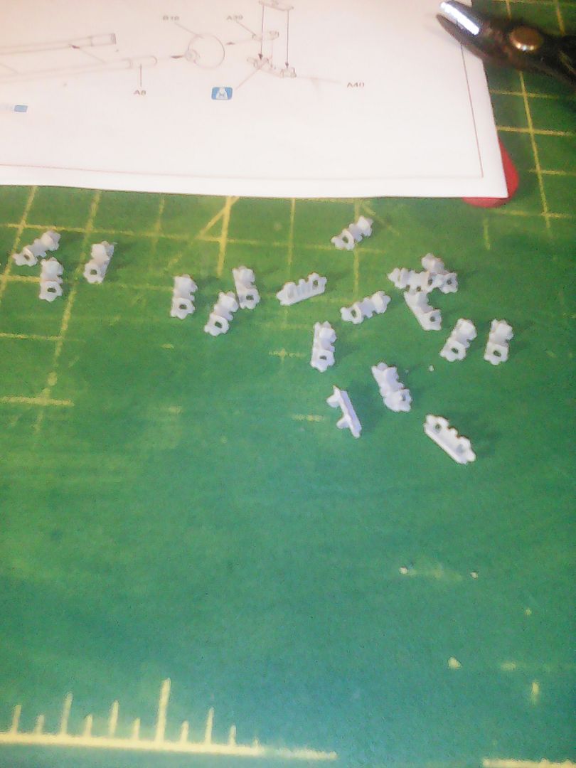

So with the tracks built and painted in black with a silver dry brushing
Here it is all finished
Thanks for looking and for your comments
