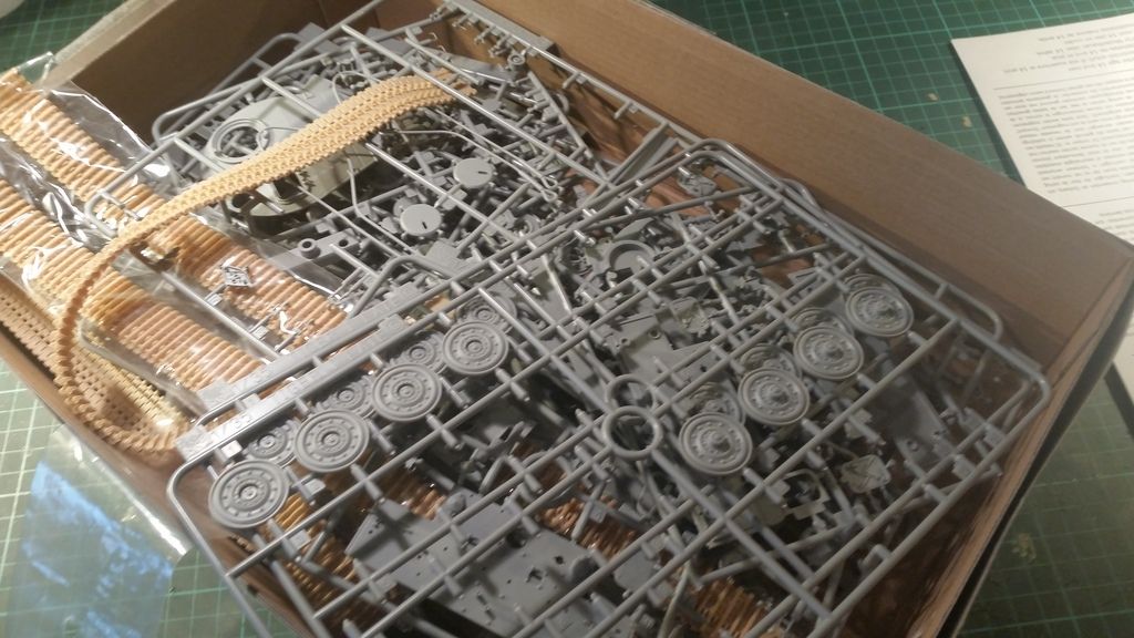

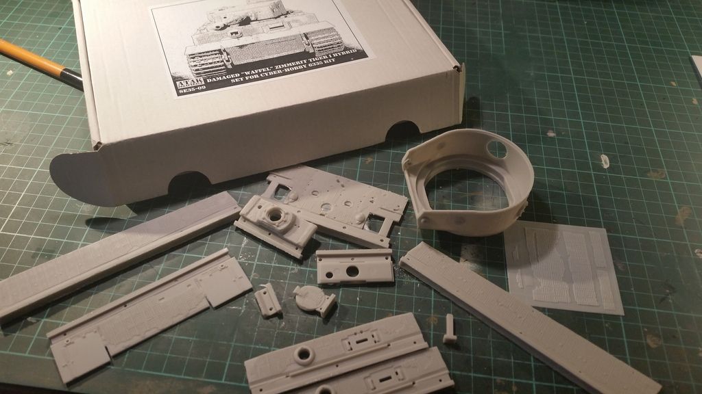

What i also got are these
And this
The Atak set is supossed to fit the Cyber Hobby kit but i will make it fit on this one
And the friul tracks should be fine to
And to imagine i got these 3 boxes for the price of the tracks as the guy selling this didn't want to make another kit bashing build with a lot of modifing
So i just went for it
And to make it look a bit better i still have this box of spare parts from my other Tigers i build this year
So i guess i have enough stuff to make this look good and hopefully the skill to back that up

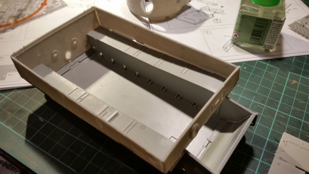

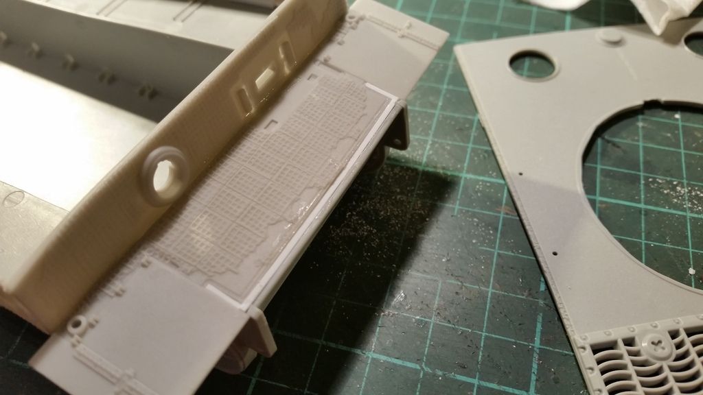

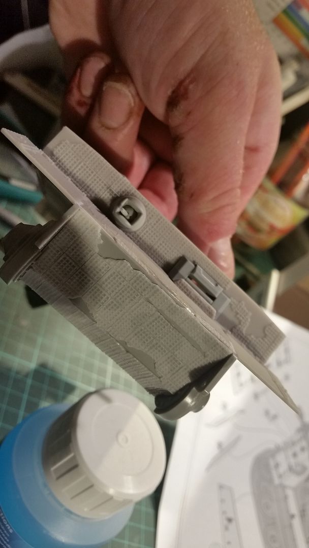

as the atak kit is designed for the dragon kits it didn't fit and i had to cut off the lower part of the kit rearplate
with dragon this is molded on the hull already
it doesn't fit perfectly but there is some more zimmerit to cover the seams and gaps
then i cut the sponsons to size
i did make a mistake with the mesurements and removed too much and i didn't make a straight cut but that will be fixed later
then the sides and drivers plate where added

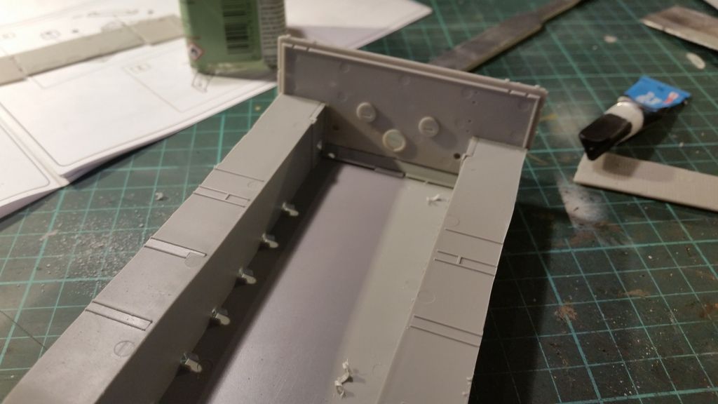

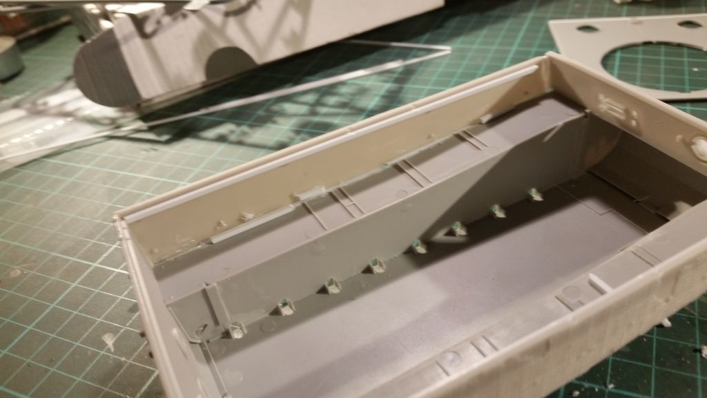

as you can see i used a lot of styrene strips to support the sides
the upper glacis plate didn't fit either
this is because the sides of the hull are too thick and the hull is a bit longer then the dragon hull
i trimmed the sides well those tabs that are raised and used some styrene strip to fill the gap on the front
more strips where used
this time to make supports for the hull roof wich needed to be extended aswell but i wanted to make sure the roof can't fall into the hull when i glue it in and to make sure it is a bit stronger when i have to pick up the model while painting
and finally a test fit of the hull roof
it seems to fit altough i should use some presure when i glue it in as the fit is very tight to say the least

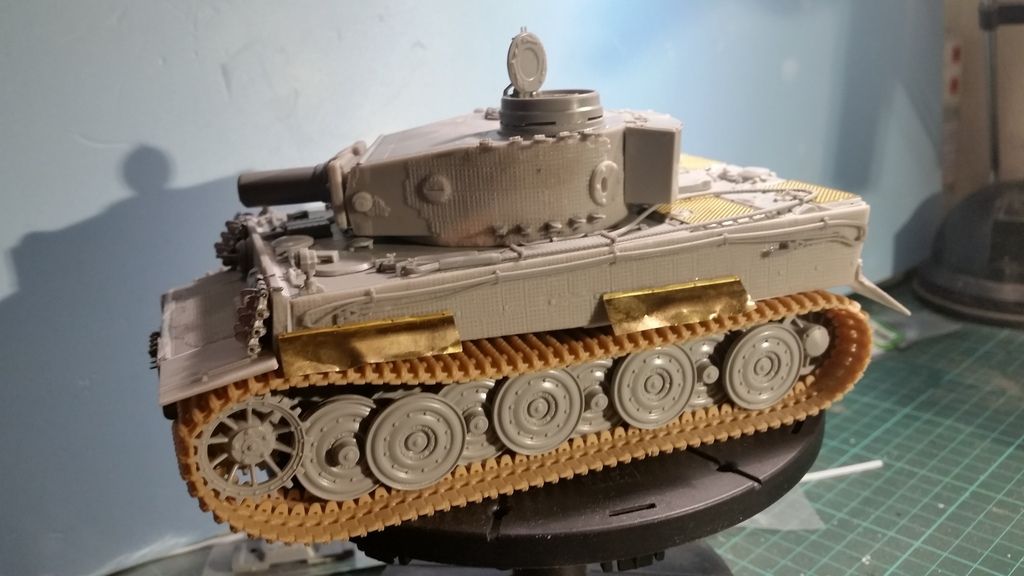

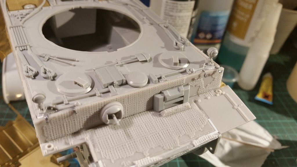

hi guys
so a new update for this build
by now the entire tank is build with 1 very important part missing
the gun is not placed yet as the kit gun was terrible (too short and thick) so i need a replacement and i ordered 1 but as the same order contains some pre order kits that will be availble at the end of the month
they are the re released Tiger 1 Late and Tiger 131 so yaaay even more Tigers but i guess these will stay in the stash for a while
but back to the order at hand , the gun is missing but i want to paint it in a dark grey as the heat resistant primer without a coat of paint over it so it doesn't matter it is not here yet
as for the rest of the build it went pretty good and i replaced all the kit tools with spare dragon parts
the same goes for some other bits and pieces
but a picture says more then a thousand words so let's go to that part

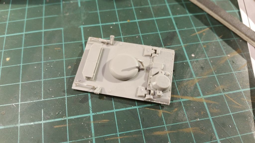

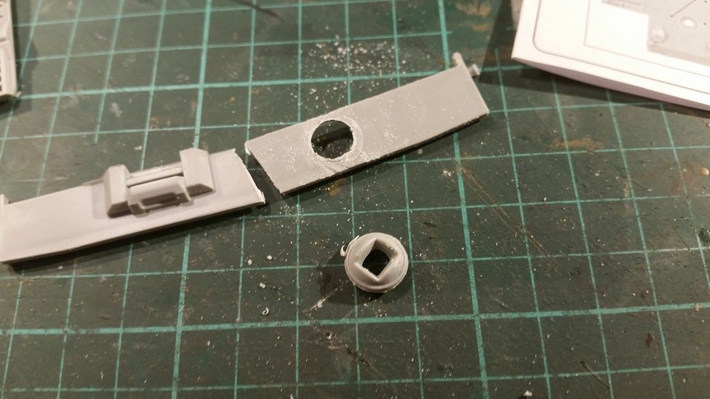

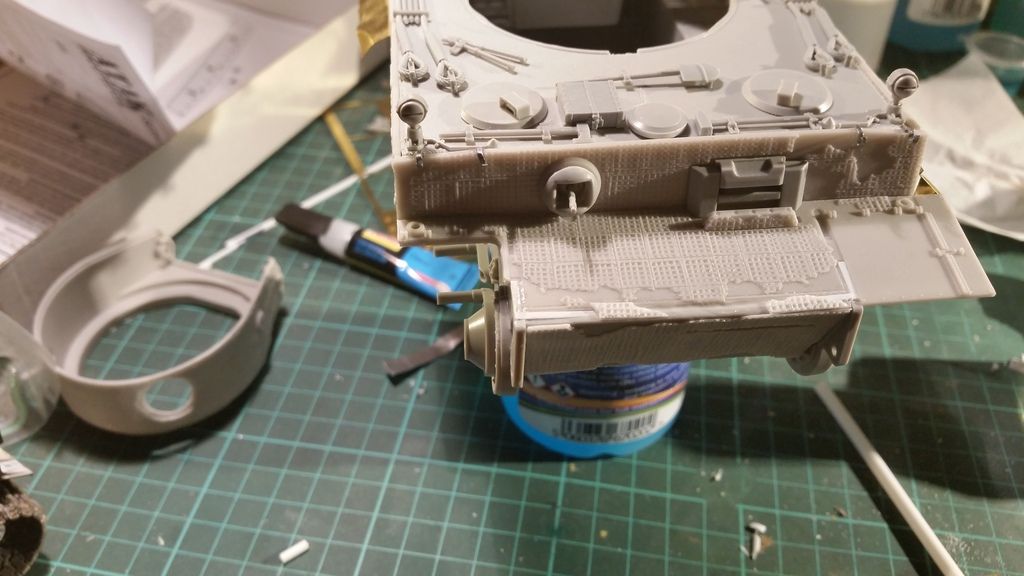

the first thing was to get a front part for the mg mantlet wich had to be removed from the italeri part
it was then cut to size so it would fit and glued on the hull

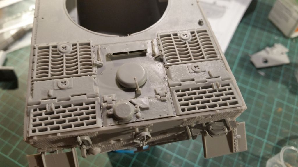

the engine cover was glued together but i changed a few bits later

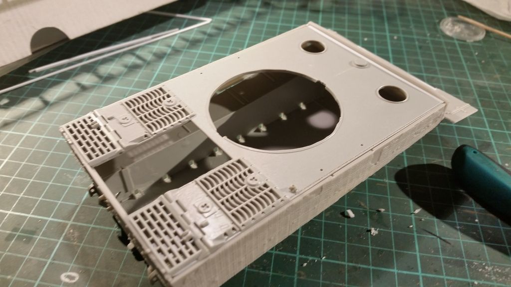

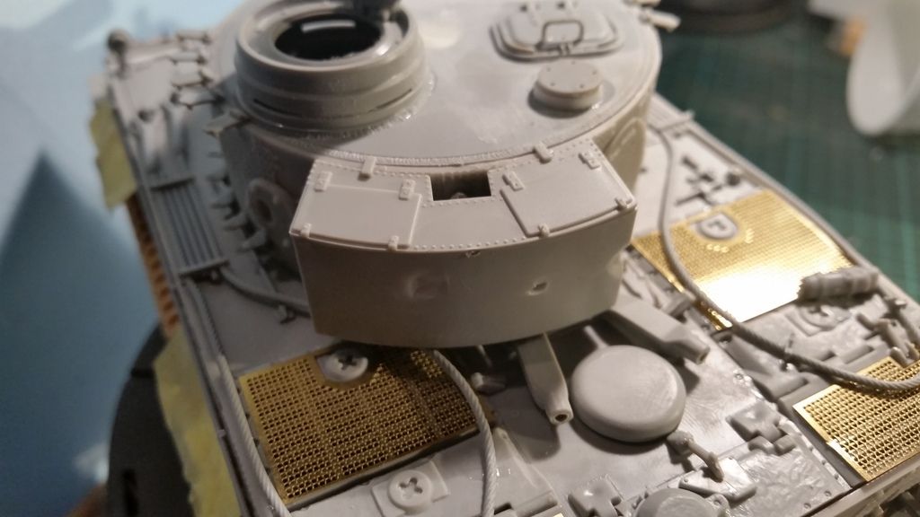

the hole for the turret had to be enlarged as the dragon/atak turret is bigger
the antenna mount was cut of the hull roof and replaced with a nicer looking spare part
although it now strikes me that i didn't add a antenna yet :bash:

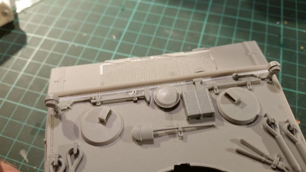

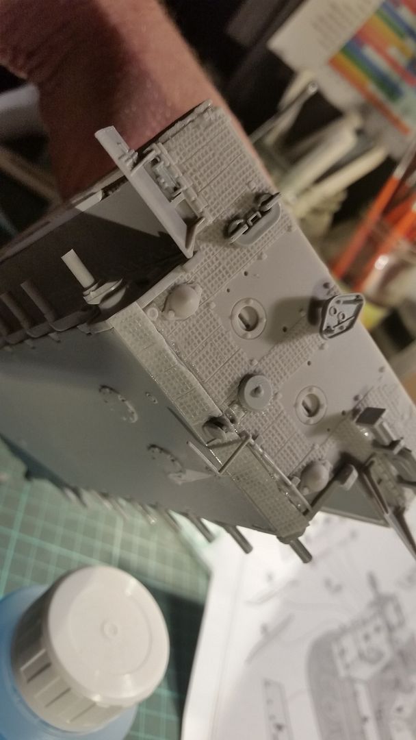

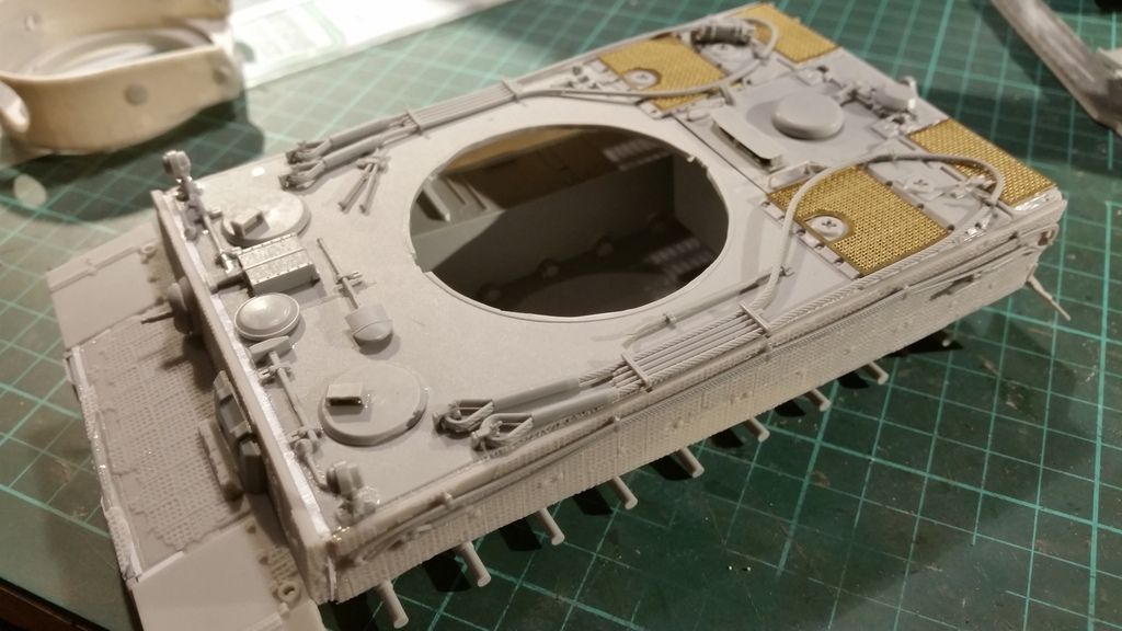

the engine tub and cover where placed this gives the roof plate a bit more strenght wis was needed to keep it from deforming when i try to place it on the hull
some rear plate tools where added
these are all from the basekit but look okay only the jack is missing a part but i want to make it look damaged later on by adding rust and a inregular shape where the small endcap should be
the tools where added
these are all spare parts from dragon kits
the white styrene strip was soaked with some TET and then scratched with a blade to make a weld seam
i did this before i added the tools but forgot to shoot a picture of it (not my finest hour :mrgreen: )

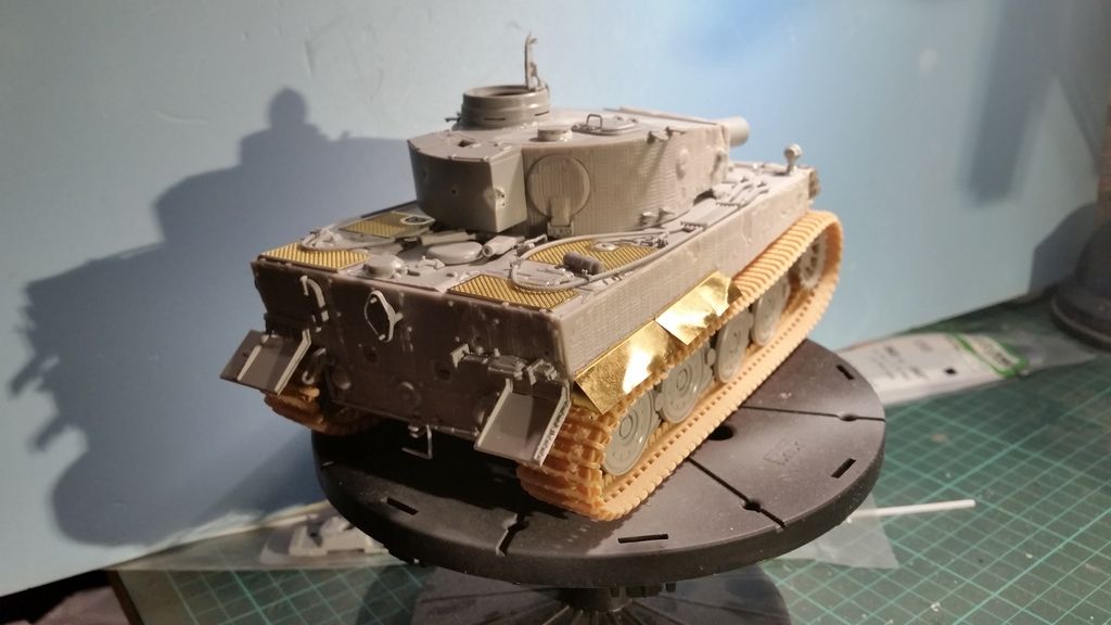

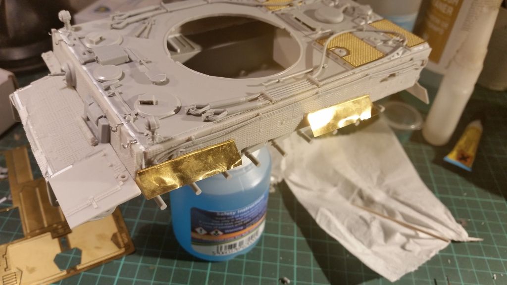

the side skirts where added
these are from the italeri kit but are made by a other company
they are nice not the same quality as voyager or aber but still they are good
they where bend up and then glued on

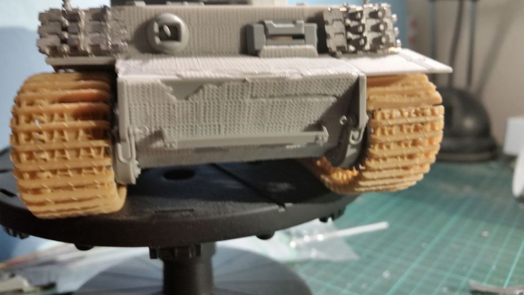

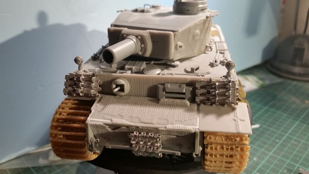

i then decided to add more battle damage so i cut off one of the front fenders
when you lok at a photo of a real Fehrmann or hybrid Tiger you can see 2 rows of 3 tracks hanging on the front

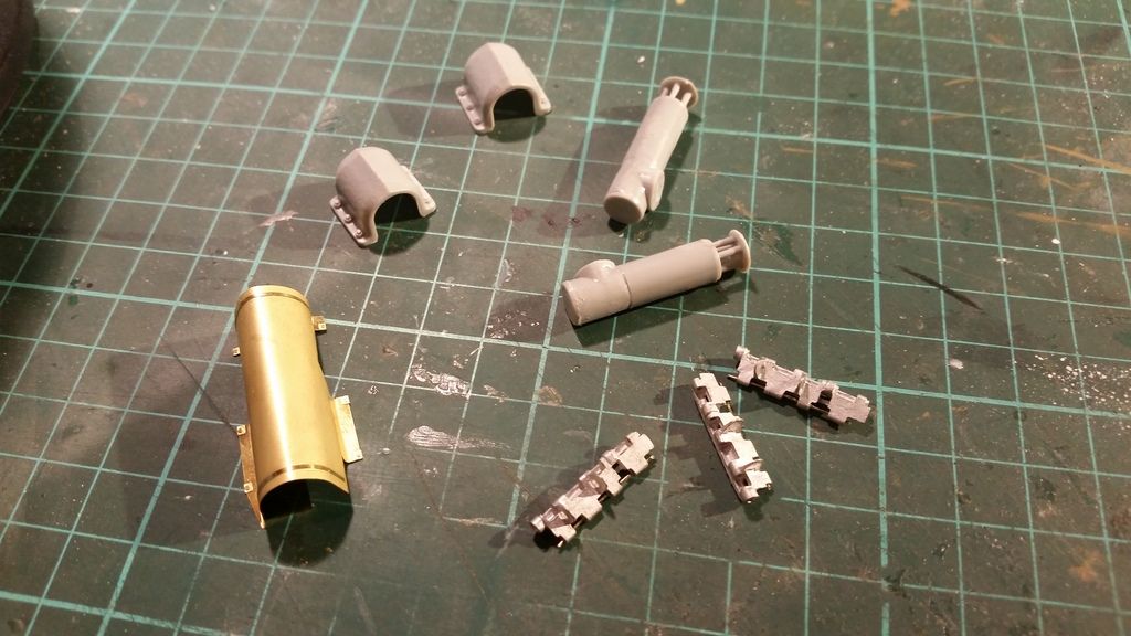

to add these i made some small hooks with leadfoil wich where reënforced with some ca glue

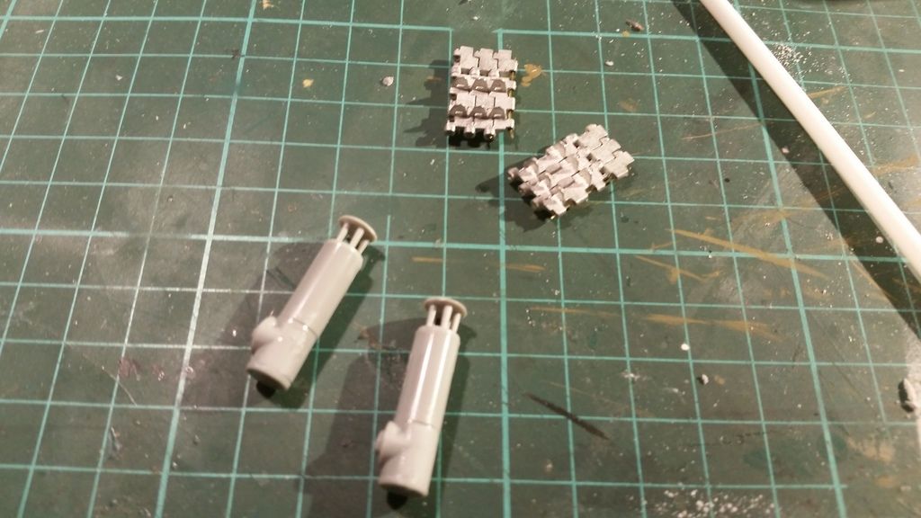

the exhausts and the spare tracks for the front

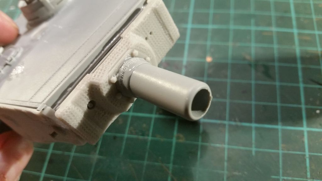

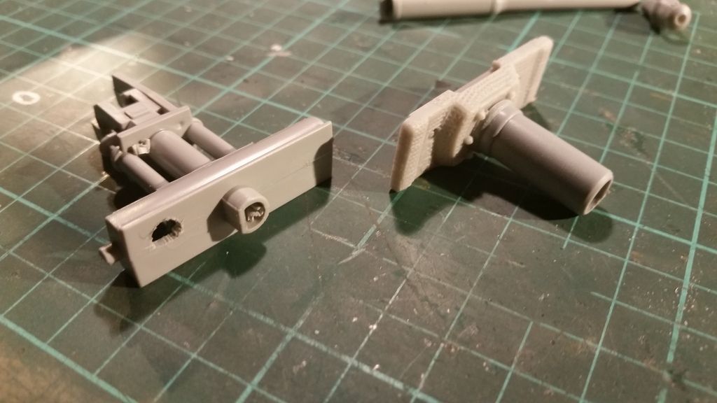

the gun needed some modifying
the internal part is from italeri the zimmerit mantlet is from atak and the sleeve was cut from a spare mantlet

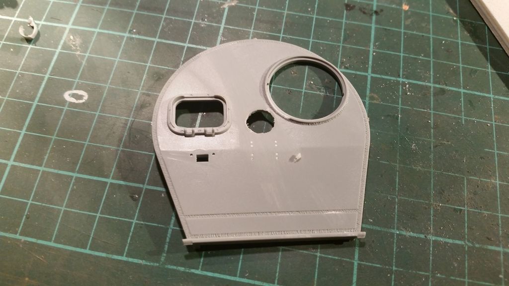

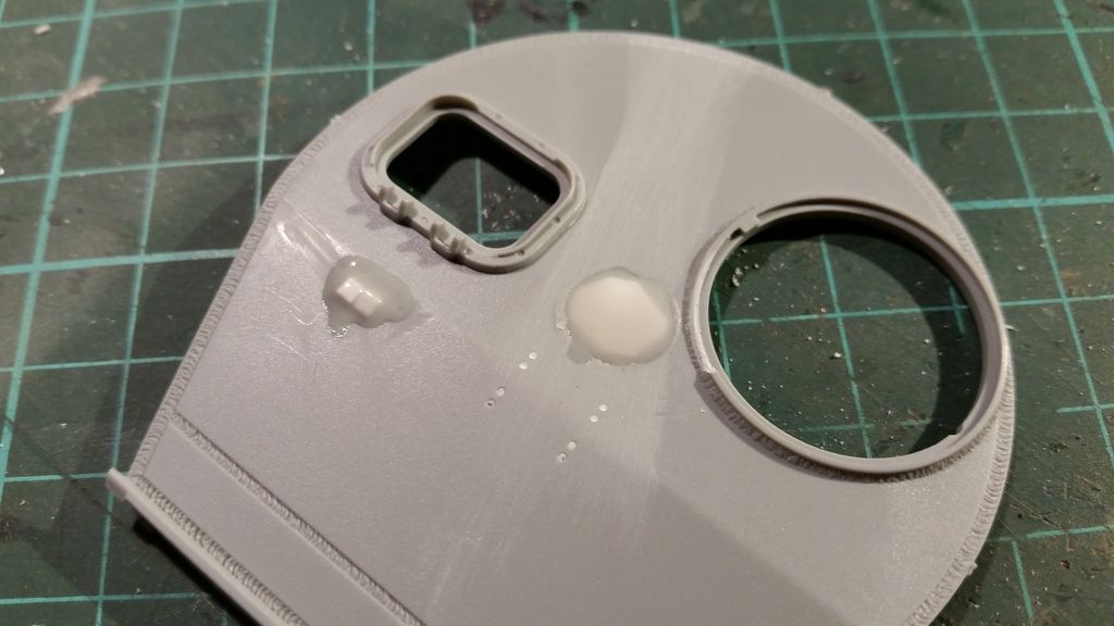

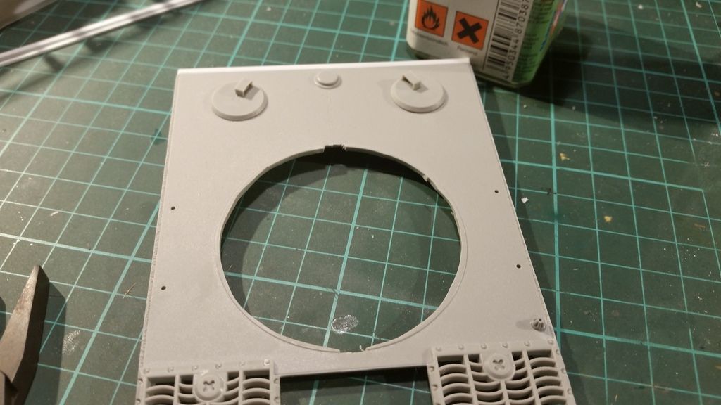

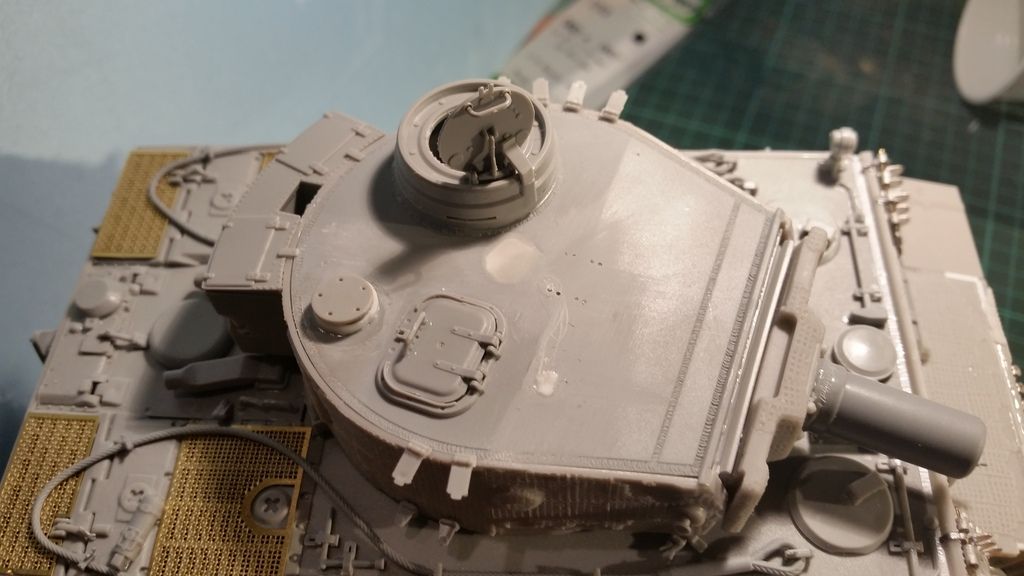

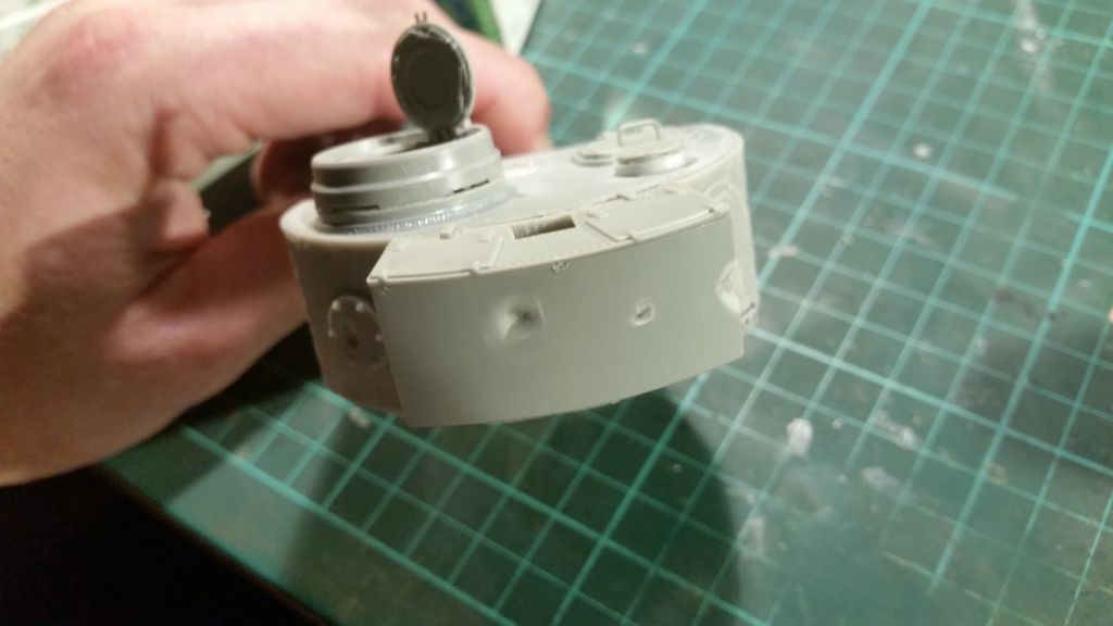

the turretroof needed some modifying too
these holes need to be filled
the holes where filled with some styrene scraps and then finished with a splash of molten sprue
i used it a few times now but i really like it and i think that if you have a old bottle of TET you should give it a try
just use a pencil sharpener to get small and thin scraps of sprue and toss them in
stir it and leave it for a while so the styrene can melt and then you have a cheap bottle of filler wich becomes just as strong as the kit part you use it on

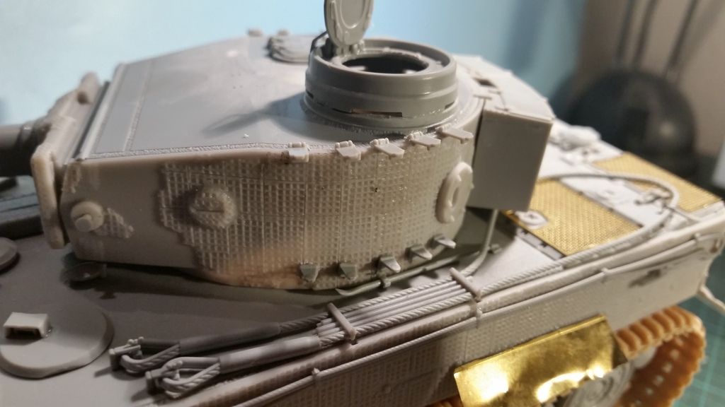

the mantlet needed a bit of filling as i damaged the rim of the gunsleeve or it was that way i don't know
it just had to be fixed
the turretbin was dented
for this i used a chisel from master tools (trumpeter) wich is a nice tool to have
i then thinned the walls on the inside and simply applied presure on the outside using the top of a pair of tweezers

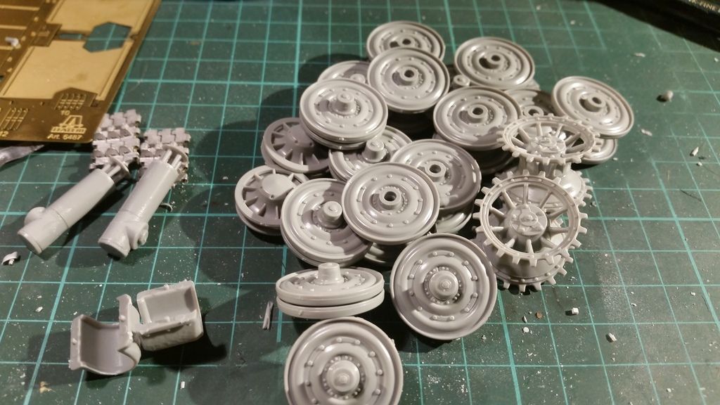

a nice pile of wheels that need sanding :banana: oooh no more like :wall:

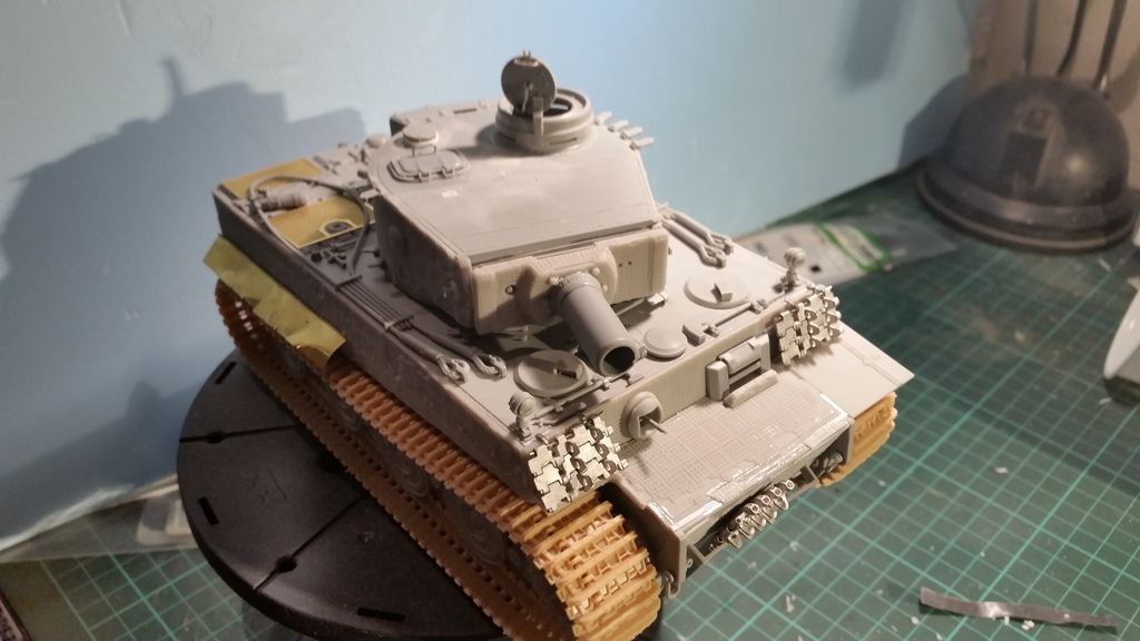

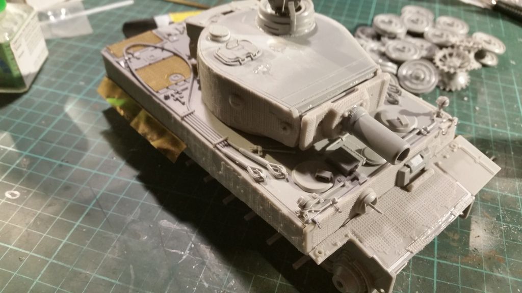

a inbetween test fit of the turret
all the parts that will be painted seperate from the hull to make it easier
here you can see a last minute change
i replaced the stock airintake with the one for the feifel filter wich is also included but not used
just for that field converted look
the friul tracks where not used but instead some ds tracks wich will work aswell
the friuls will be kept for a other build

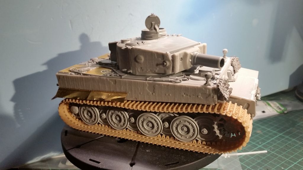

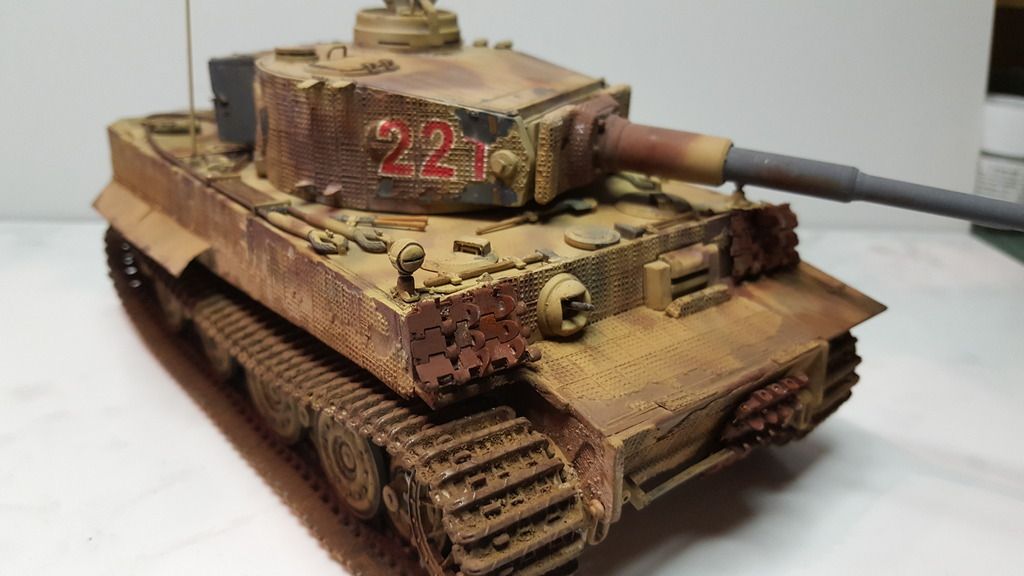

some pictures of the build up model
i think it is now ready for some paint but i don't know wich colors and wich scheme i want to use
so i will have to look for some inspiration but i do know it should be a colorfull one with a grey basecoated turret with zimmerit on top of that and a camoscheme and the same for the hull but then i will use primer red for the metal and then the camo on the zimmerit
well then that is all i have for now
i hope you like it so far happy modelling and untill next time
cheers Mark

It has a gun by now allthough i bought a gun for a Tamiya kit by accident
But it can be fitted if you drill out the interior of the fun sleeve

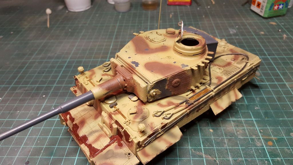

So this forgotten shelf queen has seen some action lately
i managed to paint it but i forgot to take photo's of the proces
i will gloss coat it tomorrow and maybe decal it later the same day
but i lost the decals so i will use some spares i have left
so it won't be a Fehrmann Tiger but one of the other Hybrids that where seen in the last days of the war
it will.need some heavy weathering to blend all of this together but i haven't done a heavy weathering job for a while so it could be fun to do that

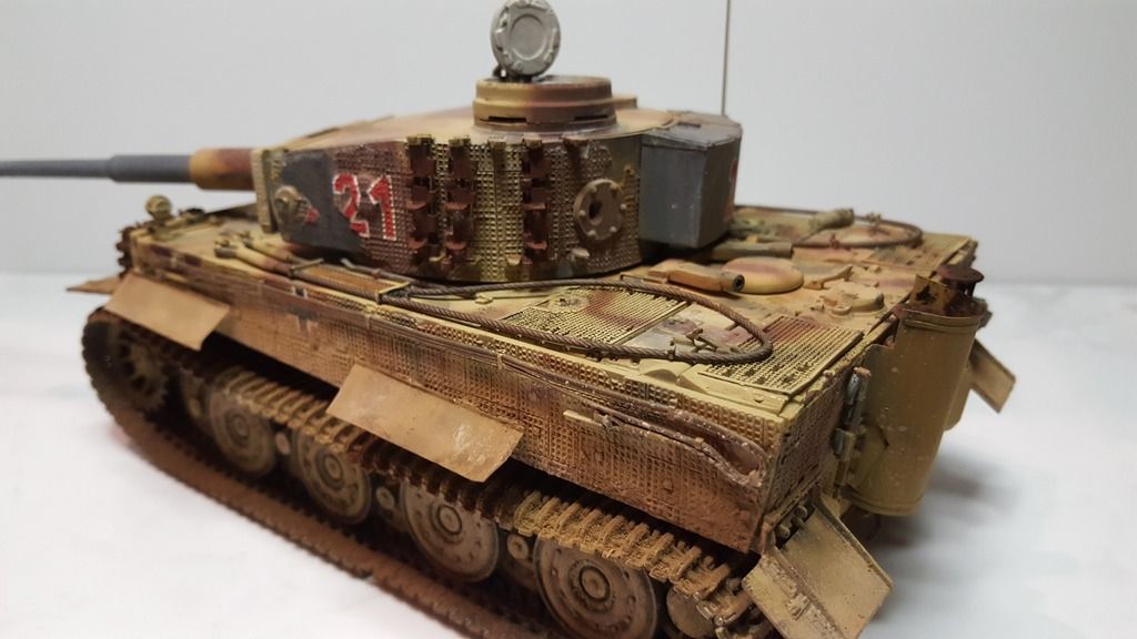

Hi guys
so here is the final reveal thingy for this build
i finished it today
but unfortunatly i don't have any progres pics for it
i had a virus on my phone and the photo's where on there
so the entire memory bank had to cleaned out and everything was erased
and i forgot to upload those photo's
but on the bright side i did upload the pics for my other builds so those are safe

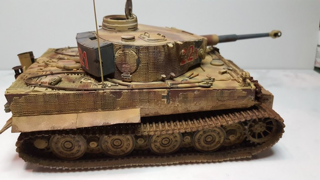

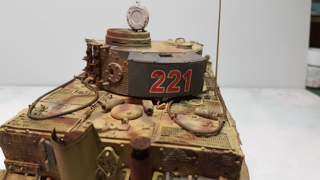

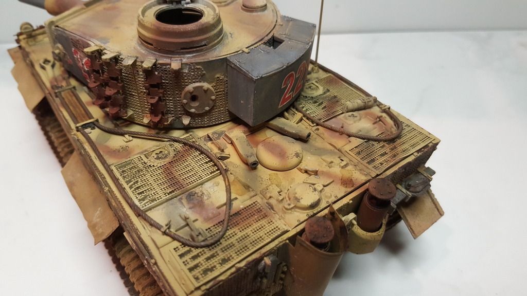

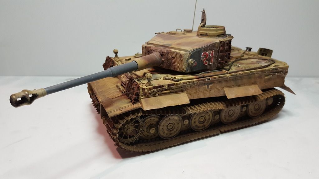

But before i really start rammbling about here is my Hybrid Tiger 1
aka FrankenTiger (by me)
So that is all for this build
i hope you like it
thanks for stopping by and having a look
cheers, Mark

Did you use cheese cloth for the texturing on it? That's what it looks like to me. Wonderful job!
Damon "Mad Hat Modeler"
B-25 Mitchell
Re: All Heil Frankenste......Tiger ?

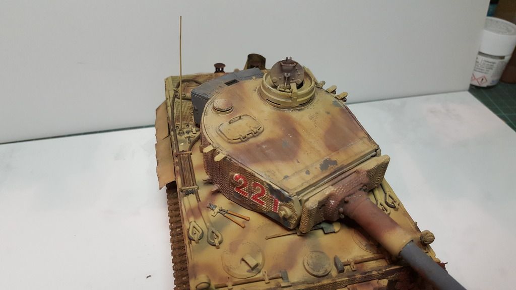

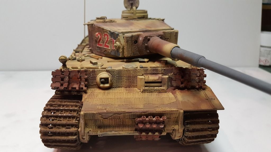

Damonkh wrote:Did you use cheese cloth for the texturing on it? That's what it looks like to me. Wonderful job!
Thank you
if you mean the zimmerit ,then no
it is a set from Atak wich is a resin set with a turret and thin sheets of resin
but this set had the waffle zimmerit wich was a lesser known and used version
you can find it on StuG III's and the StuH III but for tanks it was pretty rare
unlike the common striped zimmerit you see on many german tanks
if i had to make it myself i would have needed a stamp with the right shape and i don't know if there is such a thing

Looks great, love the concept of a hybrid tiger and also that waffle zimmerit brings the tiger a really new look. If only it happend in real life.
On the Bench....
Italeri: Focke Wulf TA-152 H-1 1/48
Tamiya: King Tiger 1/35
Dragon: Defense of the Reich 1/35
Tamiya: Sherman tank 1/35
Thanks
The Hybrid Tigers did excist
There is not a whole known about the few that excisted though
The best known are the Tigers fron Kampsgruppe Fehrmann and even things like the turret numbers aren't clear
But what is know is that there was a F01 and F05
From photo's that are made fron these tanks you can see that they have parts from earlier production runs and later
The F05 had a mid or late hull combined with late steel wheels and tracks but it had a early turret judging by the cupola and turret bin
They basicly where a last ditch effort from the maintenence crews to get some Tigers back in the field
The zimmerit is a set from Atak and to be honest i don't know if there ever was a Tiger that had the waffle pattern but i thought that would look nice so that is why it has this pattern instead of the regular horizontal or vertical ridges
