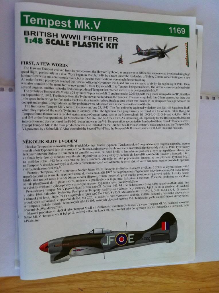

The box art is amazing.

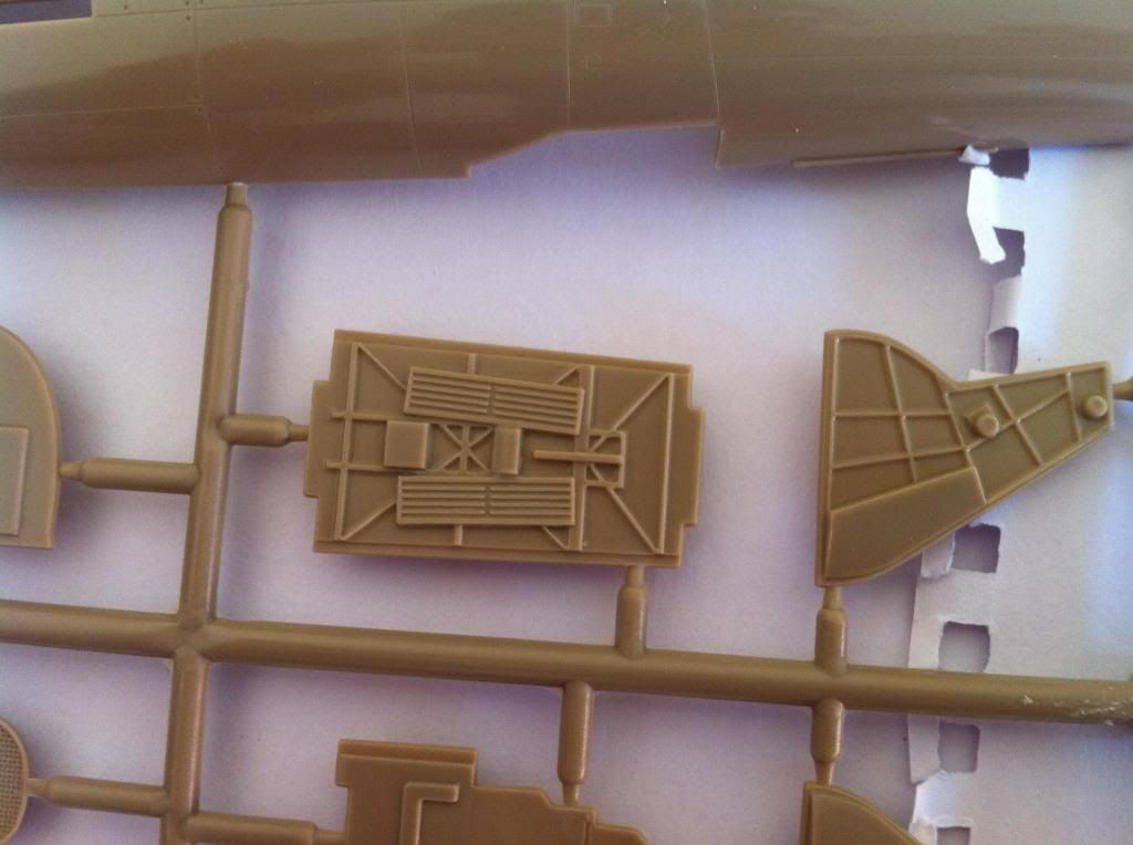

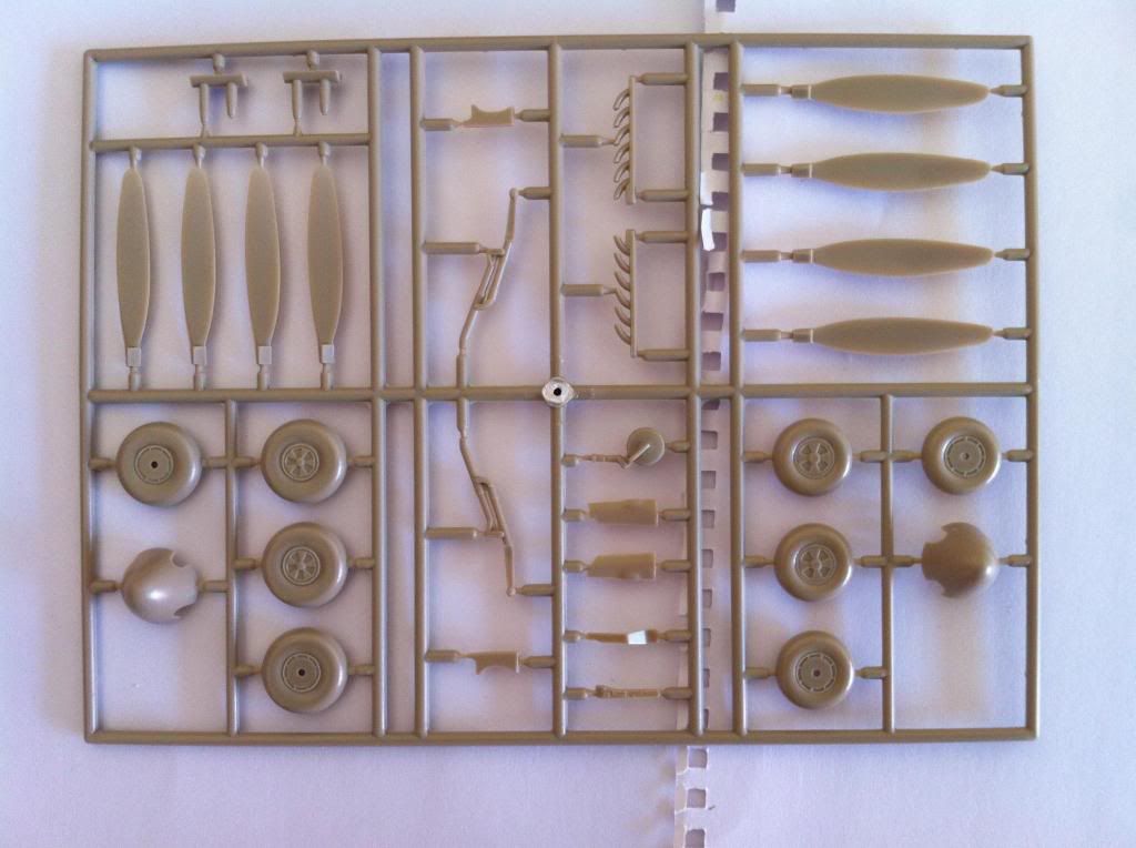

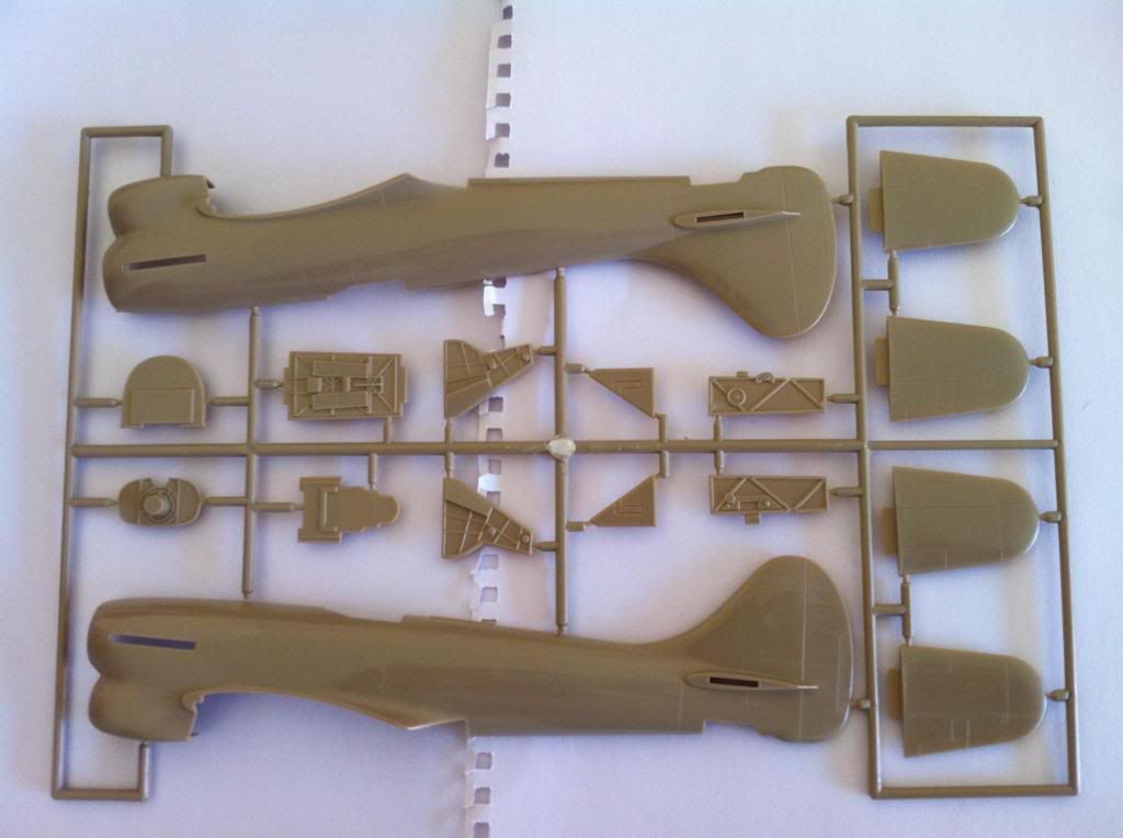

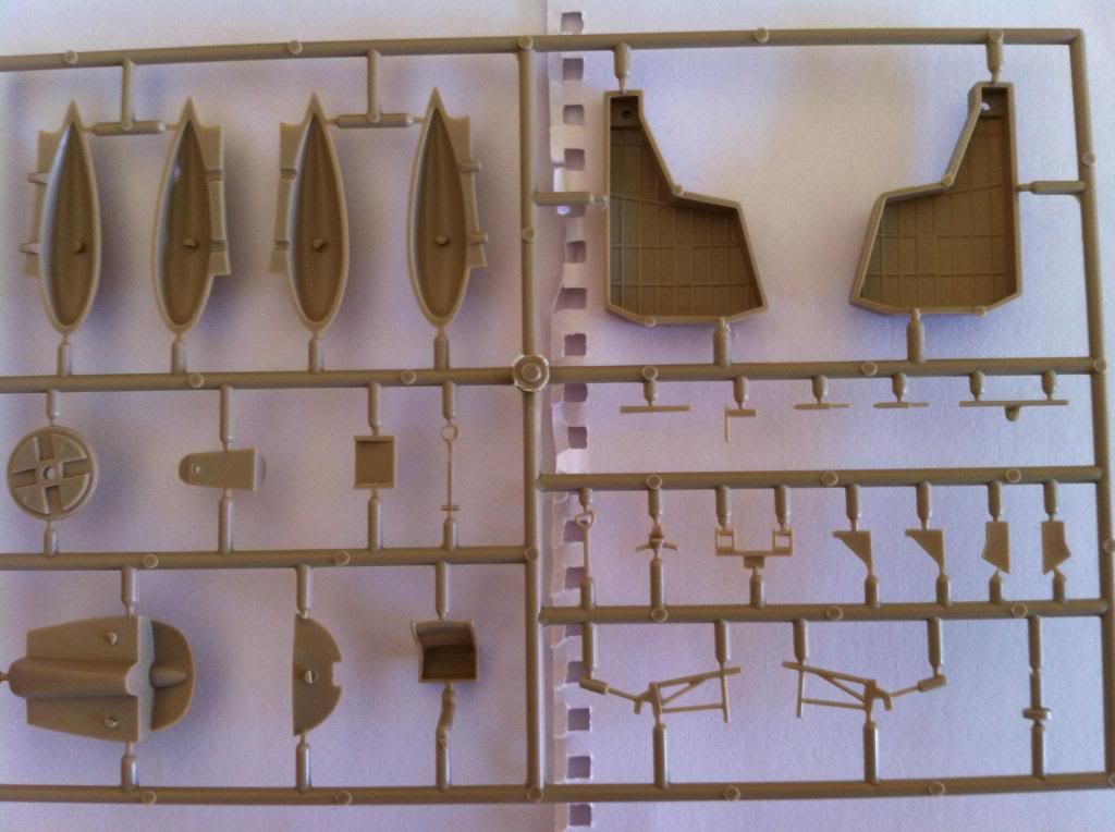

right on with the kit shots the detail is really clear and crisp the plastic has a shiny coat it so will have to prime me thinks the panel lines are really delicate so will have to be care full when sanding.

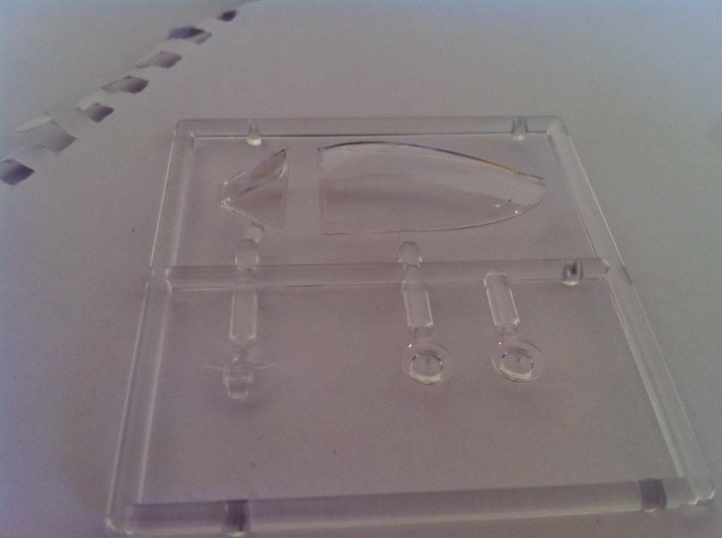

not the best shot of the clear parts but they are great really clear LOL

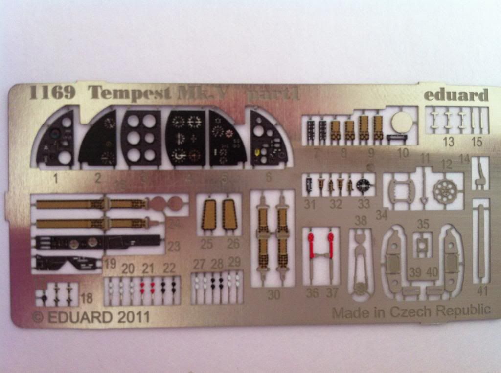

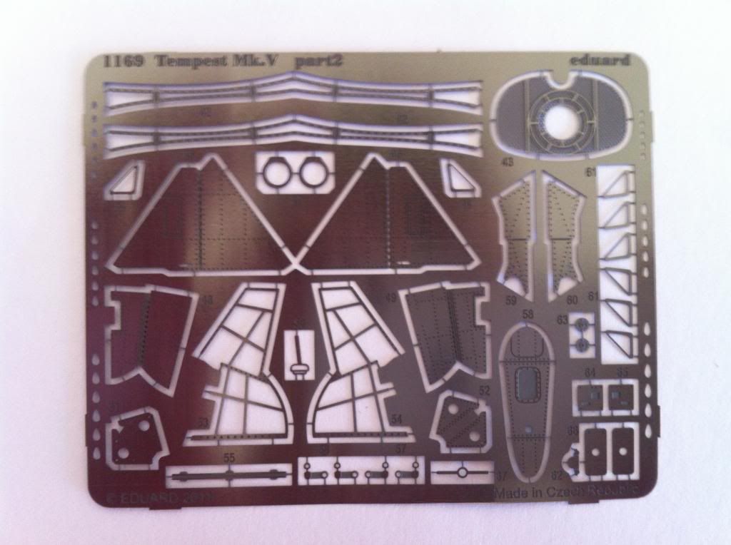

two bits of Photo etched one for the cockpit and one for the rest

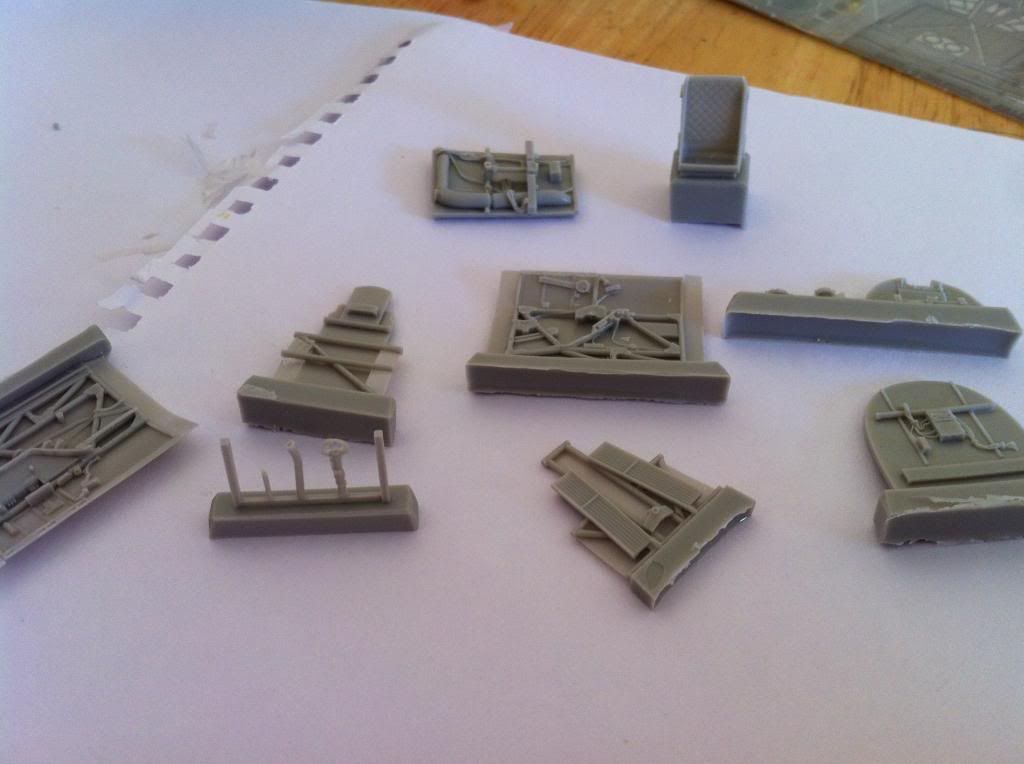

the resin parts of the cockpit

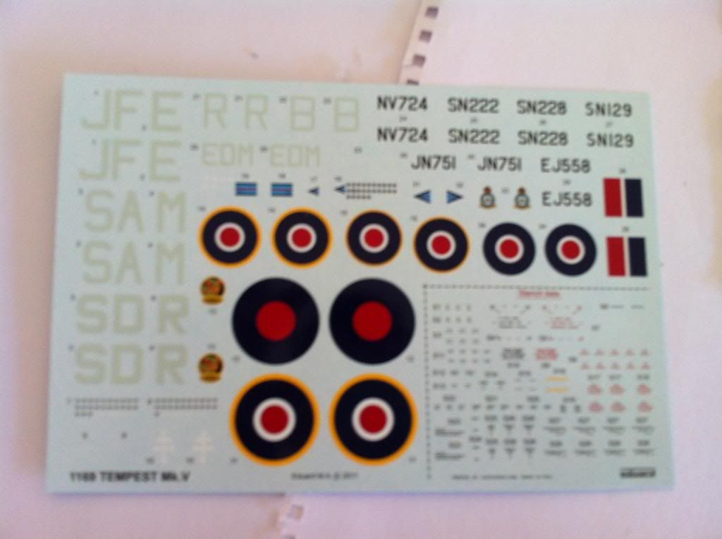

the decals very good and thin but glossy

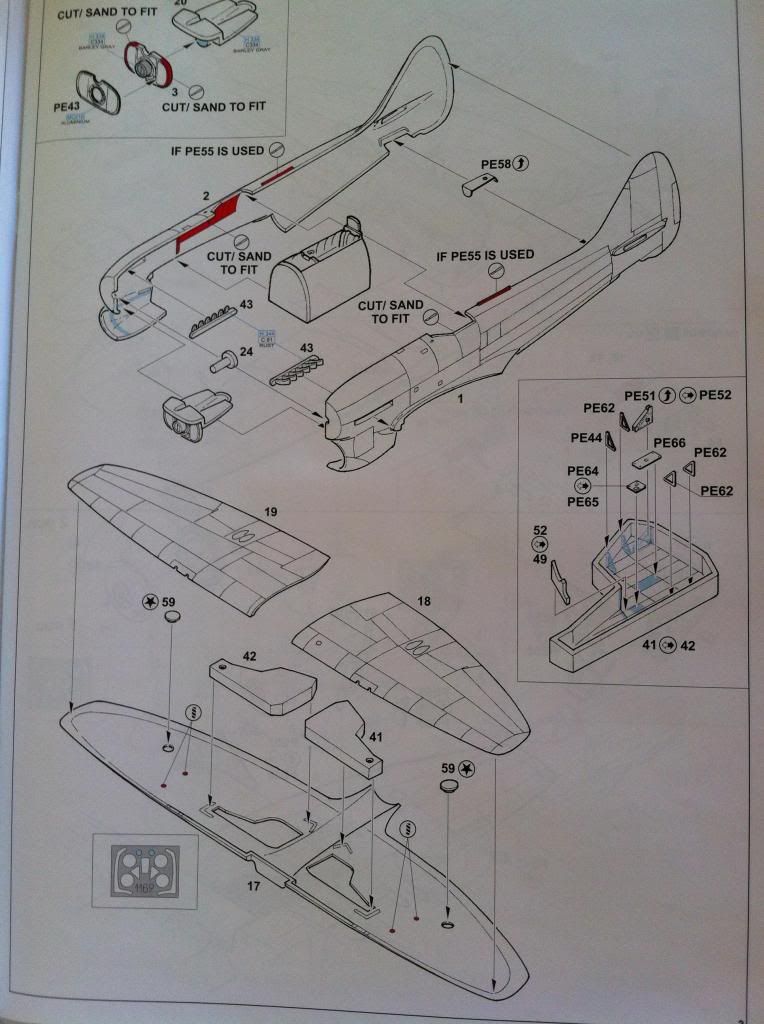

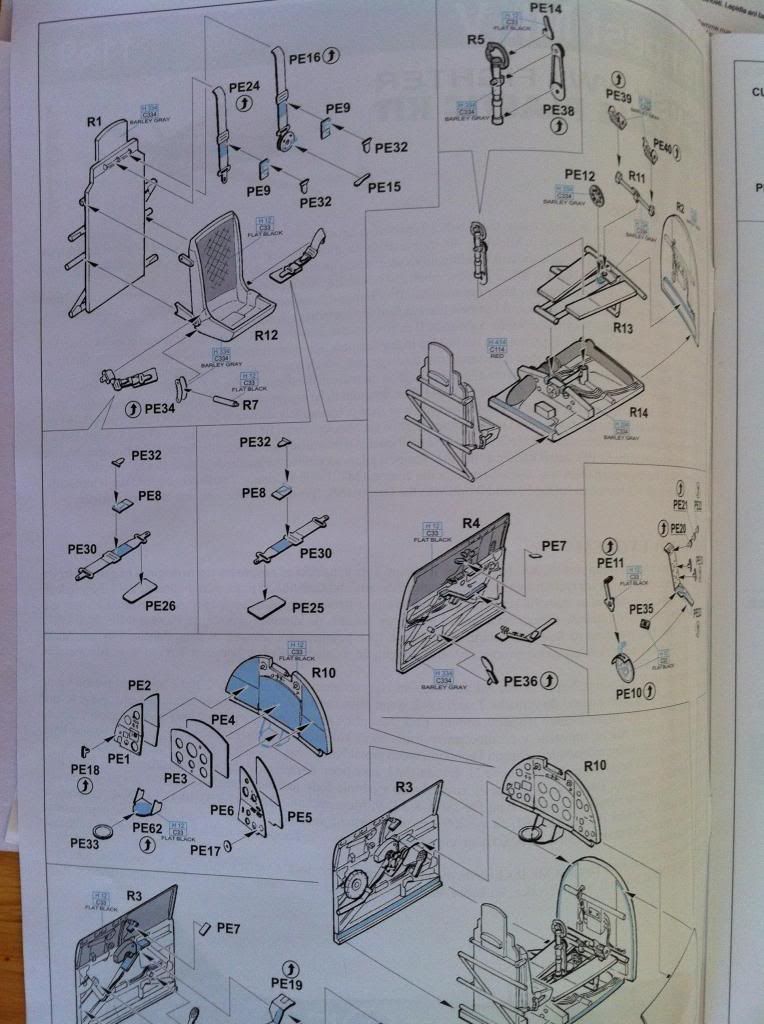

the instructions really easy to follow and in colour

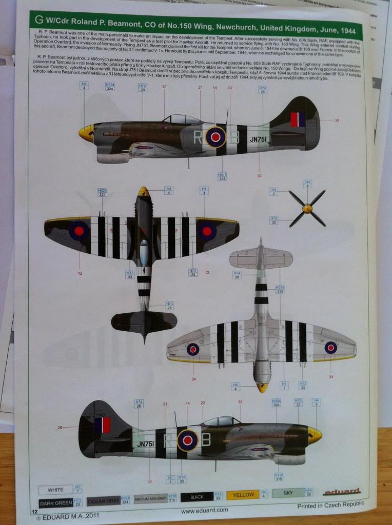

and the version (1 of 6) i will be doing

Wow shiny plastic! I would recommend giving the entire thing a sand over before you paint that. And definitely use a primer before painting.

Cheers Gav didn't think of sanding it but will be priming it.

After doing some research on the kit there are a few problems. One being that with the resin floor of the cockpit will need to be left of so it will fit because of the undercarriage bays but will cover this in more detail during the build.

Nice looking PE that's for sure. Good luck with the build. Looking forward to this one :-)

Talking if PE is superglue ok to use in it aswell as resin
Re: Eduard Mk. V Tempest
Yeah use superglue for the resin and PE parts.
Cheers Gav thought so just wanted to make sure
Nige201980 wrote:Cheers Gav thought so just wanted to make sure
Or you can use pva for the PE which gives you a lot more time to place parts, as superglue there is no going back once it's applied.

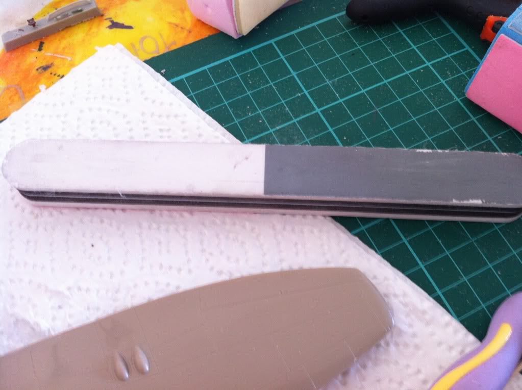

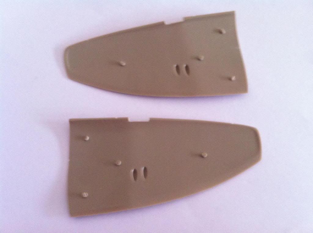

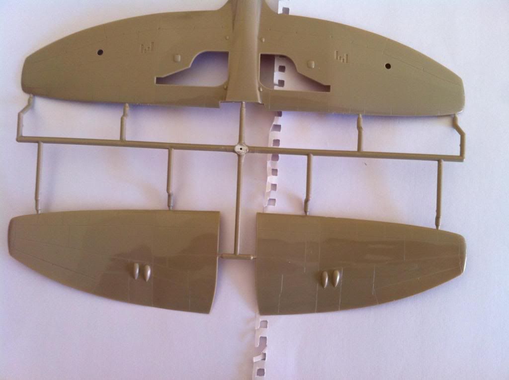

So with today being so warm :banana: not much got done mainly just getting things ready for paint.

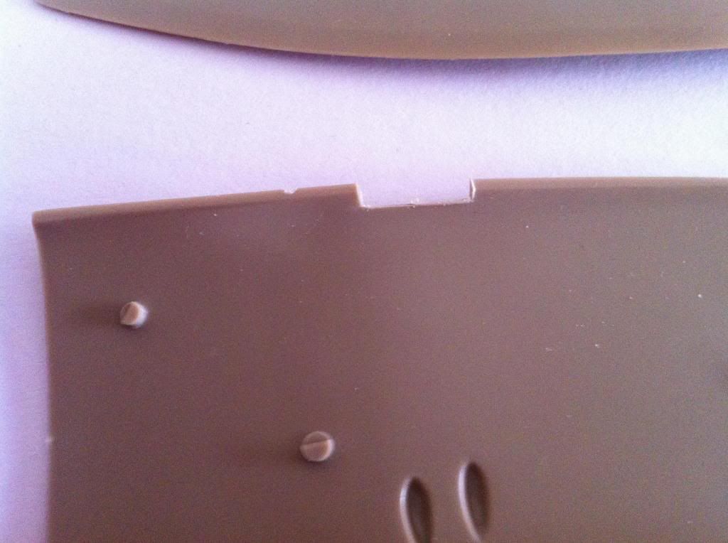

Has I was doing an early version I needed to cut bits out for the cannon inserts.

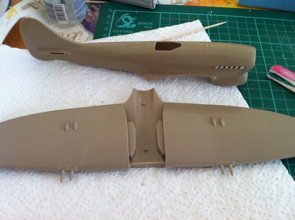

The upper wing parts

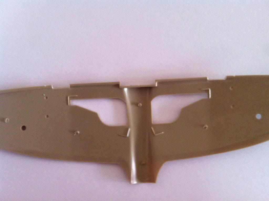

The lower wing parts
And a close up. There is a guide on the inside of the wings so getting the right placement was easy. I just used a scalpel under its own weight.

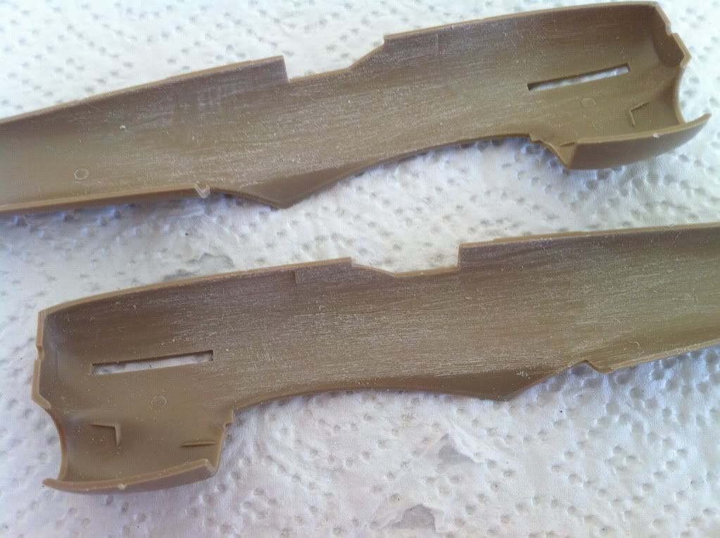

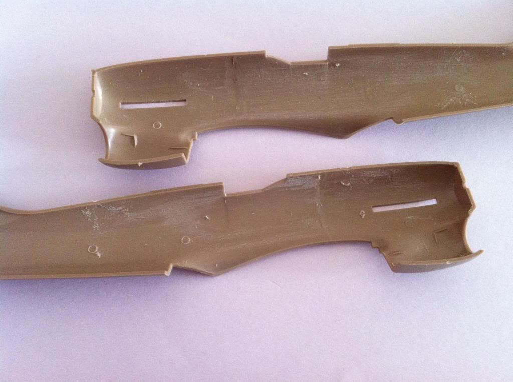

The fuselage half's I scraped of the detail ready for the resin cockpit

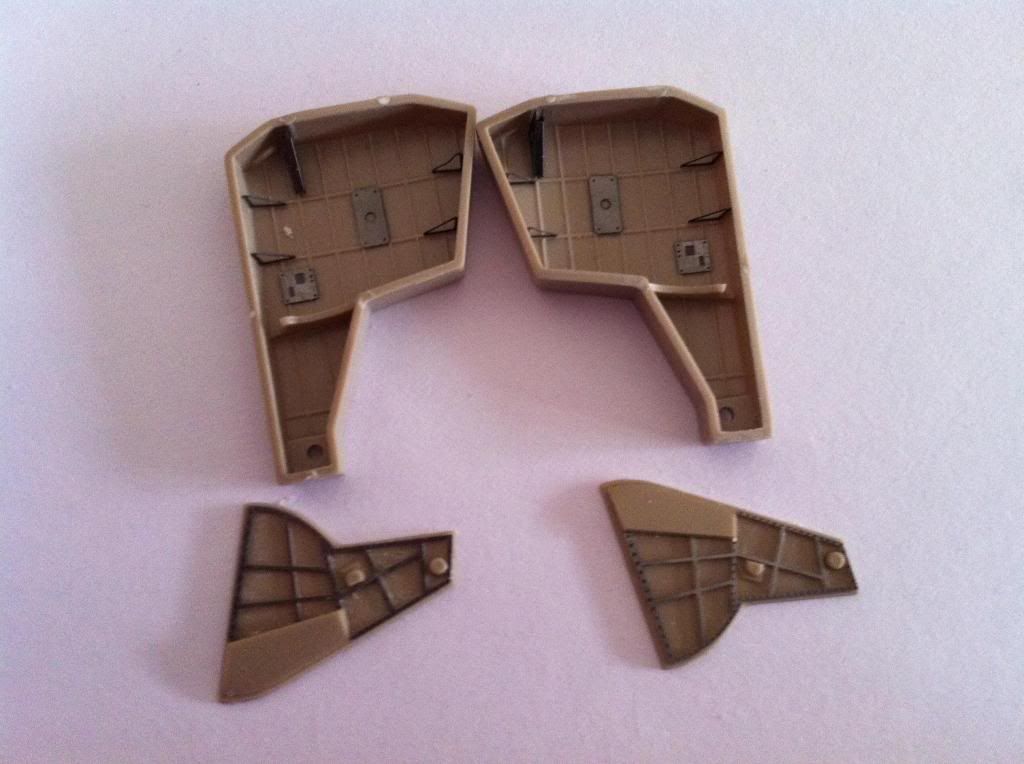

The undercarriage bays with the PE fitted

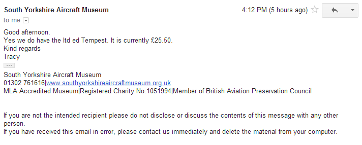

I email museum store, you very lucky. It cost now £25.50 again boohoo

Nige201980 wrote:Your joking only got it two days ago and it was the last one aswell when I went because I could believe my luck.
Funny, I have copy of email ?

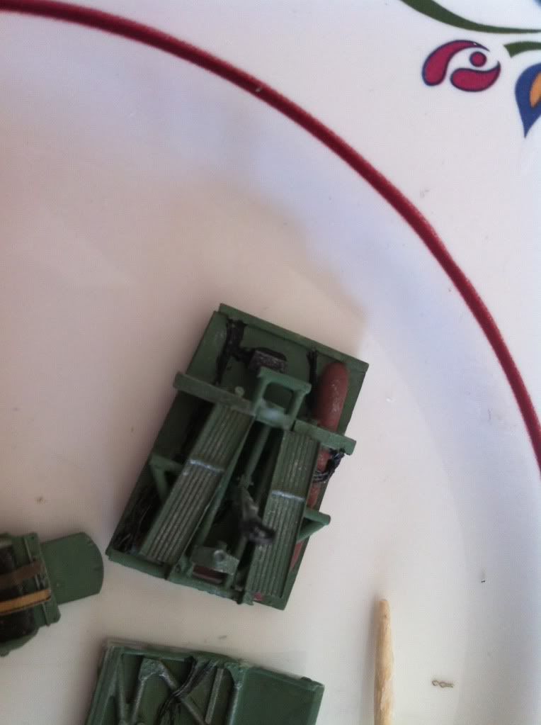

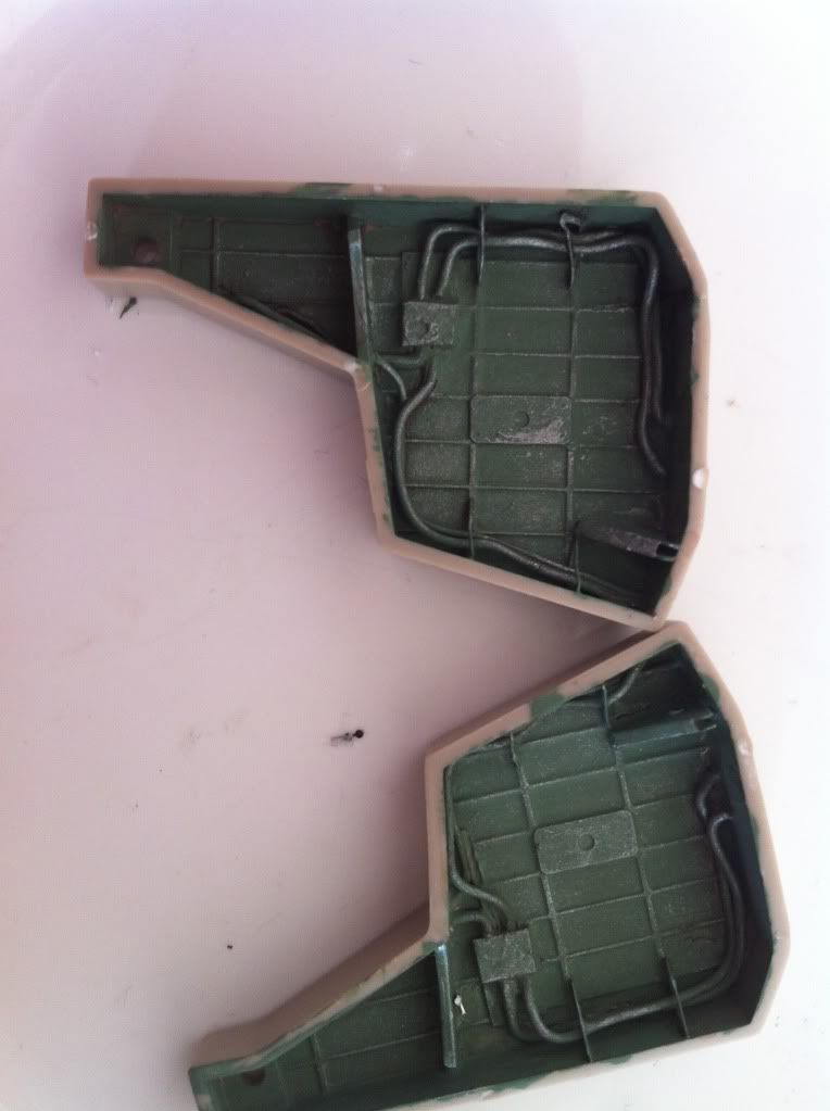

Quick update

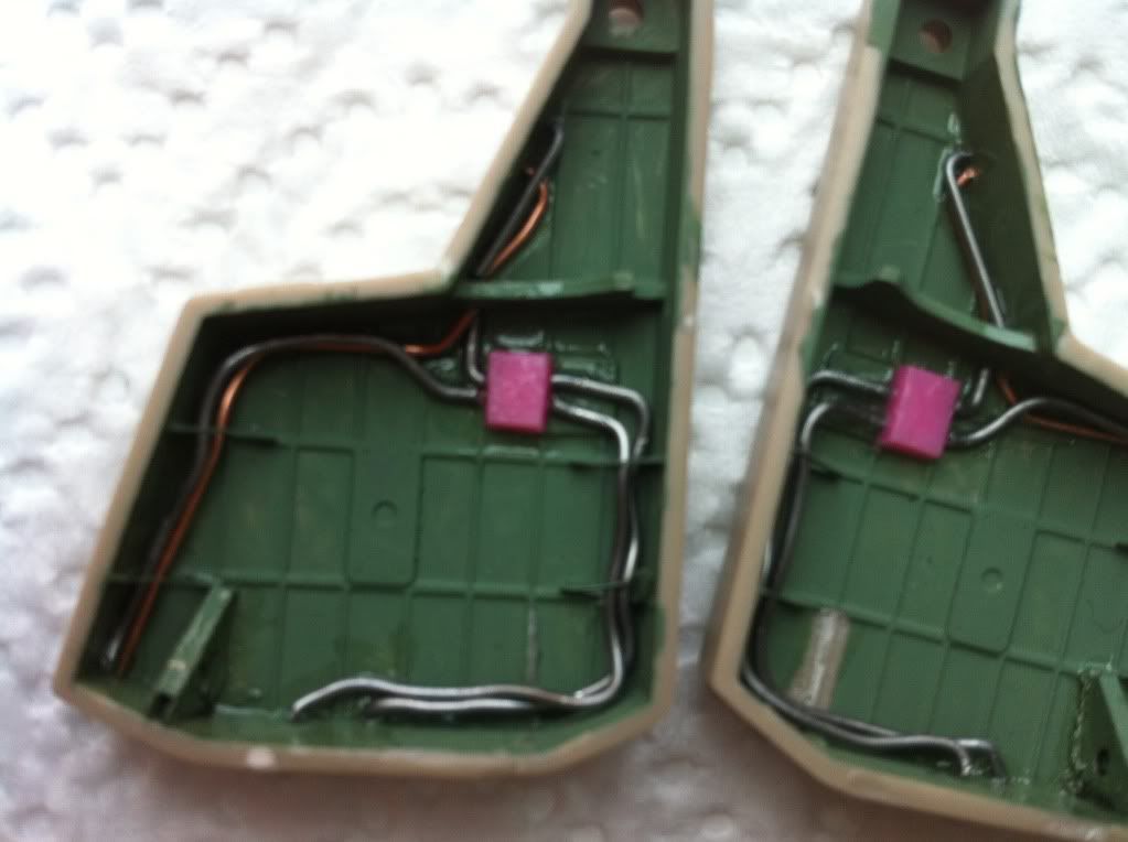

I painted the cockpit and undercarriage bays in a coat of humbrol 78 cockpit green but I found the undercarriage bays still a bit bare.

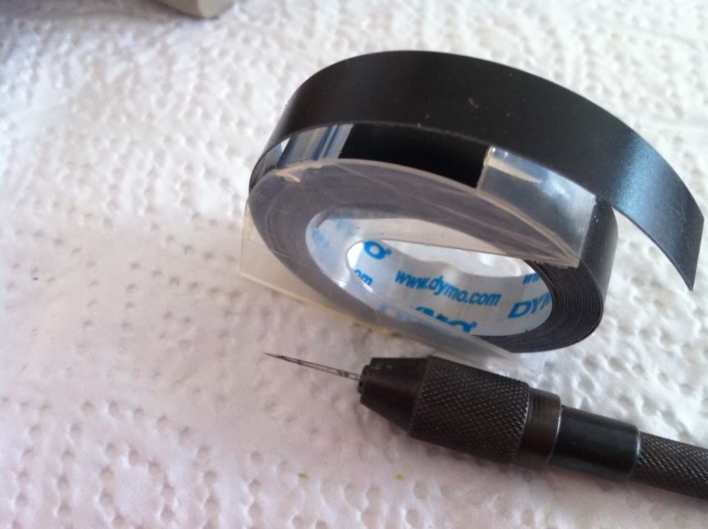

So I thought I add some wiring just to add some more detail. I used soldier and some of the centre of a tv cable.
And with some paint on.
I think they have turned quite well seeing as this is the 1st time I have ever tried this.
Next it's on to painting the detail for the cockpit.
Great job on the scratch building Nige, looks great.
Good work so far Nige :th:

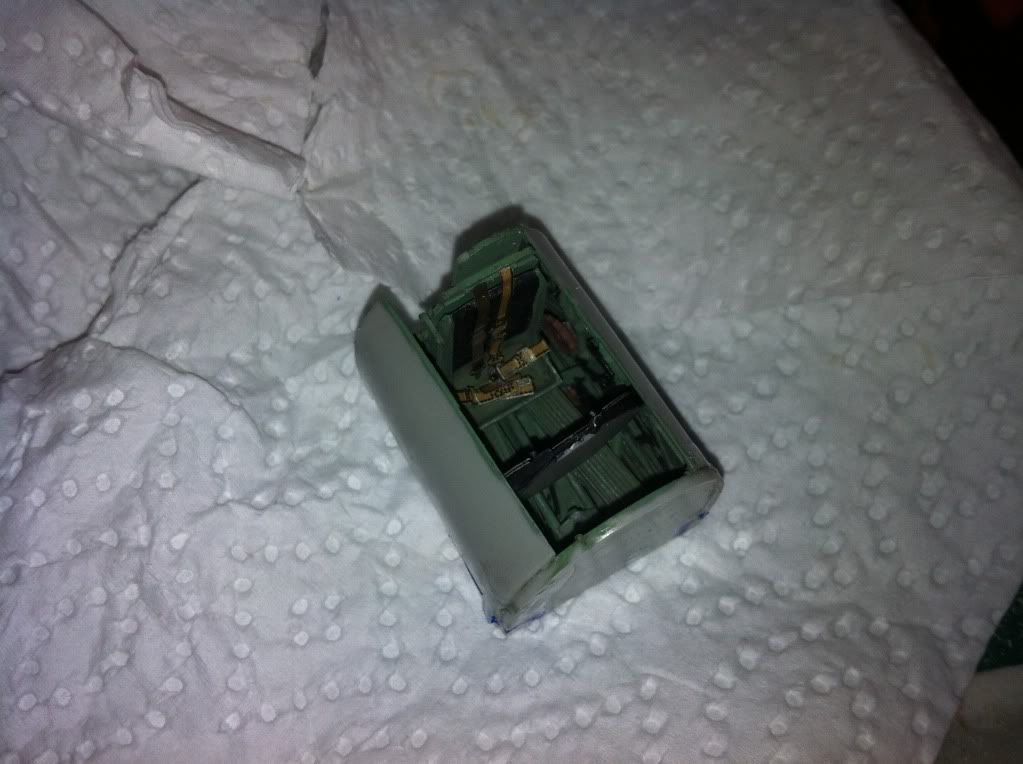

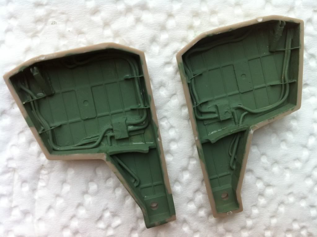

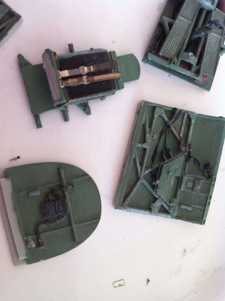

Cockpit all painted with humbrol 78 and cables done in black gave it a dark brown wash and dry brushed with humbrol 56 I think.
Also painted and weathered the undercarriage bays.
Not all the PE has been used because of the small bit pinging of when I tried to use them.
But I think it looks ok for the 1st time I used it.

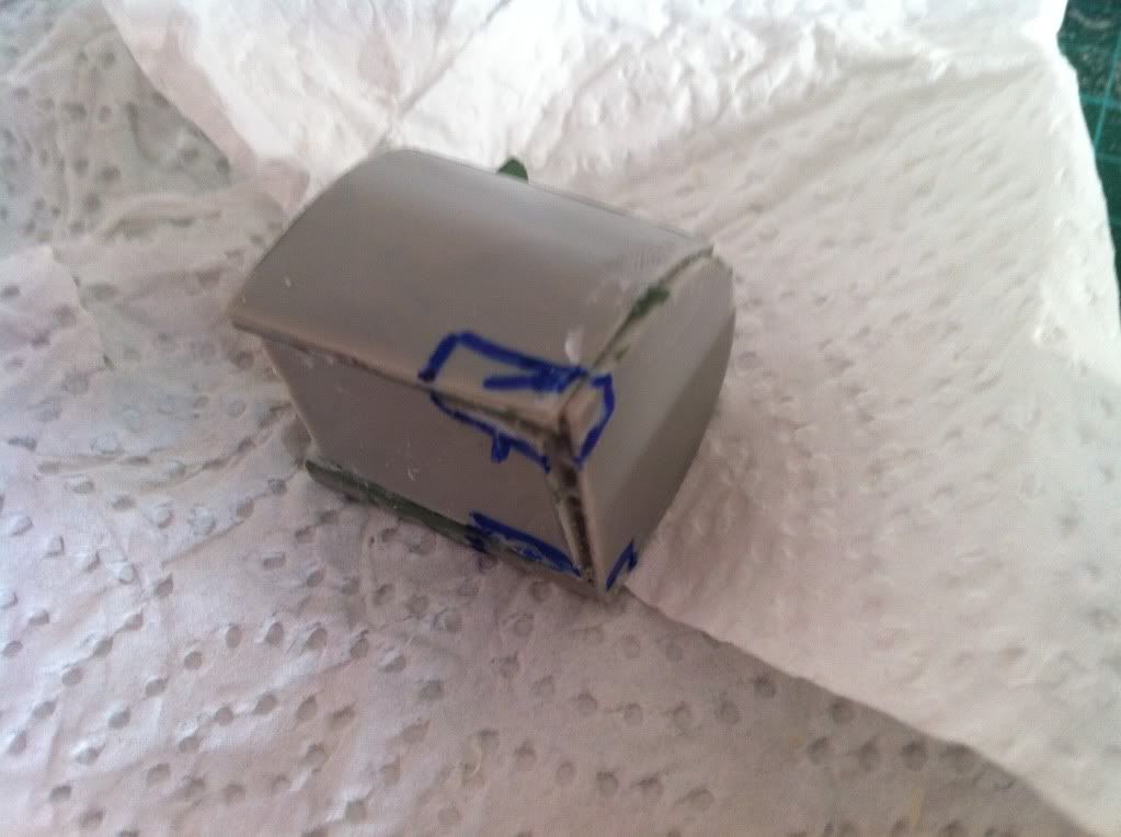

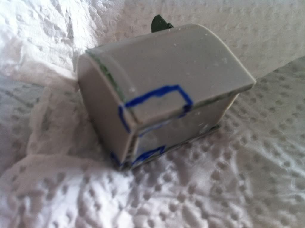

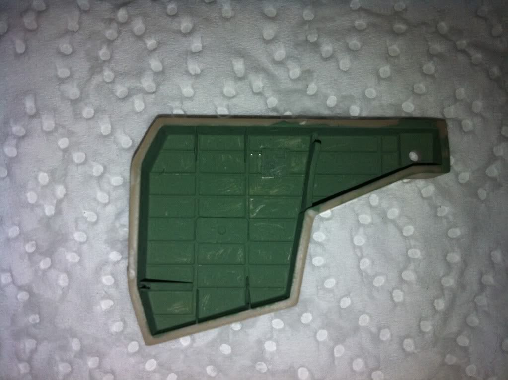

Well the cockpit is now together and looks good but trouble is on the horizon but 1st the the cockpit
As stated before the cockpit fouls on the undercarriage bays so surgery is need the bit that need cutting out the bottom may need sanding but ill look at that later when I'm ready to button it all up.
And the finished result
That's a better fit.
Now on to sanding the fuselage half's and the cockpit sides to get it to fit there.
That's it for now.

Nice surgery to get everything together! Looking very good so far. Can I recommend the PE cutting tool myself and Lee have which stops the stuff becoming food for the carpet monster. I found it at Sprue Mart here http://www.spruemart.co.uk/index.php?pa ... t&Itemid=1 but I am sure there are other suppliers as well.

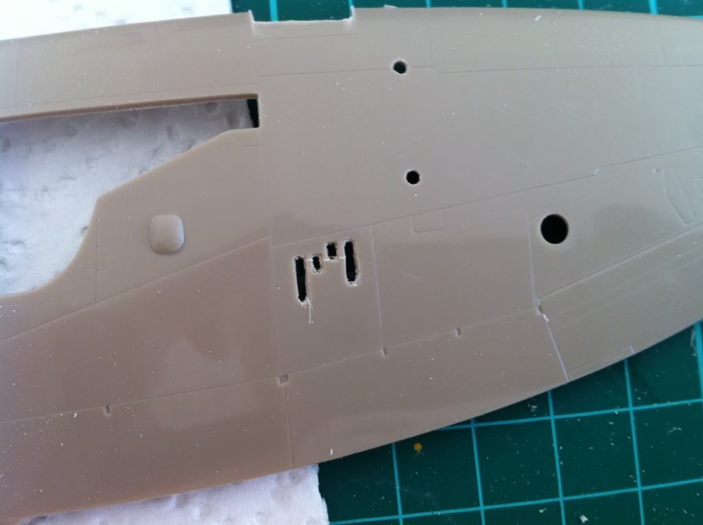

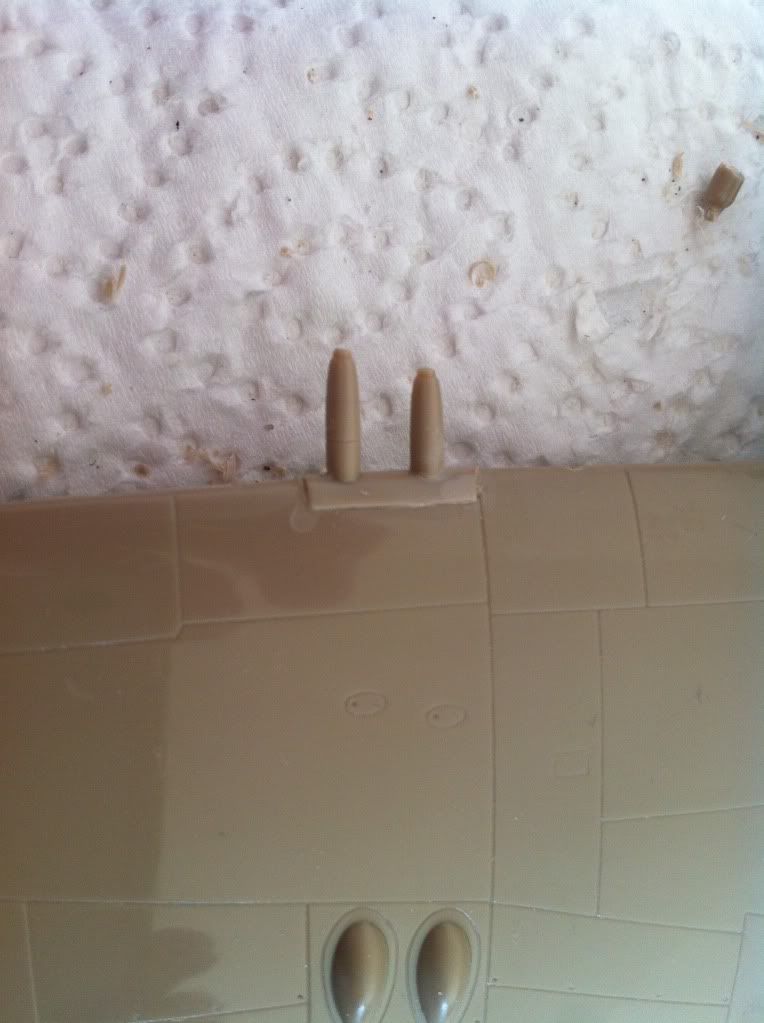

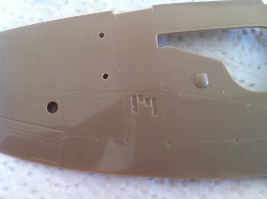

Right update time had to sand quite a lot of the fuselage and the cockpit to get it to fit
I drilled out the locating points for the drop tanks and I noticed that the casing enjection holds were fill in
So I cut them out too
That better will tidy them up when a sand the airframe down.

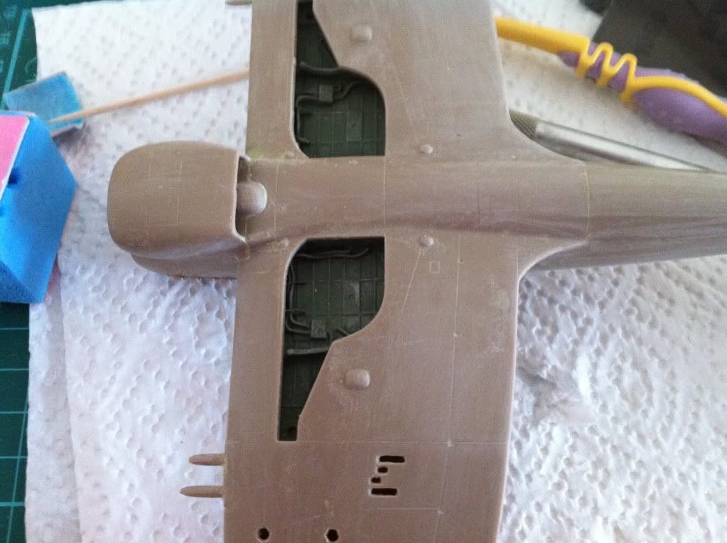

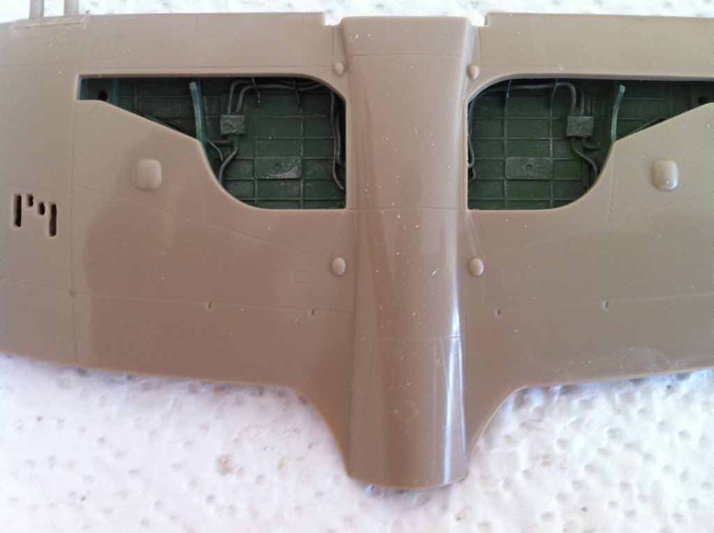

The wings and fuselage glued together I will leave it over night then put the cockpit in and join the two together

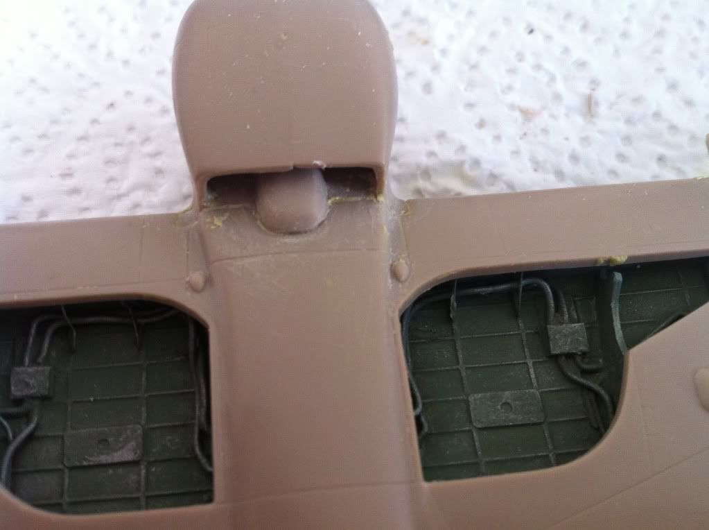

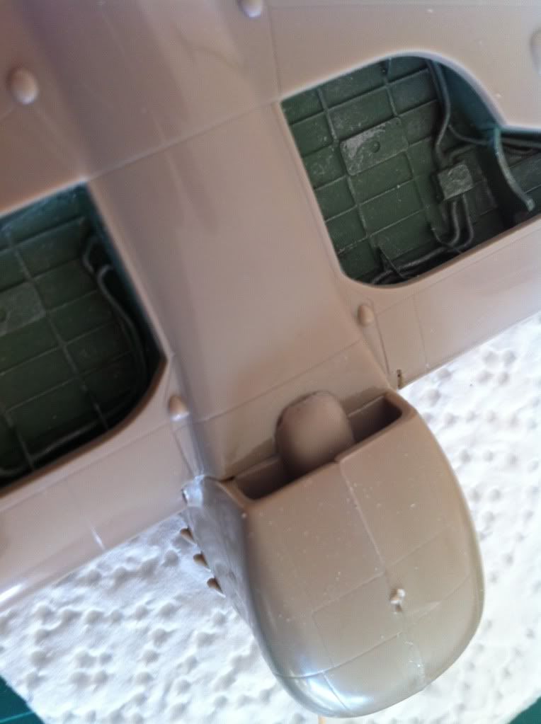

And the wheel bays in they look really good (well I think they do lol)

Nige201980 wrote:And the wheel bays in they look really good (well I think they do lol)
I also think they look very very good, I assume the wheels will be down?
Yeah they will down thanks guys.

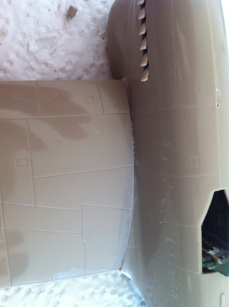

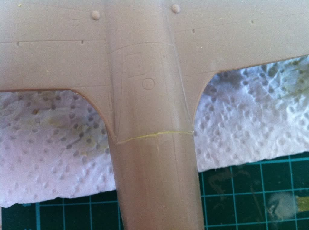

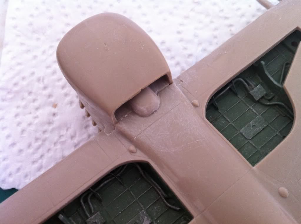

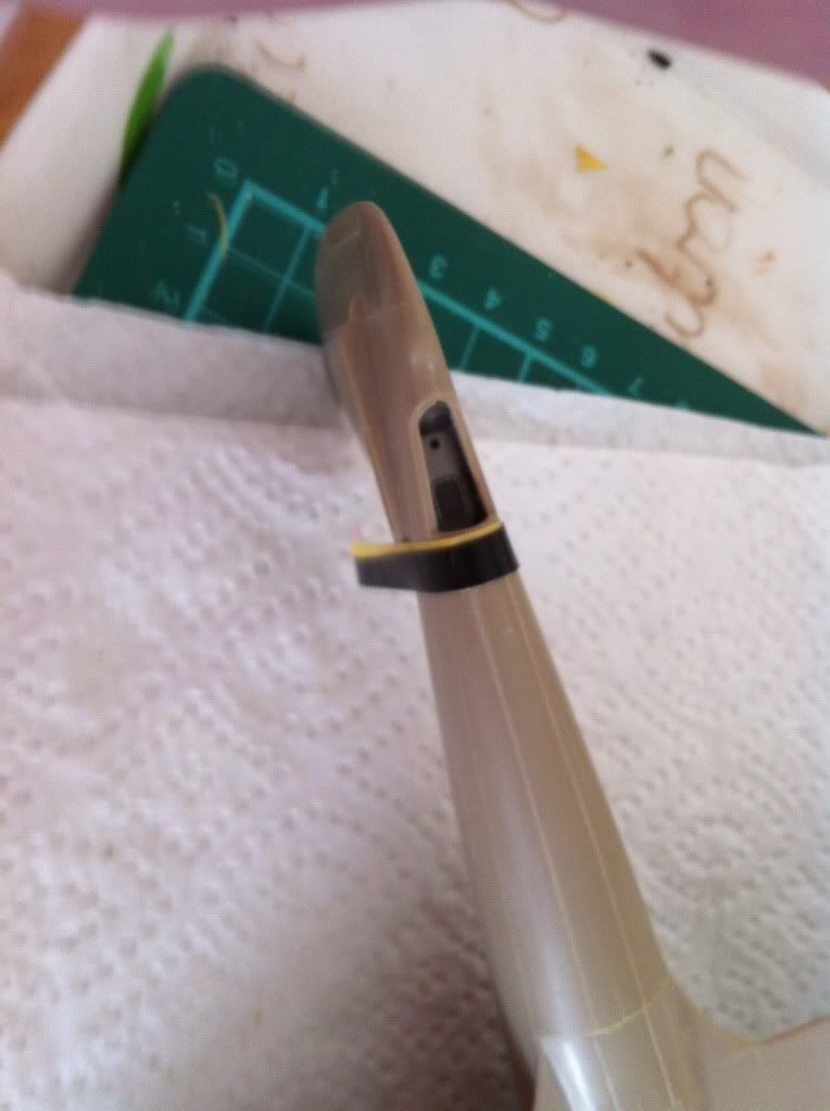

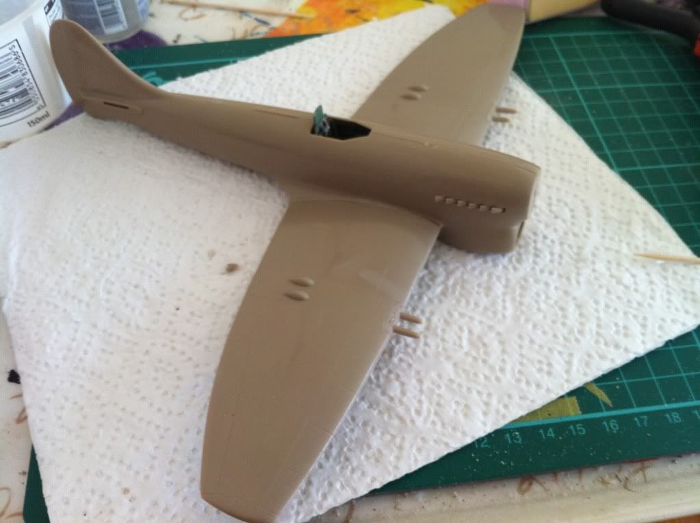

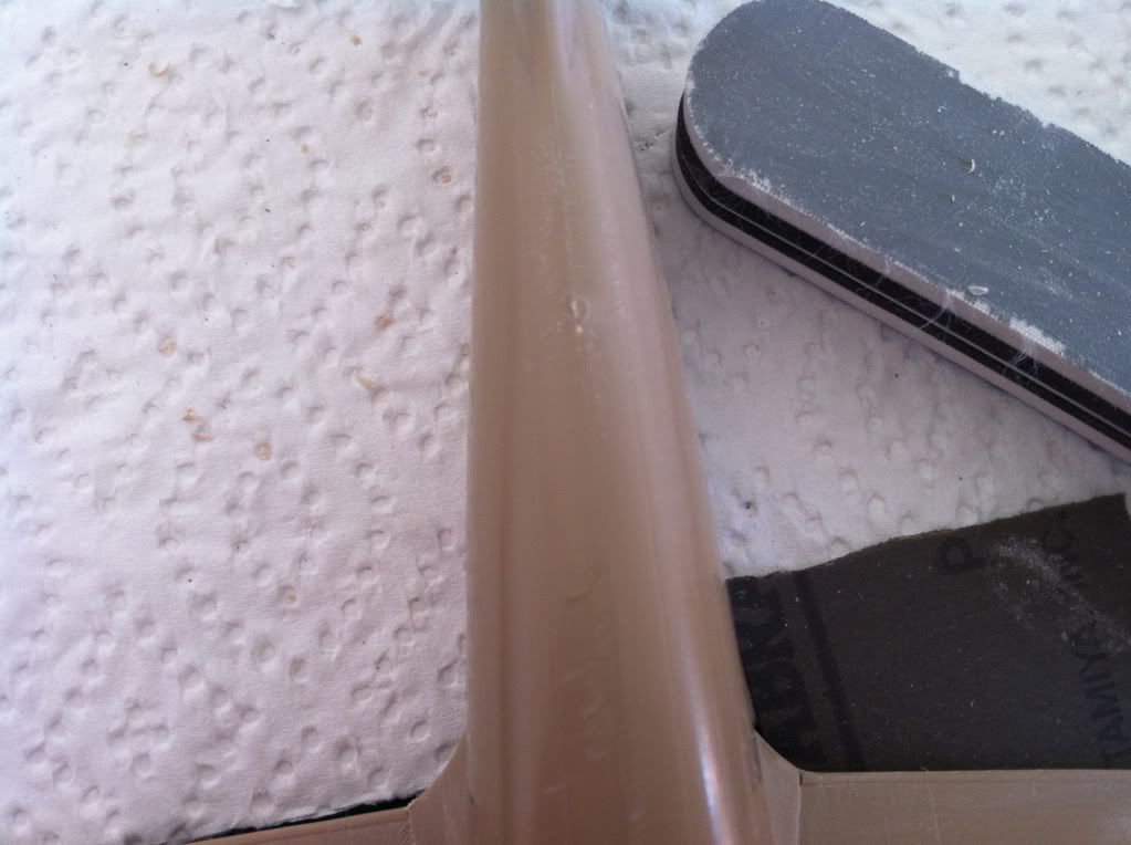

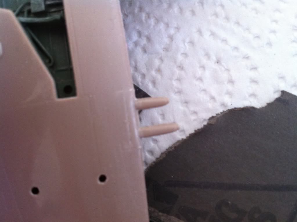

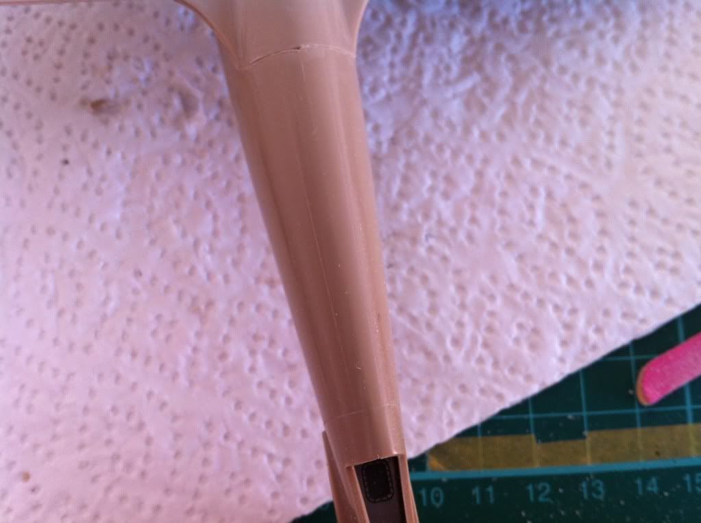

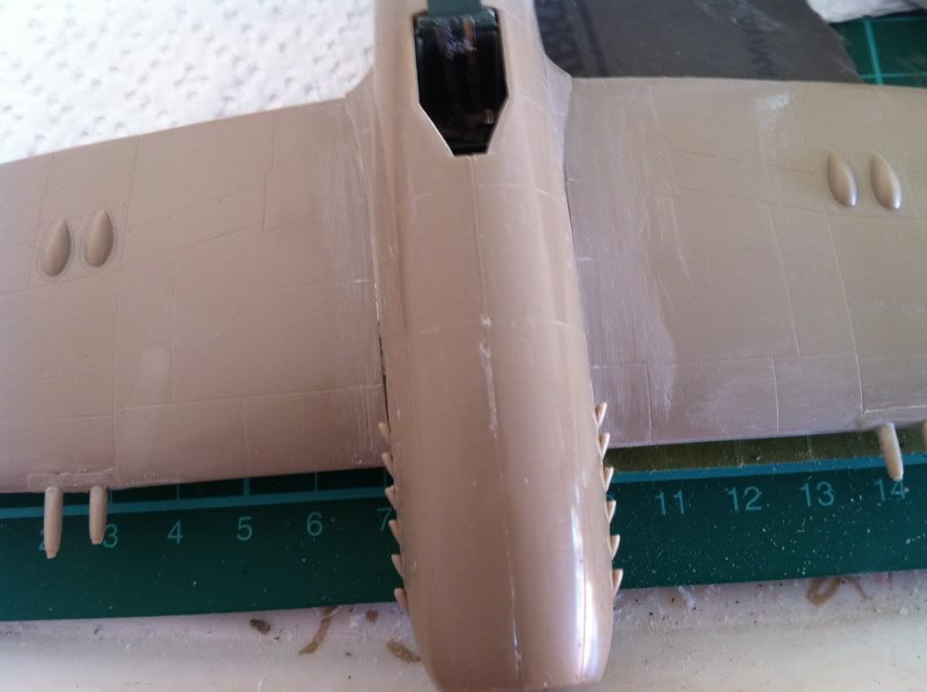

Update time guys.

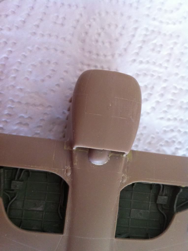

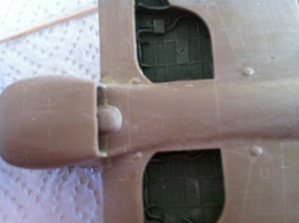

Cockpit in and wings joined the fuselage

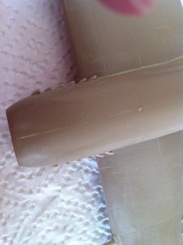

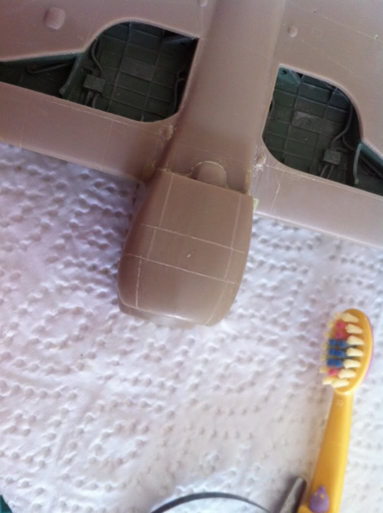

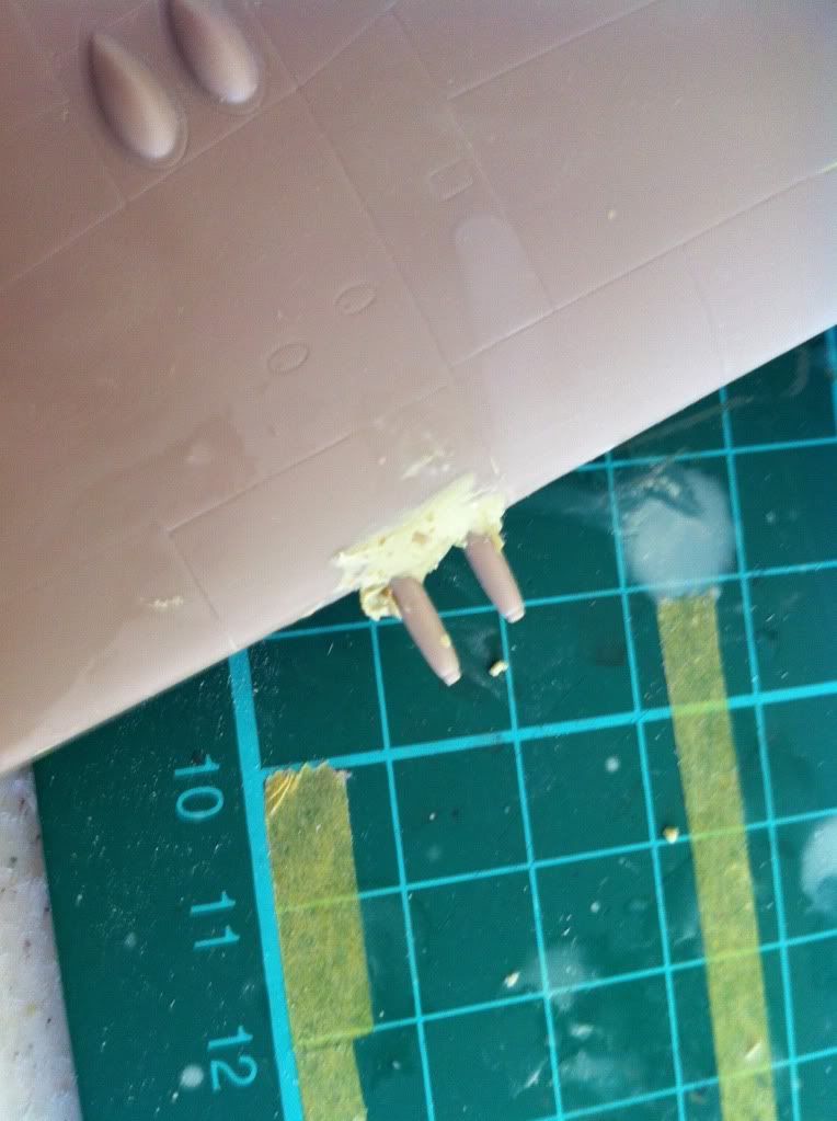

But there are quite a few gaps and steps some in harder to reach places like under the chin

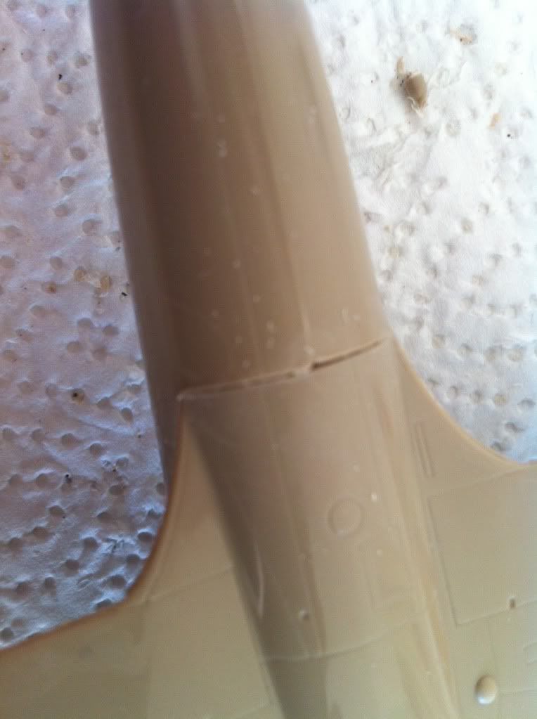

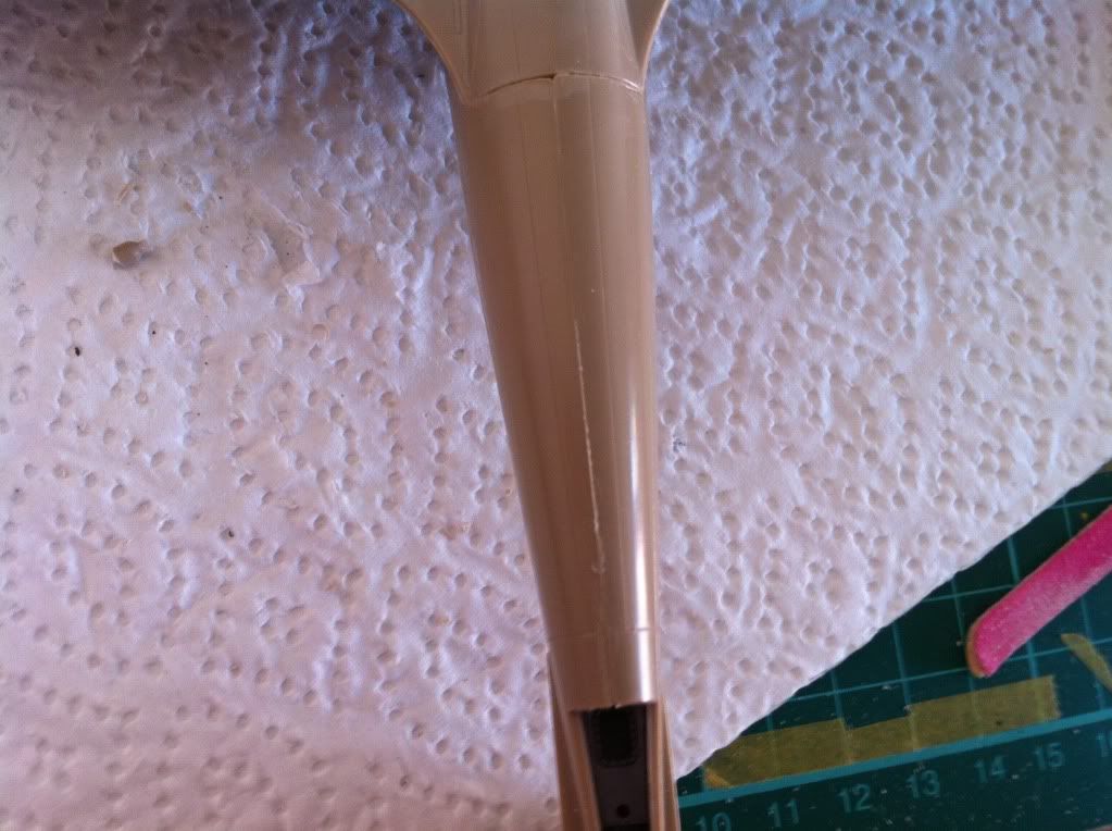

And the normal place at the back of the wings

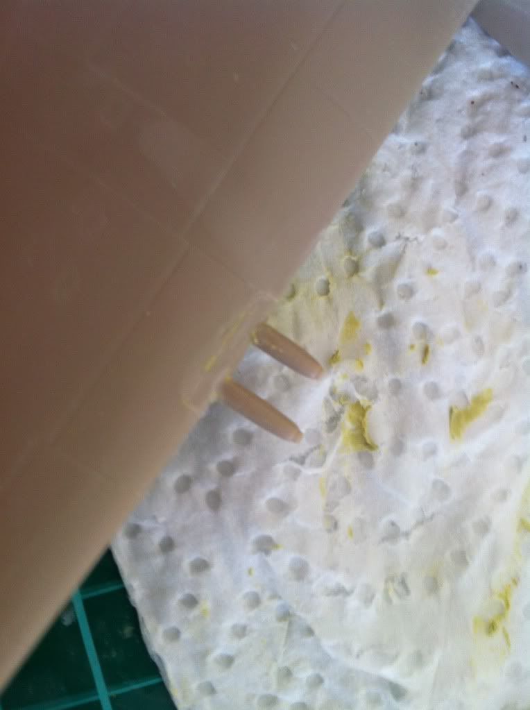

The cannons

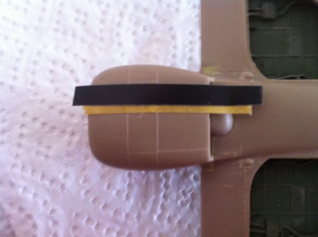

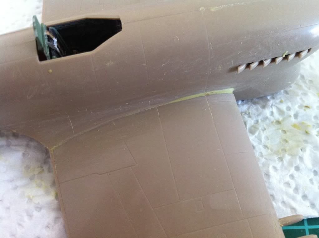

And of course the wing joins

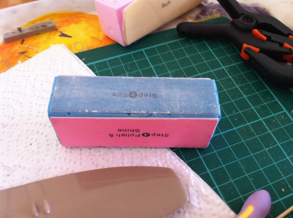

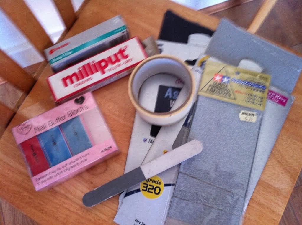

So plan of action sand the seam lines and what have you fill where needed then sand again.
I'm interested in seeing how you fix these Nige, I have a BF 109 that I want to start in the near future and I haven't build an aircraft since I was a wee lad.
Watching you knock this together could be helpful buddy.
Lots of pics if it isn't too much trouble?
Post by UKscalemodeller »
The wheel bays don't look.good, they look great.
hansolo
Posts: 1524
Location: Amsterdam
Post by hansolo »
Yip, those details are awesome!

Sorry but this will be a photo heavy update for Coen and trying to deal with gaps, steps and seam lines.
These are just some of the tools and bits and bobs Ill be using
These next two are pound land buys
Comes in a pack of 4
Before I've started
And after using each of the 4 sides of the block then the white of the nail file/sanding stick then the grey to buff up to a shine so I can see if there any more to do
The same was done on all the seam lines/joins
This one may need a bit of filler
This will need filler to fill the gap
And so will this I used a cocktail stick/tooth pick (covering both bases ;)) with some sand paper rapped round it.
This what ill be using for the gaps well the 1st stage along with the mark 1 finger.
With it applied
And then wiped the excess of with water and my finger.
I will let it dry over night and will apply some more tomorrow because it will properly shrink then will be sanding again so until tomorrow.

Right it did need more filling so that's done and all sanded back and the whole airframe sanded down.
These seam lines should be invisible when primed (hopefully)
Some detail needs putting back so out with the dynamo tape and a pin vice fitted with one of the wife's old needles I bent the end of the needle slightly make the angle to hold the vice a easier
If you use it with tiamya tape you can use it more times I find
