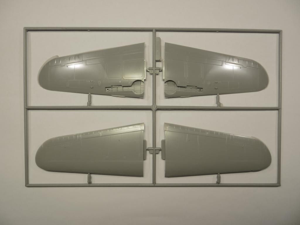

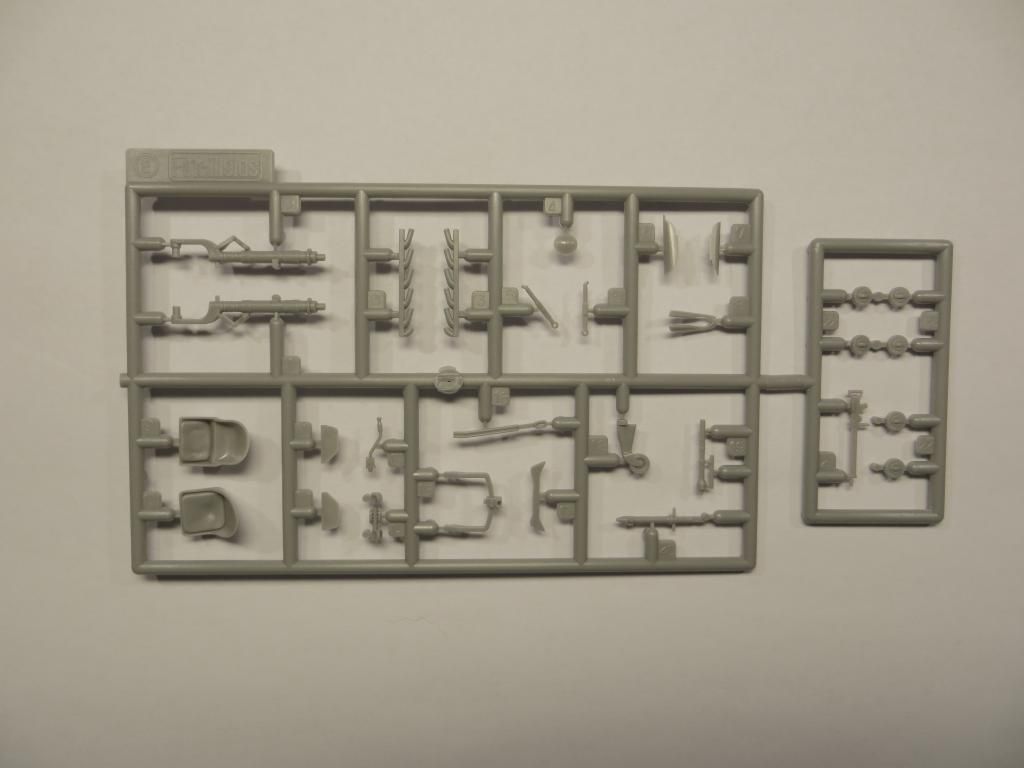

The Kit:

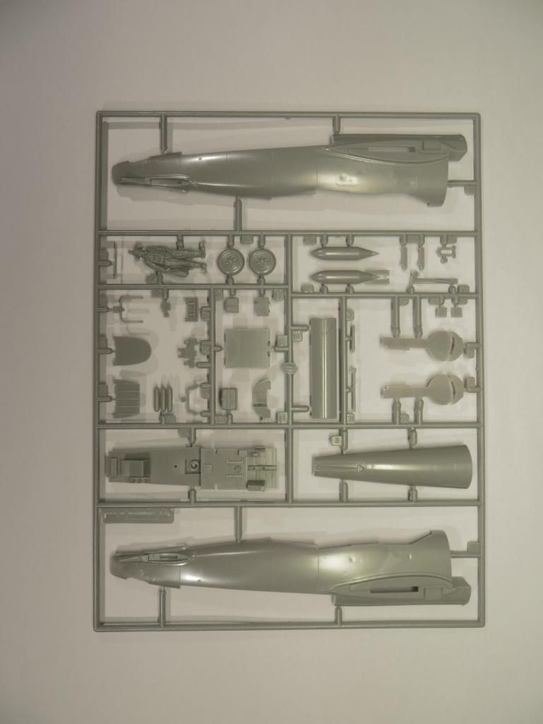

Here is a quick review of the kit:
To be continued...

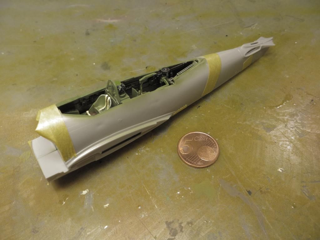

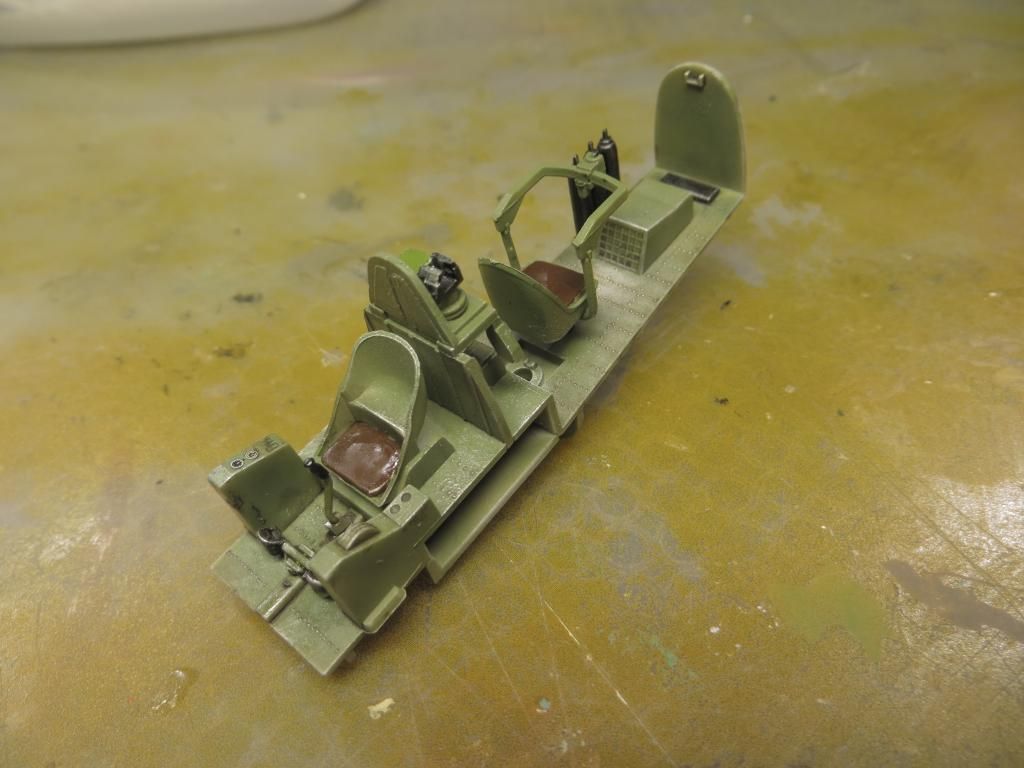

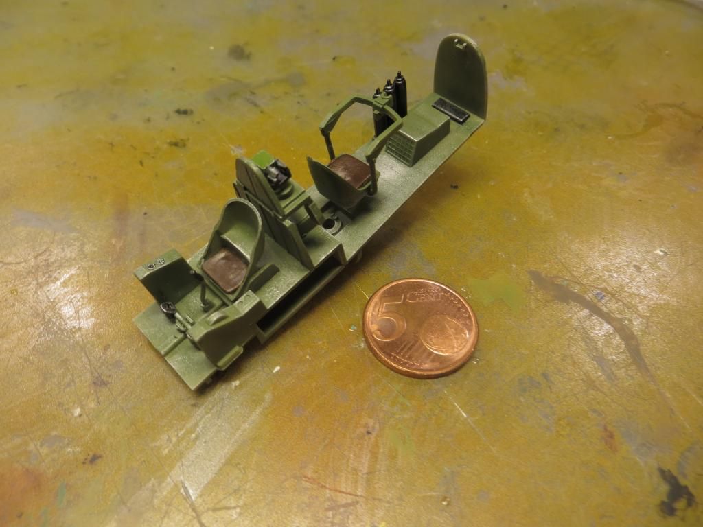

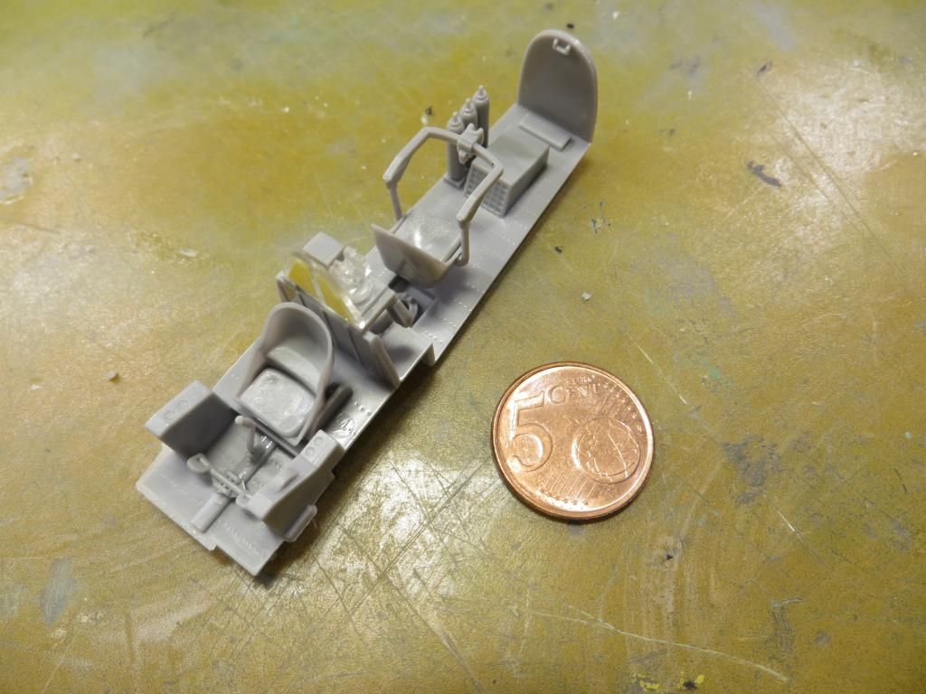

Finally an update! :banana: Sorry for the long wait. Time is just too fast! :crazy: So here is some progress I have done:

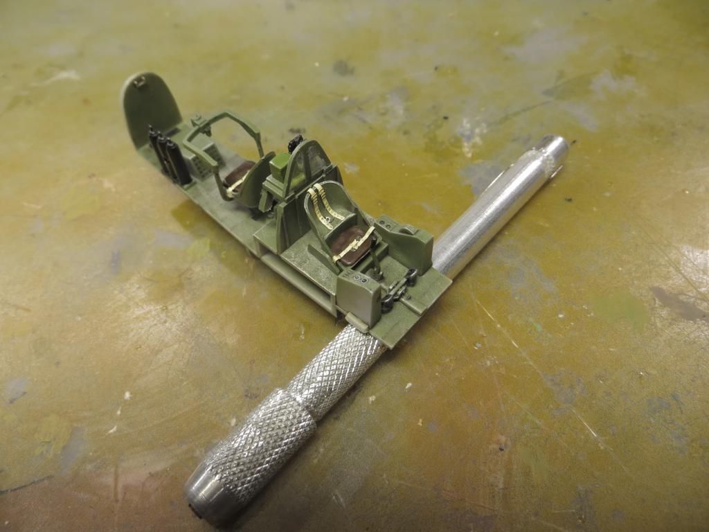

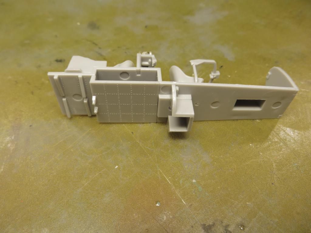

Cockpit built up.
A few parts added to the fusulage halves.
More parts added to the cockpit.
A few parts to be added.
Got this a few days ago. :)

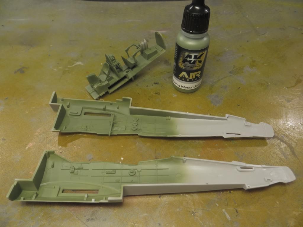

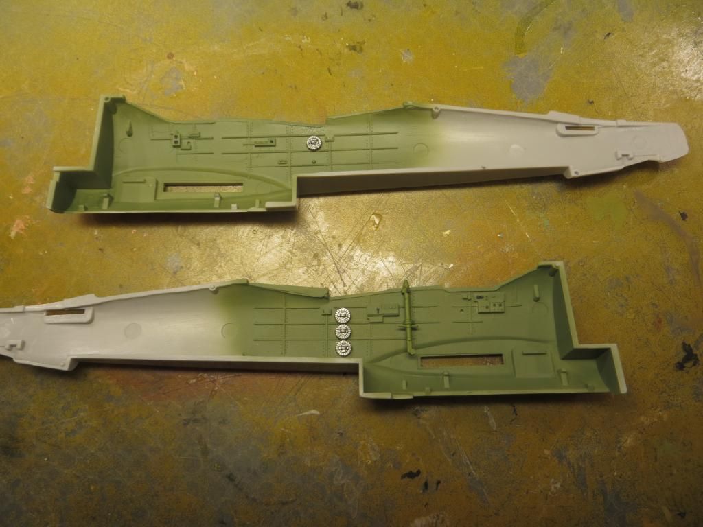

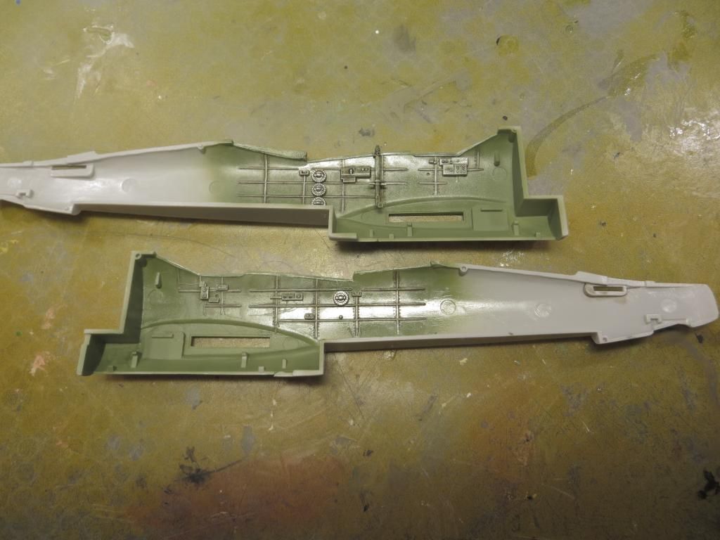

Sprayed in Nakajima Interior Green.

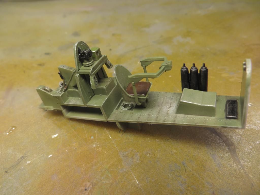

Some detail painting here and there.

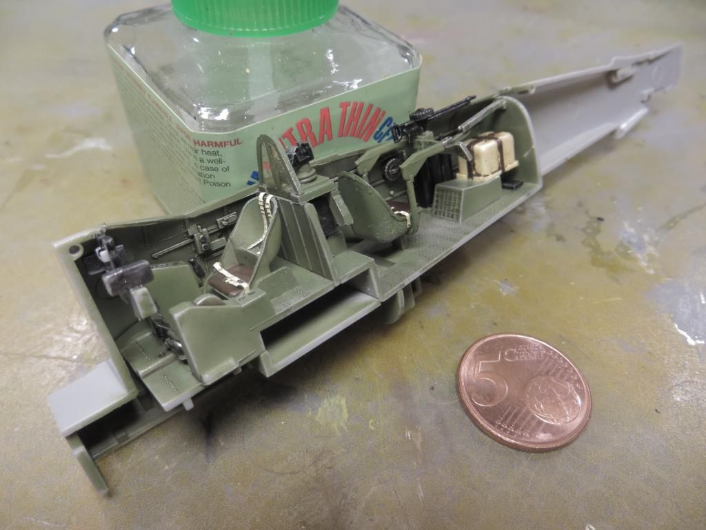

Cockpit drybrushed and gloss-coated.

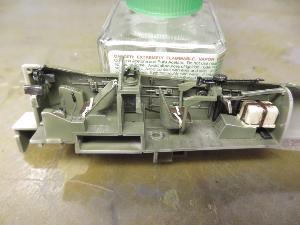

Then I gave the cockpit a wash with some Mig olis.
Some bits'n bobs to be added to the cockpit.
I put in some leftover PE seatbelts from random kits.

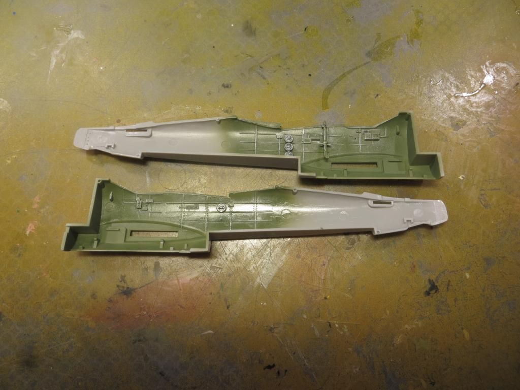

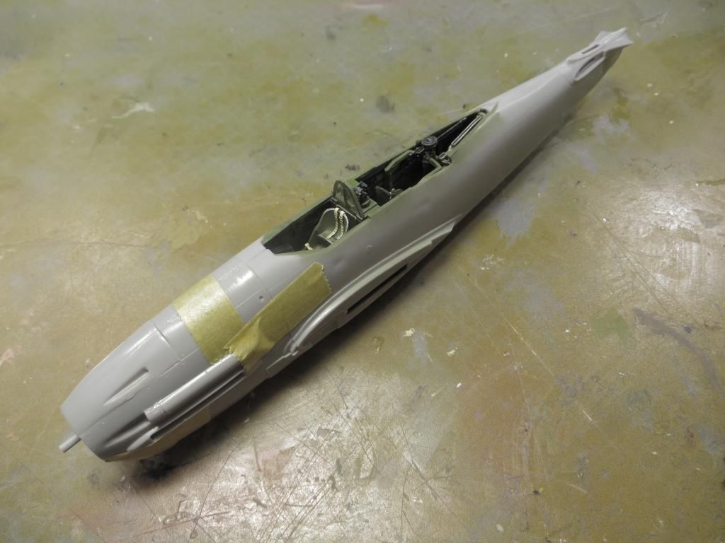

Rest of the parts added to the cockpit and glued to the fusulage half.

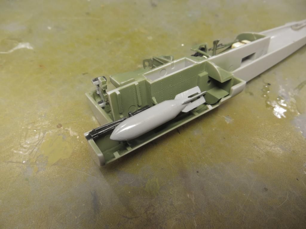

Bomb attatched into the bombbay. Sadly it won't be seen.
Fusulage halves glued together.
To be continued...

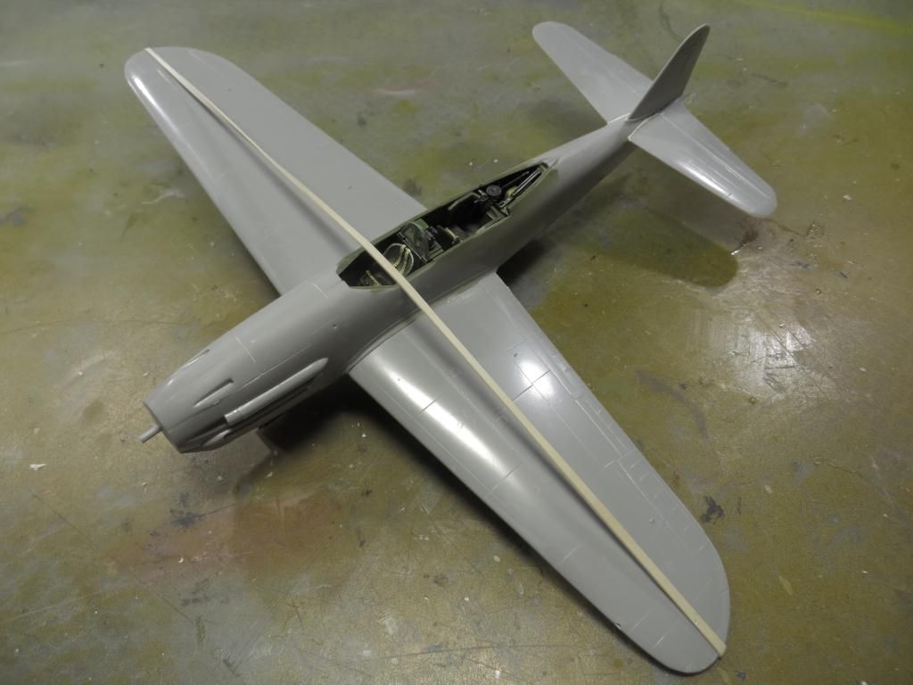

A little update this time. More to follow.

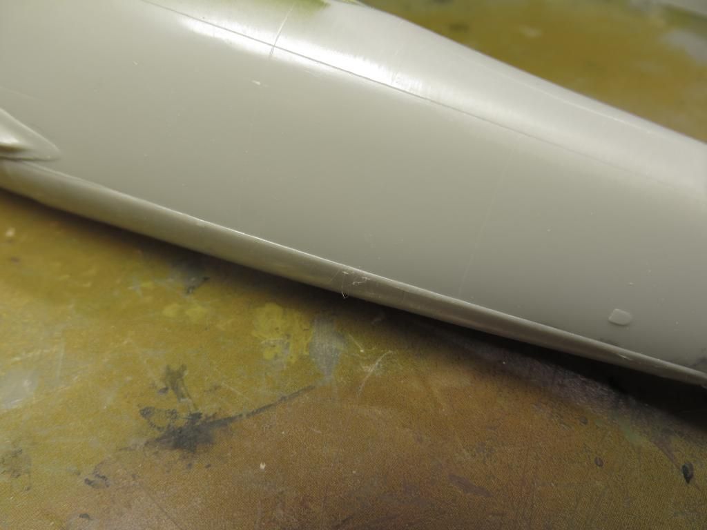

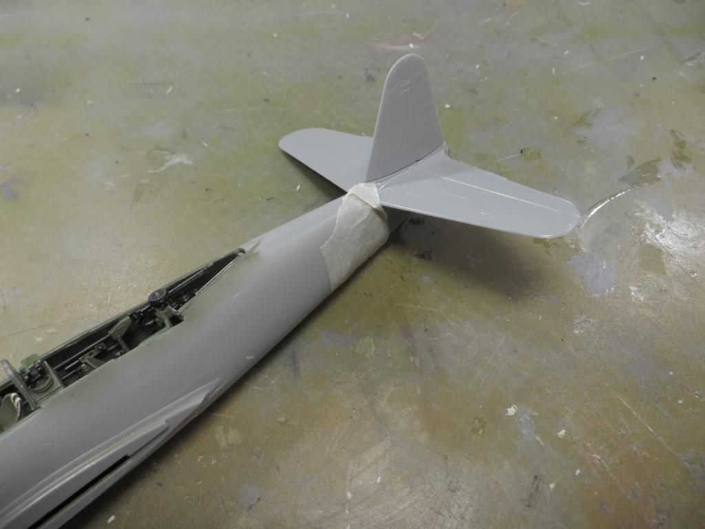

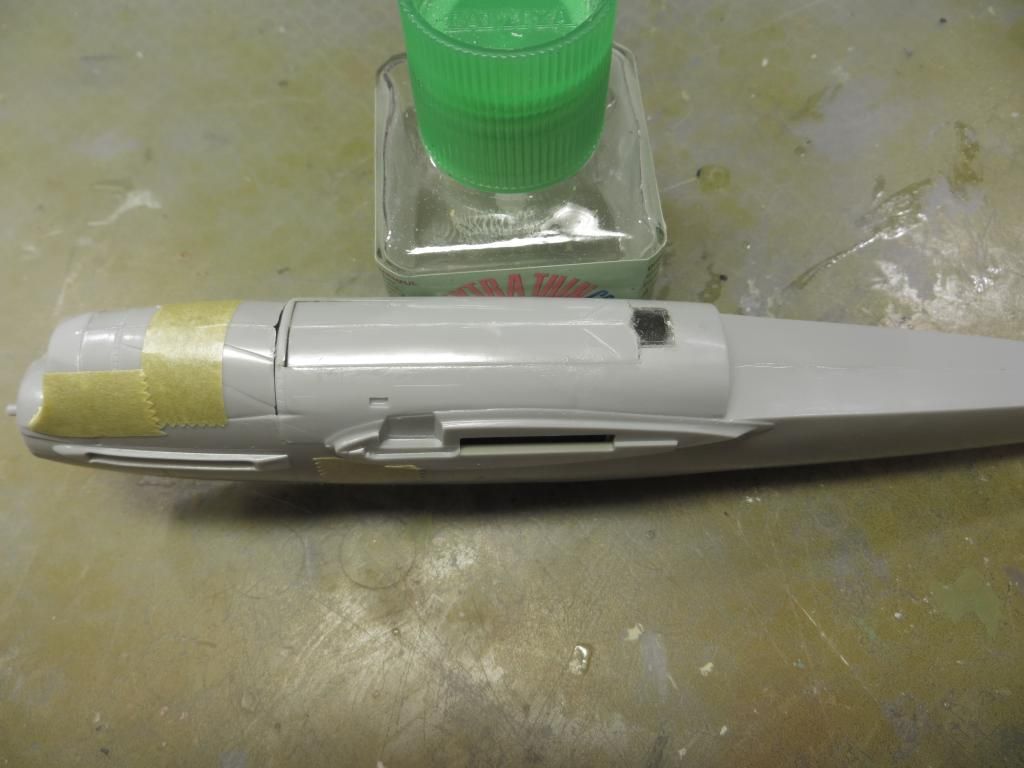

I wouldn't say this is a "great" kit. The fit is bad and it lacks lots of surface detail like panellines and rivets. I'll sure add more rivets to it.

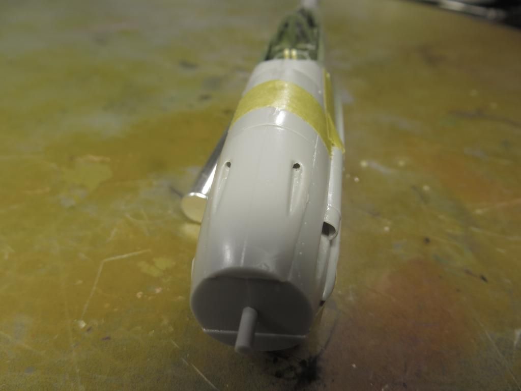

Cowling built up and attatched to the fusulage.
Bombbay doors attatched.
I drilled out the holes for the machineguns.

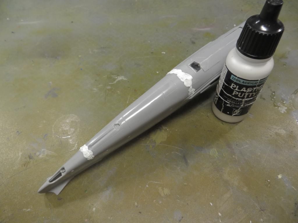

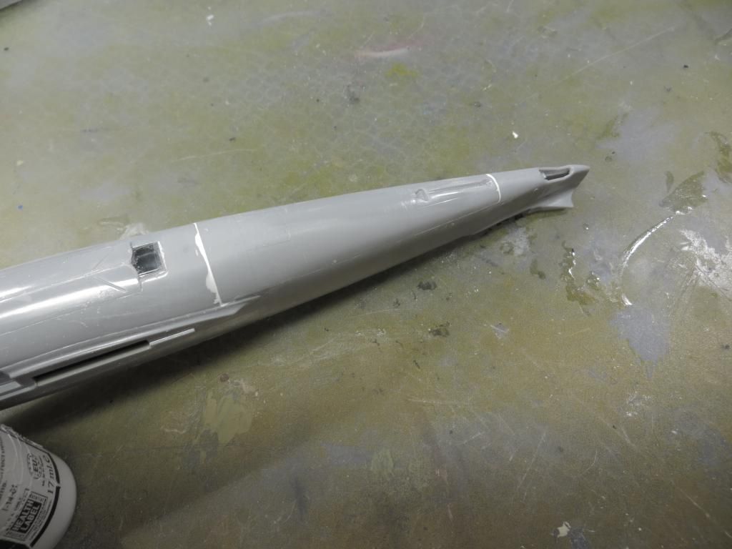

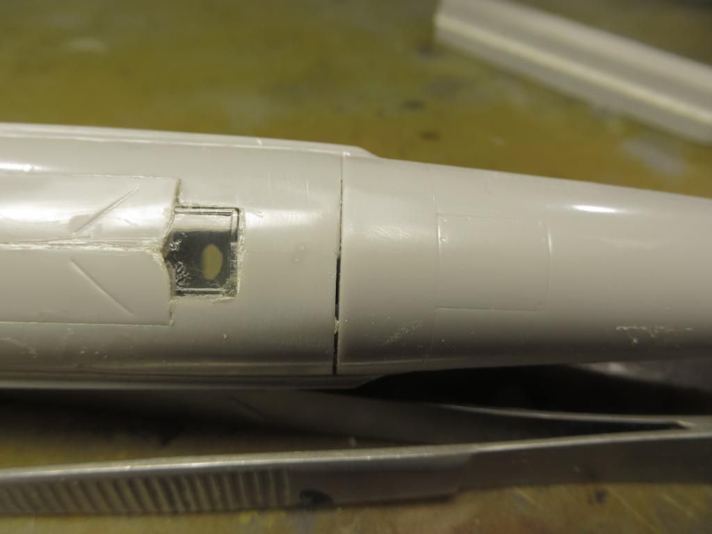

Lower part of the fusulage attatched. The fit was really bad. :bash:
Big gaps here.
And the part was even too wide! :eeek:
Lots of putty and sanding needed.
I think it's finally good enough.

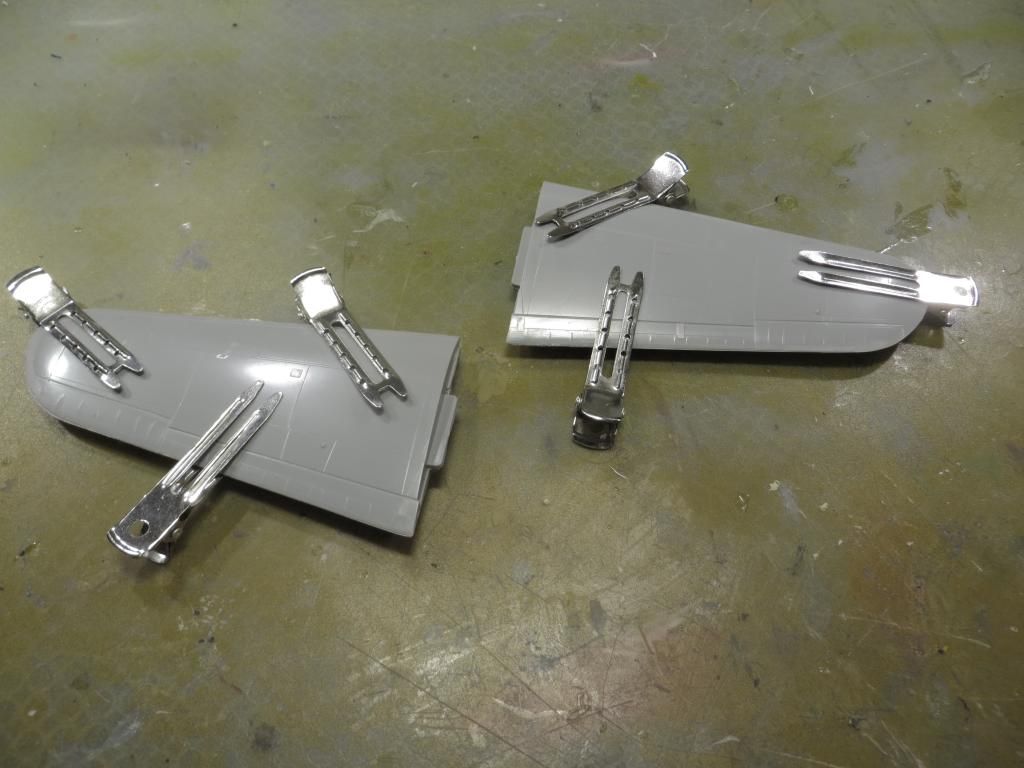

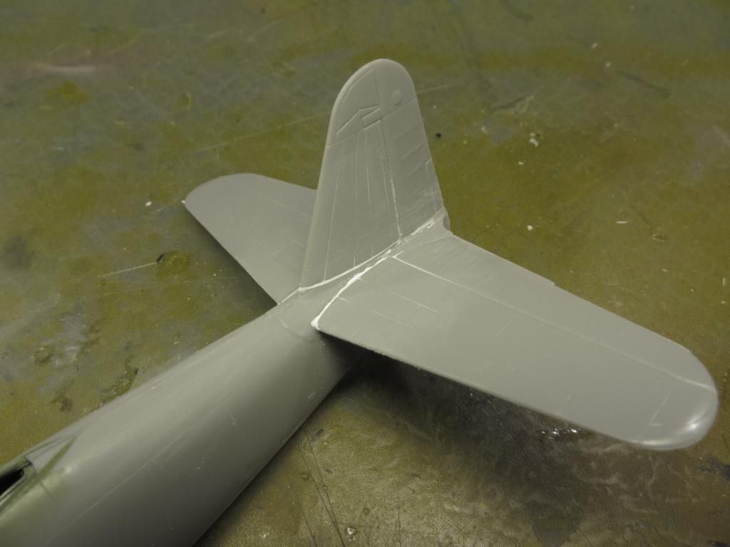

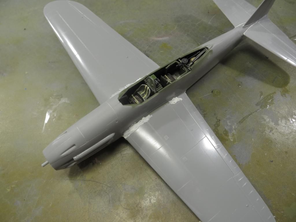

Wings glued together.

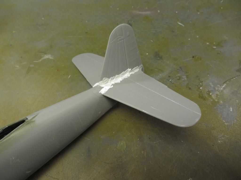

Horizontal and vertical stabelizers attatched.
More filler needed here!
Sanded smooth.
Wings attatched.
And filler in the wingroots of course!
To be continued...

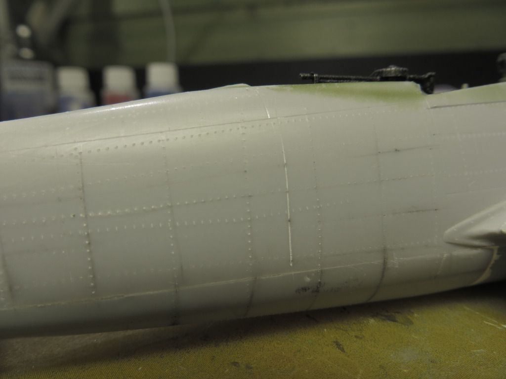

Sorry about the delay on this build, because a month ago I had came to a tougher part of the build, like doing the riveting and vacu-forming the canopy, so I almost lost the mojo. And then I was ill for about a week or so. But I slowly worked my way forwards on the build and now I got it this far.
Not to speak of that I just got a new AB a few days ago, a H&S Infinity CR Plus! :banana: Gonna have a great time with this new tool in the arsenal.
Enough talking there, Here's some progress on the build:

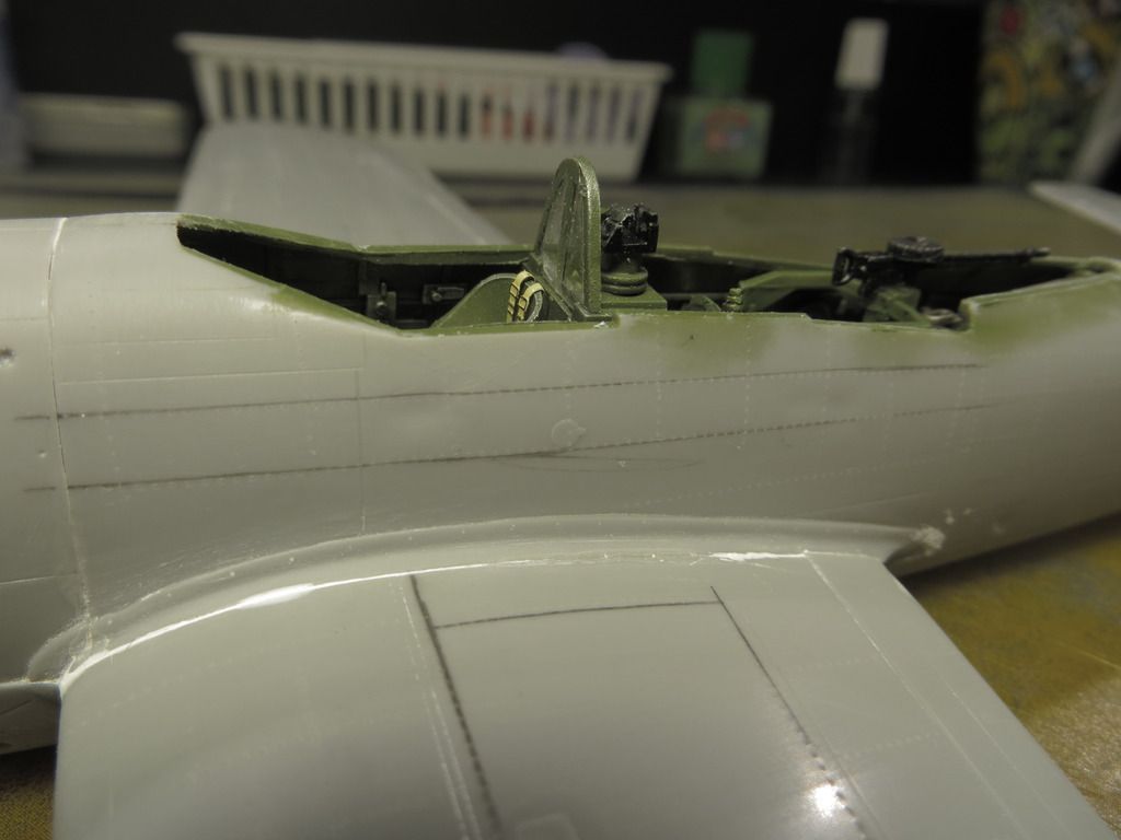

Some filler needed in the wingroots too.

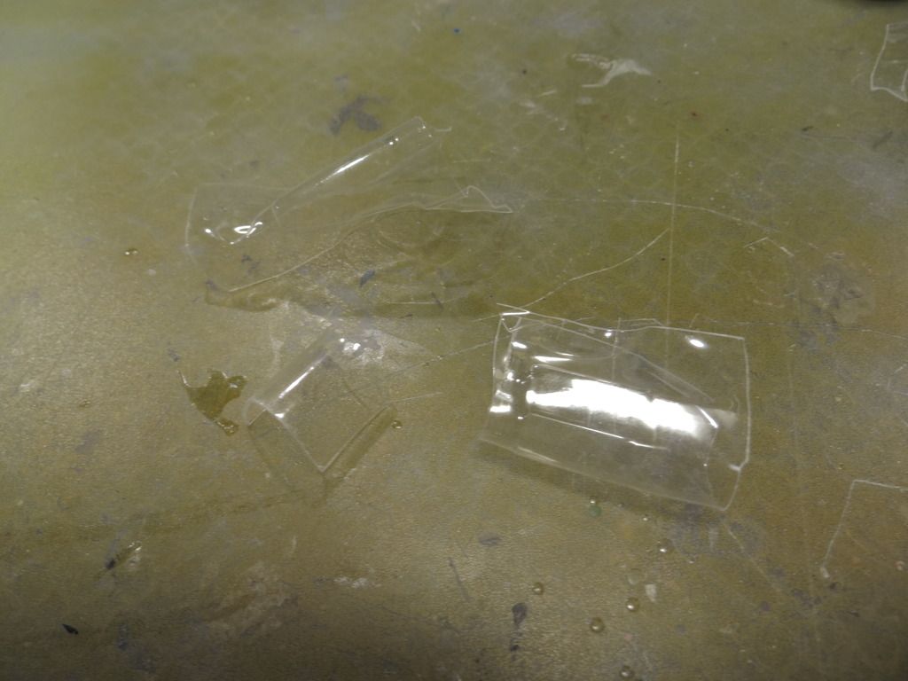

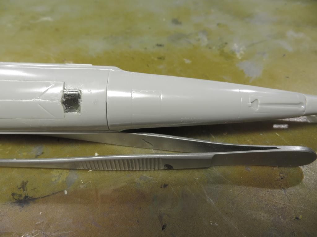

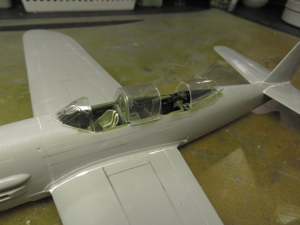

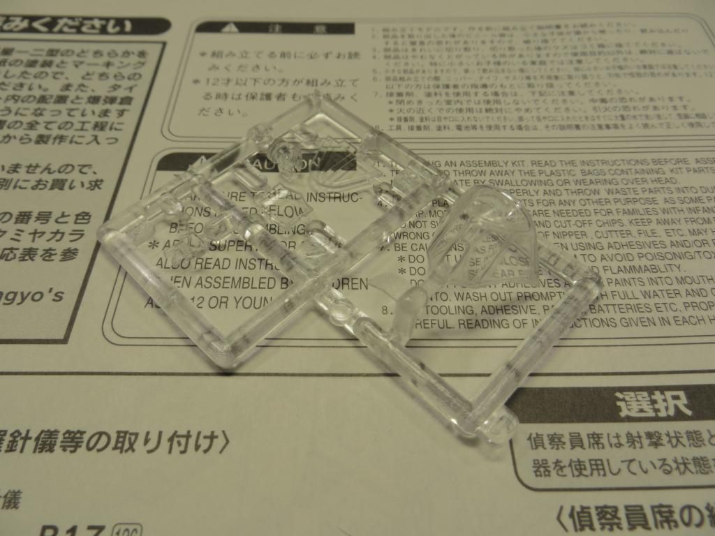

Then I started vacu-forming the canopy one section at a time using the original kit canopy as a mould. I will use the kit-supplied windshield.

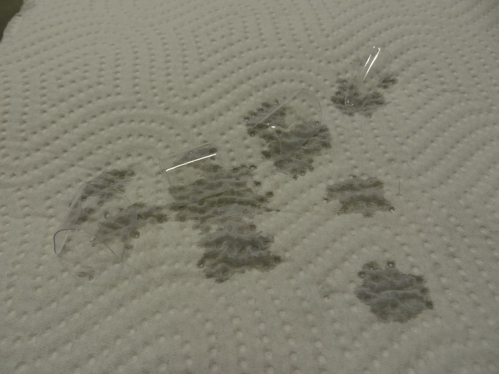

After I cut out and sanded all the pieces to the vacu-formed canopy I dipped them in a bath of Alclad Aqua Gloss to clear things up.

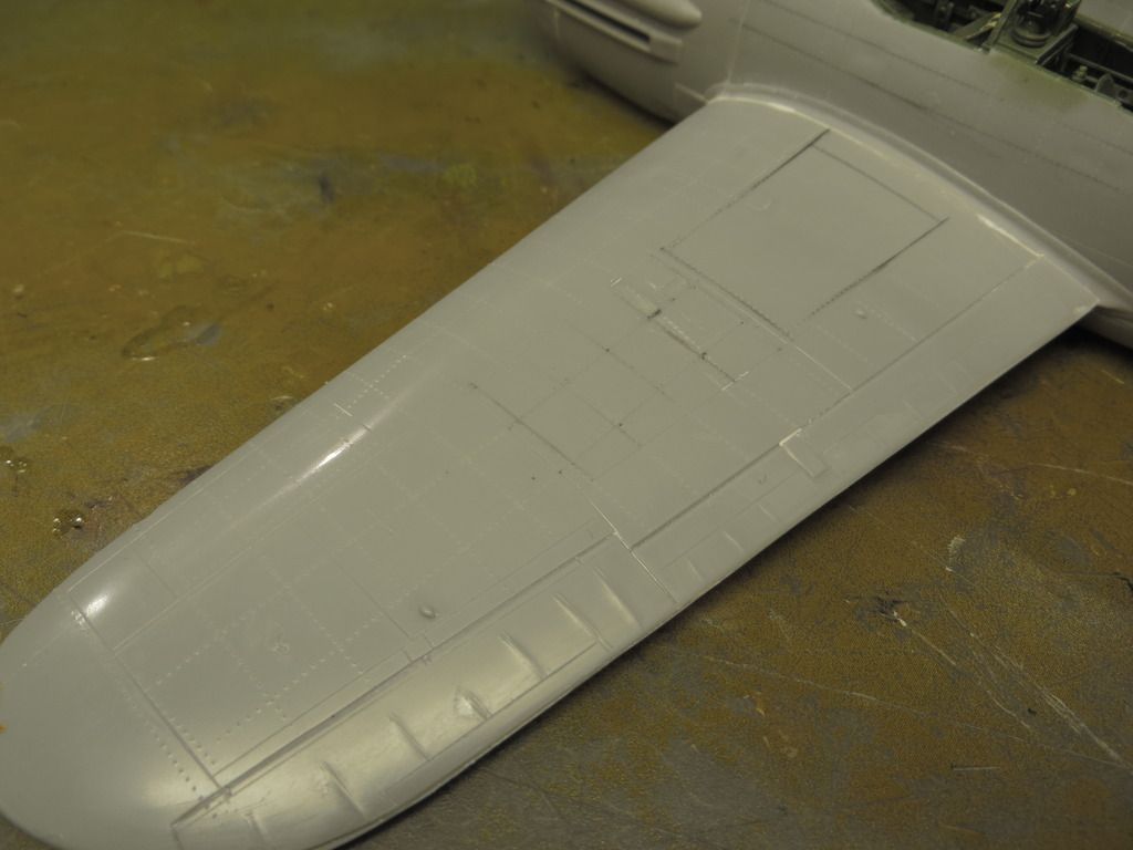

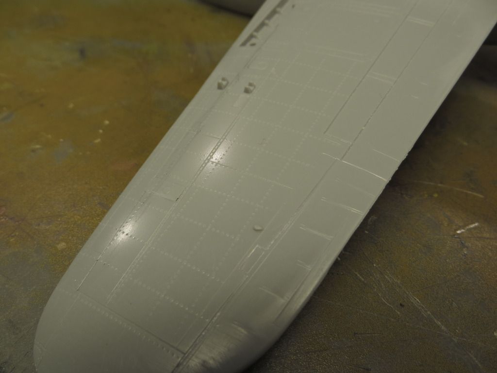

Then I started riveting the whole thing using a Trumpeter riveter. (You can see that I had to fill some rivets when the line didn't become straight.) :shifty:
A little test fit of the vacu-formed canopy. (The windshield is the original kit part.)

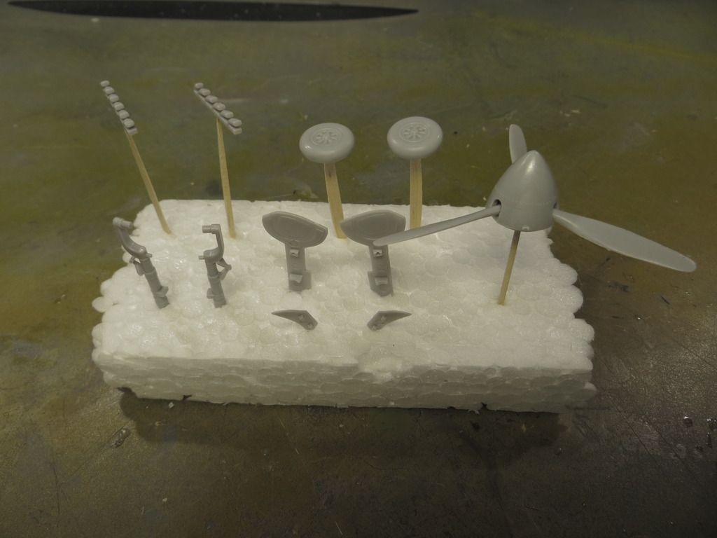

Some bits'n bobs redy for primeing, more to come.
