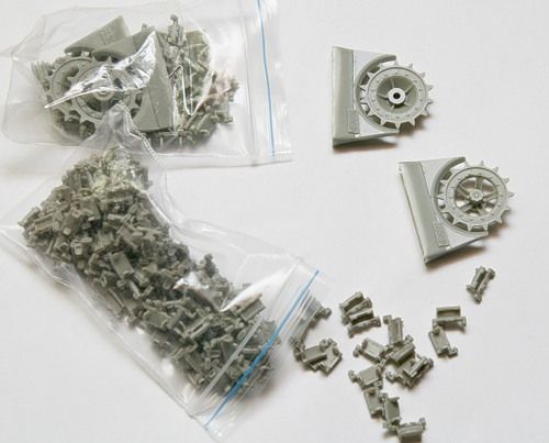

After trying to make the Zvedza tracks workable by drilling holes in them and putting a pin trough, I have made my decision. Broke 4 micro drills (0.3mm) and ruined 6 track links. It is allmost imposible to get the track links drilled all the way trough 100% straight.
I have done this job before without troubles, but these Zvedza just will not be drilled...
I got a lot of pacience, but there is a limit.
So... Time to visit the after market!
Found these workable tracks from MasterClub on Ebay. They are resin, and have great details. Every link got its own casting nr like the real ones have, so thats a plus!
These will work fine, and saves time, drills and frustration..
I think I have made the right decision...
Concentrating on my PE work now while waiting for these tracks to arrive from the UK!

Nice one dude.
Those track look nice hope they work out better for you.

Well, if you couldn't make the Zvedza ones work, I doubt anyone could. By the sounds of it you've done exactly the right thing getting AM tracks; I read once that only a foolish man continues in the same direction once he realises he is going the wrong way.
Hope those new tracks do the job for you.
Re: Zvezda 1:35 Russian BMP-2D
Those tracks are really nice Frans, the detail alone would have convinced me to get them.
They'll be perfect.

All looking great. Interesting about the tracks though, was thinking of getting some zvezda armour myself. May not now
- fly1ngdutchm4n
- First Lieutenant
- Posts: 3554
UKscalemodeller wrote:All looking great. Interesting about the tracks though, was thinking of getting some zvezda armour myself. May not now
Thank you. The Zvedza kit is not all that bad tho... But this one is a older kit, and low on details.
The track links had to be glued like the Dragon magic tracks. But I wanted to make them workable, and that is almost imposible. I think the newer zvedza kits are better, but I never done those before, so I would not know that...

Those tracks look great, good luck with them when they arrive

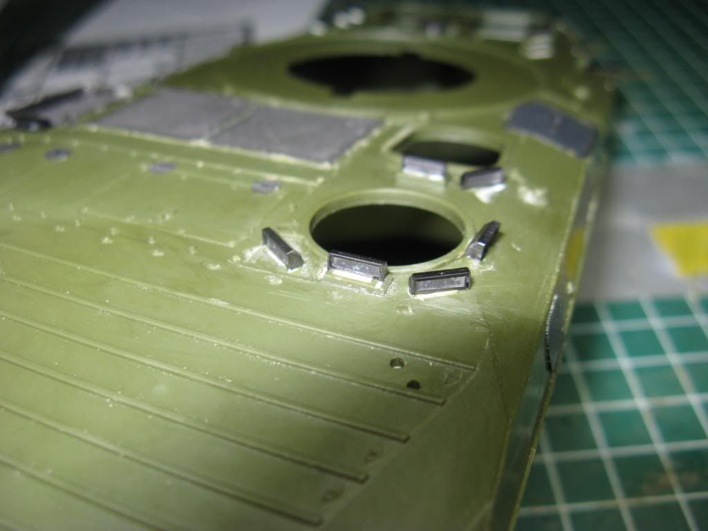

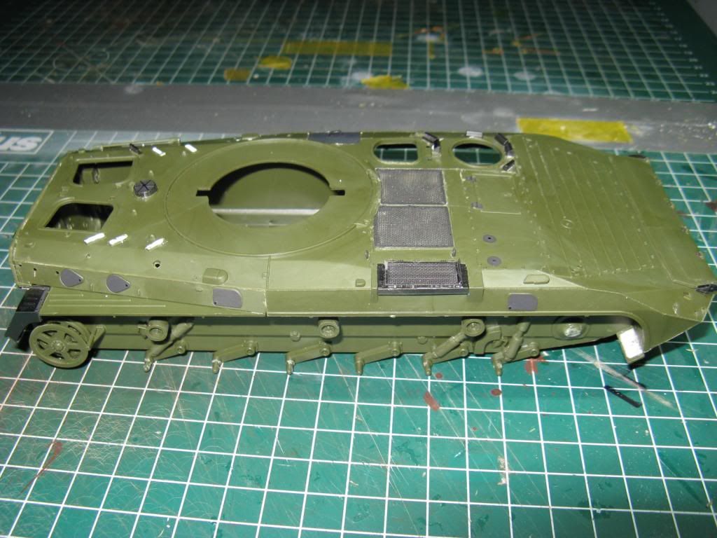

Update #7
Friday night, and weekend
Time to show a little update!

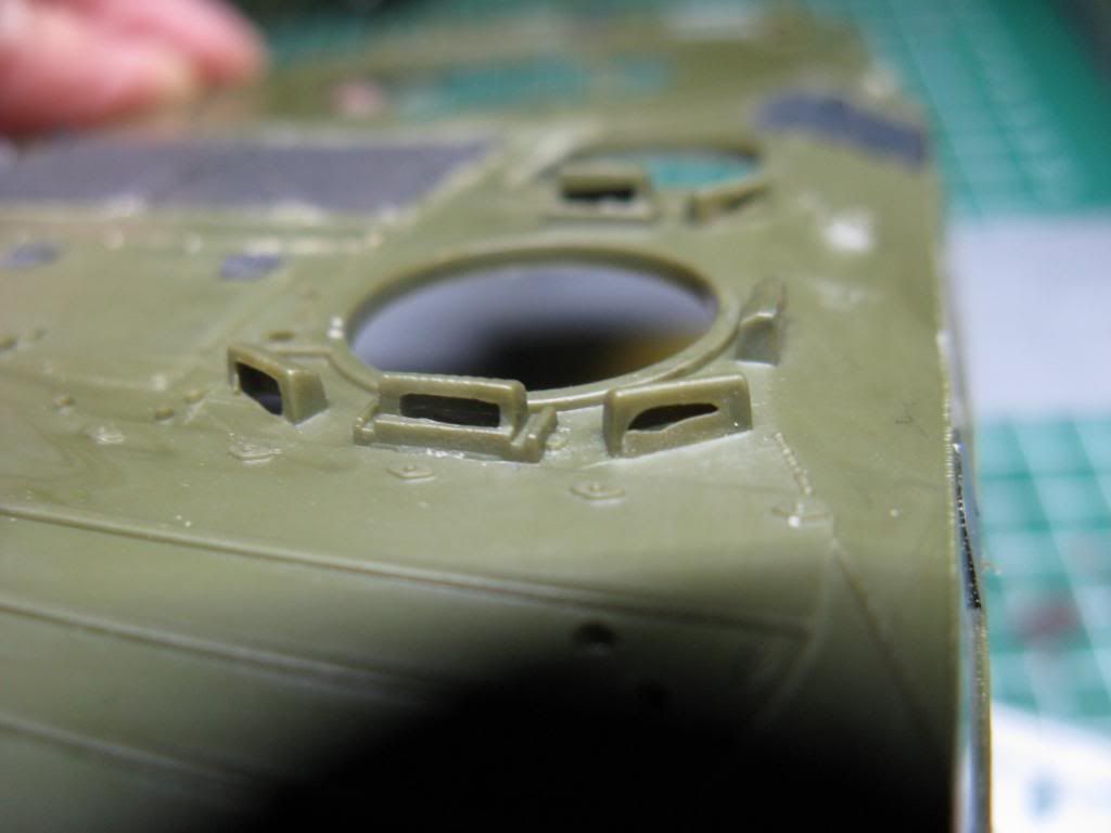

Time to replace these thingies what should be periscopes...
One periscope is made from two PE parts. Hard to bend them, but it is possible.

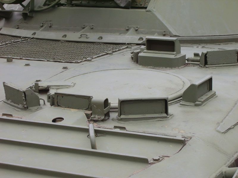

And here is the real thing...
I must say.. This is a realy good PE set from Aber

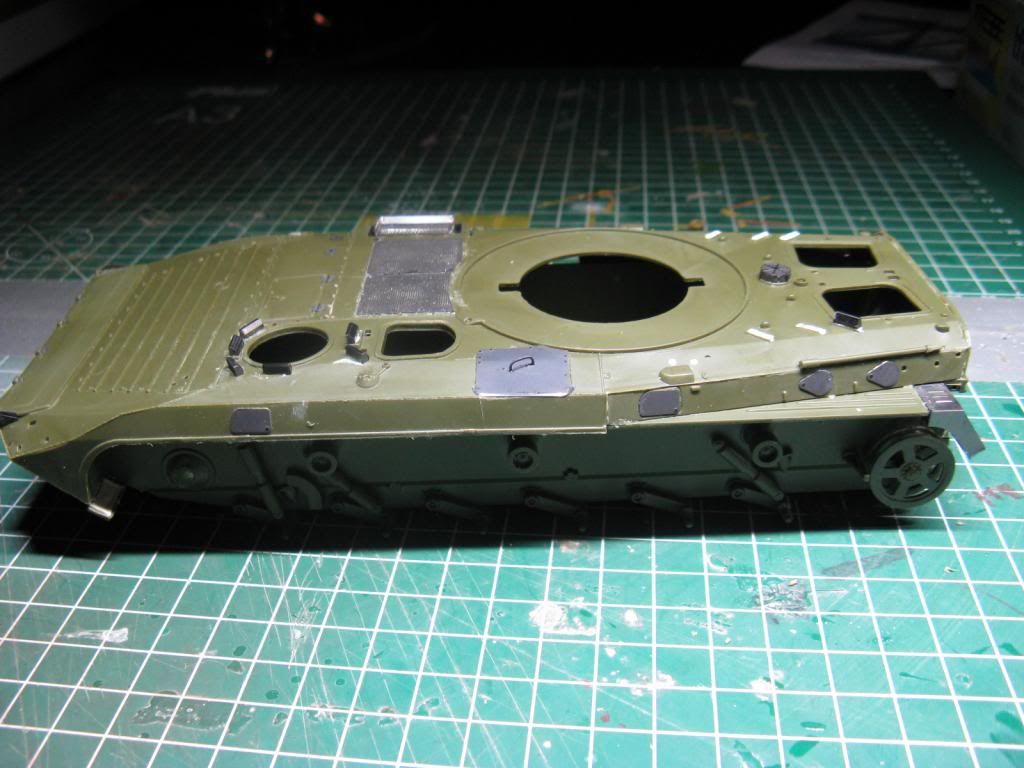

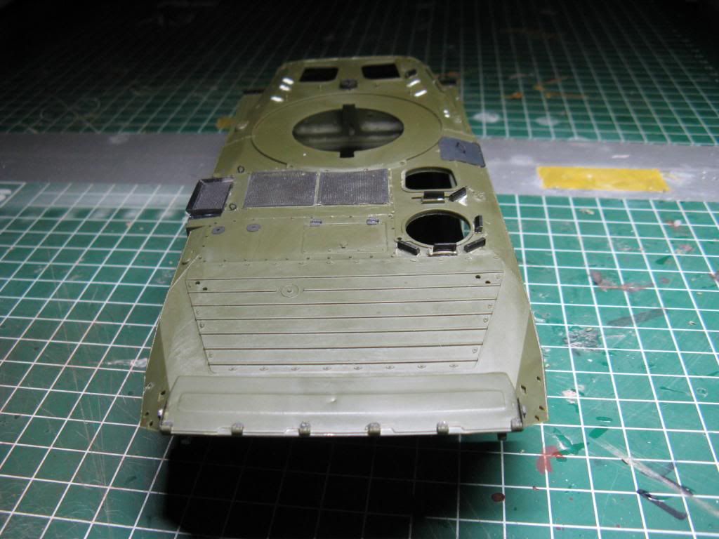

First I glued to upper hull to the lower hull. It needs some filling and sanding, but that's for later.

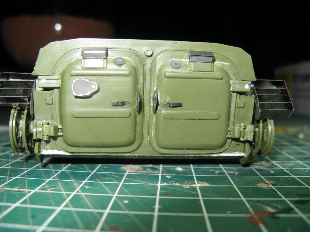

Finished the back doors.

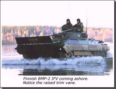

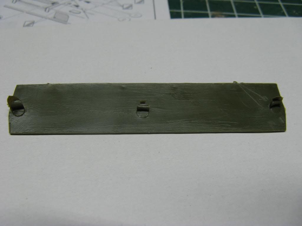

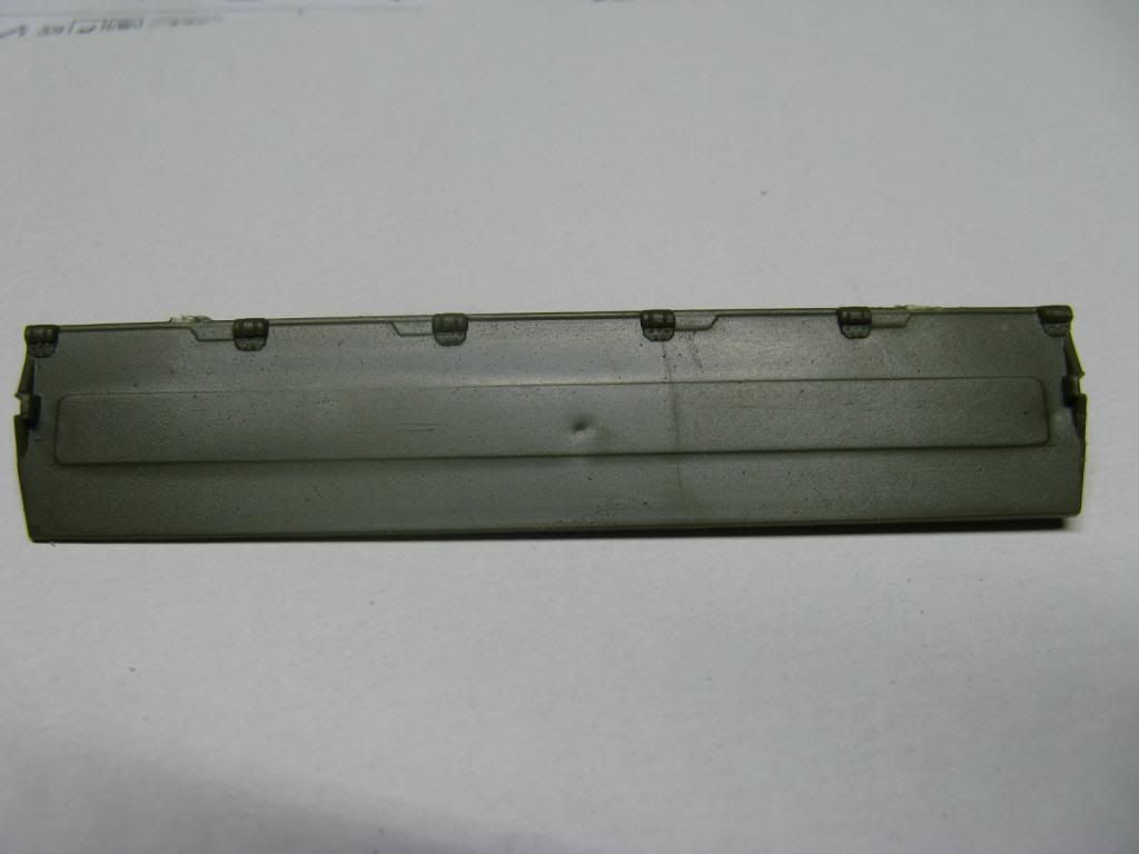

Detailed the trime vane that is on the nose of the vehicle. It's to prevent the vehicle going under water when it's going fast in the water.
Here's a picture of a Finish BMP 2 with raised trim vane.
And this one is flat on the nose like I'm doing on my model:
Time to start.
I have heard of molding pins/marks, but this is ridiculous...
So after the usual filling and sanding, this is the front of the vane.
The side hinges are going to replaced and a part of the front hinges too.
This is the reworked one:
Side hinges:

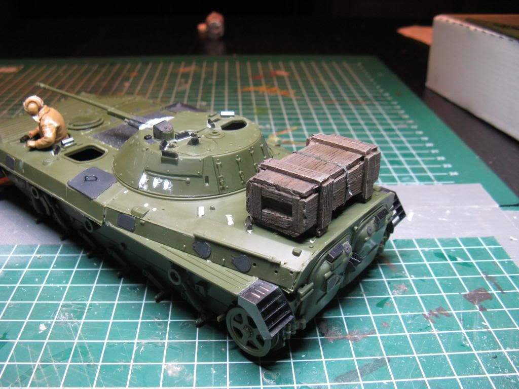

And here is a 360 view of my progress so far..

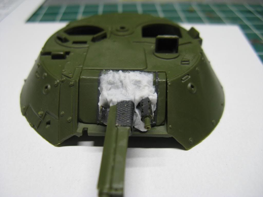

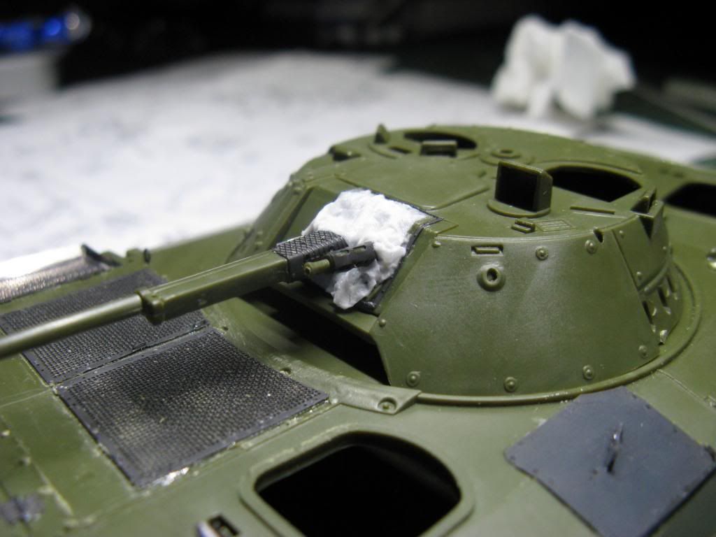

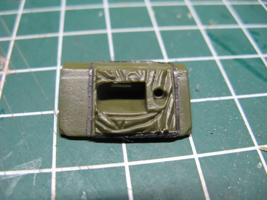

Update #8
After a short and loud trip to Lee's library
I did some work to the 30 mm automatic cannon 2A42.
Again some parts needed to be removed and replaced by PE.

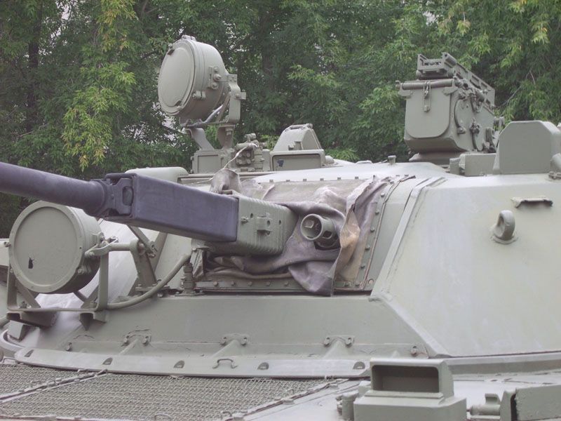

When I looked at a picture of the Original gun, I noticed a canvas cover over the gun.
The Original part has a molded one as seen here:
But I wanted to upgrade this too, so I used the tissue and wood glue technique to create a new cover.
It's not very clear to see on this photo (it looks a bit like paper pulp) but It's still wet and my camera does not pick up the detais very well.
Here is the Original cover that I used as reference.
That's it for now, tomorrow I got some more time to build.
See you then!
That cover will look cool when it dries.
It should still have some of the texture of the tissue paper.
I always fine that it looks a lot like canvass.
Nice work Frans.
Nice work Frans.
- Paul
- Site Admin
- Posts: 12622
That's cover looks awesome
great job Fran's

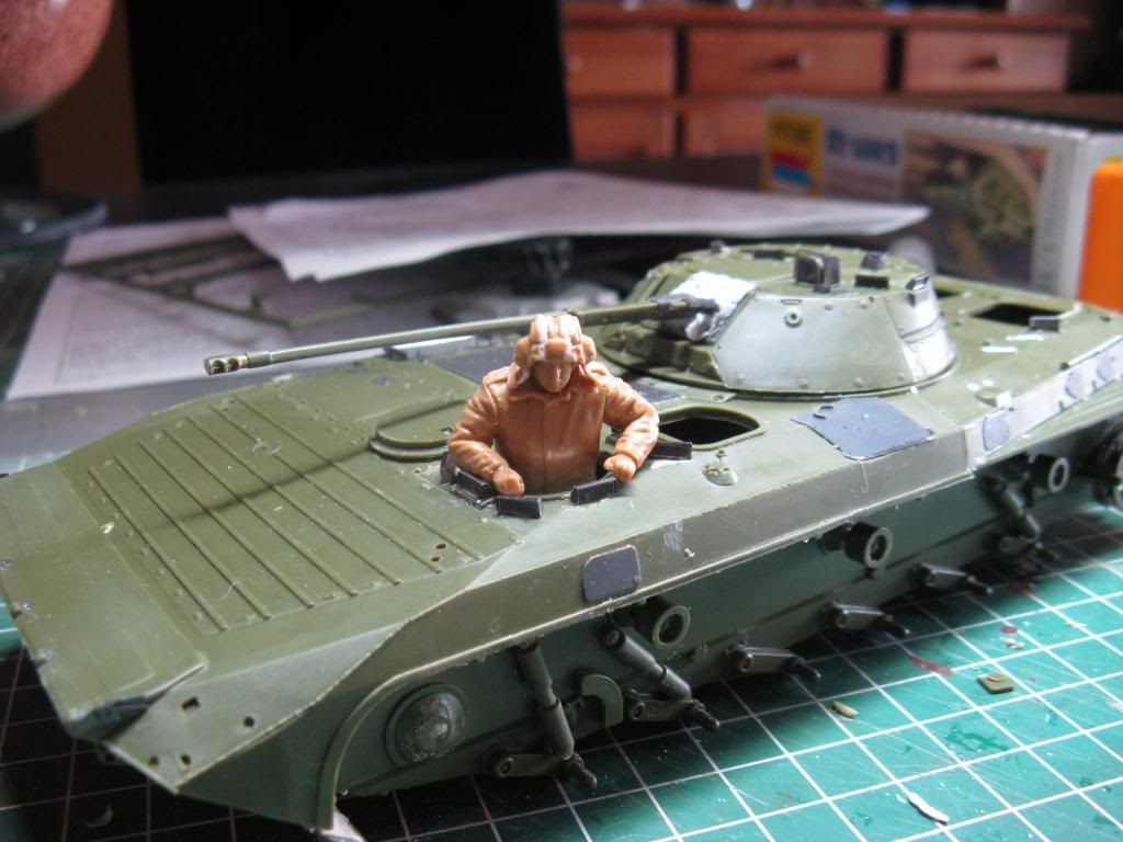

Hi guys!
I didn't do much this weekend, for I'm tired and don't want to ruin any PE work.
So, Instead I glued on of the figures together, and I'm trying out some positions where to put him.
It's actually a gunner, but his body is way to big to place him there.
So Iv'e made him a driver instead.
What do you guys think about this position for the driver?
He looks a bit grumpy, but that's probably because he had a lot of filling in his crack(s)
Getting some rest now guys. hope to get some work done next week!

Epic PE work. How much more is there left to put on?
coming along nicely mate,
the crew member looks very nice and adds a nice sense of scale,
great work, this build is a proper labour of love and its certainly worth all the work you've put into it
great stuff
Shane
great stuff
Thank youUKscalemodeller wrote:Epic PE work. How much more is there left to put on?
There is a lot more PE to do, but no big things.
Just things like the smoke granates, periscopes, some clamps and clasp, belts, hinges, bolts, handles, ....., ....., ......,
So not much at all...
Thank you Shane,longlance67 wrote:coming along nicely mate,
great stuff
Shane
I thought the figure lookt a bit too big, but it's not, it's the correct size.
I'm having fun building this poorly molded model. It's a real challenge to make a low detailed model pefect.
I'm way out of my comfort zone with this "modern" build, for I am a German ww2 builder, but I like the build of this thing.
There is still a lot of work to do, but I'm getting there!
I like the look of that figure there Frans.
The placement of his hands if perfect for the location of the periscopes.
Very natural looking.
Possibly talking to someone standing next to the vehicle.
- fly1ngdutchm4n
- First Lieutenant
- Posts: 3554
Like this figure myselfCoen wrote:I like the look of that figure there Frans.![]()
Very natural looking.![]()
Got two other figures planned standing next to the BMP.
Had to warm this figures arms to place them in the position I wanted.
Poor guy...putty in his butt and melted arms...

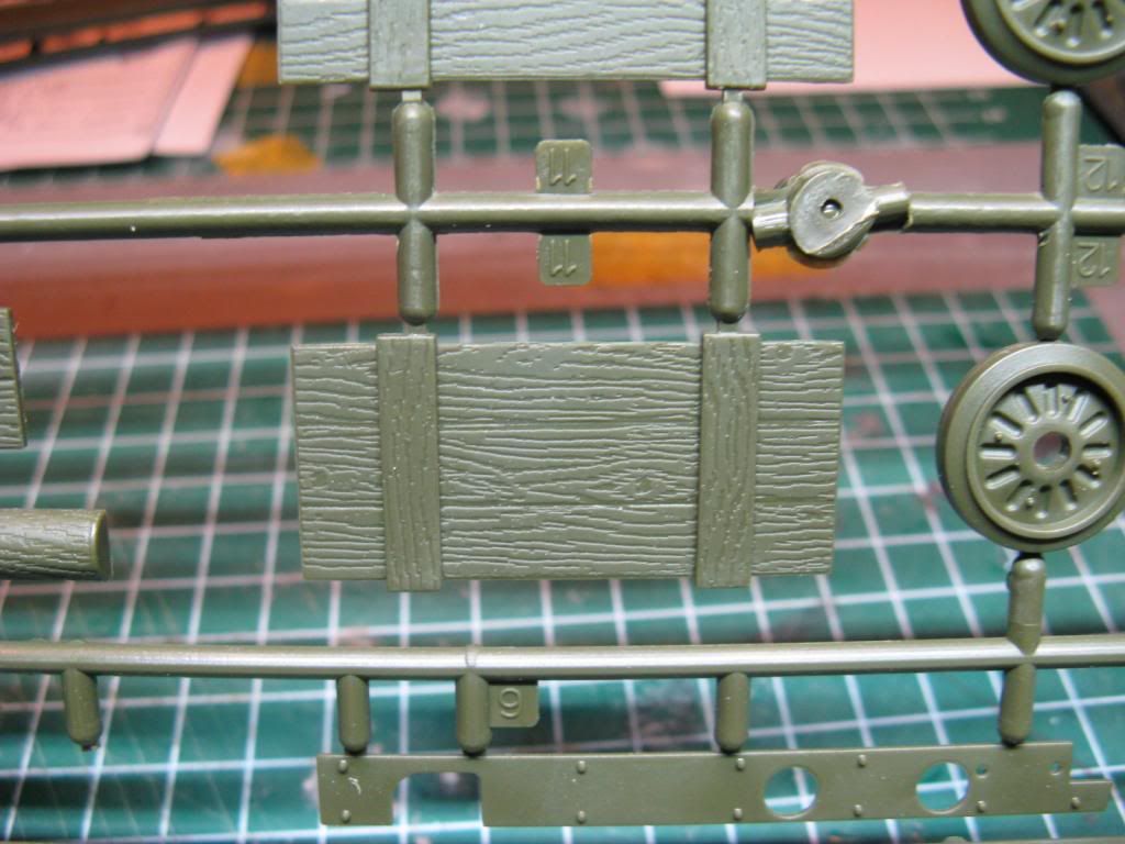

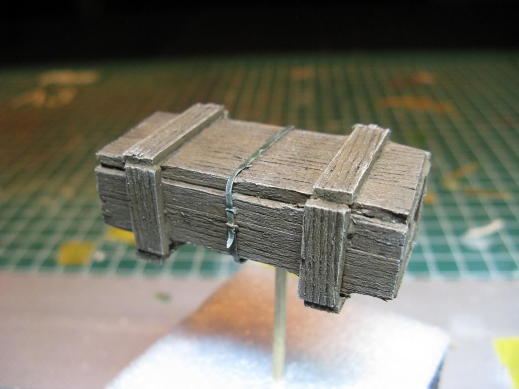

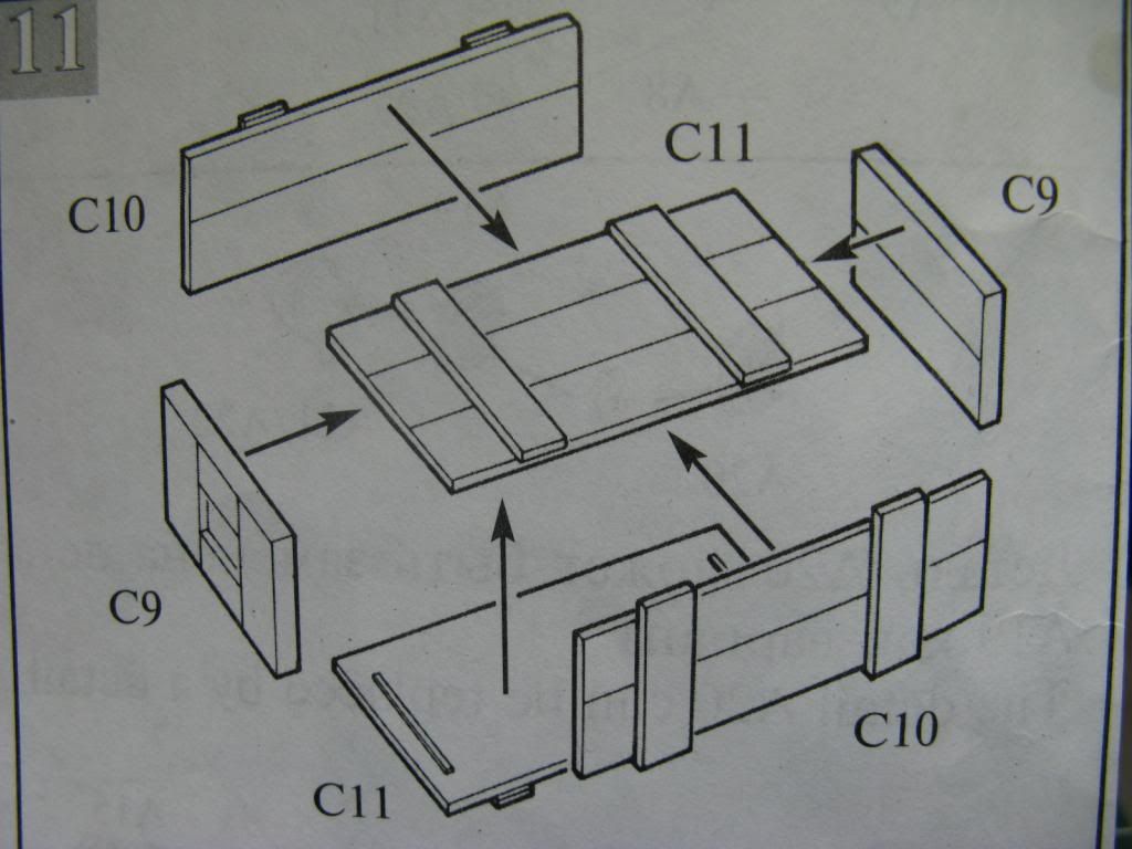

Had some time left tonight, Did not wanted to build much or sticking my head in my butt like Coen, so I started crafting a crate instead...
This kit is provided with a plastic one, but I don't like it.
Time to replace it...
Manual
Parts

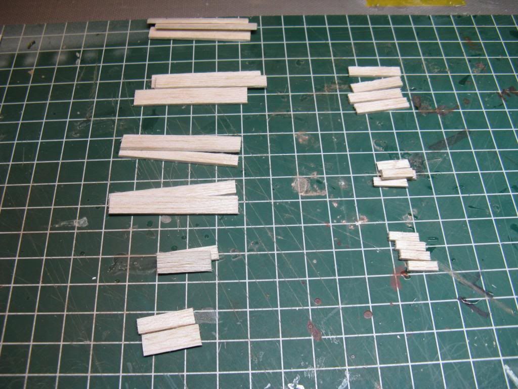

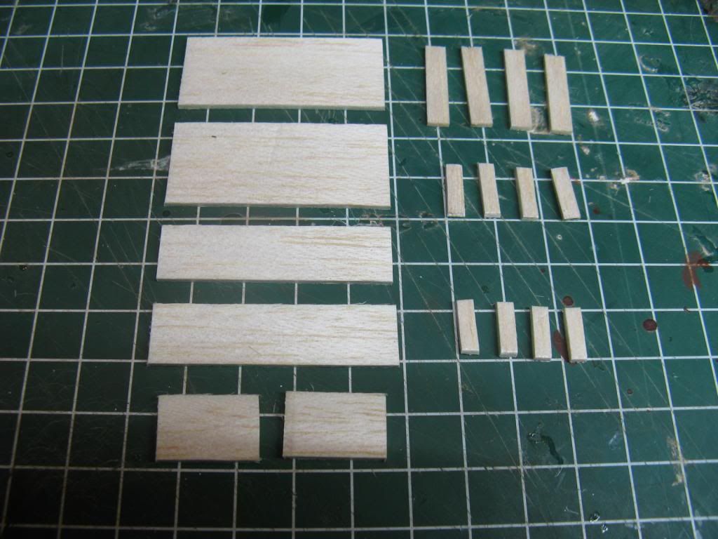

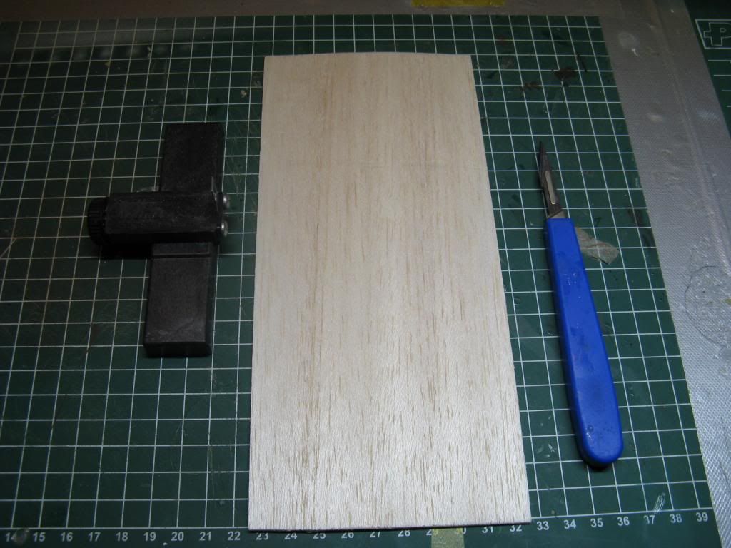

These are the materials I'm going to use:

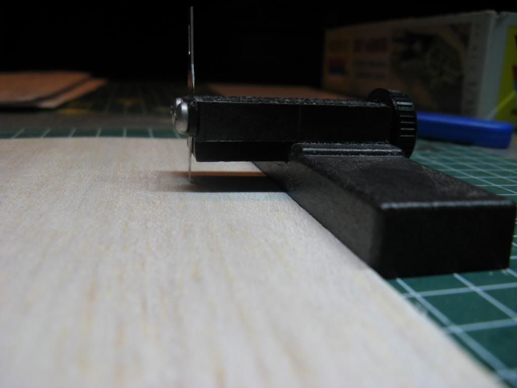

1.5mm Balsa wood, scalpel, balsa cutter, cardboard and woodglue.
This is my balsa wood cutter. Awesome thing! Turn the wheel for the desired thickness, and cut the piece you want!
After some happy cutting, these are the pieces I'm going to use...

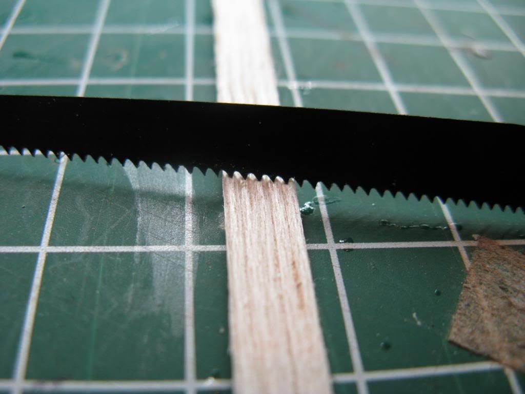

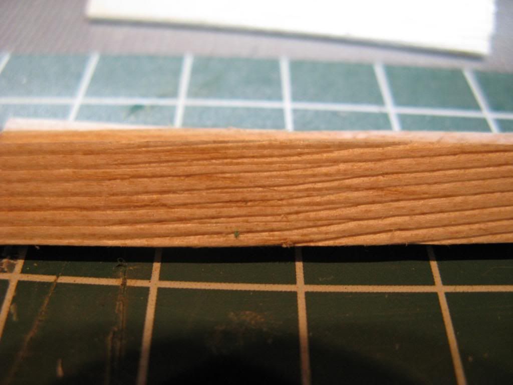

For a more wood like look, I make woodgrain with a micro saw.
And you'll get this:
After cutting the pieces into planks, this is what needs to be assembled:
Time to glue the parts on some cardboard.
After drying, you can cut them loose.

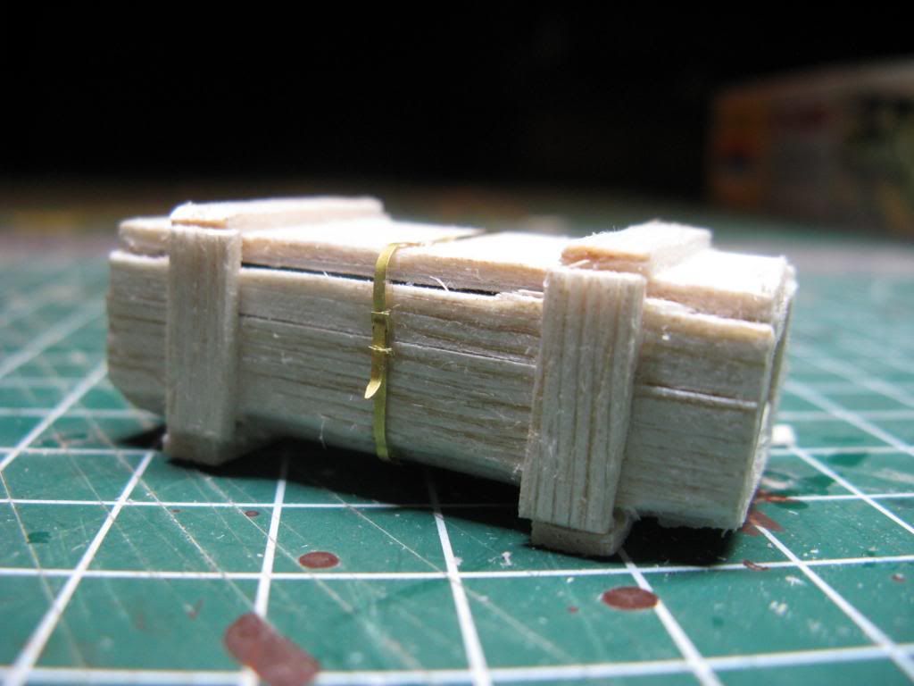

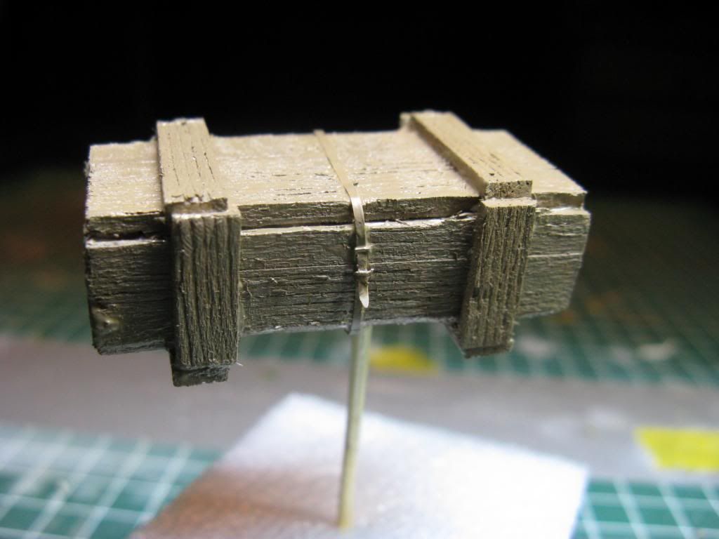

When everything is assembled and a PE beld is placed, (no build without PE for me

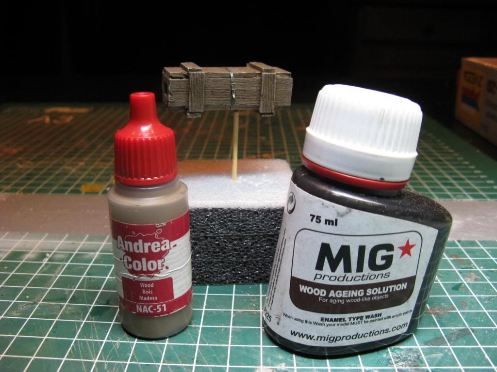

Painted it wood brown
Time for some weathering.
I used MIG wood ageing solution and a drybrush with Andrea wood and valejo white.

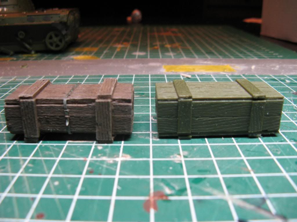

Final result:
Left: my crate Right: kit crate
What do you like better?
I don't like crates that look new like the one in the kit. Crate's should have holes and cracks in them, but that my opinion...
This crate is planed here:
I think it looks awesome...
Cheers guys!

nice work mate
adds a lot
shane
Awesome work on the crate, love it
I pulled my head out just long enough to see this wonderful crate appear.
It's wonderful haha.
Actually it's bloody fantastic!!!!
I make mine out of fruit basket wood or Popsicle sticks, depending on the thickness.
I've never thought to use PE though. That's pretty cool!!!
