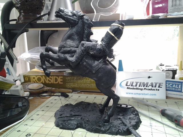

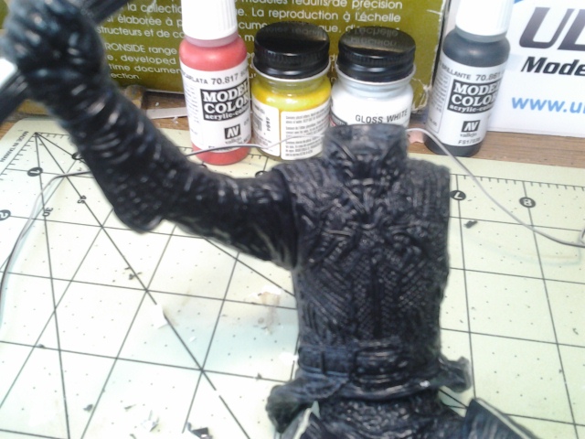

Flash Mr. and Mrs America and all ships at sea. Here is the latest update on the Headless Horseman. I got the legs glued on the lower body, but there is some major fit issues. Where the legs glue onto the lower body, the body portion is flat and the legs are dished in towards the center of the leg and on the left leg, it only makes contact in a couple of places. The lower body also has a big bulge on the end of the legs, then has a smaller diameter bare portion toward the end. The holes in the body and the pins in the legs, move the legs toward the center of the body. I trimmed the pins and elongated the holes to move them outward. MEMO TO SELF: check to make sure you have the left leg on the left side and the right leg on the right side. You can swap them from side to side and they will fit trust me. The leather leggings I raised up possibly a mite too high, but they set high anyway. Okay, now the lights in the horses head and in the body. I was going to use individual NANO lights for each eye, but that presented a problem in a way. I would have to run two lights to the horses head, and a third into the body of the horseman. So after seeing how much light the green stickons put out, I went away from the NANO LEDs and went to the stick on red lights. That way I can do all the painting, shading etc, then drill out the eyes, nostrils, mouth if I want to and only need one light for the horses head. I stressed over how I was going to light up headless's neck, yet not have an opening that just looked into the body when the light wasn't on. I had more Rube Goldberg, Grouse Creek Field Engineered idea from casting a clear part, to cutting and painting a piece of clear styrene black then scribing lines in it. Then suddenly I had a brilliant flash of an idea. I would cut the opening out and just leave a rim around it to support the part that goes in there, so I can remove it when I want light, or put it back on when I don't. Now, how do I keep from losing the part? I drilled a hole in the tab that went into the slot and will put a piece of wire with a weight on it to keep it in place. The inside of the horses head is painted white as is the headless's body. The lights are mounted to the brackets and the wires are just run loosely for right now. If you notice, the inside rear leg on the horse is off. I was cutting a groove in it with a saw and had a piece of metal in it to spread it, when the leg popped off. Now this was put on with TET and when you look at it, the TET did slightly melt the plastic all the way around the seam on the leg. I don't know if I will glue it again with TET or super glue. Gotta think on that one. So here are the photos of what I have been babbling on about. Twokidsnosleep talked about using the green lights in the body and I thought about it, but I am using green lights in another portion of the diorama, so I that's why I went with the red ones.
just temporarily stuck on base.
wiring being run
wiring being run
Legs attached and body shaped

I'm filling all the seams on both the horse and body now. I'll post a couple of pictures of all the seams and I'll post a video showing what I found out about the different putties I used on this. I won't go into all the detail on ISM.

Hi, we're back. Since my last post on June 15th, I have went back to work, so I have been busy with that, working on my other builds, so I just took a break from this one for a while. One thing that has bothered me on this build is where the spurs come out of the boots, instead of off the back of the boots. Also the angle of them wasn't quite right shall we say and the size is a little odd. The boot heels are a little short so I added some sheet styrene to them. Where the torso attaches to the lower body, it didn't look quite right so I built it up with Milliput putty, but actually it probably wouldn't be seen that well. I have the left hand and what it will hold figured out and am finishing that up. Just a might different than the picture shall we say?

body fill
body fill
spurs where the instructions say to place them.
back body fill spur holes plugged
