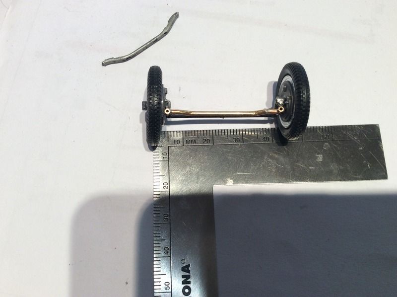

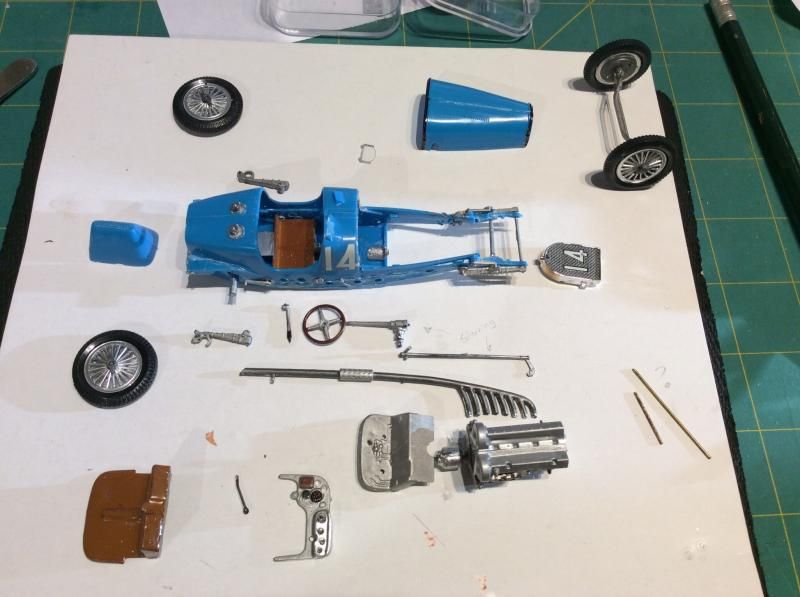

I was playing around today, trying to figure how to make a new front axle for a 1/32 Bugatti type 59 I am rebuilding from an e bay glue bomb.
This is a similar version of the T Series of Bugatti racers
Was reading and watching videos about soldering (and brazing) and bought some silver solder today and gave it a whirl
Plastic vs brass axle
Test fit between the wheel...not too bad
If anyone has any soldering tips fire away, I am all ears

I had CA glued the three tube bits for the axle with telescoping pins...worked ok, but huge joints and not too strong. That is when I went into the silver solder

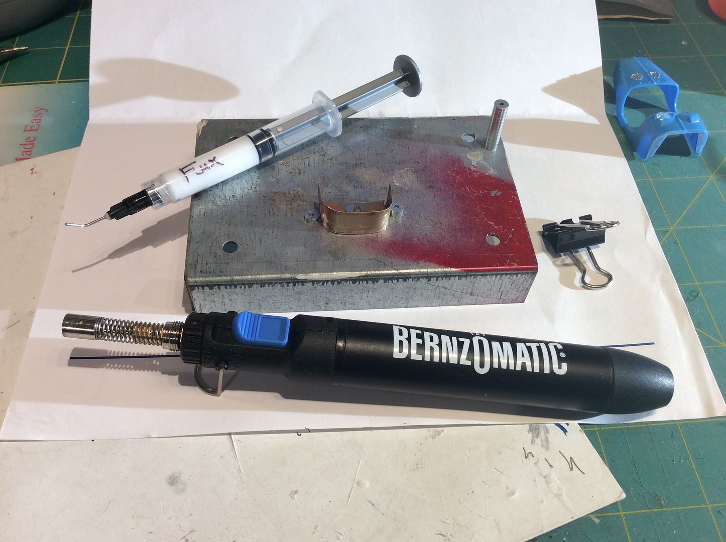

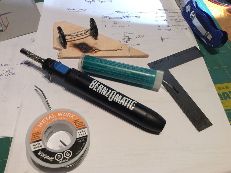

Some things I did different from electrical soldering
*Used silver solder that increases the silver content in the solder and the strength
*cut the solder into tiny little chips and apply them to the joint where the flux is
* Used thick flux that holds the solder bits around the joint location....so when the metal is heated, poof, the solder just wicks right into the joint
*used a butane torch to get the heat there fast, then off fast
The silver solder sets really hard as well, you can feel the difference from the weak tin stuff. You can finish a silver solder joint right away when cool enough to handle

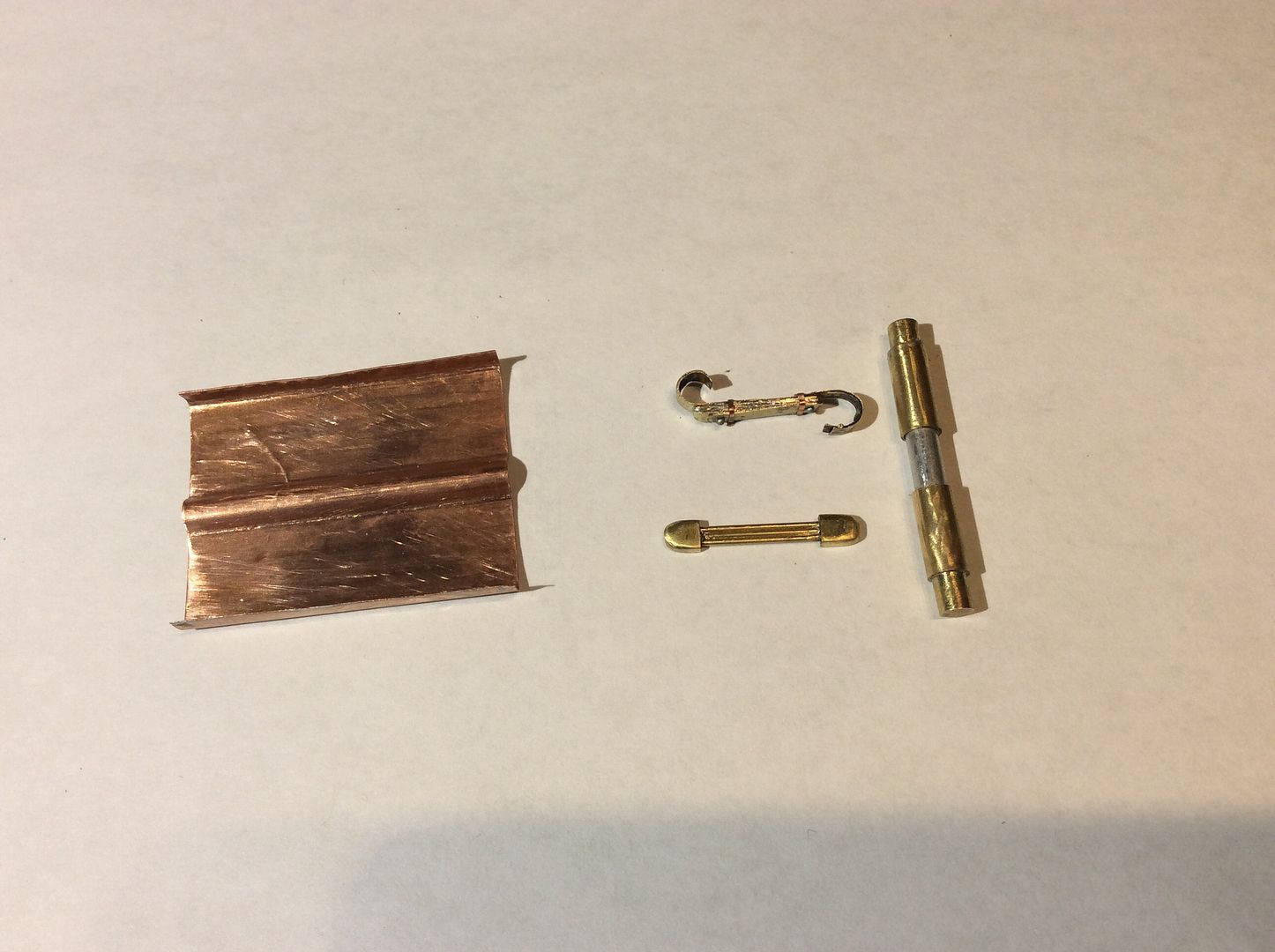

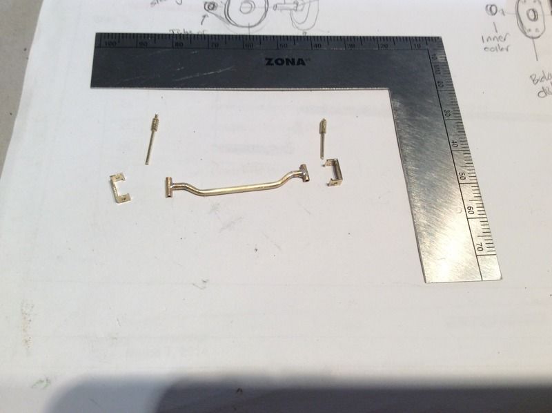

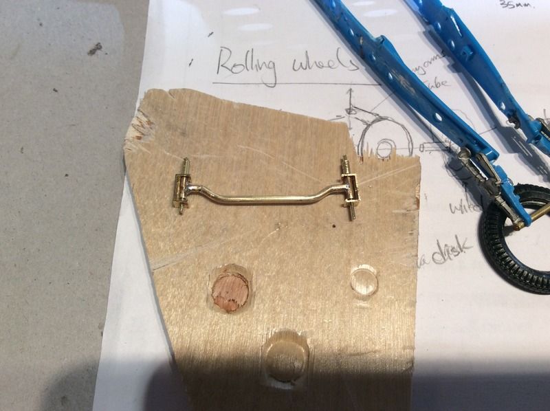

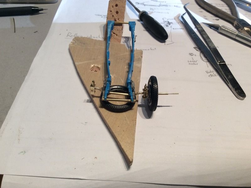

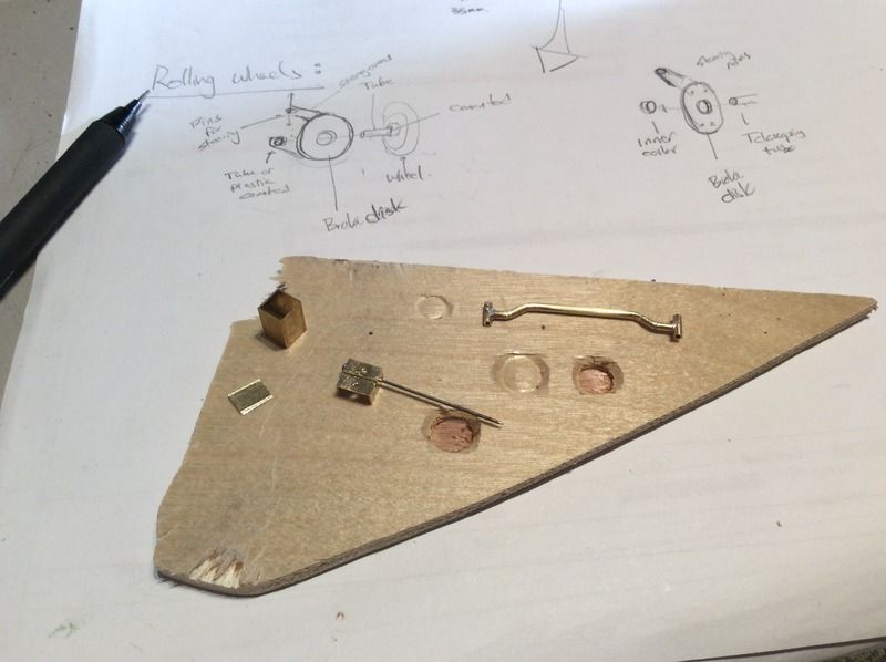

Continuing with the front axle fabrication:
Square brass stock to make two c-shaped linkages for steering and wheel rotation
I drilled the required six small holes before I split the stock into two
Some test assembly with pins
And a mock up with the frame and tire
Lots more to refine and file, but rolling and steering will work now
Next step is to solder a tube to each 'C' arm to accept a wheel

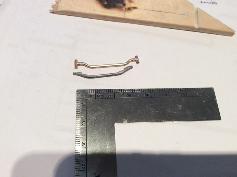

Posts: 18019
Re: Anyone doing brass and silver solder??

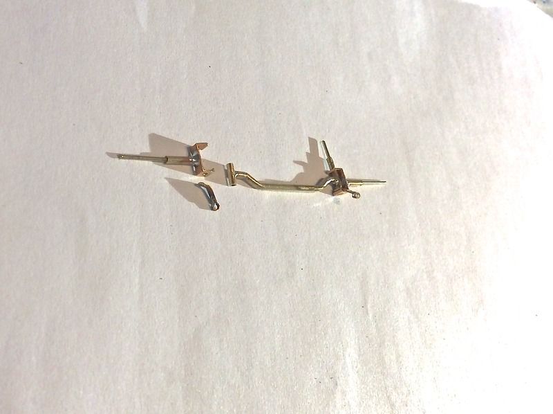

Lots of fun soldering the brass rounds onto their supports for the tie rod

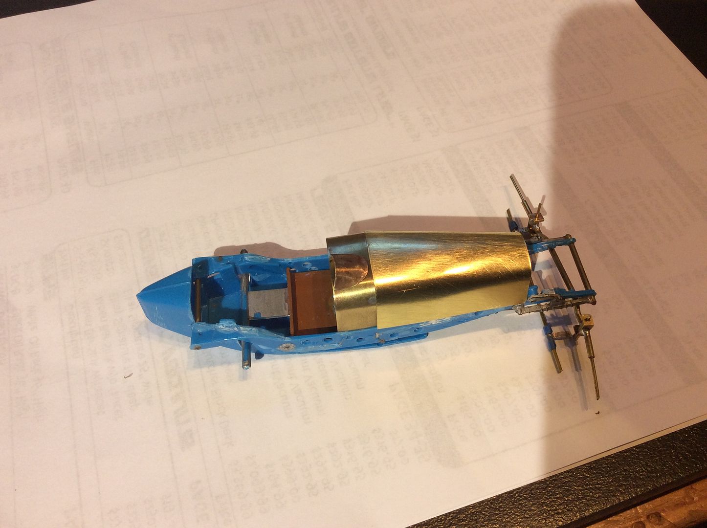

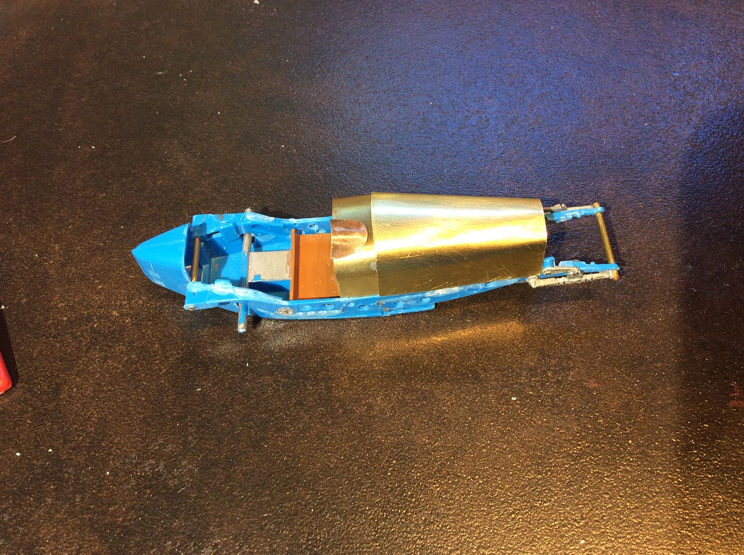

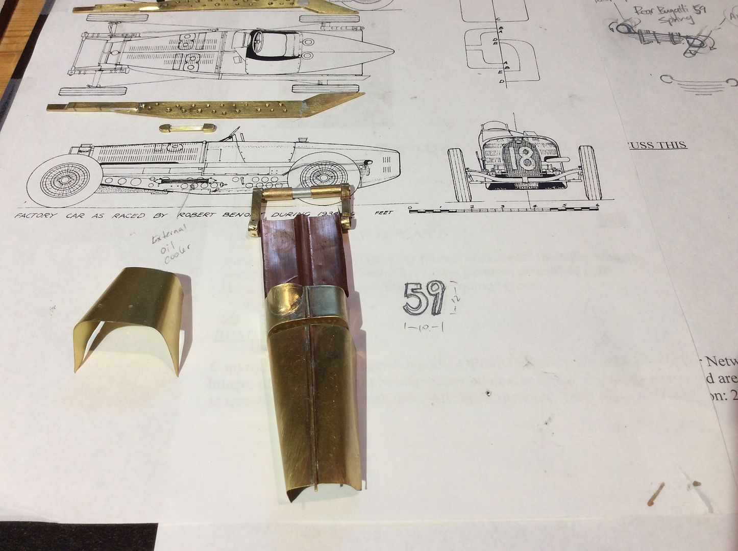

Posts: 18019

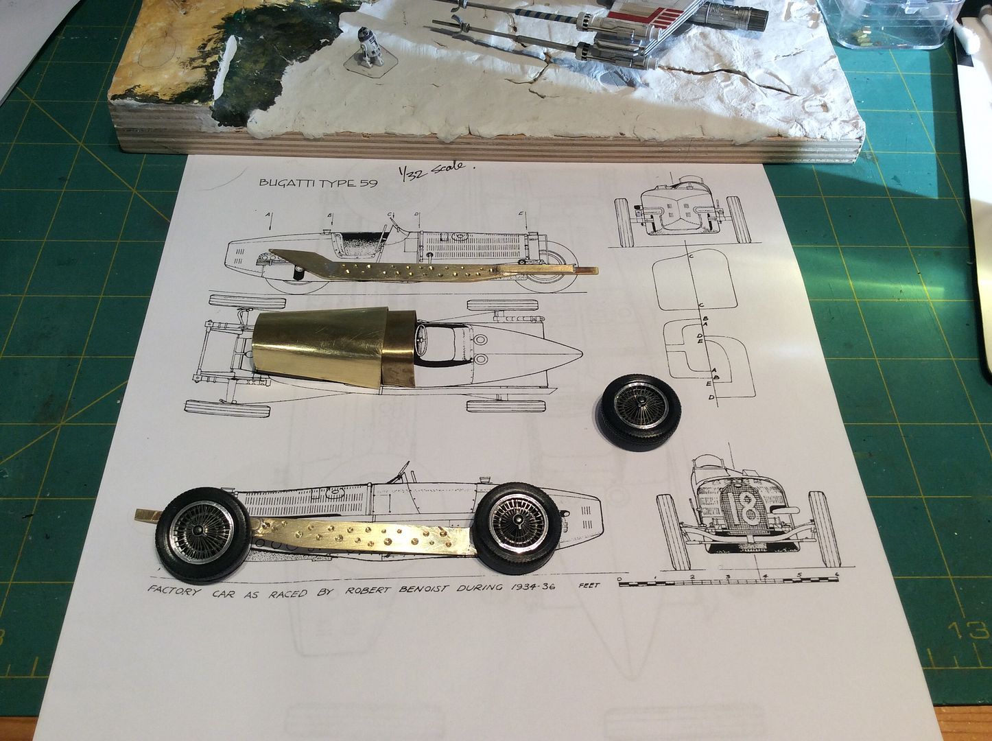

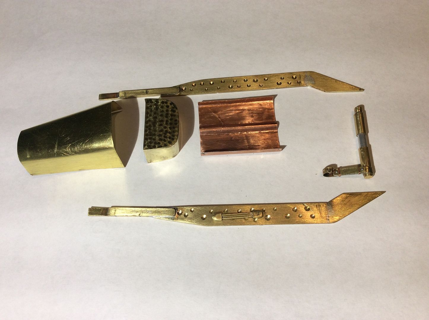

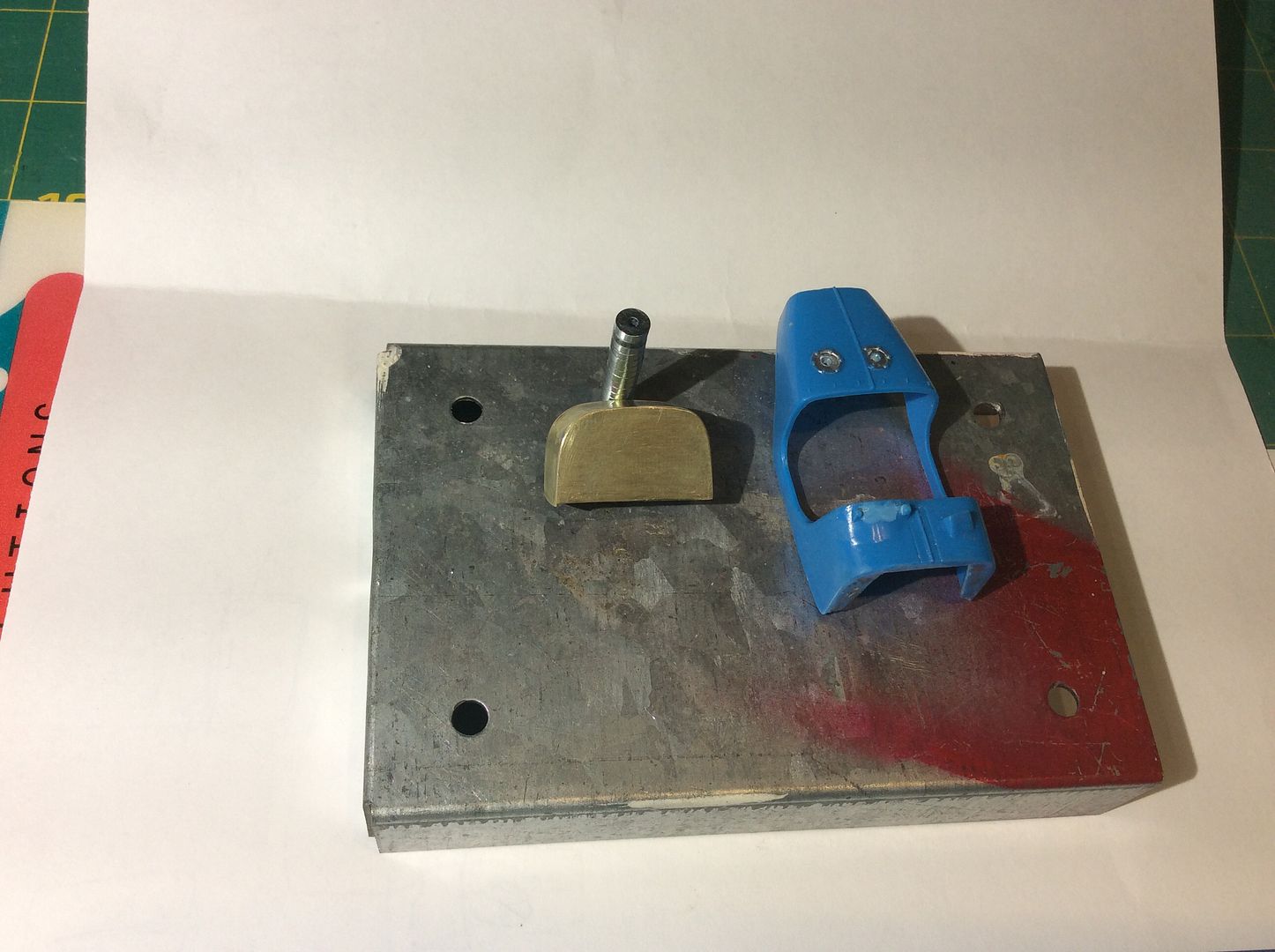

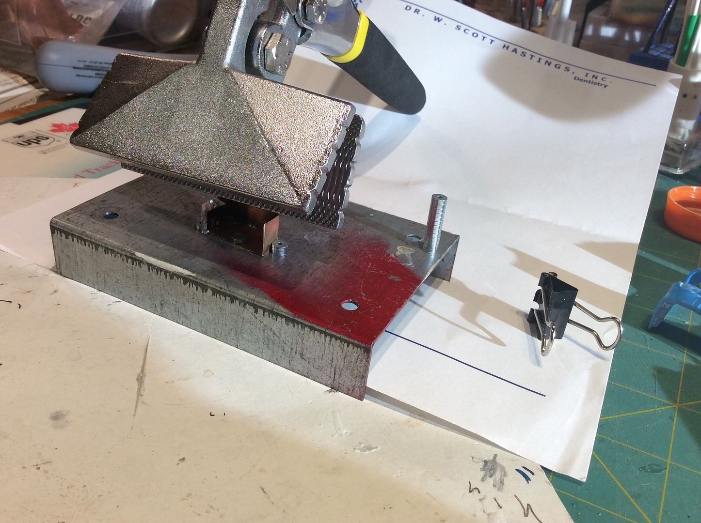

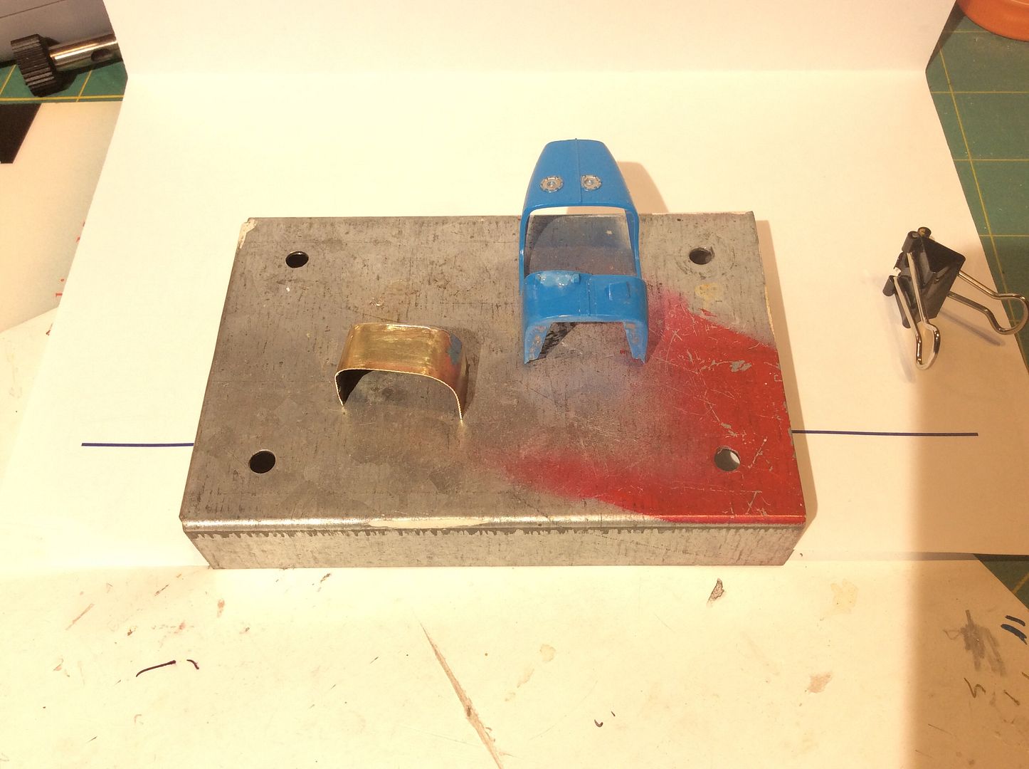

This was my "Friday after a stressful workday before dinner is ready blowing off steam" project
Formed a piece of brass to create the cowling shape for the front of the Bugatti's cockpit. See brass section vs the blue body
Then silver soldered brass cowling to a flat sheet of brass to create a firewall.
I failed miserably at this a couple weeks ago, so took another run at it
Flux applied with a syringe so it is more accurate
This is the cowling sitting on the flat piece held in place by magnets and a heavy bending tool...so nothing's moving
Torch flame goes in that front opening where flux and solder await along the perfect joint formed by this jig
Cowling and firewall semi polished and shaped
I don't know if I am making a whole brass Bugatti or not yet....just practicing soldering with the purpose of making parts for something at this point that may or may not later be assembled together to form a sort of carish vehicle looking object somewhat resembling a T59 Bugatti :think:
That is practice with a purpose rather than random shapes just soldered together :geek:

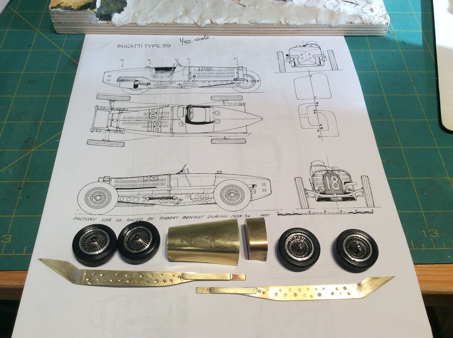

Posts: 18019
Fooling around with bending more body parts. Finger bending the hood....made a paper form and then cut brass with shears. Lots more refinement to go for a good fit. That is my 'new' tile base to work on
Nothing is soldered in place, just dry fit testing to try and get gaps closed...it isn't easy to do that!!!
Posts: 18019

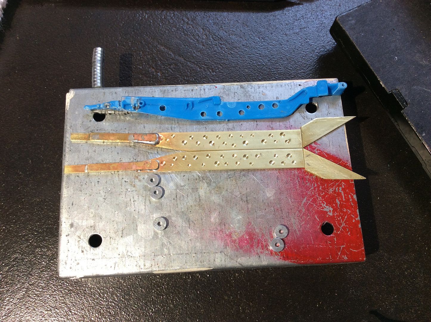

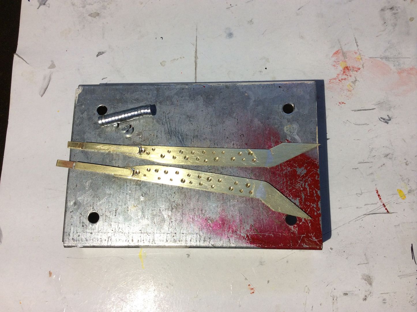

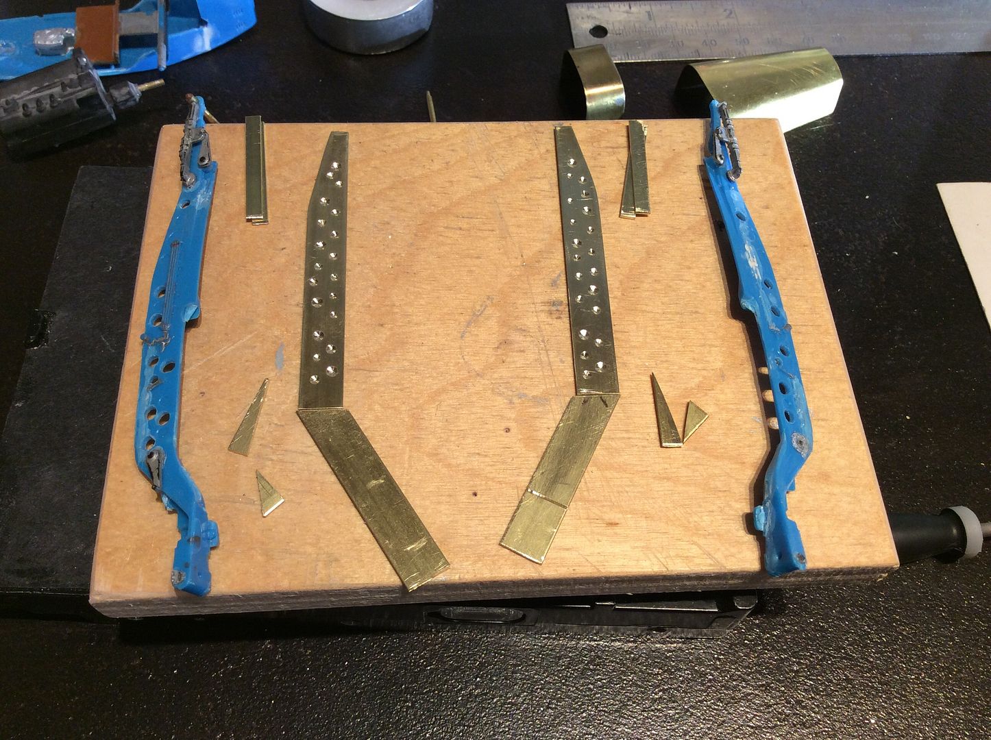

Frame rails cut and laid out
Soldered front extensions
Soldered rear extensions
Tajfl
Posts: 142
Joined: Fri Apr 17, 2015 7:37 pm
Location: Slovenia
Slovenia
Post by Tajfl »
Nice :)
From front axle, to maybe whole brass model ;)
Posts: 18019
Tajfl wrote:Nice :)
Yes, I am a complete idiot :wall:

Working off some plans now
More parts. Floor pan, oil cooler, a rear leaf spring and it's mounting rodImage

This is a little sideline pet project and I am actually getting better at soldering, which is what this project is all about
The real issue is setting parts up squarely with tight joints and stable enough to solder..that is the time killer :wall:
Also lots of time researching parts and their design and trying to duplicate those. Blueprints are hard to find.
I am happy with the rear spring"s soldering, but not its appearance or function...so will make a few more
It is kinda cool to make your own parts
rubegoldberg
Posts: 523
Re: Learning brass construction with silver solder
Post by rubegoldberg »
a small version of machinists square blocks might help. nomsayin'?
Posts: 18019
Absolutely...pricey, but absolutely. Magnets work wonders as well

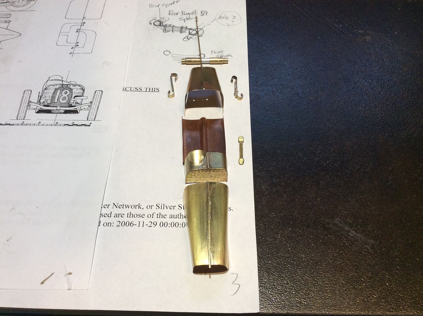

Some more body parts made today
Midline seam re-created with brass tube, made other rear spring and got the windscreen cowling soldered to its location.
The midline has been located properly, just looks off as the panel sides have uneven extra brass beyond their finish lines....ie the sides aren't the same length yet.
I want to get the frame rails soldered together, but have to figure out some complicated maneuvers with a jig to keep them square :scratch::
Been contemplating louvre manufacture as well, will likely be plastic add one as cannot do it predictably by hand
