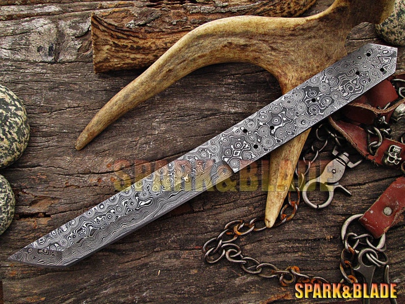

This one is NOT a letter opener.

bfrd wrote: Thu Jan 14, 2021 11:19 pm This one is NOT a letter opener.
Reminds me of the Japanese Tanto.
Very nice. :th: :th: :cheers2:

digger303 wrote: Fri Jan 15, 2021 5:04 am
There is a good reason for that! I didn't do a traditional Japanese handle though. For this one, I just ordered the blade already cut.

Mostly Tanto were used as a stabbing weapon, but as it varied in size a little it could be also used as a short sword in a slashing fashion. Heavier versions were designed as armor piecing.
