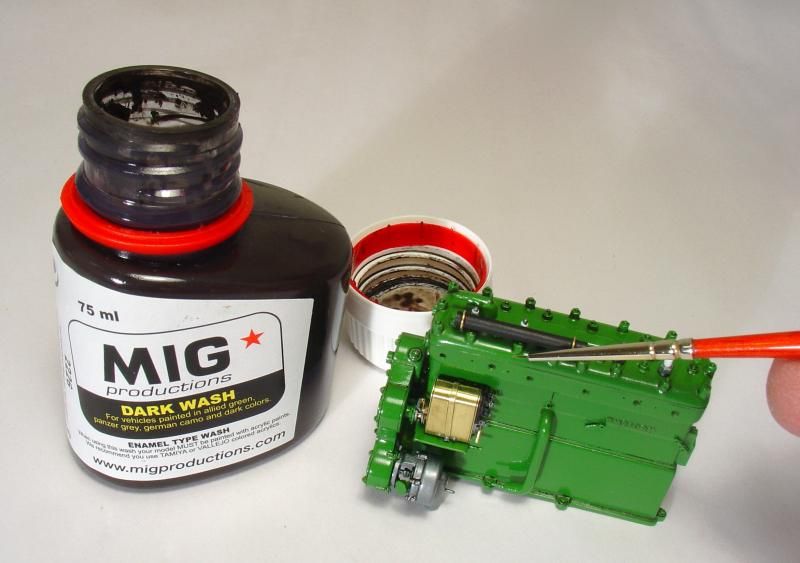

Posts: 18120
Re: Need help with pin washing panels lines
This is a great pre mixed product for engines and such. They have oil and fuel stains as well.
Not my photo btw

Can you do an enamel wash over acrylic? I don't know much about such things.
