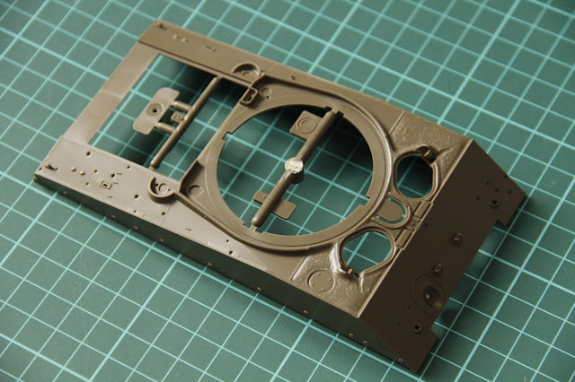

This is the upper hull for 35346

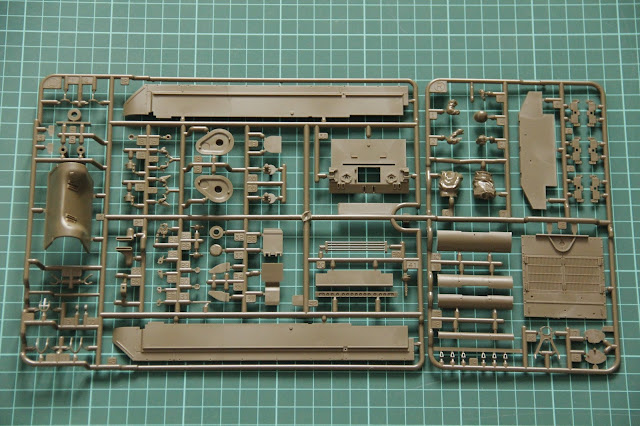

This is the sprue for 35346 containing the side guards, they are the long pieces top and bottom you can see they form the upper inner hull above the tracks and the side guards.
https://3.bp.blogspot.com/-ckLEqKtSfDA/ ... G_8104.JPG
