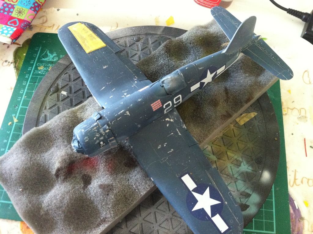

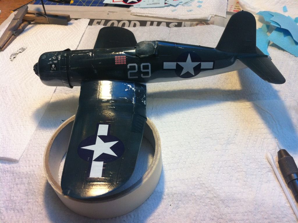

Hi Guys
Update time

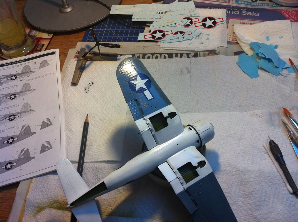

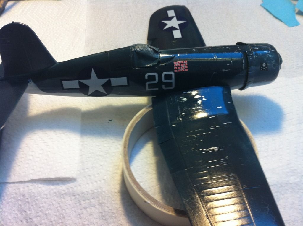

Decals are on so its starting to look good now.
Next up the weathering

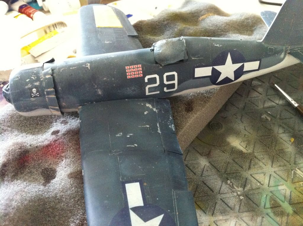

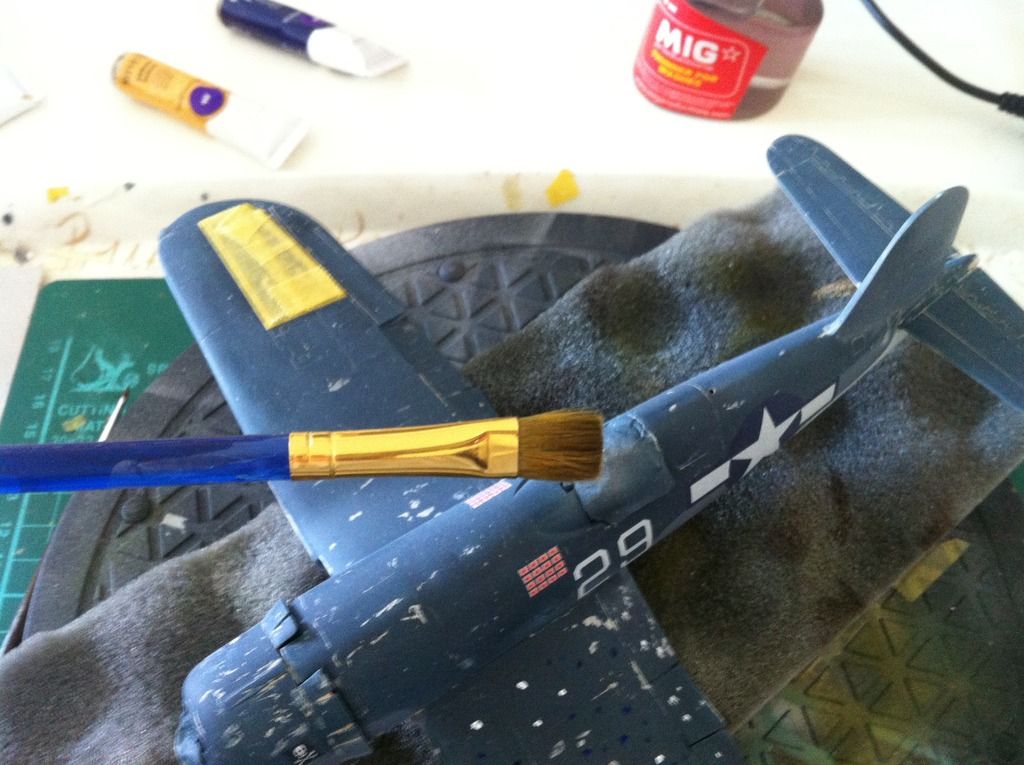

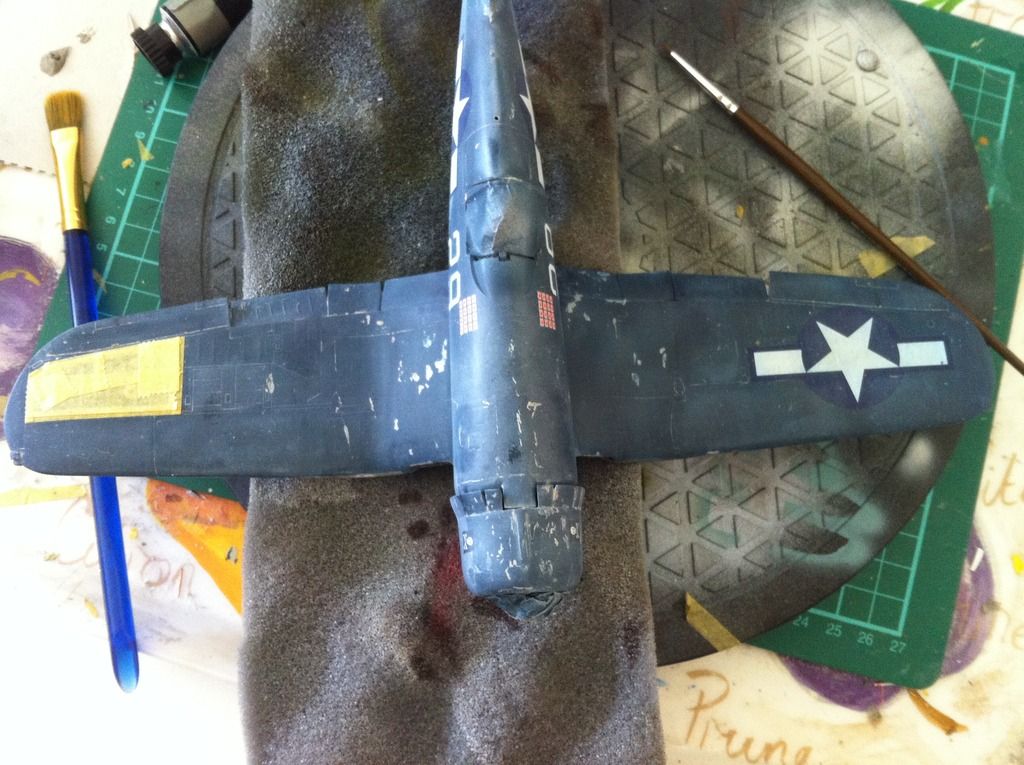

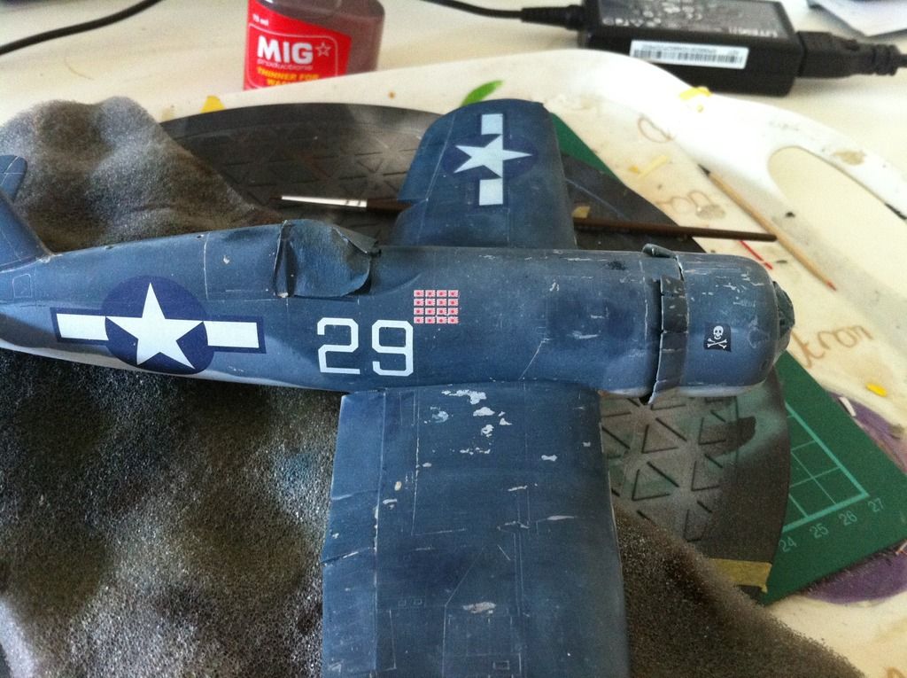

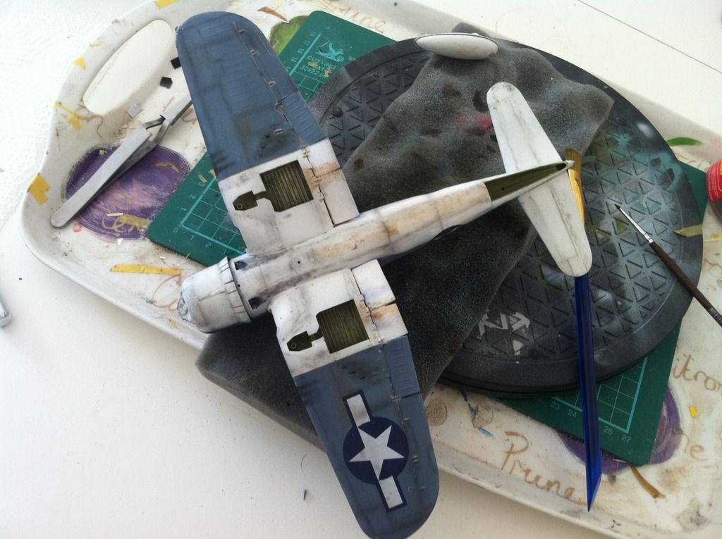

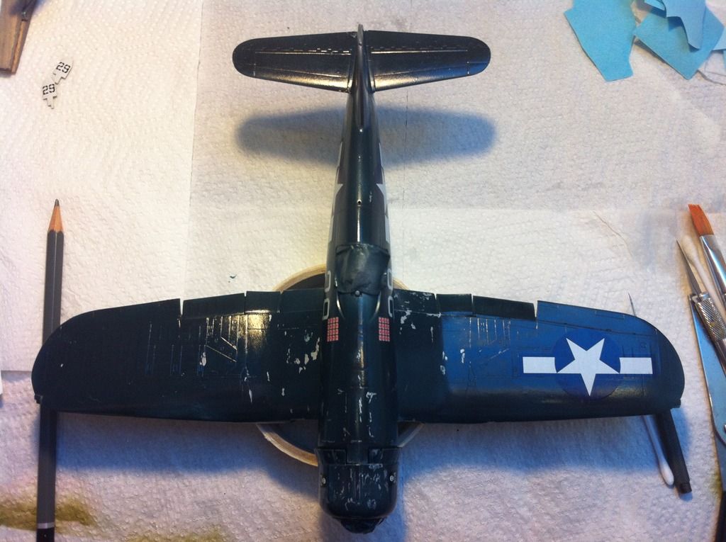

So its on with the weathering of this bird. 1st up is the wash and i'll be using Ultimate light dirt as this aircraft flew from a dusty area of the far east.

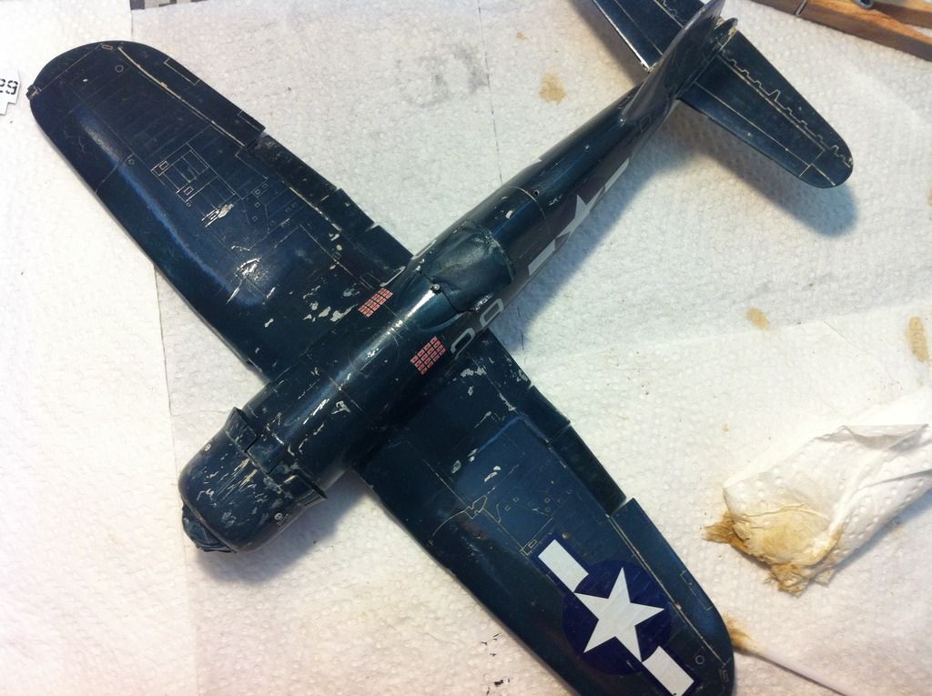

and with it applied just wait for it to dry then wipe off with a damp kitchen paper in the direction of airflow.
There we are

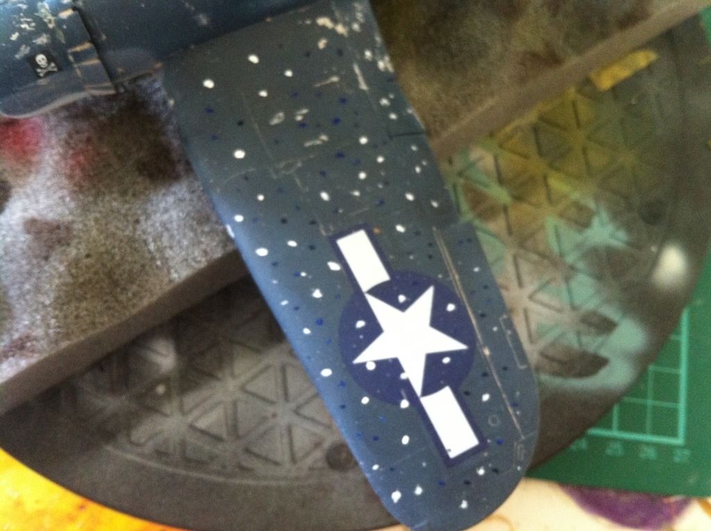

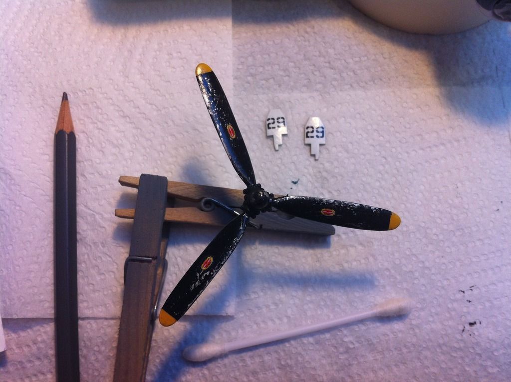

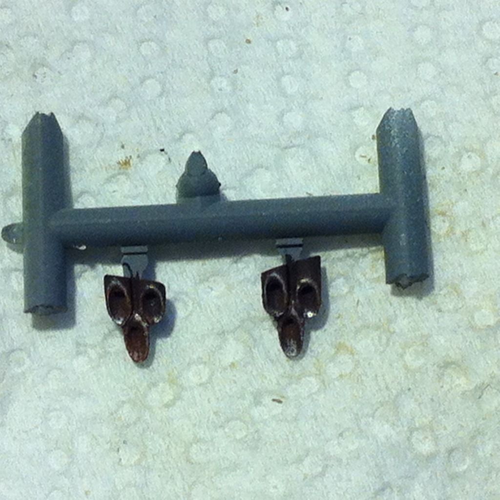

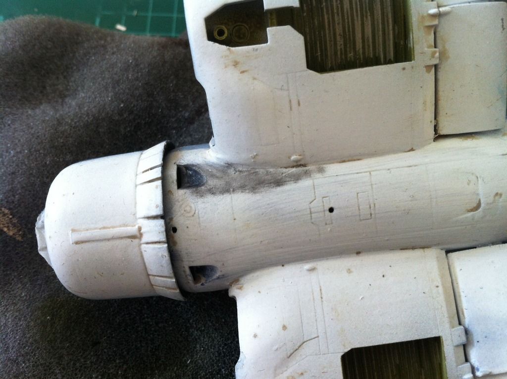

To the exhaust i dry brushed some silver then added some mig rust coloured pigments.

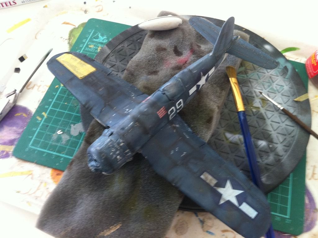

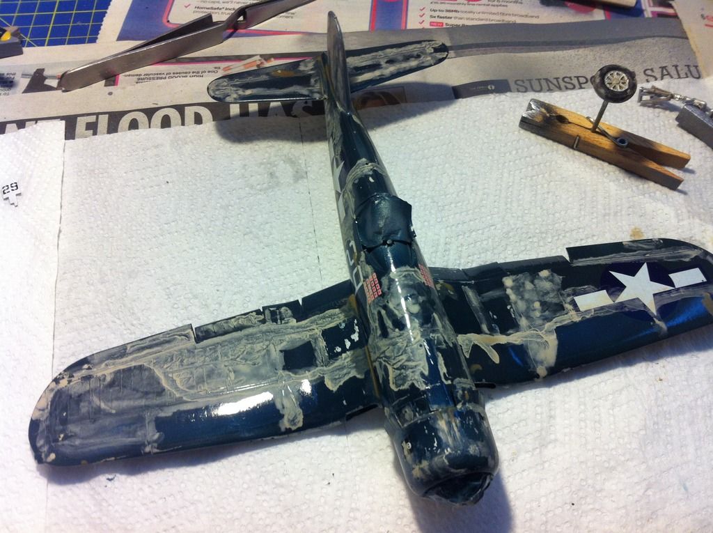

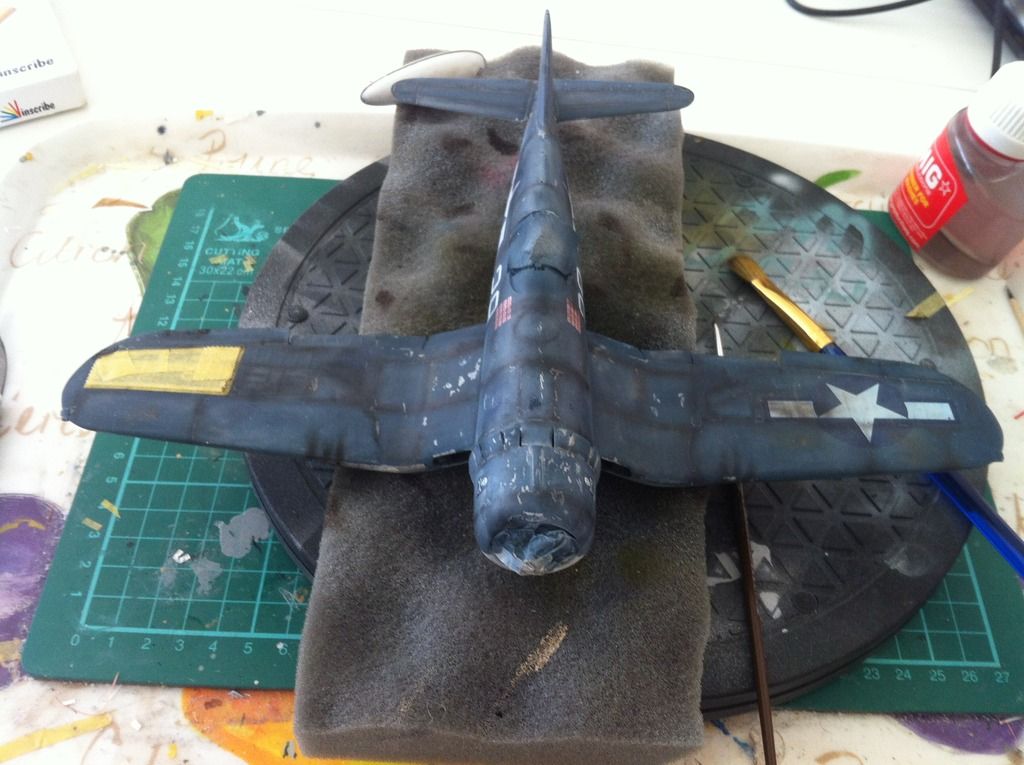

Next up is I'll be using a technique borrowed from the armored guys an oil dot filter? i think its called has you can see i have masked one lot of fabric in the wing to replicate a newer part.

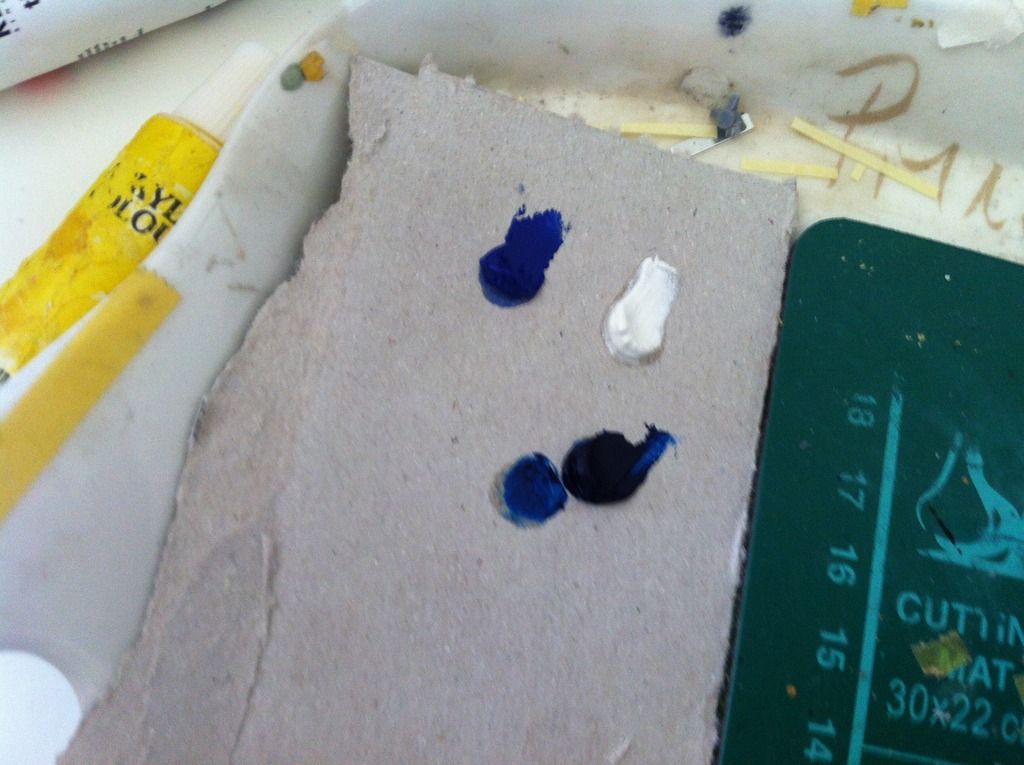

I'll be using these cheap oils
on a bit of card to draw the linseed oil out a bit.
then i just dot it randomly over the flat surfaces.
And with this or white spirit we blend it in with a fairly wide brush.
And hopefully you can see some tonal variation.

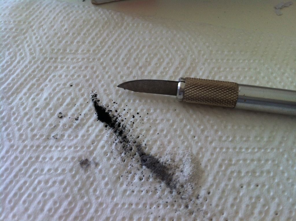

next up are pastels i got these for about a fiver from the works i think.

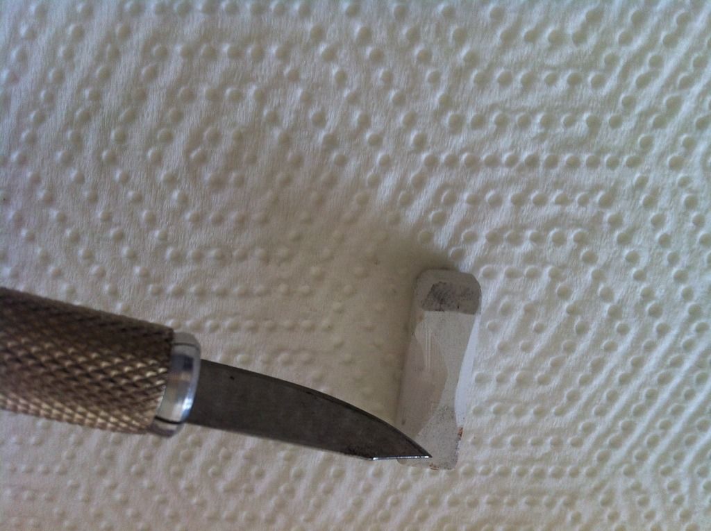

and with the back of a knife i just scrape some of on to some kitchen paper.
and we are left with pastel powder.

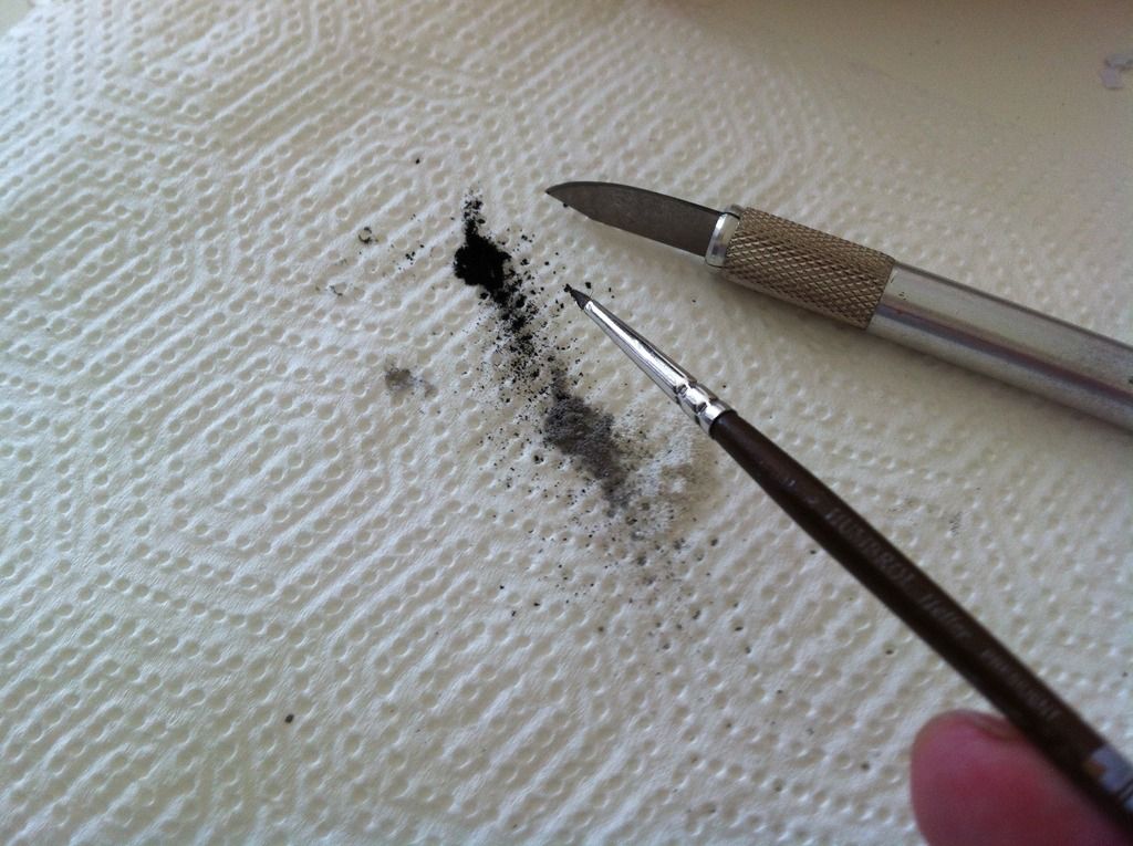

which can be used for exhaust stains using a small brush.
it can also be used to add dirt to panel lines just add it and remove it to tone it down where required.

Top drawer stuff. Did you do the oil filter over a gloss cote? I tried it on my 109 but I couldn't get it right...
No mate it's over a matt coat with a gloss coat it will just run off if you know what I mean.

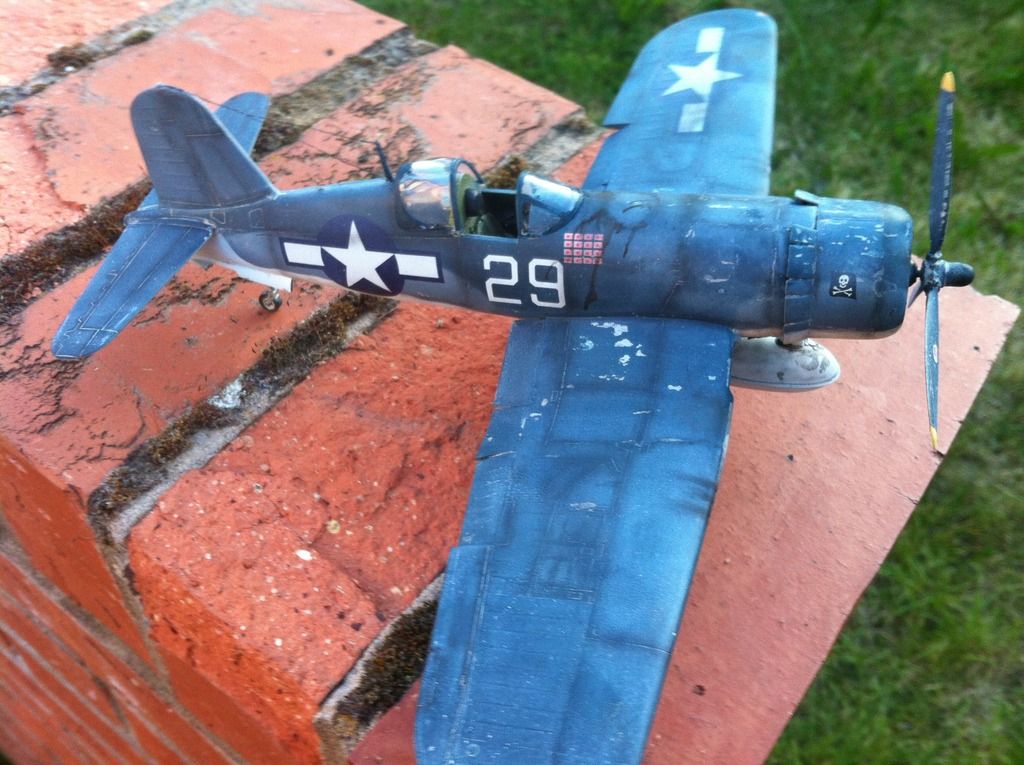

Well she is all finished after adding the undercarriage and all the other dangly bits and here she is.
There will be more photos in the revel section shortly.
And i would like to say thanks you all who followed this build and thanks for all the great comments guys.
