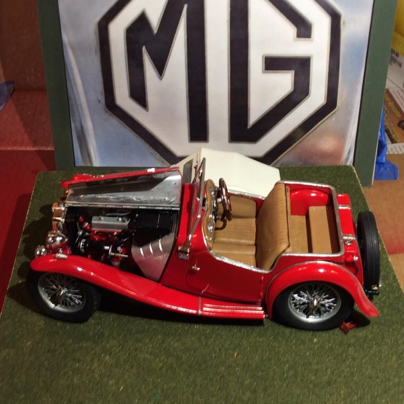

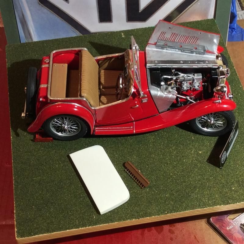

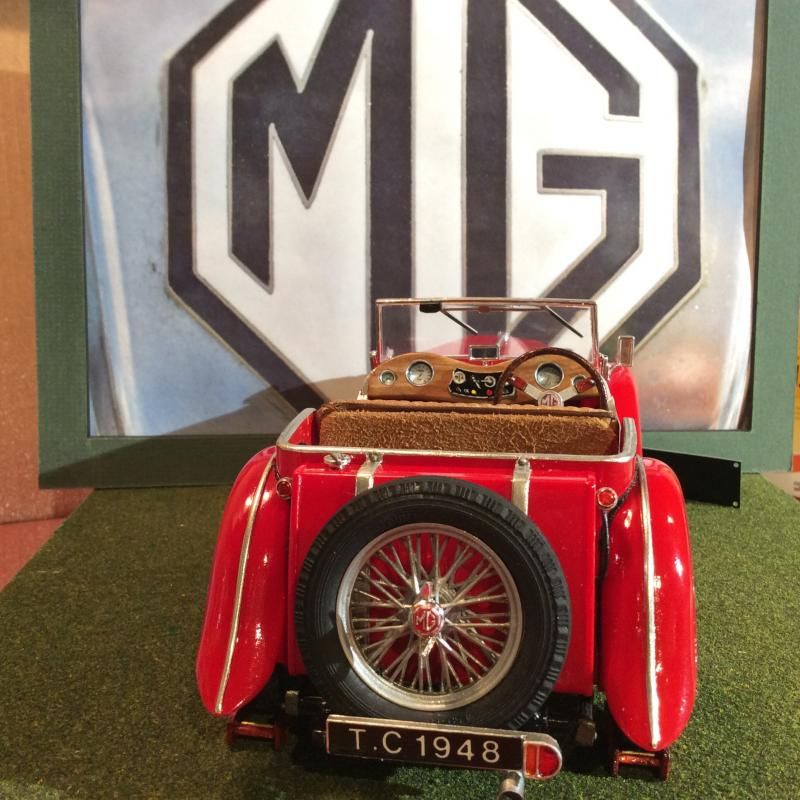

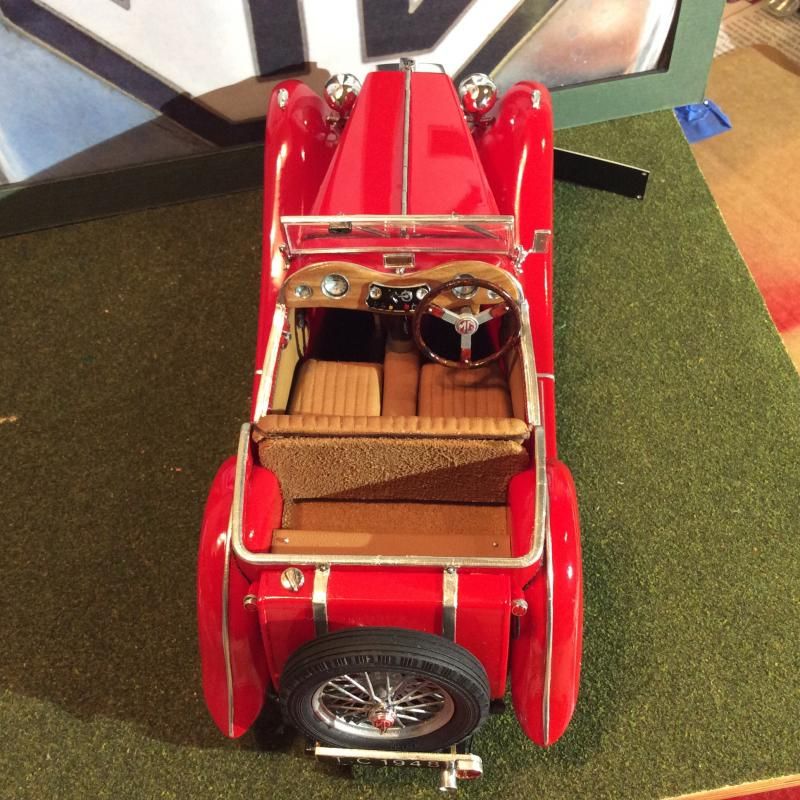

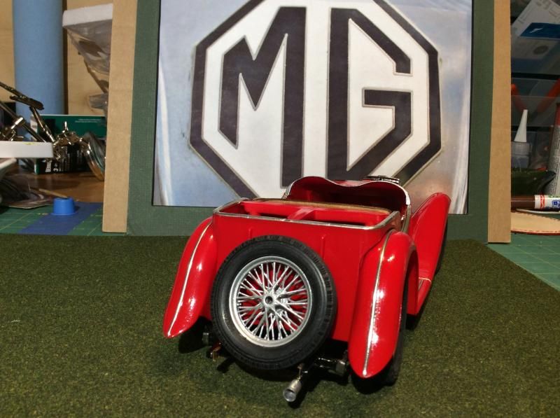

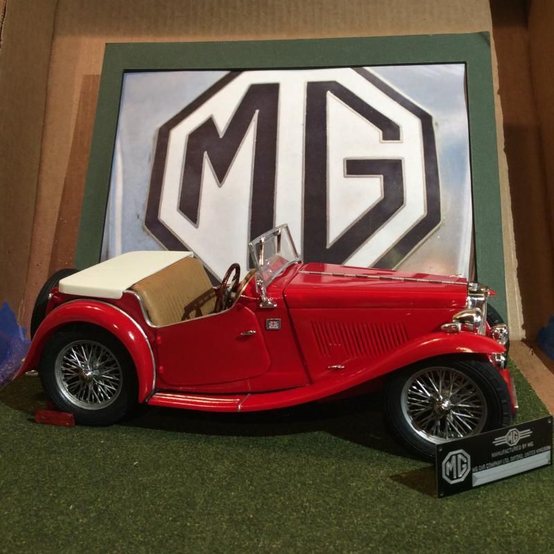

Woah, have not posted much on this build recently
This weekend was trying to get bulk of red paint done and wheels painted
I was fooling around with some glam shots so here are some pics. Everything body wise is still dry fit, rad just plunked there for fun
Still have to clear coat it and struggle with an ill-fitting bonnet, but she is looking pretty good and will finish off nice

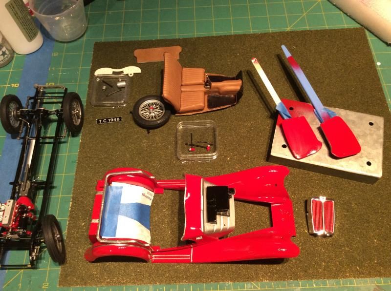

Re: 1948 MG TC long term build

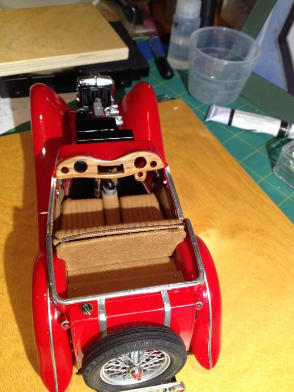

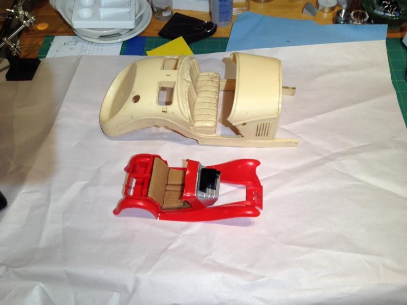

I put the leather and carpet in the back of the cab last night
I am working on getting those bonnets back into shape, removing the CA glue and fixing the hinges up
Have all the body dry fitted still so I can sort out any fit issues along the way
Hopefully more paint this weekend and then clearcoat...soooo sloooow

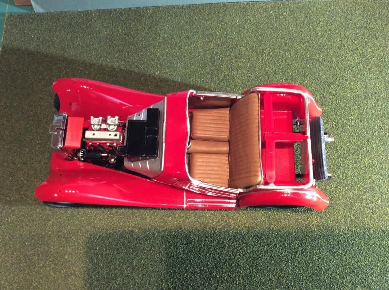

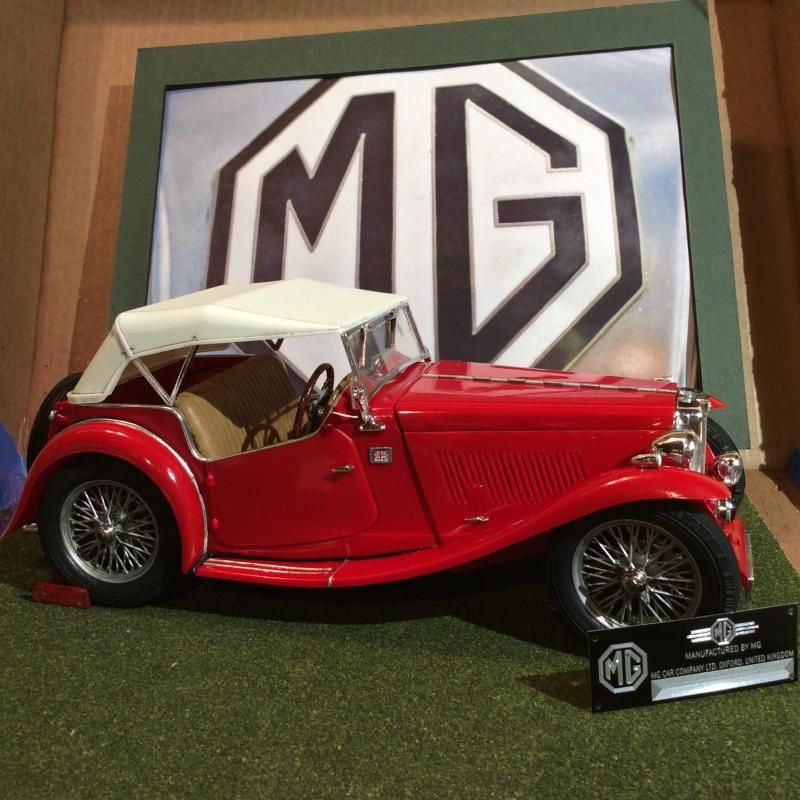

Thanks man, she isn't even cleared or polished yetm0rce wrote:Soooo shiny![]()
Looking good mate!
S.
I went a bit nuts with the BMF (bare metal foil) chrome...just too purty stuff!!

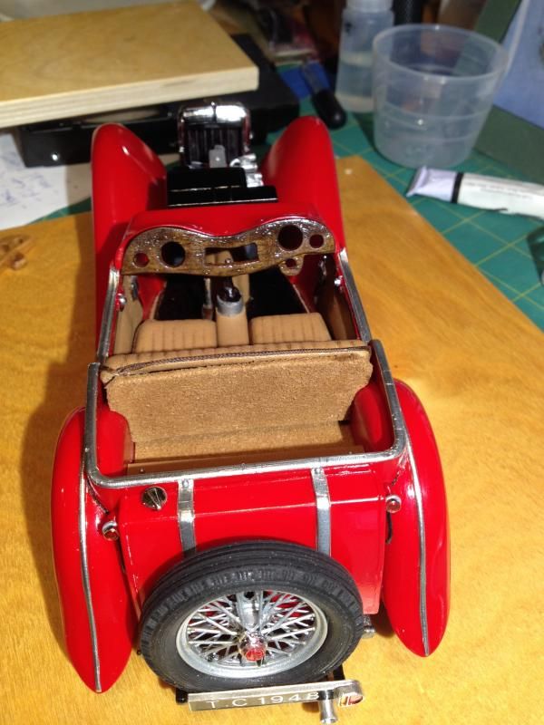

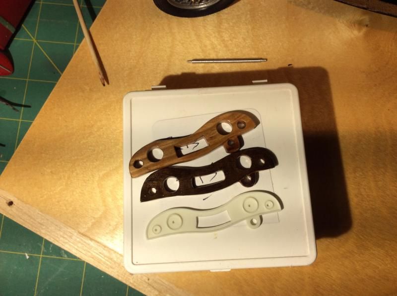

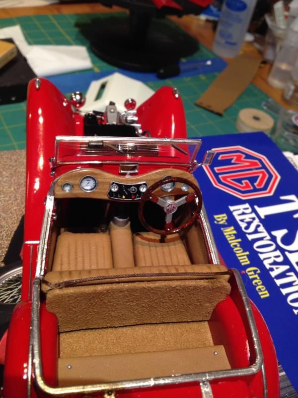

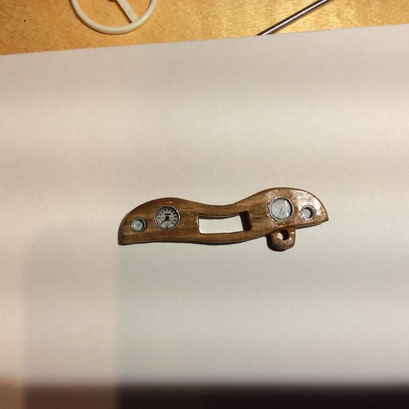

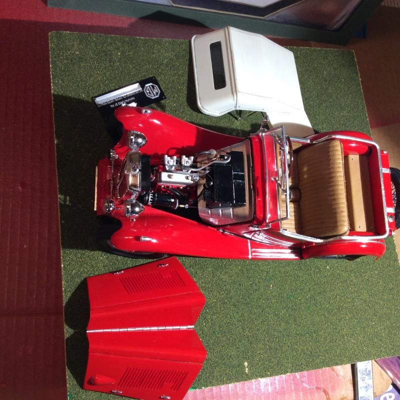

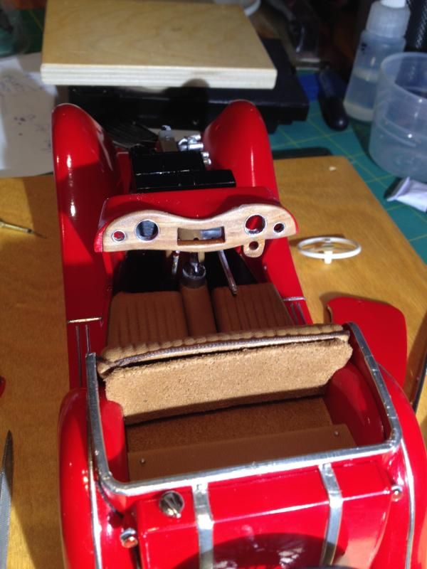

Car is cleared, but not going to rub it out as that ripped off all the clear on my test area
I made two wood dashboards copied from the plastic
Shaped from solid pear
Thin dark veneer over a plywood
This is pear with aluminum bezels
Lots of metal to polish and then add fake glass and the dials

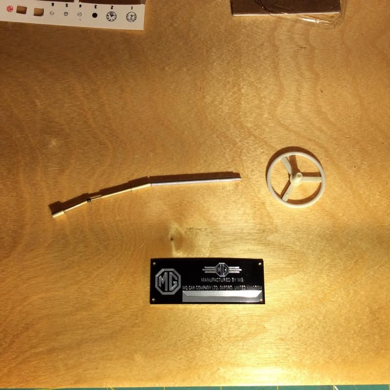

Still,working with the dials, can't quite get the white balance on the computer right to make them the same...need keep plugging at it. You don't want to see the pathetic kit decals for the gauges ...yikes
So what is on the car is cemented

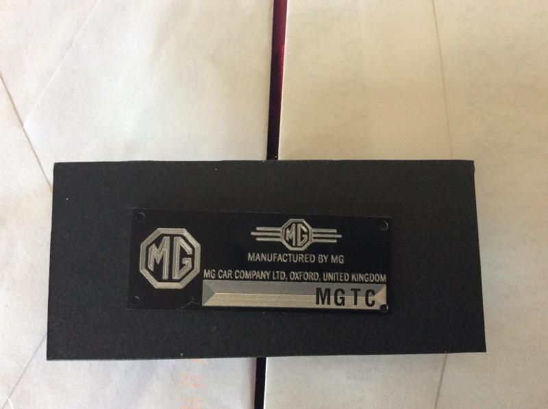

Got a few of these manufacturer plaques off a guy on E Bay for build displays...he combine ships them so got 5 different ones
A weekend's work
A weekend's work

man, this is looking SWEET! i love the use of real materials like the wood in the dash. RESPECT!
btw, since you asked via pm, i think the darker version is the one.

I am at the final corner with this project. Lots of chrome to get on, the steering wheel to finish and the 'bonnet' to paint and fit
So far the chrome is disappointing and I am considering stripping it and Allclad painting....but I want to finish now...it may be bad enough to take it all off and repaint
I painted oil based paints on the steering wheel Thursday night...it takes upwards of five days to dry. So at midnight last night I wiped it all off and did it in acrylic. Just finished clear on the wood wheel and the MG centre logo
The bonnet is too long, so will have to trim. I oven cleaned the piano hinges overnight, polished them up and put bent edges in vice today to straighten.
Painted the bonnet red and had a nice blob of run down the middle....after vowing to do many light sprays
Going to get coffee and spend some time with wife

this thing turned out great! you put in a LOT of hard work, so now enjoy the rewards. damn fine, sir!
- Twokidsnosleep
- General
- Posts: 18087
- Location: BC,Canada
Thank you my friendrubegoldberg wrote:this thing turned out great! you put in a LOT of hard work, so now enjoy the rewards. damn fine, sir!
I also really enjoyed our banter through the build, you were a big help and made it fun

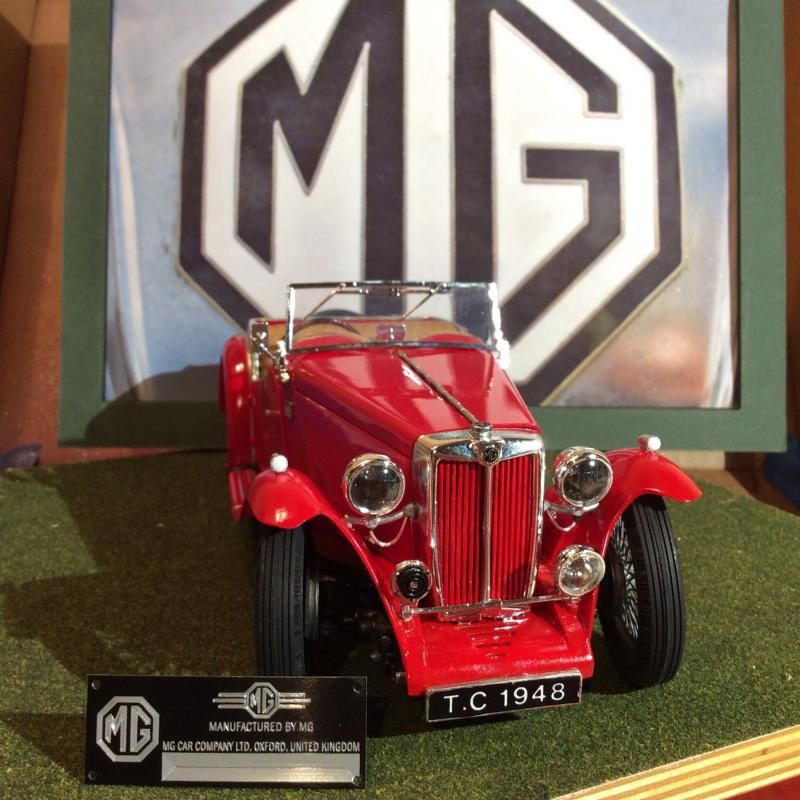

Working on the label now
Using dry transfer decals as it cannot be engraved in the silver box
I have to go get some of the #er transfers; there are a few different fonts and many sizes
Will do a final pic when I finish it
