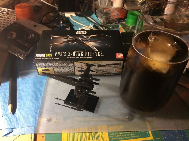

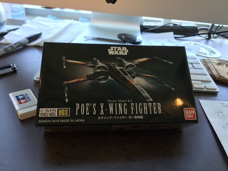

Sooooo #2 build for that bad influence, watch your wallet and wife, Lysus guy's Sci-Fi build sig
This time I have Poe's X -Wing fighter
The diorama plan is the super cool over water scene
It is 1/16Million scale and needs to be assembled with an electron microscope....it was $3 with $3 shipping from Japan
This is a kit designed to show you how old you are and that you need new glasses and contacts....something I am really going to do today on my first holiday day off

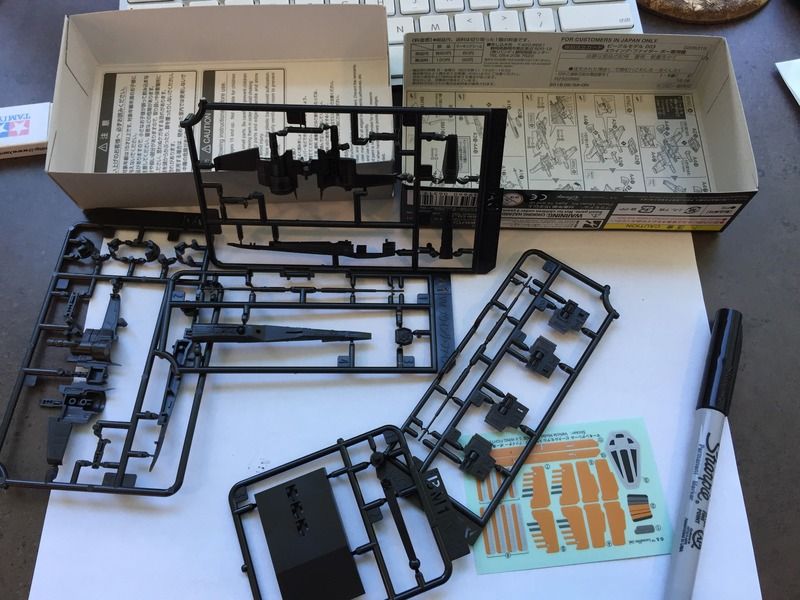

Sprues all from one bag, instructions are printed on the inside lip and you literally need a magnifying glass to read them, really.
Bandai designs these well and they snap together readily..took 15 mins for a simple oob assembly with no paint
Now, under the influence, so to speak, of that dark fizzy drink with spicy rum, I managed to knock this little bugger right to the floor shortly after the photo. I re-assembled everything, but one blasted blaster is MIA, lost to the hardwood floor monster.
I have torn the room apart and can't find it. So I will have to scratch one up.
Time to go get my eyes checked...really

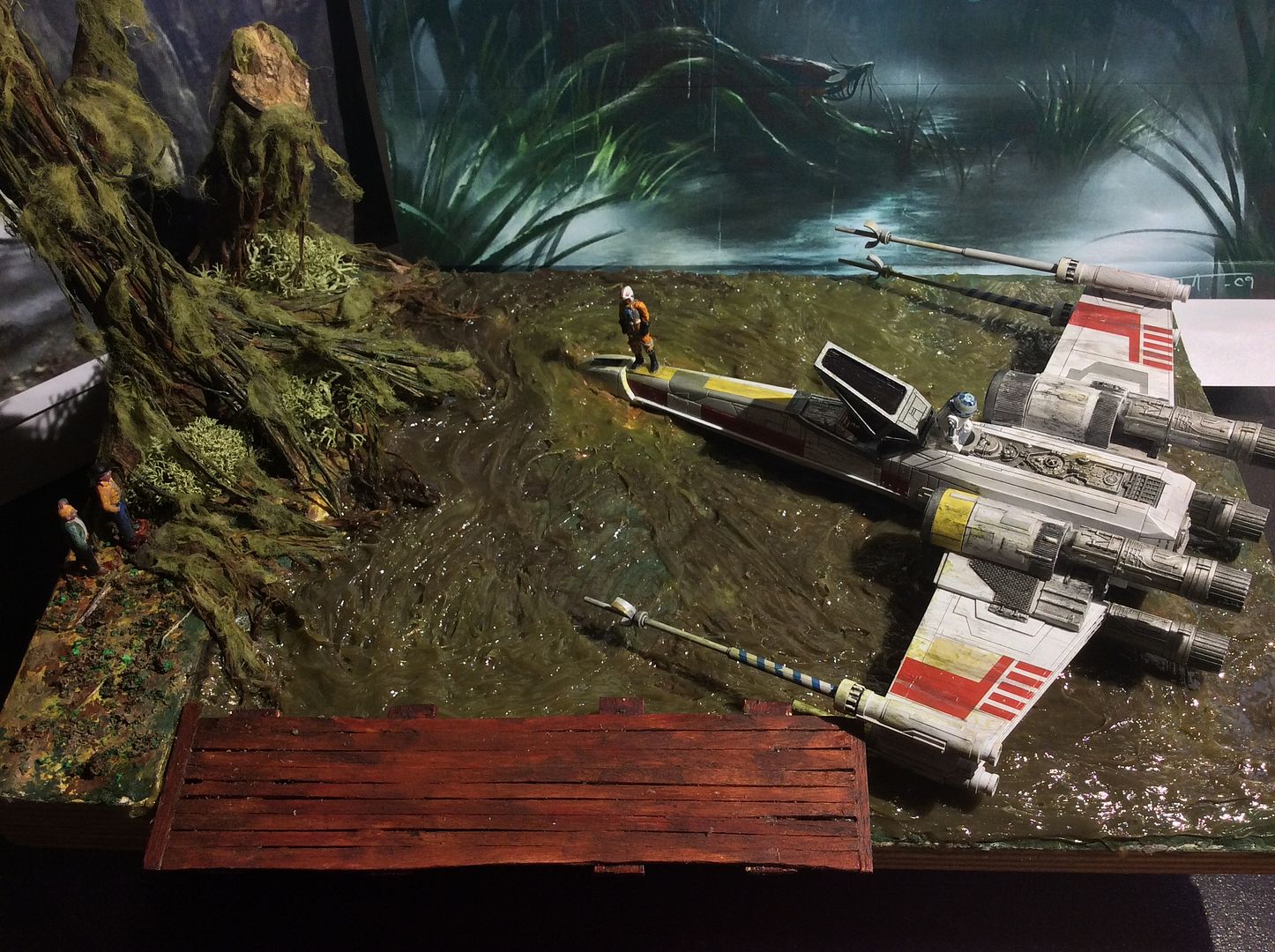

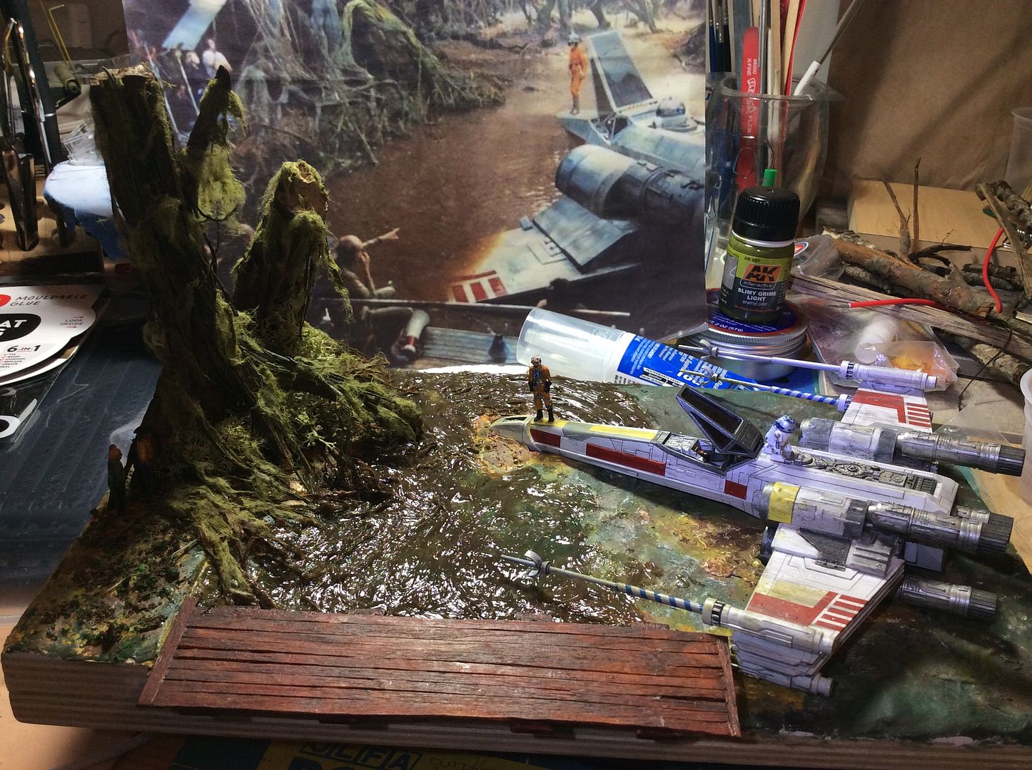

For water, I use the cheapest clear silicone from the home store. If you paint the base your desired colour, then use clear, paintable silicone on top, all you do is swoosh in your surface texture and highlight the spray etc
For Dagobah, I added oil based colours to get a swamp murky look
You can add to and build it up in layers
I did a Hobbit scene with some cleaner water, same silicone but no oils..oops I lied, there are oils in the slimy green rocks
This is all base blue colour and then dry brush white for the surface spray
Coen did some great water effects with a couple of ships he made
Now that I show you all this simplicity, I am sure to muff up this dio :tongue:

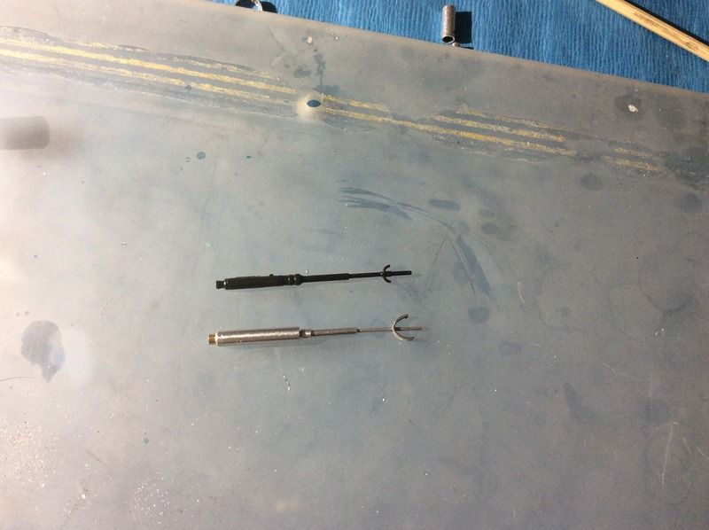

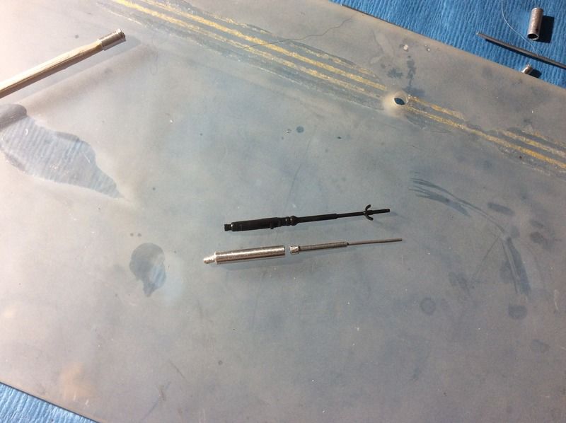

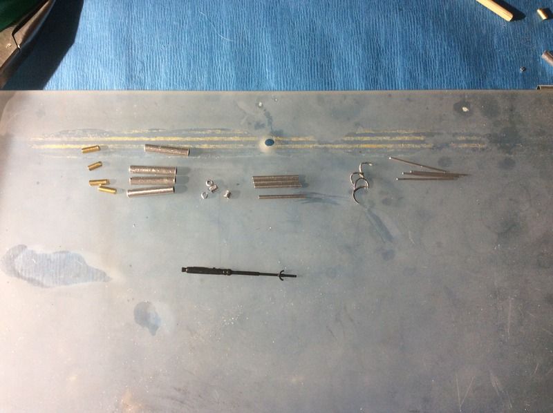

Blinking blasted blaster building
Getting there
Assembly line
Last edited by Twokidsnosleep on Mon Jul 18, 2016 6:12 am, edited 1 time in total.
Posts: 18142
Re: Micro X Wing and diorama

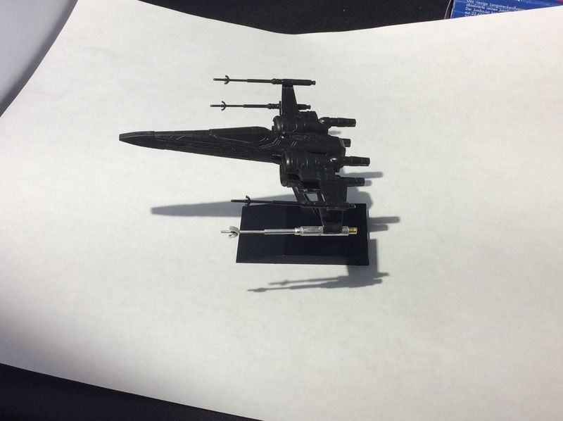

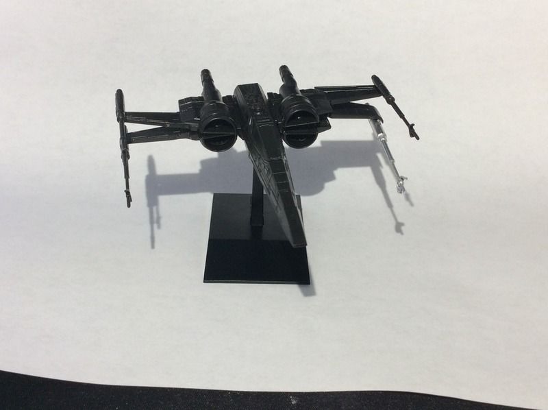

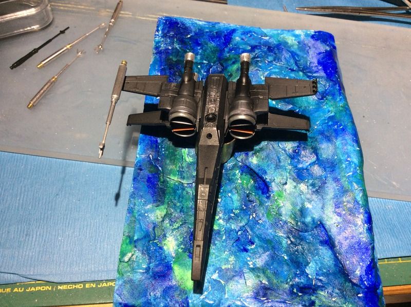

Replacement blaster test fitted on
It isn't much more work to just make four parts when you make one, so,I did and will replace them all
That way they can be more uniform

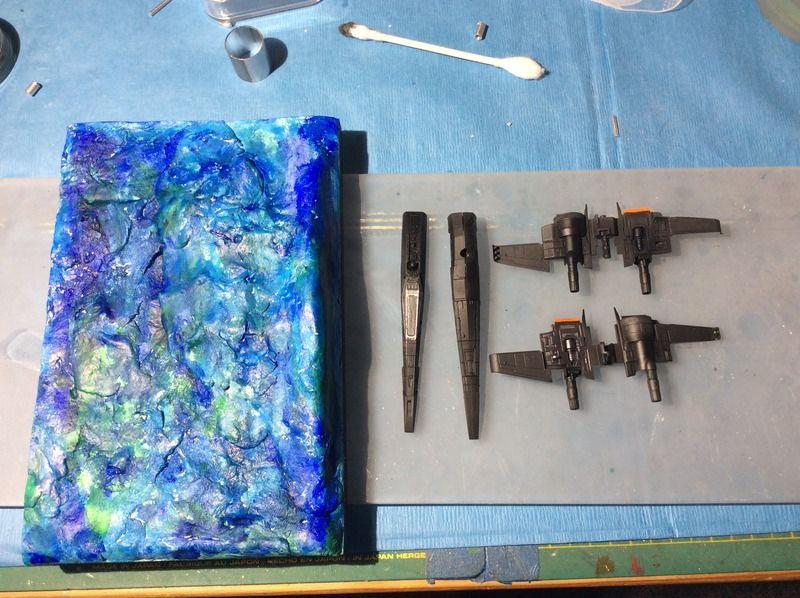

Nice quiet morning by myself painting
Got the X Wing primed Citadel Chaos black and the water's colours with Golden acrylics onto the base
New exhaust ports and one blaster attatched

Thats looking damn good that :thumb1:
Are you going for the rooster tail ?????
How did you make the replacement blasters ???
What do you hear ? Nothing but the rain
Posts: 18142
Re: Micro X Wing Diorama
Absolutely rooster tails. WOO HOO :banana: :banana:
Blasters are just a mishmash of aluminum and brass tubing strategically cut and filed to shape, telescoping and then CA glued together. Check a page back, I have them laid out there before assembly.
If I wanted to get nuts I could have made them all brass and silver soldered, but....nah

I saw the pics and thought you had turned those barrels on a small lathe, they are just the job.

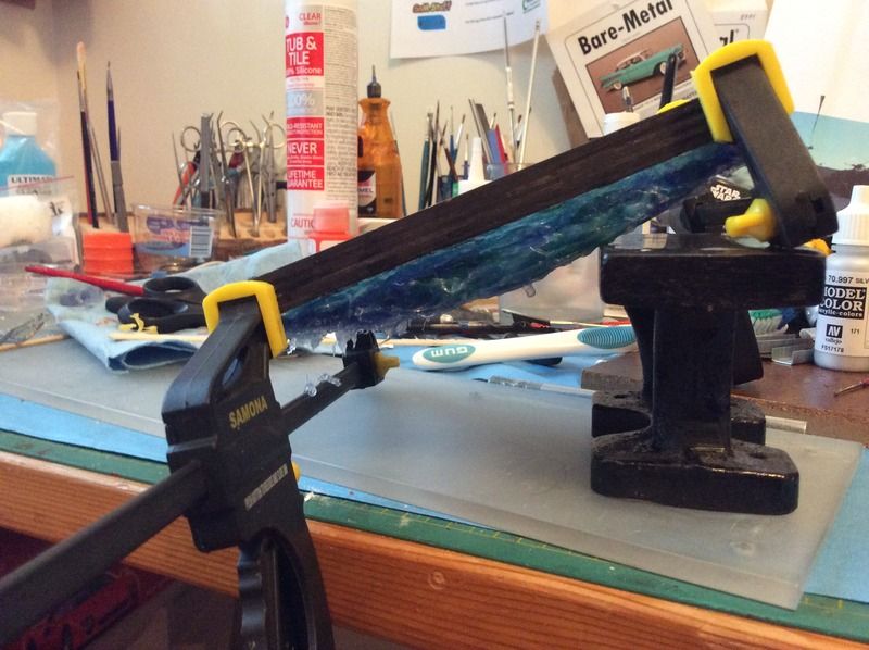

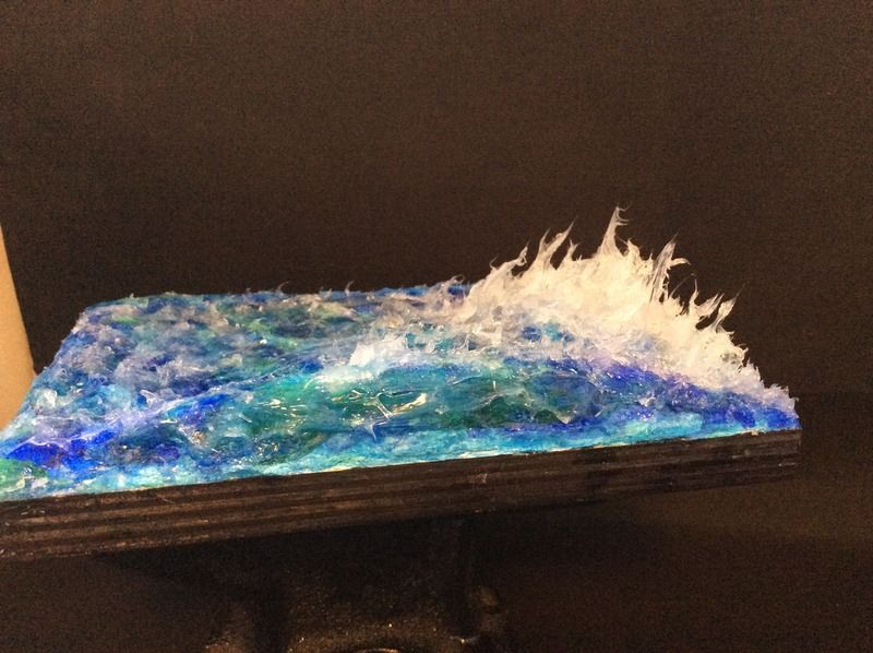

Sneak preview, first layer silicone drying upside down and tilted to let gravity help the effect
Clear GE tub and tile silicone is the stuff in the tube

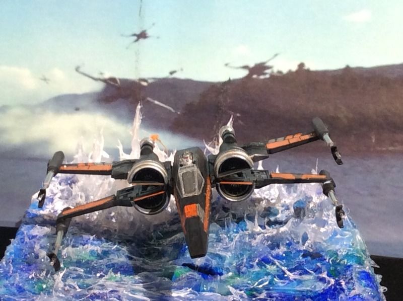

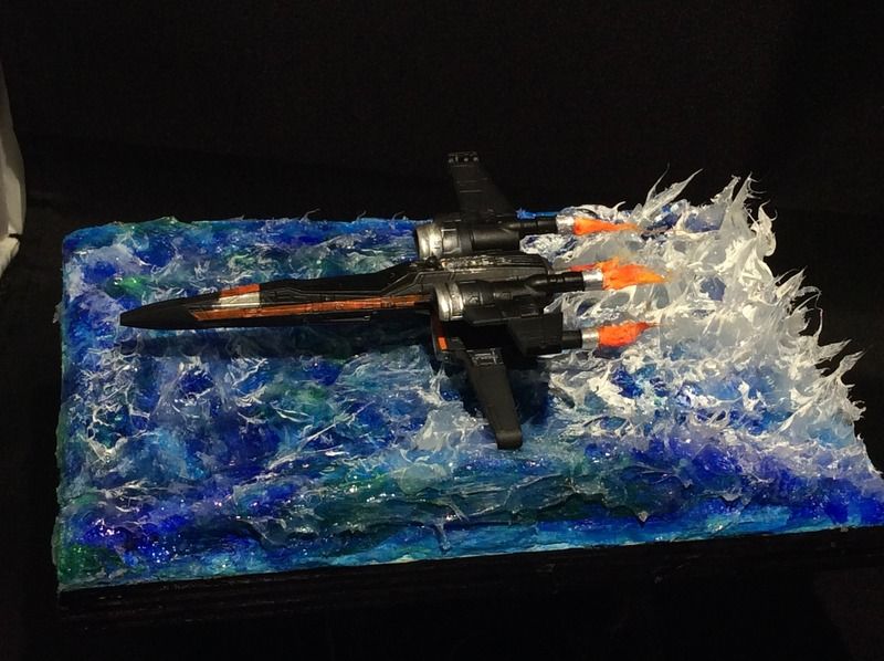

Got on a roll, got left alone and I am just about finished
Rooster tail
X Wing location
Need to let canopy dry a bit, install the blasters and get the wing painting insignias on then final assembly

Calling it done, will put her in the reveal thread

Thanks guys
I kind of got on a roll and just kept tumbling :crazy:
Bit of trouble with detail paint, but the water worked out

Thanks Jase. Thrown together but lots of thought and research while the kit was coming from Japan.
I already had that base made, so it was a natural fit and then WHAMMO it all came flying together :wtf:
Madmattmodels89 wrote::jd: amazing work! You're the waterbender! Not in a million years I could achieve such detail! Great work buddy!!!
Gosh Matt, thanks
Using clear silicone for rough water is as easy as taking a pee. Now smooth water, now that is a different story
You can absolutely do this
