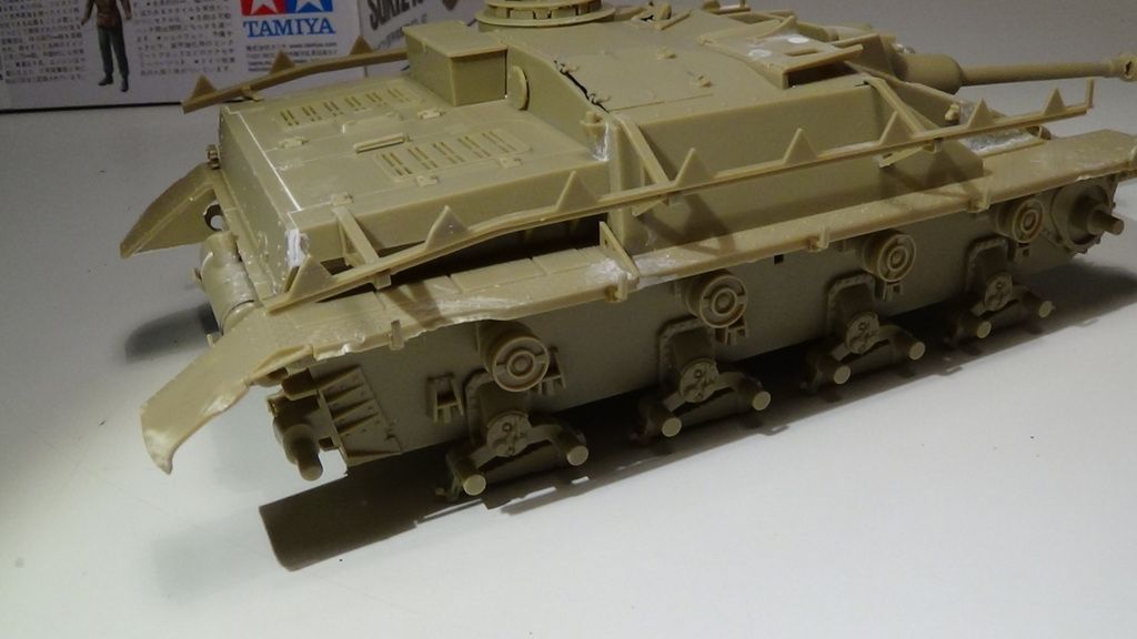

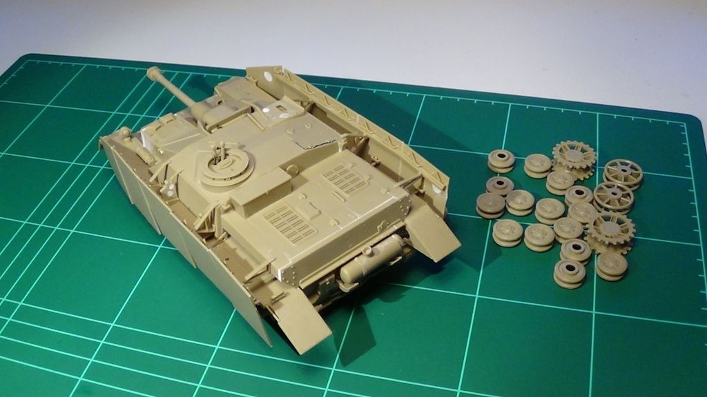

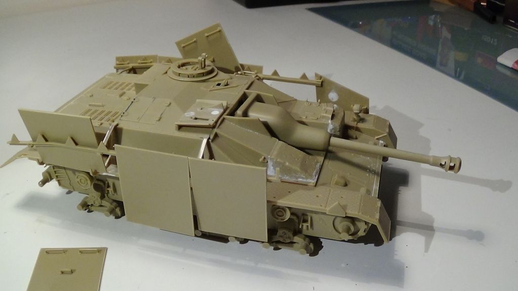

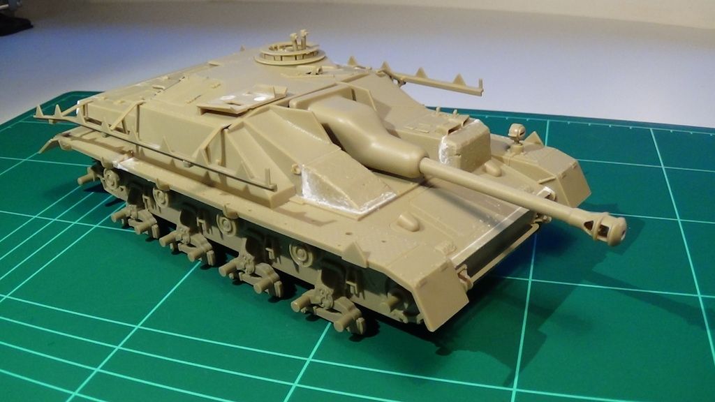

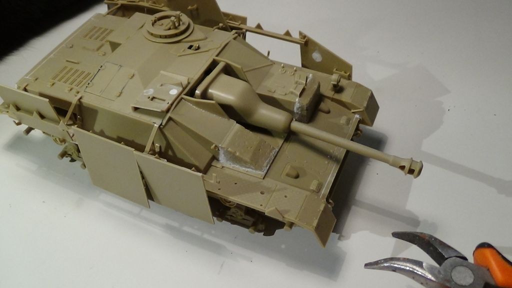

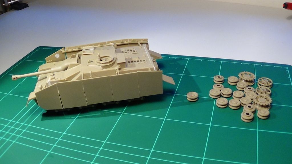

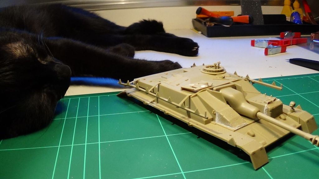

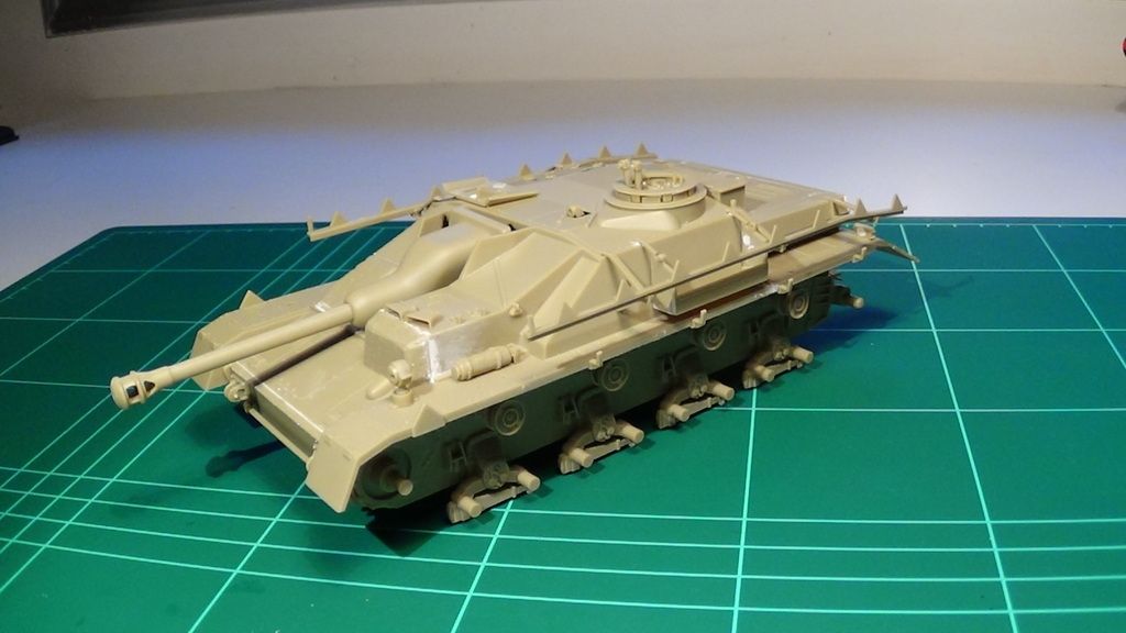

"Stug Life" GB Update 1
[youtube]9g7wNjZtq1s[/youtube]

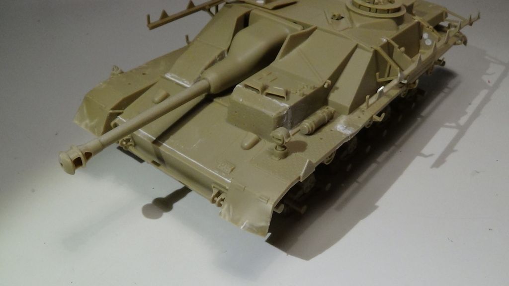

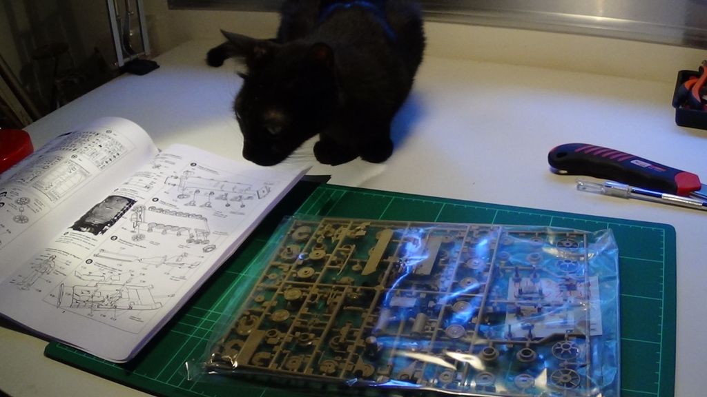

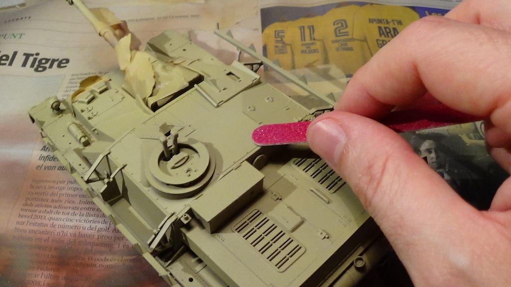

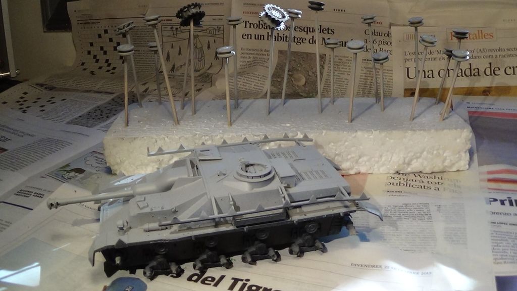

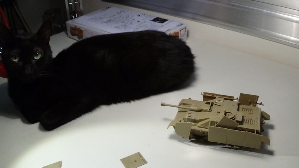

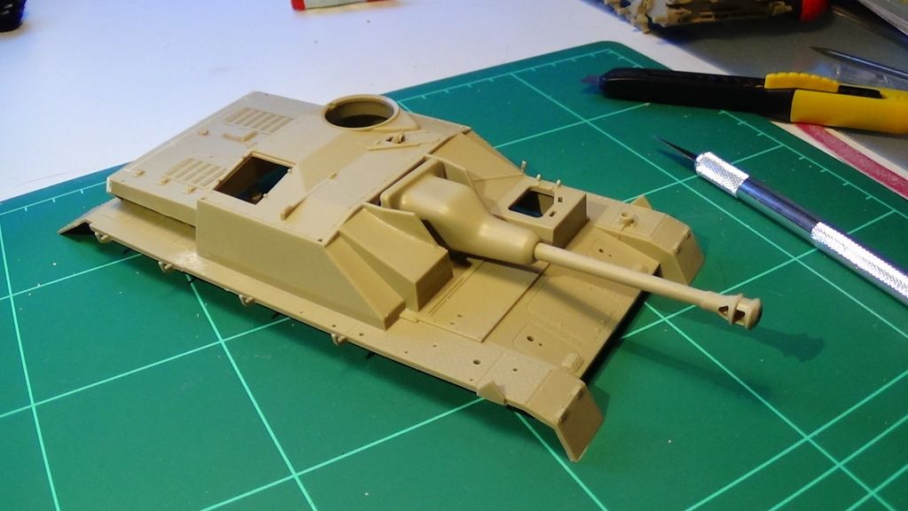

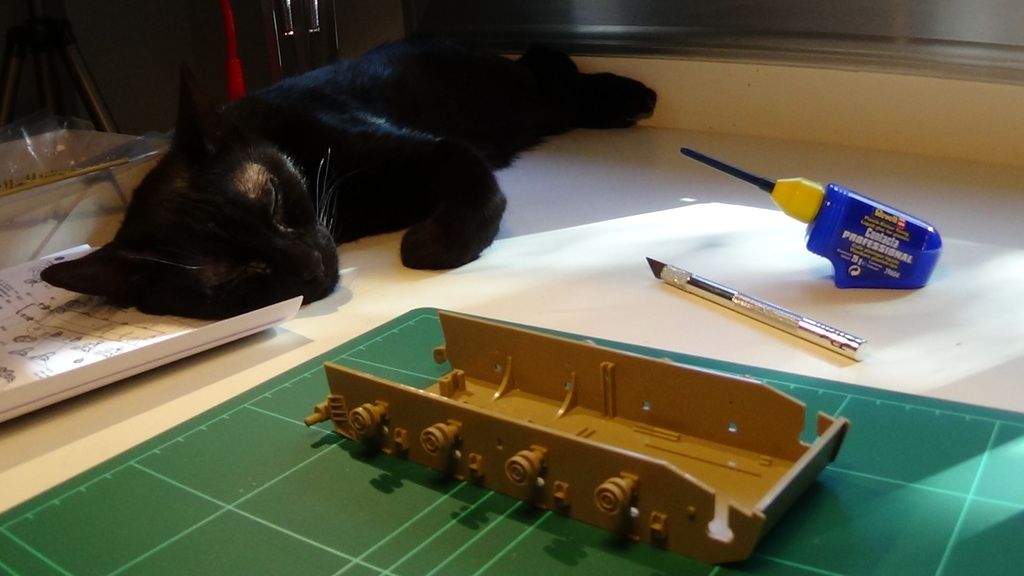

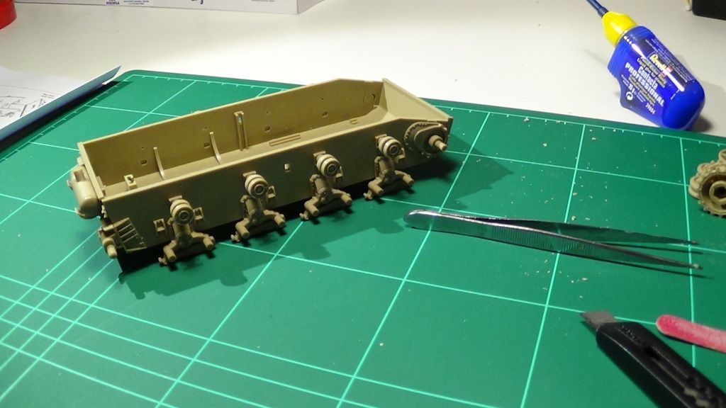

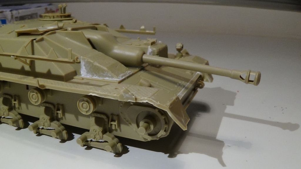

STUG Life Basics....
A new kit!

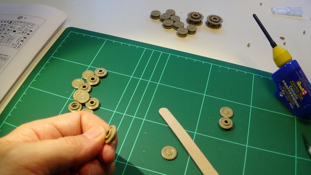

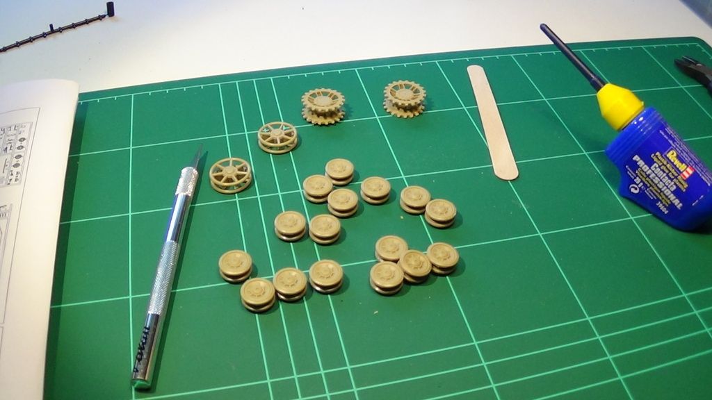

Sanding marathon
Done with them wheels!
Good suspension = Sweet dreams

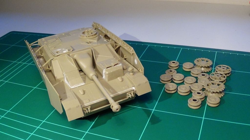

Watery filler

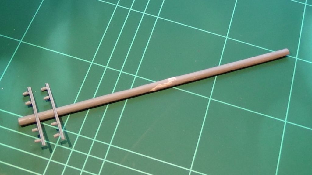

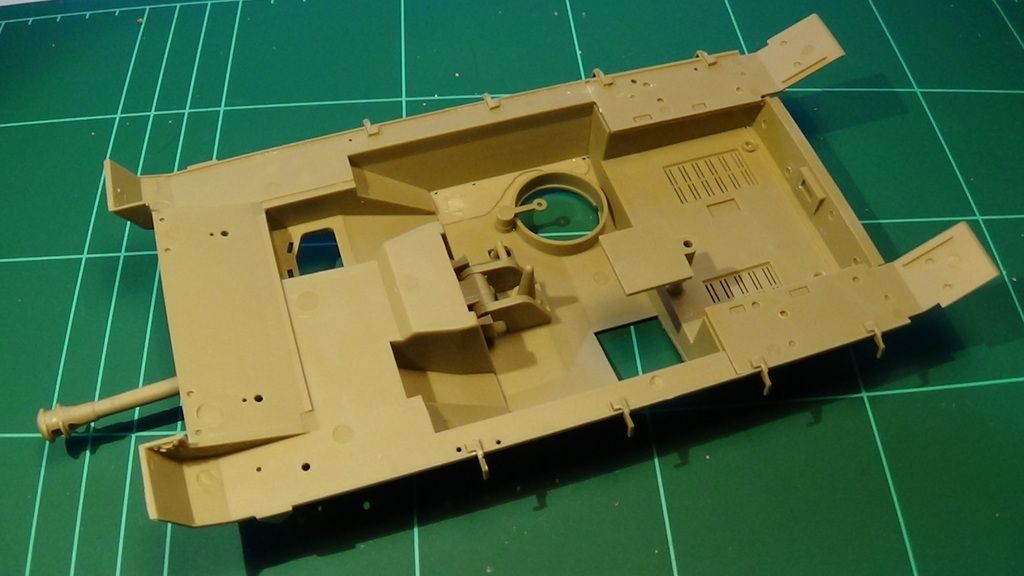

Barrel fitted
Basic interior; it's going to be locked
Niiice :)
Nicer
More fun
That's better

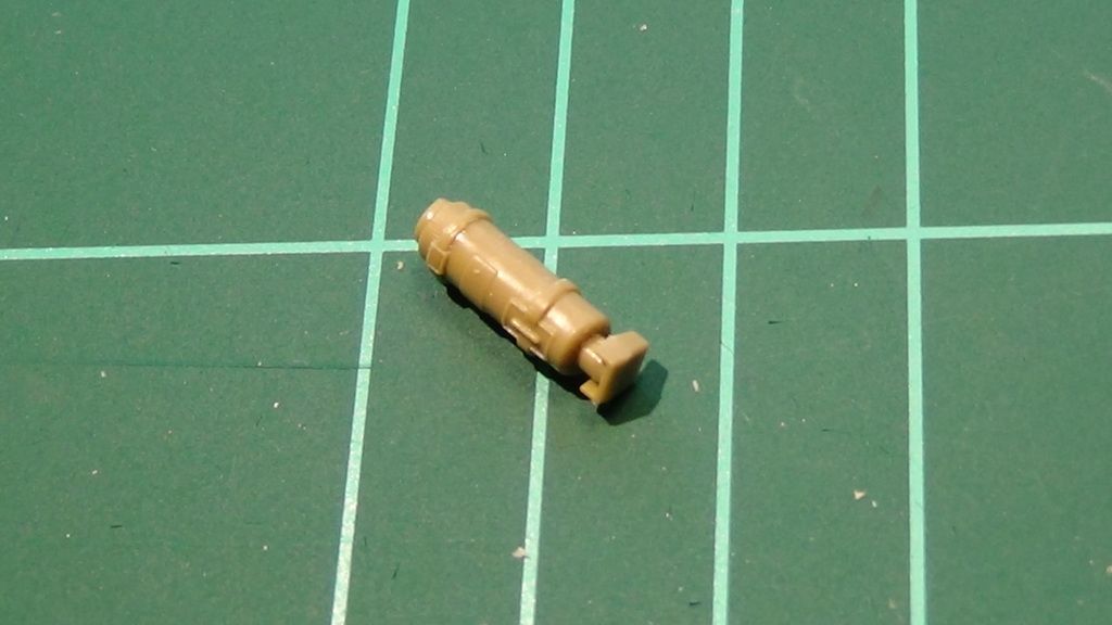

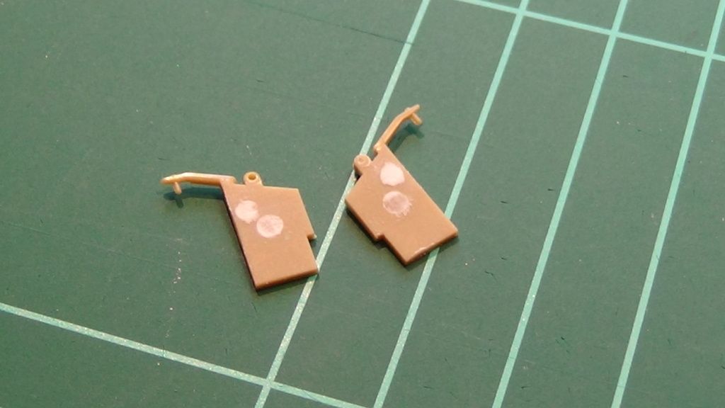

Adorable injection pin marks...
Have you noticed? ...Cats love sleeping

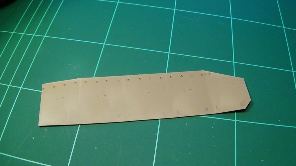

Zutzen? sutsën? Well..those damn plates need a cut
Love pin marks
Enough...
More silly comments on the next update

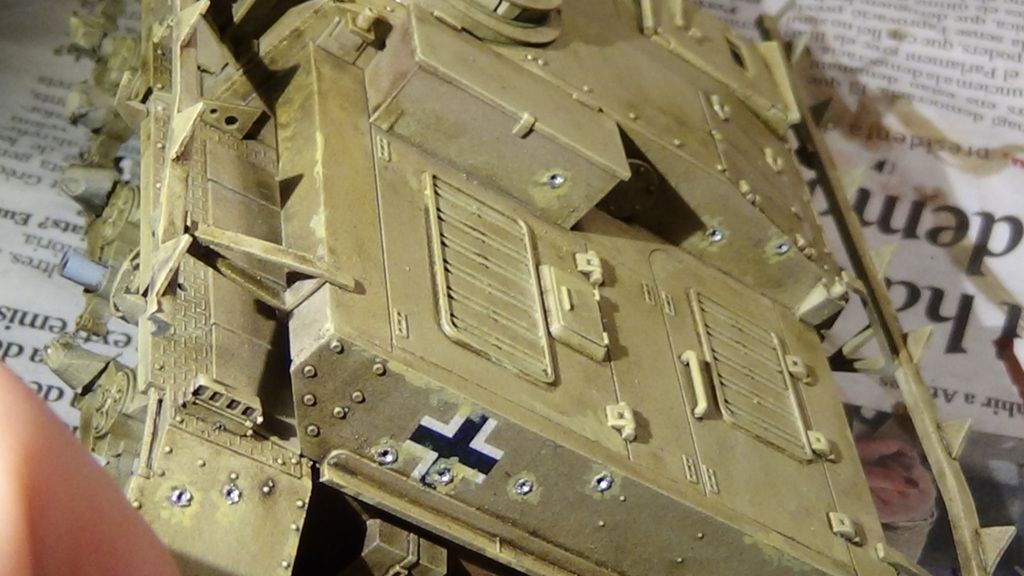

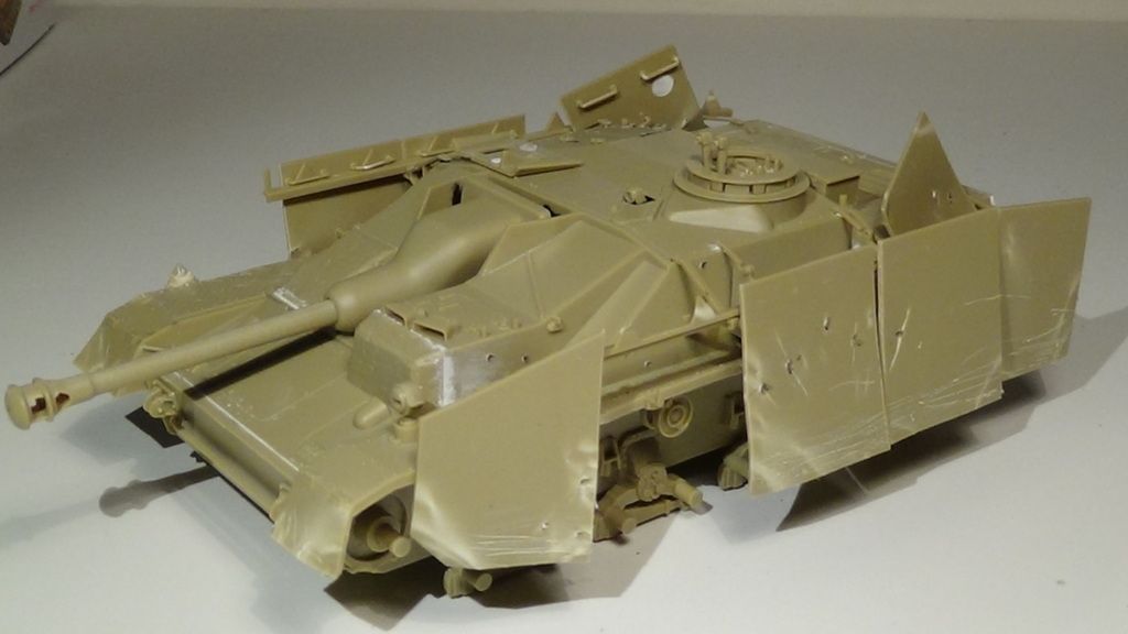

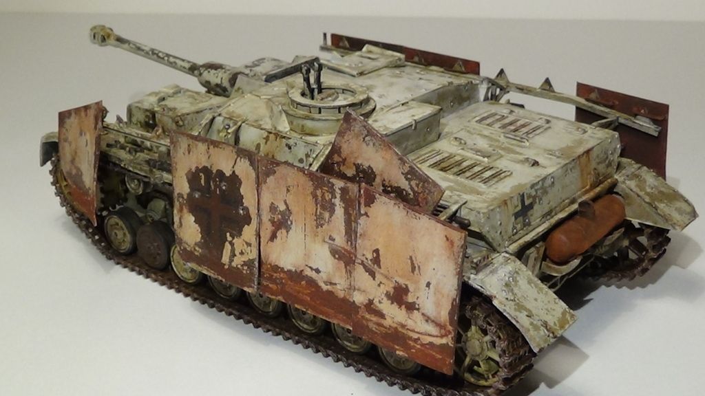

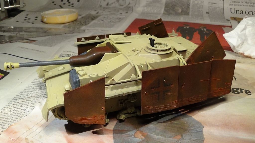

"Stug Life" GB: StuG IV Update 2
[youtube]AbOZlE5BL-I[/youtube]
Poor bug...
Nature's best design: A black cat

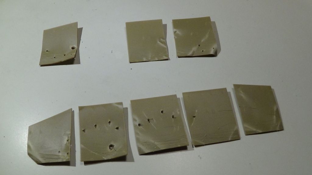

I added putty and prepared the Stug for the priming phase
Keep that away from me!!
Ok... that hurt
No comments...
B*****d
:O
Those plates had it worse
I'm afraid that a Stug was harmed in the making of this thread

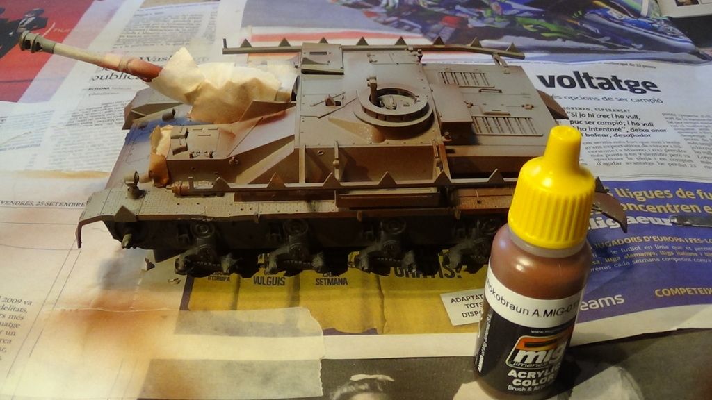

Ok. That's how the poor guy is gonna look

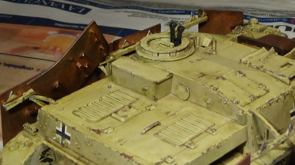

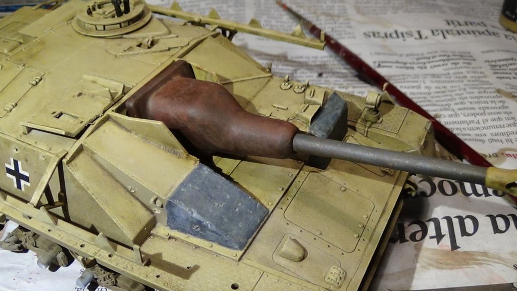

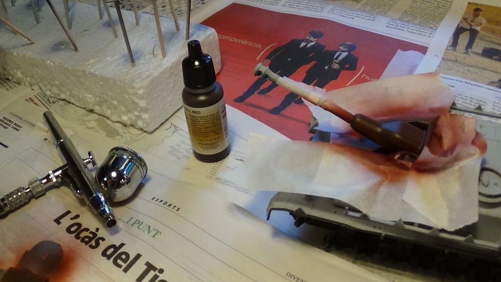

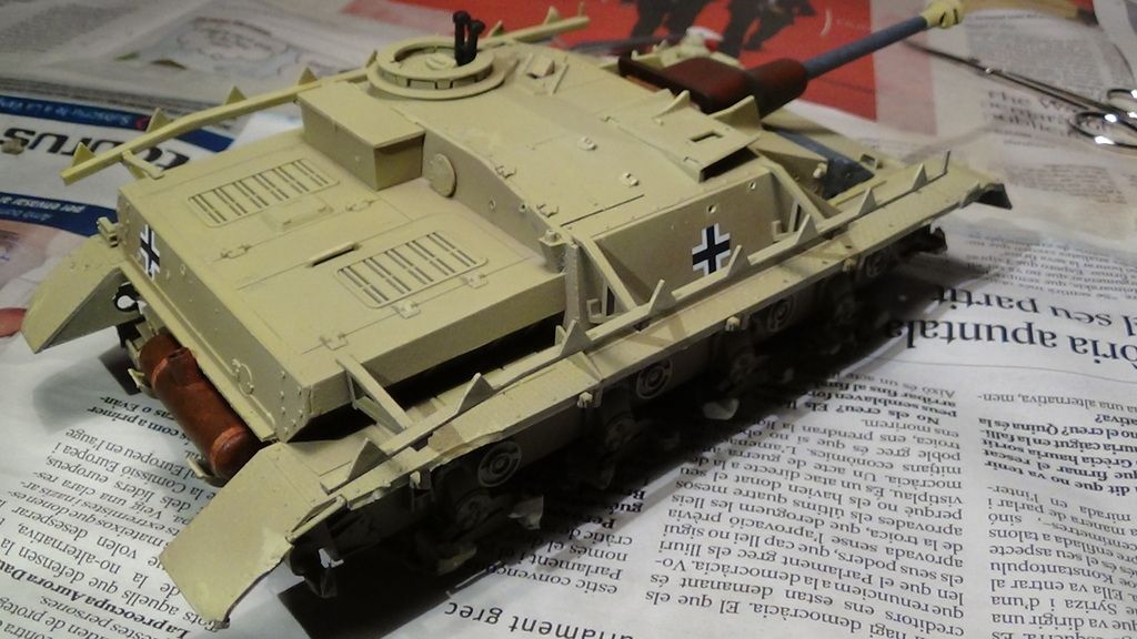

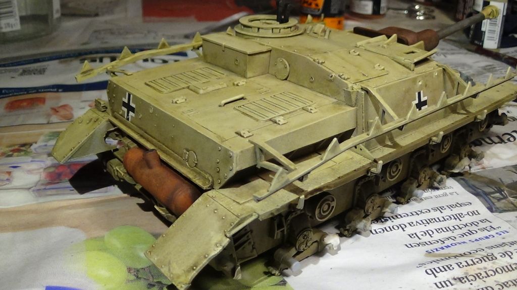

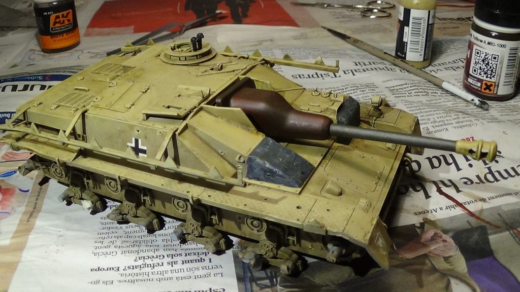

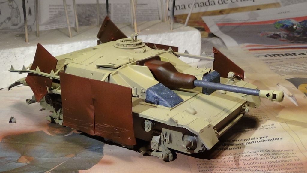

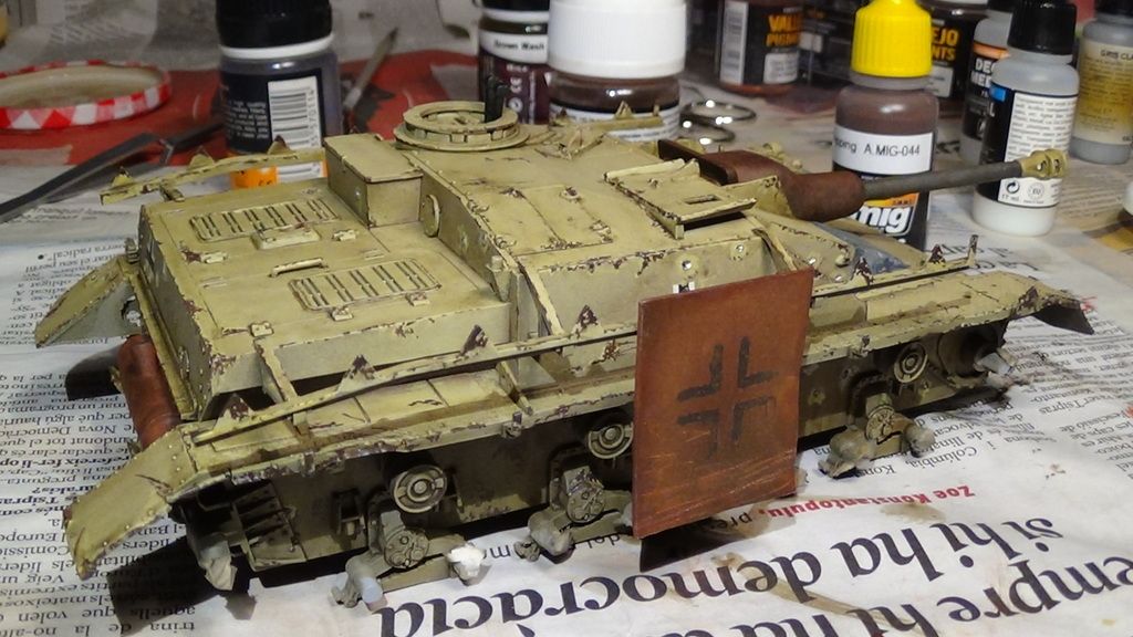

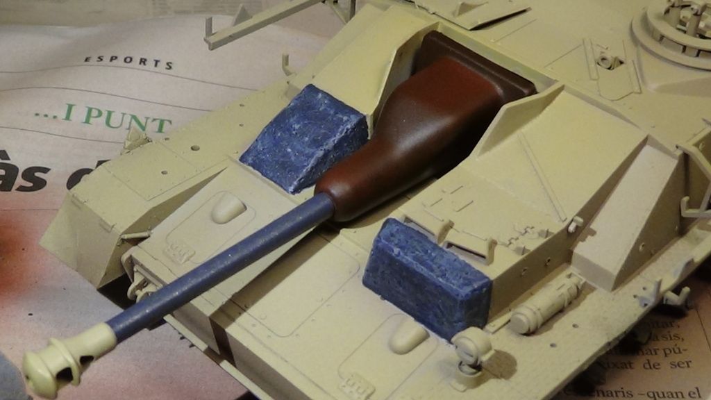

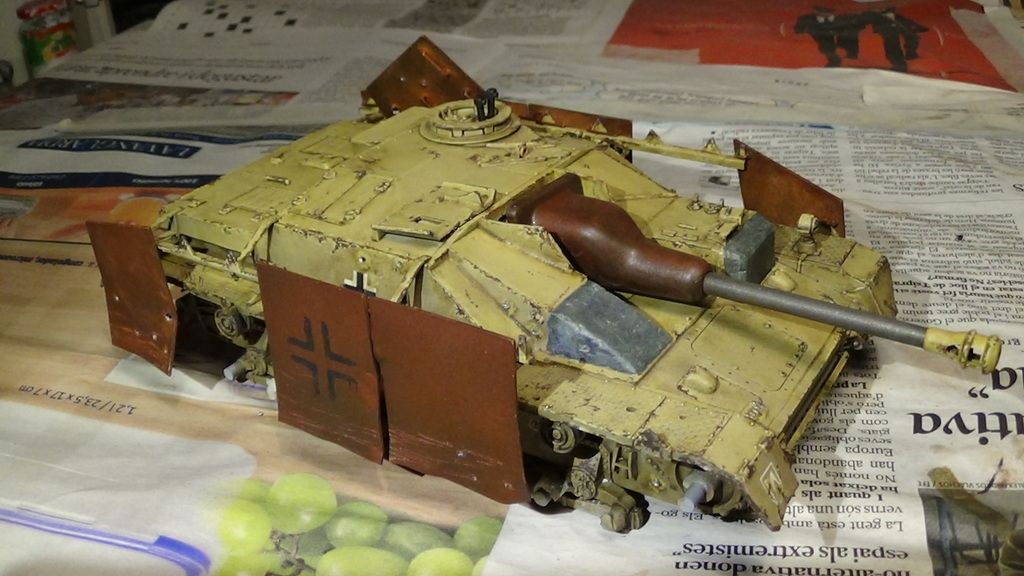

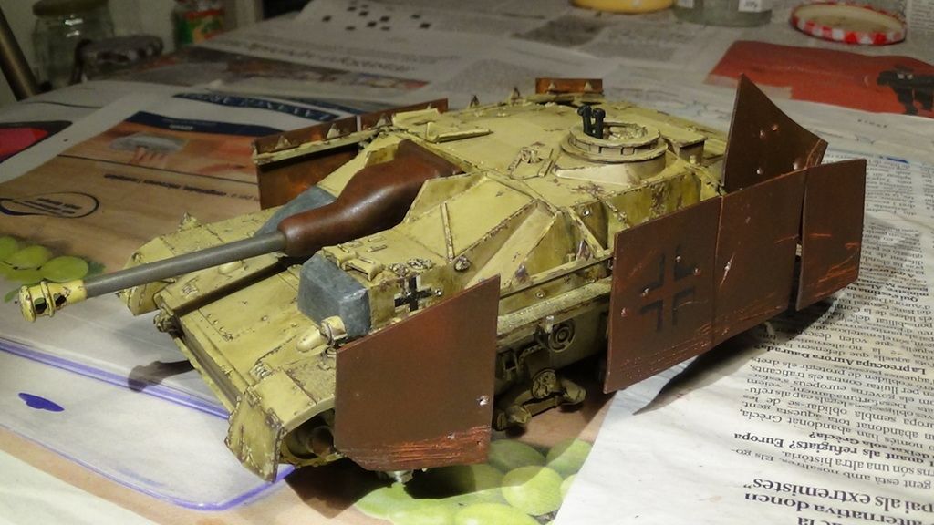

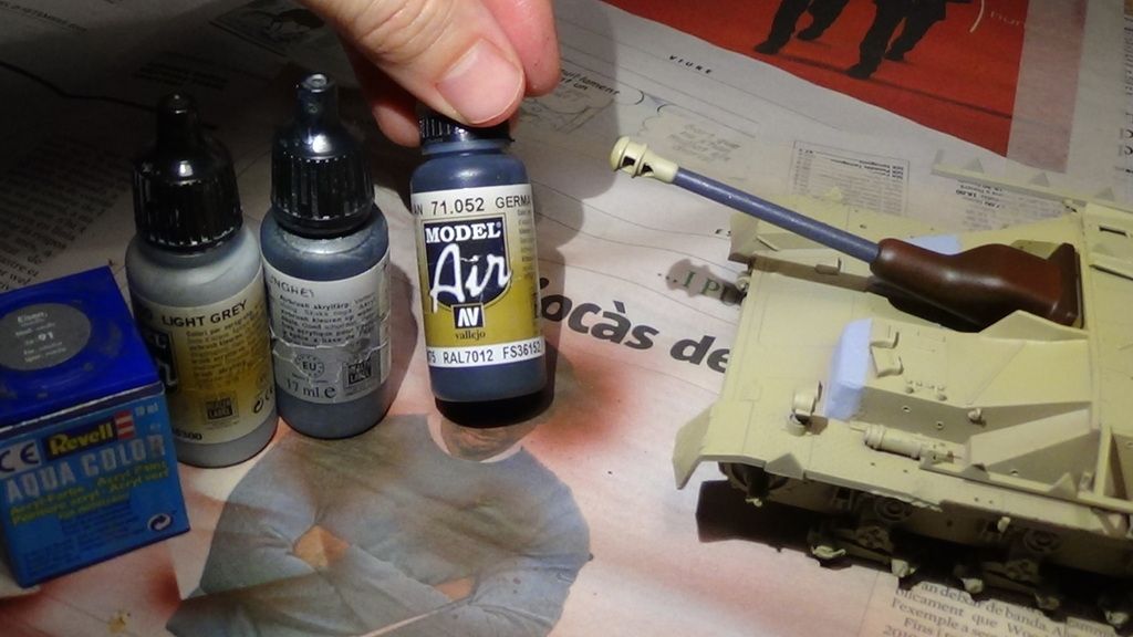

Everything was primed with Tamiya grey primer
The saukopf was painted with hull red
and the plates were painted as well
Some wheels have been replaced on the field and are also painted in hull red
There's a slight modulation with darker colours on the lower parts

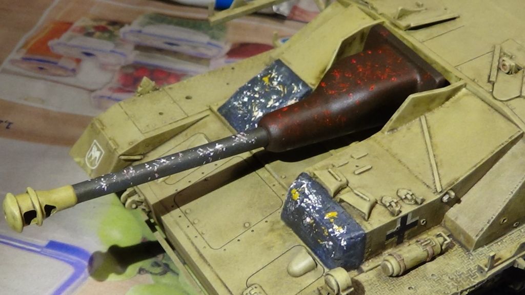

A few paint splotches were carefully sanded
I used several grey tones and a little bit of iron to recreate the barrel factory primer
I added different grey tones on that concrete
Looking good...

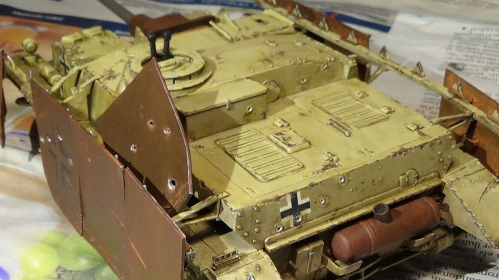

I added sand yellow on those wheels

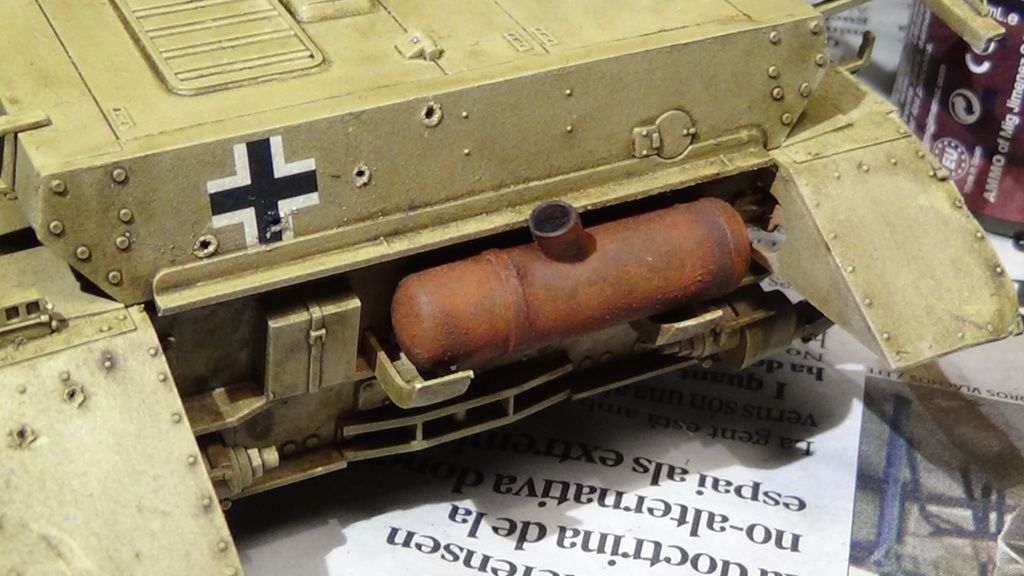

Exhaust was painted with mahagony

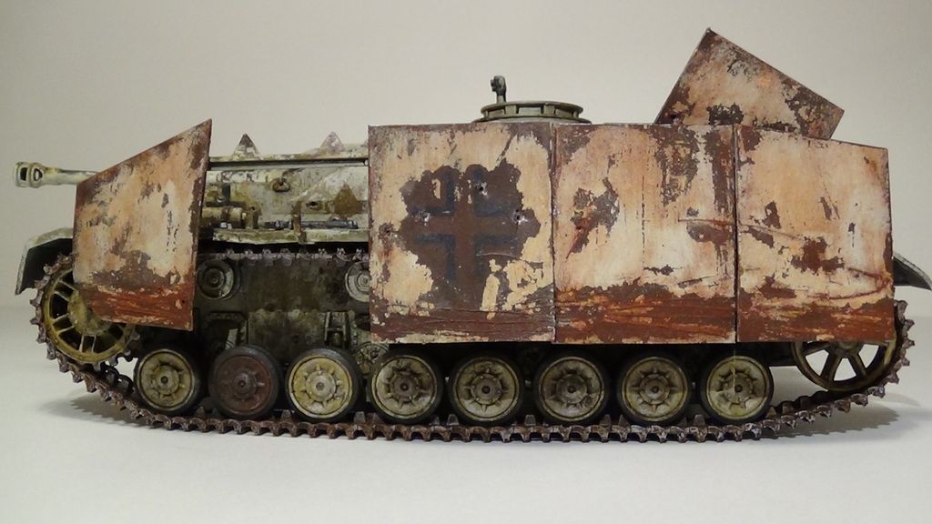

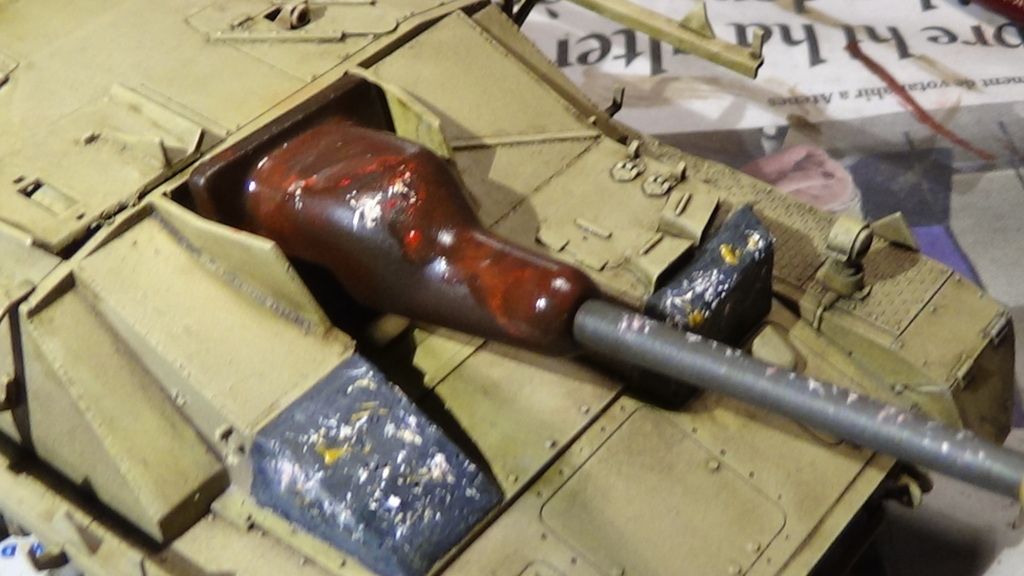

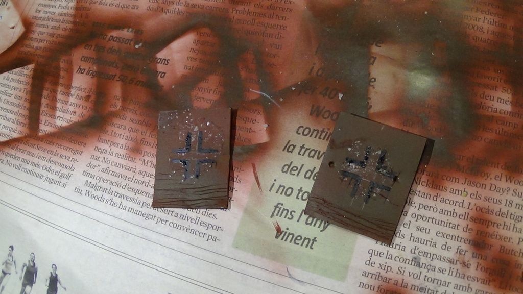

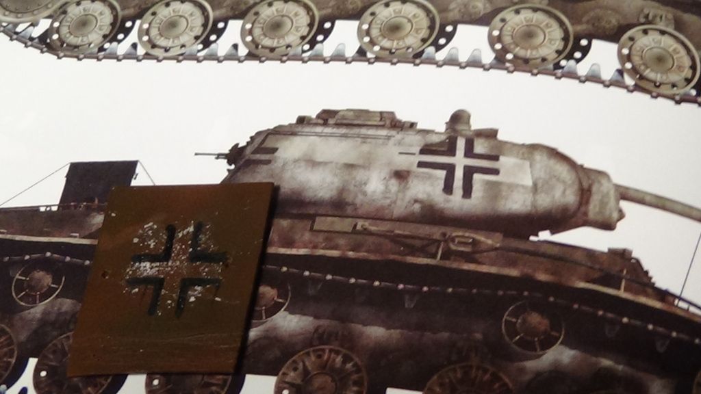

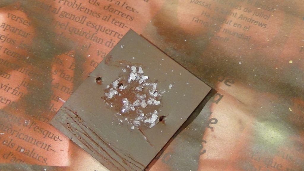

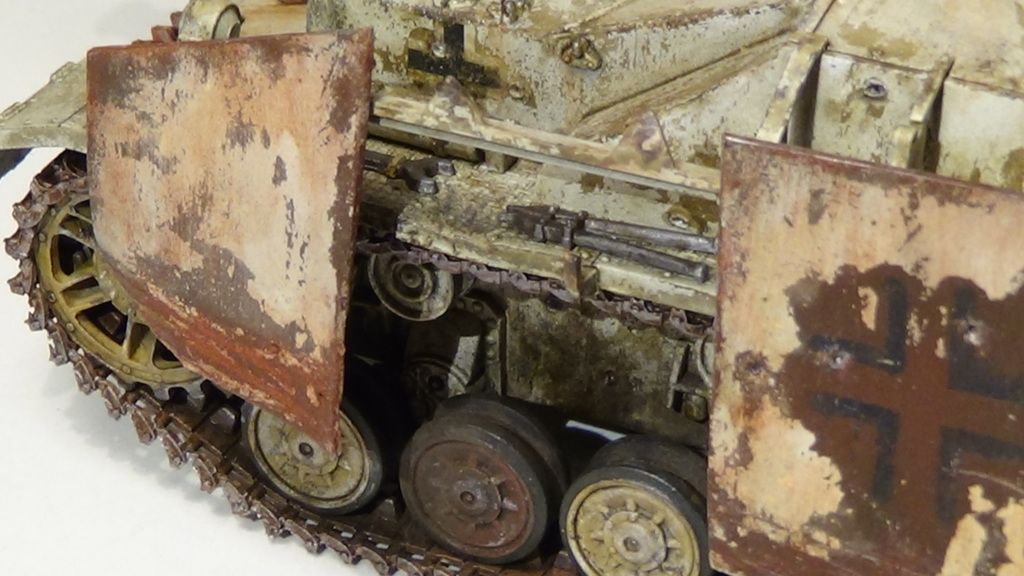

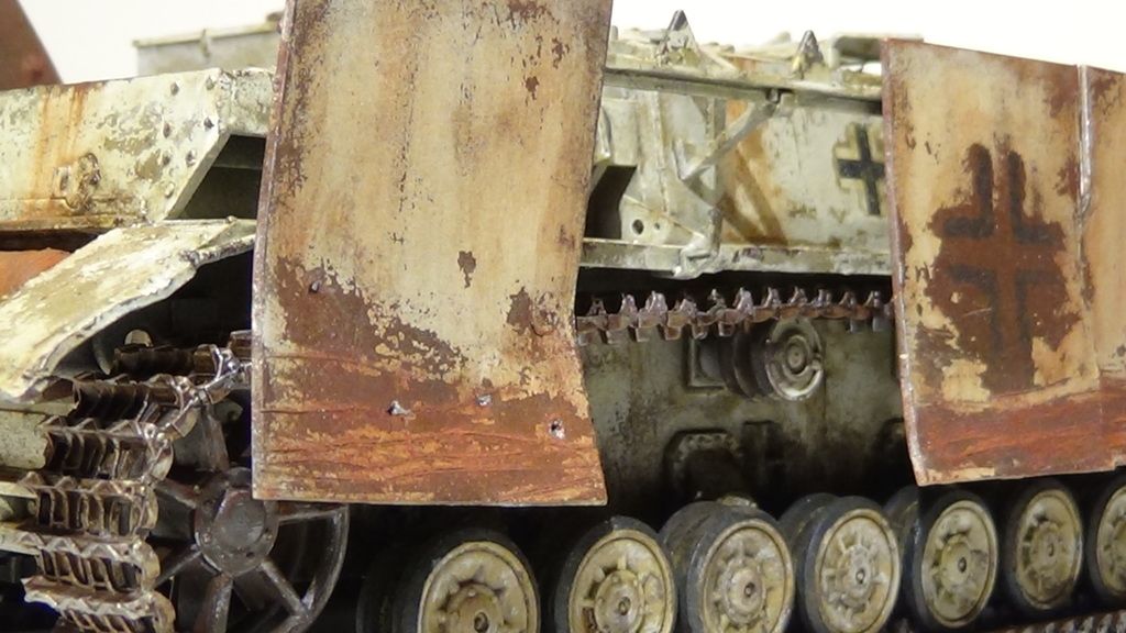

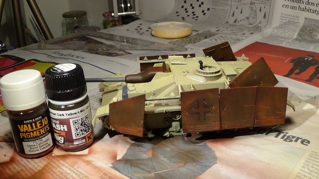

I added salt on the main plates
...and painted those crosses with a small brush
I took this pic as a model (Eastern Front Mig)
I removed salt with water and lightened scratched areas
I'm quite happy with it :)

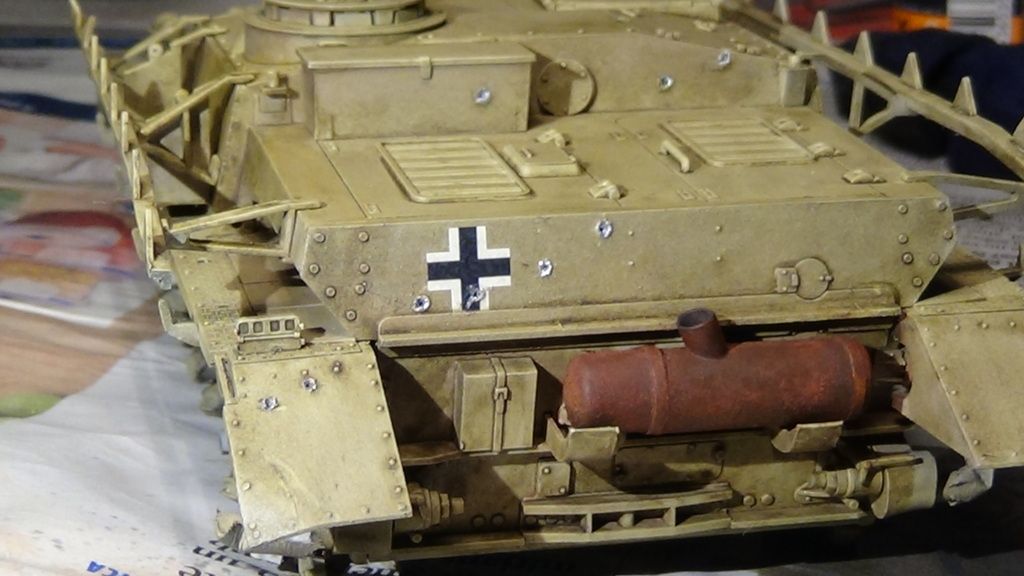

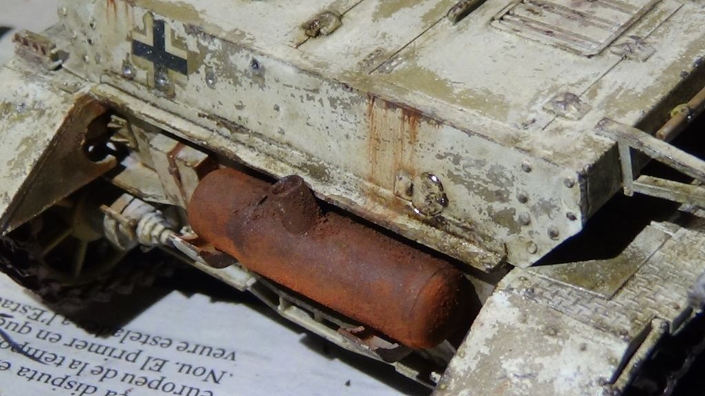

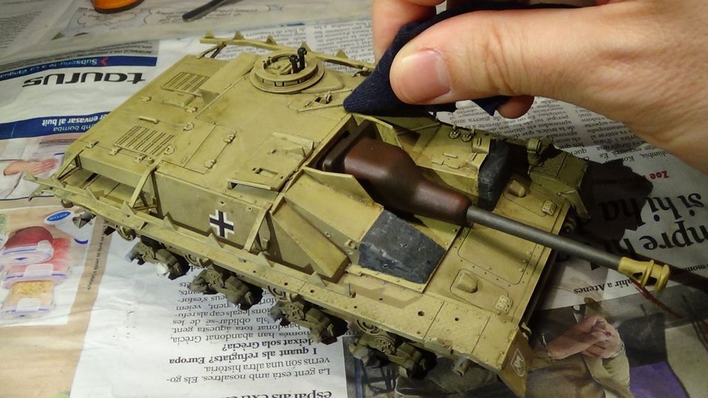

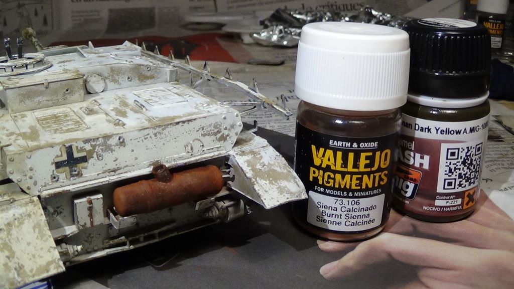

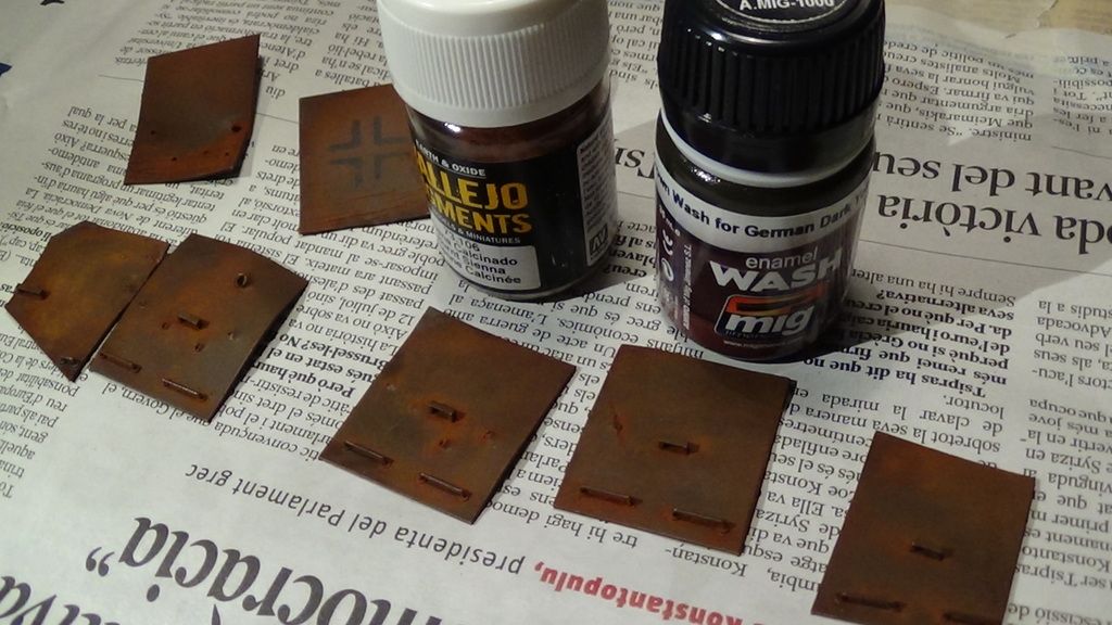

I washed those plates with enamel and before they dried I added rust pigments
Decals!
I rusted the exhaust too
Finally the Stug was washed with the same enamel concoction
I cleaned surfaces carefully with good quality cotton fabric
Looks cool
Darker rust pigments were added
I went on with an oil dot filter on the barrel and the concrete parts

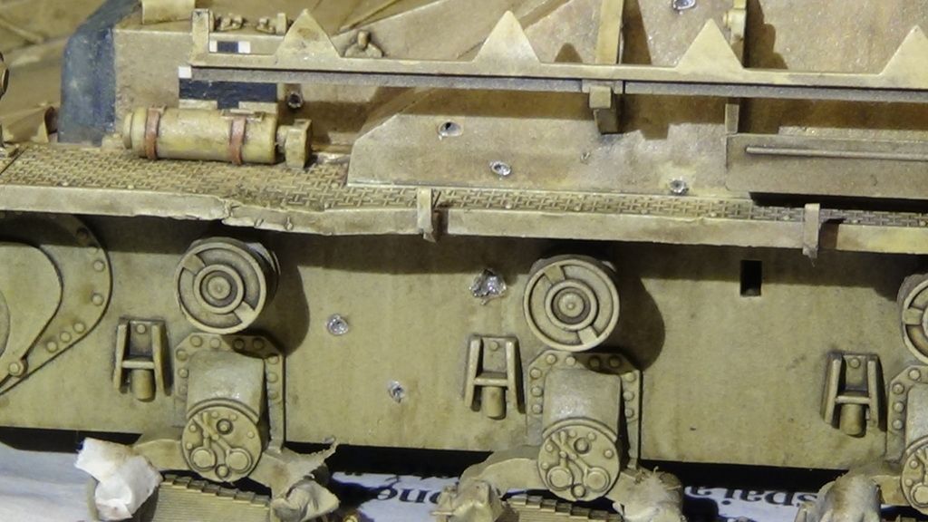

That's how it looks after washing it with white spirit
I added iron on those bullet holes
The poor bug is riddled with bullets
I lightened exposed parts to prepare them for chipping
There it is... I used Mig's 044; awesome stuff
I added a little bit of iron in key areas
And that's it! Ready for winter seasoning
Thanks for watching! :cheers2:

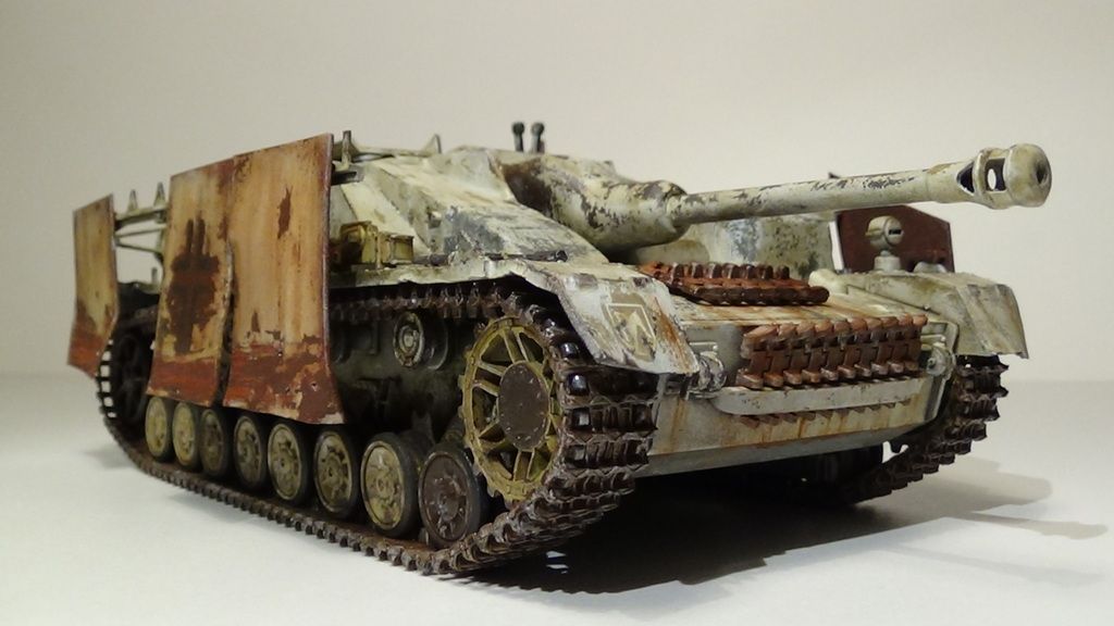

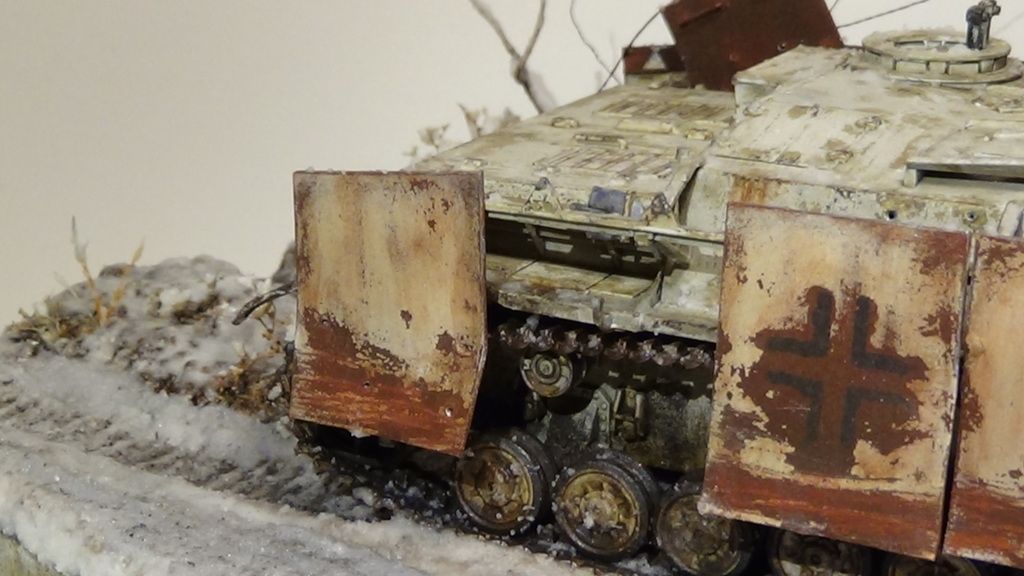

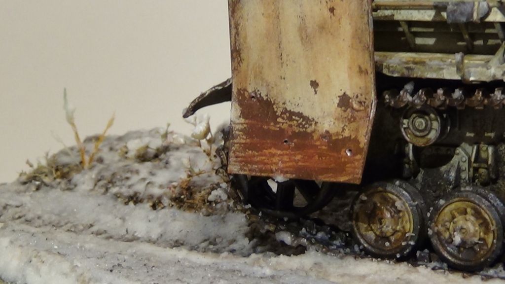

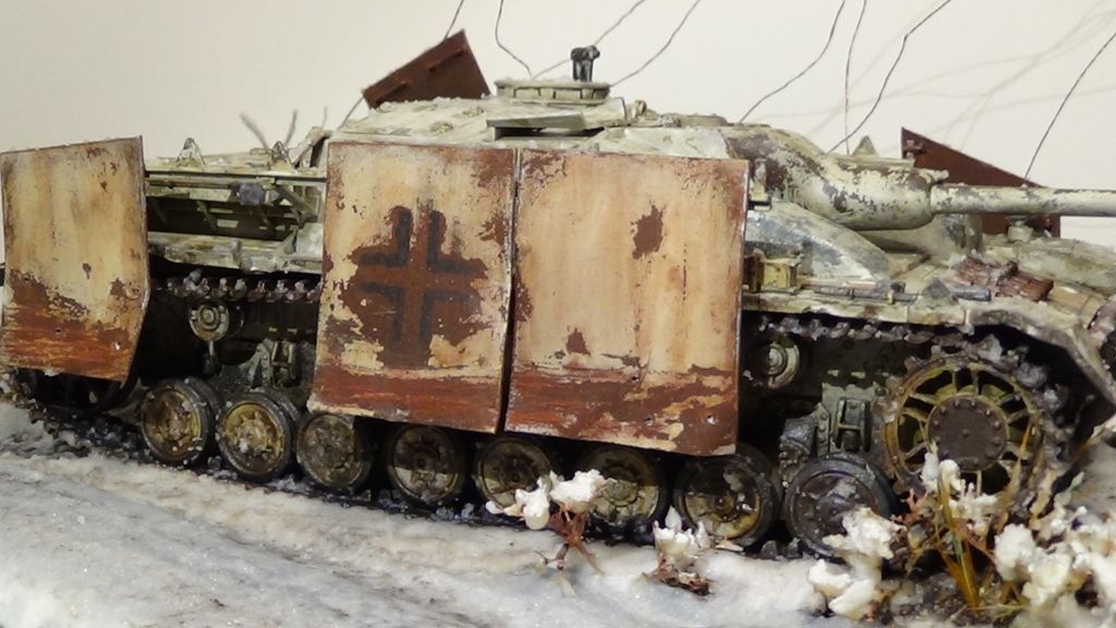

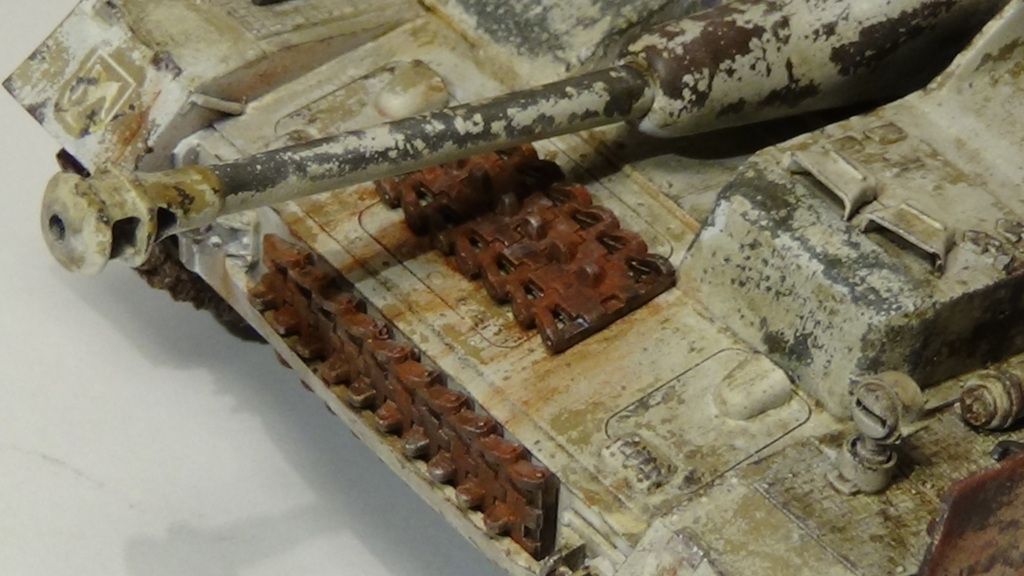

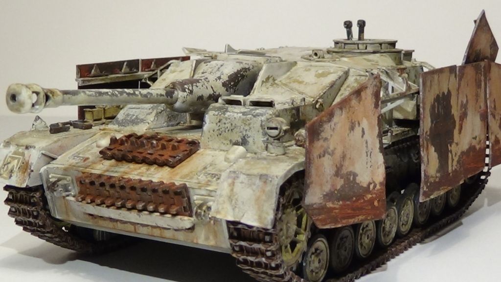

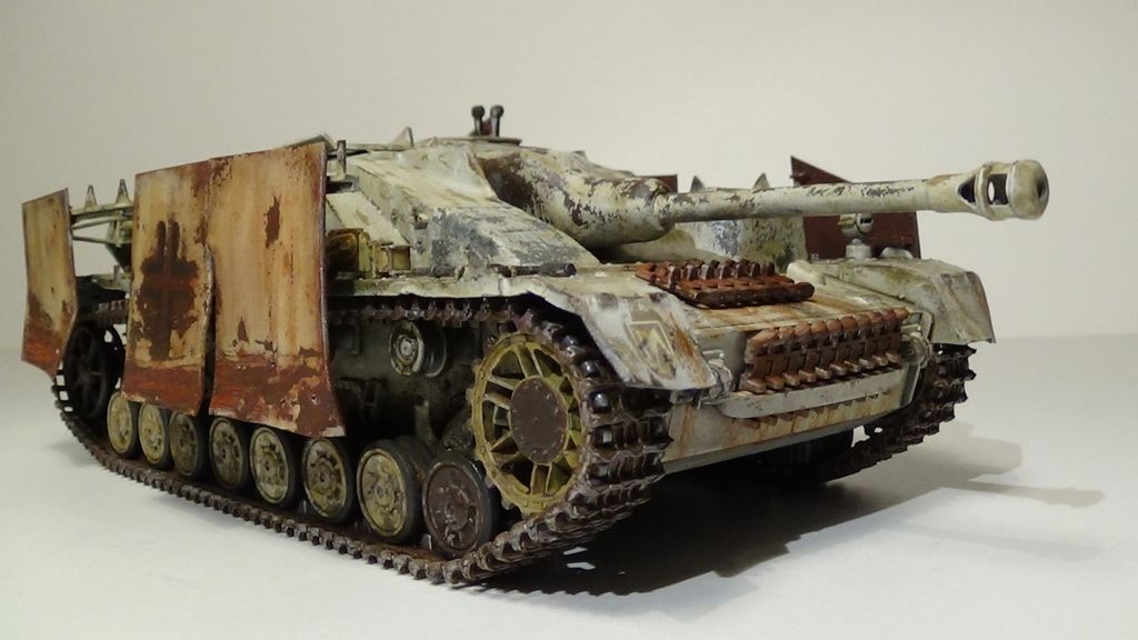

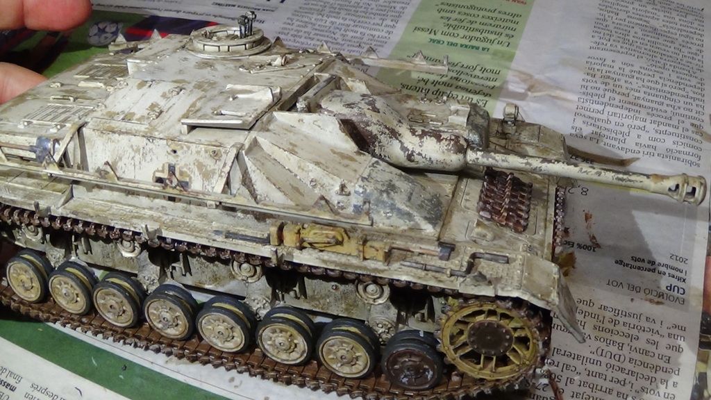

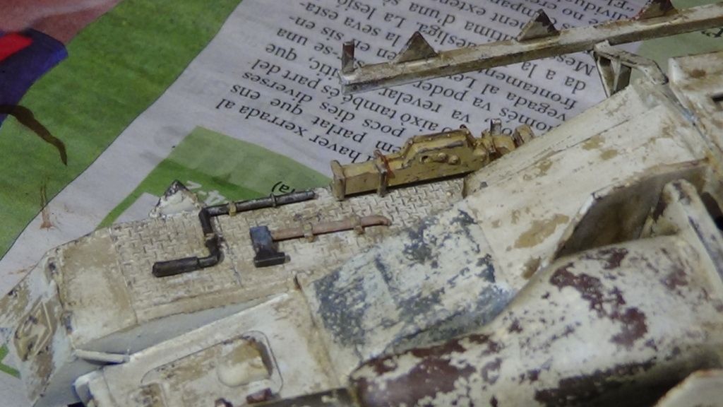

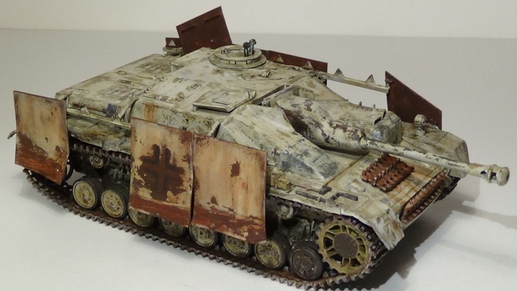

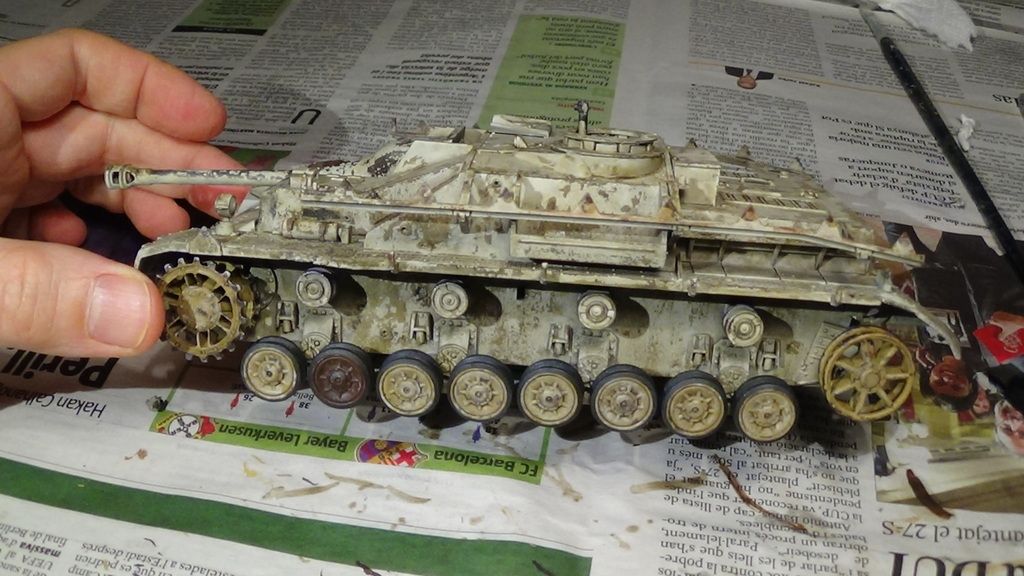

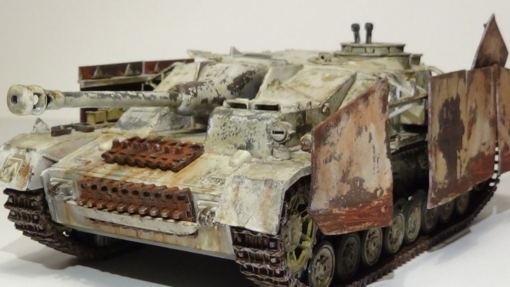

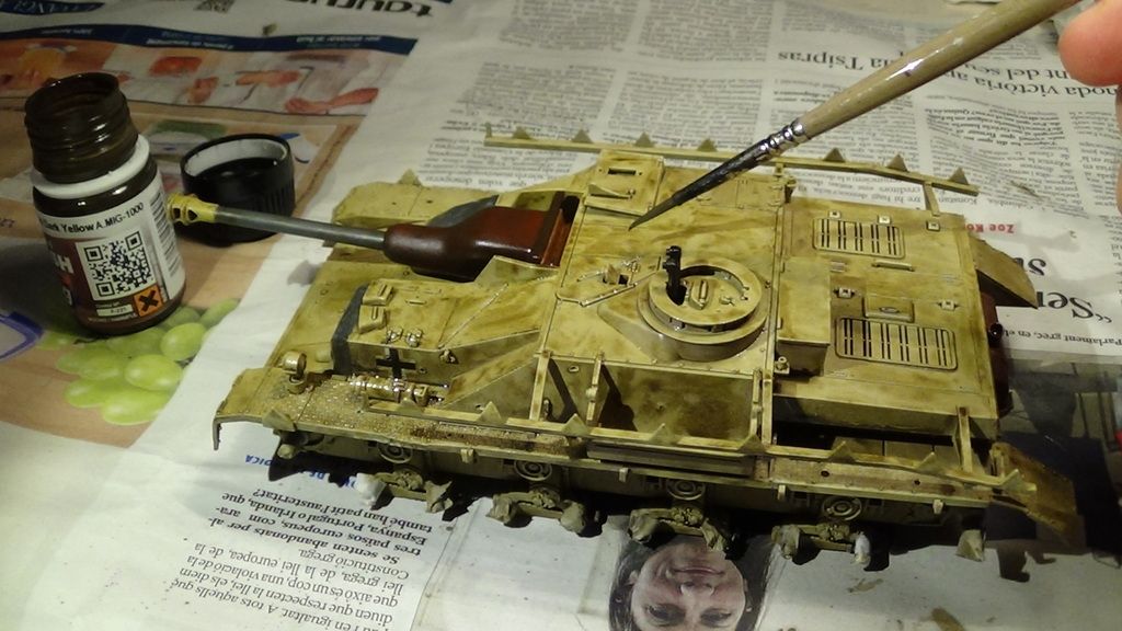

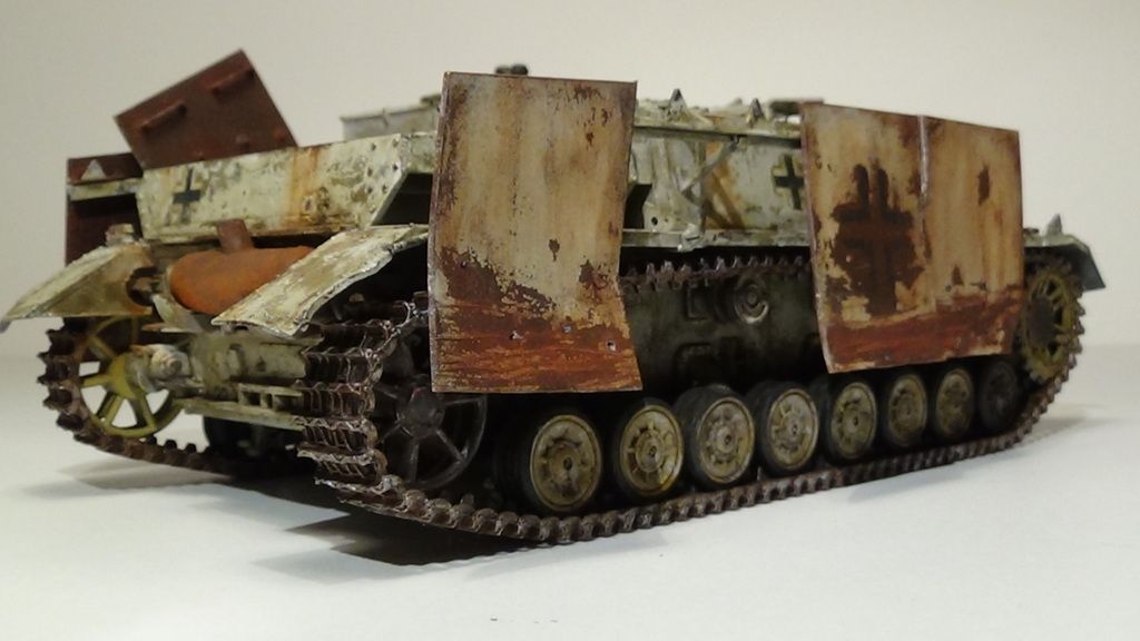

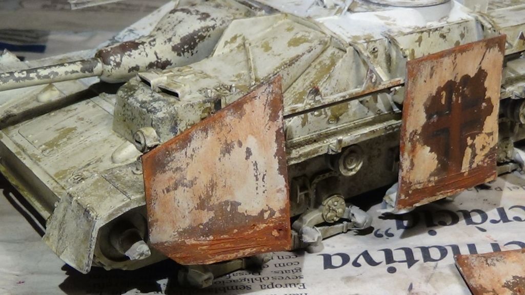

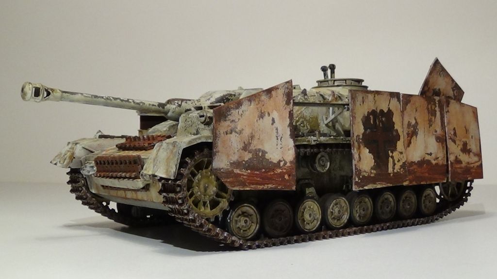

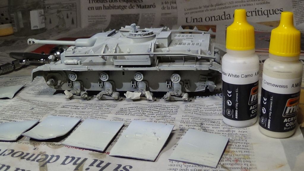

"Stug Life" GB: StuG IV Update 3
[youtube]r_3myqTufOw[/youtube]

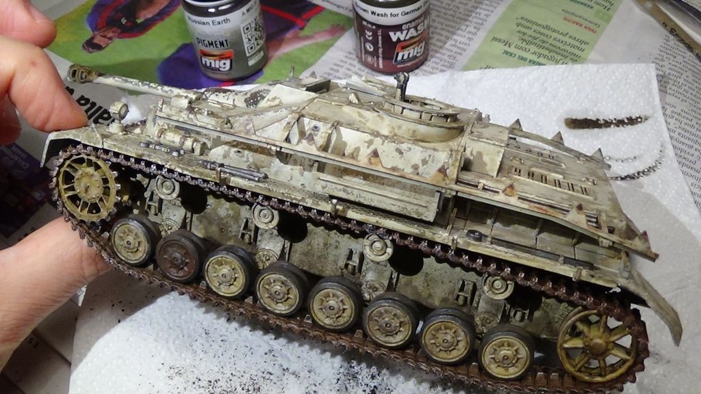

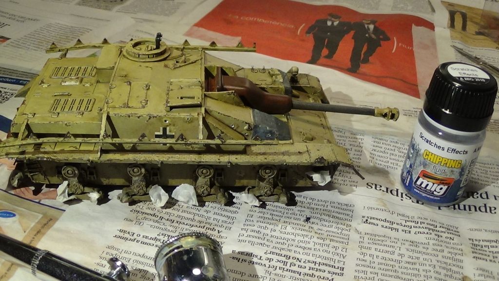

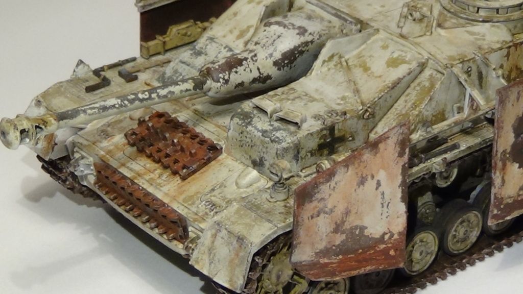

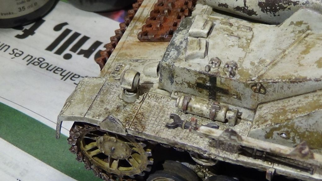

Winter is coming...

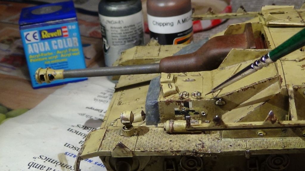

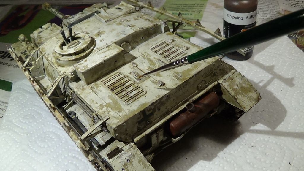

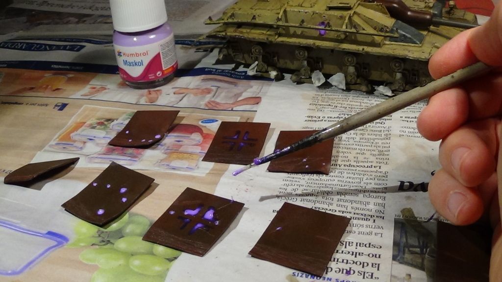

Stug from the chippy. I deep fried it with Mig scratches effects (chipping)

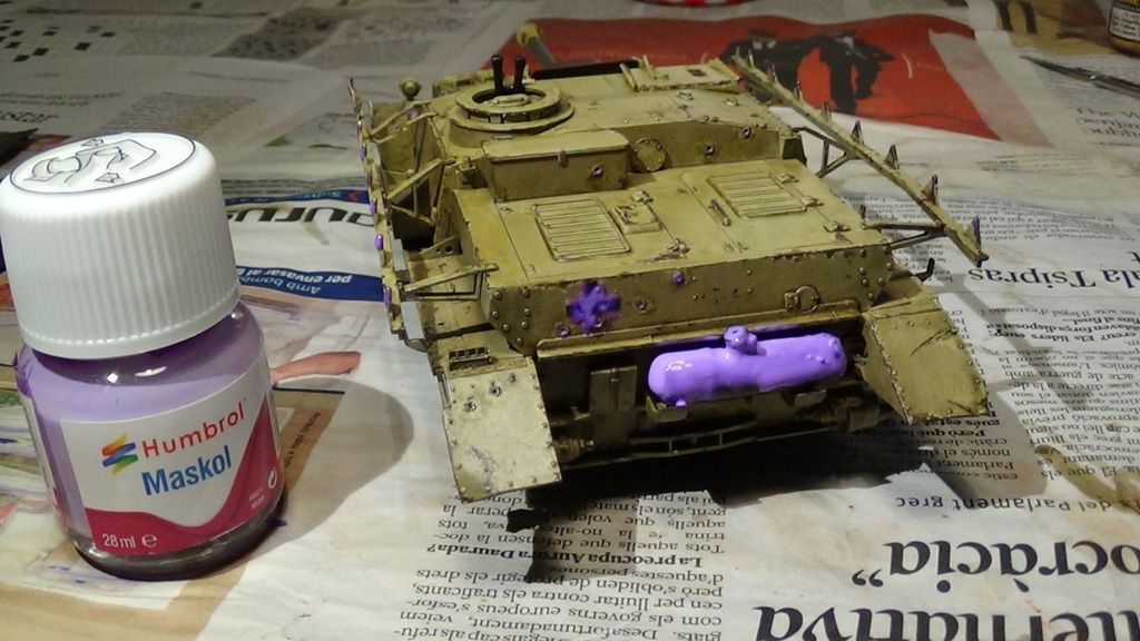

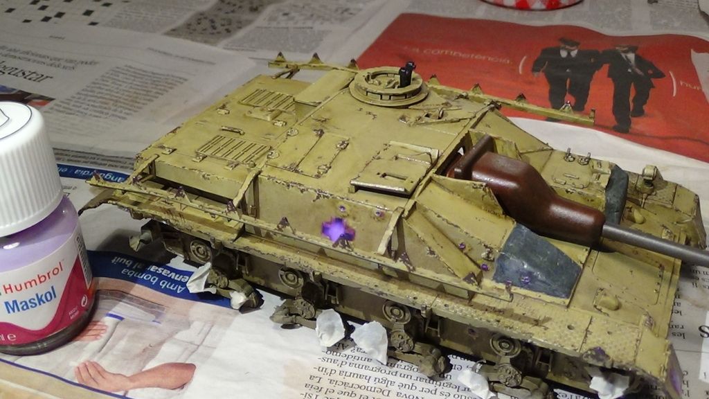

More masking preparations...
Bullet holes and decals are protected
Maskol festival

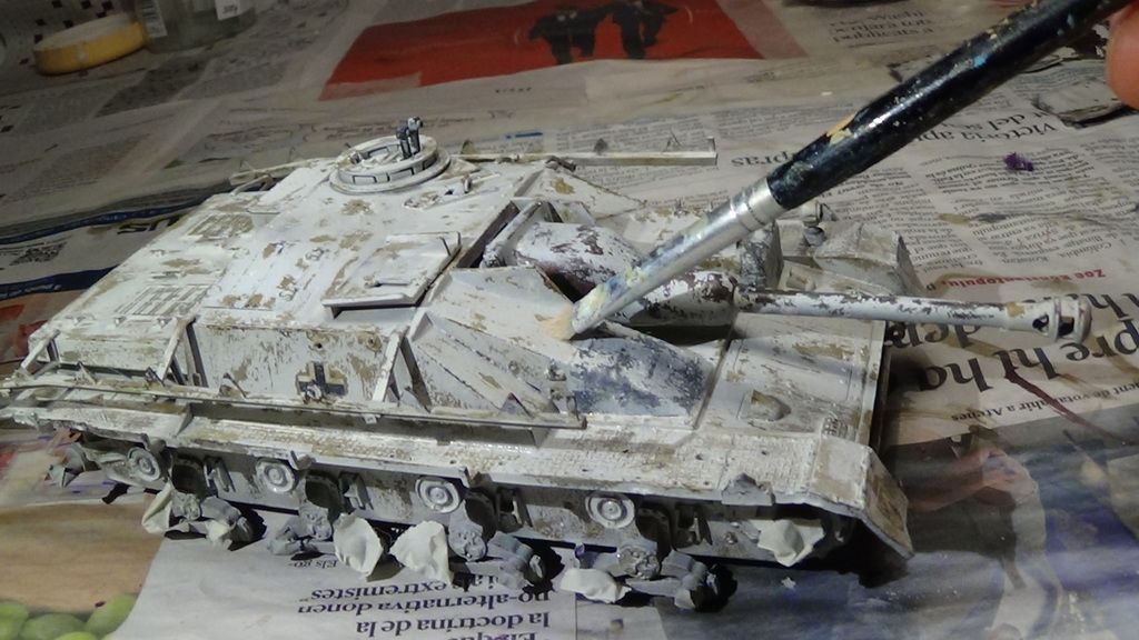

Winter has definitely come
Old hard brush + Water
After a matt varnish coat I washed it carefully with this enamel wash
More pigments were fixed with the same wash
White camo was scratched and then I added a wash and rust pigments
Looking good!

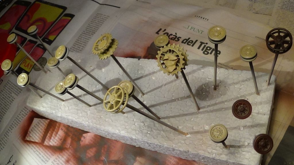

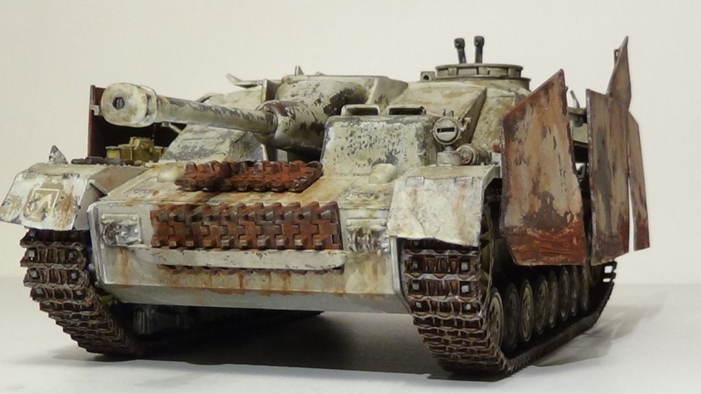

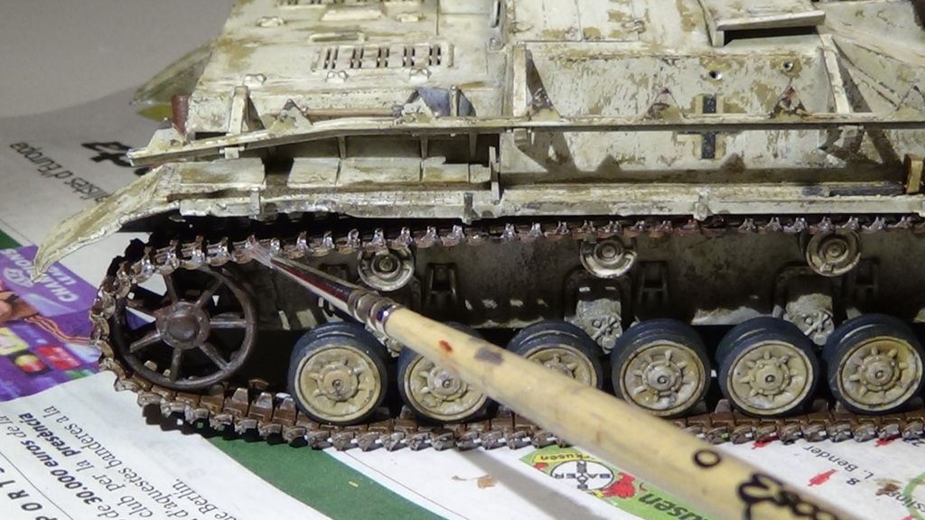

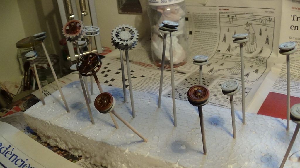

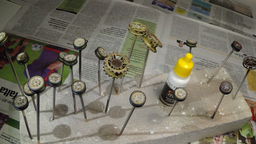

Wheels have been painted and washed
Plane guy strategy

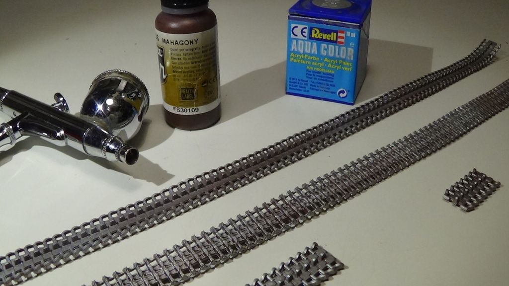

Tracks were airbrushed with a reddish coat and on top of it iron was added
Matt barnish... (let it dry!) + track wash
Wheels are prepared for chipping effects
I used white washable camo again
...and scratched it with an old brush
I added the wheels...

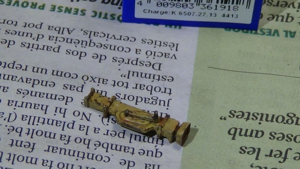

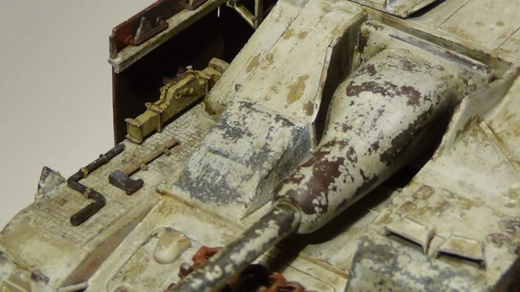

I went on painting tools paying attention to little details

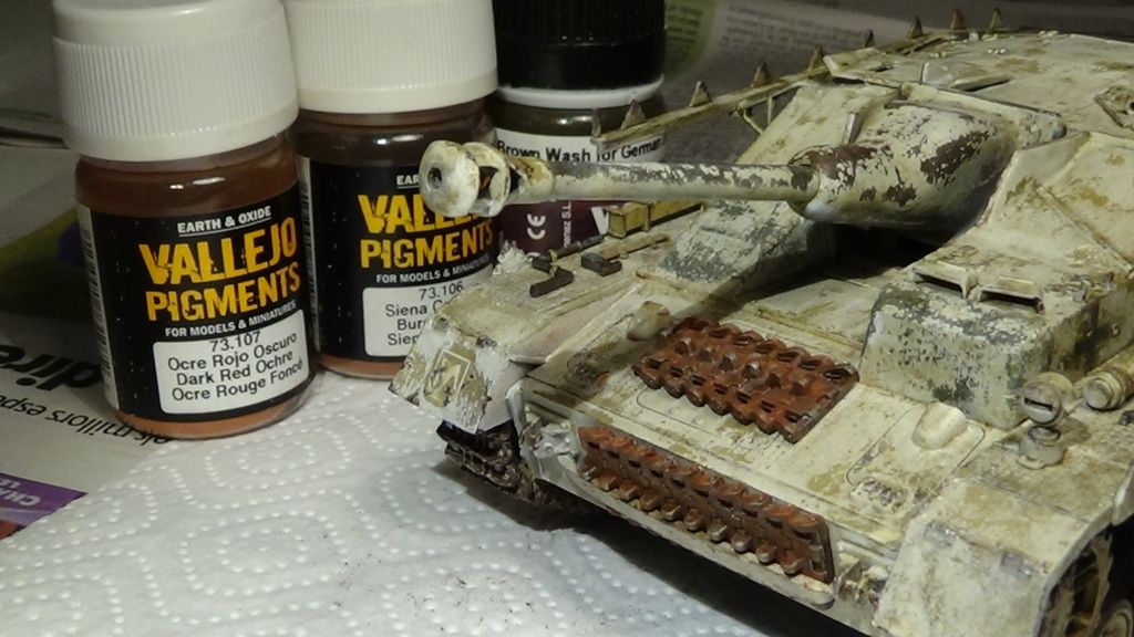

I used iron, Mig chipping and fixed rust pigments with a (brown wash)
I blended tools with the Stug adding a light touch of diluted white camo
I added iron on tracks and small elements
Russian earth was fixed with a wash
Additional chipping
I rusted those tracks a little bit

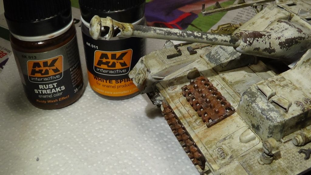

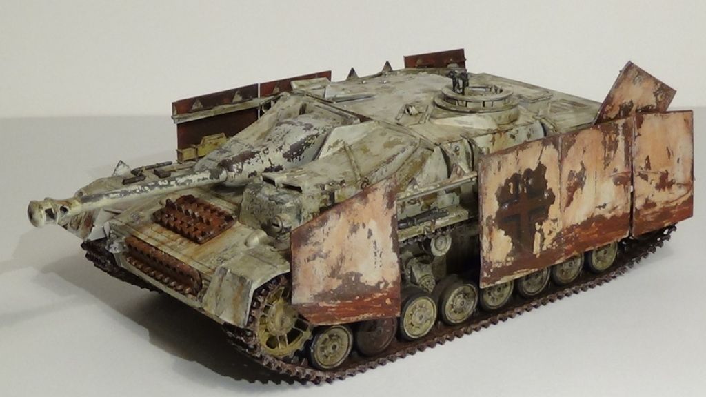

..and of course I added those adorable rust streaks
Rrrust Streaks (Quite addictive)

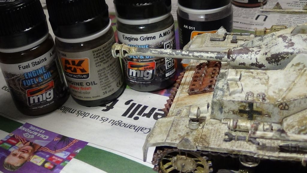

Finally, I used some grime and oil
And that's it. It's almost ready for a thuggy dio
Cheers!!! :cheers2:

Stunning work Felis! Mine will pale in comparison I'm sure.
Current Builds
PaulAyrey
Posts: 1141
Re: STUG IV "STUG Life" GB
Post by PaulAyrey »
Great stuff Felis!
Really like the contrast between the side skirts and the Stug!
JudgeDredd
Posts: 405
Joined: Tue Jul 15, 2014 9:12 pm
Location: Colchester, England
Post by JudgeDredd »
Absolutely superb. Weathering is genius!

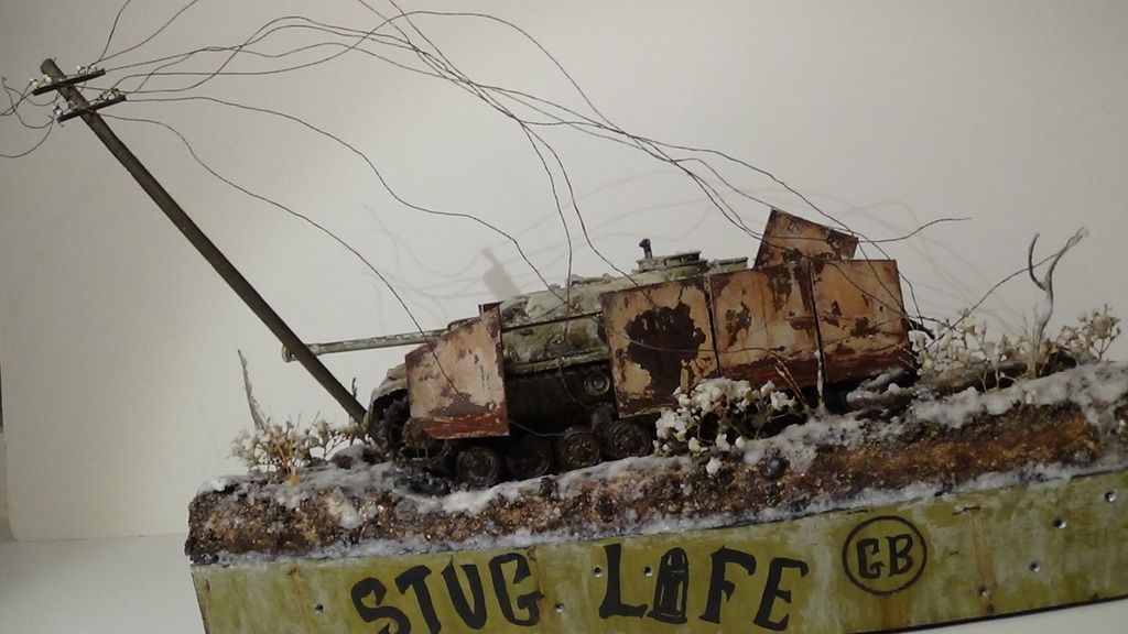

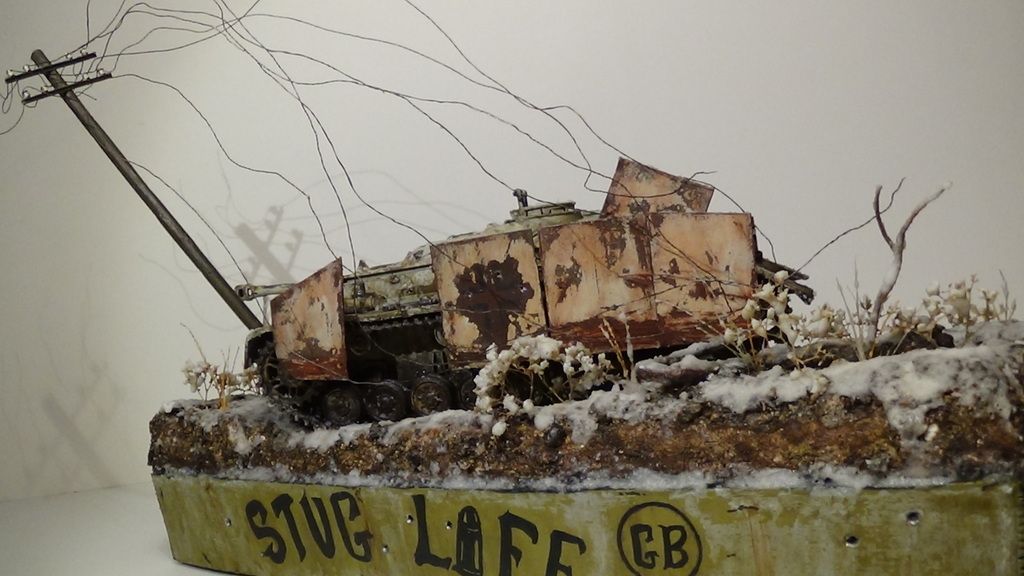

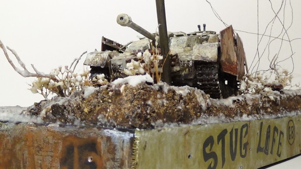

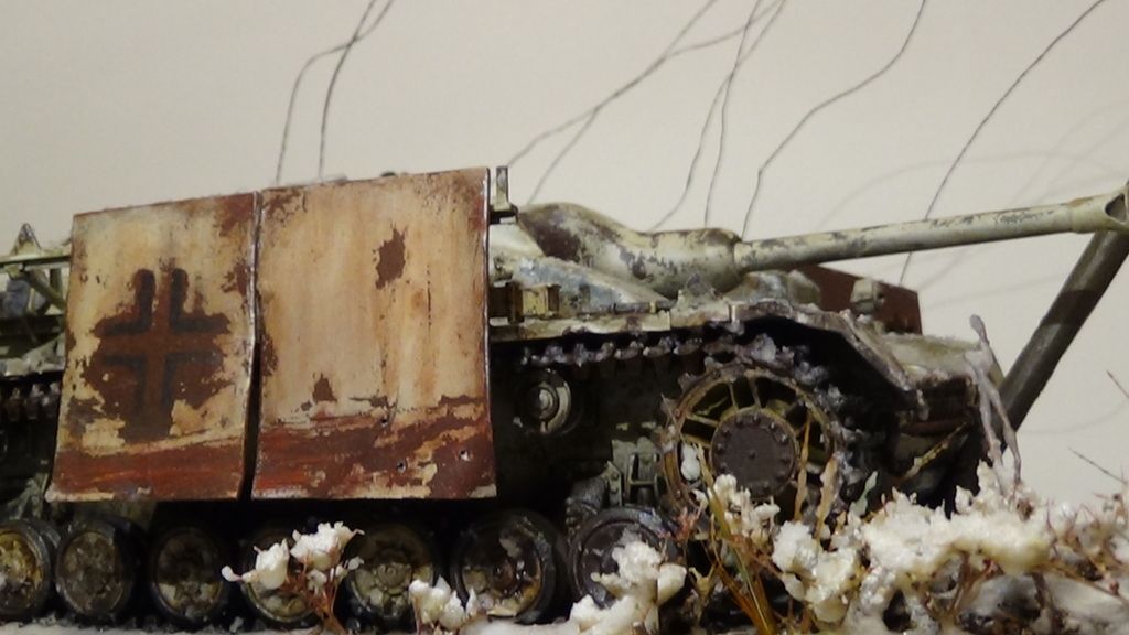

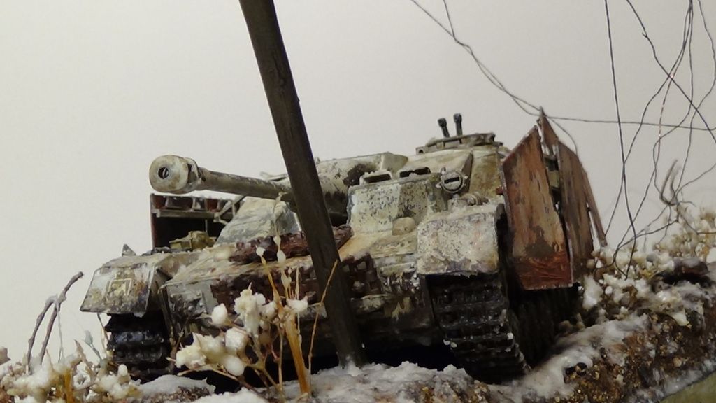

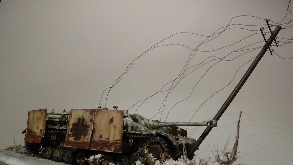

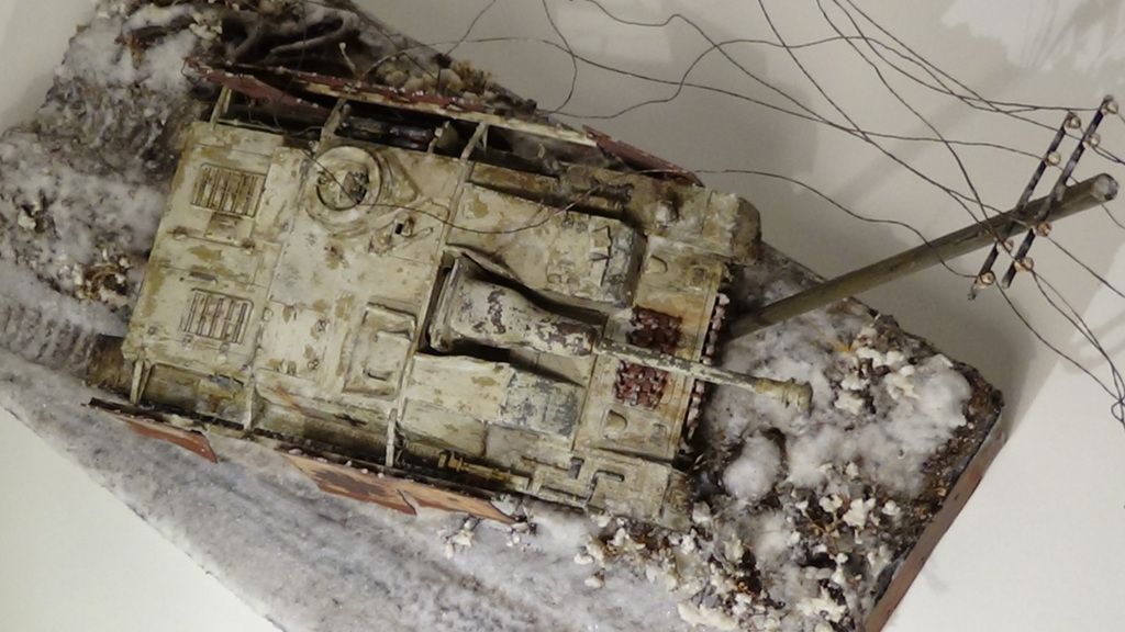

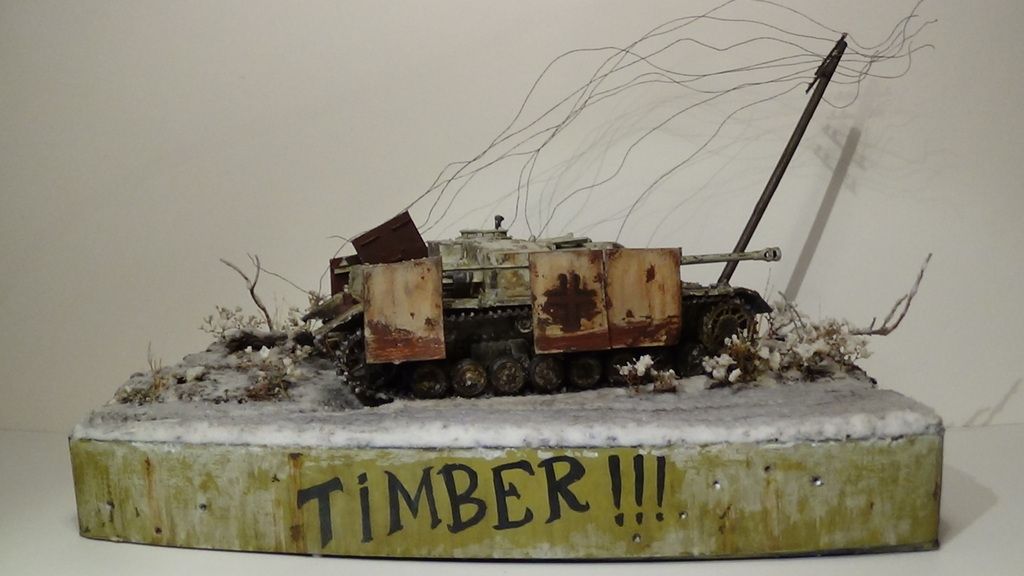

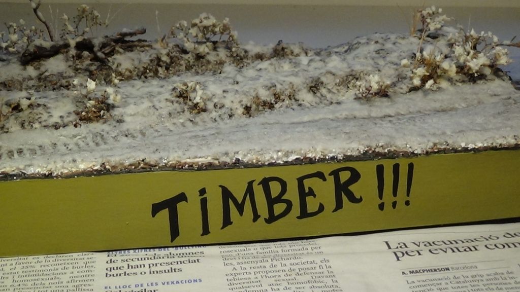

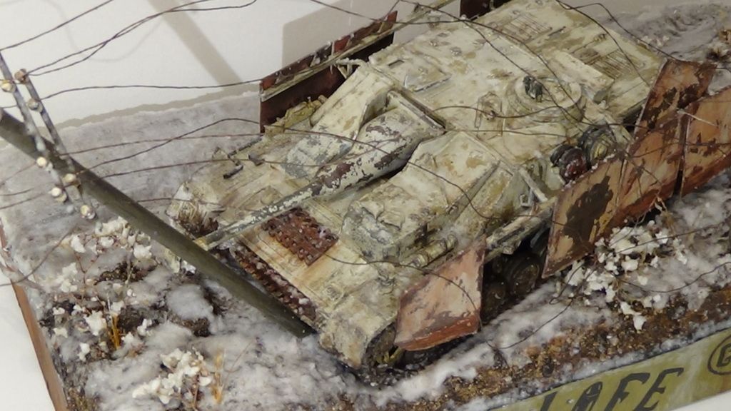

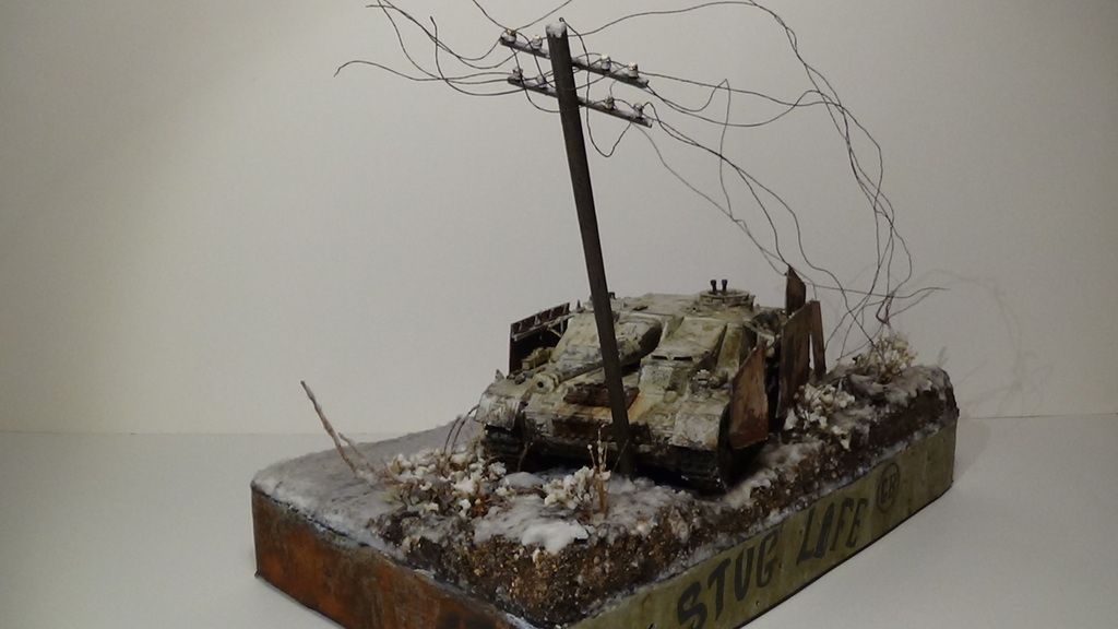

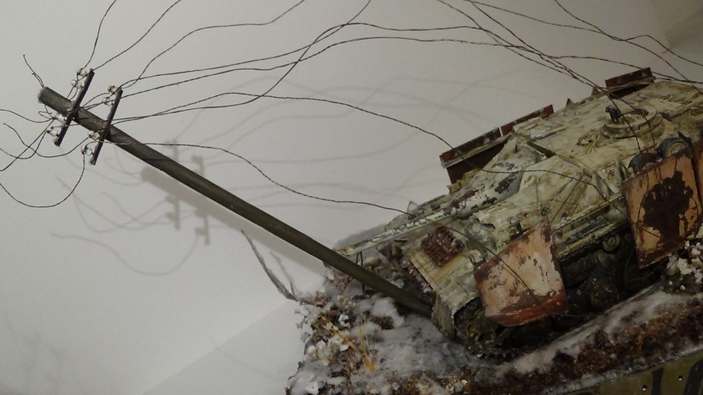

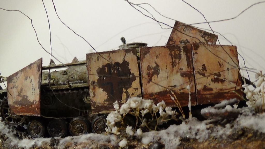

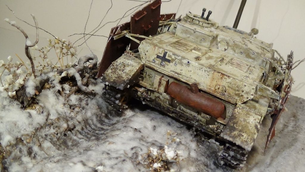

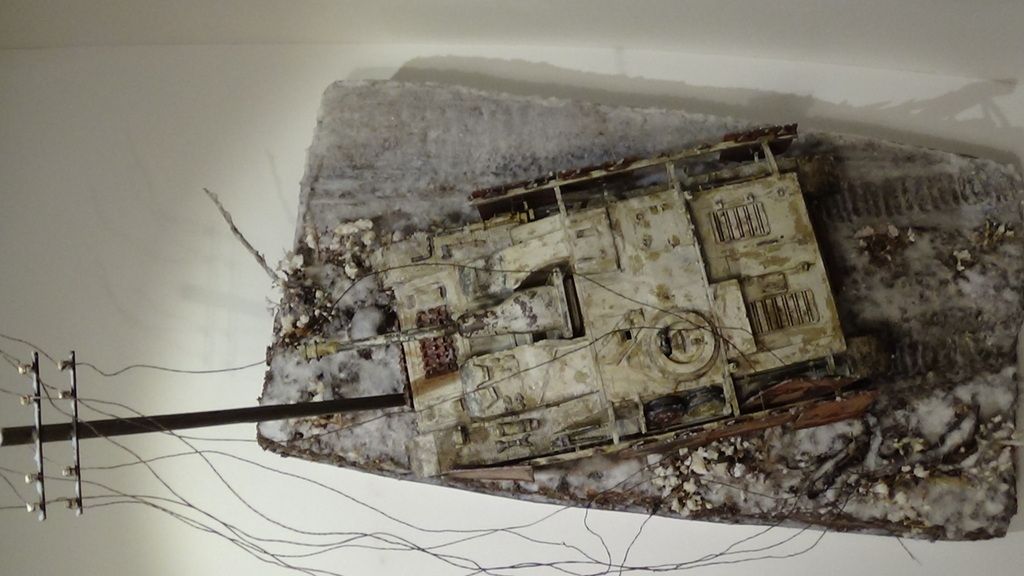

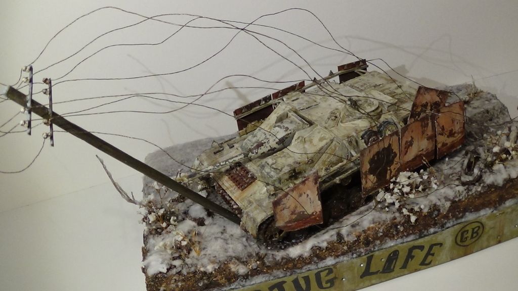

"Stug Life" GB StuG IV Update 4 & Final Reveal
[youtube]3Id3LIVVlUI[/youtube]
TIMBER!!!

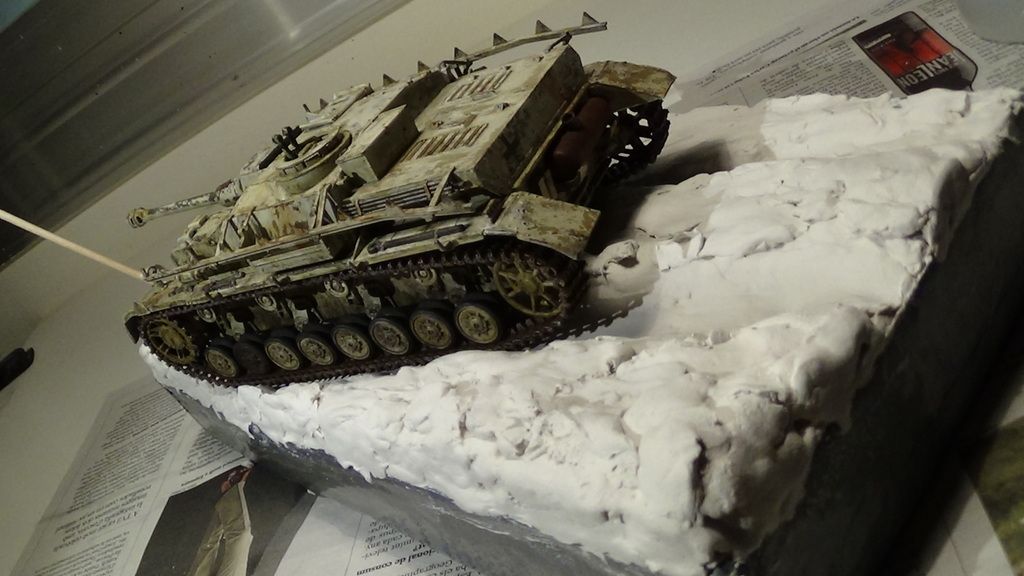

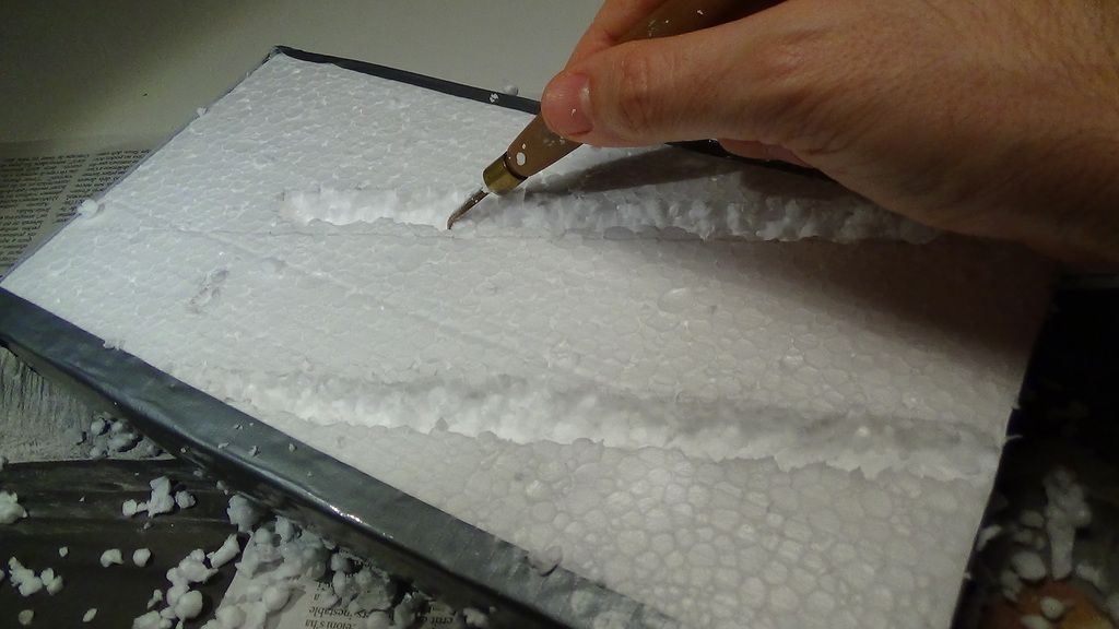

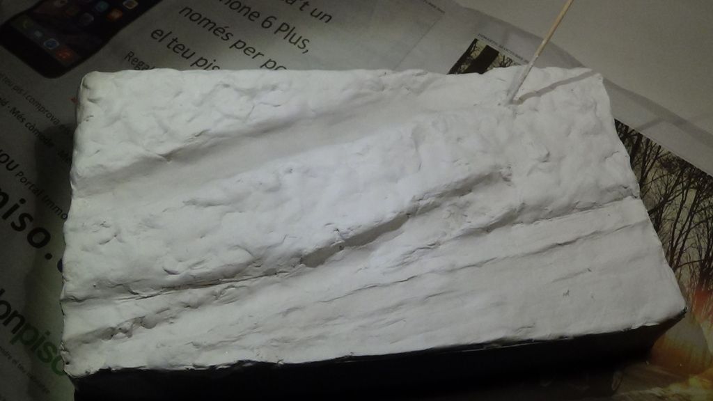

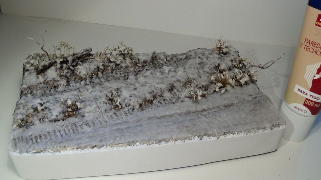

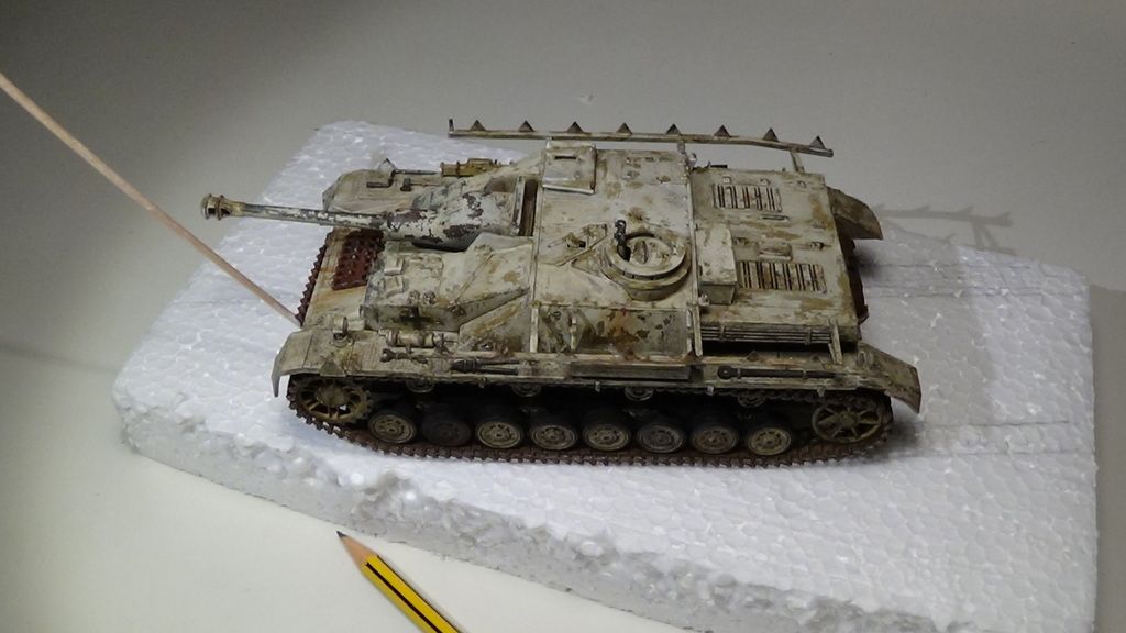

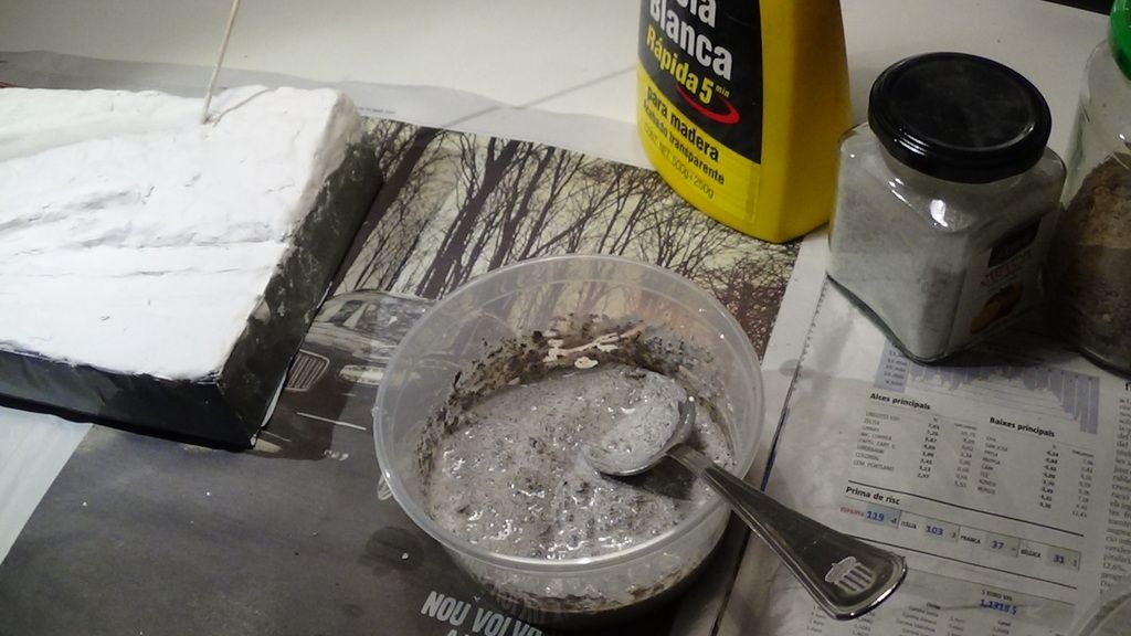

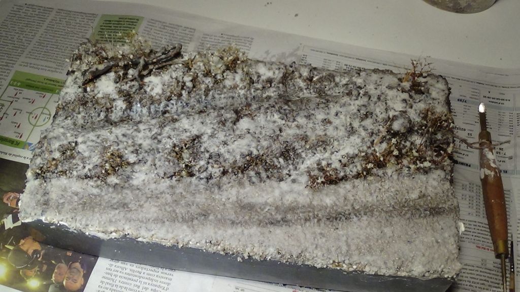

Planning the scene on styrofoam
Styro-digging; We want the Stug "in", not "on"

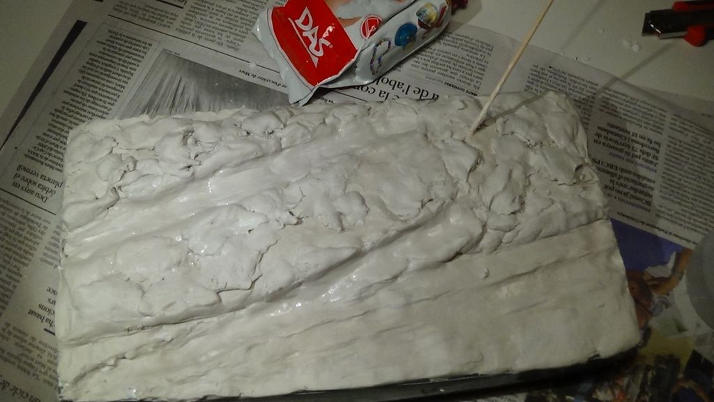

First layer of white clay. We let it dry...
A second layer is added. It looks ok
Dry. Now we can work on it

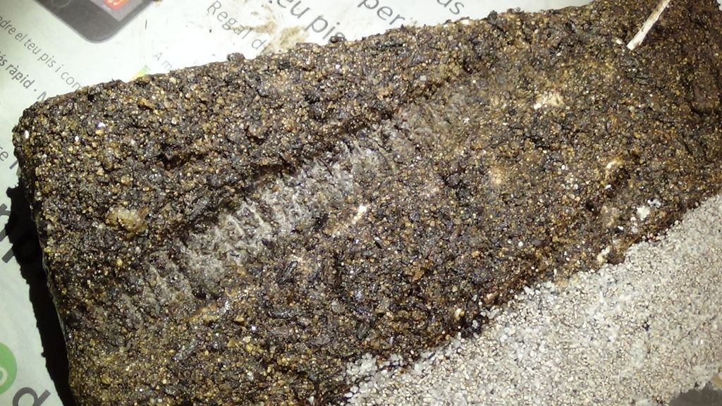

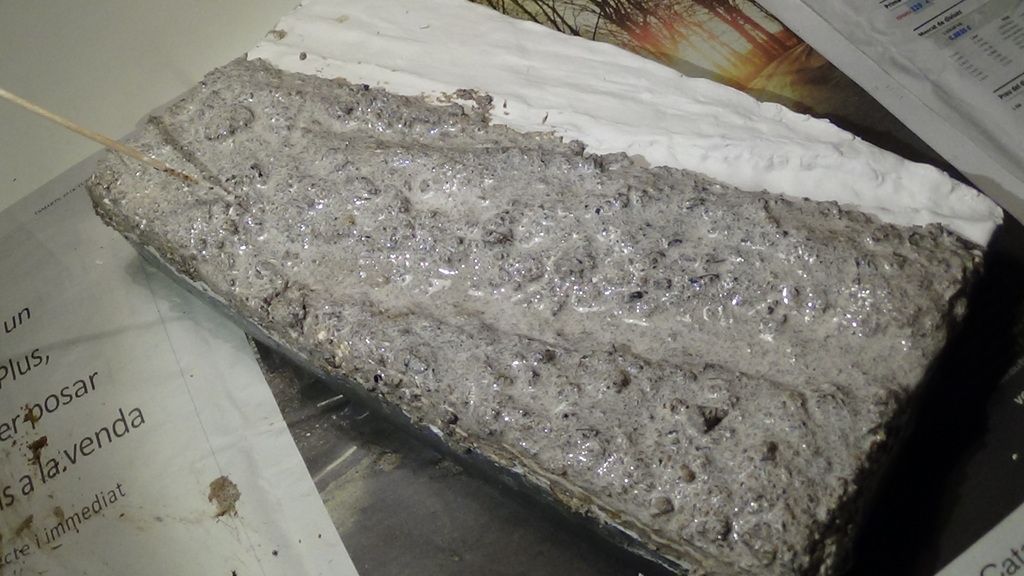

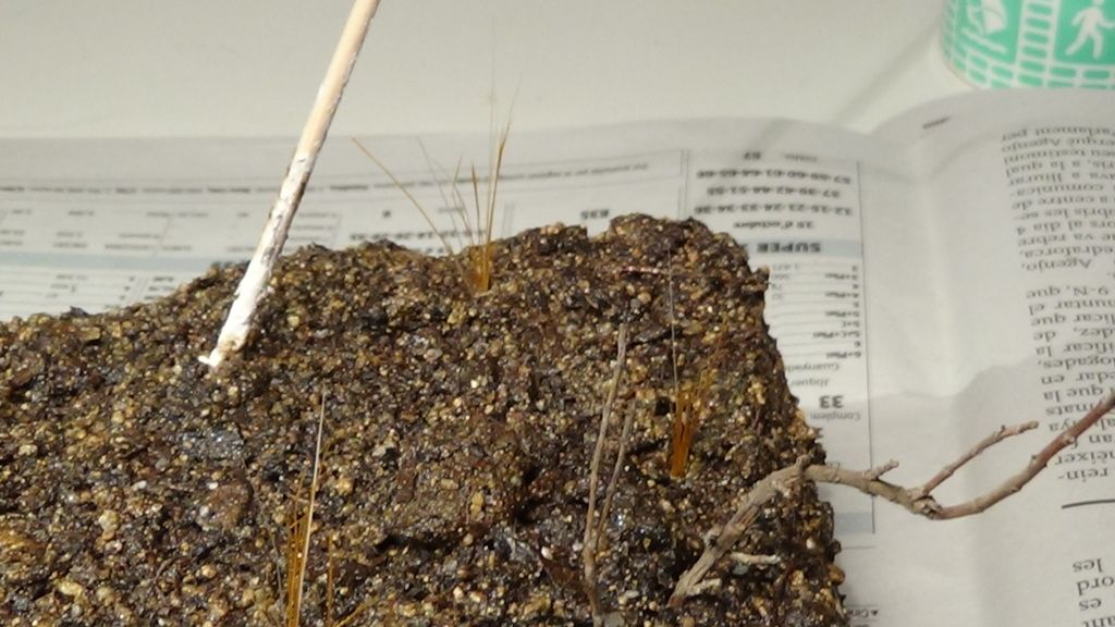

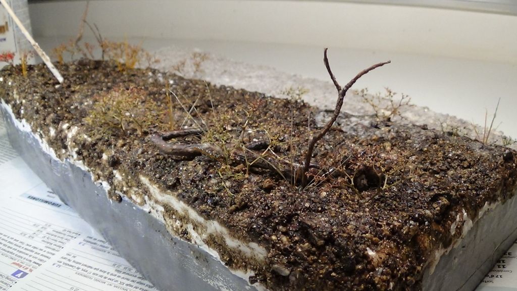

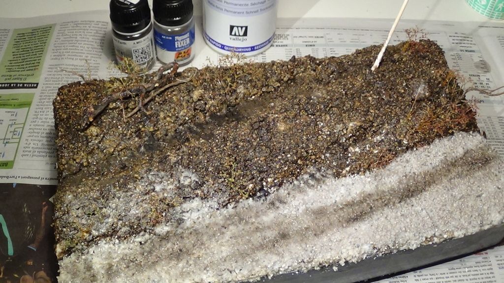

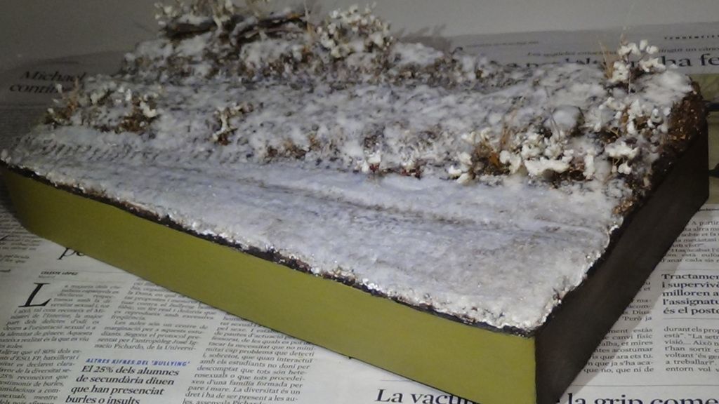

Real soil + white glue
We let it dry (24h... or more!)

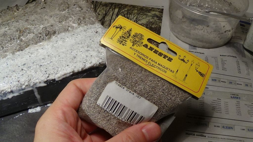

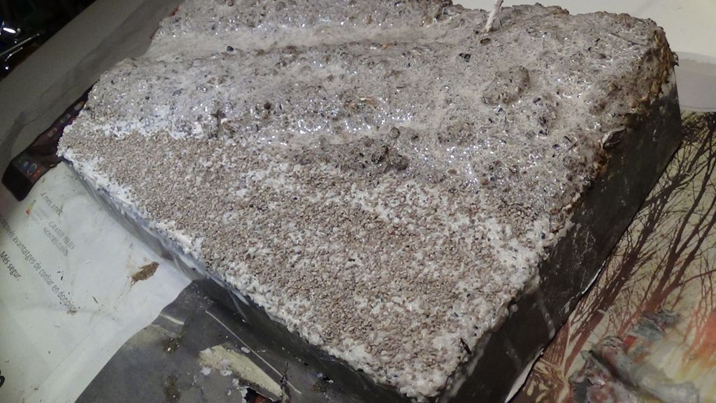

I'm using coarse marble dust and white glue on that road
Looking good...
I'm adding this gravel on the road
Not bad
Just branded those track prints before it was completely dry
Vegetation: Tall grass, small branches...
..and "sea foam"

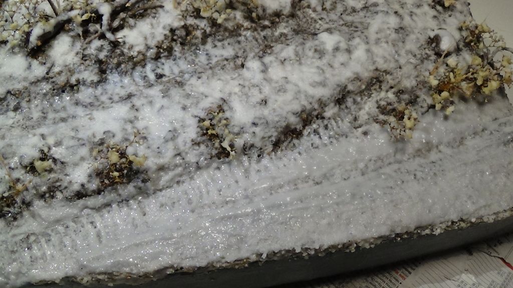

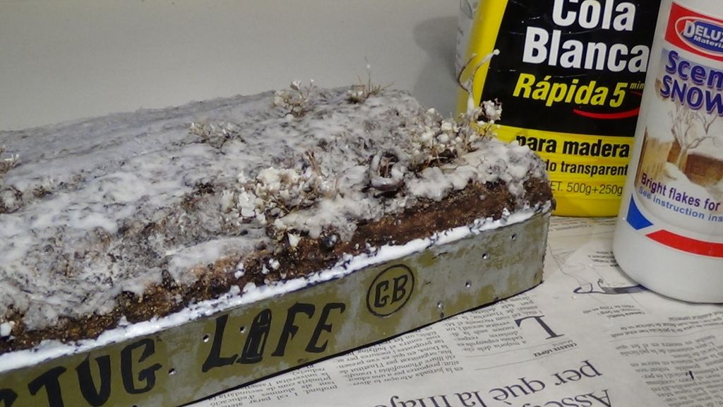

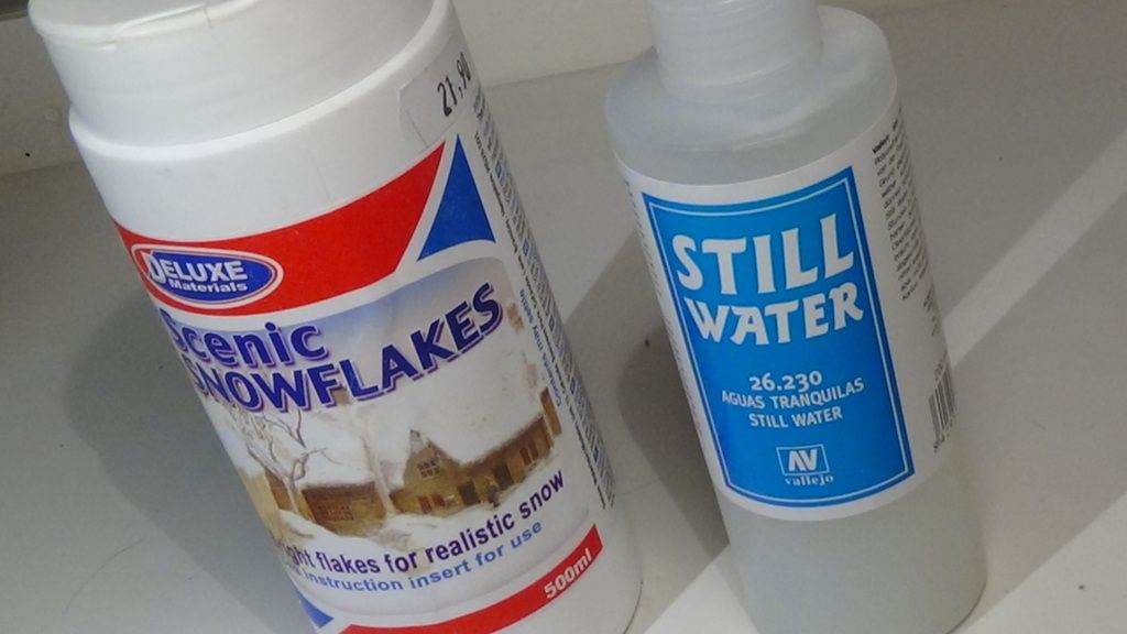

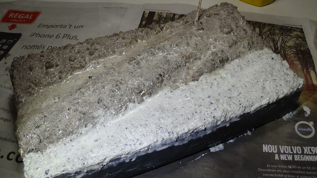

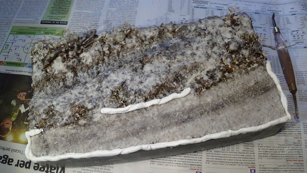

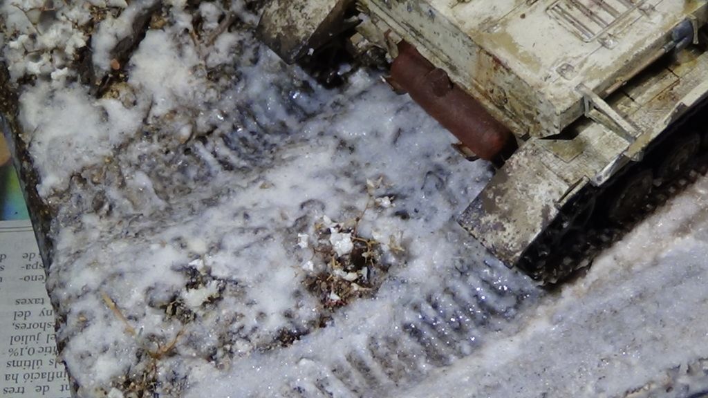

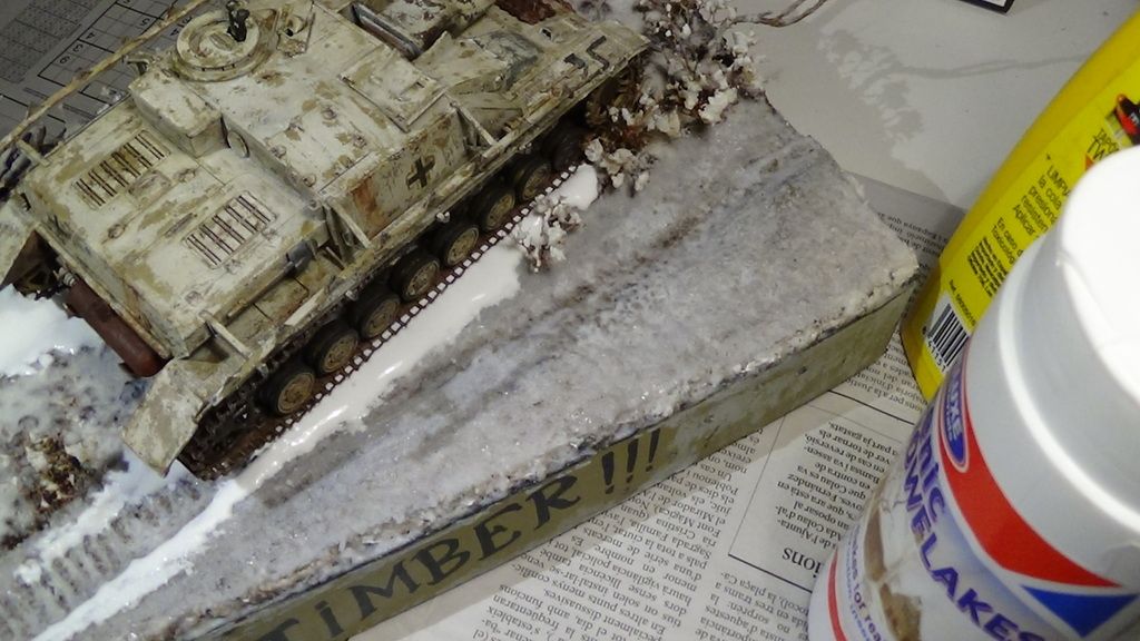

I'm going to start with that road
The first layer is quite diluted. I'll keep on adding layers till it has consistency. I've added some Russian Earth pigments
Looks good
I added three layers of snow+still water allowing each one to dry at least twelve hours, the first layer was more waterish and the other two layers were thicker. I came across a little problem; sea foam has natural tanines and I had to whiten that snow a little bit more
I'm going to create a dam
An icy swimming pool with a little bit of grey acrylics
After a while (30min) tracks can be branded

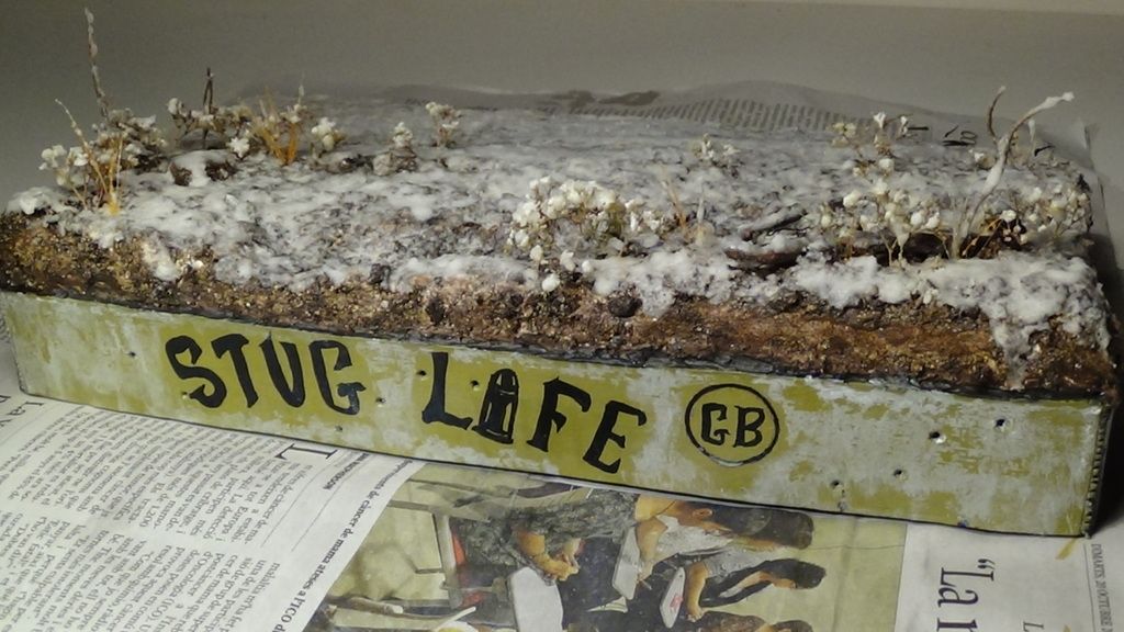

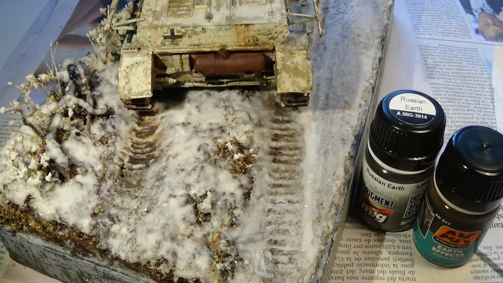

Adding Russian Earth

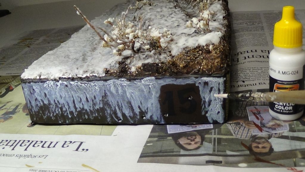

Seams around the "box" are corrected with putty
The base is primed
It mimics the Stug's colours
Letters are hand-brushed
A few bullet holes look good :)

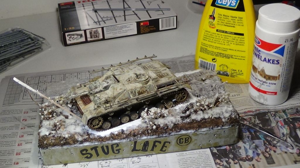

Washable white is added
You can remove it with water if you don't wait too much
I'm using white glue and snow for those seams

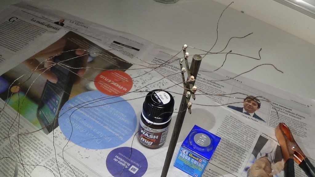

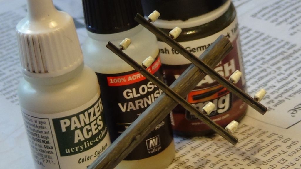

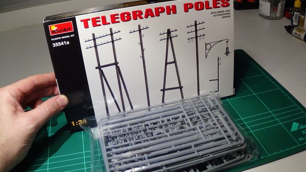

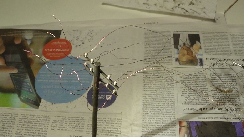

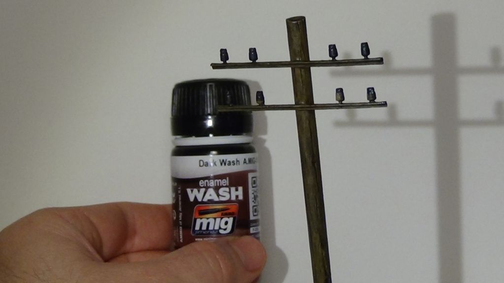

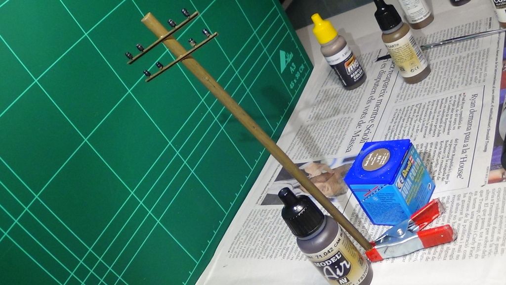

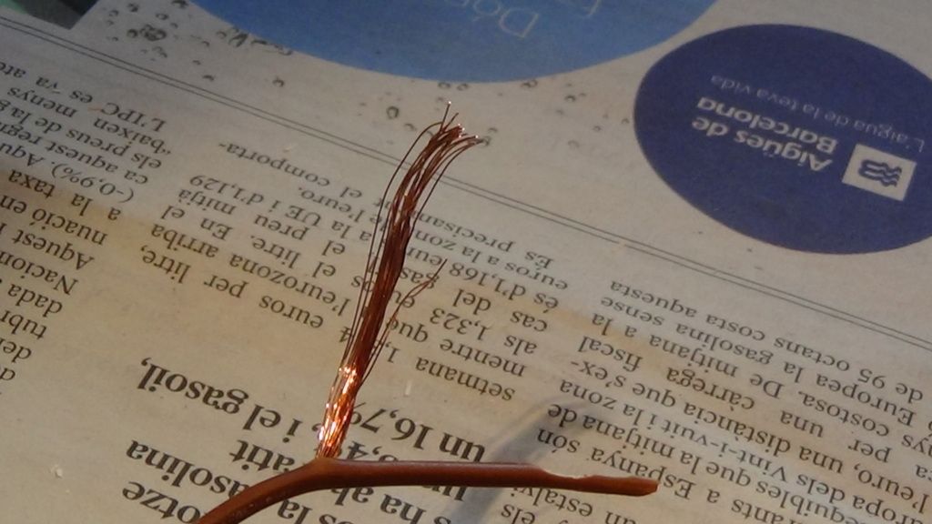

You can build your own customised pole
Sealing the Stug with white glue and snow
I'll fix the mess with pigments and a layer of Vallejo still water and snow
I let the glue dry (24h) while I attack that pole
I'm usig a couple of brown colours
..and a dark wash
Ok. The glue is not completely dry so I can brand more track prints
Pigments are added
I've just dry-brushed the pole with whitish tones
I'm going to use real copper for those wires
The china stuff is ready... I've added gloss
Looks crazy!
Finally I've added mud and a last layer of snow + still water
FINAL REVEAL
THANKS FOR FOLLOWING THE THREAD!!!! :cheers2:
Magnificent Felis!
A thousand kinds of awesome buddy.
The final is superb and the presentation of the build is first rate as always.
Wow dude!
:thumb1: :thumb1: :thumb1: :thumb1: :thumb1: :thumb1:

Thank you Michael!!! :) You da Masta!!!

:eeek: Awesome final product! Great work on that base it's pretty spectacular.

I'm truly amazed.... I don't even know what else to say. :jd: :cheers2:

well i cant find a superlative to do it justice!
