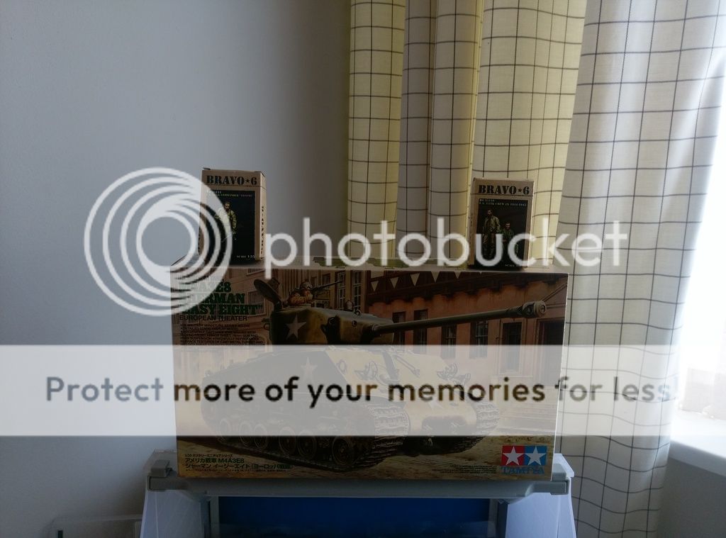

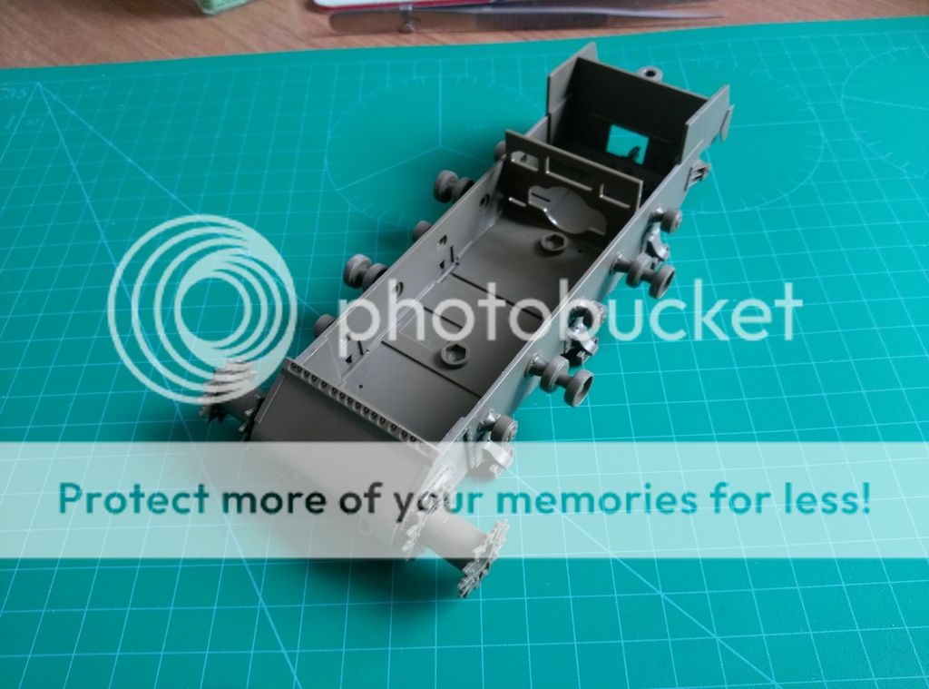

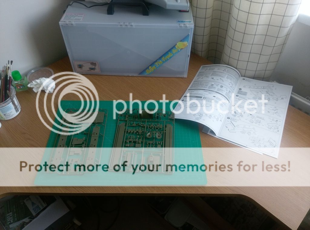

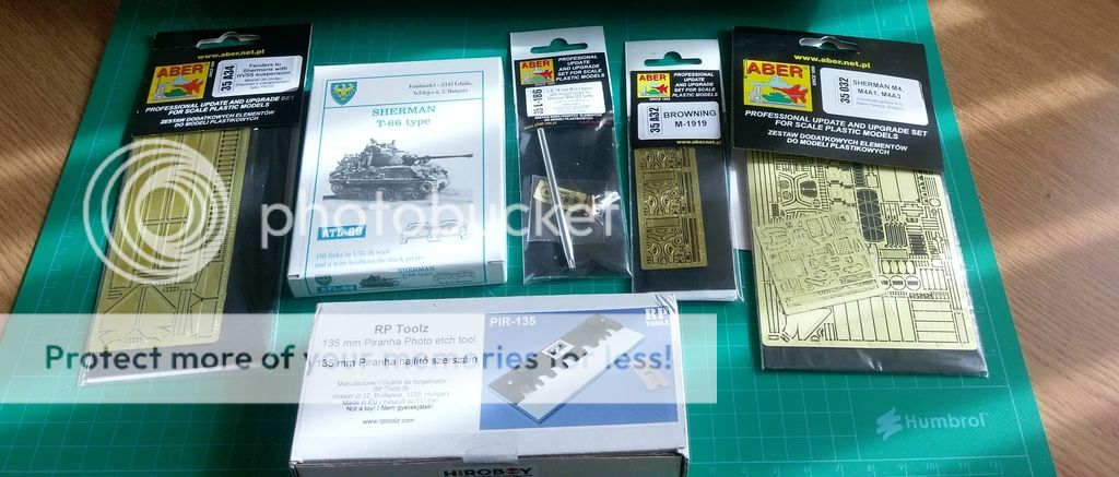

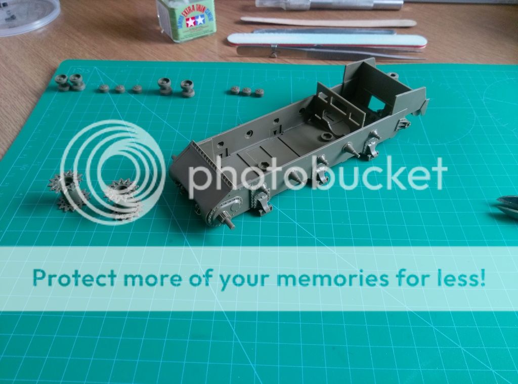

Yep the build has started :th: :banana:
I'm building Tamiya's M4A3E8, plus Fruil tracks, Aber photoetch & barrel kits, Verlinden Fury stowage kit (in bound from the US) and SK miniatures figures. I'm aiming for a Fury diorama not quite sure what yet but it will be based on some part of the film.
As promised here are a few shots of the progress
I'll keep you posted.

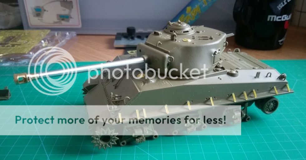

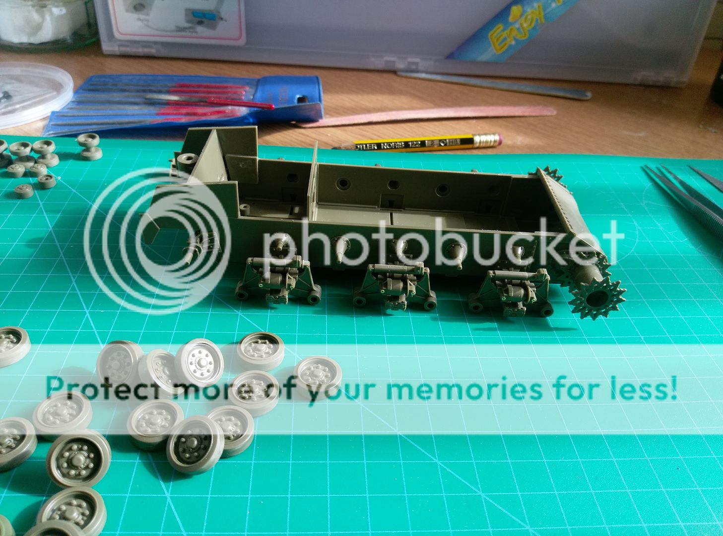

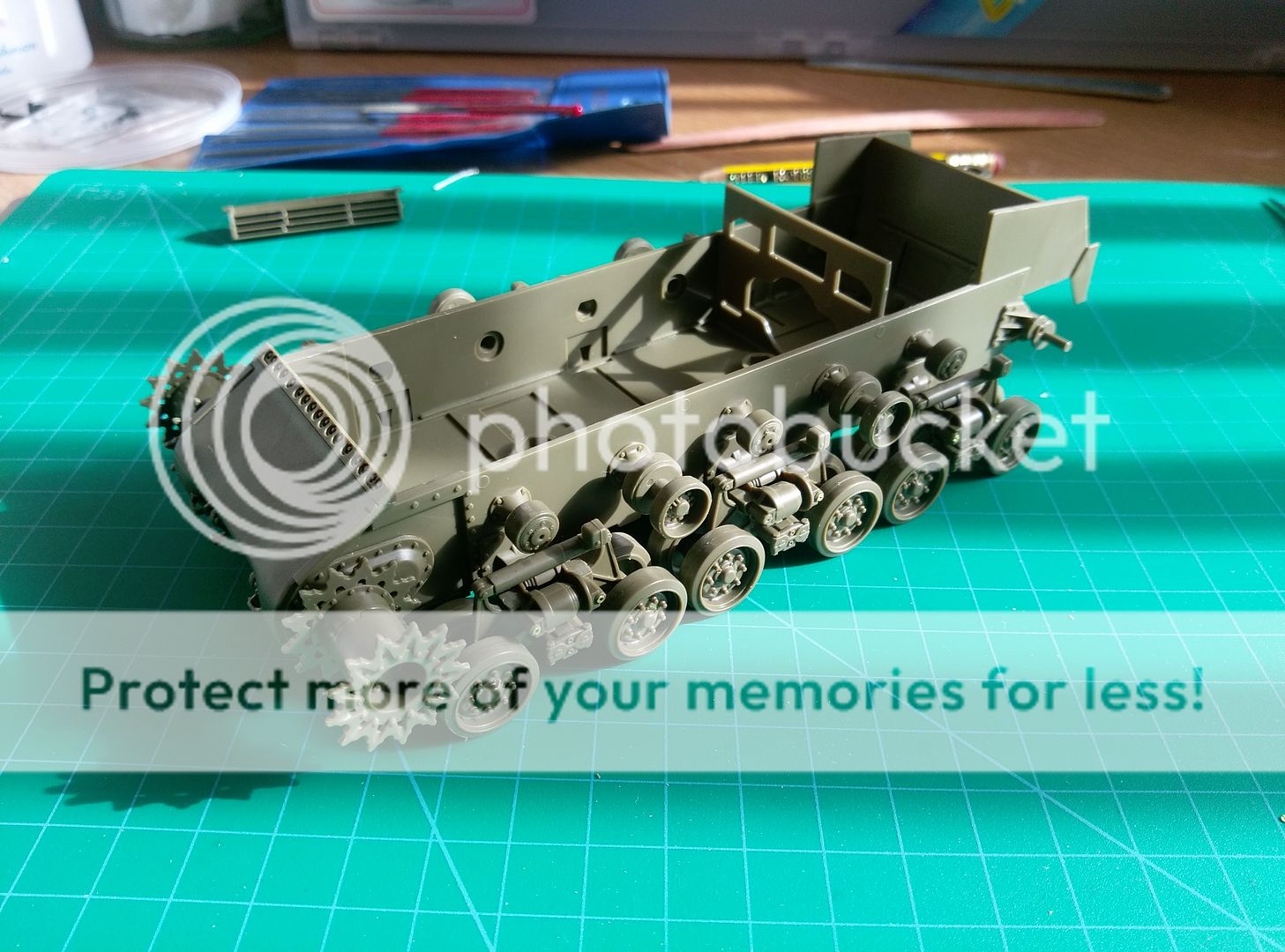

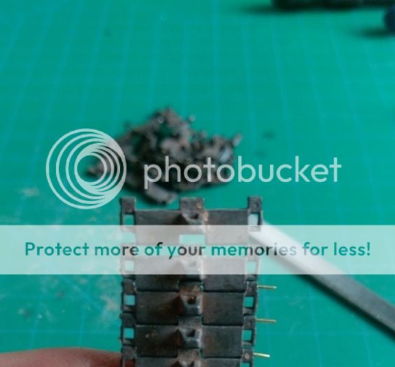

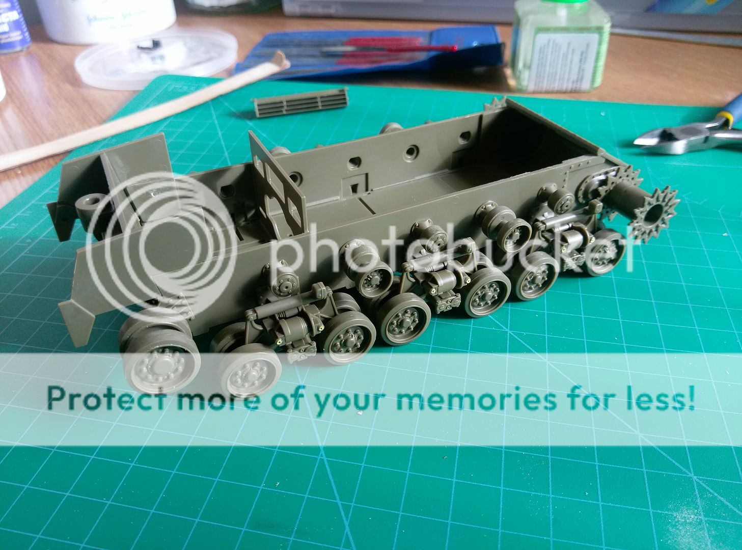

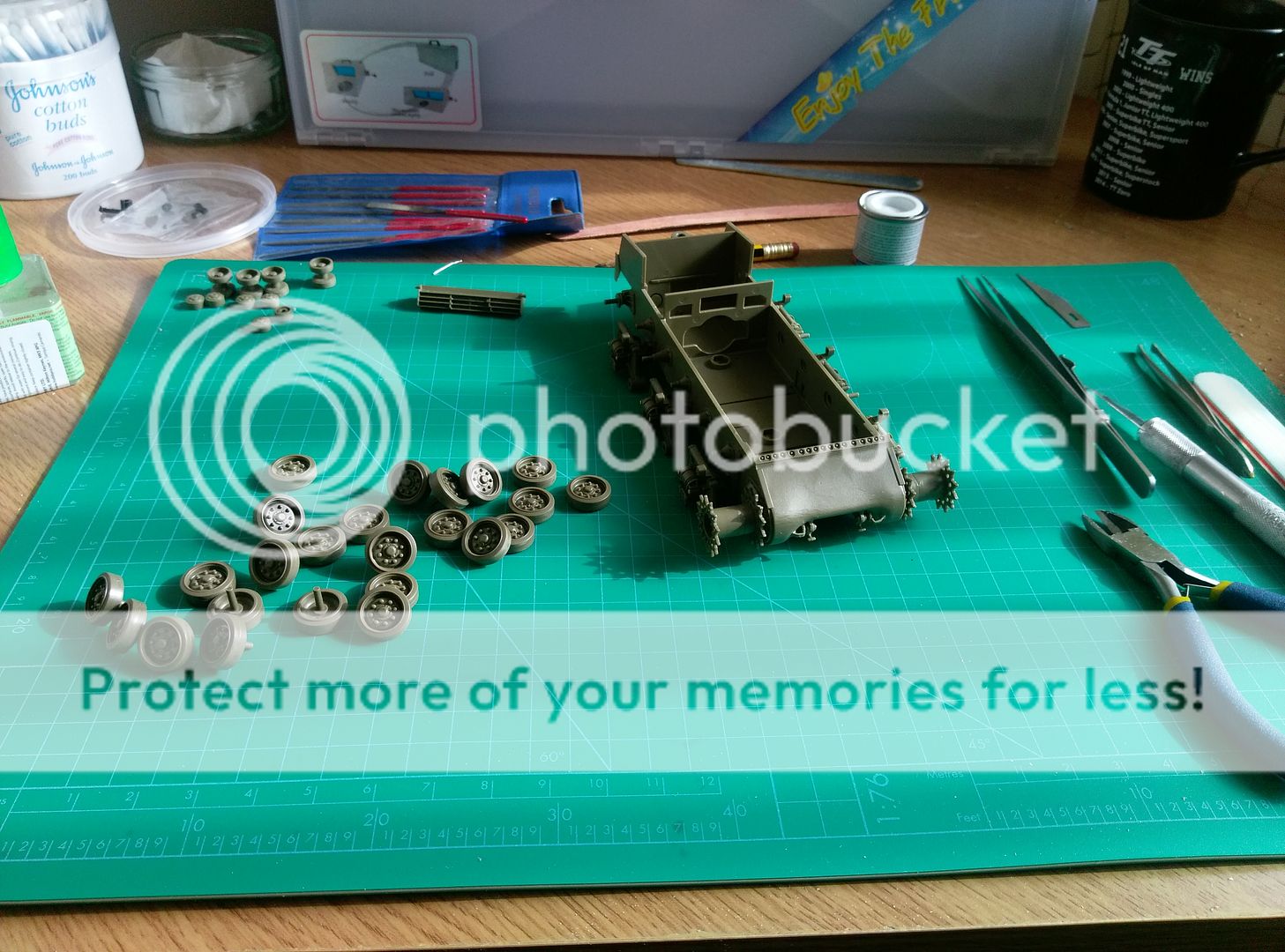

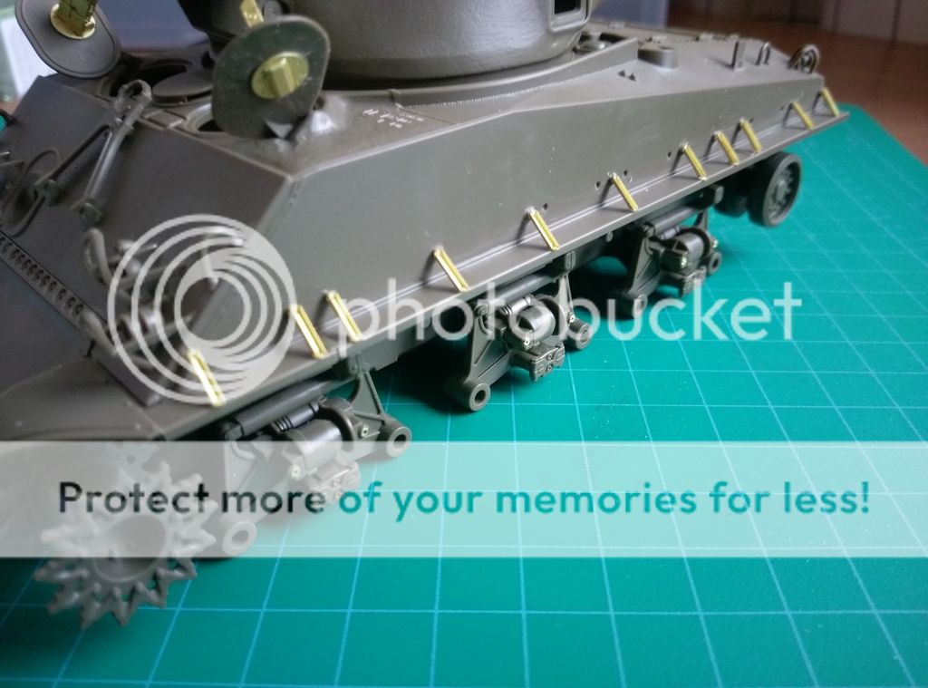

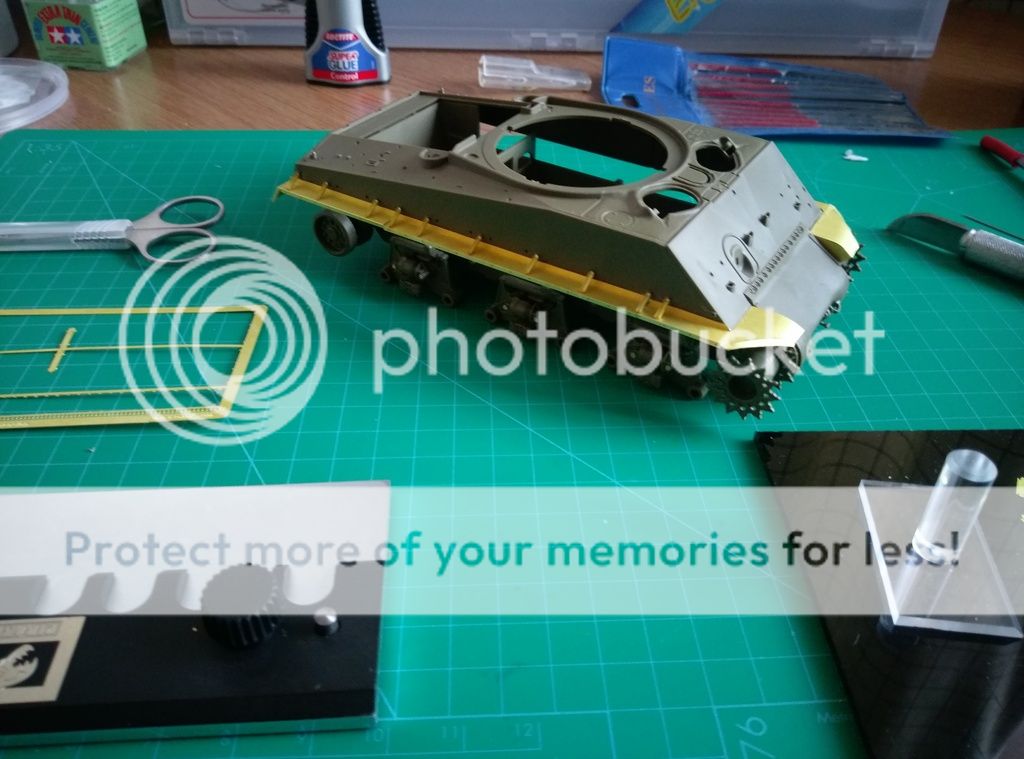

Had a bit of time this evening
Posts: 5647
Re: First build for almost 30 yrs
A bit further, this PE is fiddly stuff but I think I'm getting the hang of it.......same about the CA glue its a right pain

My first build after a 20 year break also was a small 1:72 cheap kit to get it back in the fingers :-)
By the look of this, It's hard to believe you didn't build for 30 years. Looks too good compared to my 1/72 one ;-)

I am pleased with how it's going I have to say but it is 33yrs since I built an AVF I've helped my lads build the odd car and plane over the years but they were all simple kits and the last time I did that was at least 10yrs. I was well into modelling years back and really loved doing it, I'm hoping it's like riding a bike :lol: :lol: :shhh:

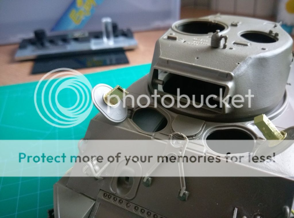

Managed to get sometime on the beach yesterday
Not too long now and the painting will start :th:

Kev, Sweet result on the build so far mate. The hull hatches came out awesome. Looking forward to seeing the end result as I'm now building my first diorama in a good 20 odd years. Like Paul already said go big or go home, is the approach there to. Good kits and aftermarket all the way...

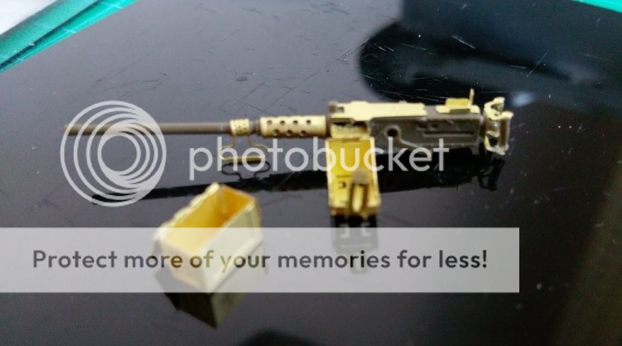

Think I'm slowly getting the hang of this photoetch now

nice result on the .50 cal. It does look like your getting back in your stride mate

That .50 looks excellent, I'd say PE is agreeing with you.

Great detailing. PE looks fantastic, and that metal barrel is a thing of beauty!

Many thanks mate, I've not done PE before but was a very very keen modeller in my teens.........how long ago was that! :eeek: :jd:

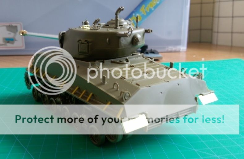

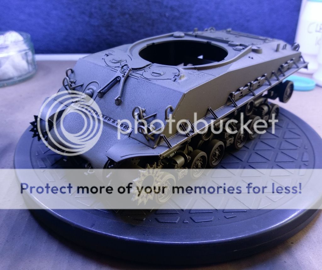

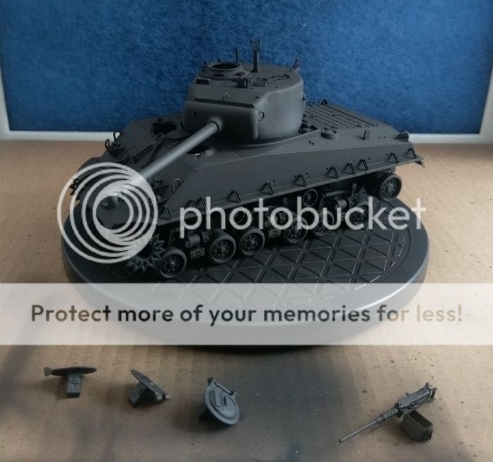

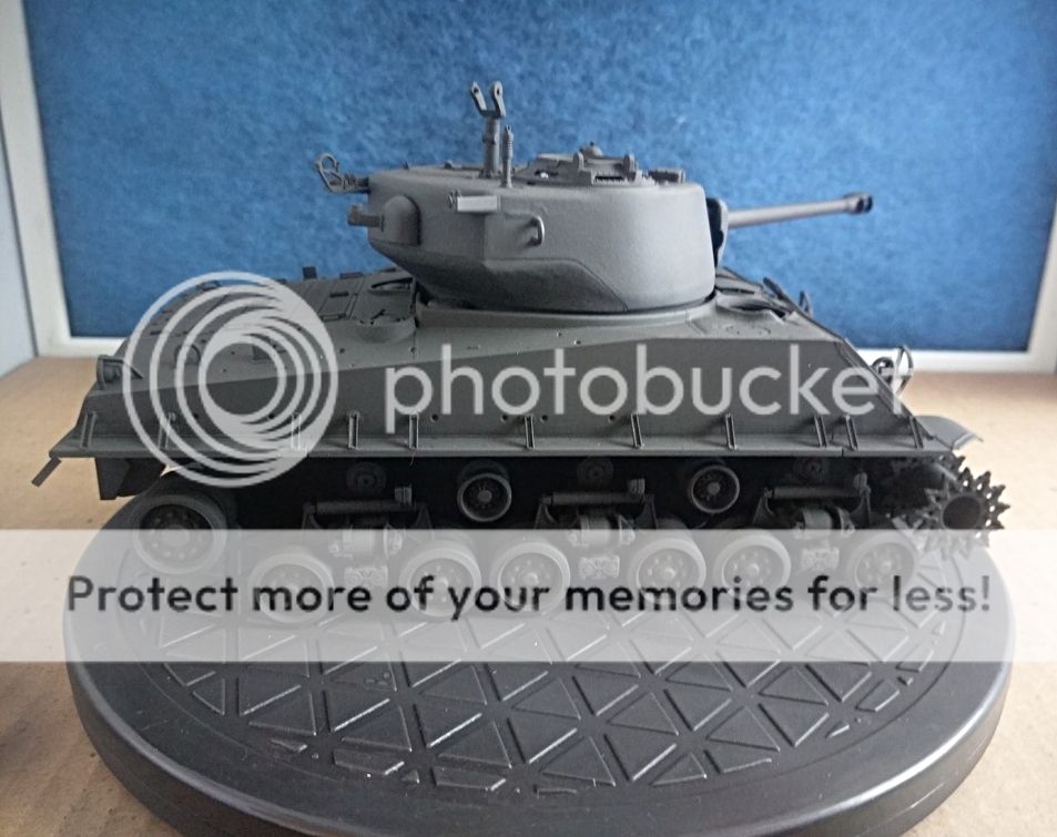

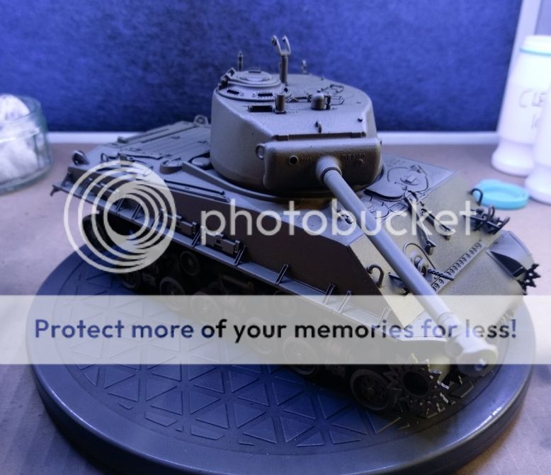

Had a bit more time on the bench today, it's almost fully assembled now and ready to start painting
I decided to fit the wheels in the end and paint while attached, the hull mounted tools, MG's will be painted separately and added before weathering, the tracks need to be build yet and weathered.
I've also got the Verlinden Fury set to sort out which is resin, something else I've never worked with. :crazy: Looking at the parts within in the kit there's lots of cleaning up to do and I'm going to need to read up on the "how to do's" on working with resin all advice gratefully received. I have made a start with the M1919 MG which is mounted in front of the commanders cupola but I'm not too impressed with the moulding. The ammo box/feed tray are moulded as one the MG body isn't long enough to attach it! :scratch:: I'll post something later about this.
So to the painting, not new but haven't done it for yep.... 30yrs and with old Revel airbrush been practising so I'm confidant things will workout ok.
Now a question if I may do I go black or gray primer?

Kev, the Sherman is looking real nice.
I've seen you talk about the photo etch used for the .50. I know for a fact that Aber also do a pe update for the .50 call itself (I know because I have it in the stash 35 L 080, For the .50 call Browning M2, And this also includes the correct mounting cradle). Some nice additions to this set would be 35 A047 (.30 and .50 ammo belts) and 35 A058 (U.S. WWII Ammo cans) but the you have a gun that worth close to 30 Euro in PE alone :jd:
Ad to that the Academy U.S. Machine Gun Set # 1384 (some say the best set ever made) at around 6 euro and the detailing cost are really starting to add up..
As to your question about primer color. From what I've seen and read so far on armer modeling (not really my cup of tea) is that they usually go for a rust or hull red primer as this will aid in the weathering later on.
In aircraft it is the new trend to black primer and not to pre-shading. However I do beleave that this trend has not skipped camps as of yet to the armour scene so grey and black panel lines are stil "allowed" ;)
I know the older Revell airbrush kits where actually Bagger 150's or Thayer and Chandler veda (now also owned by Bagger) Airbrushes. So if treated right they are pretty bullet proof. An added bonus is that spares for these airbrushes are readily available.
Already looking forward to your next installment on this build
AS always best regards and happy modeling

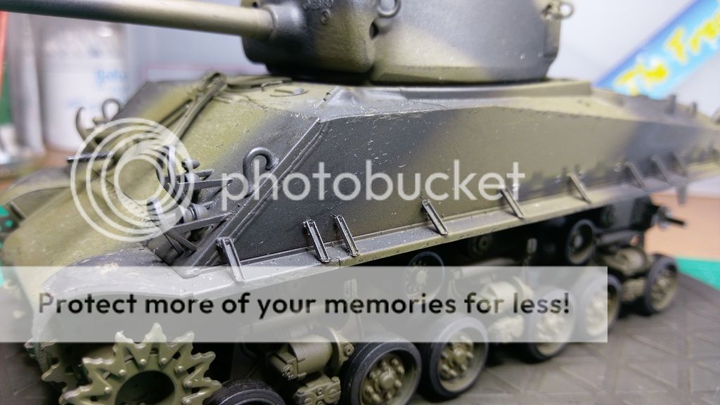

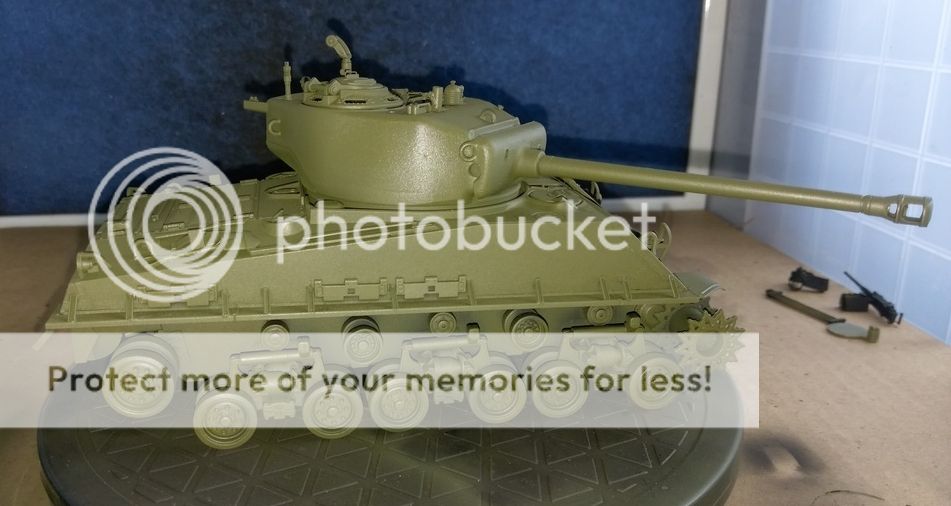

Did a bit more yesterday hit a few issues with the airbrushing see here http://www.intscalemodeller.com/viewtop ... 10&t=17651
All sorted now :th: here's the results.
Still a long way to go but I'm loving it :th:

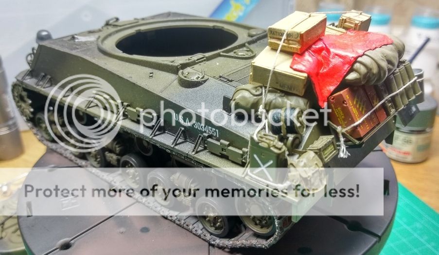

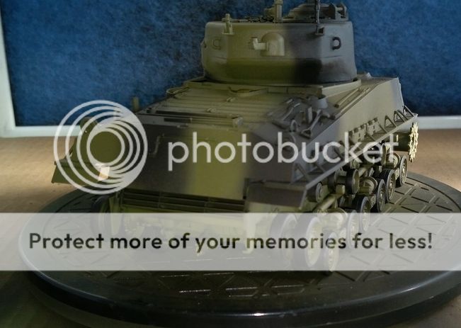

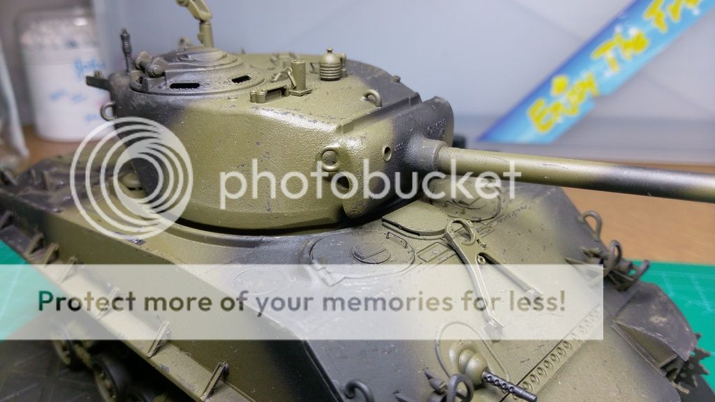

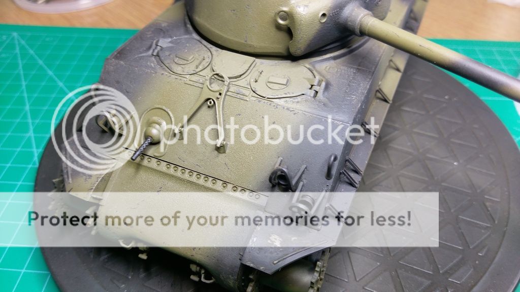

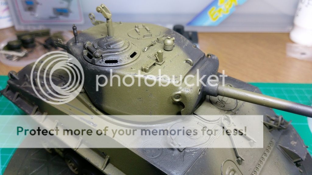

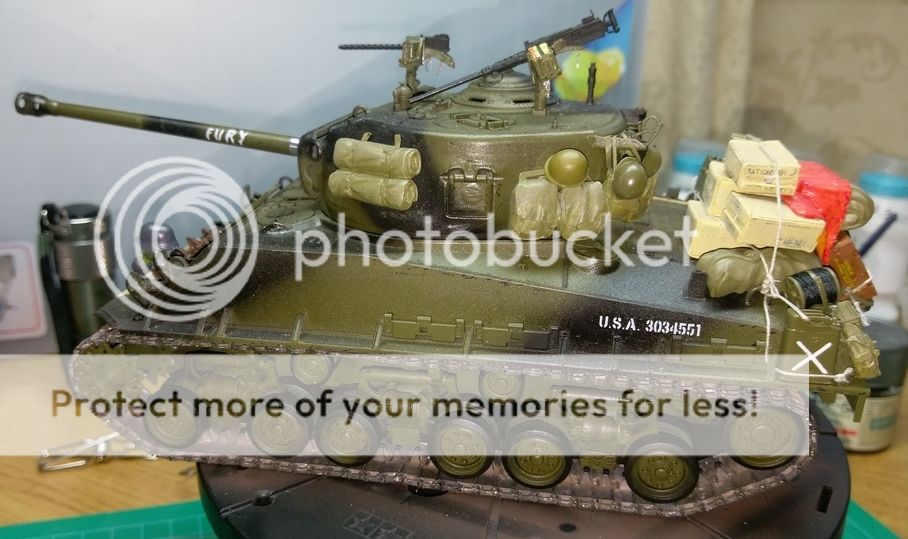

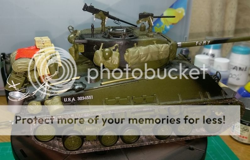

A very busy weekend doing this and that with family, but I managed to get time on the bench :th:
Got the chipping coats on
It's Ammo Mig went for the scratches rather than heavy chipping, it's odd stuff and made the surface rough not too bad but certainly not smooth. I thinned it as it wouldn't spray properly while testing I thinned about 20% and increased the air to about 28psi to get it too spray on the test, I think it needs more thinning though as it left a rougher surface any views?
Then the base colour, I'm using http://www.migjimenez.com/en/starter-se ... -set-.html for the model. You can see the roughing effect the chipping coat has had, look on the hull sides and the front glacis plate, the lower front casting is supposed to be rough. I had the thin the base coat about 20% as well. Almost had a disaster, I noticed little bits in the base on the track guards, I think they were elements of the chipping coat still left in the airbrush :eeek: god this stuff is tricky. Strip down and thorough clean of the needle/nozzle and all well, it could also have been fibres from the kitchen roll but that good quality stuff but you never know. The areas near the top idle wheels where you can see the primer have been sorted, I'm little puzzled though as olive drab base is slightly silk not hard matt, not sure why?
On to the back cam, had no issues with this thinned again by 20%, having no issues I think is due to gaining experience using the airbrush I even airbrushed the rubber on the main wheels :dance: not quite up to standard but not bad for a .04 airbrush if I don't say my self :banana:
Detail painting next, then chipping, decals and clear coat, onwards and upwards :th:
Overall a good weekend on the bench, learnt loads and confidence growing.

Looking good Kev,
Depending on the tools you are going to be using for the scratching and chipping, you might want to swap the detail painting and chipping steps..
Keep spraying paint.

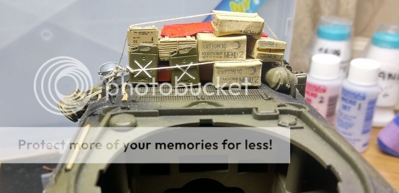

Yes I think you've got a point there :th: As you know this is based on the movie tank I'm going to base it on a scene form the earlier part on the film but that will depend on me getting the last two crewman, I'm using SK miniatures still waiting on http://www.fieldsofglorymodels.co.uk/13 ... -409-p.asp if I can't get them I'll have to rethink. Anyway there not that much in the way of chips or battle damage in the early part from the stills I've seen plus for a first build in years I don't want to be over ambitious, I've still got so much to learn.
I've been looking for somewhere to get decals as the one's in the kit obviously don't have the correct hull numbers etc, the other thing I'm searching for is some kind of thread to simulate the rope that ties down the storage.

A very nice looking Fury so far Kev :th:

Kev, Nice resin figures did a bit of digging for ya found a supplier in Belgium that has stock on all B6 Fury figures check out www.domino.be as these figures will most likely be limited edition bet get while the getting is good..

Holy smokin' Shermans she's looking fabulous :th: :th:

You're doing a fantastic job on her!

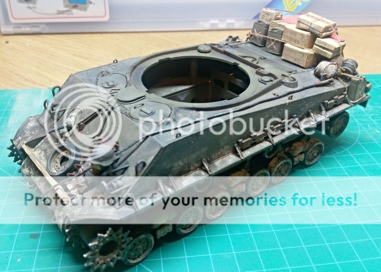

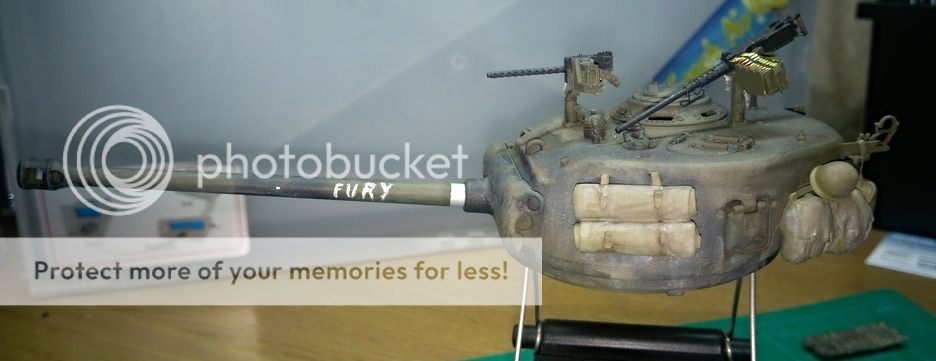

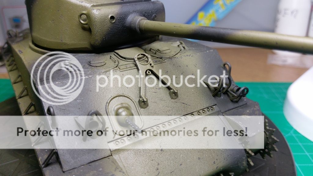

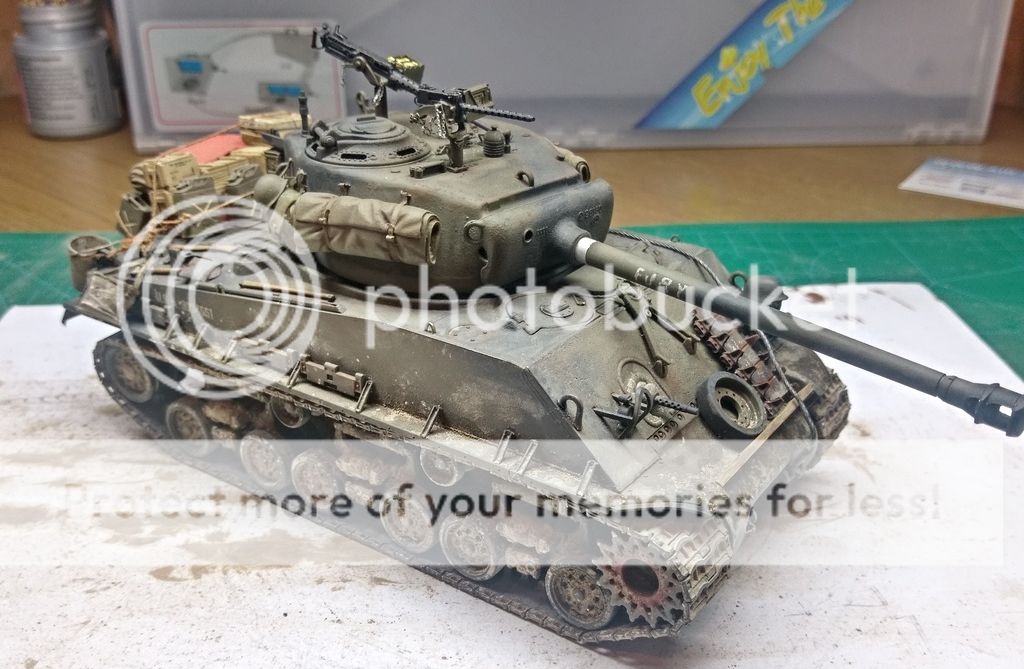

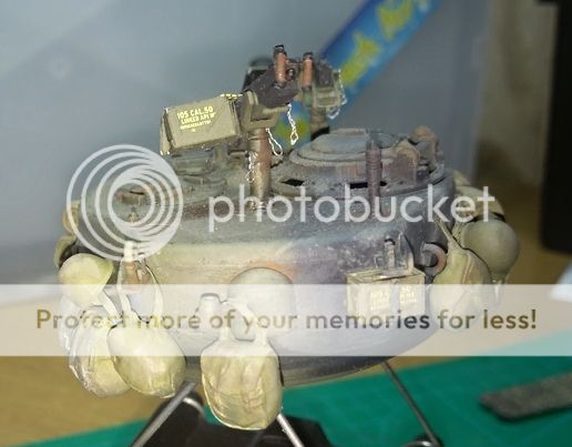

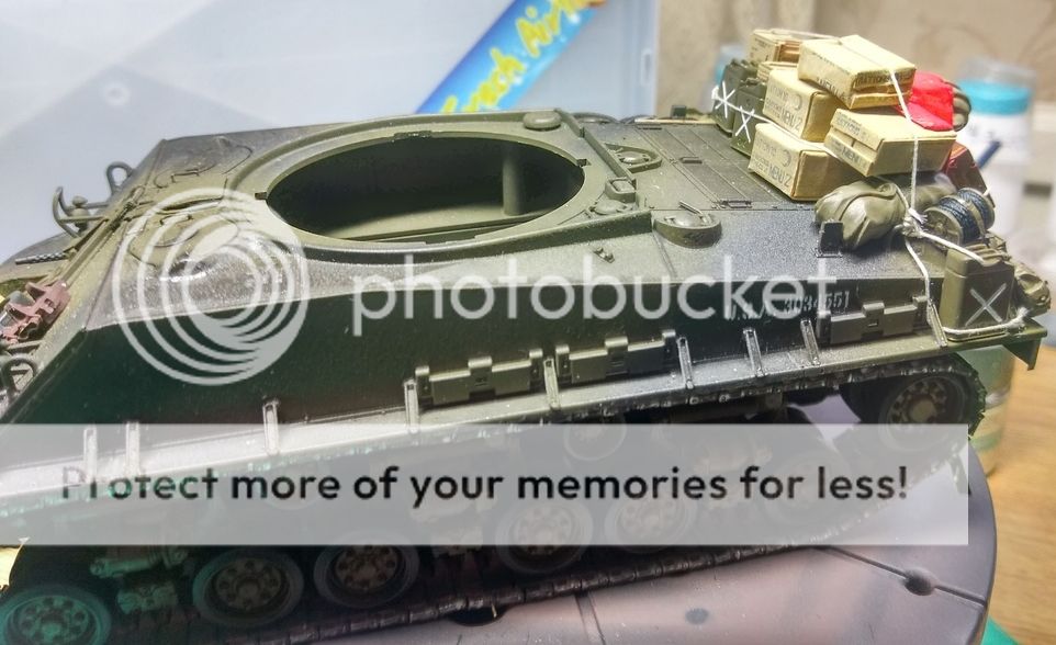

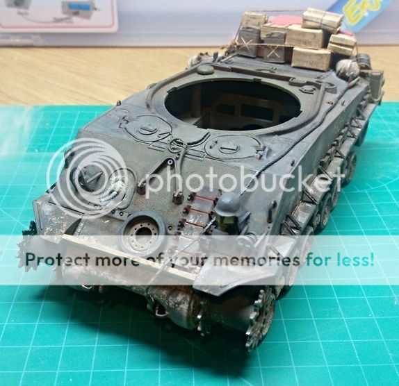

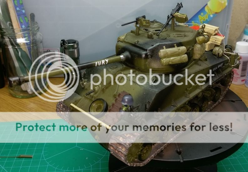

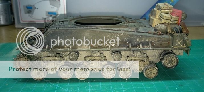

Got a couple hours in yesterday evening, my first attempt at chipping. It's very light but on all the pictures I can find there's not lot on the real thing, I think it works and will improve when all the weathering is added.

Awesome build Kev, cool chipping affects,

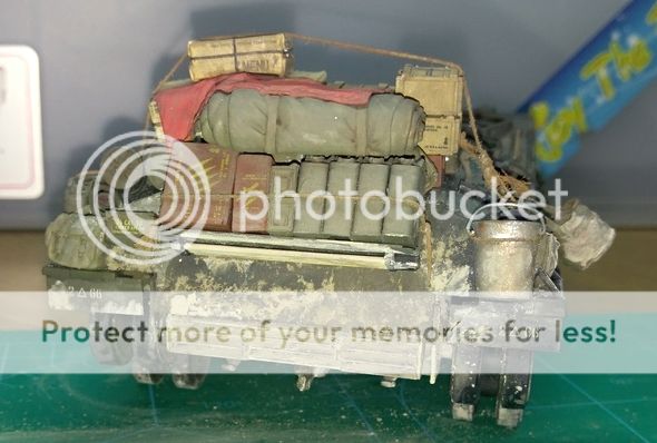

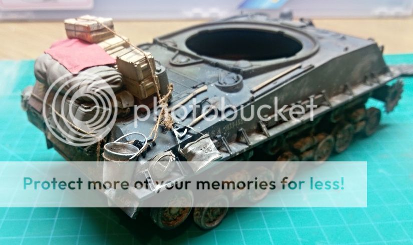

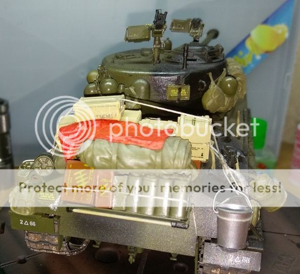

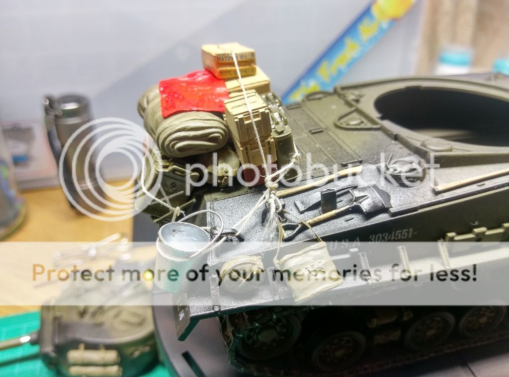

Thanks mate it's going well thus far with the odd "Oh bugger" as you do :lol:
I'll be putting the tools and other hull accessories back on later, I PVA them to prime them you can see the missing spaces in the pictures. I would have liked to have clear coated so I could start on the decals and weathering but I forgot to order gloss varnish when I kitted myself out, that should arrive today/tomorrow with luck. I made a start on the Friul tracks last night chasing out the holes and tidying them up, hopefully get the burnished today and start their assembly/weathering tomorrow after clear coating while it dries.
It's slowly coming together :th:

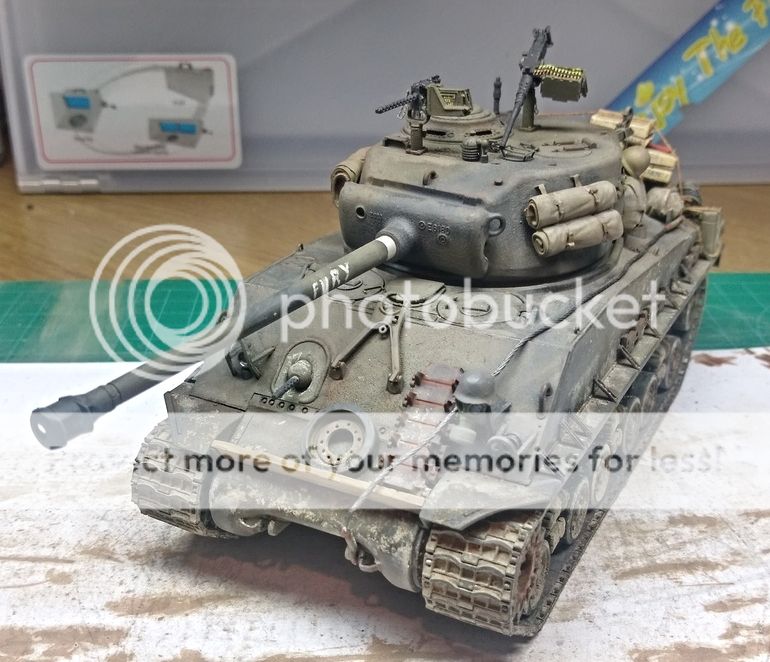

Kev we all stil have the "Oh bugger or the odd get in there you ... peace of plastic" moments are part of the charm of our hobby ;)
The paint job and chipping came out nice, not bad at all for a first venture back after a 30 year sabbatical :th:

I like how random and varied chipping is. This is the way to go. Well done!

Really like how this build is coming together. The camo looks great and the subtle chipping adds some great contrast. Can't wait to see how it looks once you start putting the weathering on. Kind of makes me want to try my hand at some US armor. May have to pick something up eventually.

I've been working on the friul tracks last couple days, bench time has been hard to find this week :crazy:
As I mentioned earlier
Kevthemodeller wrote:Paul the tracks are a great deal of work. The burnishing was straightforward but the fit of the links isn't brilliant. By that I mean they don't fit or are very tight when put together. That's before the link wire has been put in the wire it's self doesn't help either because being coiled means each bit you cut is also bowed. I also found chasing through the link pin holes pre-burnishing a waste of time as many became blocked with a fine powder and needed redoing. All that said they still look great.
Here's what I mean just about every single link has been the same and I've only just completed one side so far :eeek:
As you can see they don't fit too well, I wasn't expecting this based on what I'd seen in videos on line I have to say, the odd one certainly but not just about all. It's been a very slow process taking much longer than I was anticipating, whether it just this pattern or it effects all types I don't know I've got them on order for my Tiger so when they arrive I'll let you know.
But I think worth it, pictures when they're all finished.
